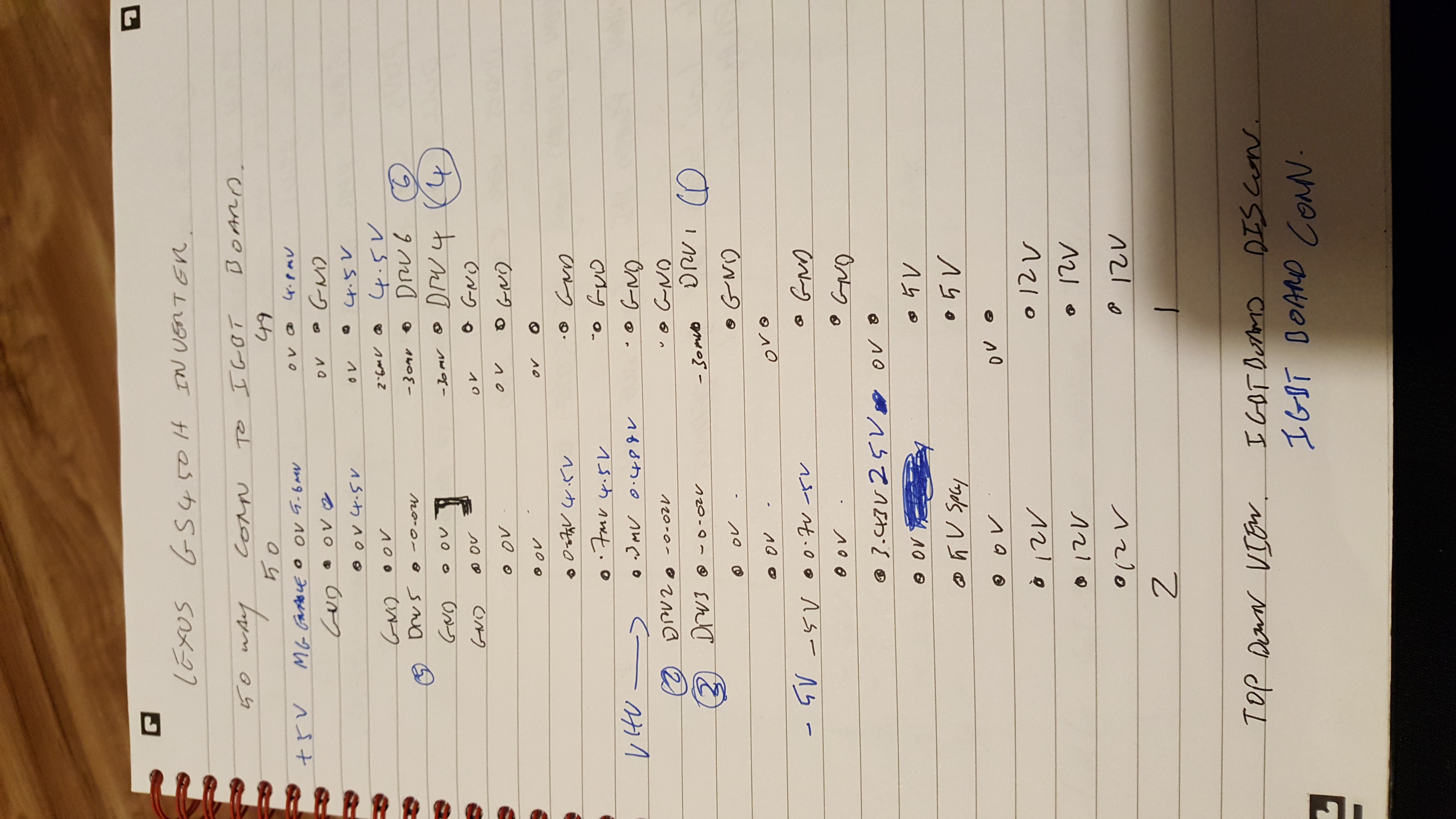

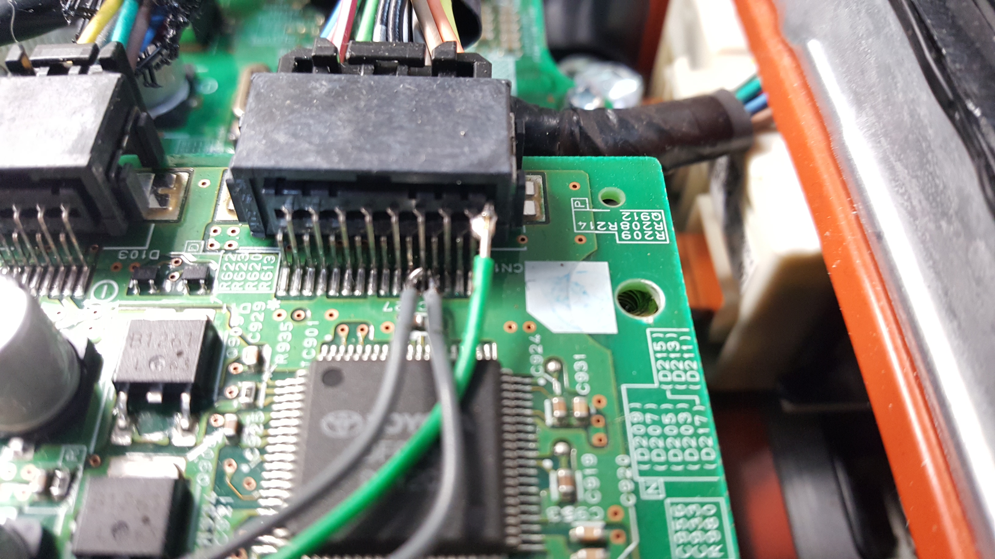

Re: Lexus Inverter Hacking
Figured I'd forget in the morning so grabbed my notes. Of course my pos scanner won't work with Linux so snapped a few photos. Hope it helps. In the photo you can see the two grey wires carrying the pwm signal and the green wire is +12v. iirc you may need to bypass a transistor on the back of the board to enable the booster. I'll try and get a few better pictures.
You'll need to tap the 50 way connector to get the hv and lv bus measurements.
Thanks Damien, I'll have another look at my setup.
I am using the same pins as your grey wires for PWM high and low, and am pulling the HV (inverter side) voltage from the same pin of the 50-pin connector as in your notes.
The green wire which you have as 12V, for me that's a 0-5v signal for the LV (converter input side) voltage. This also matches up with your pinout drawing for the connector. There is 12V present at the other end of the JST connector, again this matches your pinout drawing.
With this in mind, I don't have any notes on enable pins for the converter. I hope I'm just missing something simple. Here's what I have so far. Hopefully bypassing this transistor will get it to power up. Right now I'm getting no sign of life from the converter.

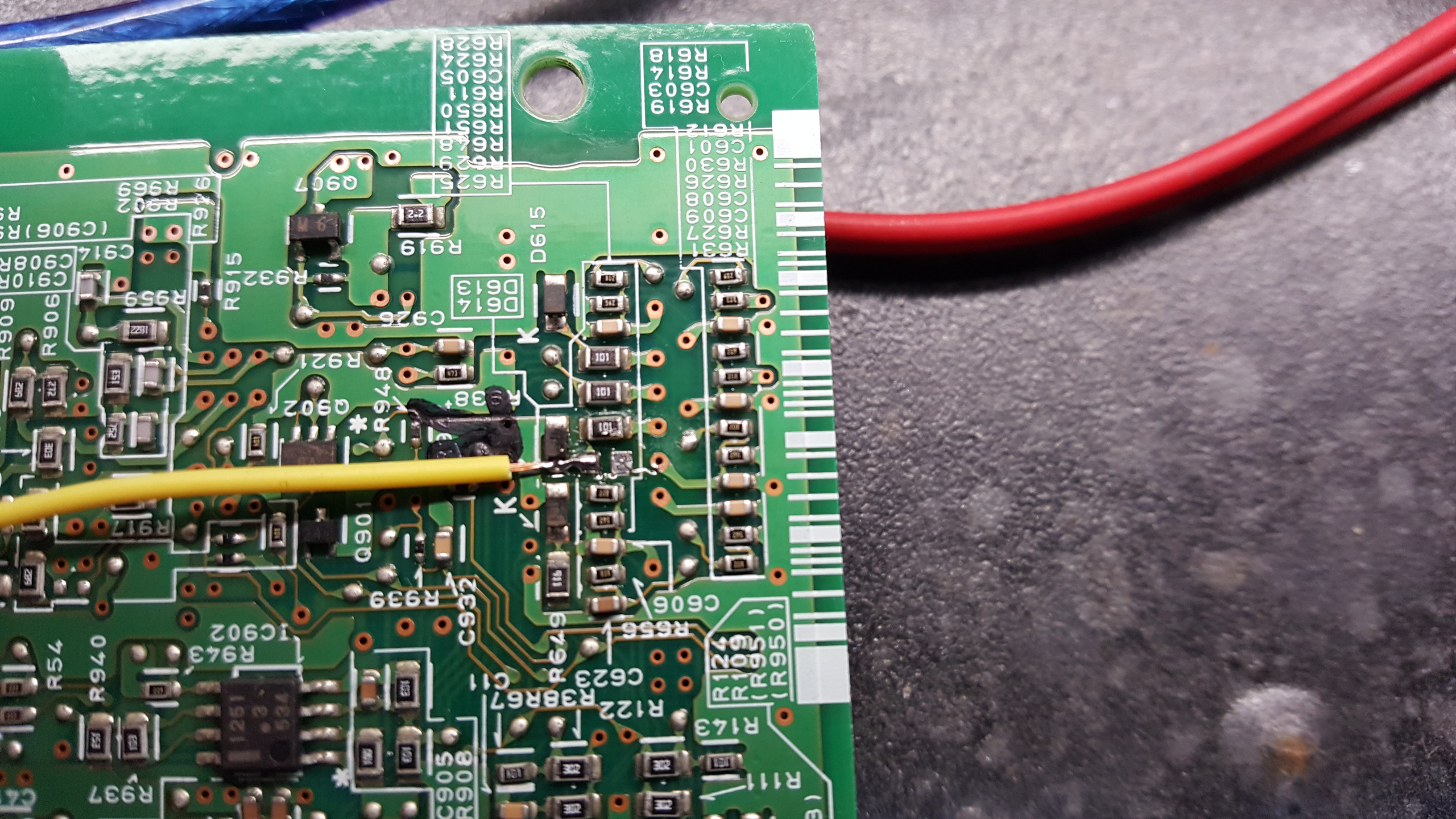

Here is a look at the back of the board with the enable line. The yellow wire needs to be pulled to ground if memory serves. I'll power it up over the weekend and confirm.
