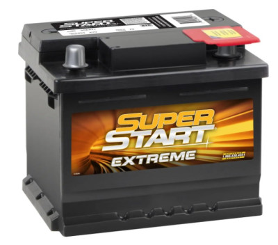

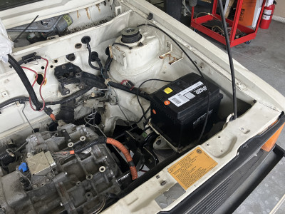

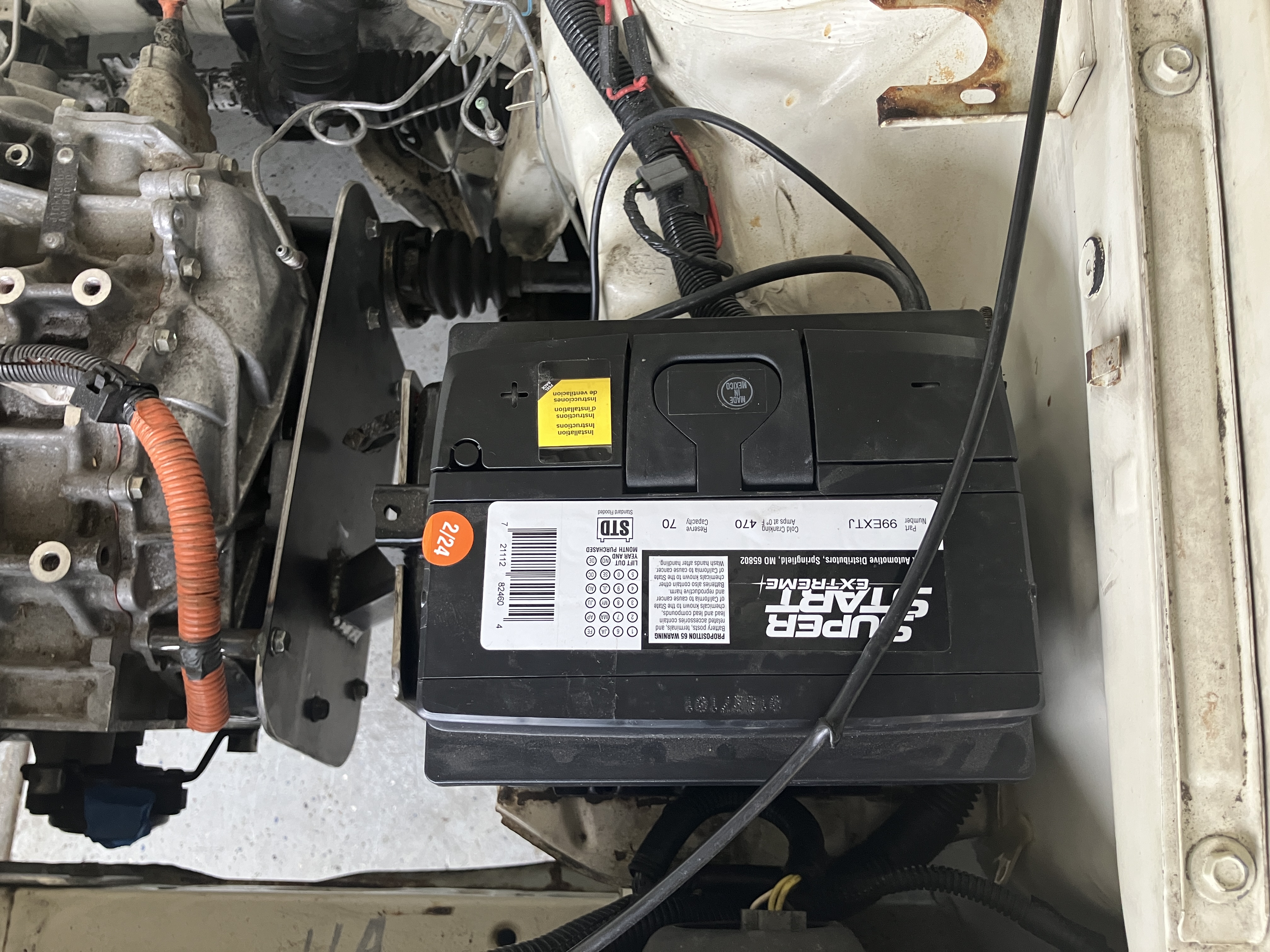

Guess who just spent $260 bucks on a regular 12 volt car battery? ... but did I mention it's a Super Start EXTREME, lol
Super Start Extreme Battery Group Size 99 T4 - 99EXTJ
Have battery prices gotten stupid expensive in your neck of the woods as well ?

Re: 1984 Voltswagen Rabbit Prius Gen 3
it do fit like a glove though... the two OEM sizes the computer recommended were surprisingly huge
Yes, batteries are really expensive on the east coast too. I'm looking at making LiFePo4 batteries instead. Pesky freezing temps that you cant charge is slowing that.

I would have used a motorcycle LiFePo instead. I used one in a LEAF for over a year in CO winters (down to -20F).

Not sure if you meant building a battery or the freezing temps & charging.
I was looking at using LEV60F cells with a BMS and a heater. I watched the video but I didn't see anything about how to deal with below freezing temps and charging. Was considering ultra caps then switching on the battery once above freezing but it's got a lot going on and clunky.

I am using small 30Ah AGM battery in Mazda now and it holds its own. It was like 80€ sometime back though.jrbe wrote: ↑Sun Mar 10, 2024 3:09 am Not sure if you meant building a battery or the freezing temps & charging.
Sometimes i see it falls down to 9V but i managed to get it up and it still holds charge. I think your normal Pb starter battery would just die under the abuse.
Important consideration is to lower the standby drain of the car as much as possible. All the standby relays draw quite a charge and if you can remove than you are mostly good with smaller battery.

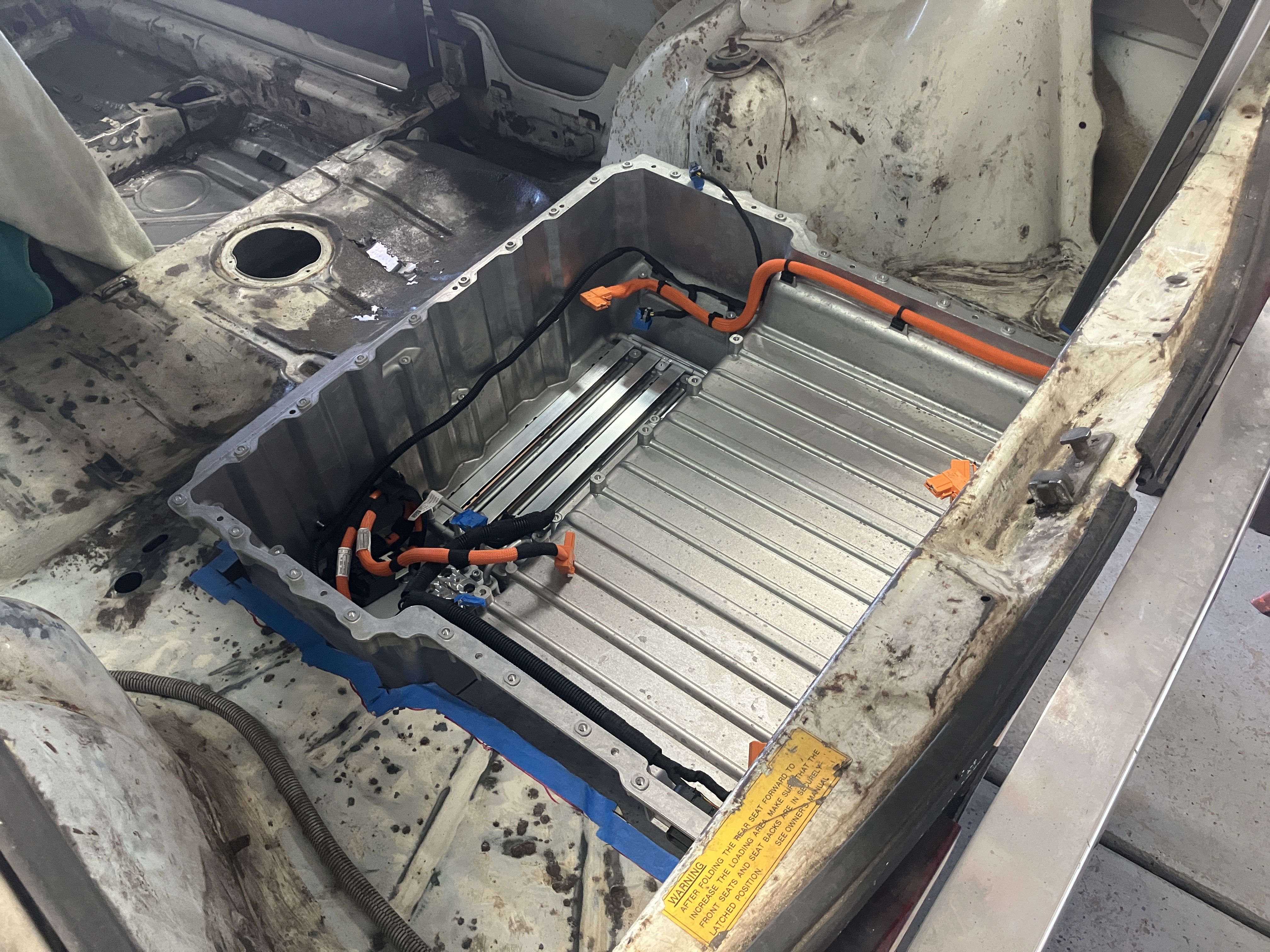

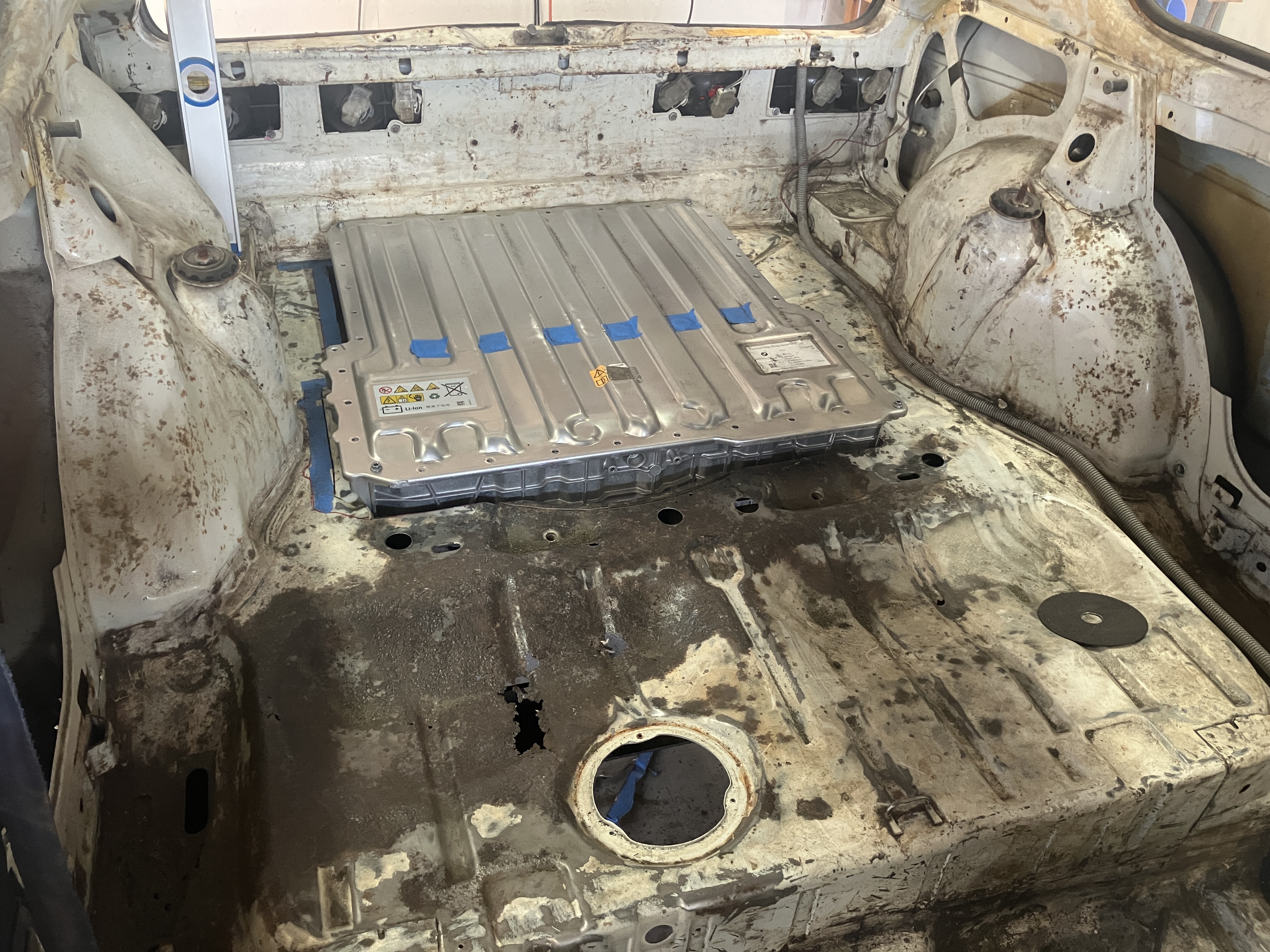

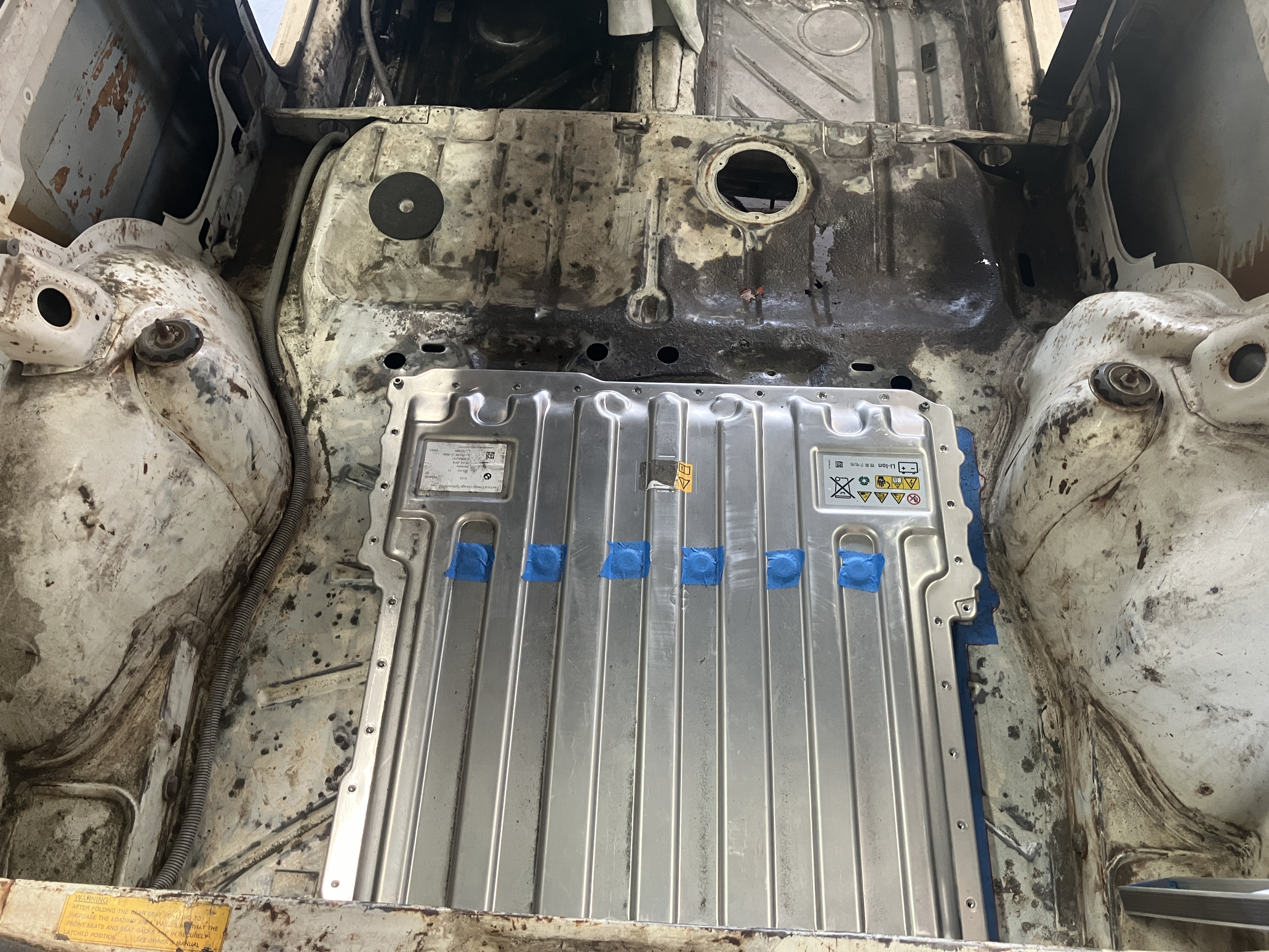

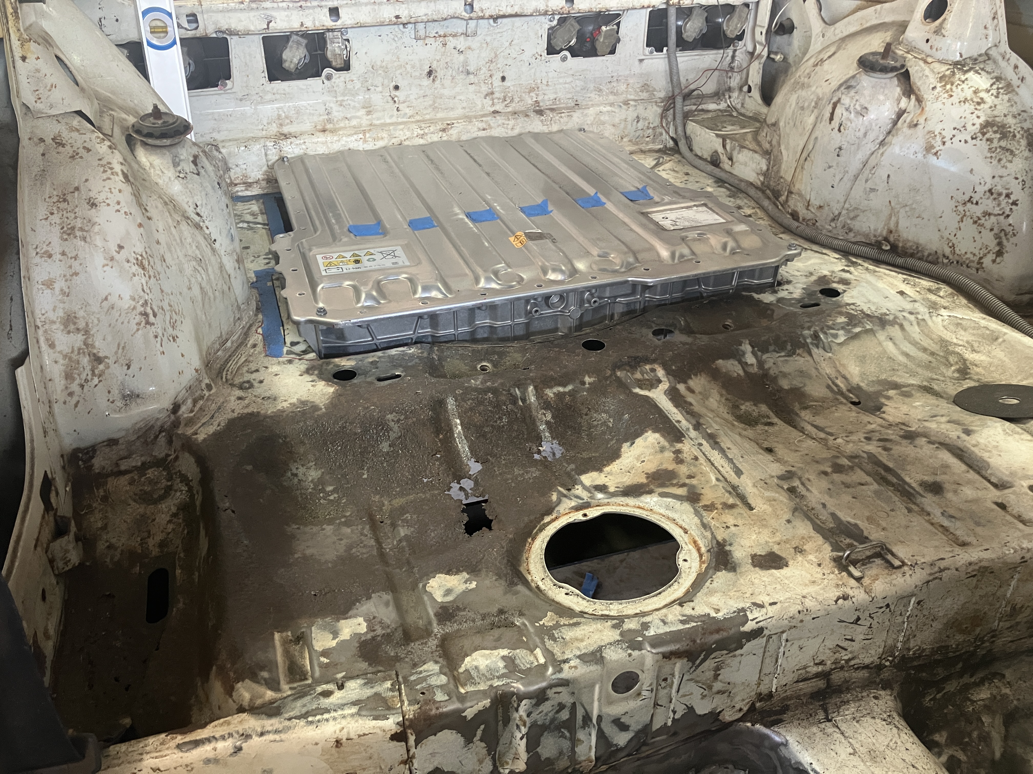

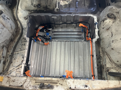

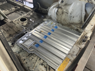

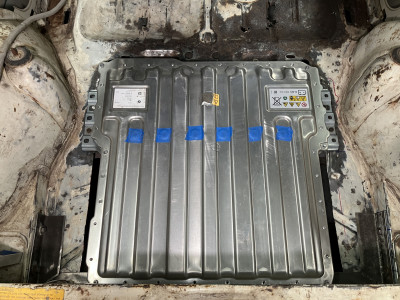

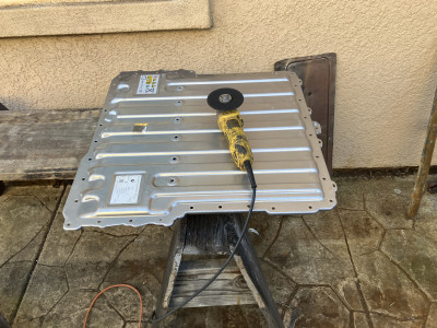

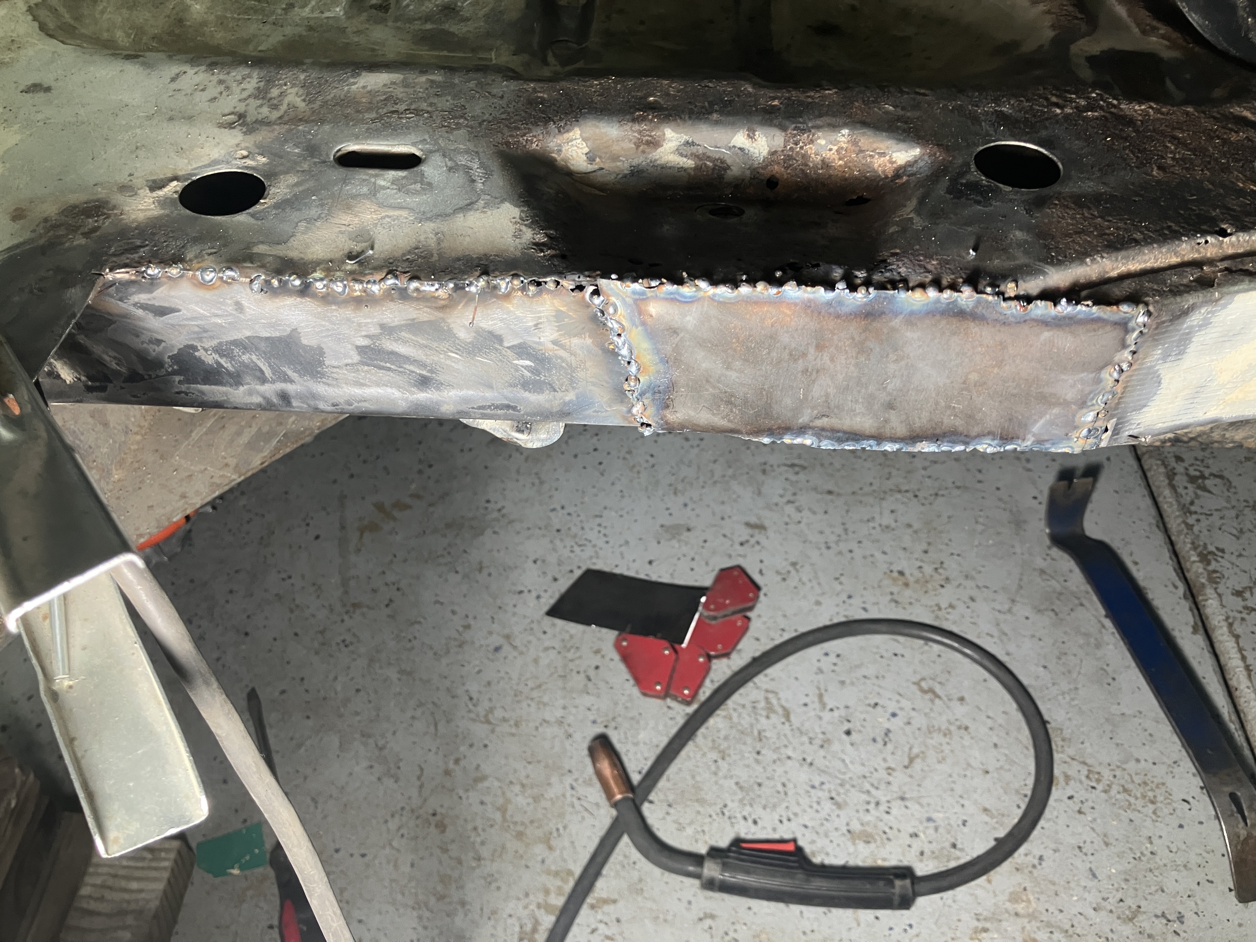

some pics of the battery pack trial fits
I soon decided to bolt the cover back on to keep the dust out of it
- Gregski
- Posts: 2743
- Has thanked: 500 times
- Been thanked: 946 times

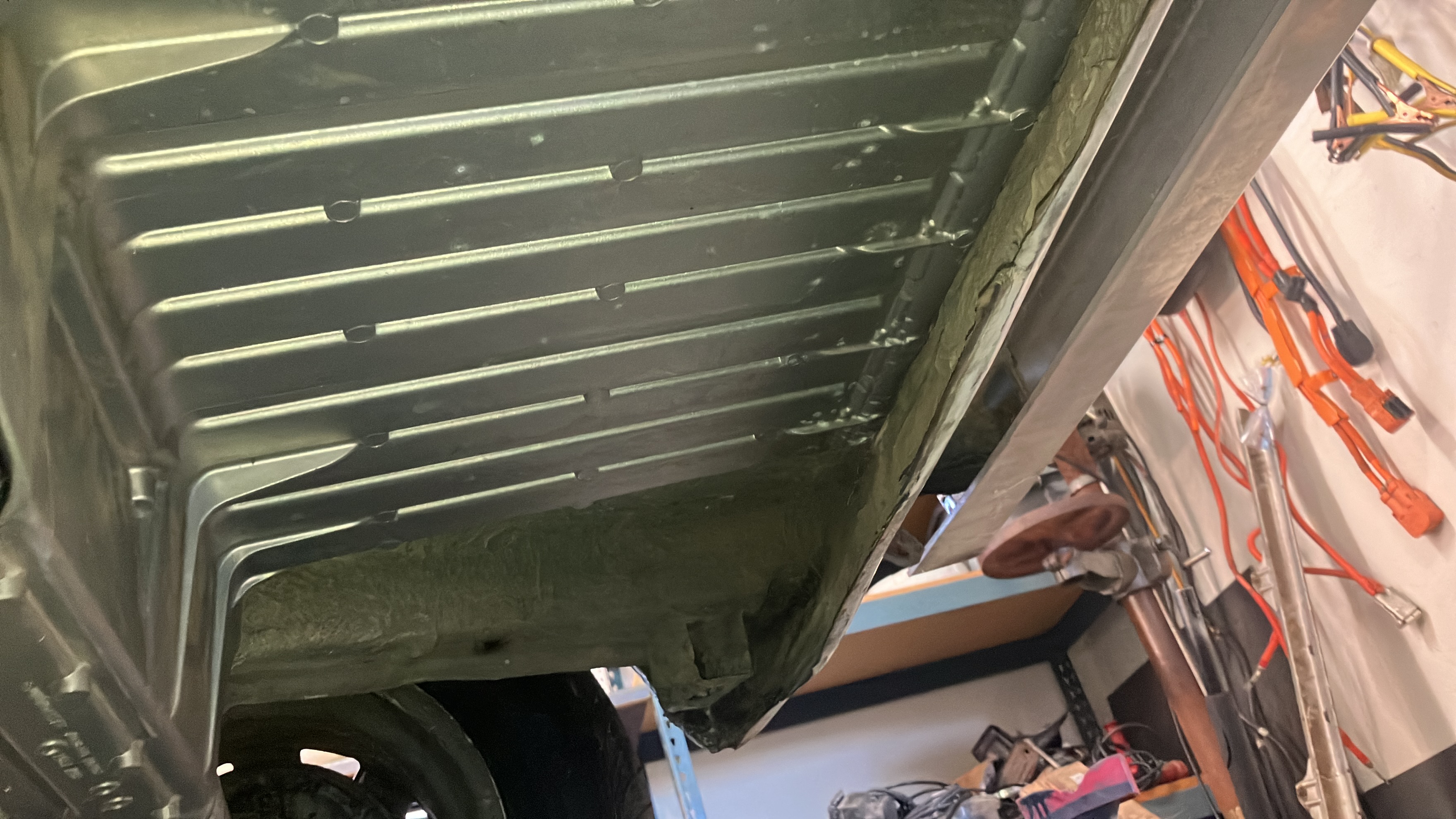

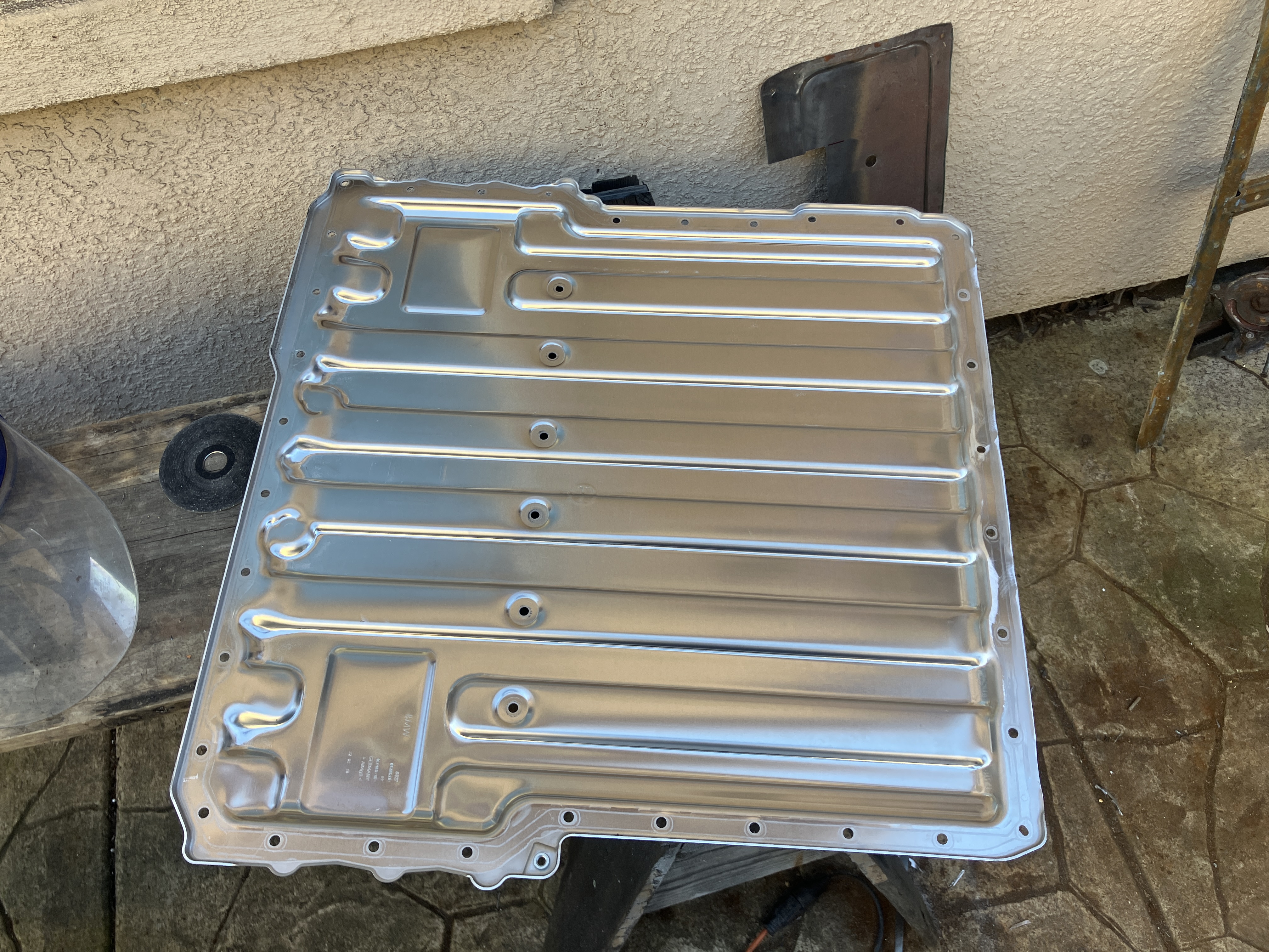

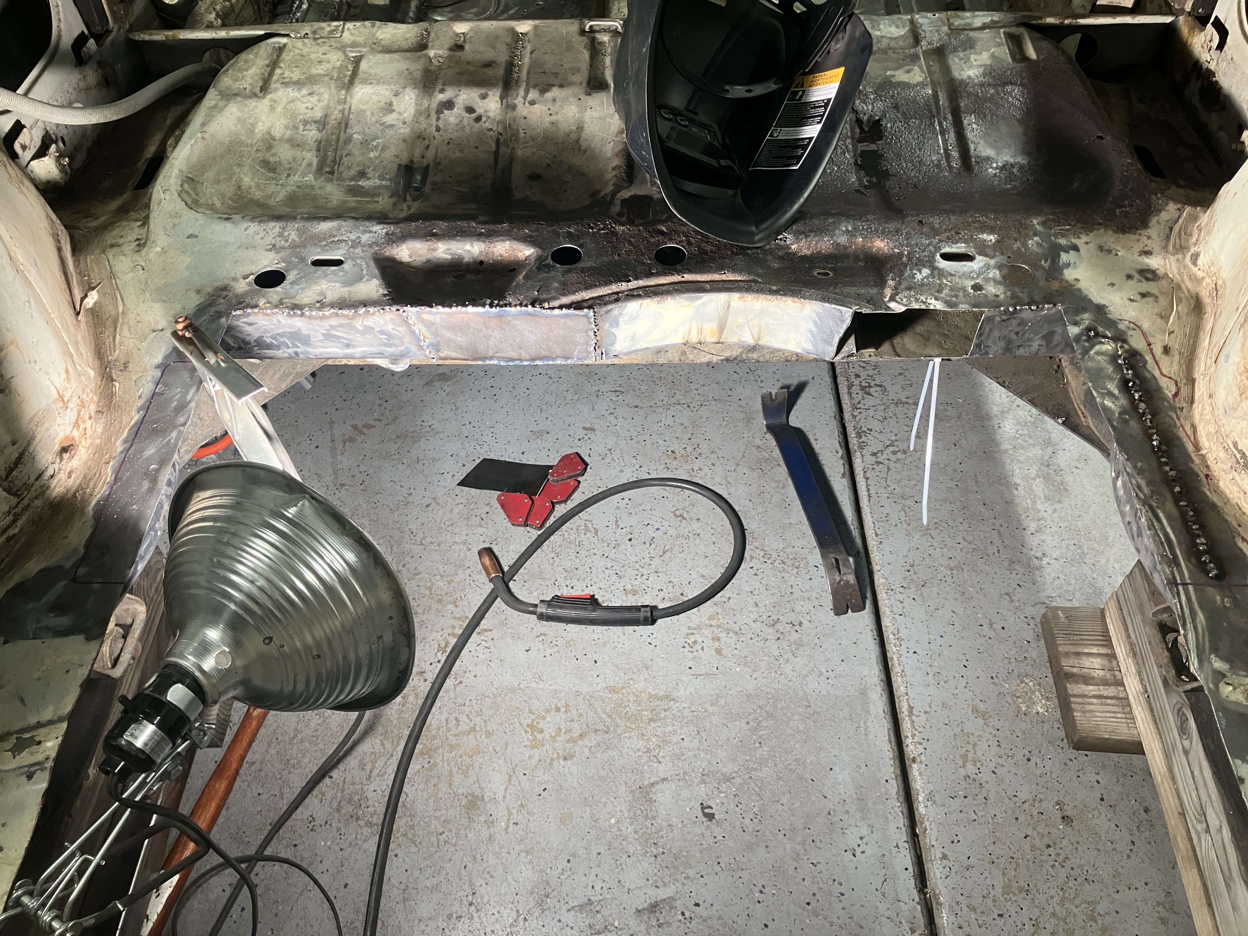

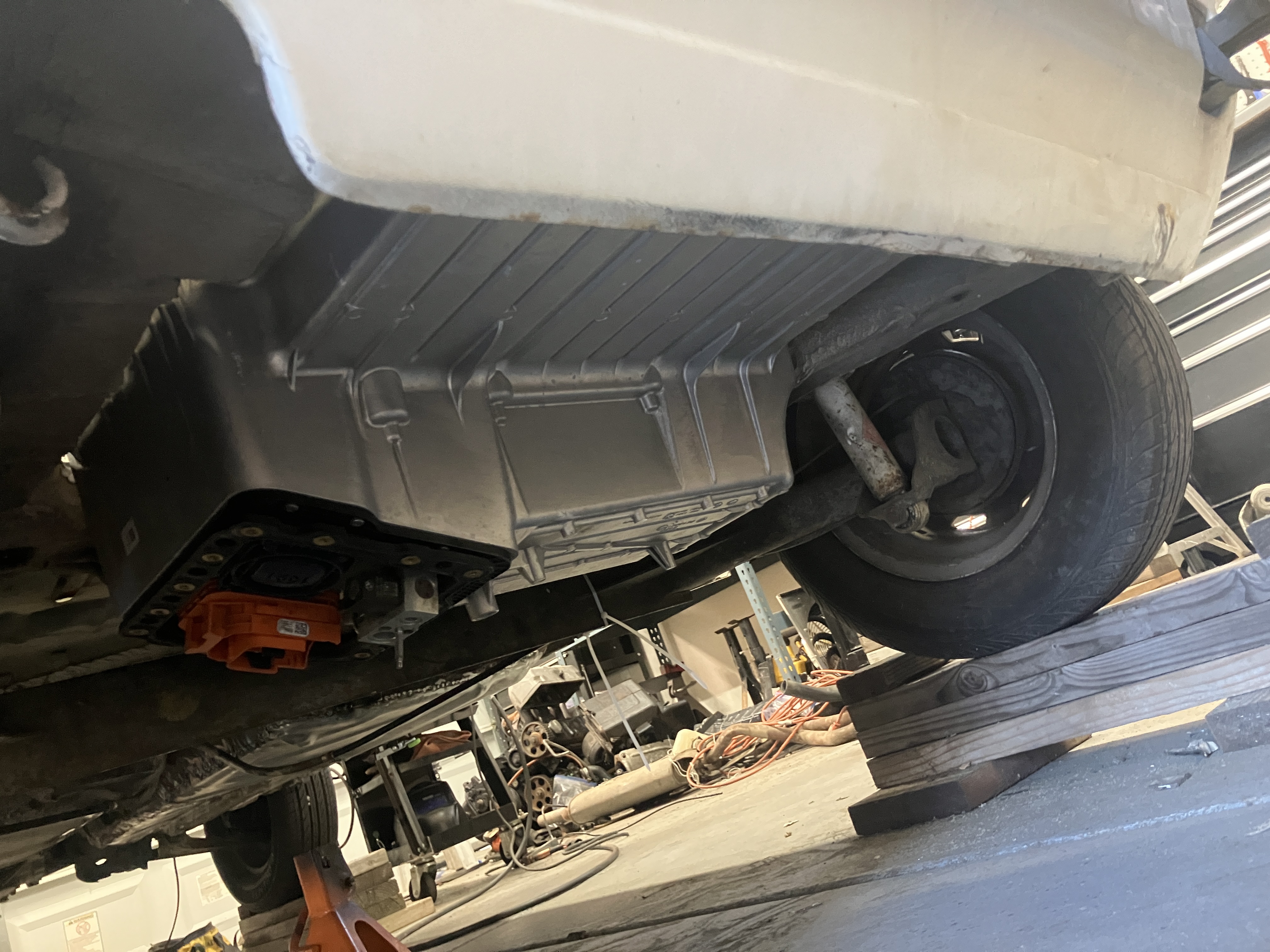

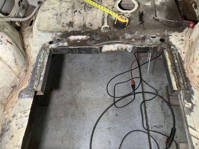

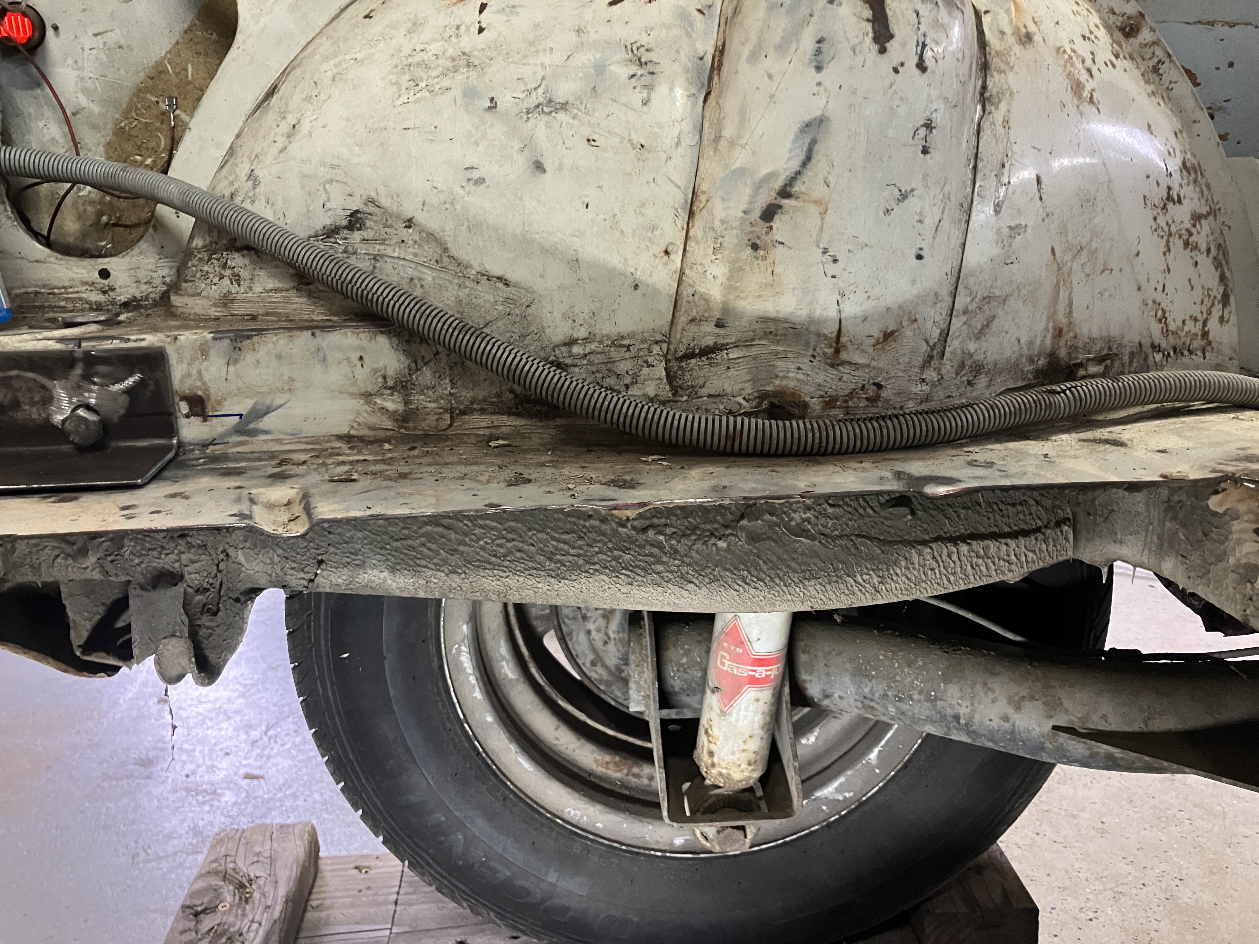

here is it from underneath the car

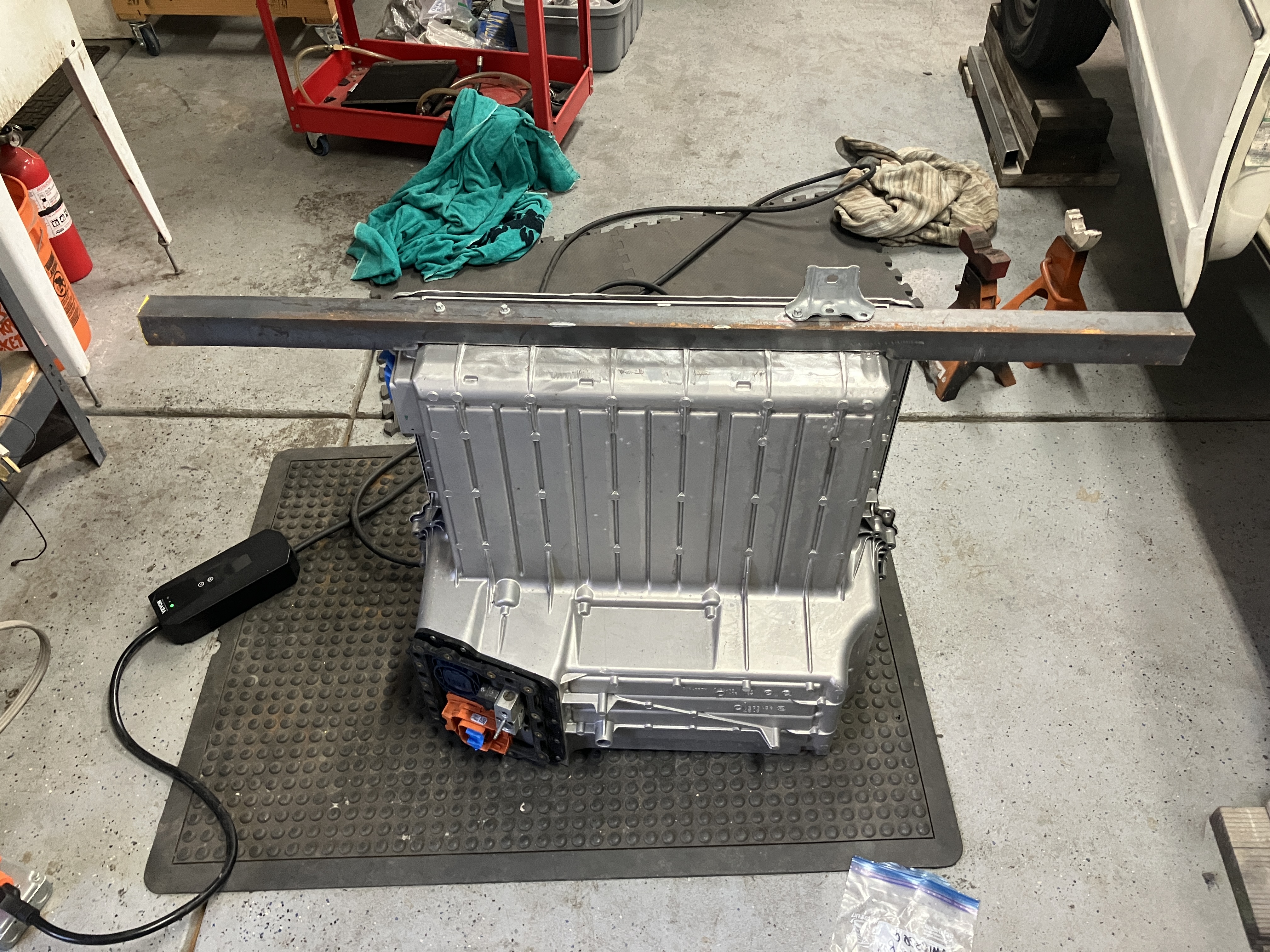

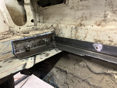

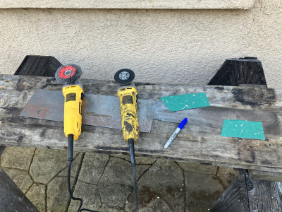

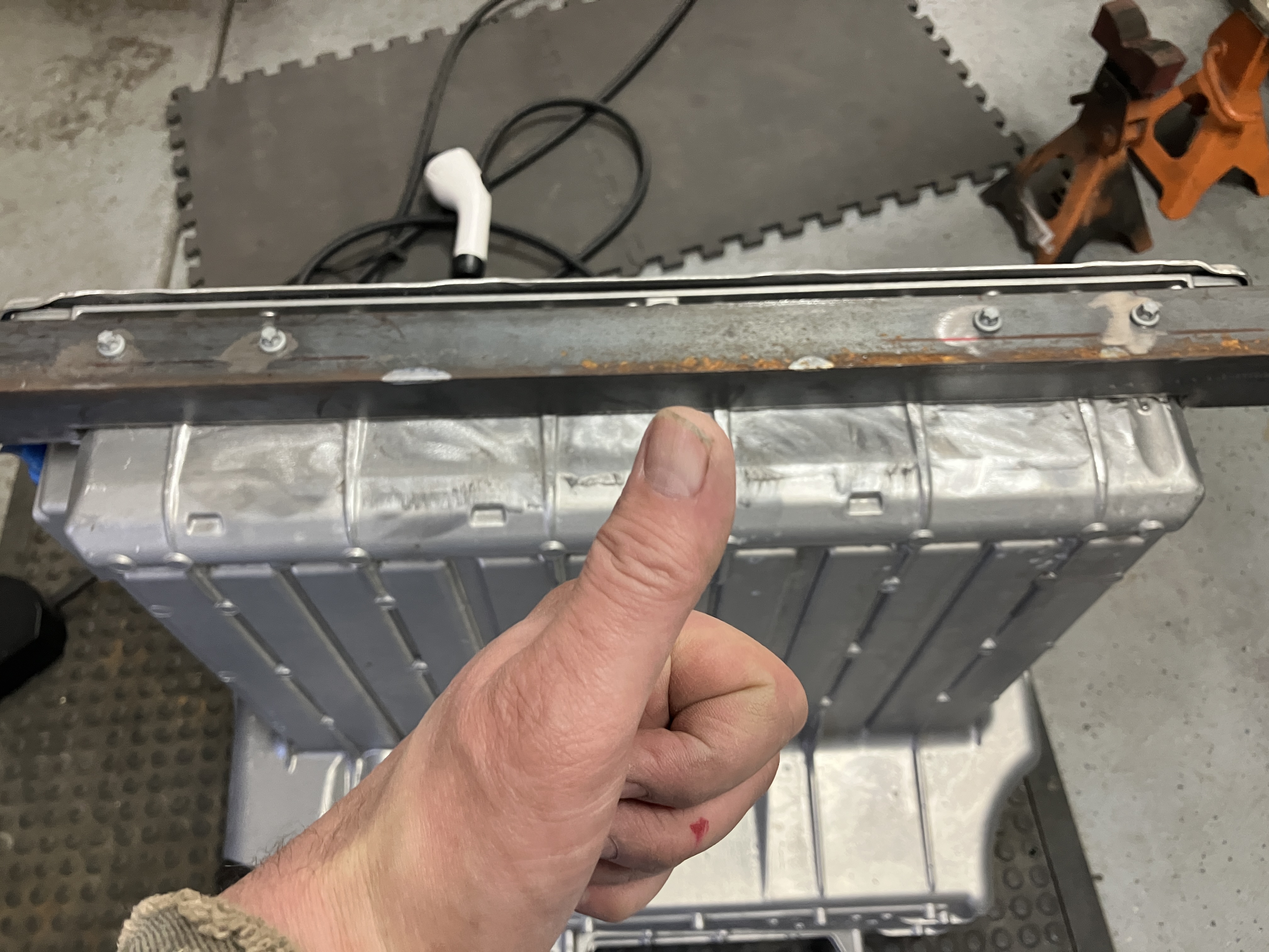

Hole Transferability Station (HTS)
that's red Sharpie ink not blood (for once) on my finger

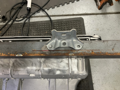

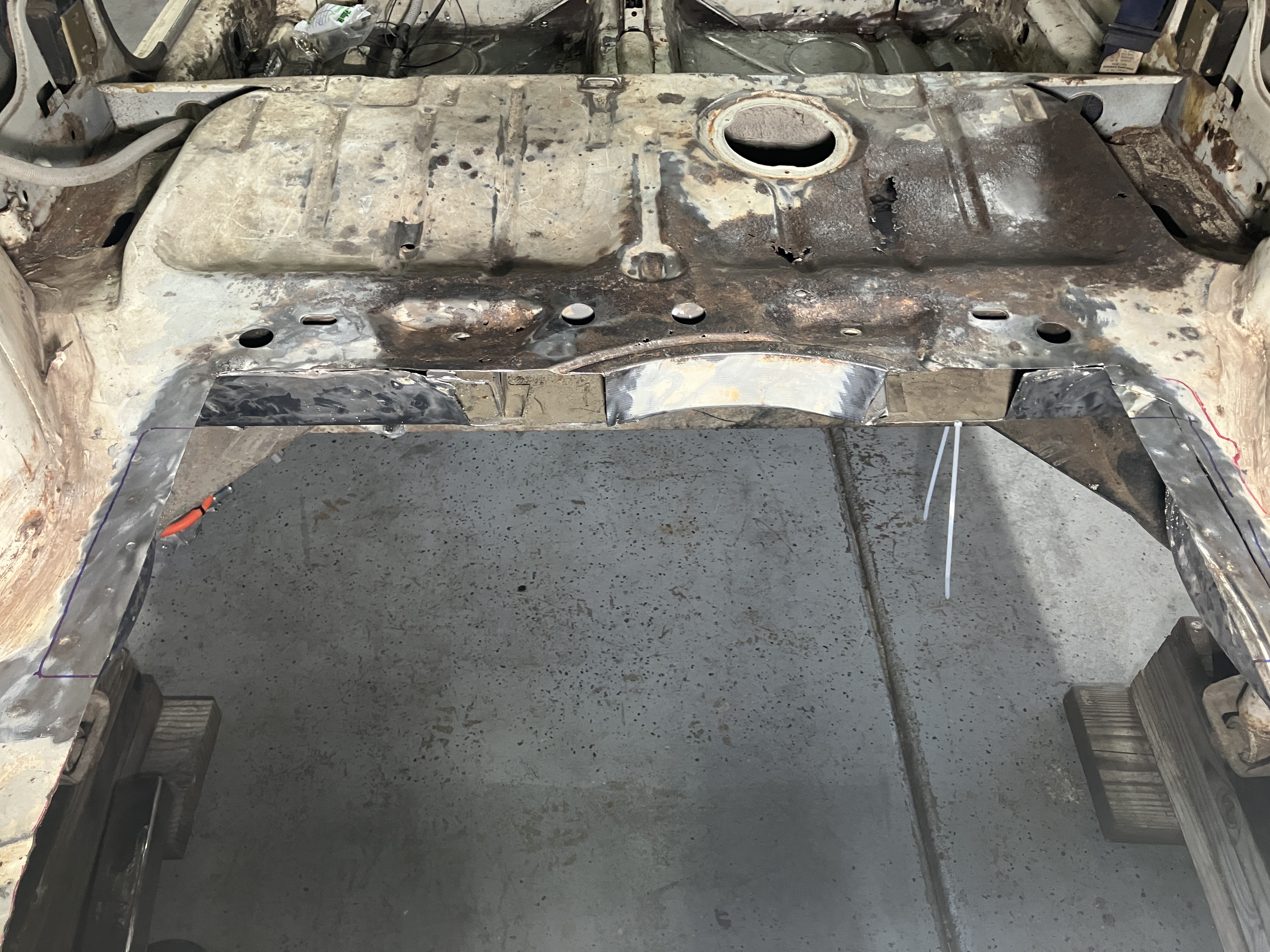

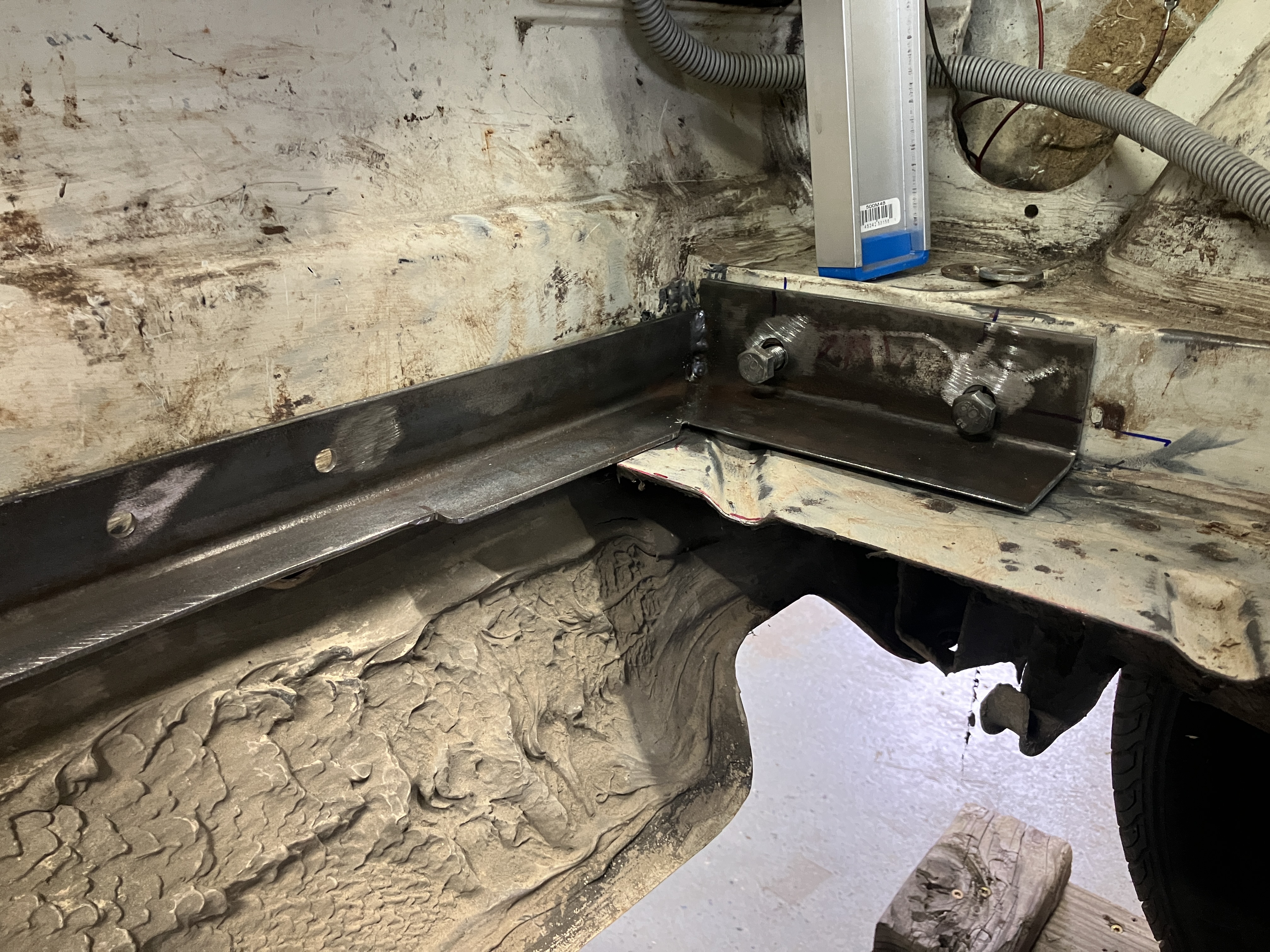

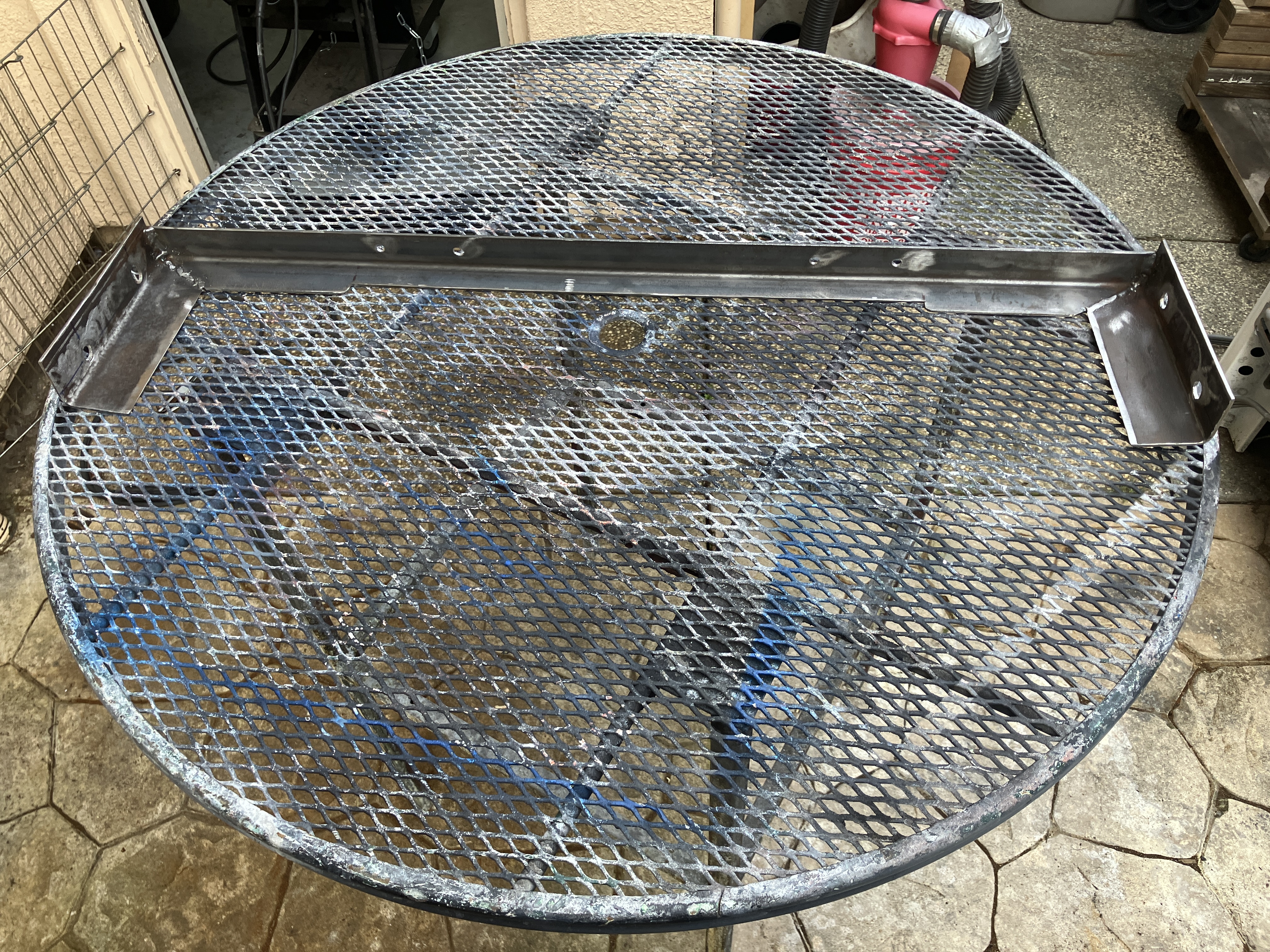

the rear bracket
Platasaurus Rex

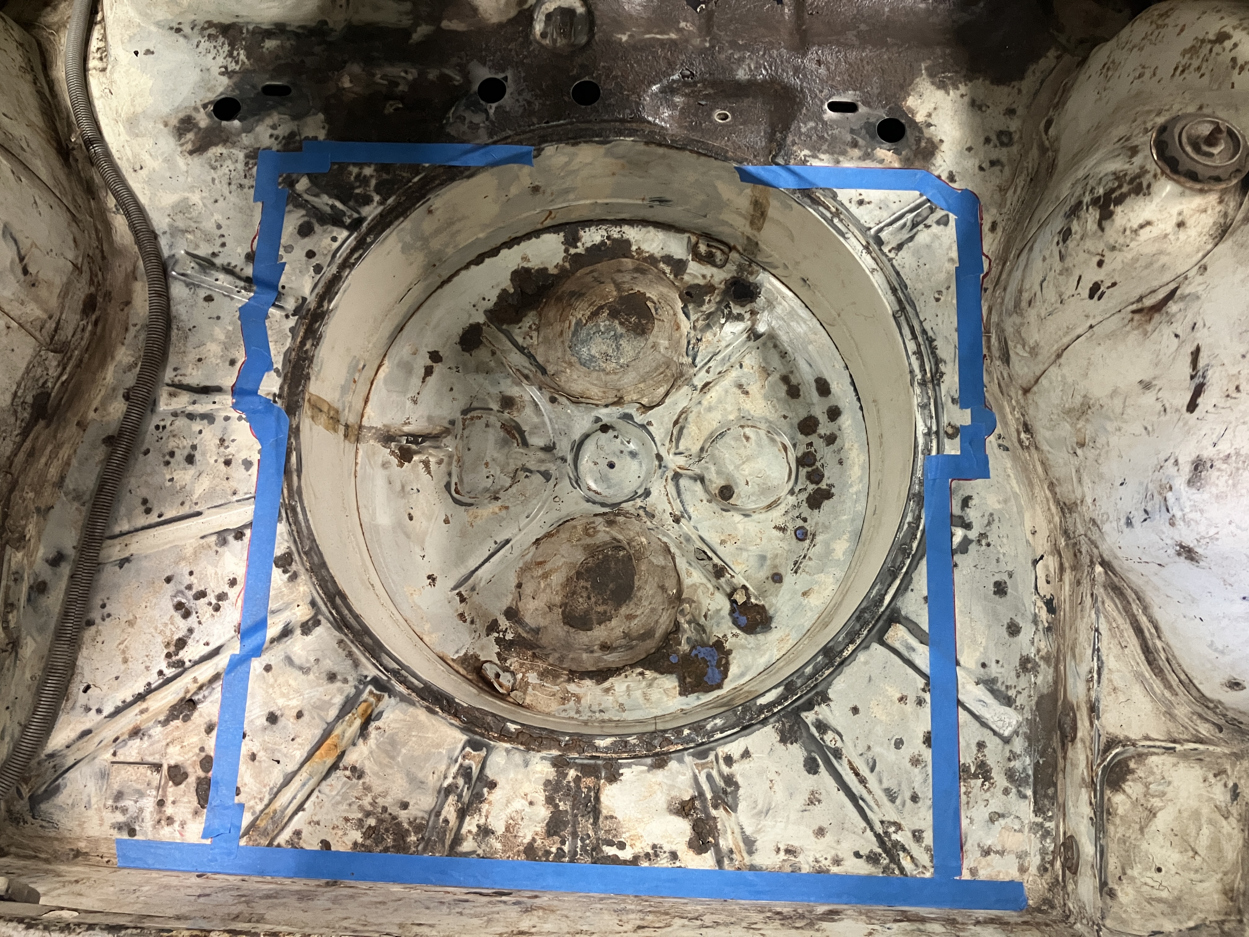

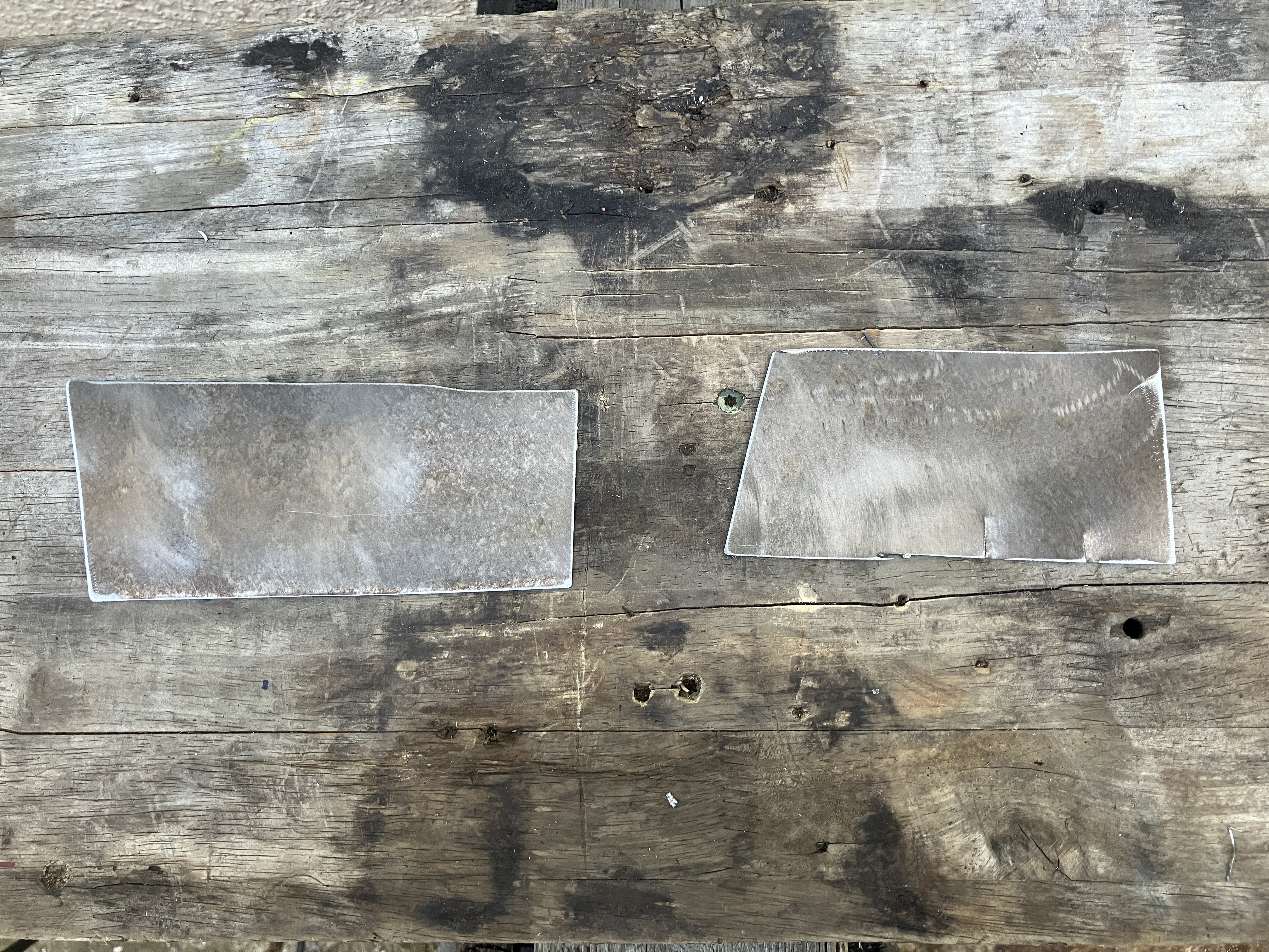

Template Time

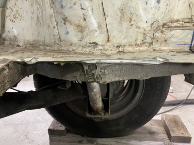

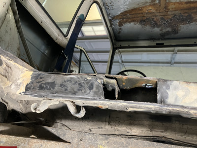

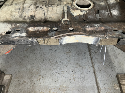

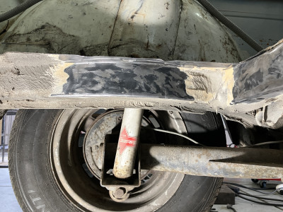

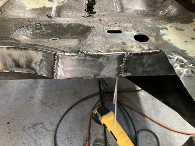

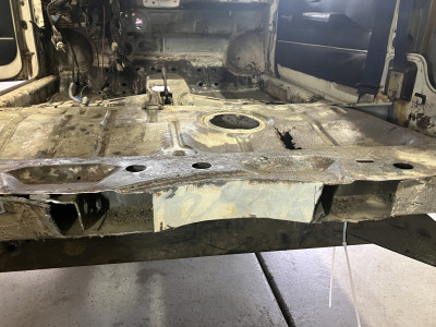

going after the front braces, bracket thingies, the white stuff removal was zero fun
DRIVER SIDE
PASSENGER SIDE (I think Irma was having a bad day on the production line that day and took it out on my frame rail)
before all the grinding
DRIVER SIDE

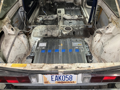

and she's in, should make for a great little 7.6 kWh starter pack
