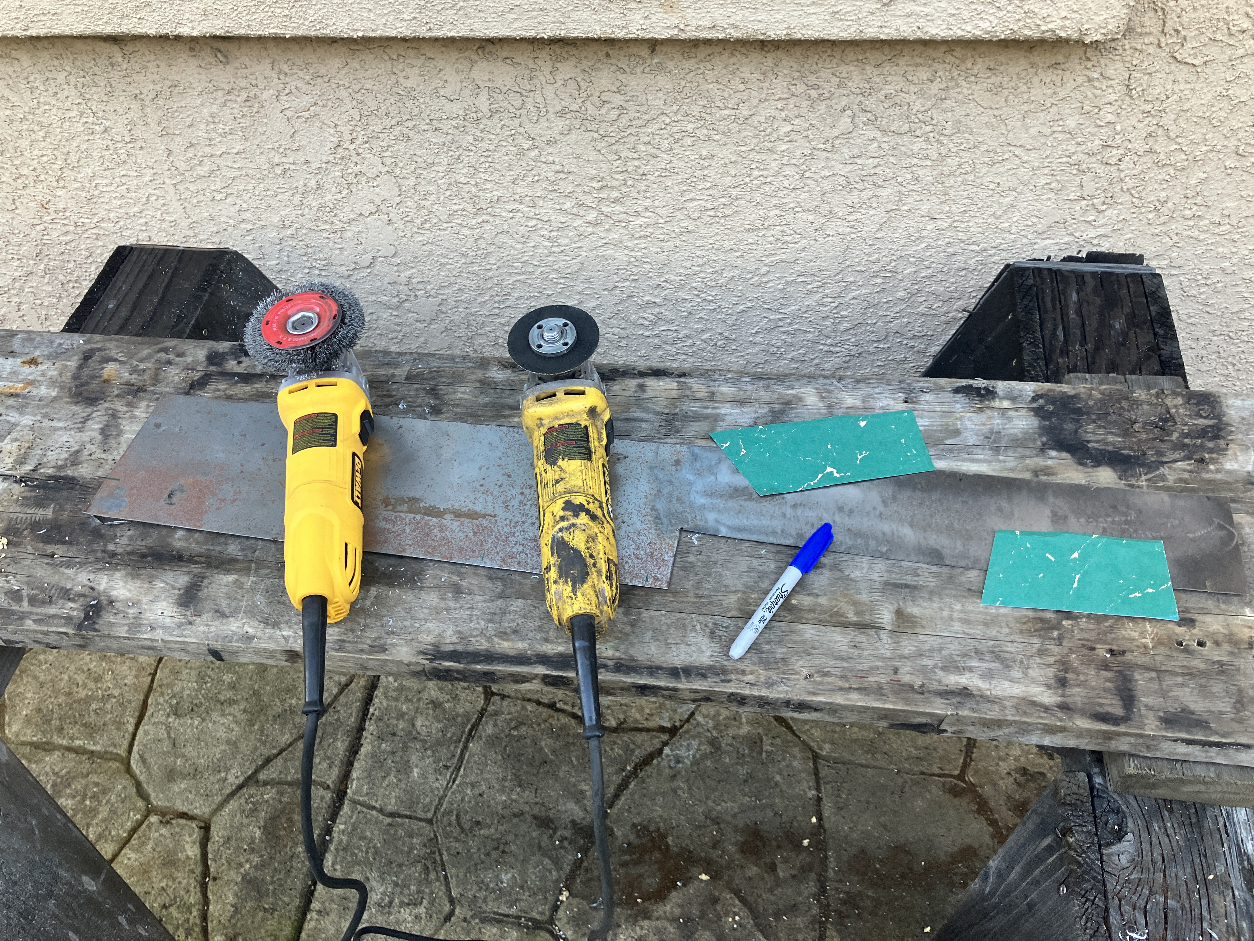

Ahh yes, the holy trinity of angel grinders.

I use it as well. I keep one grinder with cutting disk, one with thicker disc and the third one with that grinding pads disk which allows me to quickly grind my welds to see if there are any cracks...

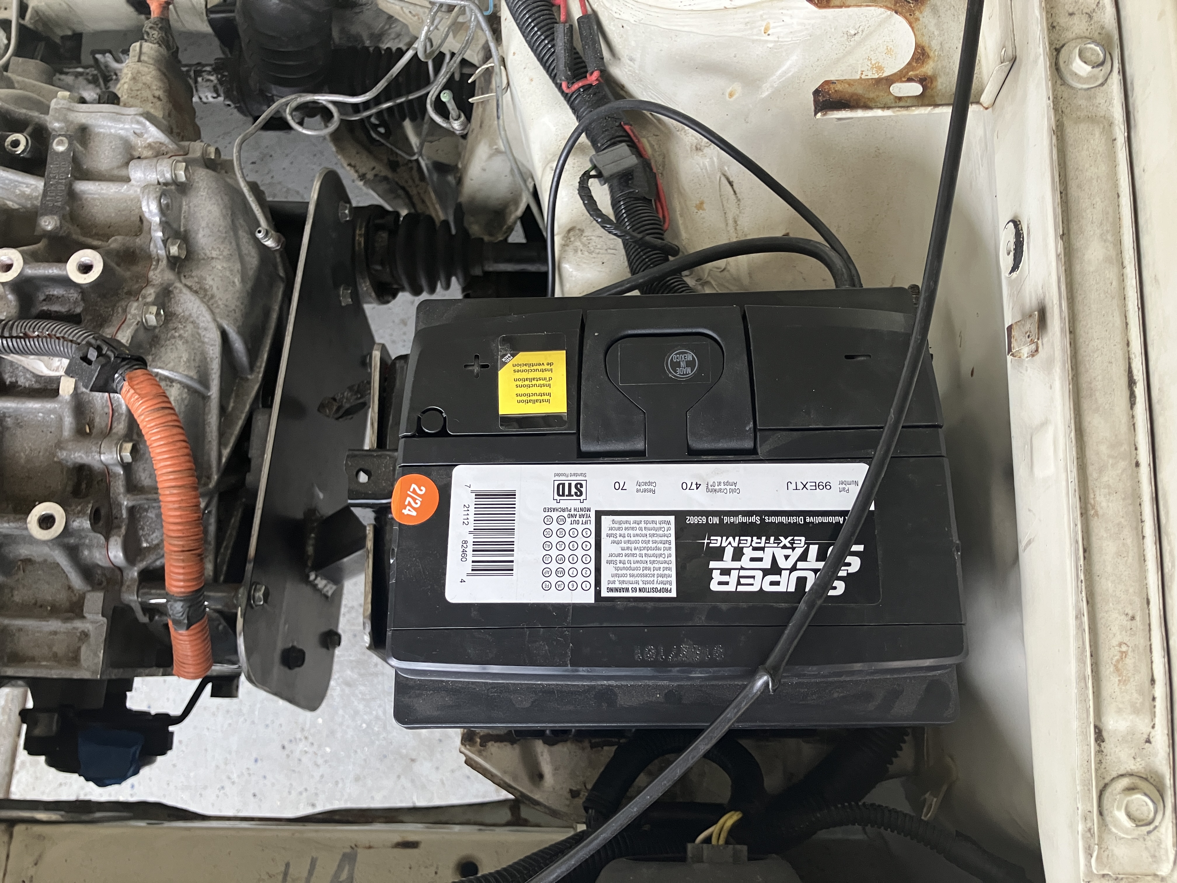

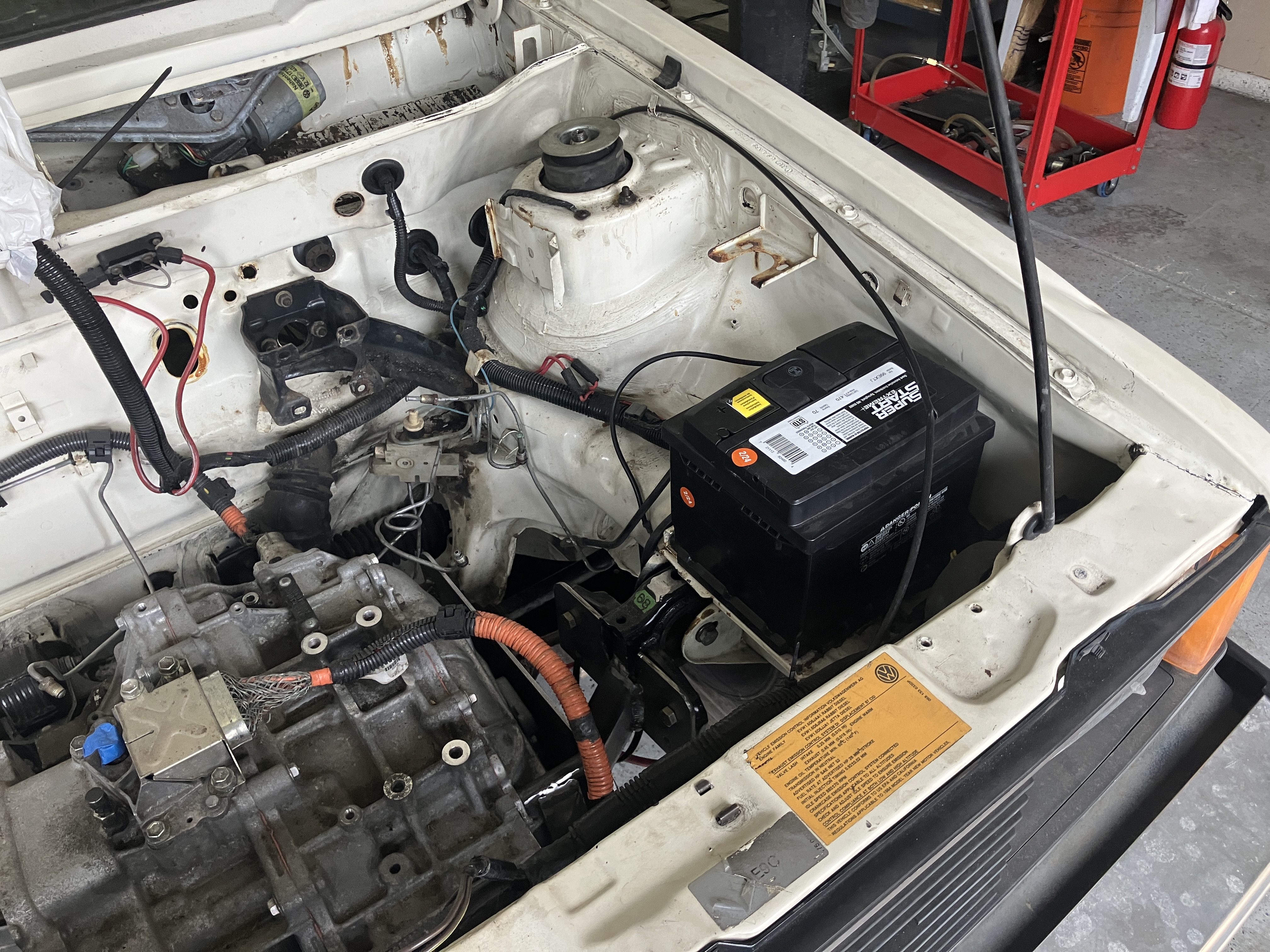

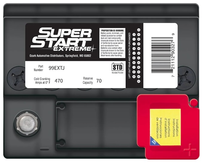

Guess who just spent $260 bucks on a regular 12 volt car battery? ... but did I mention it's a Super Start EXTREME, lol
Super Start Extreme Battery Group Size 99 T4 - 99EXTJ
Have battery prices gotten stupid expensive in your neck of the woods as well ?

it do fit like a glove though... the two OEM sizes the computer recommended were surprisingly huge

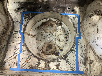

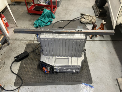

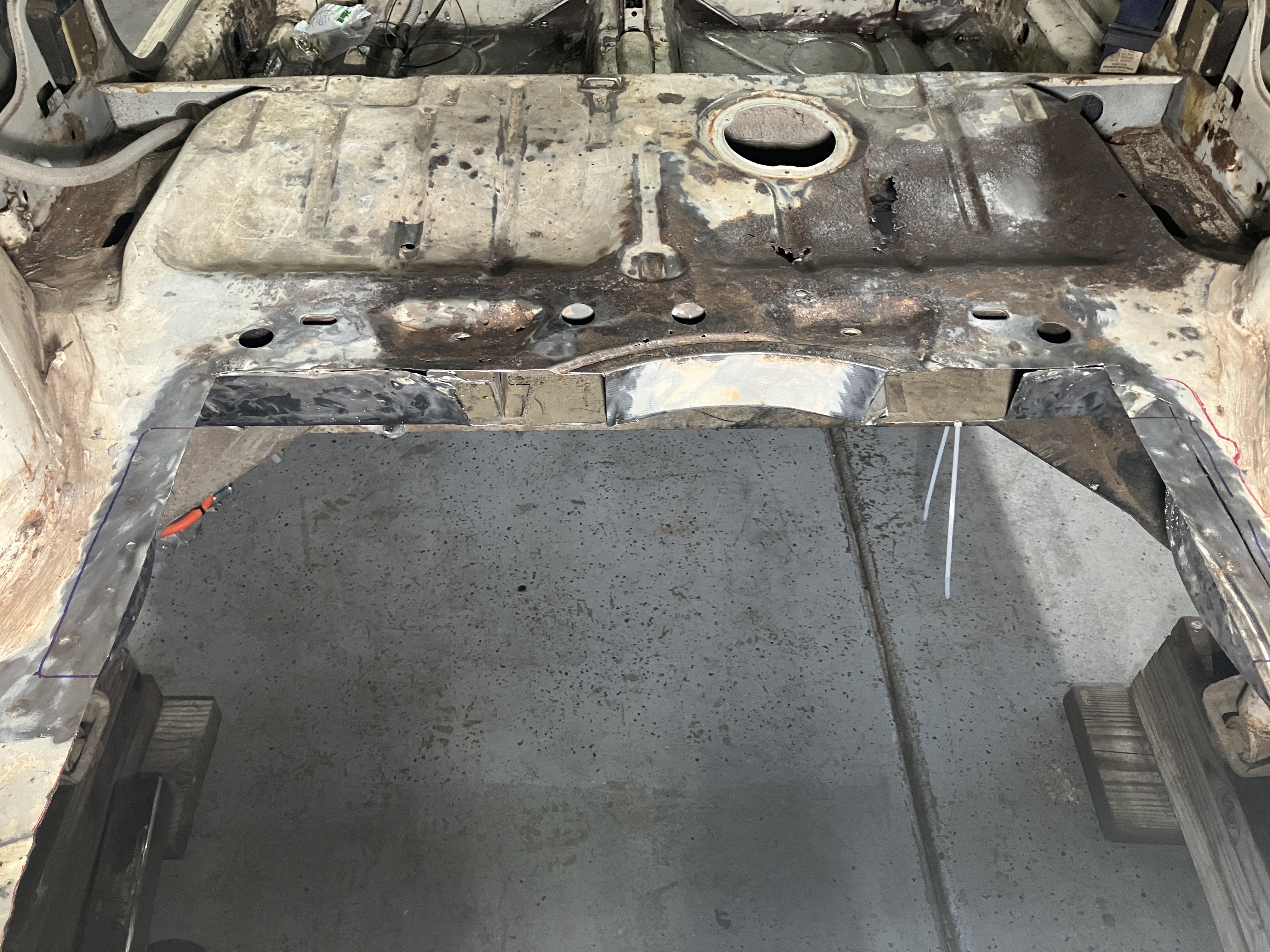

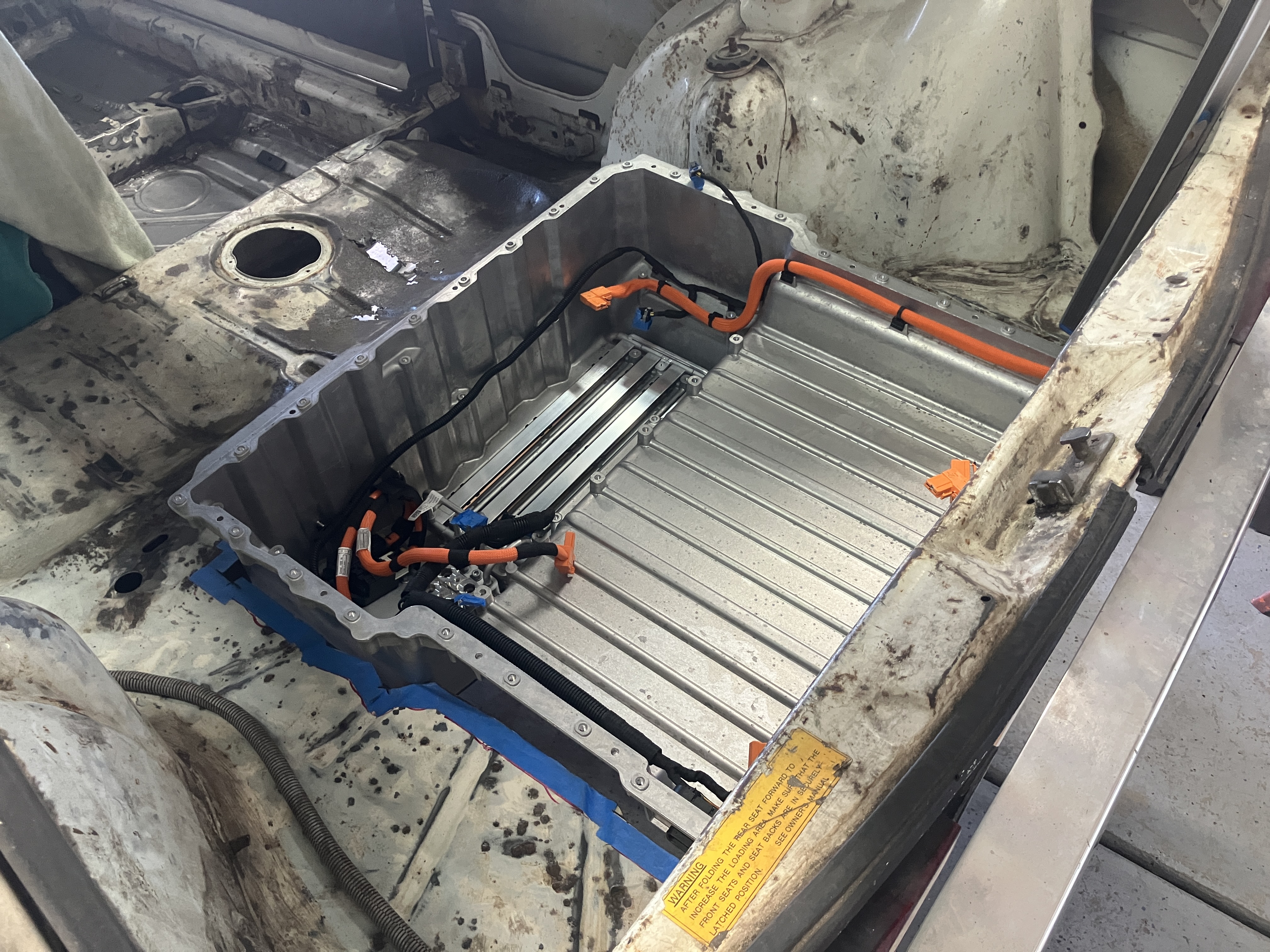

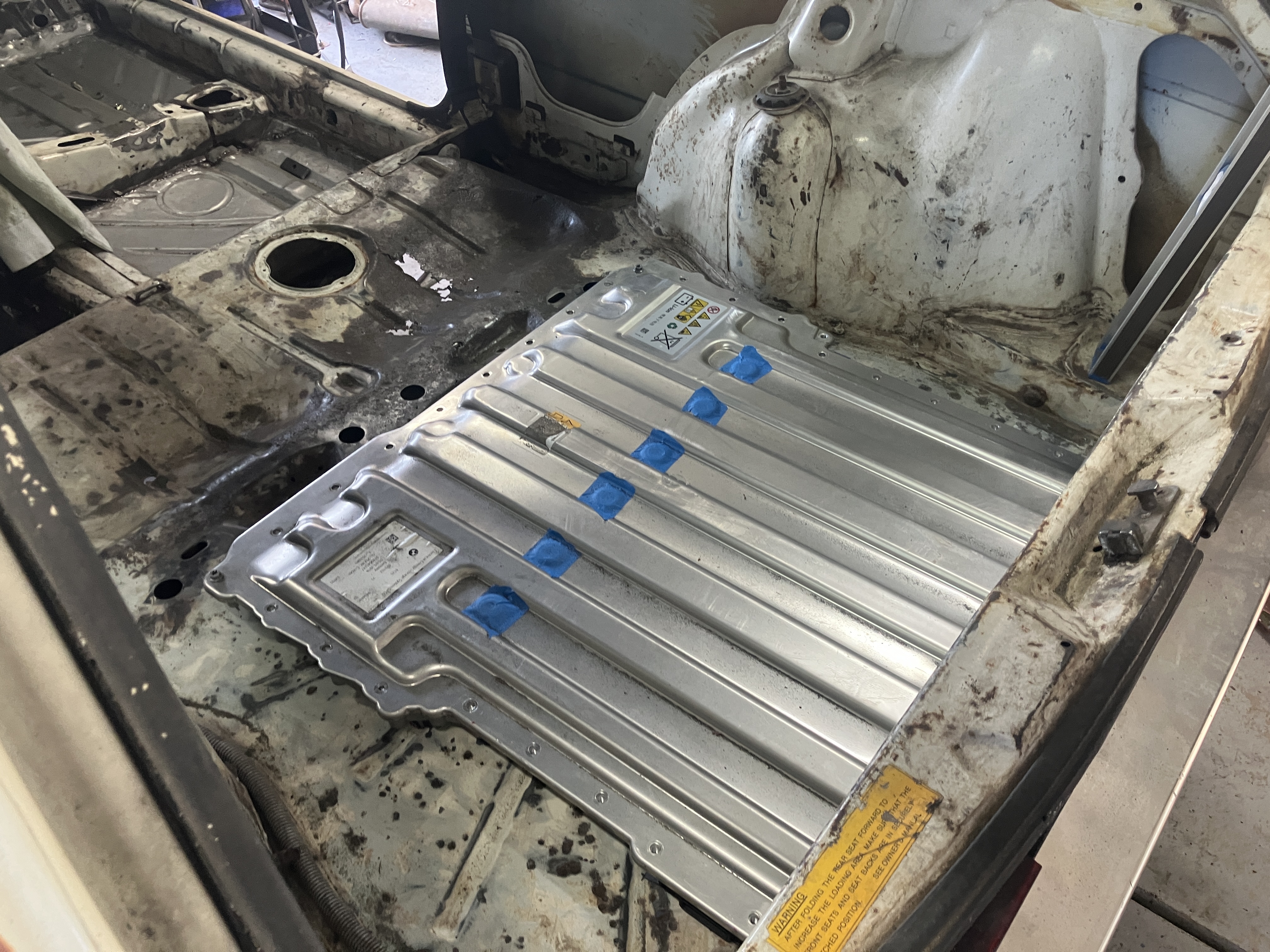

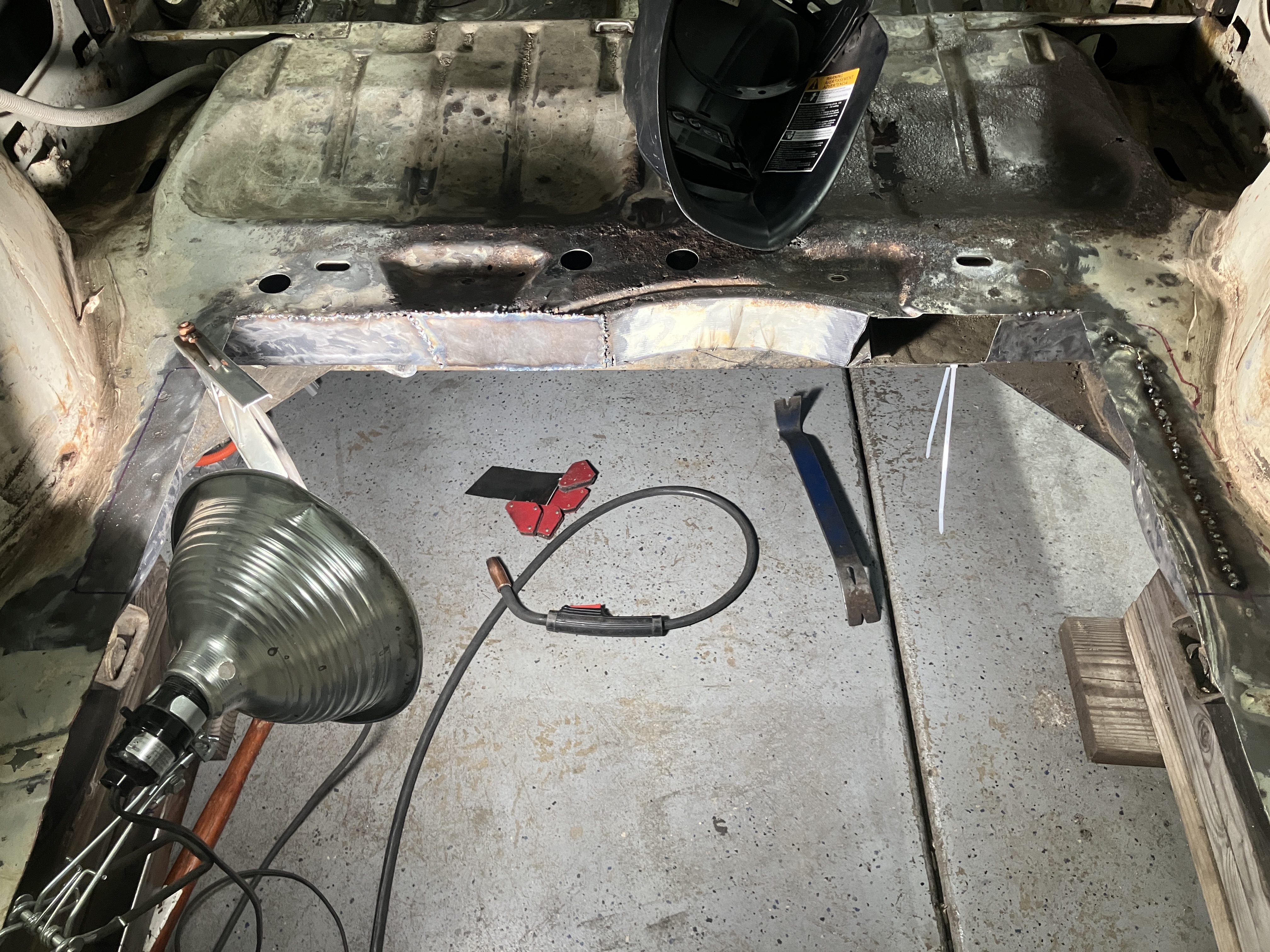

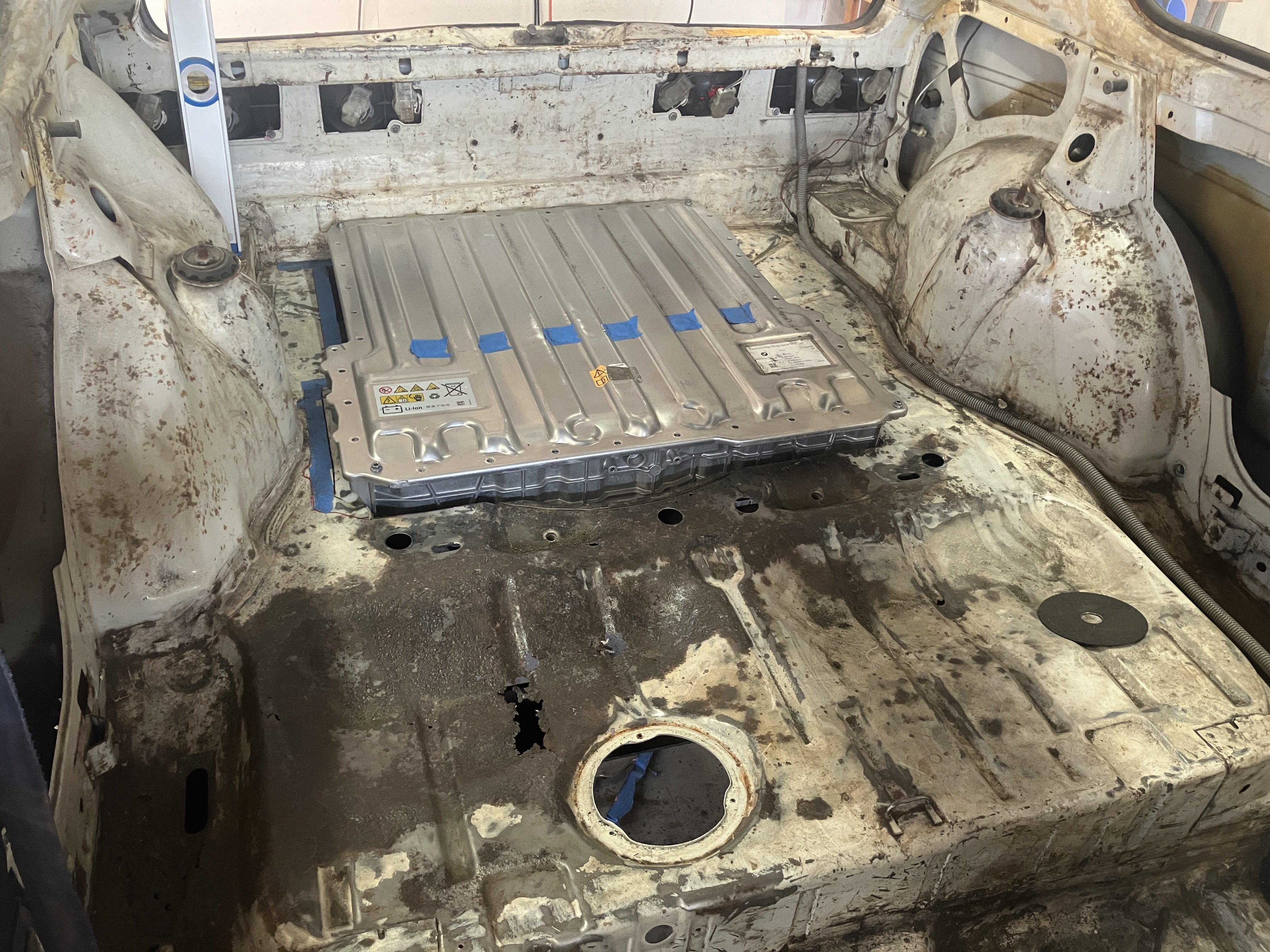

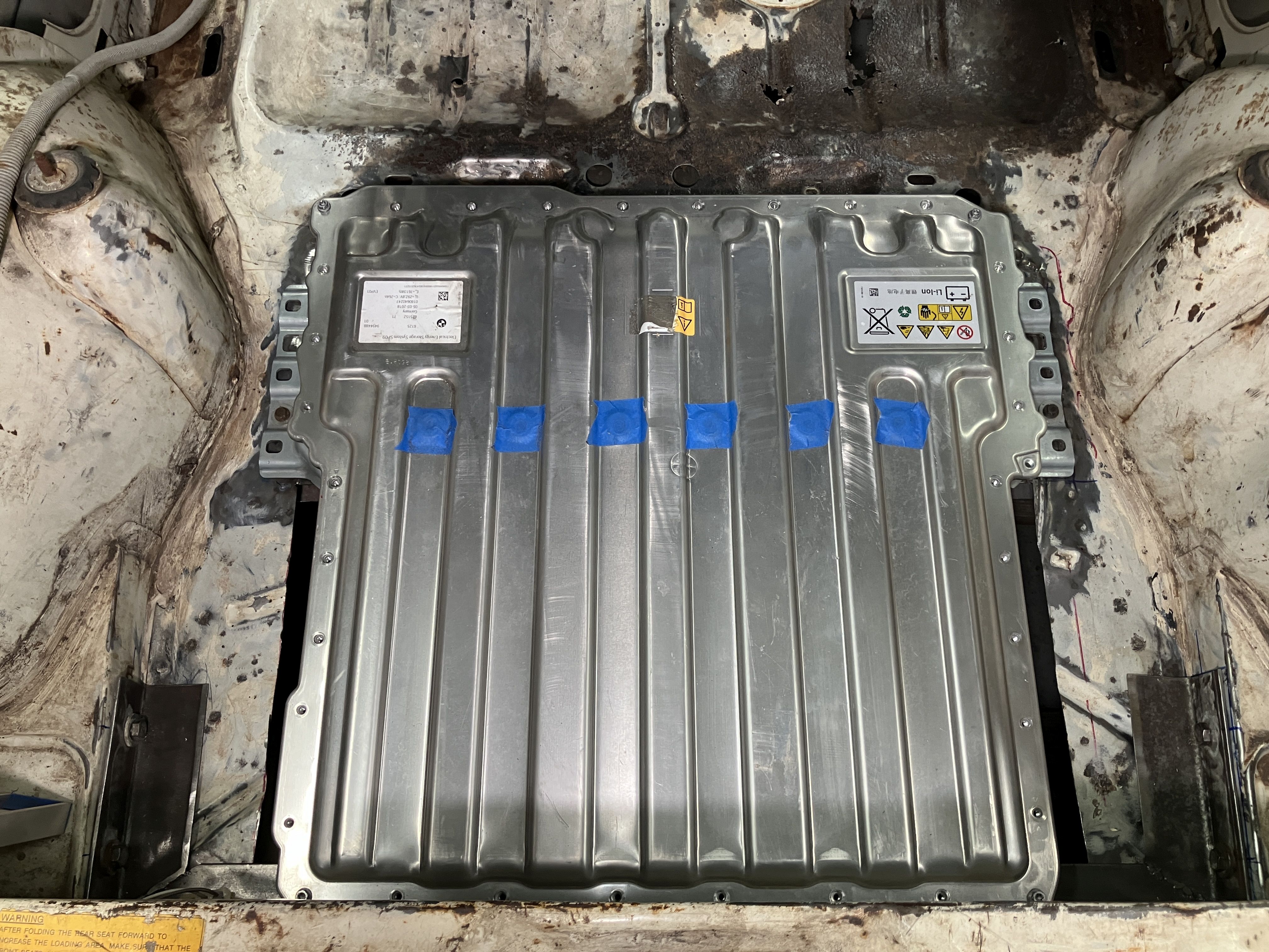

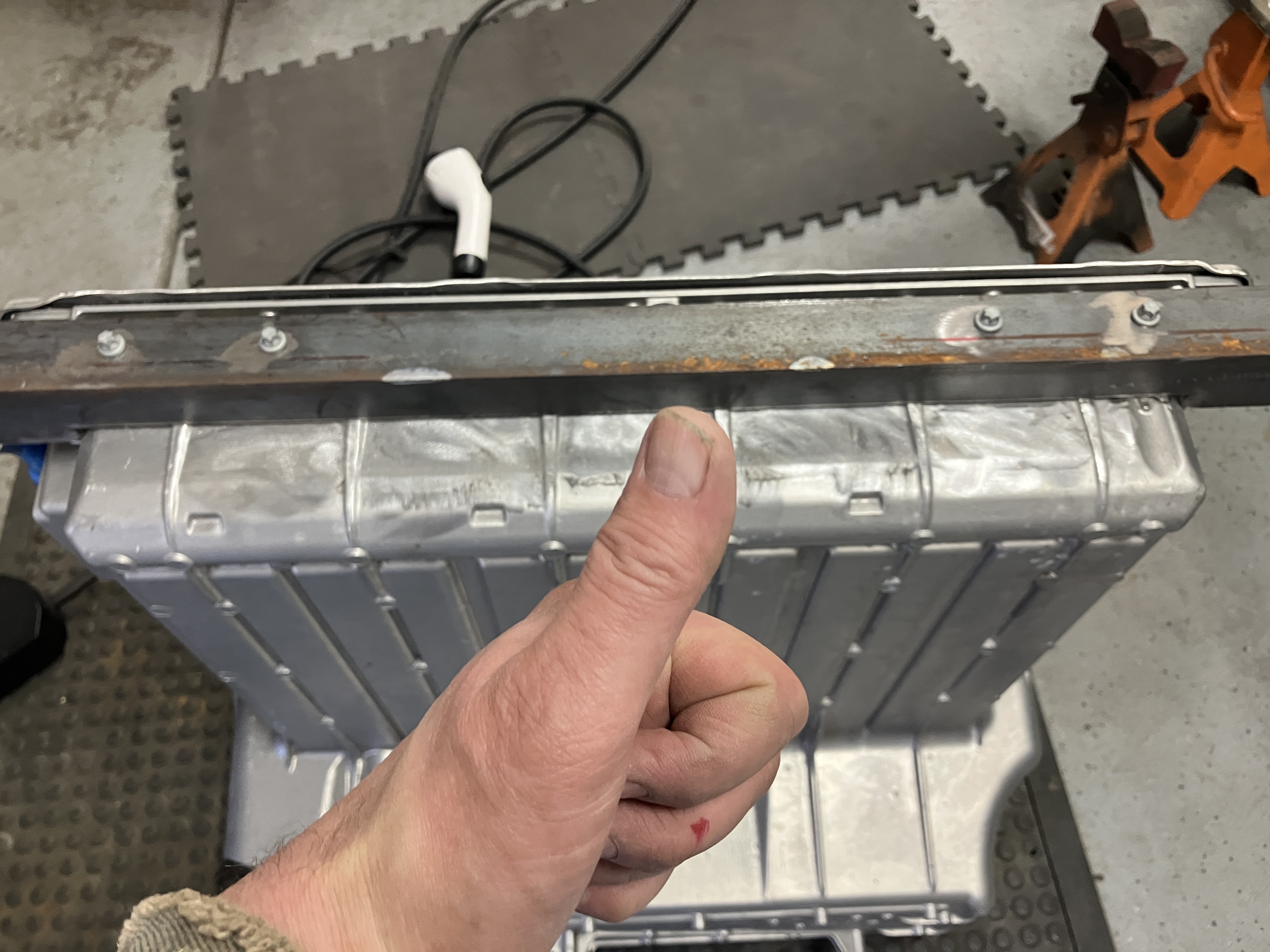

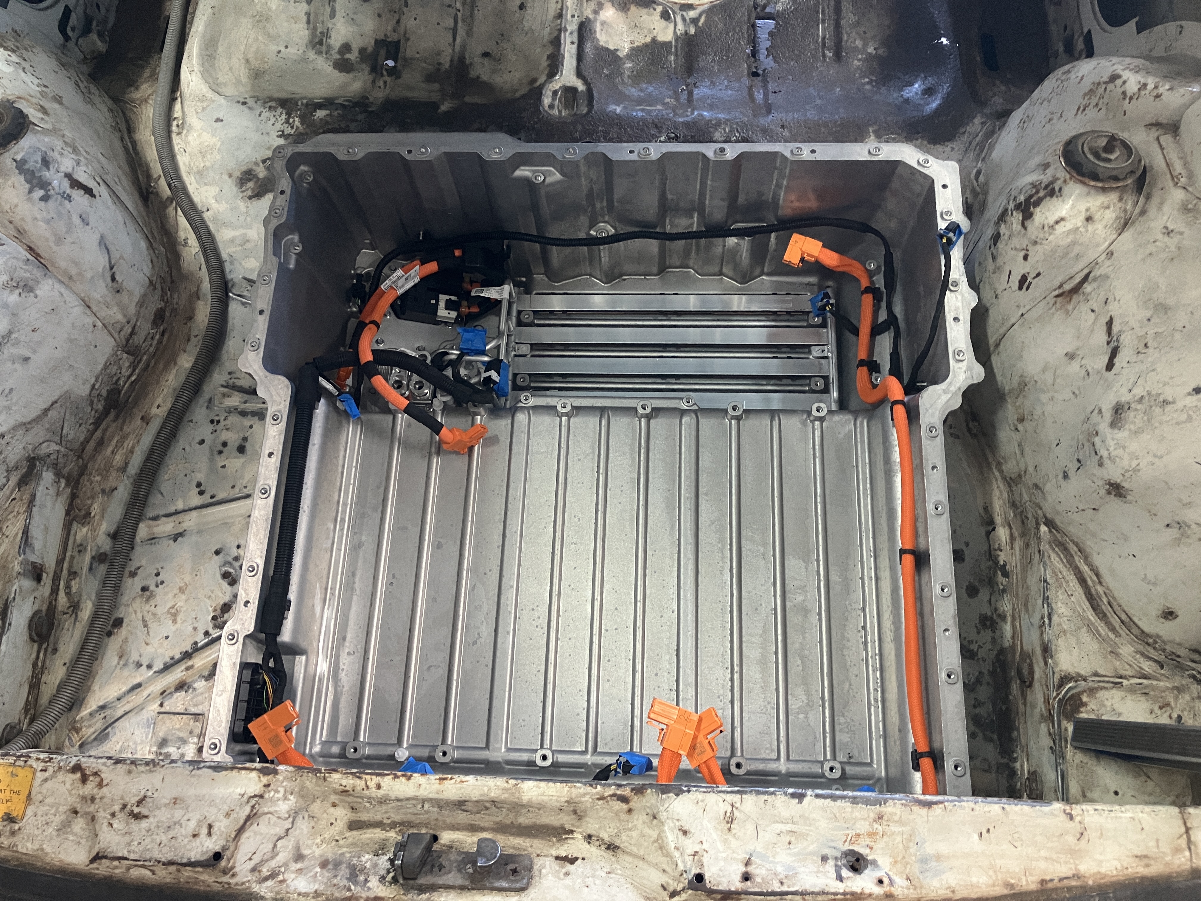

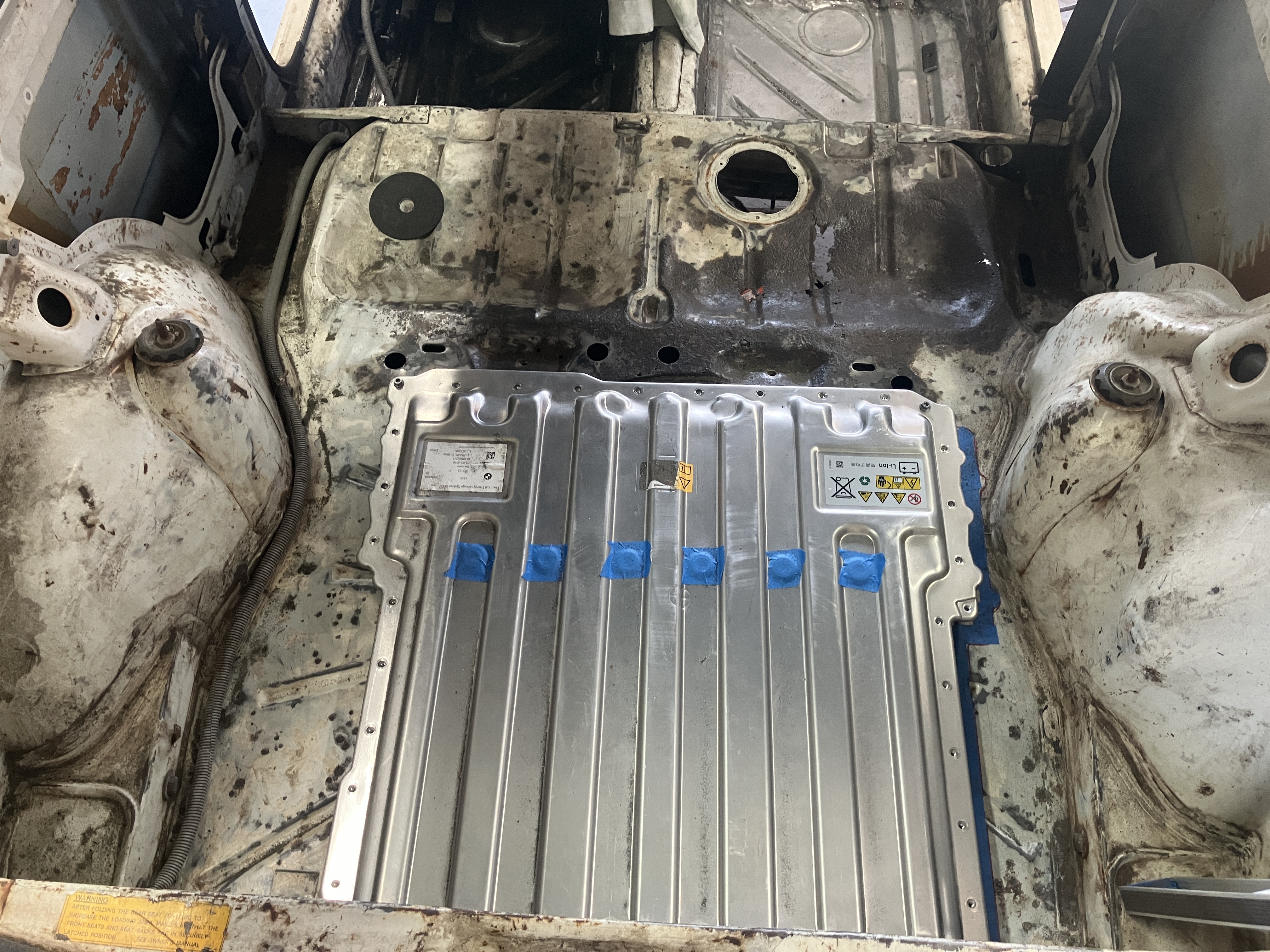

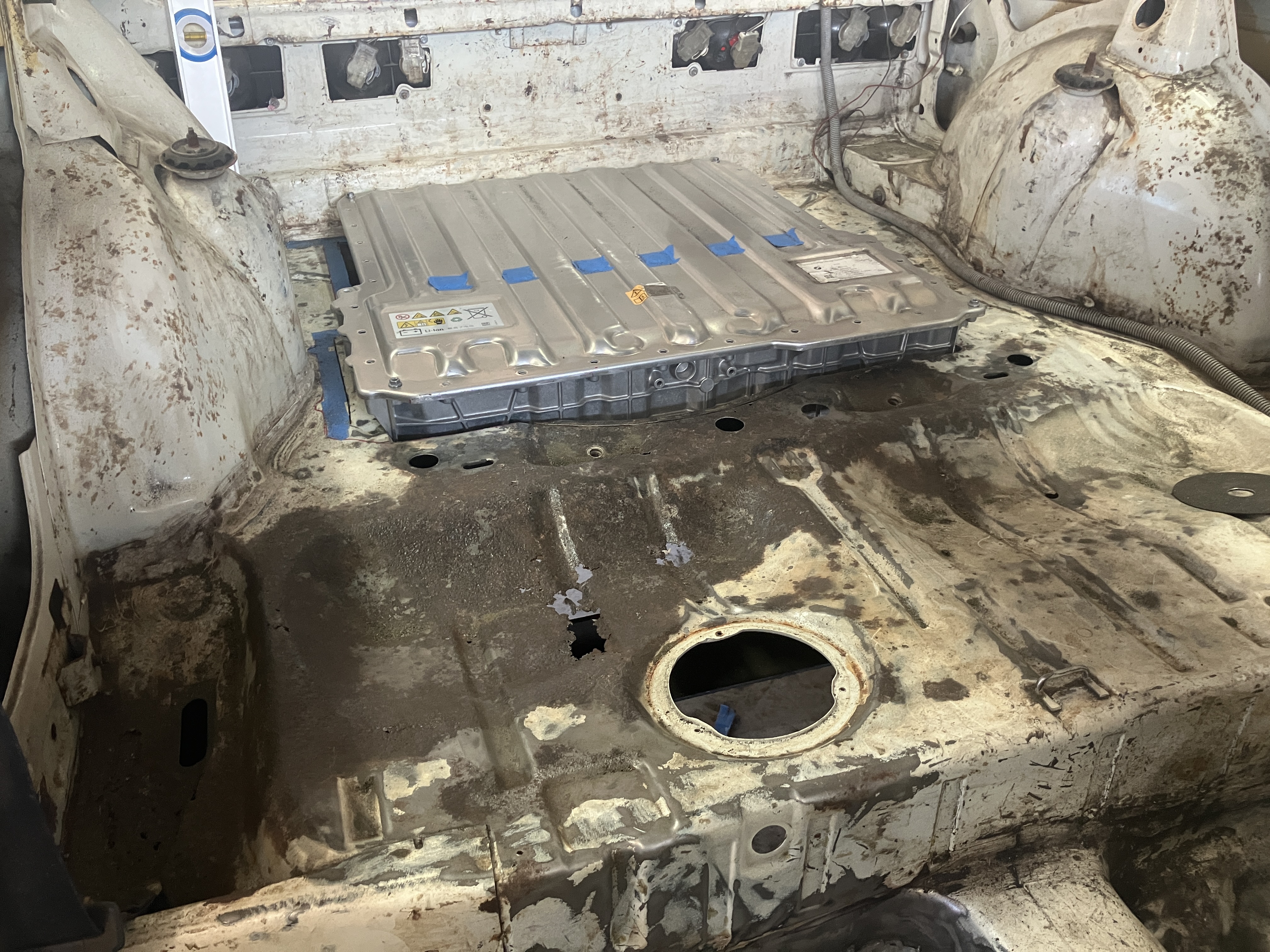

some pics of the battery pack trial fits
I soon decided to bolt the cover back on to keep the dust out of it

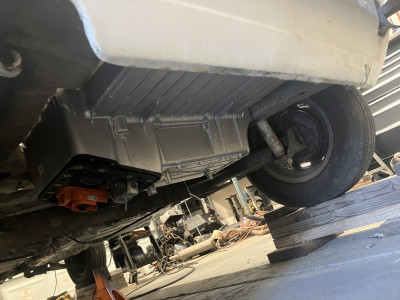

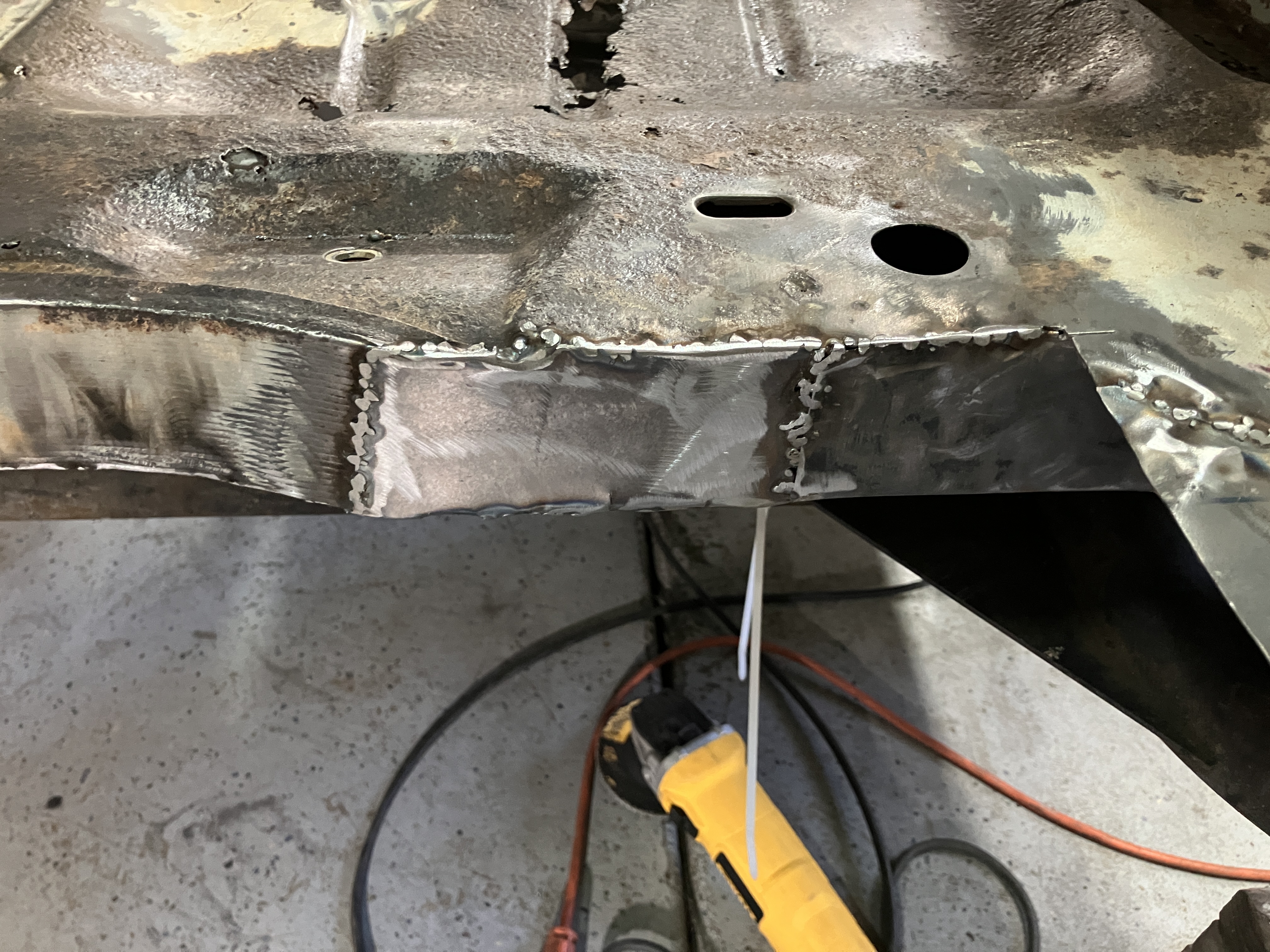

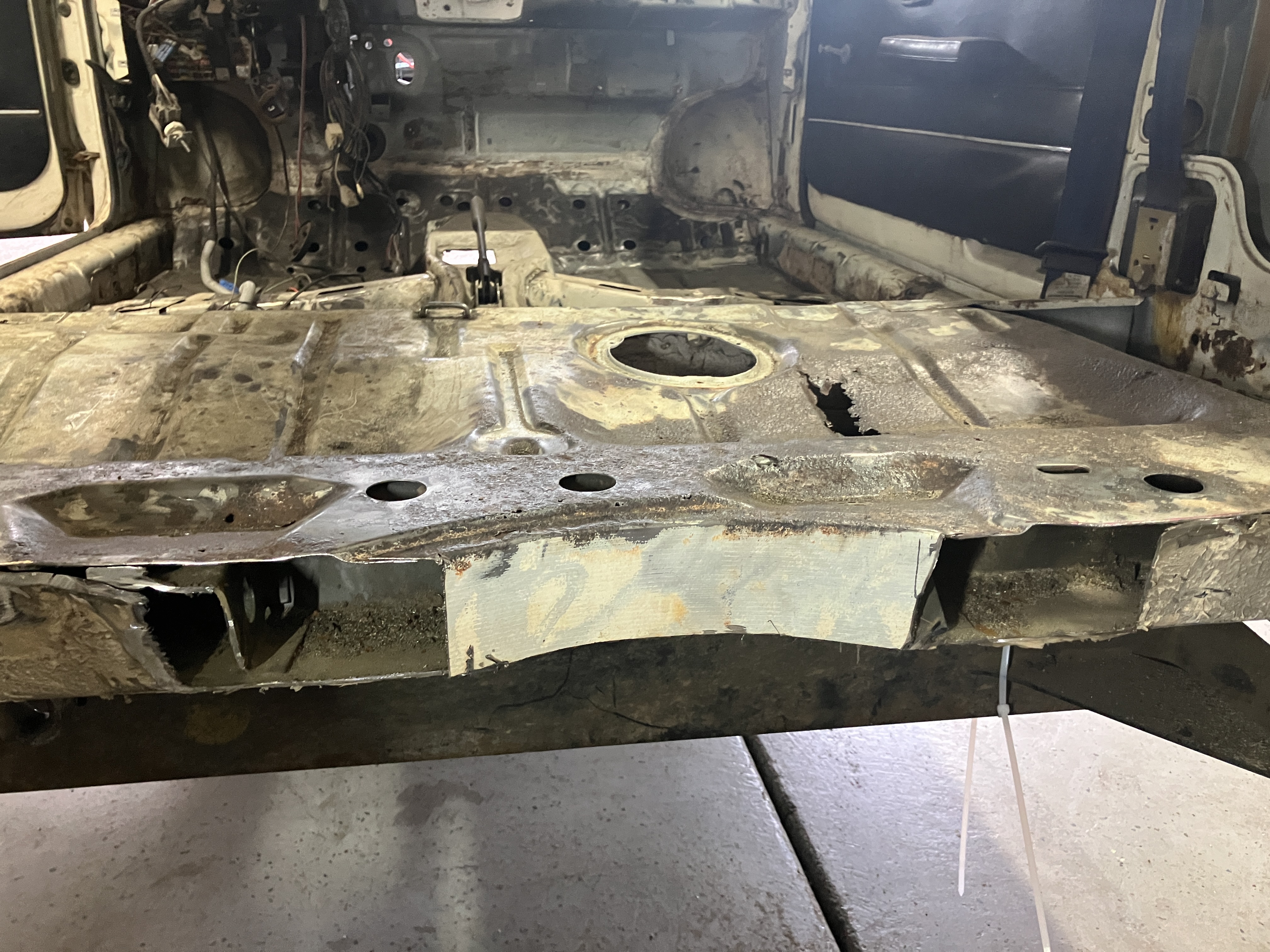

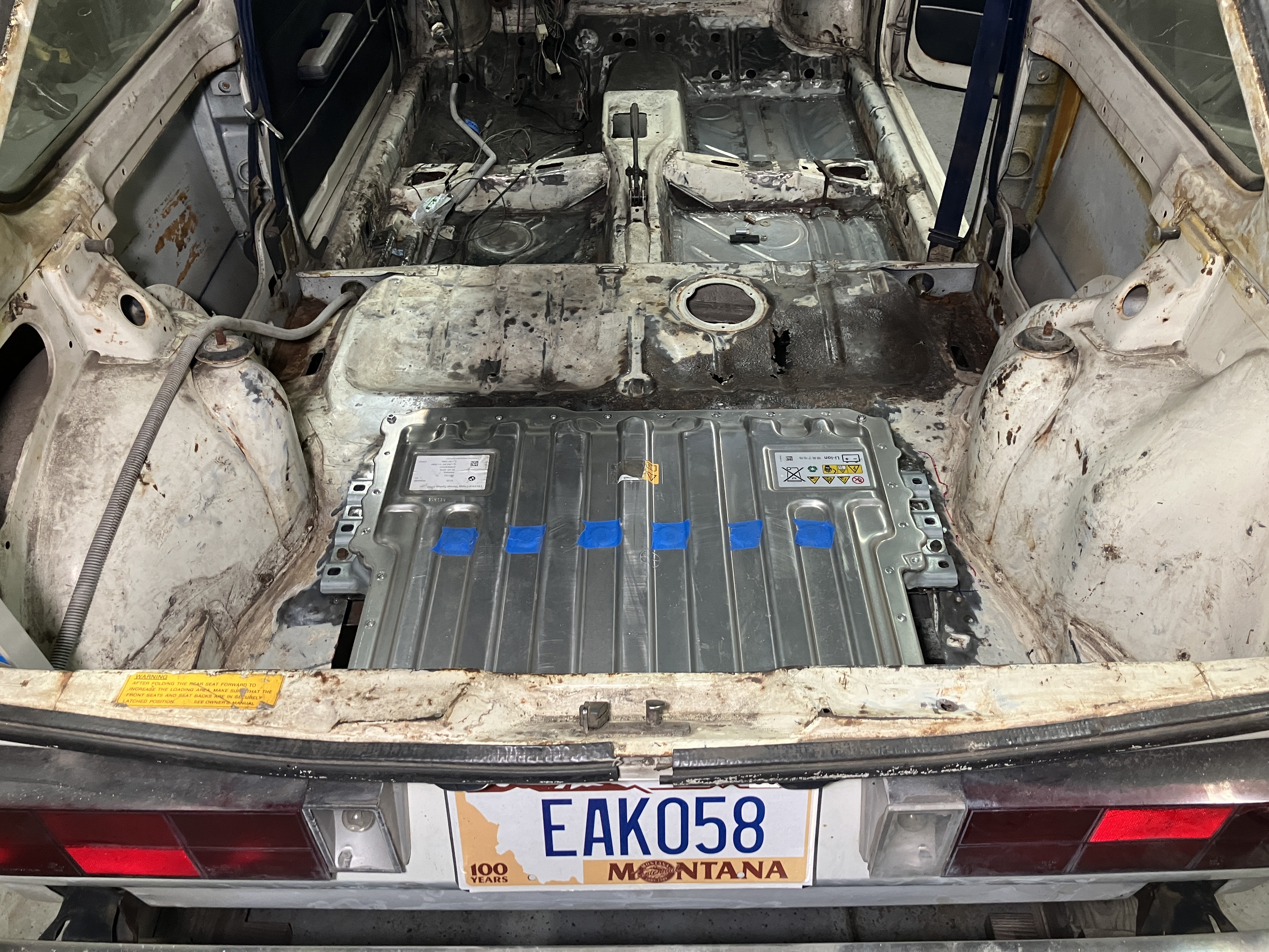

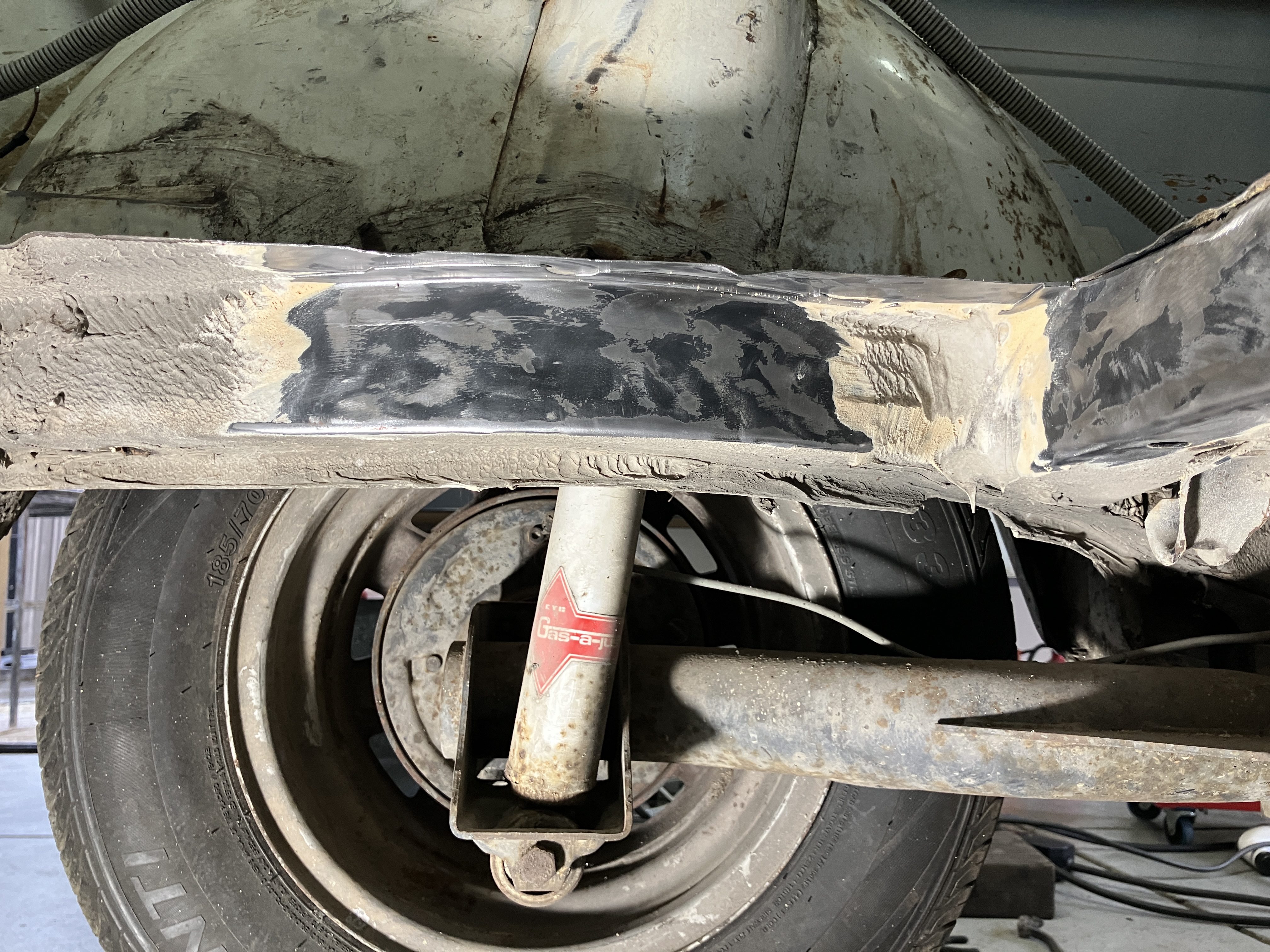

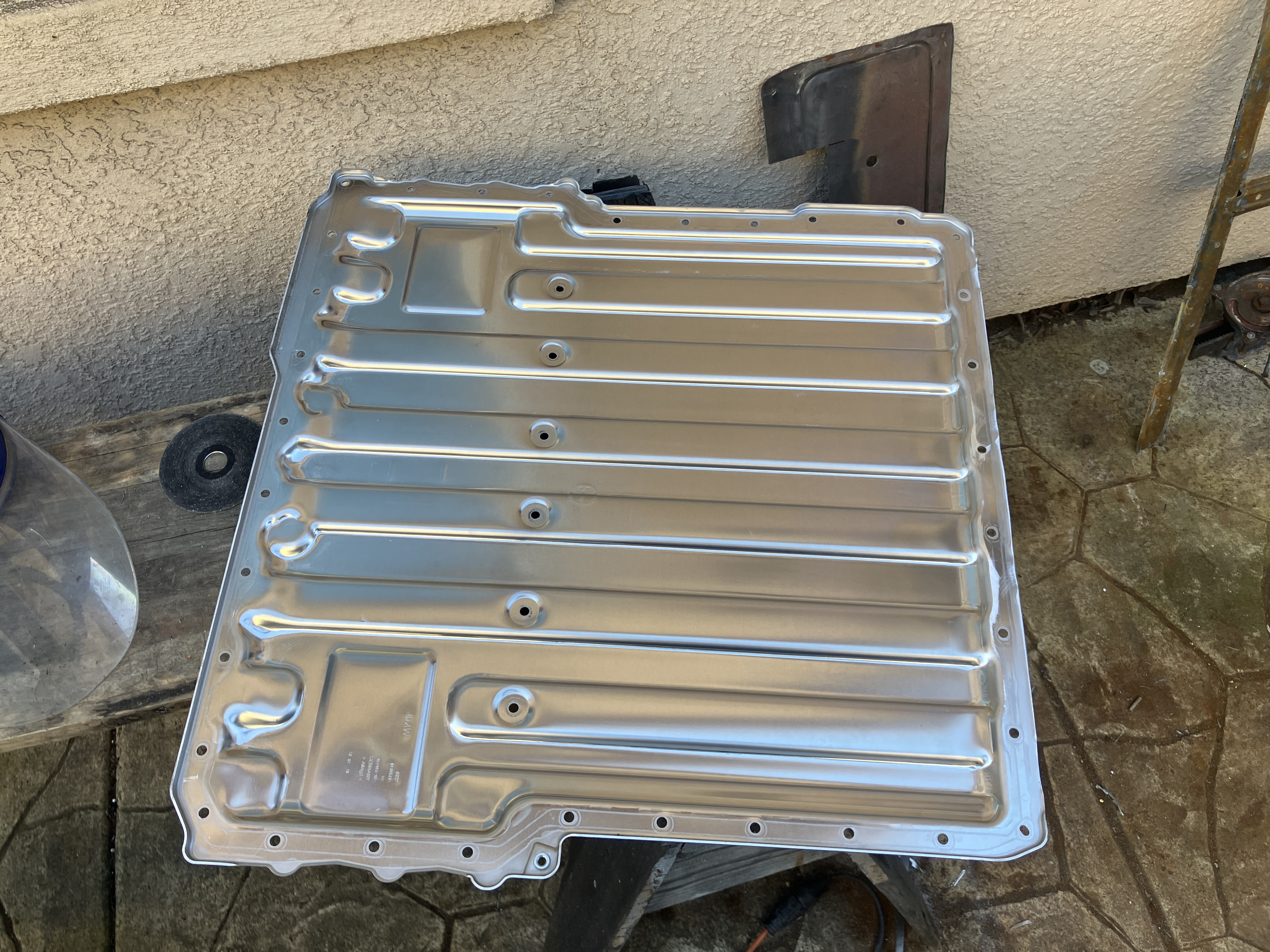

here is it from underneath the car

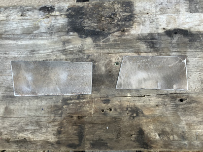

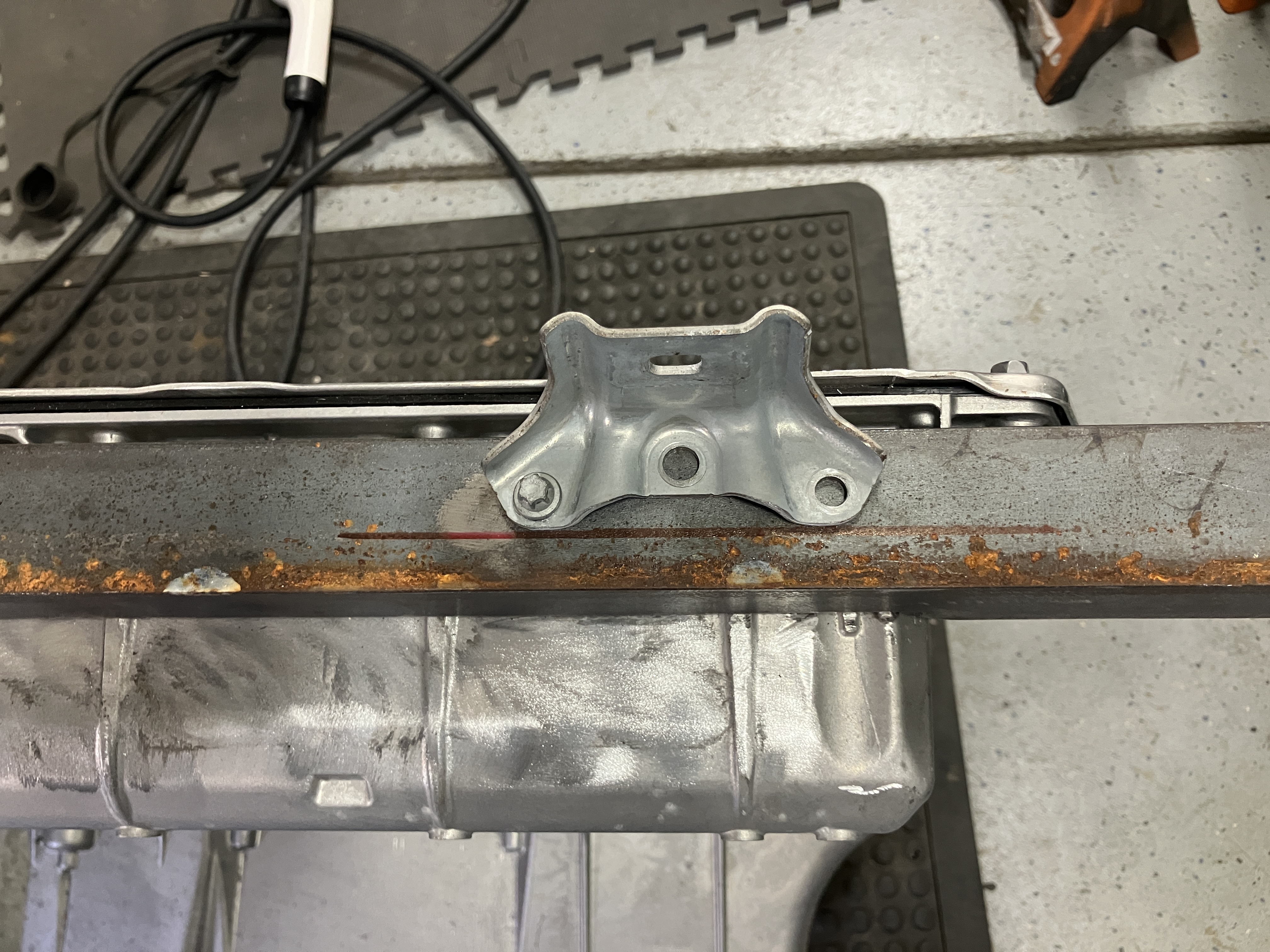

Hole Transferability Station (HTS)
that's red Sharpie ink not blood (for once) on my finger

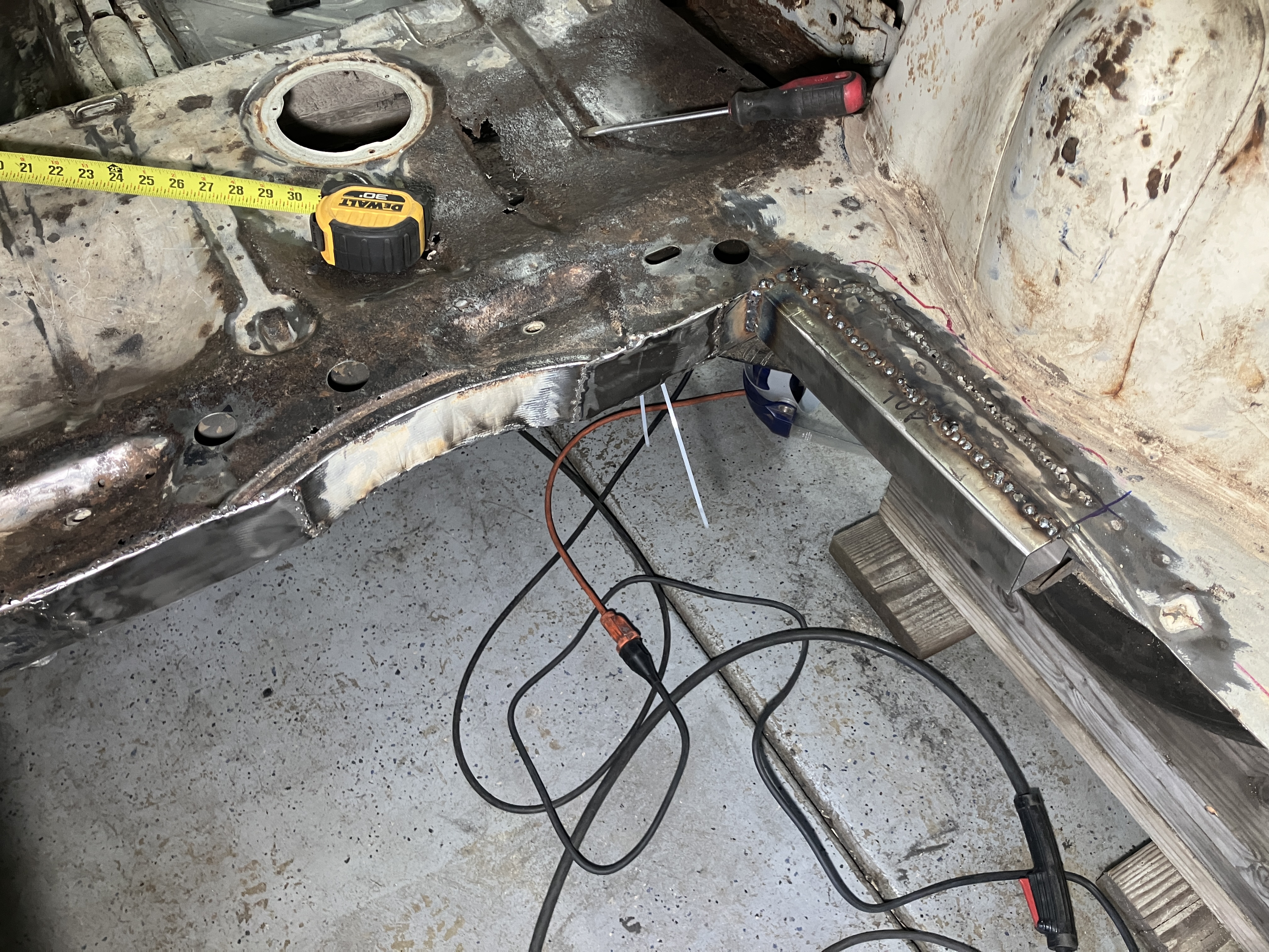

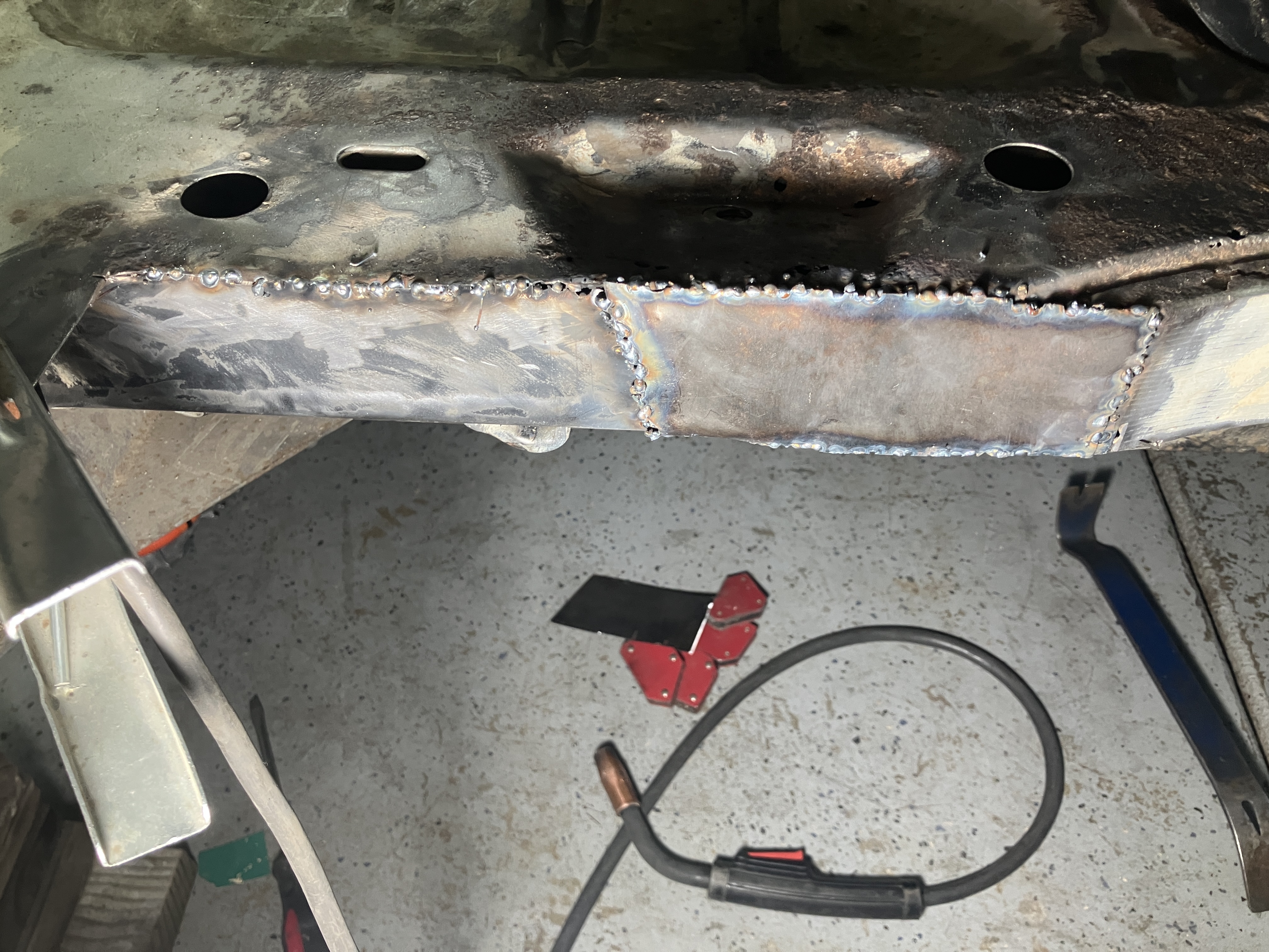

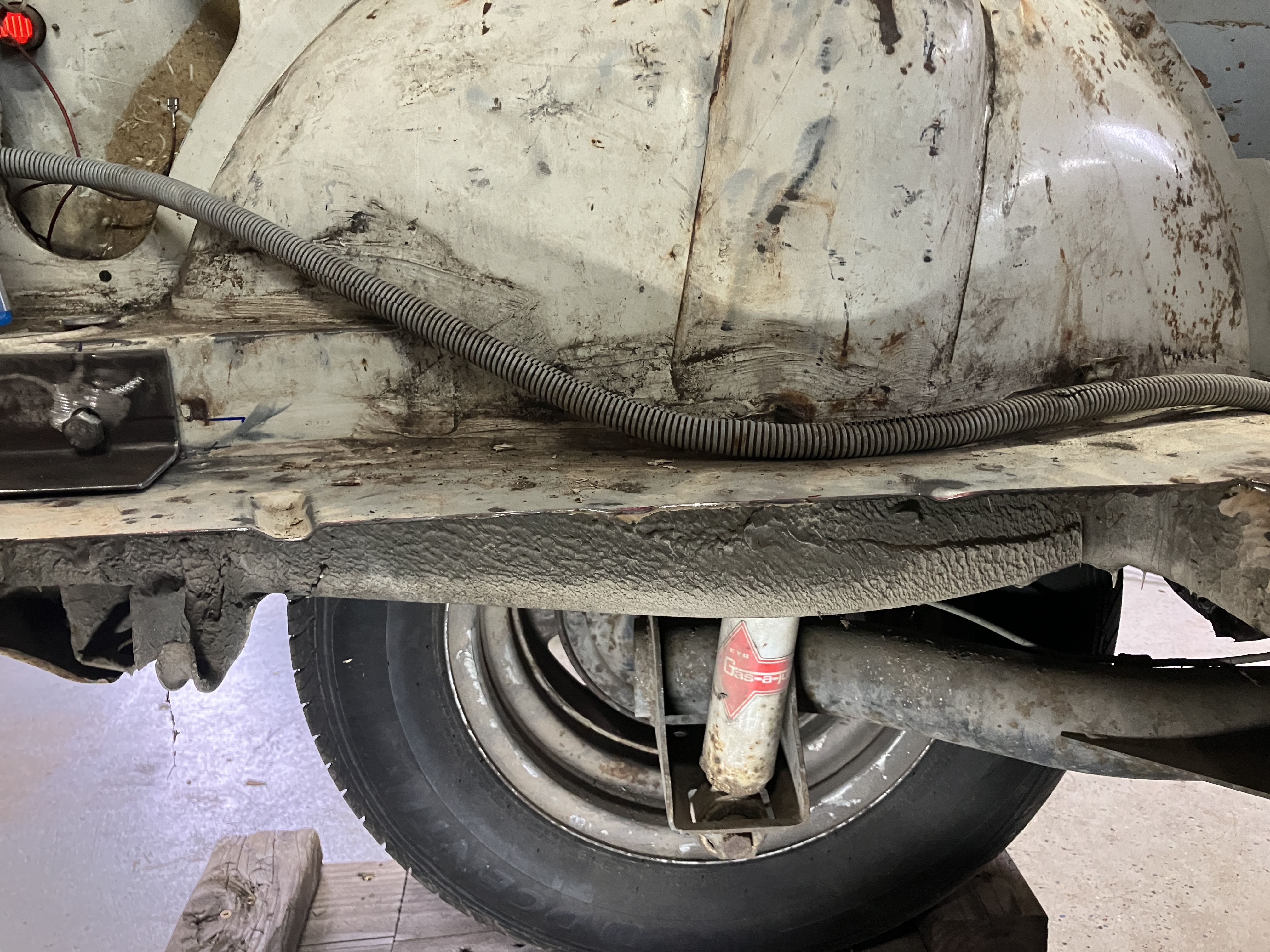

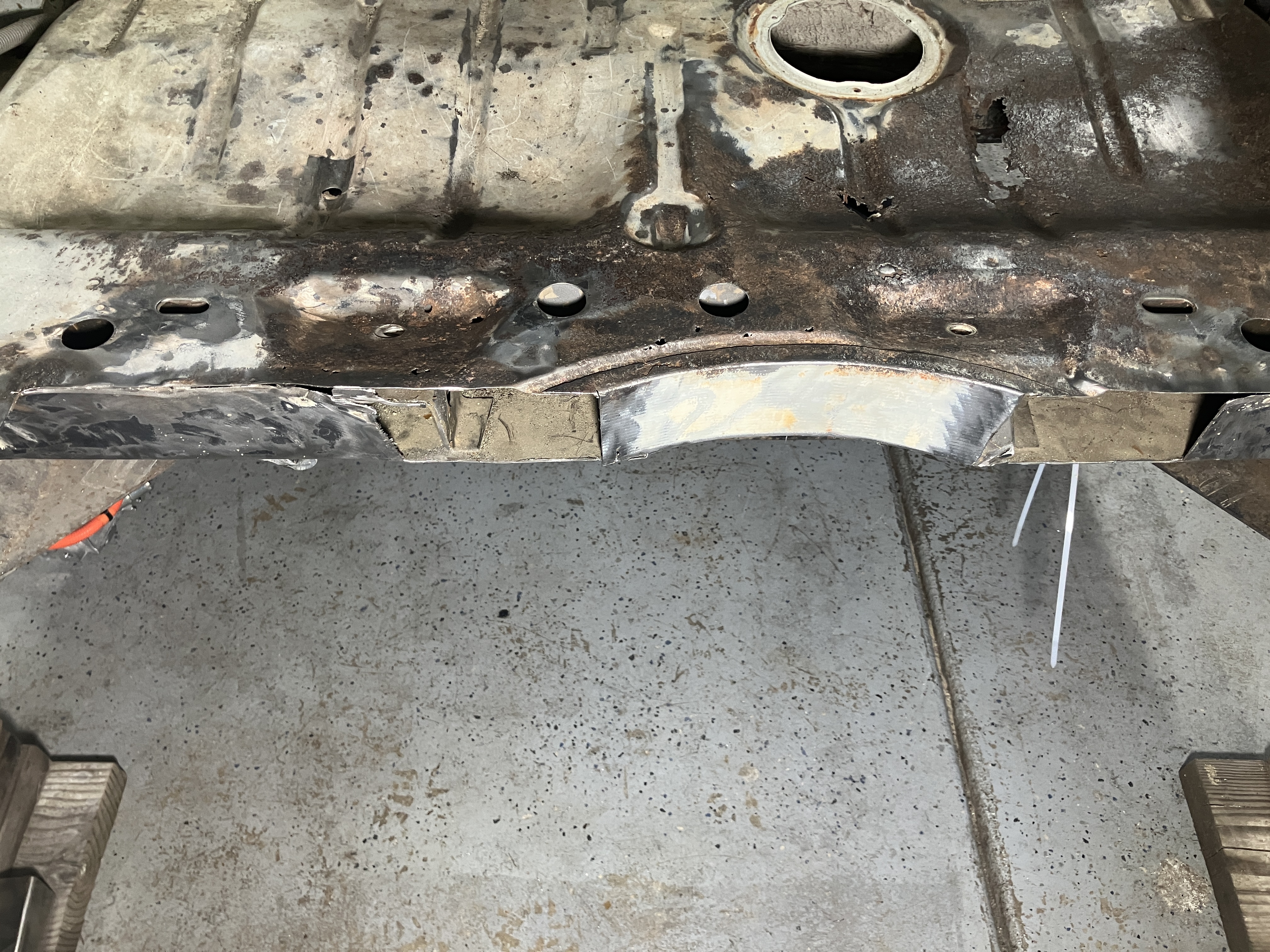

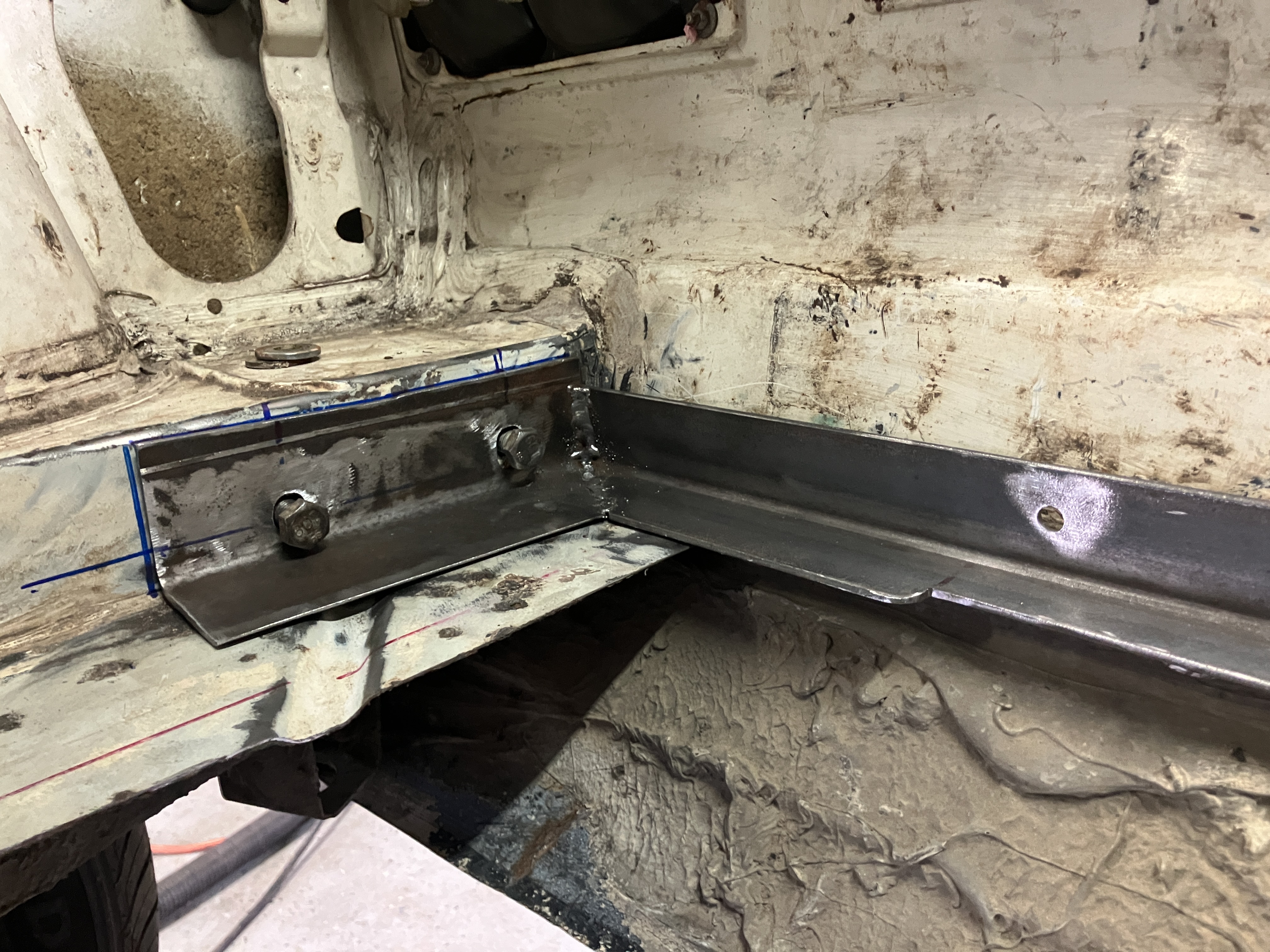

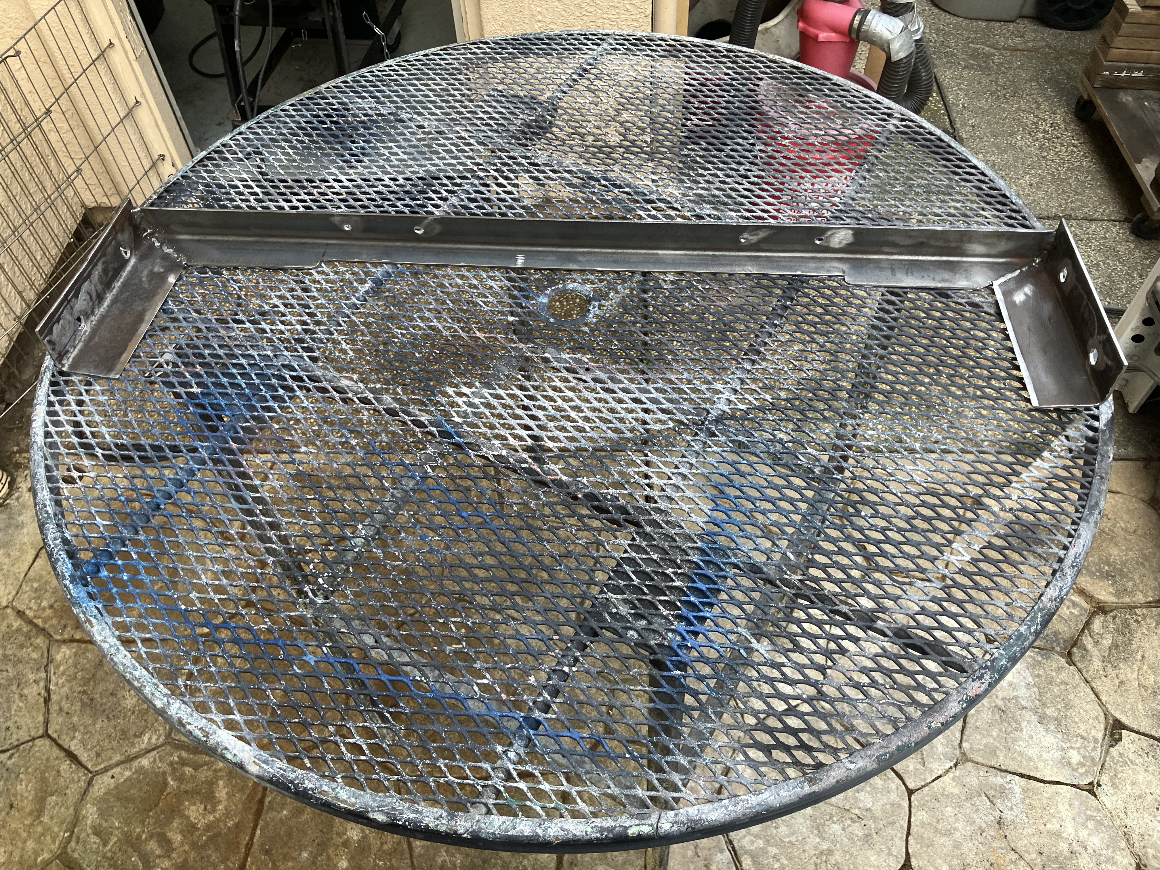

the rear bracket

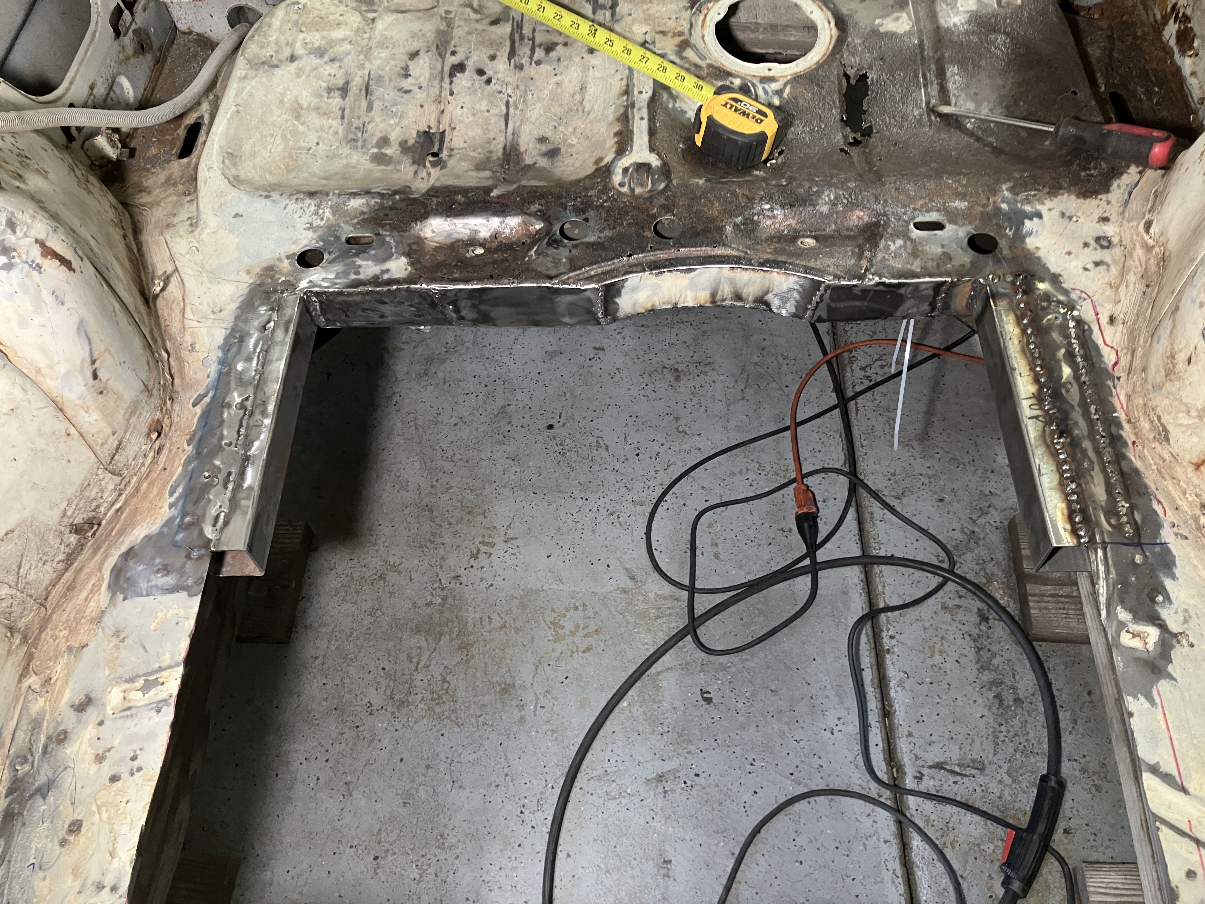

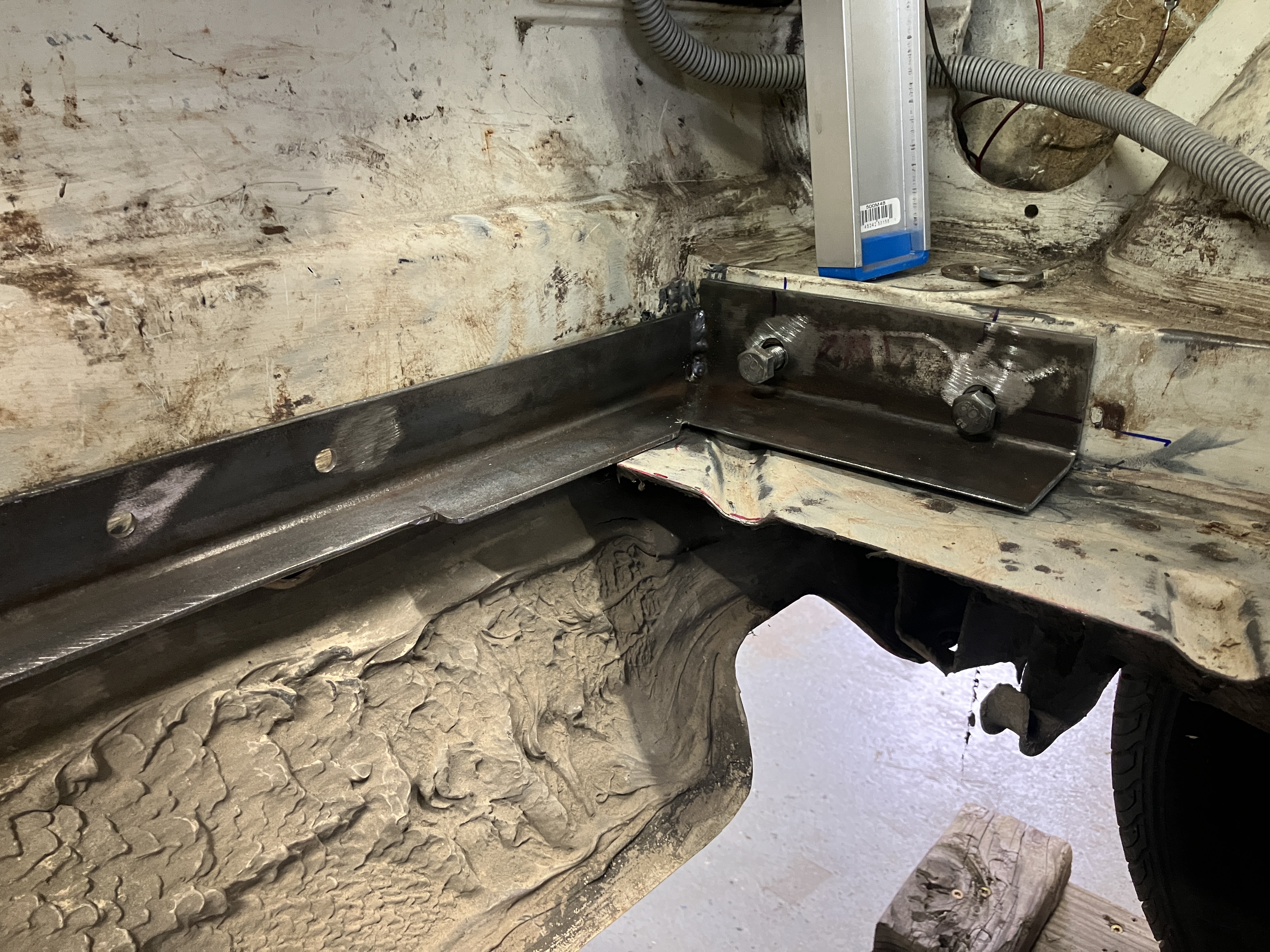

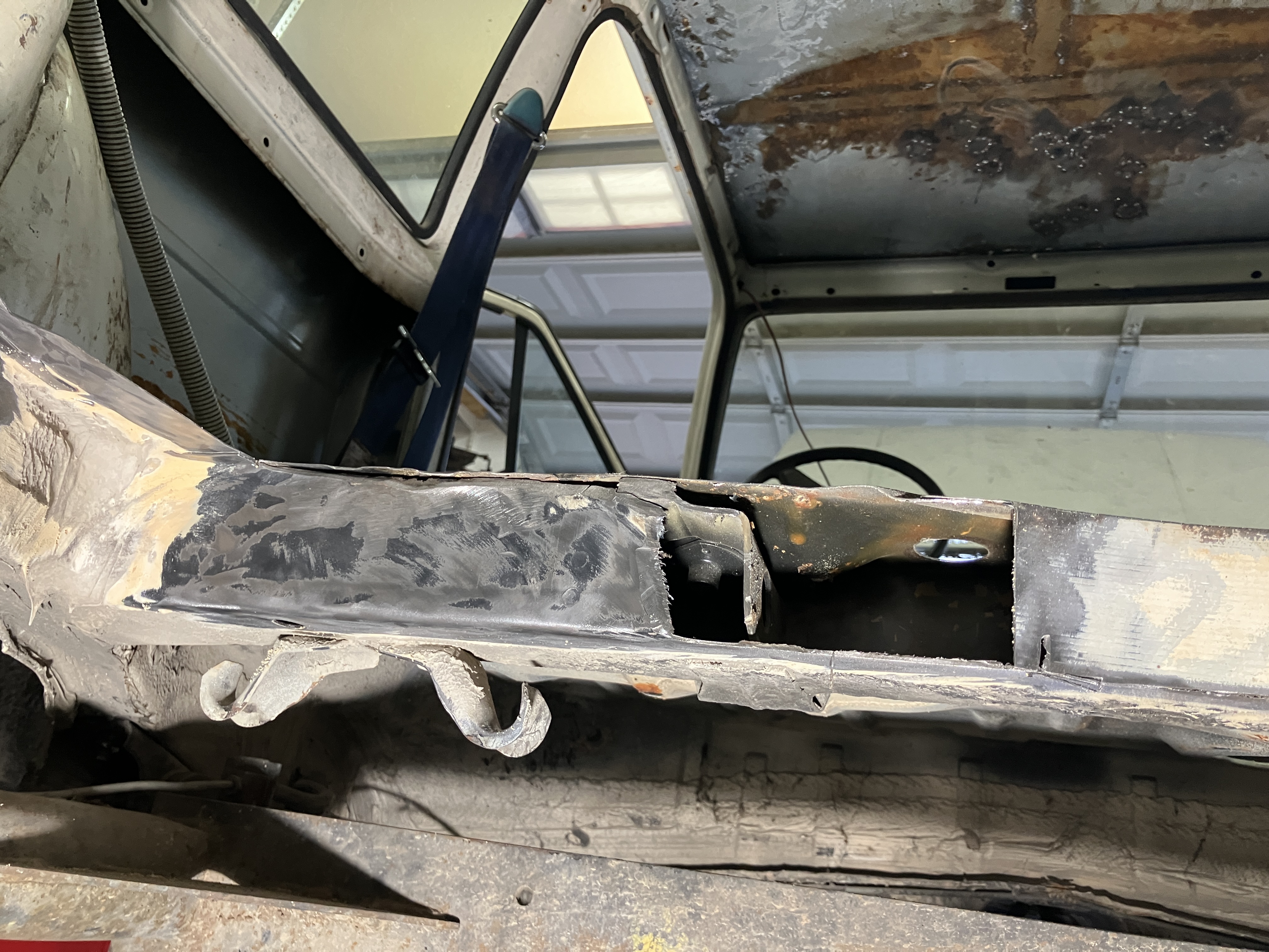

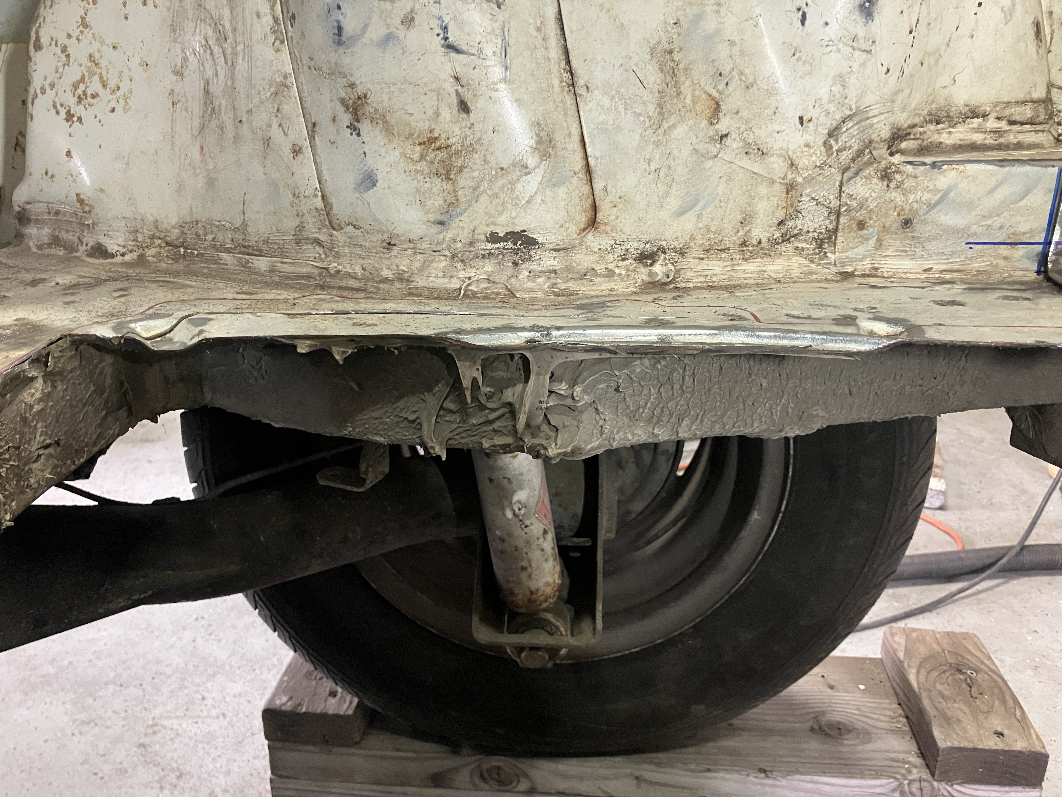

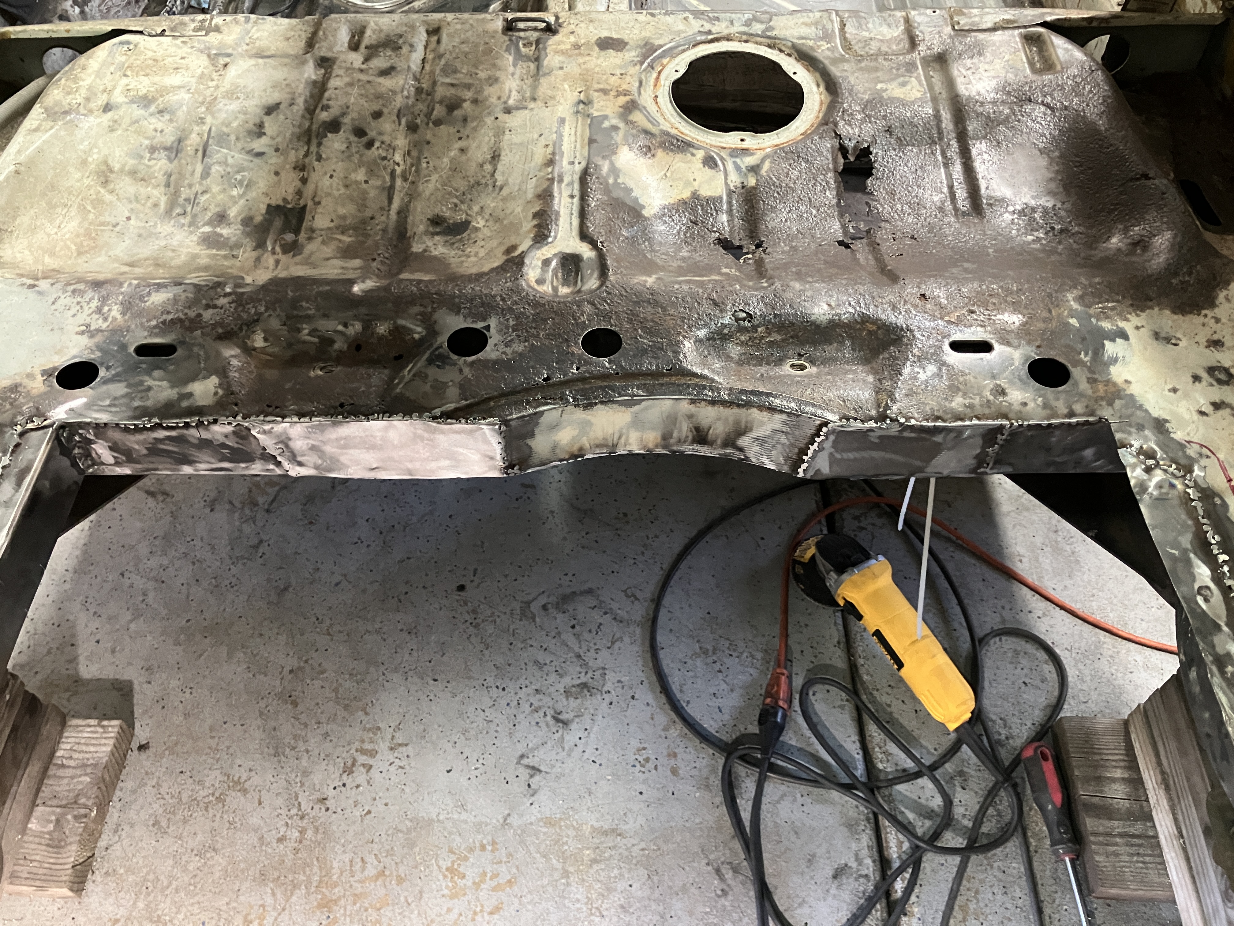

going after the front braces, bracket thingies, the white stuff removal was zero fun
DRIVER SIDE
PASSENGER SIDE (I think Irma was having a bad day on the production line that day and took it out on my frame rail)
before all the grinding
DRIVER SIDE

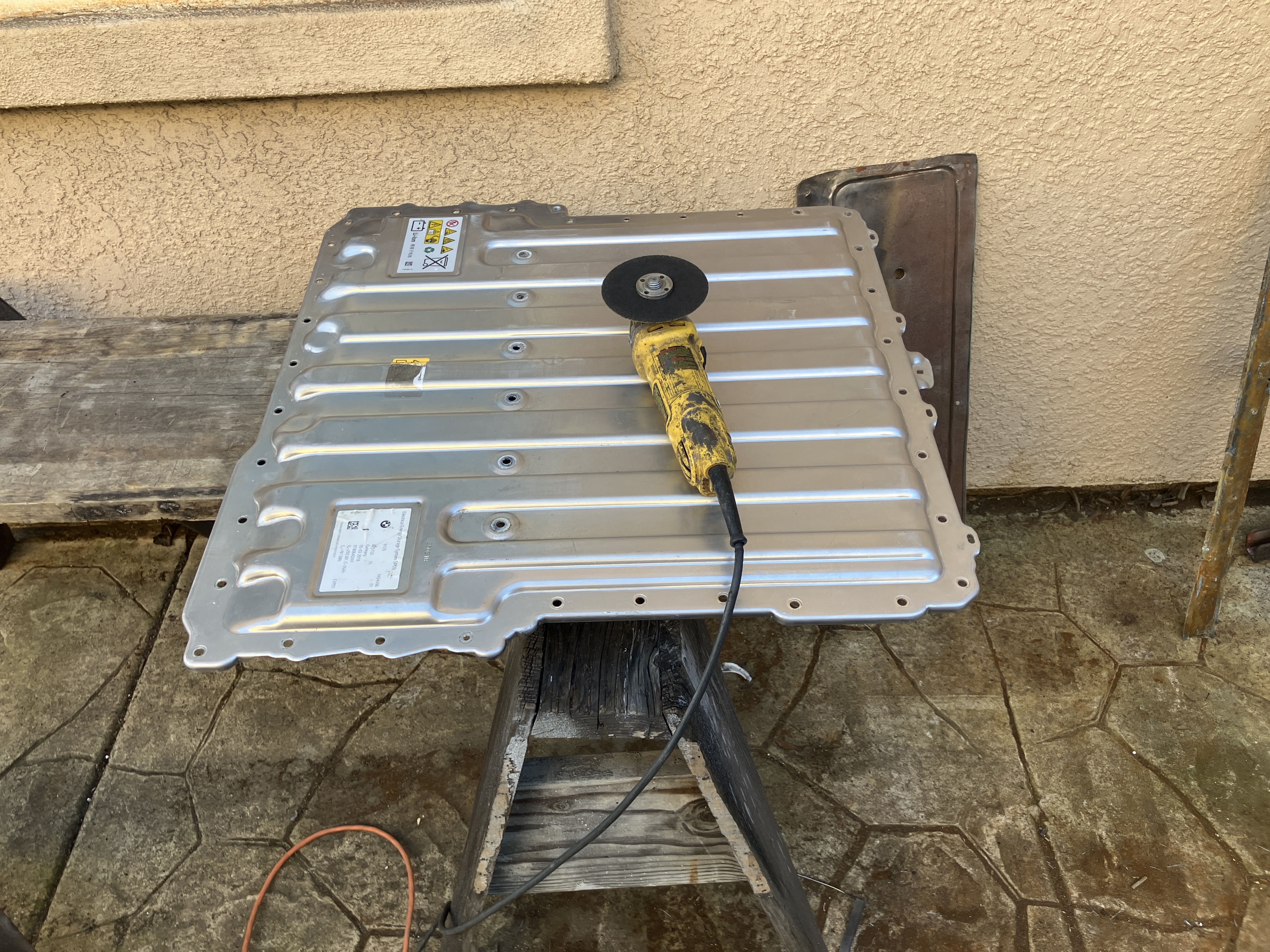

and she's in, should make for a great little 7.6 kWh starter pack
