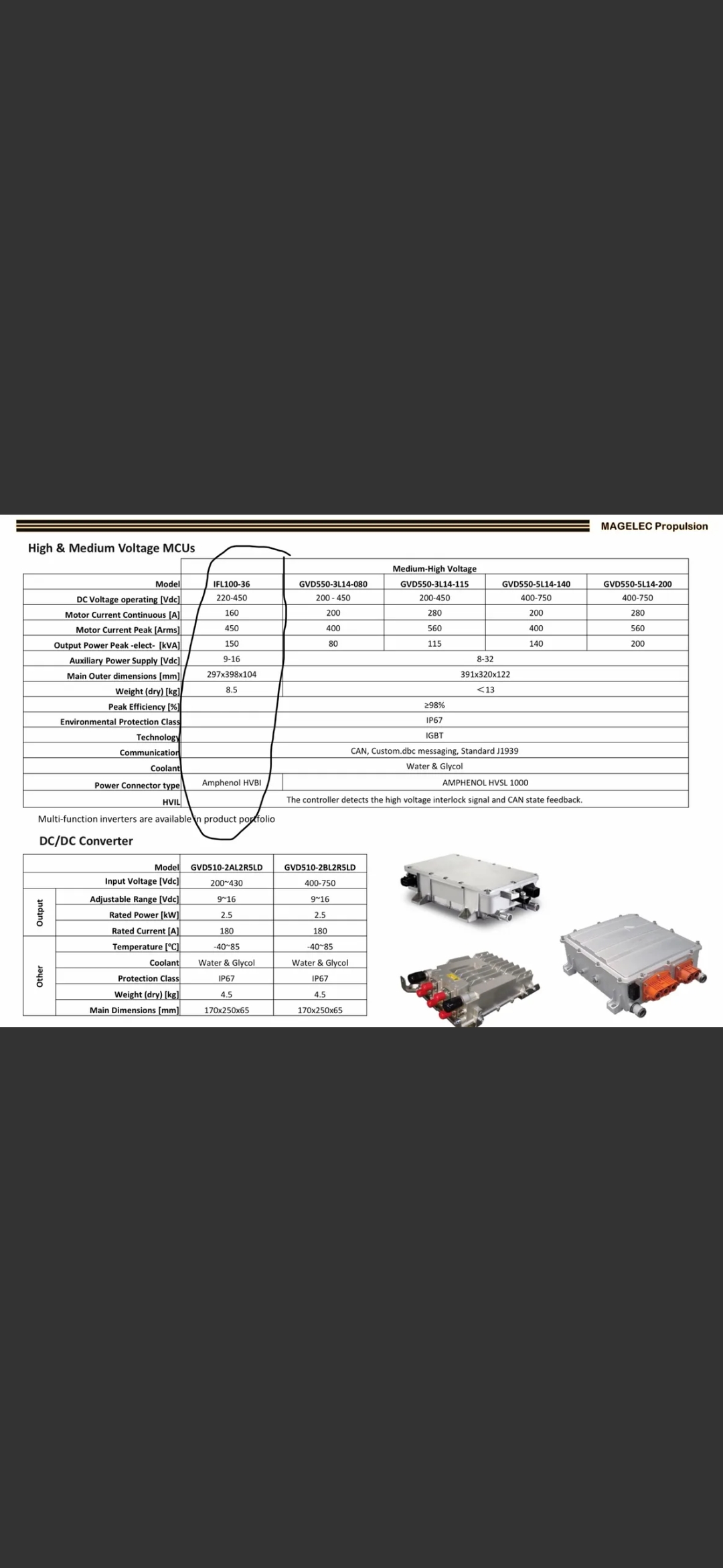

I am building a unique project, hoping someone could please help. I am building a STOL drag airplane
First type to be electric.
I acquired a duel axial motor setup .2 MAGELEC PROPULSION M24P4-D-19 AXIAL FLUX With matching motor controller's, I don't have a compatible vcu. I was hoping someone could help me get these motors operational. Any help would deeply be appreciated. Thanks William

If you compare the speed, drag and weight i think your selection of airframe is about on par with the power requirements for cruise, albeit at slower speed with more drag.
If i understood from the photo your choice of airframe is Zenair 701? Or are you planning on using Wittman Buttercup?
Do you have an idea about the battery?
I see the motor data shows 90kW cont. is that for the pair or individual motors?
Do you have a CAN bus control document for those inverters?

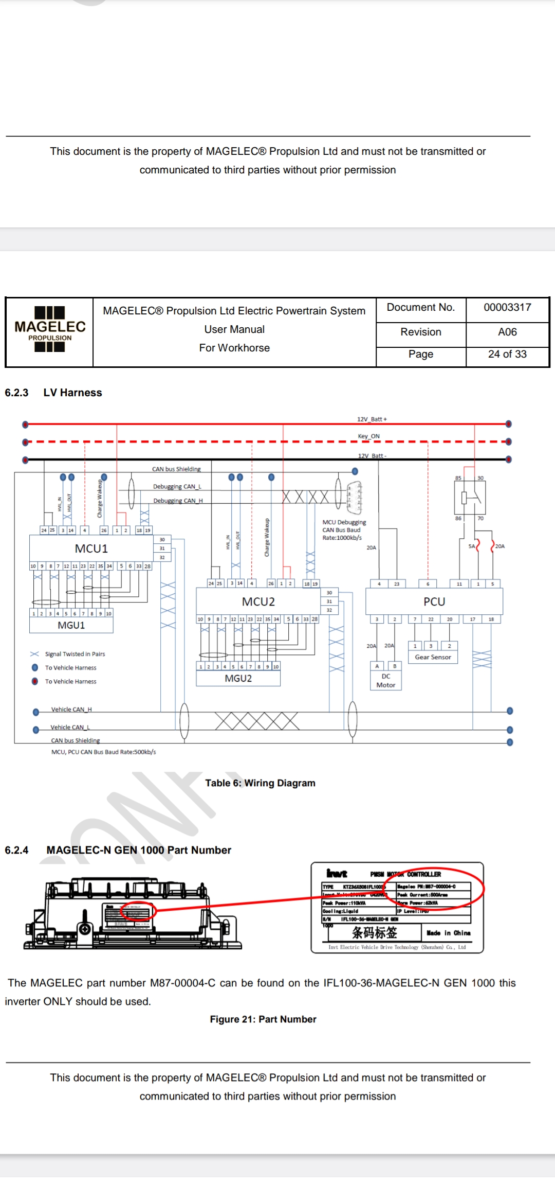

Aerobat wrote: Sat Mar 09, 2024 12:26 am I will be using The Zenith 701 airframe. I don't have any can information, this is were I lack experience. I have only a general wiring diagram. This is were I need help.
Ok, wiring is not a problem. To use CAN bus you would need to have native protocol document. This will show which IDs are used and which bytes carry command info. Also there are reporting IDs where you can receive diagnostics for your drive. You will need those to lit some lights in the cabin to let you know if inverter is overheating...
OK i see CAN speed is 500kbaud which is normal speed for device control.
EDIT: I suggest you buy this kind of CAN analyzer: https://www.aliexpress.com/item/1005004 ... 1802s9NtrC

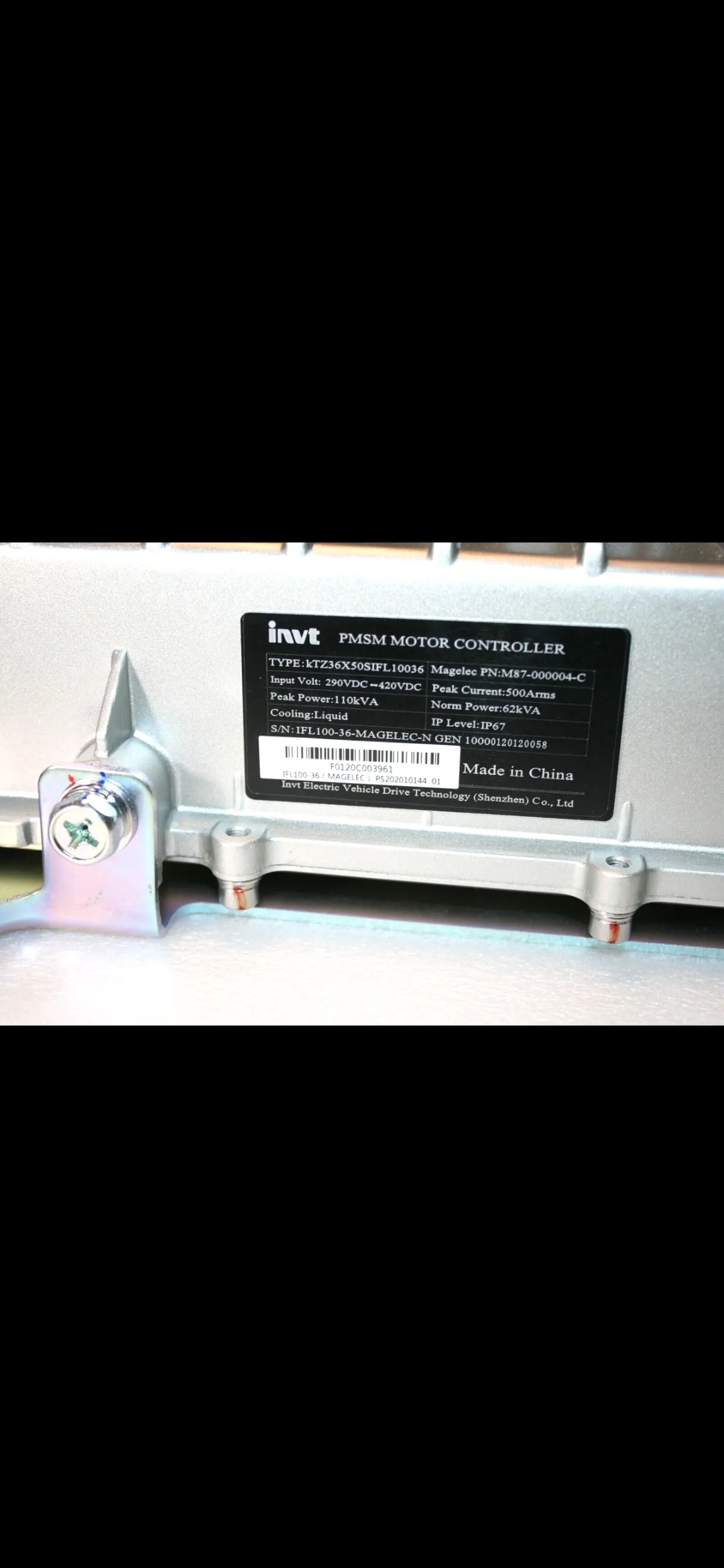

Could you send me the photo of product plates of inverters so i can get the type and P/N? I can search for the protocol from my end.
Meanwhile as a product owner you can try and contact the company and tell them you are designing your integration and you require CAN protocol to drive their inverter. If you have to buy that document from them as proprietary... so be it.

I purchased motors from a third party, I contacted the manufacturer and supplier, but because of liability. They wouldn't provide me with any information. It's been very frustrating trying to find any information on this unit,

Hi, Any update on the data sheets? I would like to purchase the motors but would like to see some pinouts of the resolver before I pull the trigger!

Howdy, hope it's not too late, I can get you pinouts and CAN protocol if you want. Only issue I'm having is that the inverter has two sets of CAN wires, one labeled Vehicle CAN, and one labeled Debugging CAN. The Vehicle CAN doesn't give a nice looking signal over an oscilloscope but the Debugging CAN does. However, I only have CAN protocol for the vehicle CAN, not for debugging. So I'm a little lost on getting it setup.

If a CAN does not show the usual sqare waves on oscilloscope it most likely is missing the proper termination.
