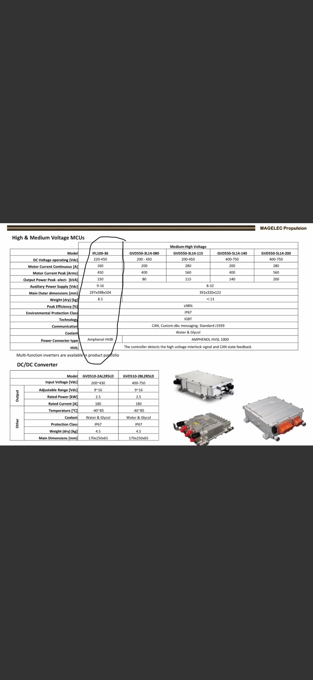

I see the motor data shows 90kW cont. is that for the pair or individual motors?

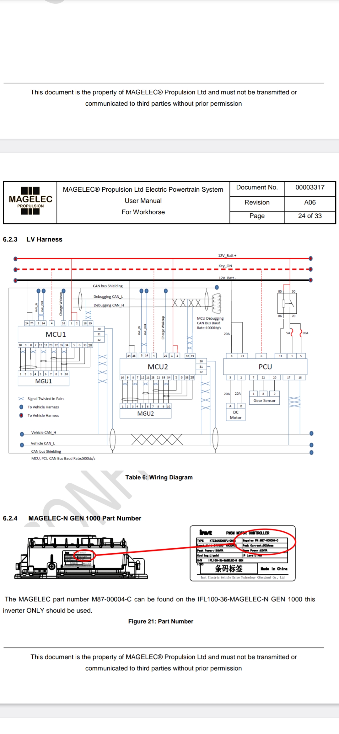

Do you have a CAN bus control document for those inverters?

Ok, wiring is not a problem. To use CAN bus you would need to have native protocol document. This will show which IDs are used and which bytes carry command info. Also there are reporting IDs where you can receive diagnostics for your drive. You will need those to lit some lights in the cabin to let you know if inverter is overheating...
OK i see CAN speed is 500kbaud which is normal speed for device control.

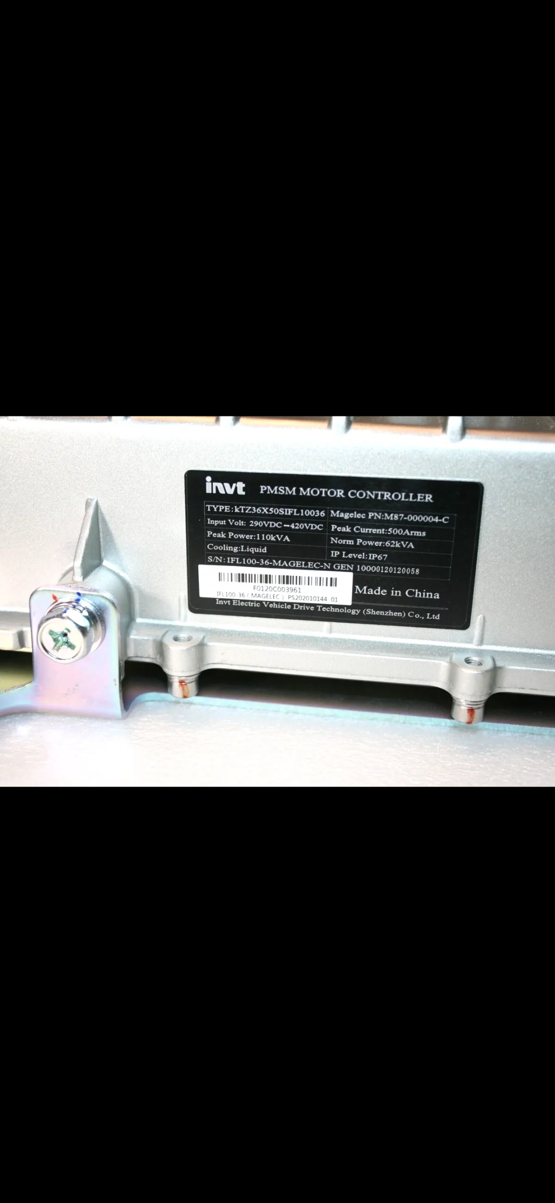

Could you send me the photo of product plates of inverters so i can get the type and P/N? I can search for the protocol from my end.
Meanwhile as a product owner you can try and contact the company and tell them you are designing your integration and you require CAN protocol to drive their inverter. If you have to buy that document from them as proprietary... so be it.

I purchased motors from a third party, I contacted the manufacturer and supplier, but because of liability. They wouldn't provide me with any information. It's been very frustrating trying to find any information on this unit,
I picked these motors for the axial design, duel motors duel controller's and duel battery pack. Double redundancy. Also I am engineering a counter rotating propeller assembly. To eliminate toque effects. These motors are rated to 600 volts and total of 400 kw.

I contacted manufacturer and supplier, they will not provide any information, after further research on VOLT inverter, I think these will fit my application perfectly.
I read all information in the links you provided. Honestly it's a little over my head. I only have basic understanding. I can build circuitry and do minimal programming,

What i have seen about motors and inverters from Magelec it seems like moderate power inverter 500A 400V and 120kW motor. This things do look like they can absorb some overtorque. It surprised me motor is rated for 120kW continuous! Probably a good option for direct drive application.
I would say axial motors need some revolutions to get up to torque but when there they provide consistent torque. Good for prop shaft drive and generator maybe not so for car transmission drive.
