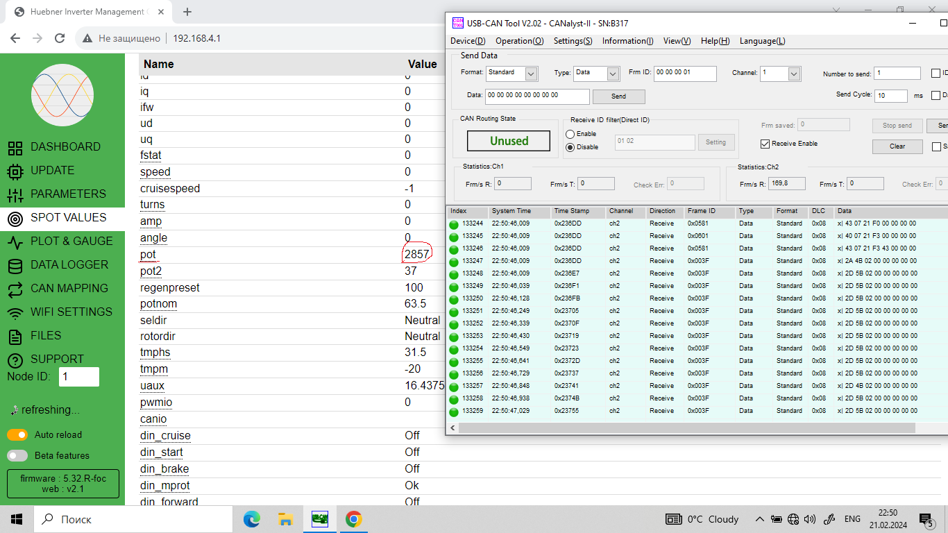

This suggests that the board from a Prius (Yaris) with two controllers can no longer be controlled as before, or I read the instructions upside down:https://openinverter.org/wiki/CAN_commu ... _CAN_-_new!
Inverter Firmware 5.32.R

Re: Inverter Firmware 5.32.R
No, not with this version. With the next release I will add a cyclic counter that satisfies the control message requirement. CRC checking can be turned off on the receiving side.
For now you can stick with version 5.27.R on the receiving side to retain the functionality

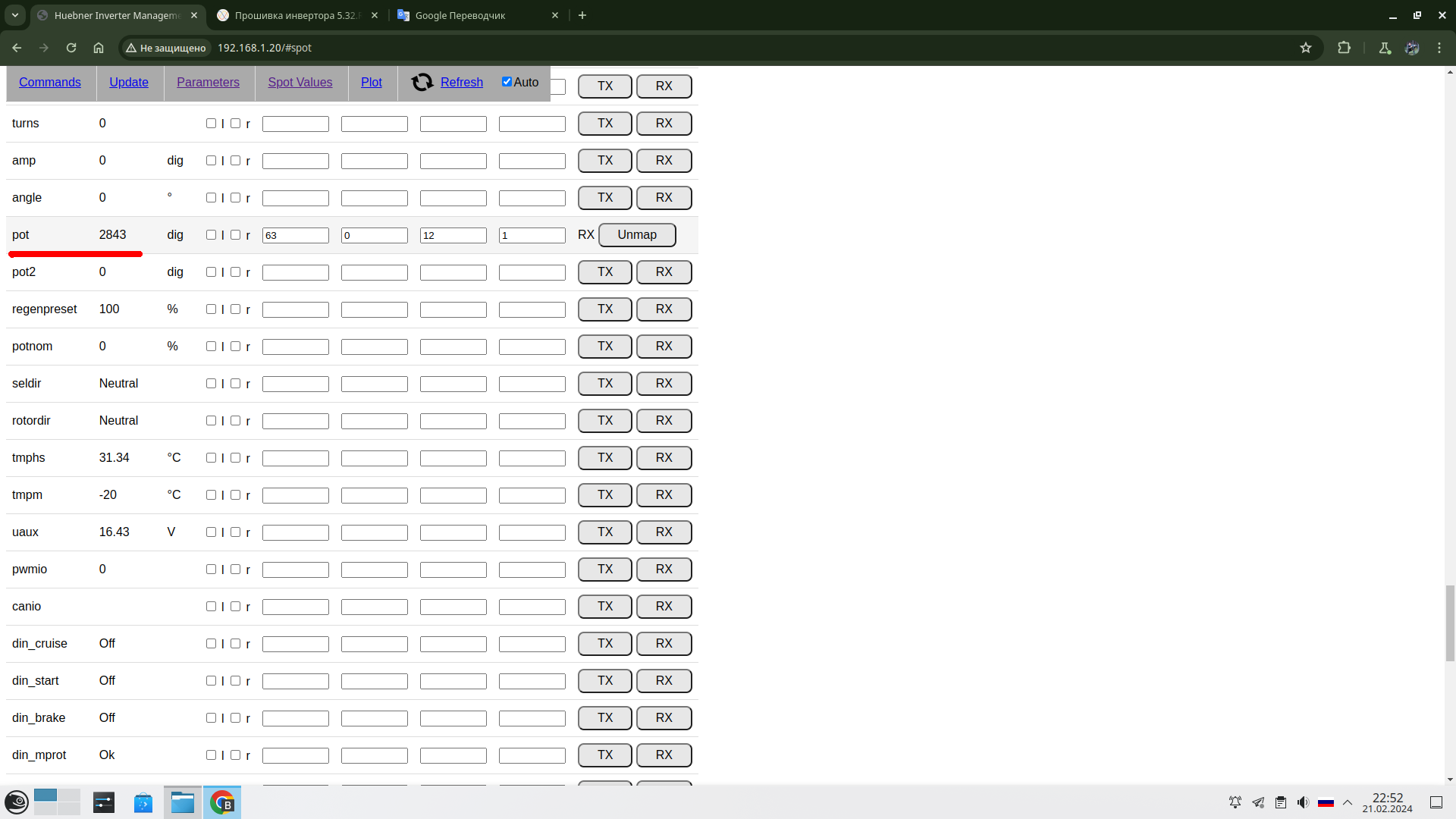

The "pot" and "pot2" parameters are not saved on both controllers (that is, Rx and Tx) after a power failure. Before the power is turned off, everything works and the slave controller receives messages identical to the master. Is this a feature of the firmware? Or am I doing something wrong? I haven't tried it since 27.
Indeed 5.32 removes any mapping from pot and pot2, even TX mapping. That should be changed. So 5.27 on both sides. You need to hit Save to Flash to make mappings permanent

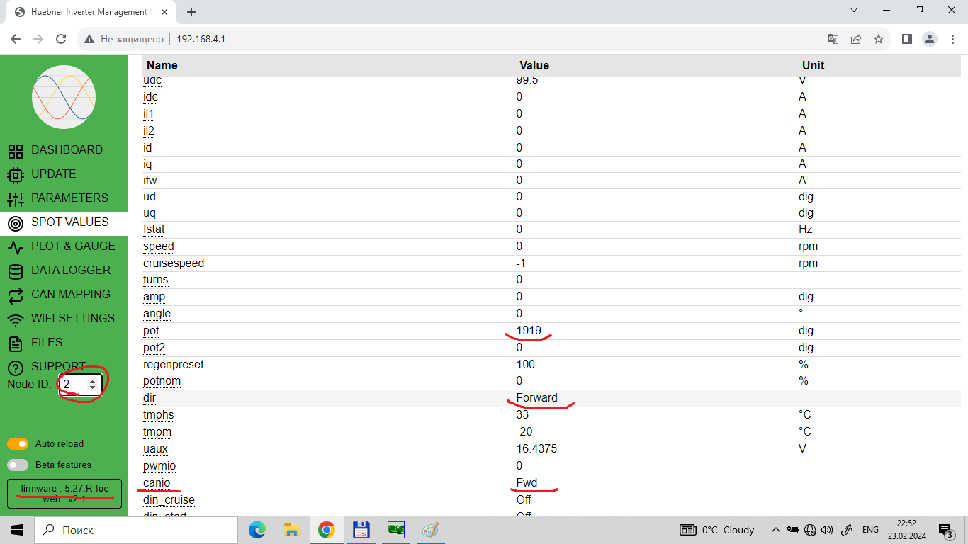

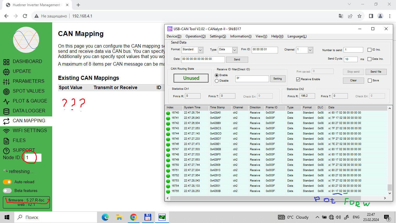

Yes - everything works with the previous firmware. The settings are saved. MG 2 sends MG 1 receives But nothing is displayed in the CAN map. But this seems to be a problem in the web interface. In the old (gray) mode, all CAN data is visible.
