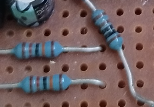

Thanks for adding more detail pictures to the GitHub. I have now modified my TP-PA4010 and working on other steps. I try to list electric unit that this project needed. Sorry for having so much question. I am quite new to doing physical electric things.
  • light-green 18650 accu
  • 2 * B0512S-1WR3 voltage converter
  • what kind of bridge that can replace potentiometer?
  • what kind of cable that connect to PEV ? 3D printed module that plug into PEV charging port
  • what kind of capacitance you used in this project?
  • what is this 89A252M?
  • what kind of resistor in the picture?
  • what kind of 3 squares in the Circuit diagram?
