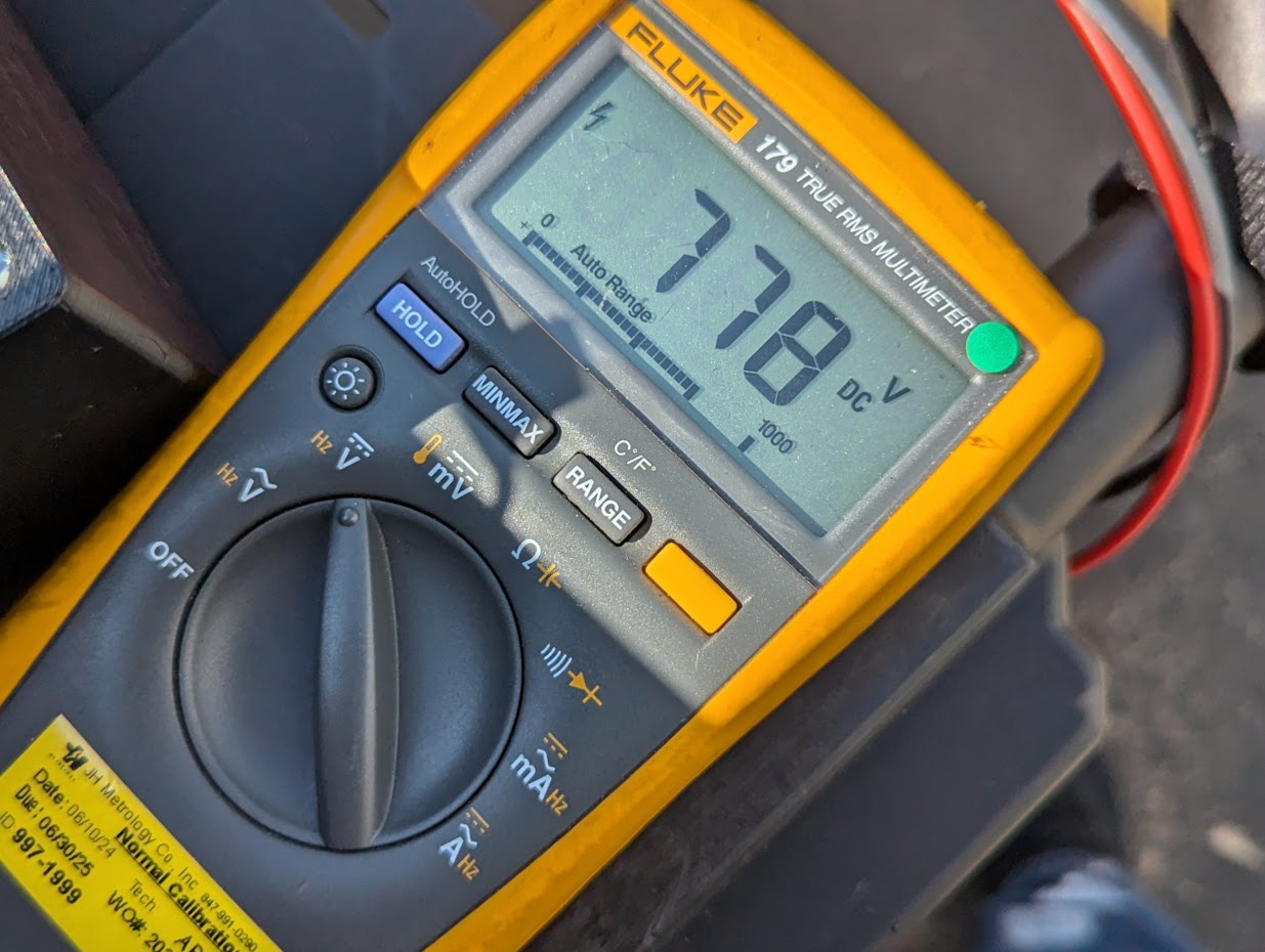

Today I was able to do the light bulb test on the Polestar 2. With the DC/DC converter I mentioned earlier, supplied it with 12v and set it to 580v (voltage drops a bit to around the requested voltage when the car is measuring voltage, as this converter is unregulated), only needed it to pass precharging. After that I could switch the separate power of and the vehicle kept discharging for 1 hour, possibly more but this was all the time I had. After disconnecting the setup the cooling fans kicked on and the SoC updated by dropping to 74% after switching to drive.
This is a very good sign for discharging these vehicles for V2x and that will be my next test with goodwe gw10k-bt and a decent cable.

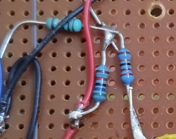

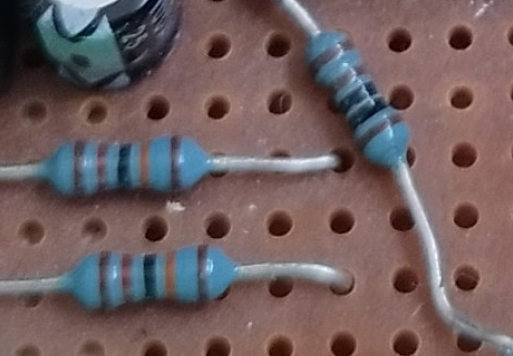

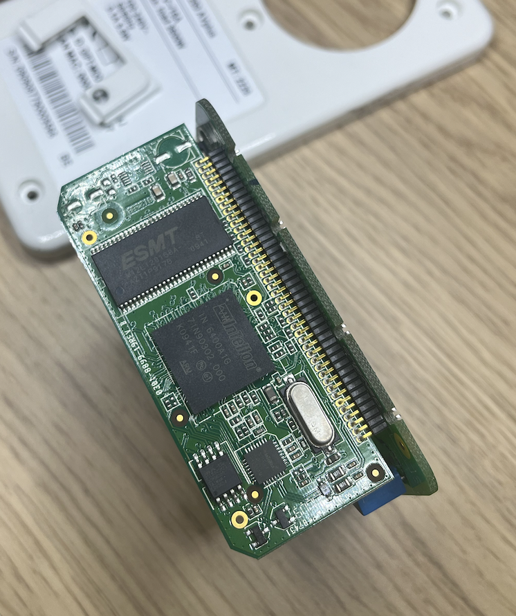

Thanks for adding more detail pictures to the GitHub. I have now modified my TP-PA4010 and working on other steps. I try to list electric unit that this project needed. Sorry for having so much question. I am quite new to doing physical electric things.
  • light-green 18650 accu
  • 2 * B0512S-1WR3 voltage converter
  • what kind of bridge that can replace potentiometer?
  • what kind of cable that connect to PEV ? 3D printed module that plug into PEV charging port
  • what kind of capacitance you used in this project?
  • what is this 89A252M?
  • what kind of resistor in the picture?
  • what kind of 3 squares in the Circuit diagram?

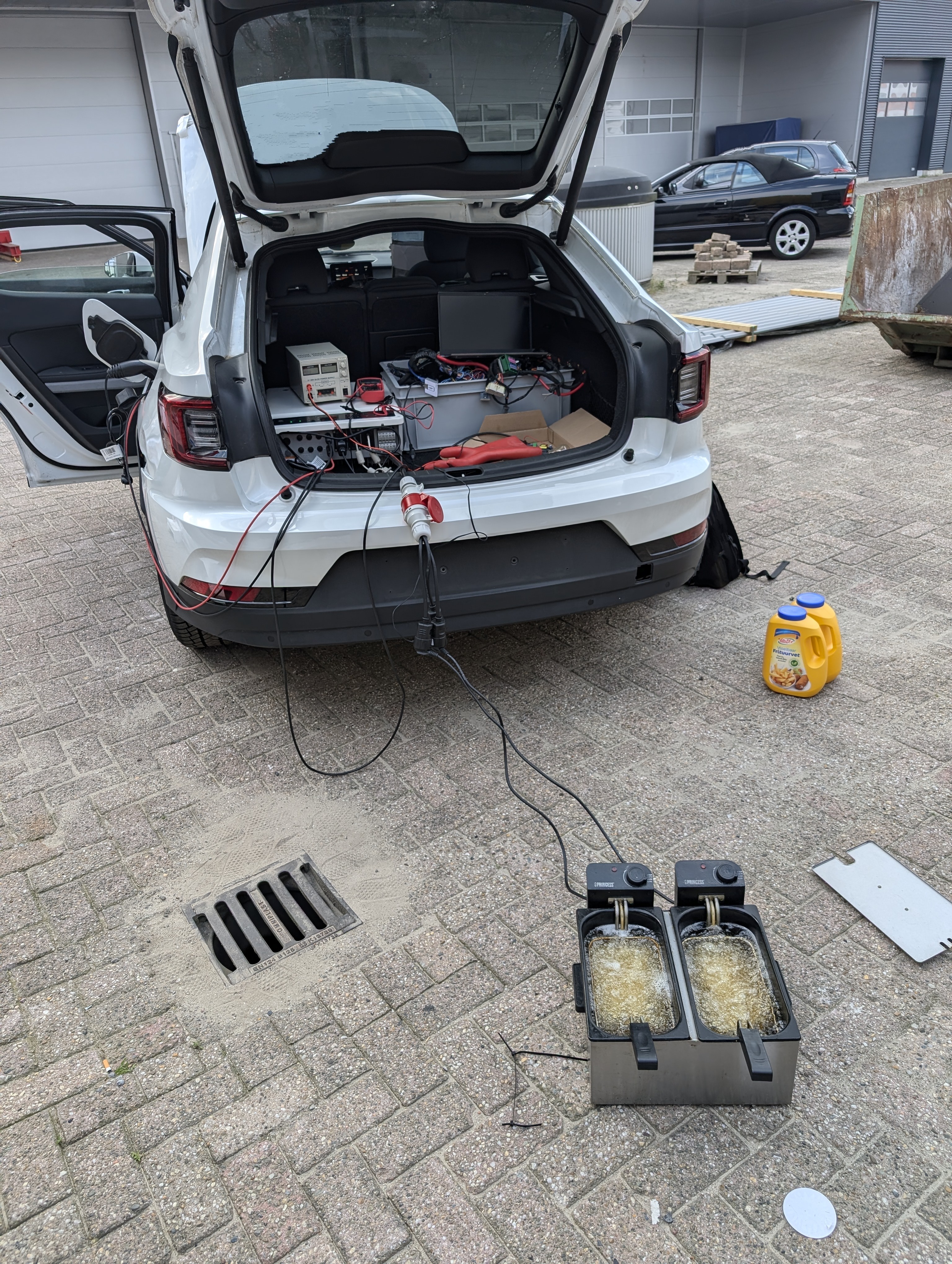

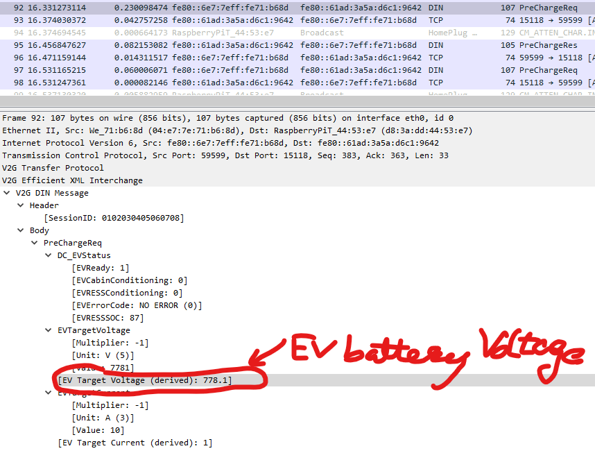

Hey all, little update on the polestar project.
We were successfully able to configure the inverter to work without a BMS (lead acid battery mode).
Here a little picture of a big load connected. The car just kept it's contactors closed for over an hour.
I have worked together with Griffigroen on this as an educational research project at an institution. Sadly the project is now ending, and we are not able to finish the system (adding HV contactor; automating the voltage setting on the precharge circuit; putting it in a nice safe enclosure etc.). Also thanks for the headsup on the risks @uhi22. We were aware of the risks and besides being NEN9140 certified, also under supervision. But you can never be careful enough.

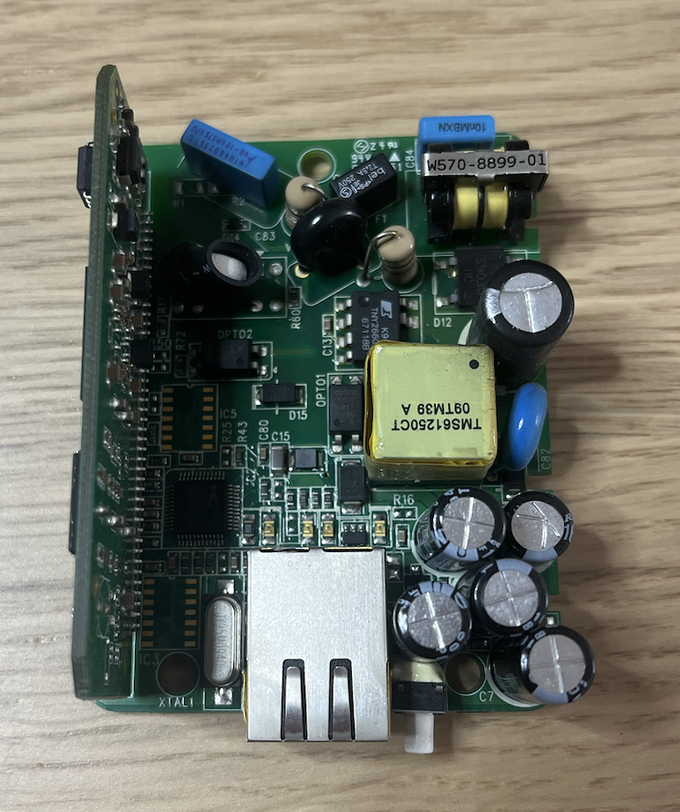

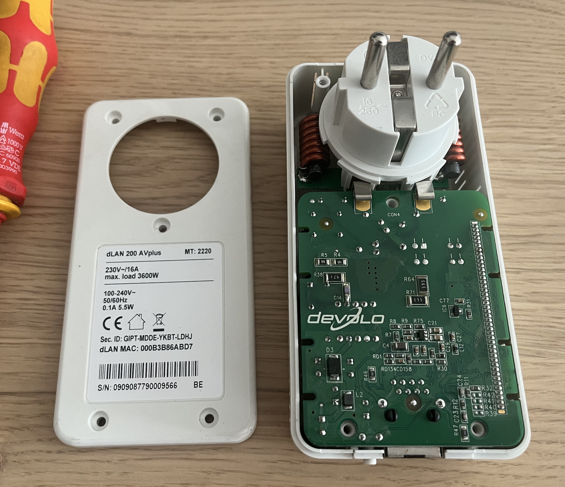

Hi, I received my Devolo dLAN 200 AVplus meanwhile. Turns out it looks very different from inside or am I missing something. Just FYI. I guess I'll continue with the TP-Link TL-PA4010 then.

Oh, there seem to be quite different versions, this is from 2009 (date code points to week 41 in 2009). My part (pictures here: https://github.com/uhi22/pyPLC/blob/mas ... 200-avplus) is from 2010, it is a "single board" design without the "daughter board".

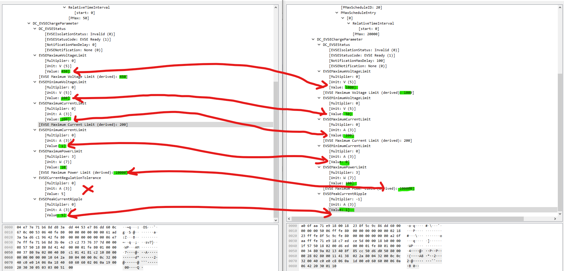

Well, I am stumped.
I 3D printed a plug shell to give the Kona something to lock on to, and that seems to be working well.
It will close the battery contactors and the plug pins are live, however it will only stay live for a second before it fails.
It sends a single current request and then falls over.
[72480ms] [EVSE] from 4 entering 4
[SNIFFER] EXI from 15118 to 51163 (22bytes) = 80 9A 02 00 40 80 C1 01 41 81 C2 11 60 00 40 80 00 01 93 90 08 00
[72981ms] [EVSE] In state WaitForFlexibleRequest, received (28bytes) = 01 FE 80 01 00 00 00 14 80 9A 02 00 40 80 C1 01 41 81 C2 11 32 22 00 00 08 80 00 00
[72984ms] [EVSE] {

one update - I was able to collect traces from a real 350kW charger and have updated the OpenV2Gx code to reflect the params from there. The charger is giving much higher voltage and other params in the ChargeParameterDiscoveryRes - as below:
Hence I've updated the code to reflect these values and will try the discharging experiment once again with these updated higher voltage values (1000V v/s 450V), etc.

Based on the changes in my prior message comparison, I was able to close contactors on the Kia EV6 and discharge at close to 800V. Since the charger emulated up to a 1000V the EV allowed direct access to the 800V battery without going thru the DC-DC/boost convertor.
Here's an image showing the same.
Only issue I'm having with are Teslas that have NACS connector and support CCS1 using the NACS <-> CCS1 convertor. Once the charger is connected these Tesla Model Y (and in the past Model S) - via this NACS-CCS1 connector don't see any L2 GreenPHY or above v2G messaging on the wire...
