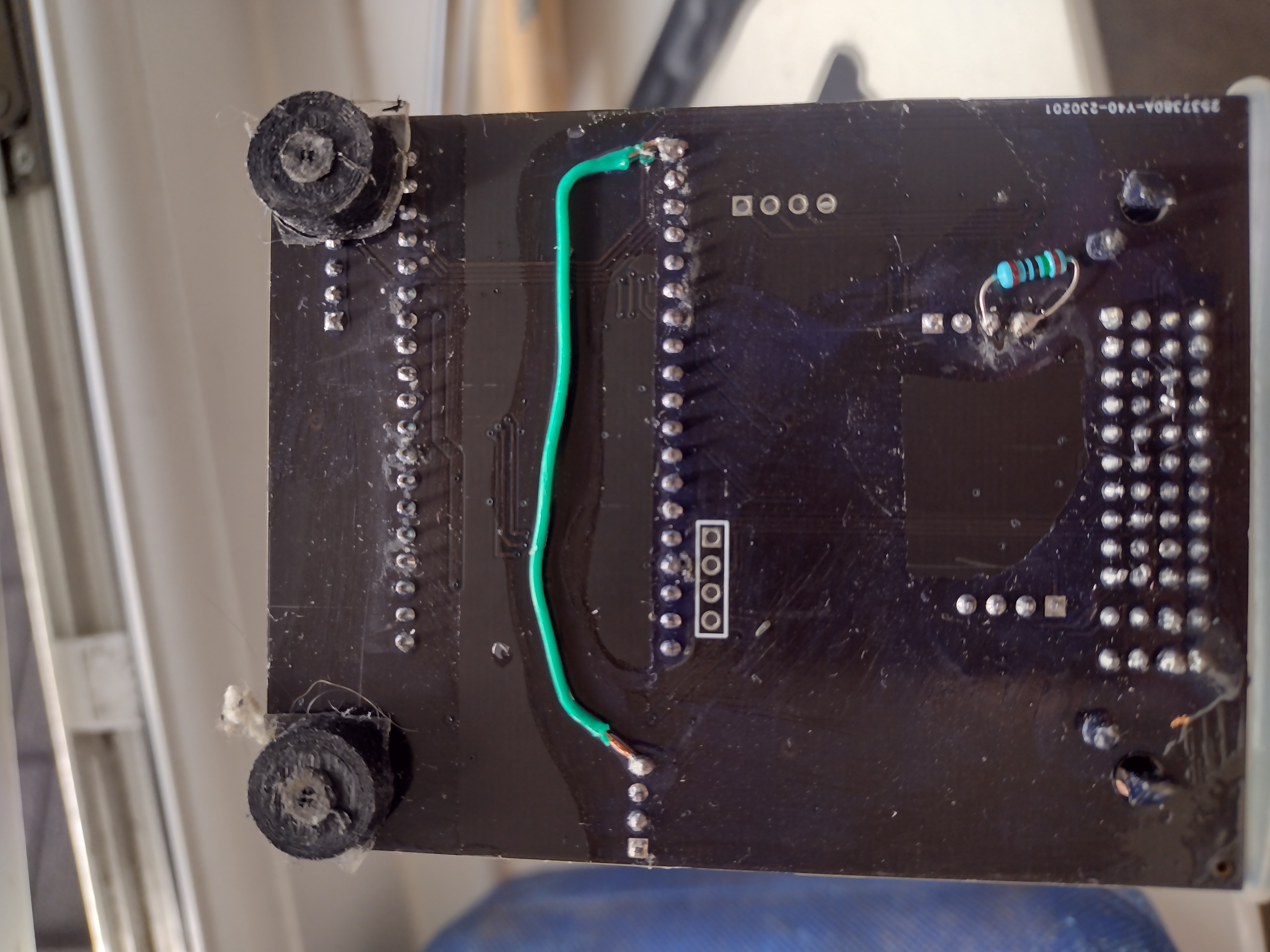

I did have to put a jumper in.
It doesn't have any analogue inputs, but you could add. You could also change the code to not require any current/voltage monitoring and trust the values the charger is saying, if you so wished.You do not have the required permissions to view the files attached to this post.
Re: ESP32 Based Chademo
Oh what is the resistor for?
Edit I just saw its on the CAN so its likely a 120 ohm resistor right?
Thanks.
-Arlin
- Posts: 1787
- Has thanked: 83 times
- Been thanked: 431 times
It is a can terminator on the second can

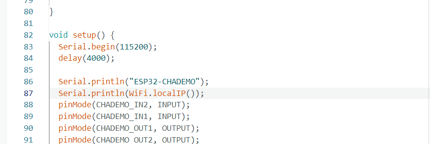

Ok back to this. I think I found the problem. Is default IP for ESP32 should be 192.168.4.1 But mine is not defining the default serial.
I added this in the INO file. And got this in the serial printout on the Arduino screen.
Anyone know how to add a set IP address?

And changing it to this. I got this.Arlin wrote: ↑Sat Sep 14, 2024 8:40 pm Ok back to this. I think I found the problem. Is default IP for ESP32 should be 192.168.4.1 But mine is not defining the default serial.
Wifi starts further down. so only have it print the IP towards the end of the setup() section.
Tried it this way as well. Still 0.0.0.0
Also do I need to change WiFi.begin("Beetle_CHademo", "Fia84grapu"), to something else?
In order for this to work do I simply log into the wifi that the board is displaying in the serial output?
I am getting stuck on this part. But I have been off of it for a while. I am just getting back to this now.
Oh how to get the Web page to load from my PC so I can set the settings etc.
Assuming you have the the same version as on github, connect your wifi to ESP32-CHADEMO, password ChadMeO.
Then access the web page at 192.168.4.1 which is the default IP address for the ESP32 web server.
