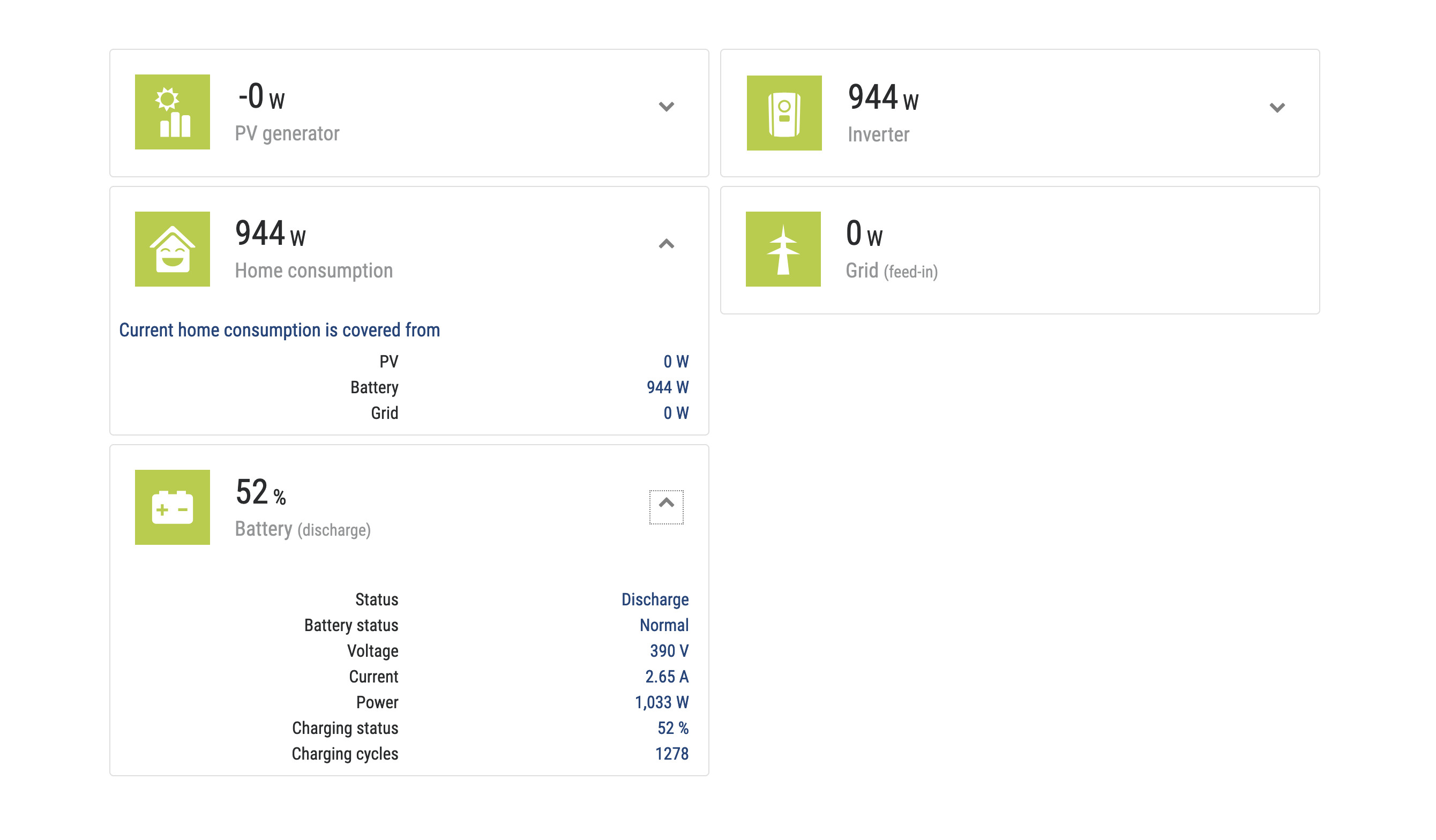

Summary: Tesla Model 3 2019 (EU) as "solar string" on Kostal Plenticore Plus (together with the amazon precharge converter) happily delivered 5kW for ~15 minutes.

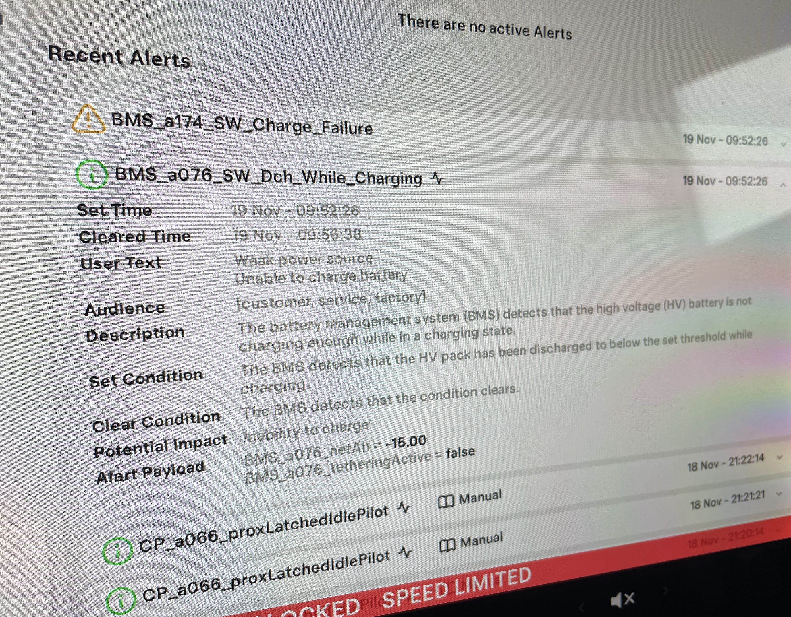

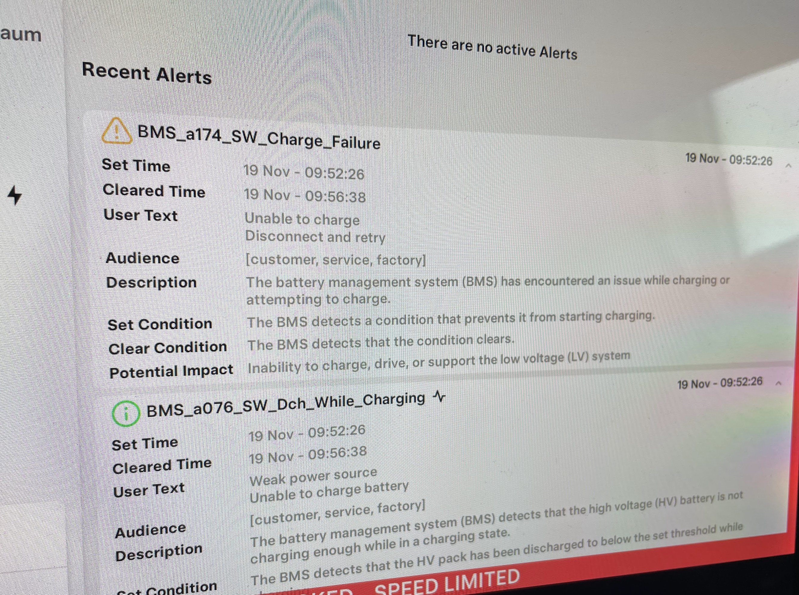

Let's make that ~70 minutes :)
The car sent a PowerDeliveryReq with "ReadyToChargeState": "0", and then a SessionStopReq, last lines of the log is attached.
Also the alerts in the service menu are very interesting. Seems to be the threshold is 15Ah of discharge.
Edit: Including BMS_a076 / BMS_a076_SW_Dch_While_Charging and BMS_a174 / BMS_a174_SW_Charge_Failure as text here, so it's searchable.
2024-11-190_car_aborts_after_15Ah_discharge.log

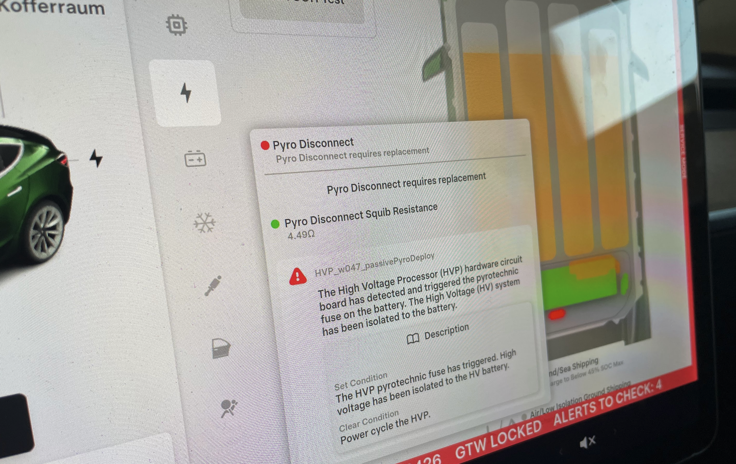

Some setback on my side. For context, my current setup looks like this: (1) RaspberryPi with pyPLC running (hooked up via WiFi to the local network), (2) an ESP32 running the battery emulator code for communication with the inverter via RS485 and also controls some additional contactors (also hooked up via WiFi) and then (3) the inverter itself hooked up via Ethernet to the local network.
There must be some care taken when it comes to stopping the charge session: No power should go over the wire. The base case is when the car user presses "stop charging" on the car UI, the car first will send a PowerDeliveryReq with ReadyToChargeState set to false, and then a SessionStopReq. For both messages it is fine to wait around for one second with an actual reply; In the meanwhile there is enough time to send modbus commands to the inverter to reduce the power to 0, and as a failsafe, on the SessionStopReq I'll also open the contactors attached to the battery emulator, the idea being I'd rather have those welded than the contactors in the car.
That works reasonably well... except for two issues:
  1. For some reason the PLC connection starts getting hung up somehow a couple times already; the symptom being that the raspberry starts sending TCP retransmissions, which take too long and therefore the car will abort the session (reported on github), but on the pyPLC side no SessionStopReq is received.
  2. If you read my description of my setup carefully, you will notice that I’m kind of insane and do safety critical communication over a wireless network. Well, that can be congested sometimes and requests can take a while.
So if those two occur at the same time you get this apparently (the inverter was drawing with around 4000W at this point):
That is the HV system wouldn’t come up anymore. Shout out to my wife for being super chill about me bricking our daily driver.
The behaviour at least is good news, I think: Before opening the contactors and risk welding, it will rather blow up the fuse (much cheaper to replace). At least that's my understanding, I don't have hard proof for it. I didn't capture all the messages in the service menu, and most of them were gone after a reboot, but I guess somewhere in there it would give a reason.
That happened last Thursday, and on Monday I had new pyrofuses in my hands. Initially I ordered two to have one as a backup, but since those weren’t OEM fuses and I read some scary stories about replicates in the meanwhile, I decided to blow one up before putting it into the car :-) Luckily it did its job. Replacing the pyrofuse in the car is like a 2h job. I guess it could be done in about an hour if you are more experienced (let’s hope I cannot confirm this soon-ish :lol: ). HV system comes up again, everything seems fine :)
Anyway, further experiments are on hold on my side until I’ve a backup pyrofuse (hopefully before Christmas, actually picking up one from the local Tesla service center on the 23rd if everything goes as planned). In the meanwhile I’ll squash the battery emulator logic for talking to the inverter somehow onto the Raspberry Pi (probably within pyPLC, it’s really just a serial protocol over RS485 and controlling a few GPIOs for the contactors) to get rid of the wireless communication. Initially I wanted to stick with the battery emulator in the picture, because it supports a couple of inverters already, but oh well. Maybe I'll also run another cable to the inverter to not use ModBus over TCP but rather over RS485.
Additionally I want to be able to detect those TCP reconnections reliably. Not quite sure yet how to do that, but since the sniffer messages are popping up multiple times in the syslog there should be some way to detect it. And then I'd like to improve the situation to not even have those TCP reconnections anymore, but not really sure what I can improve on that front.
Let's hope blowing up a pyrofuse is the worst that can happen to the car with those kind of experiments :)

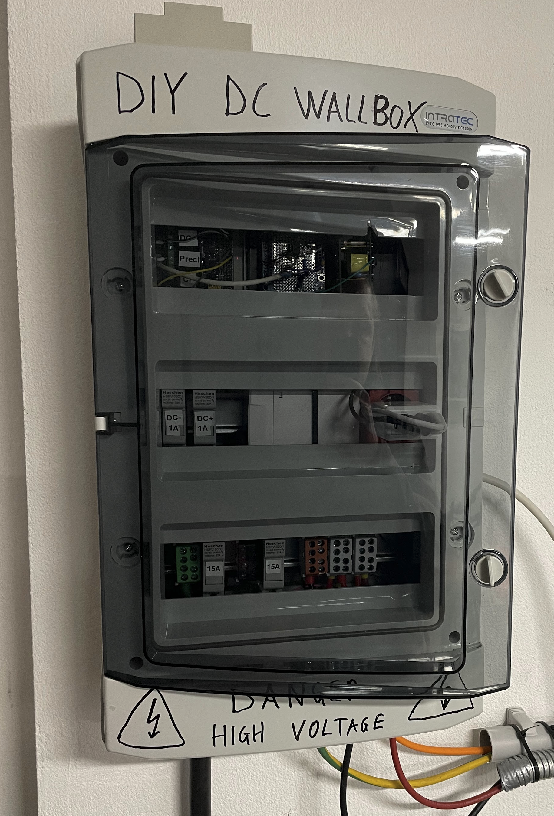

lewurm
Posts: 30
Joined: Mon Jul 17, 2023 1:41 am
Has thanked: 41 times
Been thanked: 21 times
Re: Drawing power out of CCS port (V2x, inverse charging, bidirectional CCS)
Post by lewurm »
uhi22 wrote: Mon Jan 20, 2025 7:11 am Looks like the Teslas 15Ah limit can be worked-around by pretending a charge current while actually discharging: viewtopic.php?p=78883#p78883
Alas nope, there was a follow-up: https://teslamotorsclub.com/tmc/threads ... st-8579714
What's interesting: with that device the battery heater turns on, which is boring quickly in cold weather (it's like ~7kW and trying to heat up to 50°C). Interestingly with pyPLC I haven't seen that ever. Ingineerx (the author for that teardown) was so kind to send me a trace of the PLC communication. It's on my list to check if any differences in the messages pyPLC sends avoids the heating, or if it's due to the Tesla BMS firmware (he is using an older firmware version on his car).
vbarrier wrote: Sun Jan 19, 2025 9:20 pm Did you be able to continue your testing after Christmas? :)

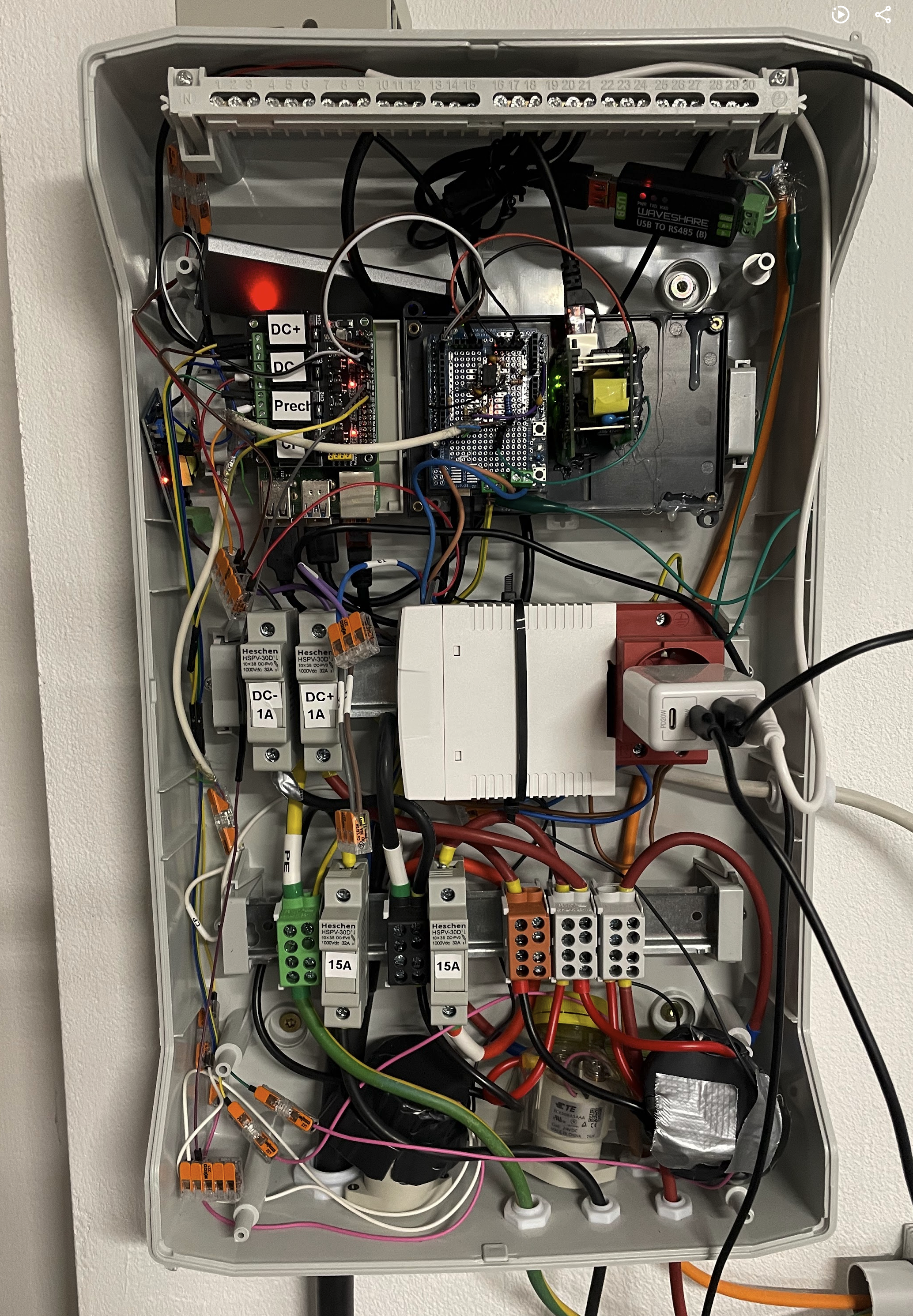

Yes! I'm planning to do a more structured write-up somewhen next month, but for now a braindump for curious folks must do it; basically all the information is out there, I just built something on top of giants (pyPLC and battery emulator) and put them together :)
NO FURTHER PYROFUSE HAS BEEN HARMED IN THE FOLLOWING ACTIVITIES (first good news :D )
The first thing I tackled is the timeout issue. There are two ways to detect it: (1) Whenever the communication is in state CurrentDemand the expectation is that the next message will arrive within 110ms, if not, a stopDCSoft is triggered, and if it happens again a stopDCHard is triggered: https://github.com/lewurm/pyPLC/blob/cd ... #L473-L480 The difference is that stopDCSoft tells the inverter via ModBus to reduce the power to zero, while stopDCHard will open the contactors of the wallbox (ignoring any potential load and thus risk welding).
The (2) way is to hook into the sniffer https://github.com/lewurm/pyPLC/blob/cd ... #L317-L320 which will also trigger a stopDCSoft. This is however slower in terms of reaction time, it's somewhere around 300ms. I assume you could tune that value somewhere in the TCP settings of the kernel, but I guess the first variant is already good enough.
And then I replaced the jumper cables that I used within the wallbox for CP with some 2 pair telephone cable that has shielding, and suddenly the timeout situation was much much better. It's still happening, and from the few observations I have it seems to only happen when there is a lot of sun; I assume the DC cables between wallbox<>inverter are carrying some noisy stuff when the inverter is more at work? I ordered some ferrite rings to put on the DC cables (please tell me if this a bad idea, I have no idea what I'm doing regarding EMI).
I also gave up on using the Battery Emulator, and instead ported the inverter communication to Python and use it directly within the pyPLC loop. This makes the coordination much easier, it's basically another variant in hardwareInterface.py. It's also equipped with some additional tweaks that are easily possible in a Linux environment, e.g. I'm using the pykoplenti command that uses the REST API of the inverter to turn on/off its battery support. Probably possible on an ESP32 too (which Battery Emulator runs on), but much more cumbersome. And then there is some interaction with my local Home Assistant instance for high level control, logging state transitions and bookkeeping. By the way, I had some "performance issues" because that involves network stuff, which can have delays... and that's not good to do on the same thread as the car communication (which is pretty sensitive to timeouts, roughly one second). So there is another thread that polls/push certain stuff, to unblock the main thread. Seems good enough, but a bit hacky due to the GIL in cpython.
Regarding the step-up converter, I followed the mod described here: https://github.com/dalathegreat/Battery ... age-source
And have a little calibration script to figure out good frequencies for the PWM: https://github.com/lewurm/pyPLC/blob/di ... ter_mod.py
It depends on your input voltage, but then didn't require much tuning, it rarely needs more than one attempt before the car is happy: https://github.com/lewurm/pyPLC/blob/cd ... #L303-L339
It's pretty solid!
That's how it looks like currently.

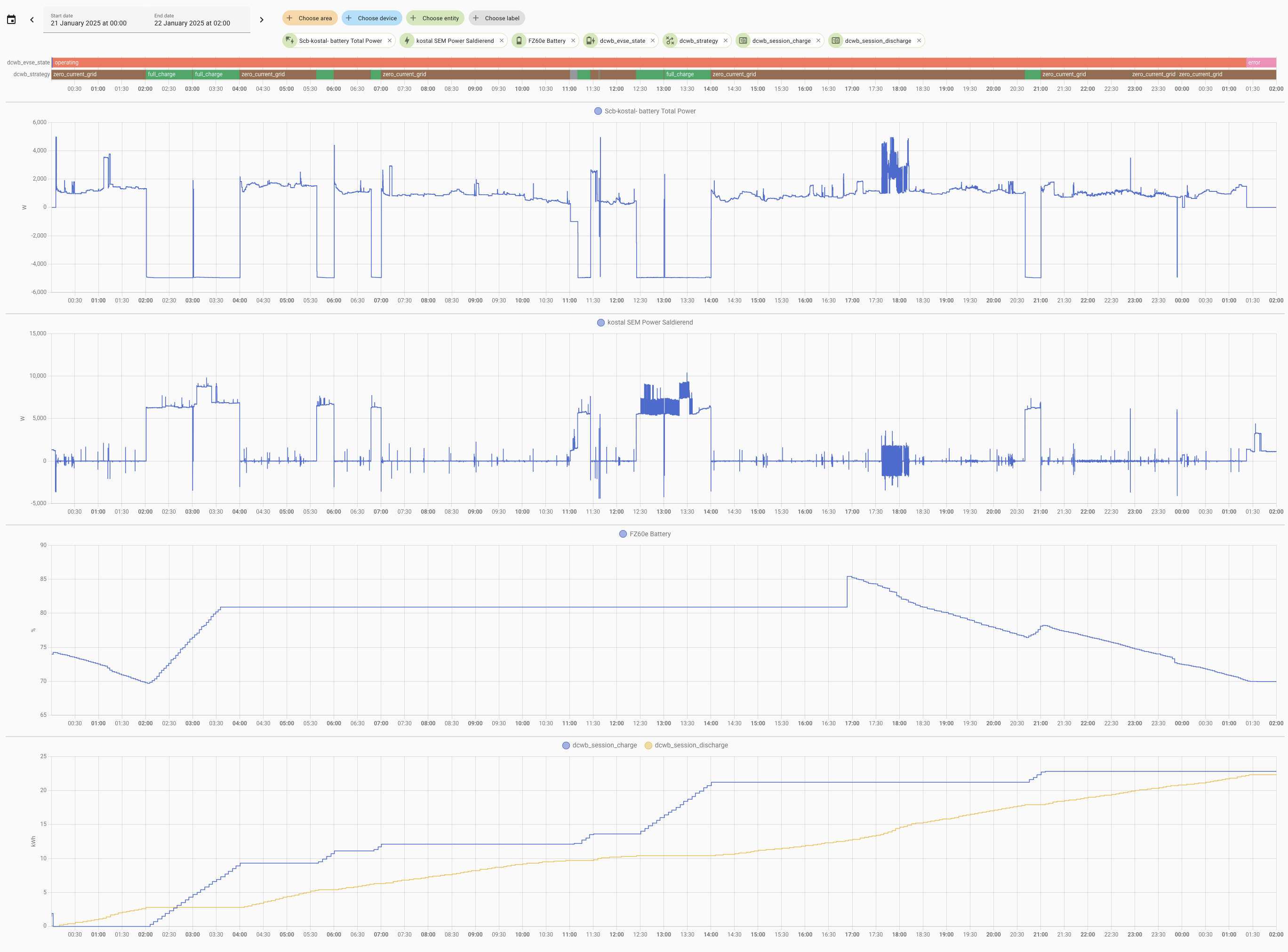

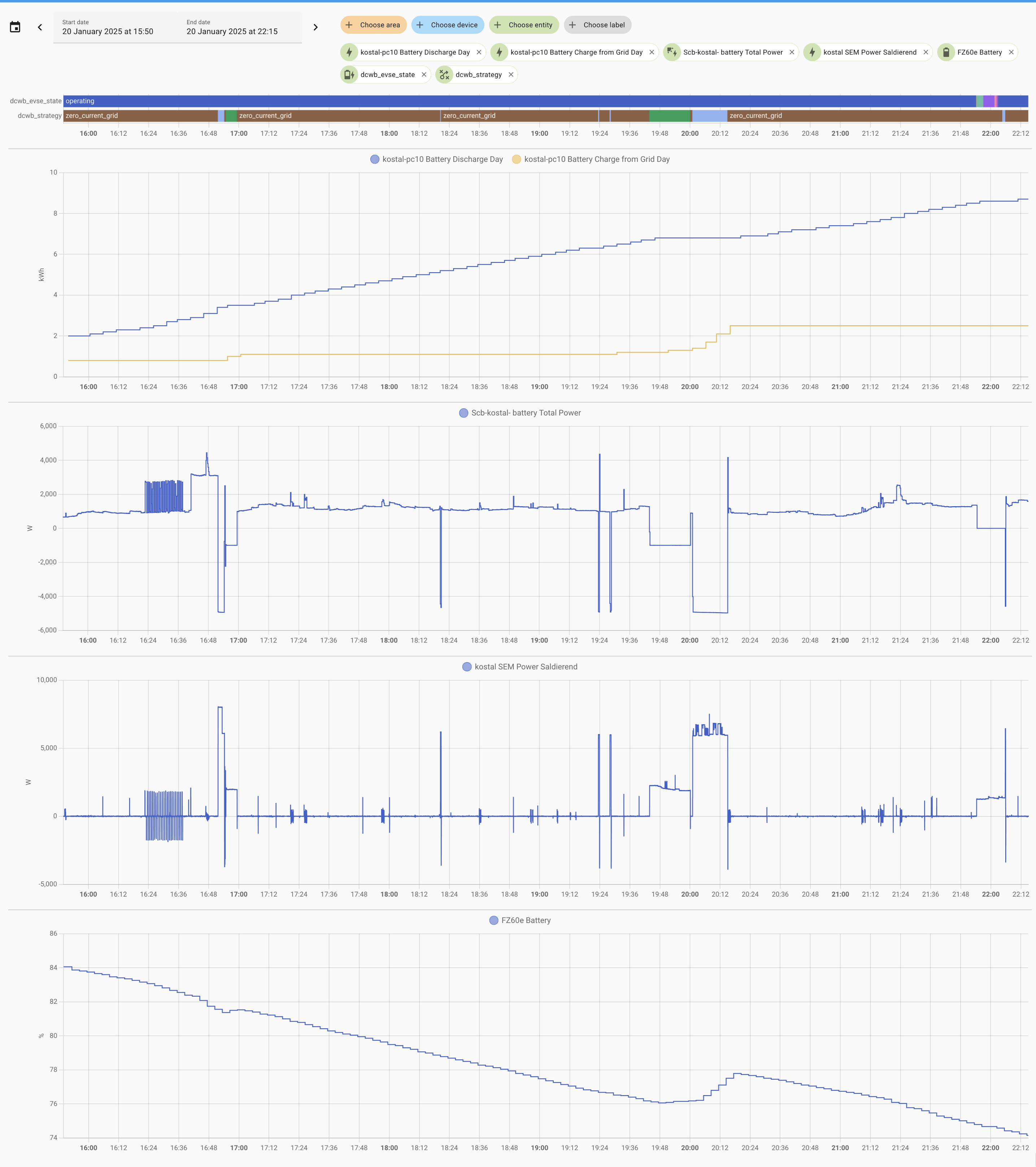

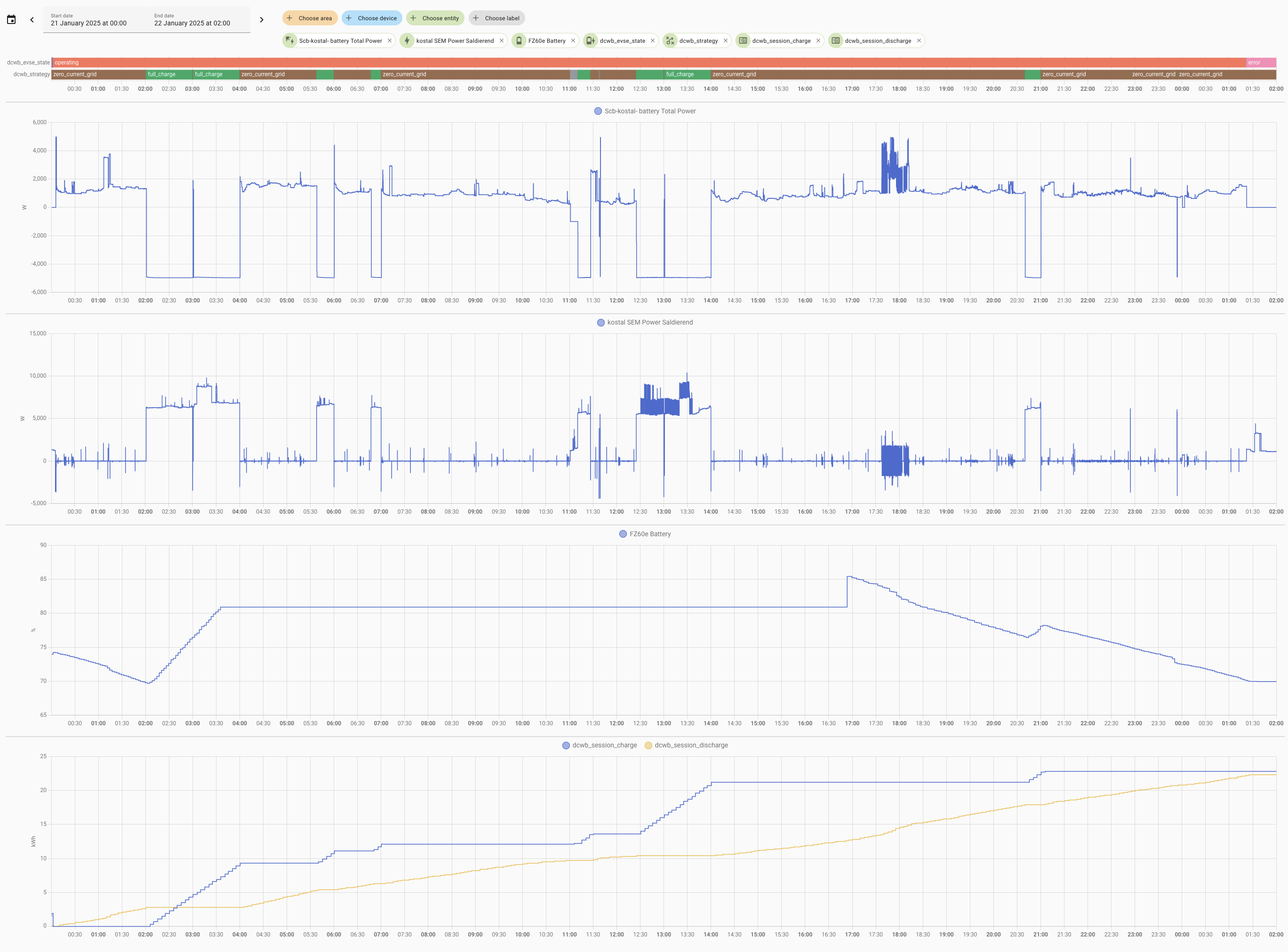

So I did my first longer session last Sunday:
kostal SEM Power Saldierend is the sum of the three phases going to/from grid according to the Kostal smartmeter (an additional device). Scb-kostal-battery Total Power is the power to/from the battery according to the inverter. dcwb_strategy is the input to a script that controls via modbus regarding how much power should go to/from the battery (it runs as part of Home Assistant via PyScript https://gist.githubusercontent.com/lewu ... 3e/dcwb.py yes yes, I'm a Home Assistant fanboi :mrgreen: ).
So it's discharging for a while, and then doing a little "charge pump" to hopefully reset the BMS state and thus bumps the 15Ah threshold. And it seems to work, because I sucked out more than 15Ah in this session. It was pretty cold in the garage already and I was tired, so I stopped the session. I thought that was already pretty cool, but there seems more to this 15Ah limit...

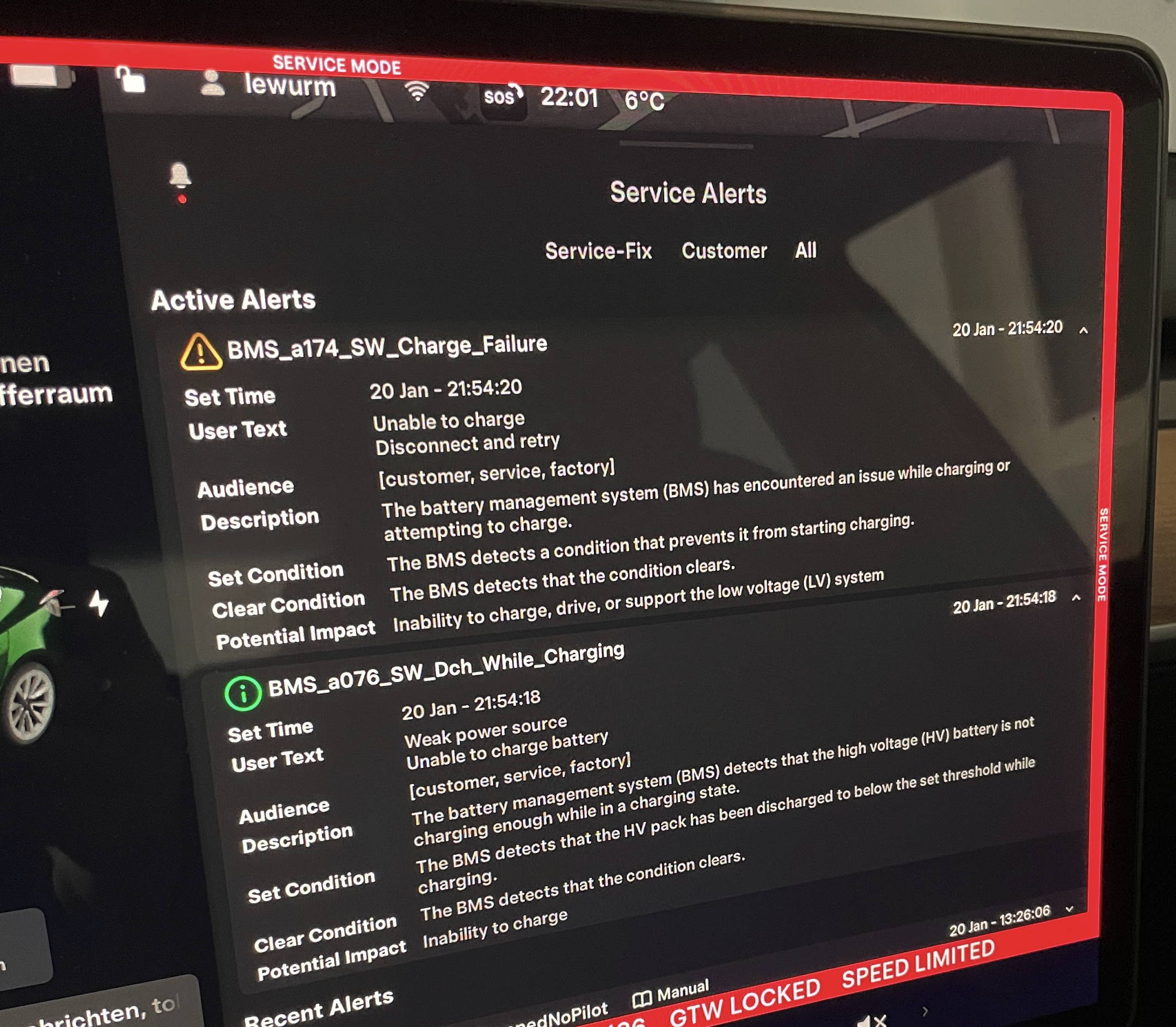

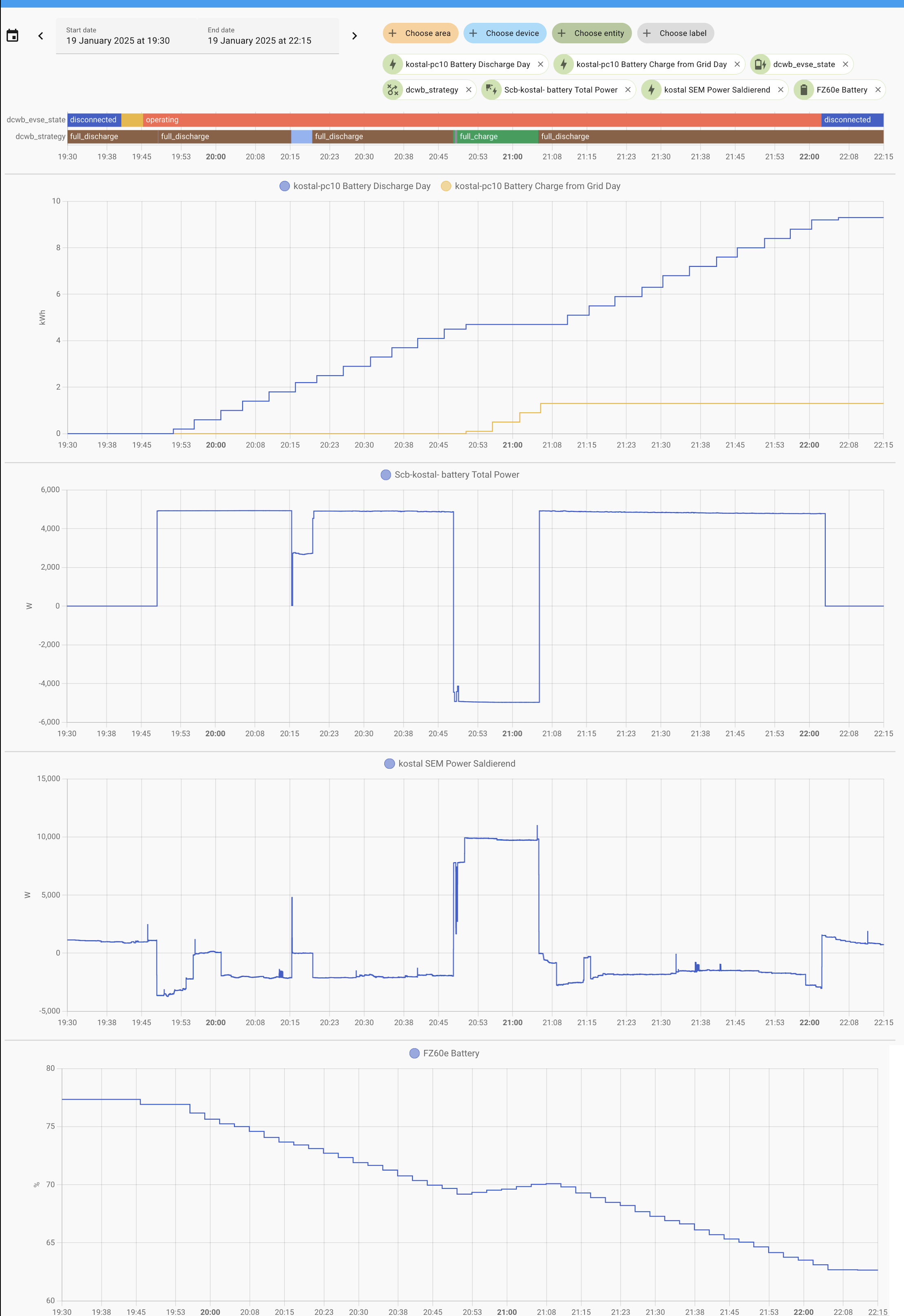

On Monday (electricity spot prices were high), I felt confident enough to leave it unattended (well I put a security cam inside the garage :D it's actually pretty useful for verifying the shutdown sequence on timeouts, the sound of the different contactors are distinctive :) ):
Here the car aborted with the infamous BMS_a076_SW_Dch_While_Charging, but interestingly enough without payload (it doesn't mention -15Ah):
Still great, that was a 6h session and I was already very happy with that.
For easy restarting a charging session I put CP behind a relay. So flipping that one for a few seconds works in some scenarios to restart the charging session, for example if the EVSE initiates stopping the charging session. Interestingly enough on TCP retransmission timeouts the session can also be restarted this way. However, on this BMS_a076_SW_Dch_While_Charging event the charge port LED pops up red. I can initiate another session, but it even refuses to precharge. It requires physical unplugging.
So I started another session, but exactly at midnight something happened: The inverter restarted. Apparently that's a thing, haha. I just didn't handle that case well, but I added some code to consider that and started another session a few minutes after midnight... and amazingly, the very same session tested next midnight, that is, it was running more than 24h :D :D :D
I want you to appreciate pyPLC for a second, it's amazing how well it works. Thank you uhi22!!!
What do we see here? So this FZ60e Battery value comes from TeslaFi which in turn polls the Tesla API... at some point the battery level got stuck, but it didn't on the Tesla App. I submitted a bug report and it was actually fixed pretty quickly then (or it was just a coincidence? I didn't get a response yet). Anyway, I thought that was funny ;)
From the charts you can probably guess the more expensive hours. Also towards the evening the oven was on and the control loop to adjust power oscillated, but fortunately the car nor the inverter seemed to mind. In the 26th hour the car stopped the session with our dear friend BMS_a076_SW_Dch_While_Charging, this time showing the payload message again (see previous post) mentioning the 15Ah threshold. At this point I already added a session counter for charge/discharge amount, so you can see that those are almost equal. However, and here comes one of the drawbacks using a car as battery: There is some idle power used by the car if it's "online" (for example when it's charging). From what I've gathered from the CAN bus, it's around 200W. And that seems to match quite well: According to my session counters there was 500Wh more charged into the car than discharged. And then 200W for 25h => 200*25 + 500 = 5500Wh. Divided by 390V that's 14,1Ah. That seems to be the right ballpark. However, it's sort of surprising, given the "charge pumps", that have helped in the first chart in this post.
And an observation from today: I stopped the charging session after ~4.5kWh discharging and did the CP flipping, but unfortunately the next session aborted after ~1kWh of discharging with BMS_a076_SW_Dch_While_Charging. Only physically replugging helped then. A bit of a bummer; alas I can't "disconnect" PP (= putting a relay inbetween) on my plug, but not sure if that would even help.
More experiments are needed ;) And maybe it's also time to have a closer look at the BMS firmware in a disassembler...
Anyway, I'm really really happy with the results so far. Thanks again to uhi22 and other pyPLC contributors for making all the work and information publicly available, and also shoutout to the folks over at the Battery Emulator Discord. It has been really fun so far and I learned a lot!
TODOs on my side:
  • figure out EMI issue whenever there is too much PV energy
  • figure out why inverter won't start battery usage when there is already PV energy there. My hope is that is related somehow with the previous point, but with the RS485 connection between inverter<>wallbox. There might be as well parts of the protocol that I'm missing in that situation. The current implementation is based on reverse engineering, so... if someone has good connections to Kostal, I would be very interesting in their custom protocol ;)
  • do a structured write-up so others can reproduce the setup more easily
  • more experiments and automation fine tuning to work around the 15Ah limit
