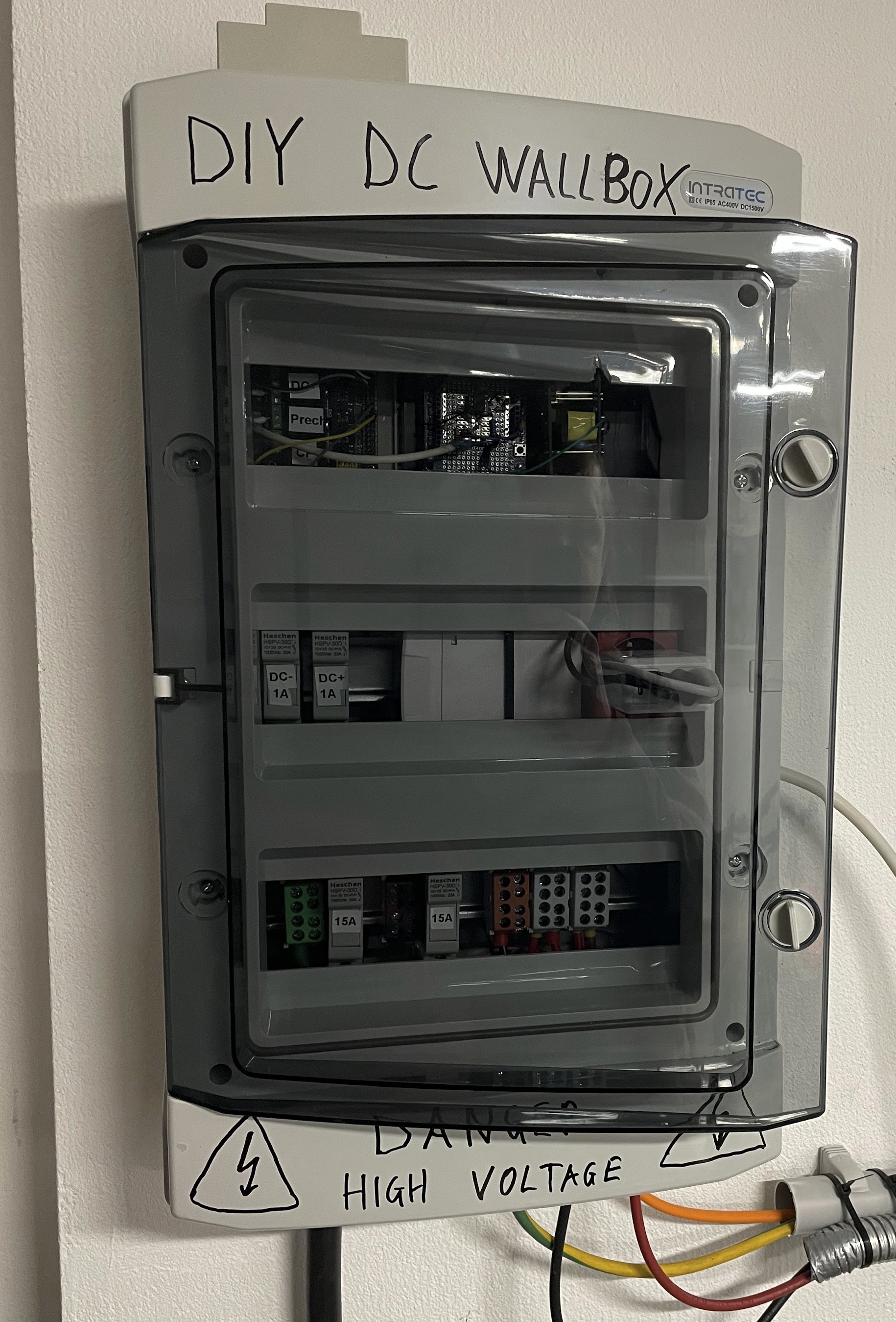

Yes! I'm planning to do a more structured write-up somewhen next month, but for now a braindump for curious folks must do it; basically all the information is out there, I just built something on top of giants (pyPLC and battery emulator) and put them together
NO FURTHER PYROFUSE HAS BEEN HARMED IN THE FOLLOWING ACTIVITIES (first good news
The first thing I tackled is the timeout issue. There are two ways to detect it: (1) Whenever the communication is in state CurrentDemand the expectation is that the next message will arrive within 110ms, if not, a stopDCSoft is triggered, and if it happens again a stopDCHard is triggered: https://github.com/lewurm/pyPLC/blob/cd ... #L473-L480 The difference is that stopDCSoft tells the inverter via ModBus to reduce the power to zero, while stopDCHard will open the contactors of the wallbox (ignoring any potential load and thus risk welding).
The (2) way is to hook into the sniffer https://github.com/lewurm/pyPLC/blob/cd ... #L317-L320 which will also trigger a stopDCSoft. This is however slower in terms of reaction time, it's somewhere around 300ms. I assume you could tune that value somewhere in the TCP settings of the kernel, but I guess the first variant is already good enough.
And then I replaced the jumper cables that I used within the wallbox for CP with some 2 pair telephone cable that has shielding, and suddenly the timeout situation was much much better. It's still happening, and from the few observations I have it seems to only happen when there is a lot of sun; I assume the DC cables between wallbox<>inverter are carrying some noisy stuff when the inverter is more at work? I ordered some ferrite rings to put on the DC cables (please tell me if this a bad idea, I have no idea what I'm doing regarding EMI).
I also gave up on using the Battery Emulator, and instead ported the inverter communication to Python and use it directly within the pyPLC loop. This makes the coordination much easier, it's basically another variant in hardwareInterface.py. It's also equipped with some additional tweaks that are easily possible in a Linux environment, e.g. I'm using the pykoplenti command that uses the REST API of the inverter to turn on/off its battery support. Probably possible on an ESP32 too (which Battery Emulator runs on), but much more cumbersome. And then there is some interaction with my local Home Assistant instance for high level control, logging state transitions and bookkeeping. By the way, I had some "performance issues" because that involves network stuff, which can have delays... and that's not good to do on the same thread as the car communication (which is pretty sensitive to timeouts, roughly one second). So there is another thread that polls/push certain stuff, to unblock the main thread. Seems good enough, but a bit hacky due to the GIL in cpython.
Regarding the step-up converter, I followed the mod described here: https://github.com/dalathegreat/Battery ... age-source
And have a little calibration script to figure out good frequencies for the PWM: https://github.com/lewurm/pyPLC/blob/di ... ter_mod.py
It depends on your input voltage, but then didn't require much tuning, it rarely needs more than one attempt before the car is happy: https://github.com/lewurm/pyPLC/blob/cd ... #L303-L339
It's pretty solid!
That's how it looks like currently. Still janky... looks better if you hide it
So it's discharging for a while, and then doing a little "charge pump" to hopefully reset the BMS state and thus bumps the 15Ah threshold. And it seems to work, because I sucked out more than 15Ah in this session. It was pretty cold in the garage already and I was tired, so I stopped the session. I thought that was already pretty cool, but there seems more to this 15Ah limit...
On Monday (electricity spot prices were high), I felt confident enough to leave it unattended (well I put a security cam inside the garage
For easy restarting a charging session I put CP behind a relay. So flipping that one for a few seconds works in some scenarios to restart the charging session, for example if the EVSE initiates stopping the charging session. Interestingly enough on TCP retransmission timeouts the session can also be restarted this way. However, on this BMS_a076_SW_Dch_While_Charging event the charge port LED pops up red. I can initiate another session, but it even refuses to precharge. It requires physical unplugging.
So I started another session, but exactly at midnight something happened: The inverter restarted. Apparently that's a thing, haha. I just didn't handle that case well, but I added some code to consider that and started another session a few minutes after midnight... and amazingly, the very same session tested next midnight, that is, it was running more than 24h
What do we see here? So this FZ60e Battery value comes from TeslaFi which in turn polls the Tesla API... at some point the battery level got stuck, but it didn't on the Tesla App. I submitted a bug report and it was actually fixed pretty quickly then (or it was just a coincidence? I didn't get a response yet). Anyway, I thought that was funny
From the charts you can probably guess the more expensive hours. Also towards the evening the oven was on and the control loop to adjust power oscillated, but fortunately the car nor the inverter seemed to mind. In the 26th hour the car stopped the session with our dear friend BMS_a076_SW_Dch_While_Charging, this time showing the payload message again (see previous post) mentioning the 15Ah threshold. At this point I already added a session counter for charge/discharge amount, so you can see that those are almost equal. However, and here comes one of the drawbacks using a car as battery: There is some idle power used by the car if it's "online" (for example when it's charging). From what I've gathered from the CAN bus, it's around 200W. And that seems to match quite well: According to my session counters there was 500Wh more charged into the car than discharged. And then 200W for 25h => 200*25 + 500 = 5500Wh. Divided by 390V that's 14,1Ah. That seems to be the right ballpark. However, it's sort of surprising, given the "charge pumps", that have helped in the first chart in this post.
And an observation from today: I stopped the charging session after ~4.5kWh discharging and did the CP flipping, but unfortunately the next session aborted after ~1kWh of discharging with BMS_a076_SW_Dch_While_Charging. Only physically replugging helped then. A bit of a bummer; alas I can't "disconnect" PP (= putting a relay inbetween) on my plug, but not sure if that would even help.
More experiments are needed
Anyway, I'm really really happy with the results so far. Thanks again to uhi22 and other pyPLC contributors for making all the work and information publicly available, and also shoutout to the folks over at the Battery Emulator Discord. It has been really fun so far and I learned a lot!
TODOs on my side:
- figure out EMI issue whenever there is too much PV energy
- figure out why inverter won't start battery usage when there is already PV energy there. My hope is that is related somehow with the previous point, but with the RS485 connection between inverter<>wallbox. There might be as well parts of the protocol that I'm missing in that situation. The current implementation is based on reverse engineering, so... if someone has good connections to Kostal, I would be very interesting in their custom protocol
- clean-up code more, I pushed my current state here: https://github.com/lewurm/pyPLC/commit/ ... 9f2bd52992
- do a structured write-up so others can reproduce the setup more easily
- more experiments and automation fine tuning to work around the 15Ah limit

Re: Drawing power out of CCS port (V2x, inverse charging, bidirectional CCS)
So from the logs of this V2L device that was discussed, it appears that it sends EVSEMaximumPowerLimit with 480kW. In the OpenV2G fork that is used for pyPLC, this value is hard coded to 10kW. For testing, I bumped it up to 250kW (that's the maximum power I have witnessed at a fast charger) and then indeed the car will start heating the battery pack.
CAN screenshot from the car. This is without any charge or discharge coming from the inverter.
So 10kW seems like a sane choice in pyPLC/OpenV2G
Otherwise I'm doing quite some testing, already cycled the pack almost 3x times
However the PLC communication is behaving weird and driving me nuts. On some days it works flawlessly (see the previous post where I mentioned a session lasting longer than 24h), and then other days it's timing out roughly once per hour. I tried a few things:
- put on ferrit cores on PE, and the DC+/- lines. Except that it adds interesting audio feedback to the setup (you can almost tell the charge rate by the sound) it didn't help.
- Since the ethernet port on the Raspberry is used for PLC, I use WiFi to communicate with the home network. I saw that the Raspberry sometimes connects with 2.4GHz and sometimes with 5GHz, and was kind of excited that this would be it. But after some testing, I can say: Nope, unrelated...
- ... because then I tried to disable WiFi and use an USB ethernet dongle (which was a good idea regardless), but that didn't change anything too.
- For good measurment I also turned off the bluetooth kernel module
- Rerouted the CP line a bit so that it isn't close to things like the 24V DC power supply
- Made sure that the shielding of the CP line is connected with PE
- Started to track the built-in temperature sensor of the Raspberry, but no correlection either (and also, the garage is not heated...)
Does anyone know how to check the "connection health" of the PLC device? I found this:
$ /home/lewurm/private/open-plc-utils/plc/plcstat -t -i eth0 -d 2 -m -e
P/L NET TEI ------ MAC ------ ------ BDA ------ TX RX CHIPSET FIRMWARE
LOC CCO 001 EC:08:6B:8B:DC:D6 DC:A6:32:21:1A:7E n/a n/a QCA7420 MAC-QCA7420-1.1.0.844-01-20120919-FINAL
REM STA 002 DC:44:27:10:16:16 DC:44:27:10:16:15 009 009 QCA7005 MAC-QCA7005-1.2.5.3207-00-20180927-CS
NID 01:02:0D:1E:56:64:07 SNID 001
CCO TEI 001 MAC EC:08:6B:8B:DC:D6 BDA DC:A6:32:21:1A:7E
STA TEI 002 MAC DC:44:27:10:16:16 BDA DC:44:27:10:16:15 TX 009 RX 009
DIR ----------- PBs PASS ----------- PBs FAIL PBs ERR ---------- MPDU ACKD ---------- MPDU FAIL
TX 6 0 0.00% 6 0 0 0.00%
RX 0 0 0.00% 0 0 0.00%
PHY ----------- PBs PASS ----------- PBs FAIL PBs ERR ----------- BER PASS ----------- BER FAIL BER ERR
0 0 0 0 0.00% 0 0 0.00%
1 0 0 0 0.00% 0 0 0.00%
2 0 0 0 0.00% 0 0 0.00%
3 0 0 0 0.00% 0 0 0.00%
4 0 0 0 0.00% 0 0 0.00%
5 0 0 0 0.00% 0 0 0.00%
ALL 0 0 0.00% 0 0 0.00% 0.00%When looking for other options, I stumbled over this: https://www.tindie.com/products/evsec/hat-raspi-evse/ I tried to contact the seller, but alas no response yet. Would kinda seem like a perfect fit for a hardware noob like me... also lower the entry barrier to reproduce a setup like this.
I already see myself ending up hacking on foccci to get something more stable. But before getting into that rabbit hole I'll try to replace the TPlink TL-PA4010P v2.3 that I'm currently using with a v5.0 and hope that the higher version number implies higher reliability
PS: I'm curious how well this setup works with other cars. If anyone has a non-Tesla EV, is somewhat close to Linz in Austria and is willing to risk bricking their car in my garage: let me know!
I use a standard 5-pole 2.5mm² cable, so no shielding at all. Works flawlessly for entire days

Sorry for the confusion: The CP cable from the CCS2 port to the box is indeed not shielded, but for "routing" CP inside the box I'm using a shielded cable (just a 4 wire telecommunication cable that I had around). This is me just being desparate; the way I understand PLC is that it's exactly built for noisy scenarios, so this shouldn't be needed.
I did that a few days after I've posted that and with v5.0 I did not get a single timeout since. I'm also using the DC Wallbox exclusively since then.
The only limitation left is really the 15Ah discharge limit. The limit is okay on days like today were almost 30kWh have been charged into the car, so I have around ~35kWh to get through the night
Luckily there are two pairs for PT1000s on DC+ and DC-, which could be used for PP instead, so no extra cable must be run to the wallbox. Found a video where a CCS plug is disassembled:
