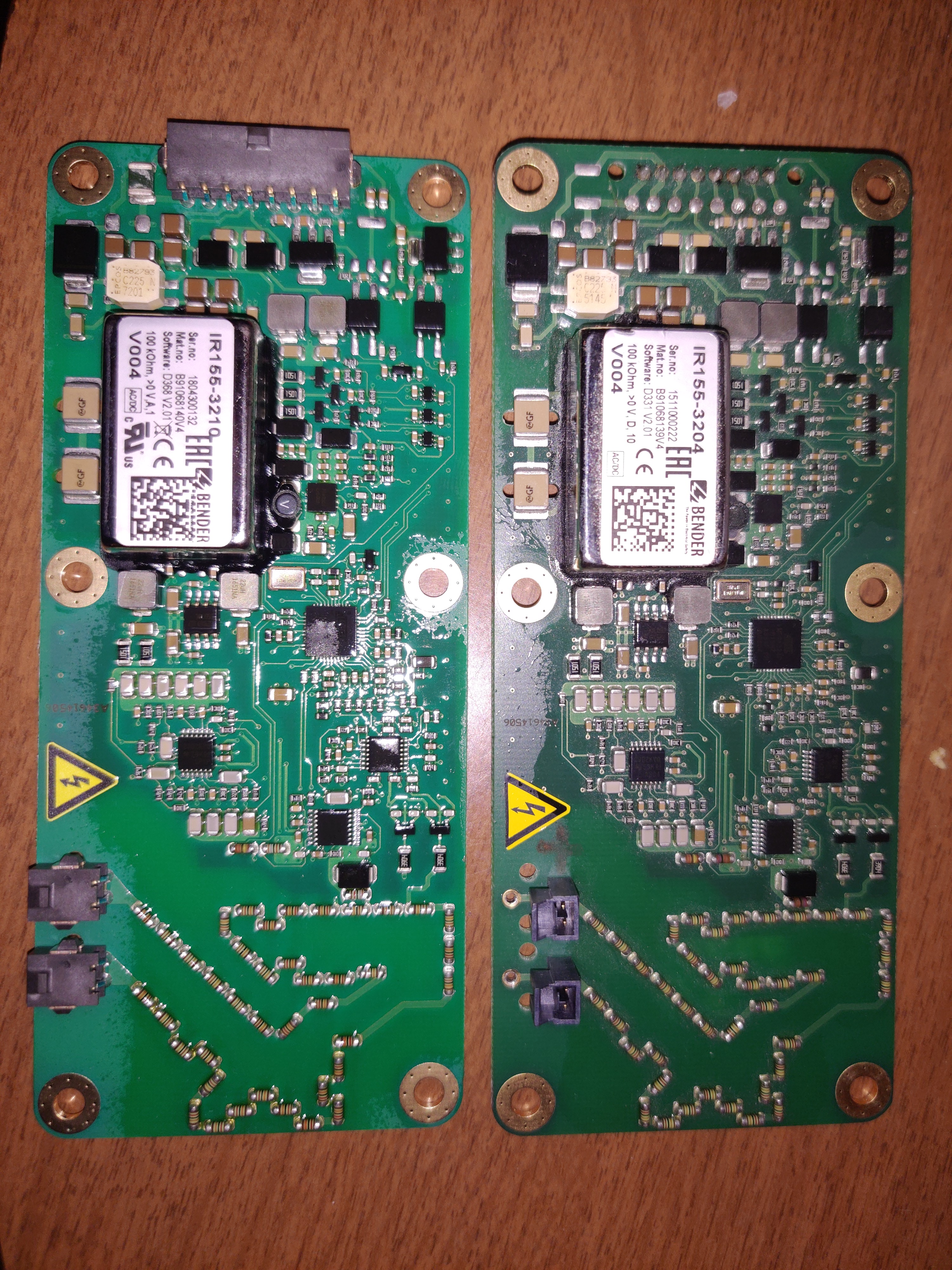

Post by nickyivyca »
Comparing the 3210 to a 3204, the only difference is the missing ferrite bead (I think that's what that is) on the bottom left corner of the board, and the label applied to the brick. (The Nano-fits on the 3204 were a manual modification and not how it originally came, borrowed board from my old FSAE team to compare)
I'm guessing D,10 and A,1 are the different parameters. If the 1 is the Fave number then that would mean the 3210 is just more reactive than the 3204.
Plan to install in my 914 as part of the next round of upgrades, we'll see how soon that happens.

nickyivyca wrote: Sat May 04, 2024 12:48 am PXL_20240430_050329480.jpg
Did you end up installing the 3120? I'm currently looking for a solution for isolation monitoring and this seems the most accessible.
