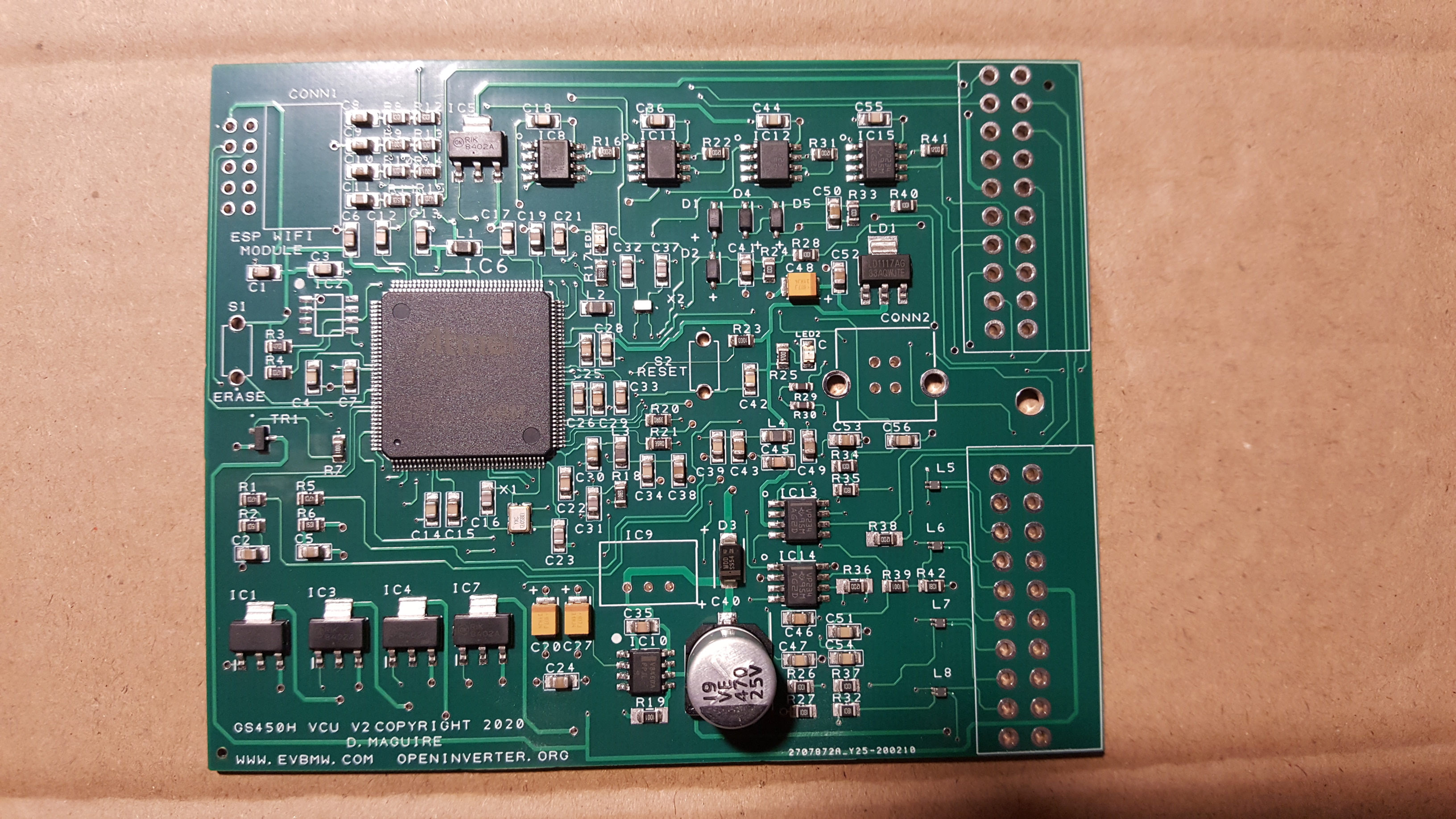

Posts: 4006
Been thanked: 1135 times
New batch of V2 controllers has arrived from JLCPCB. This batch have the SAM3 processor fitted:)

Post by Dilbert »
Looks great

Post by EVPanda »
Jack Bauer wrote: Wed Mar 04, 2020 5:56 pm New batch of V2 controllers has arrived from JLCPCB. This batch have the SAM3 processor fitted:)
Looks like my wallet is about to get a little bit lighter. 8-)
How are you selling these new ones? Partially assembled or fully tested?
