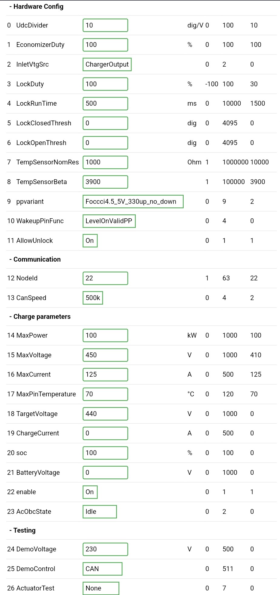

On my Saxo project I have Zombie and Foccci for charging. I'd like to add the MG ZS 6,6kW charger to the code.
To start this I want to check the rest of the system. So I selected the outlander charger for now. Planning to use the outlander code as base for the MG ZS charger.
I checked out the zombie code and as far as I can tell it should enable the EVSE and send AC to the charger and enable the HV. Without the charger communicating with Zombie?
Used the ConfigFocci function on Zombie to set up the Foccci.
Foccci is on firmware : 0.42.76.B as it came from the OI shop.
Zombie is on firmware : 2.22.A
In the spot values the EVSE current limit is correct and updating when I change the setting on the EVSE.
Also have the CPspoof set on the Zombie and it works fine, duty cycle changes with the EVSE setting.
Found some things that are off but don't know if this is a problem:
  • Cablelim and PilotLim are the pilot limit(Cablelim is not used currently I think)
  • MaxTemp is mapped in the Foccci but the Zombie code labels this as ChargePort_Plug
  • the AcOcbState and AllowUnlock CAN maps overlap
I have spent many hours coming through the code and checking things. But I am a bit lost. Could use some help.

manny wrote: Tue Feb 04, 2025 7:33 pm In the spot values
Can you show all the Foccci spot values? While Plugged in and Zombie shows the EVSE limits.

This is with the original code.
Tried to compile the firmware revision BigPie is using, but having a hard time compiling the code.

Ohh, wait. The screenshot of your spotvalues shows me two hints: I do not see AcObcState. And I see version 0.42.76.B. The "B" means, it is a build from from the github actions. And the 76 means, it is github action build number 76. So the conclusion is: This is a quite old software. Update to #80 or even the latest is recommended.
Edit: Ohh, wait again. AcObcState is not on the spot value page, because it is on the parameter page. I'm not sure whether this makes sense, should/could we move this to the spot values? Or keep it as test-parameter, to allow manual testing?
Edit2: Added the hints with the version number and the github action explanation to the FAQ on the Foccci wiki page.

manny wrote: Tue Feb 04, 2025 7:33 pm Foccci is on firmware : 0.42.76.B as it came from the OI shop.
What is the hardware version and when did you purchase it?
I completely did not recognise the fact the 76B is the build identifier. So we might have concluded it does not longer work too early, best test a release as you are doing now to see if it works as it should. Then you can update to the latest to see if it still works.

Updated to #80 without issue. The charge behaviour is the same.
weird bonus: had trouble connecting to Zombie via CAN but after the update it is instant :)
tom91 wrote: Wed Feb 05, 2025 7:38 pm What is the hardware version and when did you purchase it?
Ordered on 17 dec 2024 it a version 5.1

Have a lock. But accidentally bough three wire type. So one wire of the lock switch is connected to one of the motor wires. have no feedback at the moment.

manny wrote: Wed Feb 05, 2025 8:15 pm have no feedback at the moment
So Foccci does not know you have a lock right now.

I tested the lock with the auctuator test. That worked.
When i plug in the charger. The lock does not operate.
uhi22 wrote: Wed Feb 05, 2025 8:17 pm Regarding the Lock: The plan was, that for the case of no lock feedback it is possible to set both detection thresholds to the same value (zero IIRC), and then the lock is just controlled time-based, and Foccci assumes the intended lock state is reached after this time.
so this is not implemented? I can set "Lock feedback value" to test if this makes a difference
