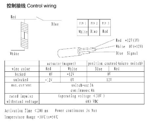

You are not running a Lock?!? That got fixed after build 80
manny
Posts: 196
Location: Netherlands
Has thanked: 58 times
Been thanked: 159 times
Re: AC charging with Foccci and Zombie, not starting
Post by manny »
Have a lock. But accidentally bough three wire type. So one wire of the lock switch is connected to one of the motor wires. have no feedback at the moment.
  • PSA battery (50kWh)
  • Zombie VCU
Posts: 2962
Has thanked: 328 times
Been thanked: 847 times
manny wrote: Wed Feb 05, 2025 8:15 pm have no feedback at the moment
So Foccci does not know you have a lock right now.

Would the AcObcState help to narrow the search window?
Edit: Regarding the Lock: The plan was, that for the case of no lock feedback it is possible to set both detection thresholds to the same value (zero IIRC), and then the lock is just controlled time-based, and Foccci assumes the intended lock state is reached after this time.
Posts: 2962

uhi22 wrote: Wed Feb 05, 2025 8:17 pm Edit: Regarding the Lock
Yes this is implemented after 80B

I tested the lock with the auctuator test. That worked.
When i plug in the charger. The lock does not operate.
uhi22 wrote: Wed Feb 05, 2025 8:17 pm Regarding the Lock: The plan was, that for the case of no lock feedback it is possible to set both detection thresholds to the same value (zero IIRC), and then the lock is just controlled time-based, and Foccci assumes the intended lock state is reached after this time.
so this is not implemented? I can set "Lock feedback value" to test if this makes a difference
tom91 wrote: Wed Feb 05, 2025 8:28 pm Yes this is implemented after 80B
Shall I update to latest version?
