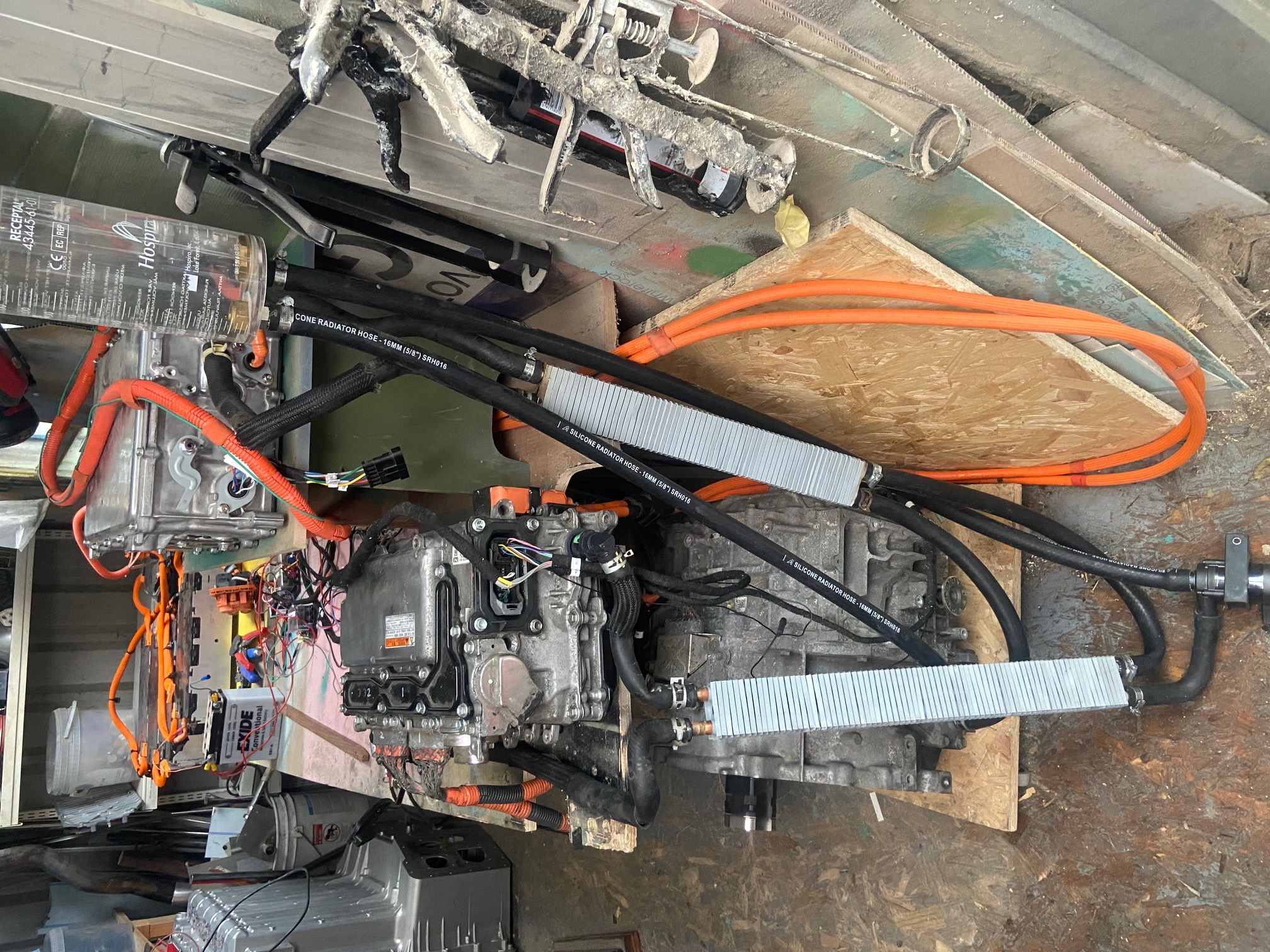

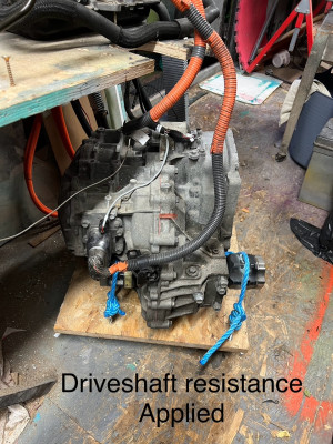

Hi, in my shed is;
ZombieVerter VCU, software V2.15A running the following;
Toyota Prius gen 3 drive train and inverter
Mitsubishi Outlander onboard charger and DC/DC converter
BMW hybrid 330e 7.6 kWh gen 1 battery pack
Toyota Yaris accelerator pedal
Tesla model S water pump connected to skirting board radiators

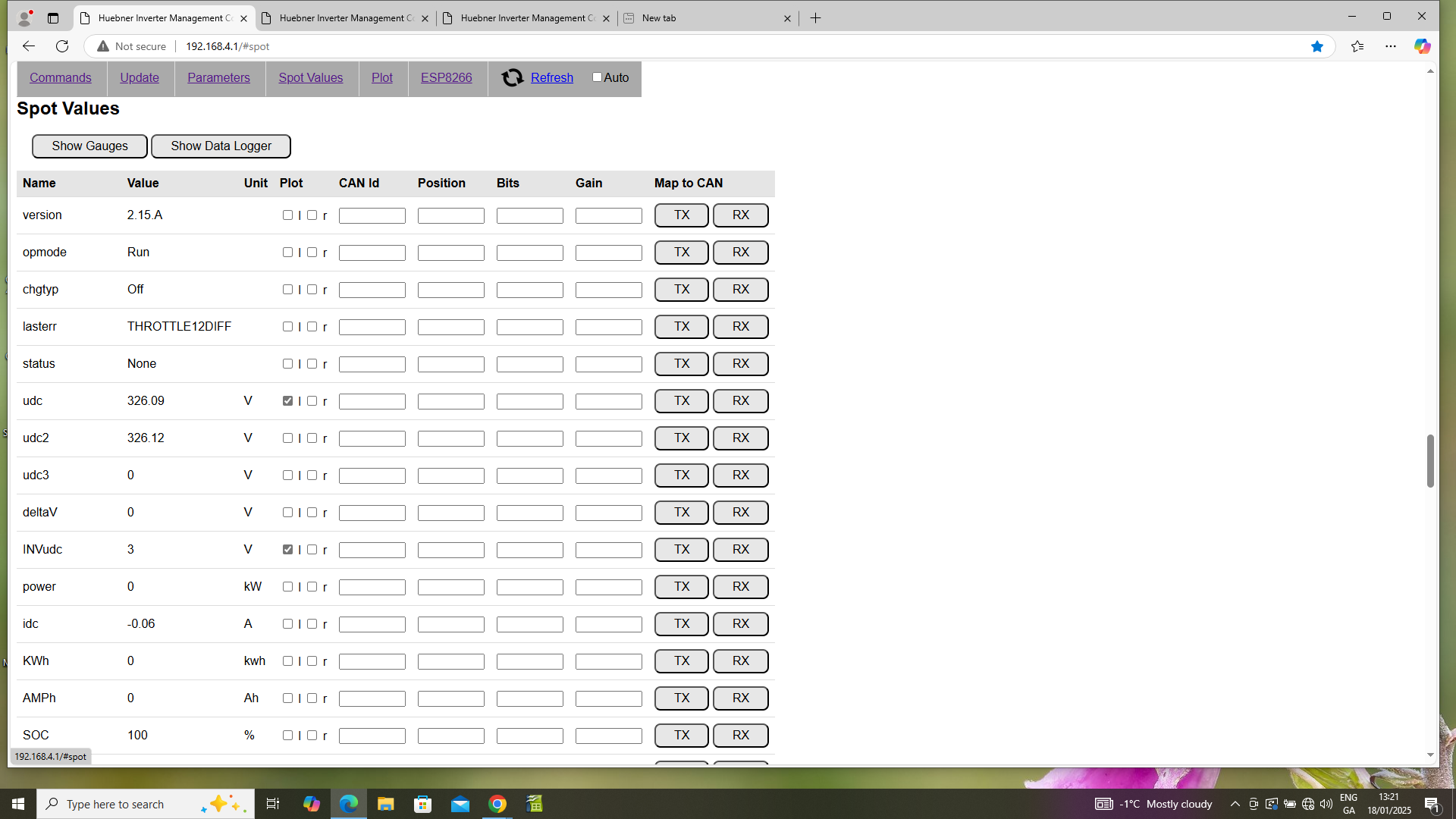

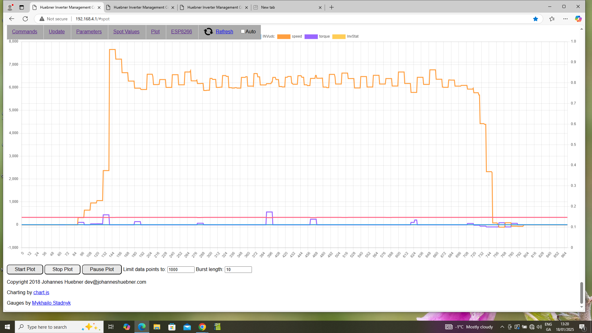

Logs (speed, torque). Spot values screenshot. Params attached
Possible to unlock power/torque of the Prius gen 3 drive train?
I have a similar bench setup as The Greg RabbitMyster (my teacher) and much like him I would love to see the Prius smash the 52mph barrier!

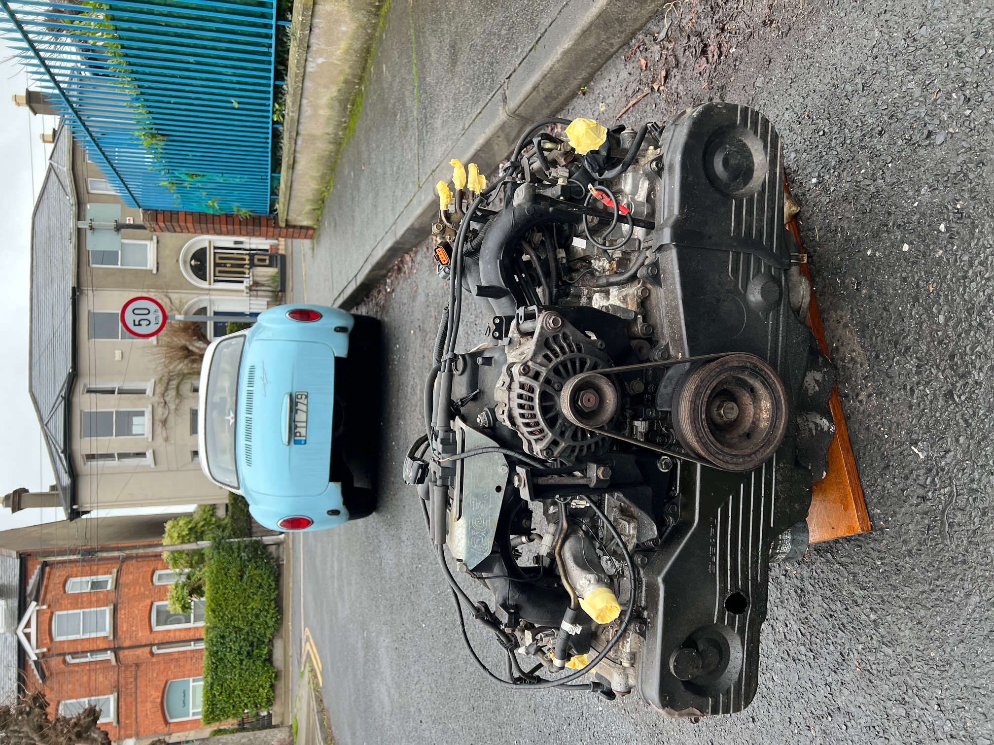

Really want to fit this Gen 3 Prius setup (because I have one and it will be different) in my 1966 Karmann Ghia which I have just de iced from a Subaru N/A 2litre 92kW 184Nm engine that I fitted in 2019.
Have converted the Ghia from Swingarm rear suspension to IRS to facilitate the fitting of an EV drive train.
I have not welded the Prius Power split device (as ably demonstrated by Damien) but am prepared to do so and anything else that may help to unlock the power!

So at the moment there seems to be a firmware limited power limit on using MG2 only. As found in testing by greg viewtopic.php?p=73007#p73007 with the support of myself.
Your speed limit is likely due to the revlim of 6000, please raise this to 8000 and see if it will reach that.
I would strongly recommend welding the power split and seeing what changes, since there can be a limit due to only sending torque requests for 1 motor.

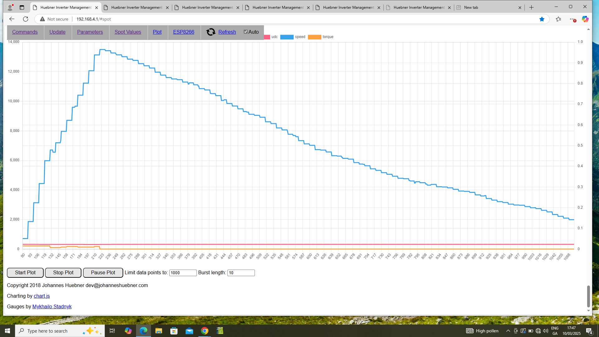

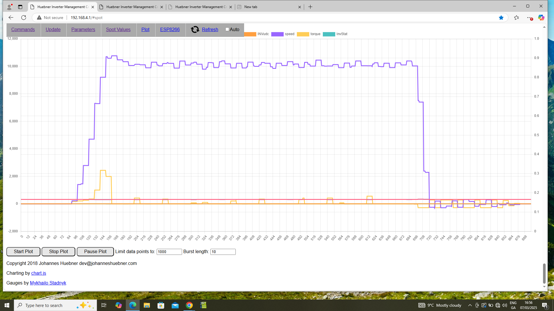

Set revlim to 8000...see log
set revlim to 10000...see log
Posts: 2962
Has thanked: 328 times
Been thanked: 847 times
Re: Unlocking the power/torque of Prius gen 3 drive train?
So this is not the limit right now. Best get this into a vehicle with a welded PSD and then start tweaking things.

Just had to chance my arm with a revlim 13000 run before the teardown!
REVLIM 13000.ods
(14.32 KiB) Downloaded 483 times

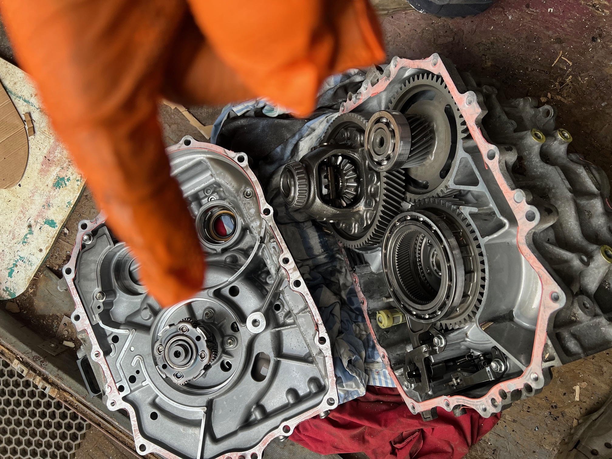

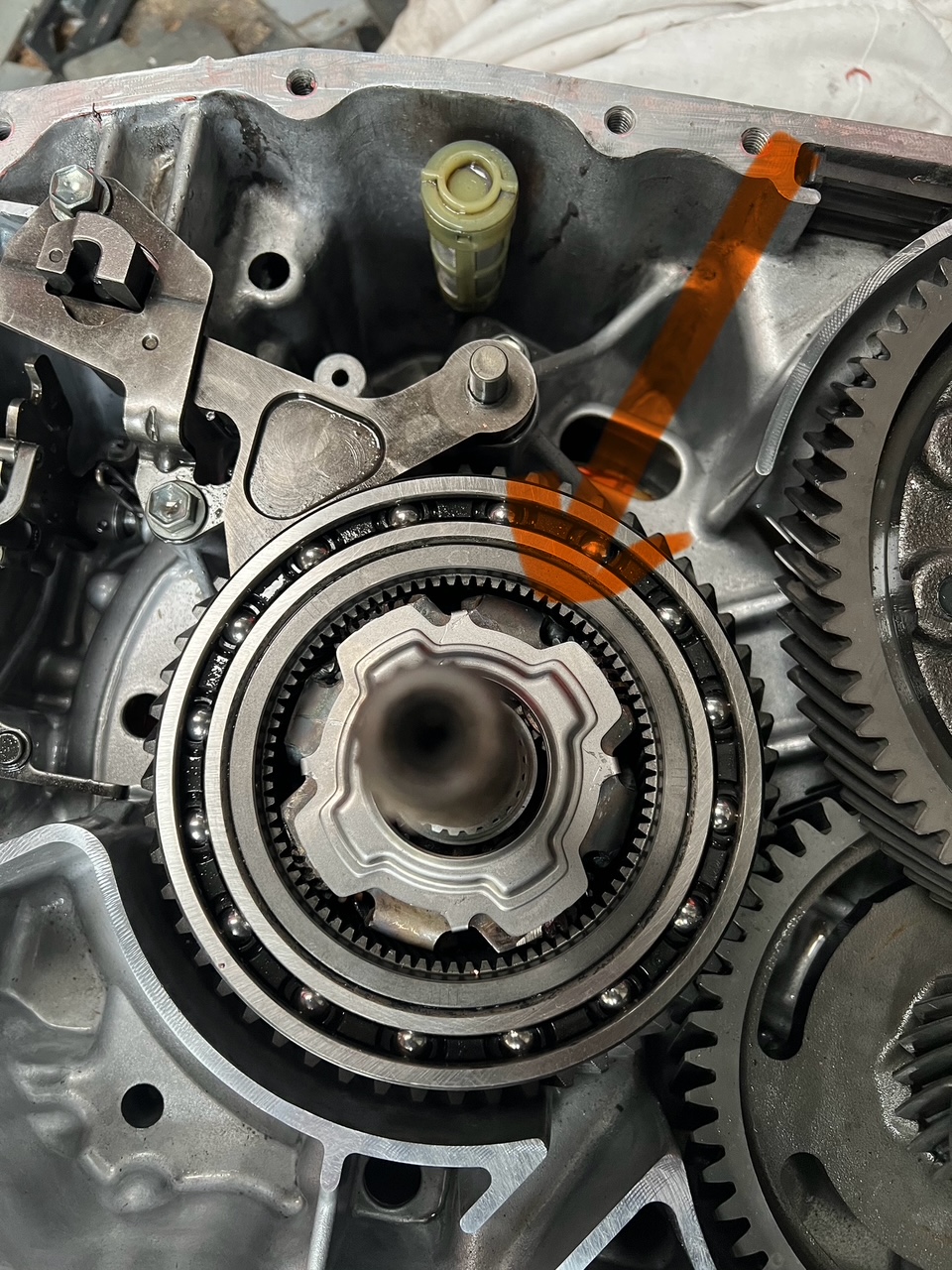

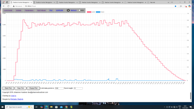

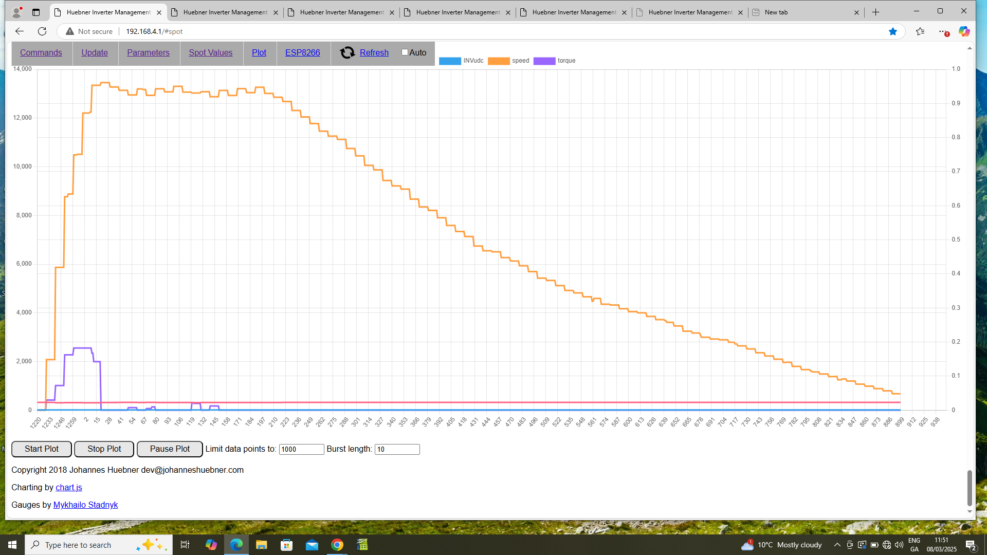

Have just welded the Prius Power split device and reassembled.
Did a quick test using MG2 only with revlim set to 13000
Is there anything else I can do?
Posts: 2962
Run MG1, I would not run it to that high a speed without oil or load.
This is just to check it runs alright and no strange noises. Please check the output rotates in the correct direction.

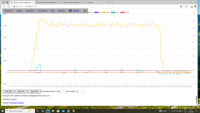

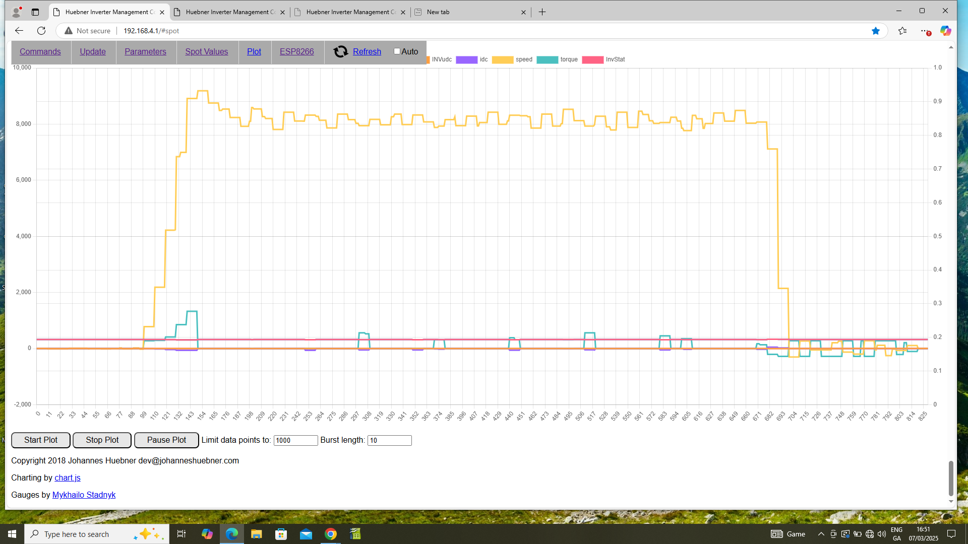

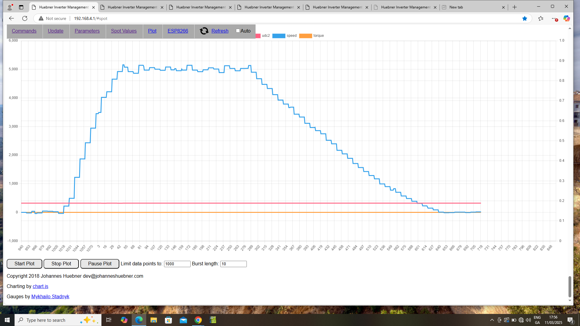

Oil in and MG1 running on revlim5000 no unusual noises.
Runs forward and reverse with output shaft matching.
Posts: 2962
Ghia66 wrote: Tue Mar 11, 2025 6:24 pm Runs forward and reverse with output shaft matching.
And this matches MG2? Then we can proceed to get to loading it up, which needs a vehicle.

I have a crude resistance rope setup on each drive hub that I could use to increase the load.

Well I couldn’t resist spinning the drive with MG 1 and MG 2 now the power shift is welded.

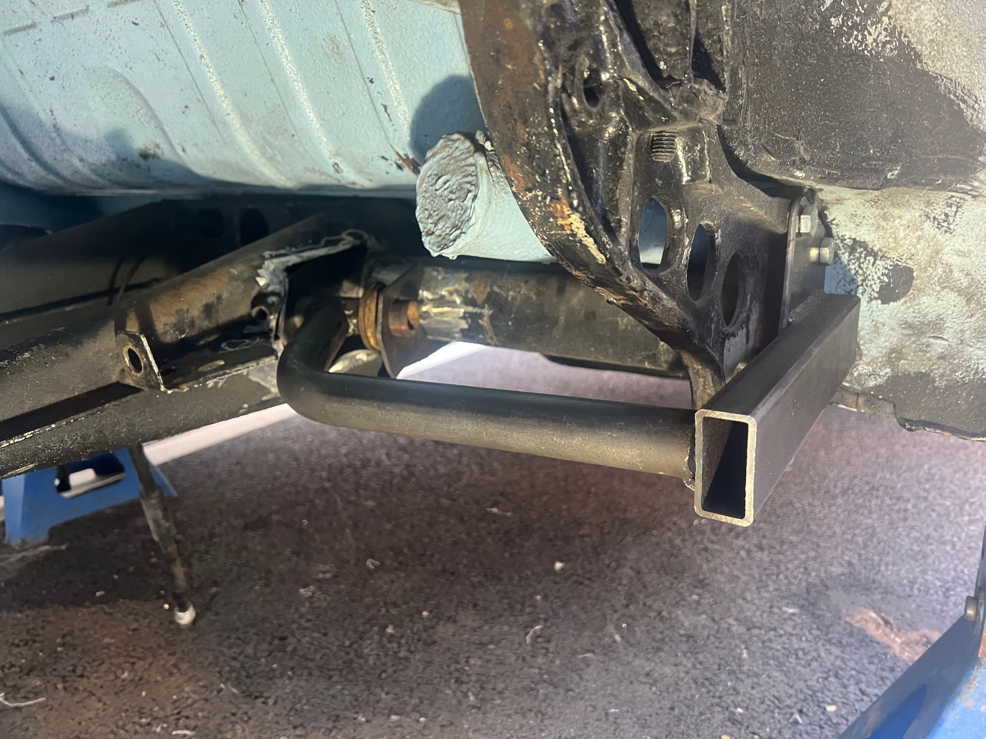

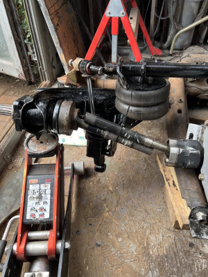

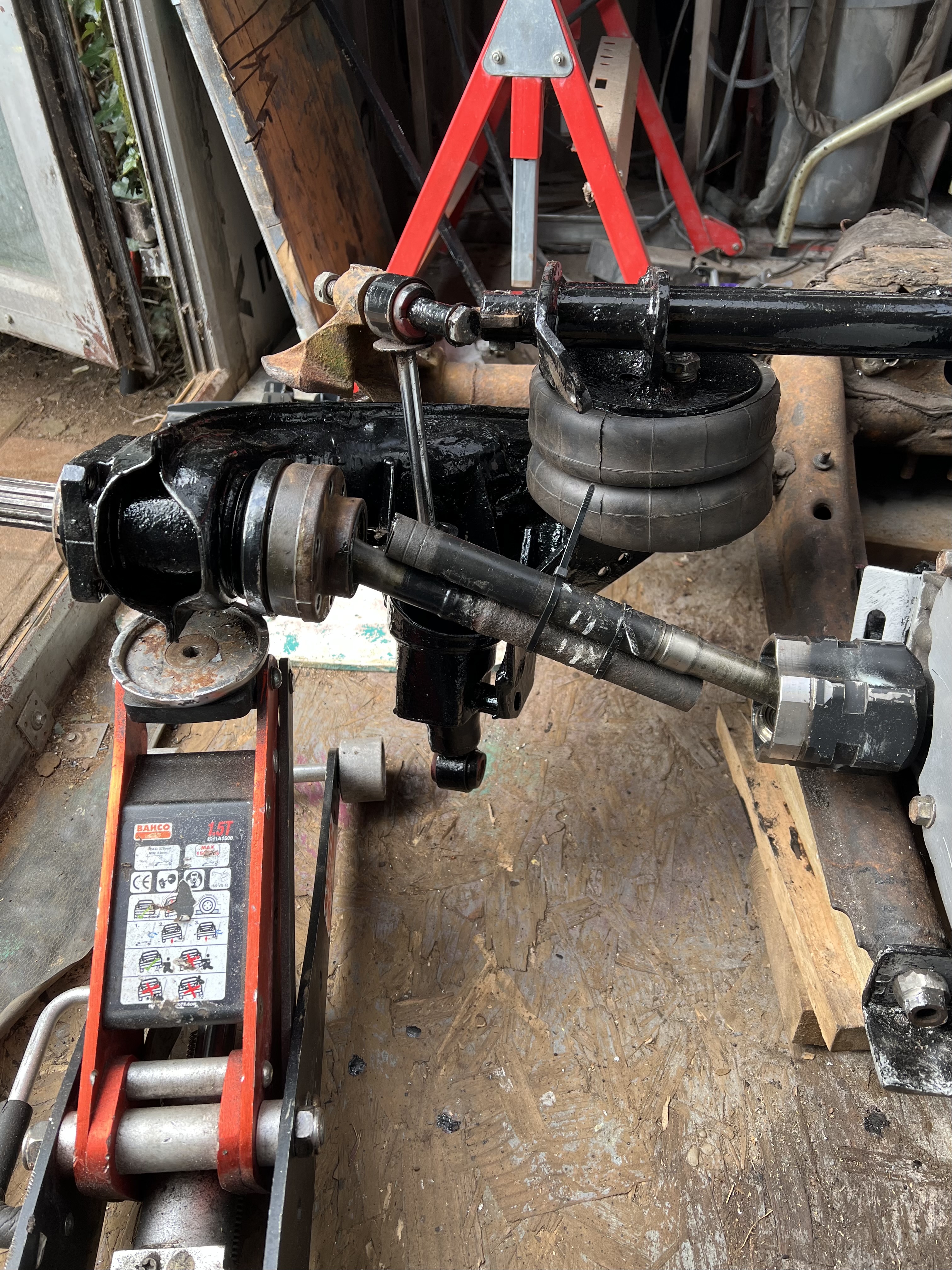

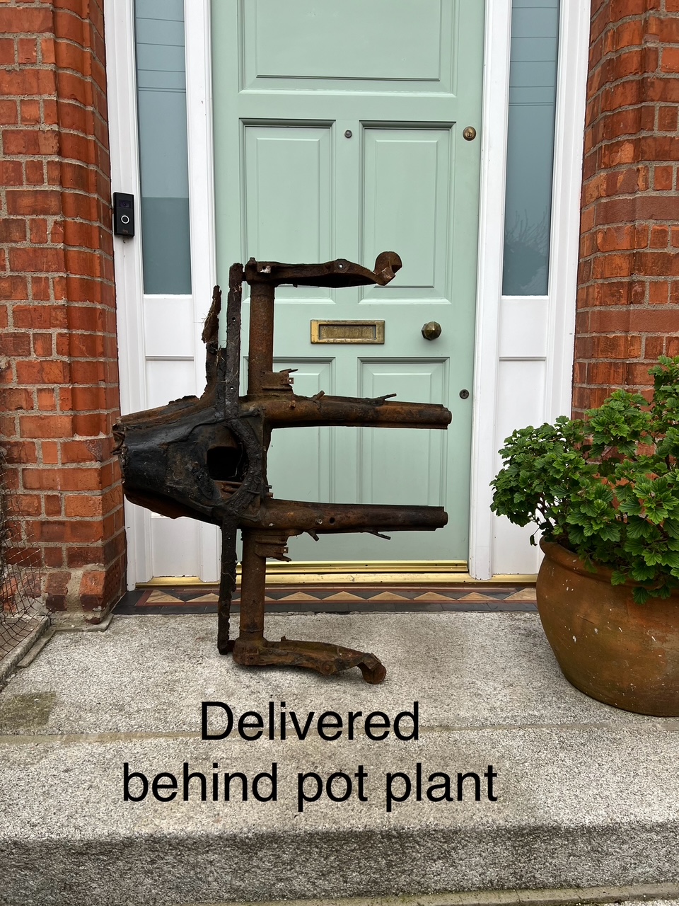

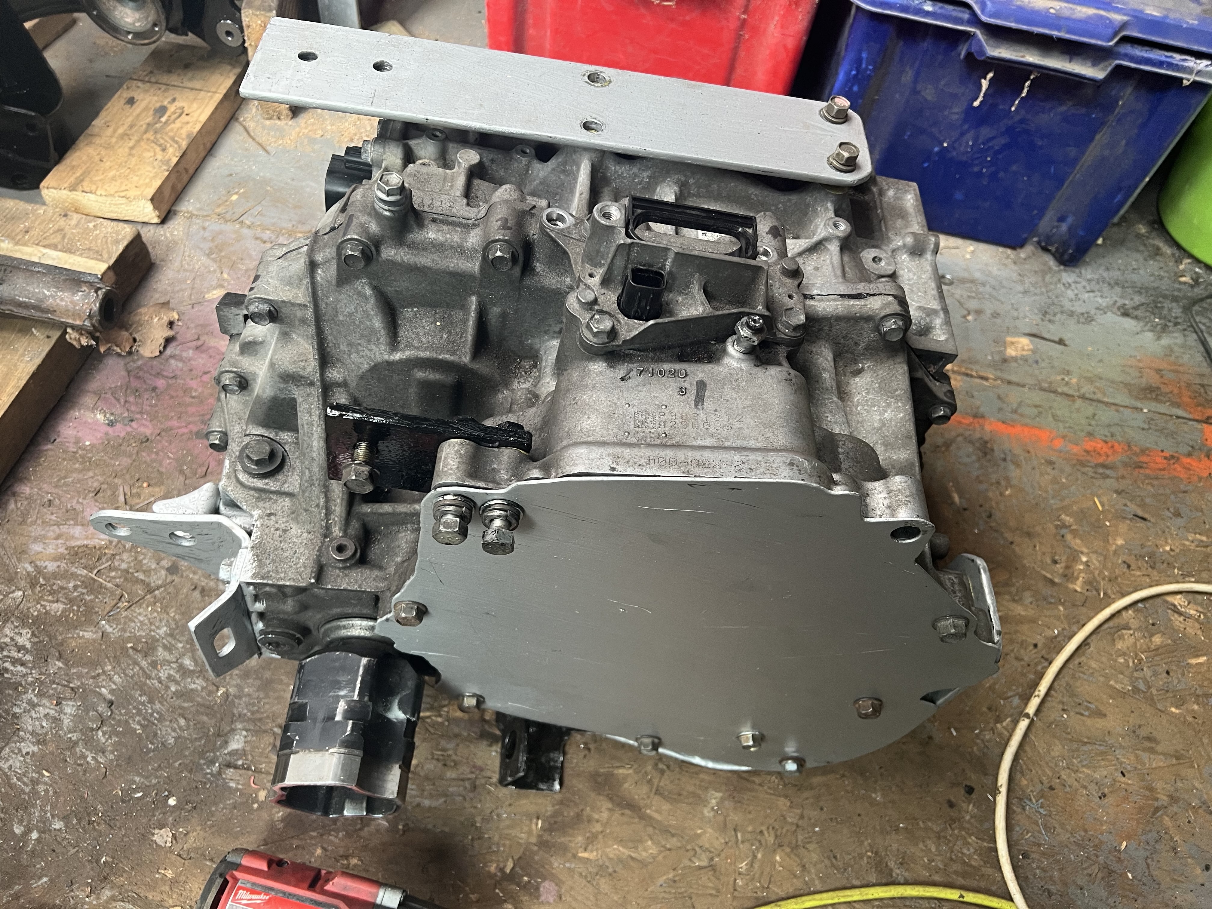

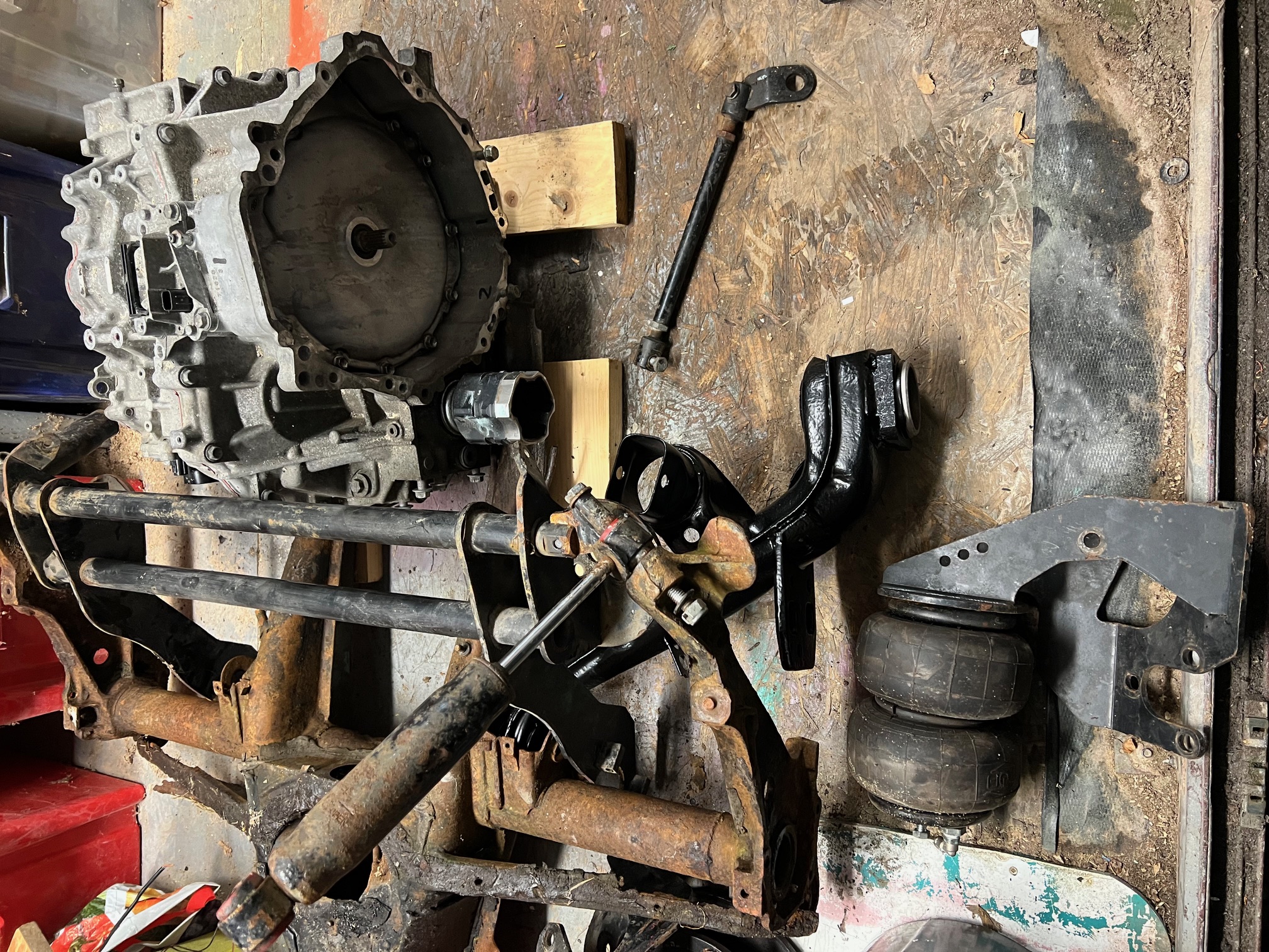

The mounts are sorted on my test chassis so now to the next challenge…the driveshafts!
Ghia66
Posts: 171
Has thanked: 750 times
Been thanked: 65 times
Post by Ghia66 »

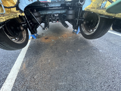

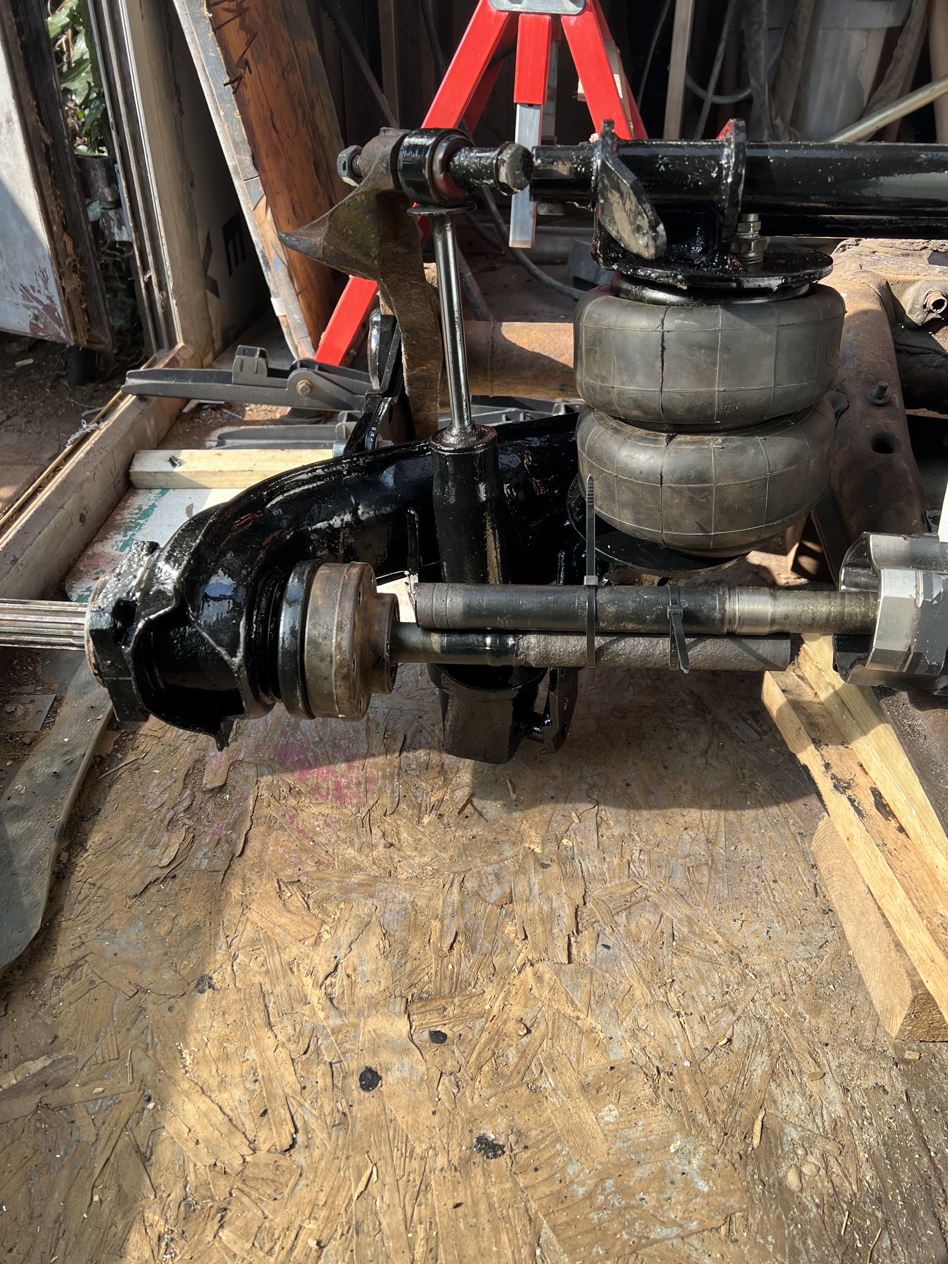

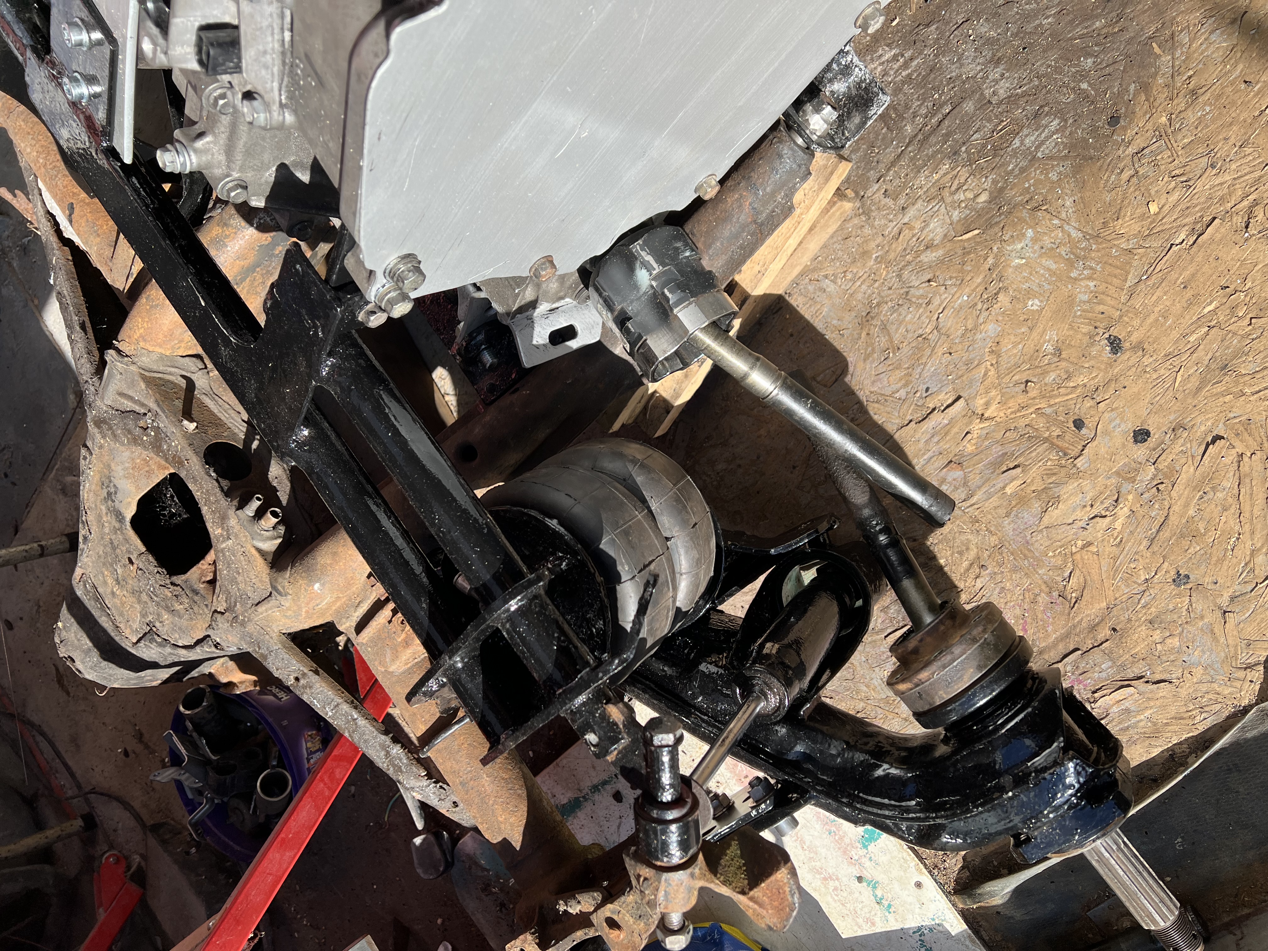

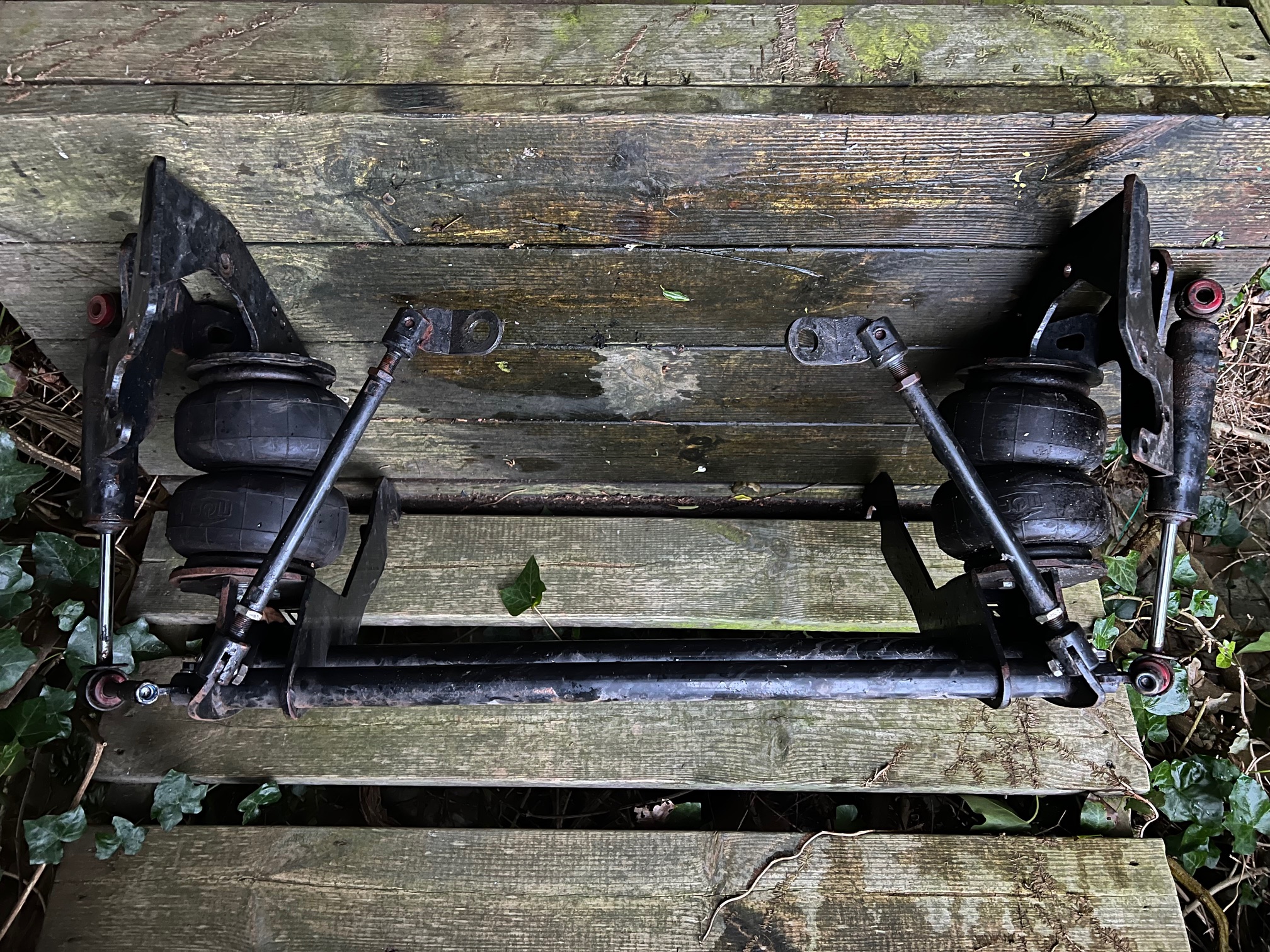

New Independent rear suspension and air bags are in
Engine mounts fitted to drive train
Drive shafts measured and sent off to the machine shop
Planning locations

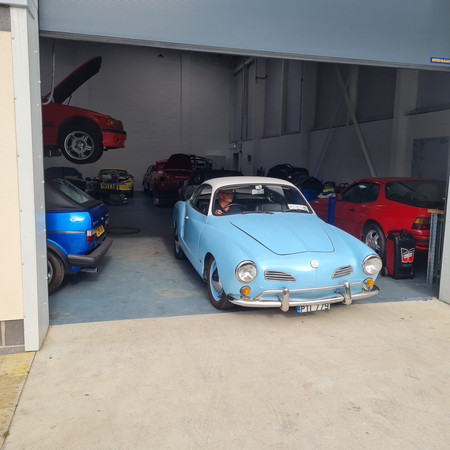

Posts: 3795
Been thanked: 411 times
Ghia66 wrote: Tue Mar 11, 2025 8:09 pm Thanks Tom, anything else I can try in the interim?
Any point in trying MG1 & MG2 together for a spin?
You may break things, so dont...
On the other hand you may try to rotate assembly by MG2 and then put the MG1 in regen :). This should be interesting...
Ghia66
Posts: 171

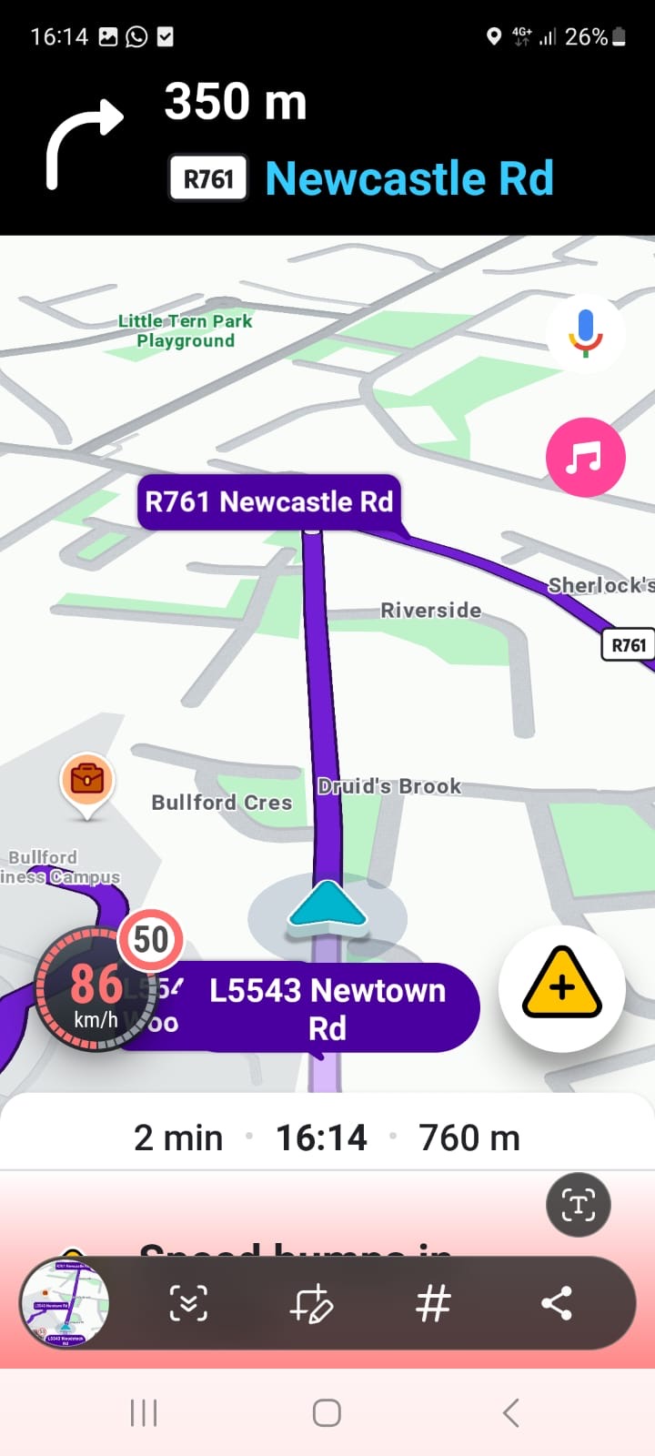

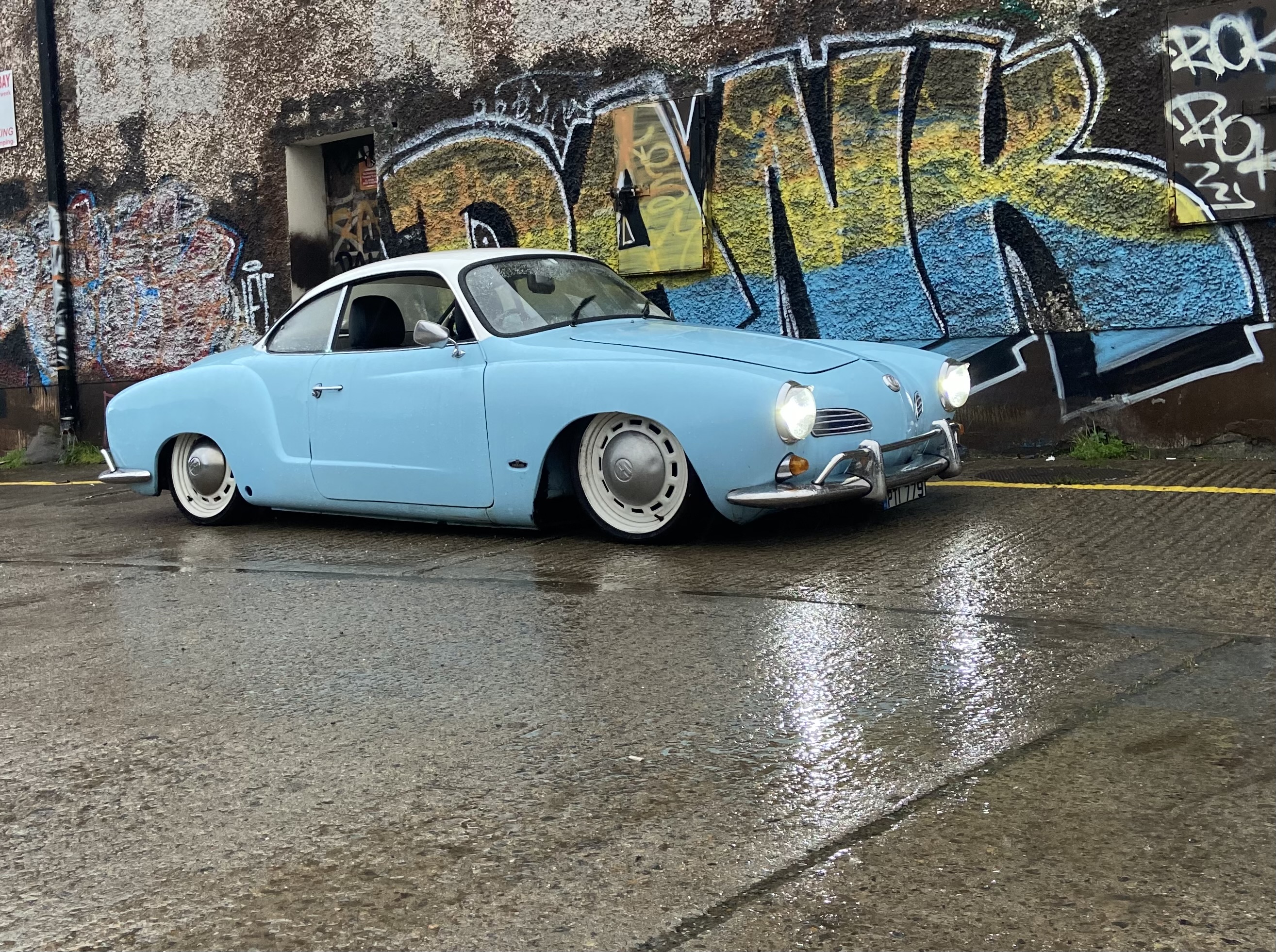

Post by Ghia66 »

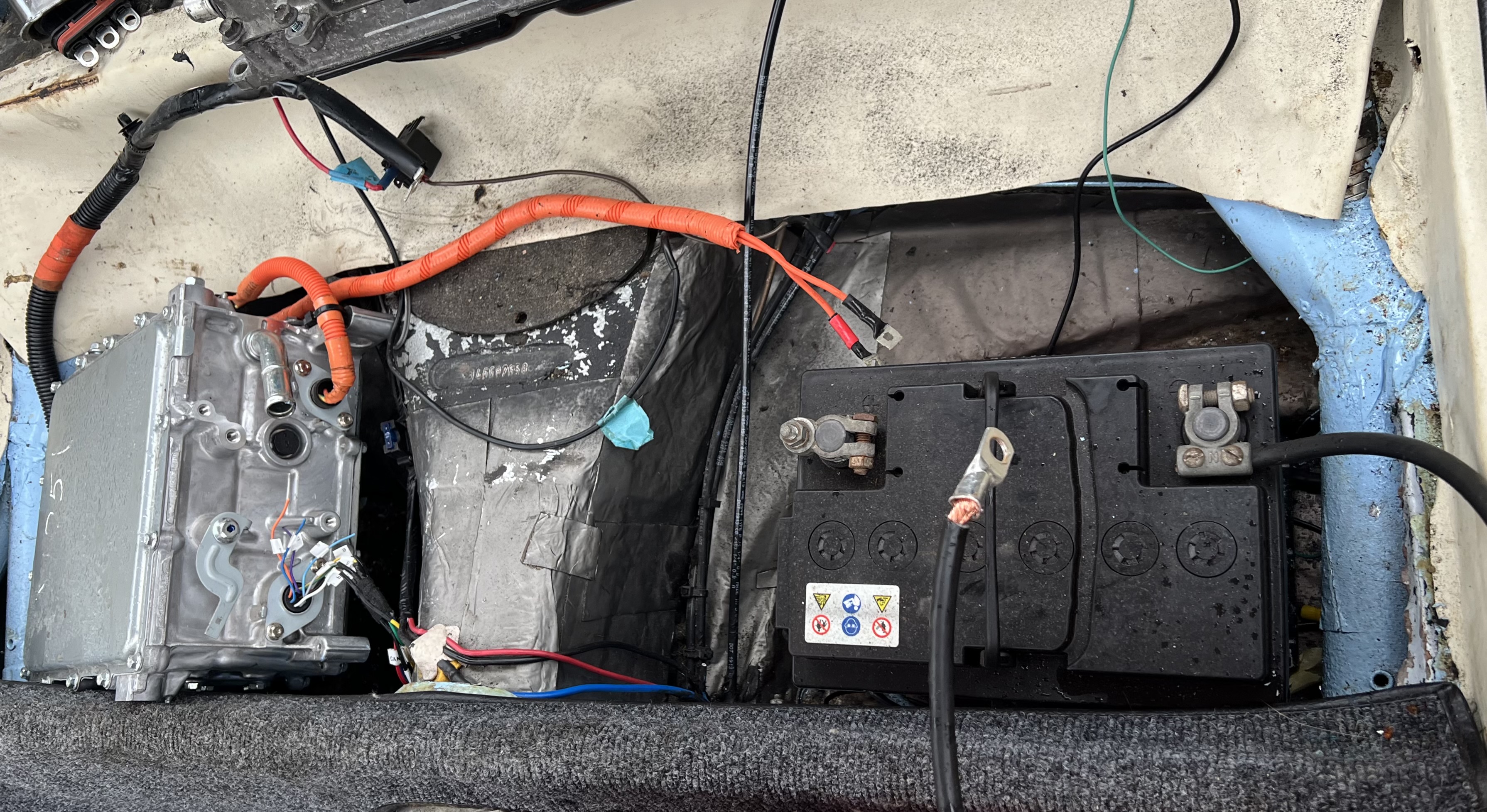

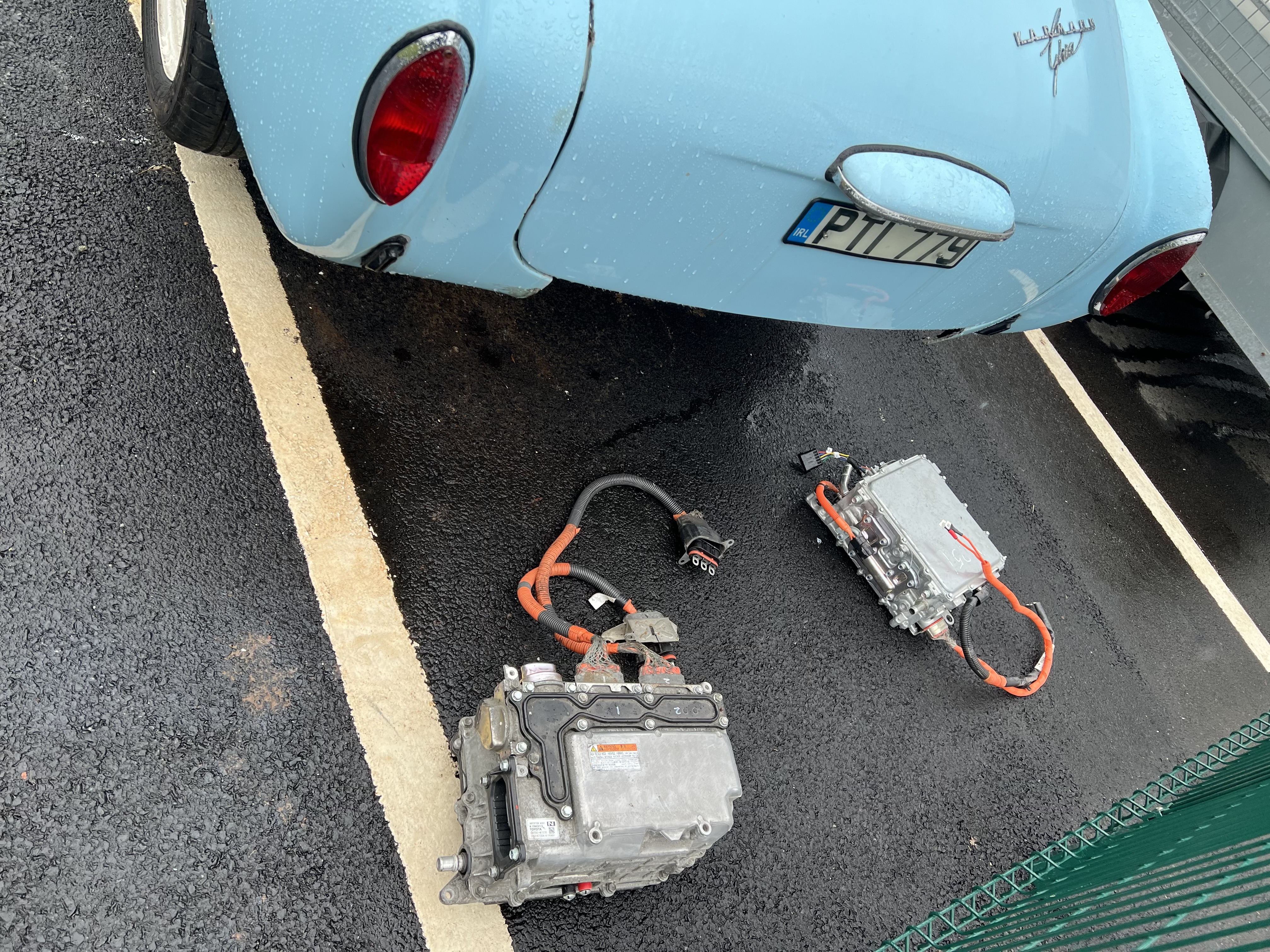

So I hit 86 kph on my third test run in the Karmann Ghia.
I reckon it will go faster when I have enough open road and have corrected the massive toe in on the rear wheels…so maybe the 52 mph Rabbit limit will be broken 🤞
Toyota Prius gen 3 motor and inverter welded power split device
BMW hybrid 530e 12kWh gen2 battery pack
BMW Safety box
What do I need to try now?

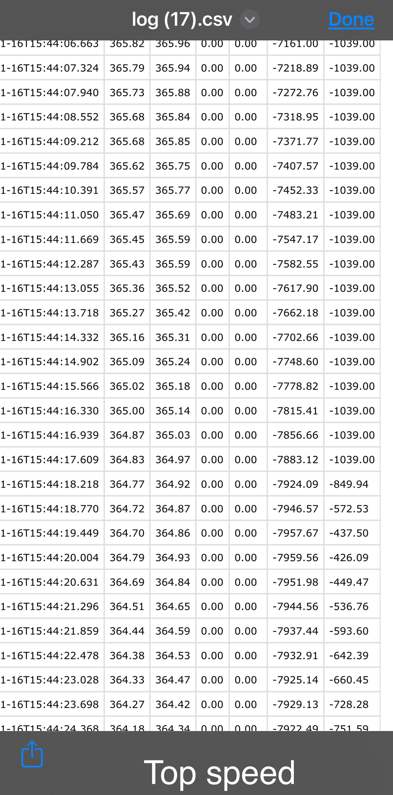

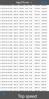

Ghia66
Posts: 171
Post by Ghia66 »
log (17).csv
(37.05 KiB) Downloaded 13 times
Whet for a test run in the Ghia and reached 103kph (64mph) but no faster. So the 52mph barrier has been passed!
It drives smoothly but the throttle needs to be pushed down a long way to get really motoring.
It spun up to 7959 rpm should I do a test run with revlim set to 13000 now?
Any suggestions would be most appreciated.
Posts: 2962
Can you please next time add
"idc" and "potnom" instead or "KWh" or "AMPh"
Please post your params.
