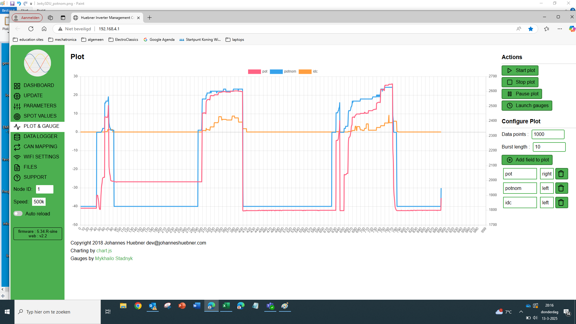

I have some trouble with my SDU rotordir.
The SDU works fine, only sometimes when I start the drive unit the spotvalues 'seldir' and 'rotordir' are opposite. In this case the car is not driving at all, when I press the trottle the car is very jerky. This doesn't stop when I restart the drive unit.
It can only be fixed by waiting 5 minutes and restart again, when I'm lucky the problem is gone...
Does anyone have this problem as wel?

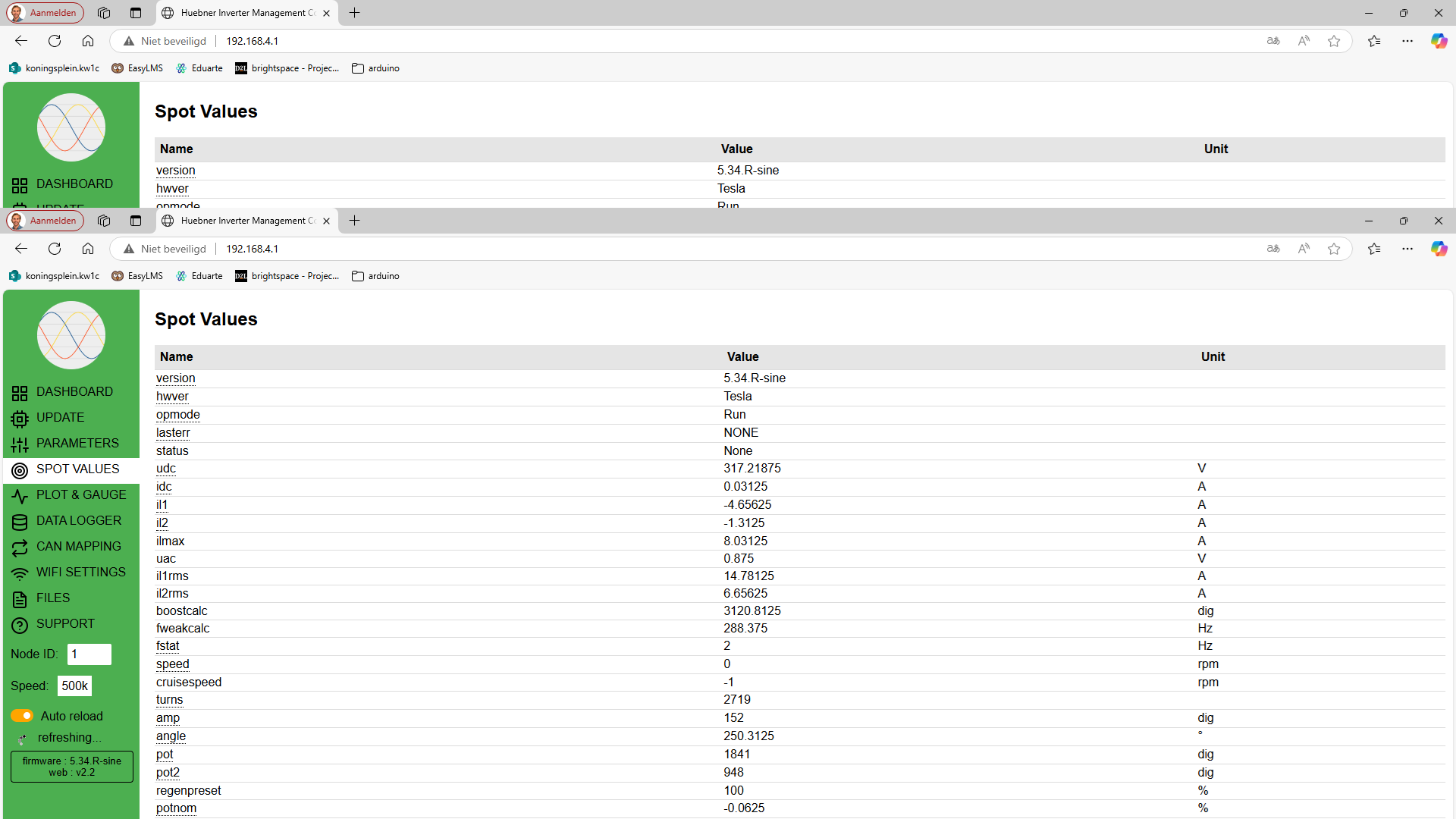

I have attached the 2 screenshots of the spot values, one is from a godd working SDU and one from a jerky SDU.
When the SDU starts jerking the rotordir and seldir have opposite value, this behaviour is very constant.

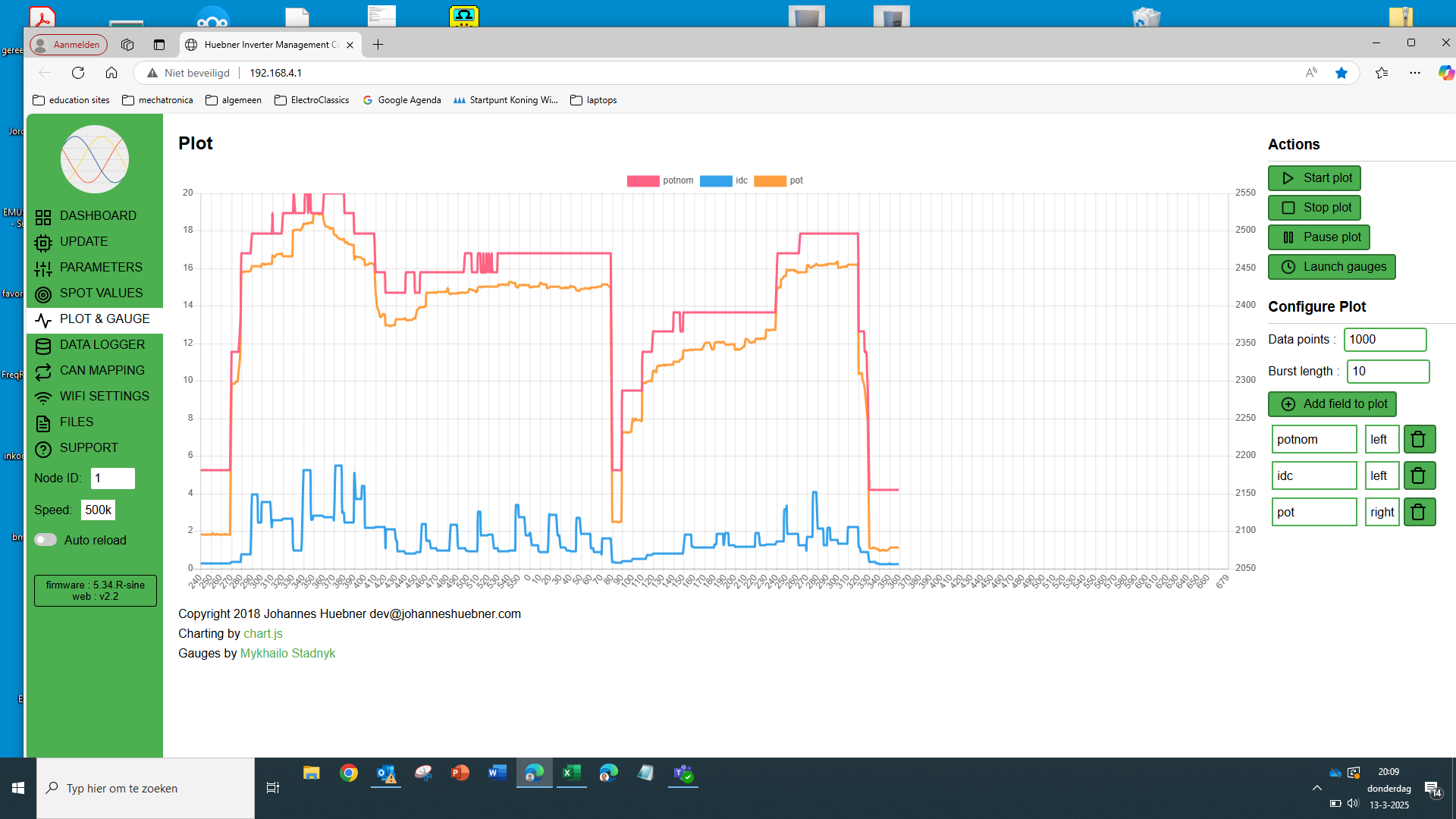

Ok. When it is jerky can you make a plot of potnom please

Re: SDU rotordir problems
Ok, so it's not derating.

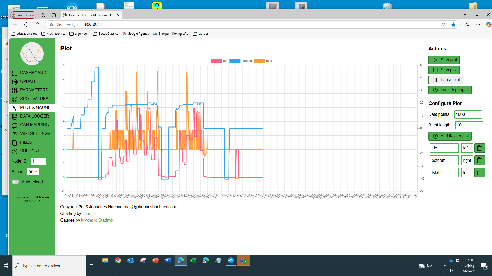

Can you plot fstat when jerky?
Ok, so it's only at slow speed then?
It is not possible to drive, the car only bouncing. When you press the throttle the bouncung gets louder.
When you push the car a bit forward and it starts rolling it is possible to drive bud it drives jerky.
