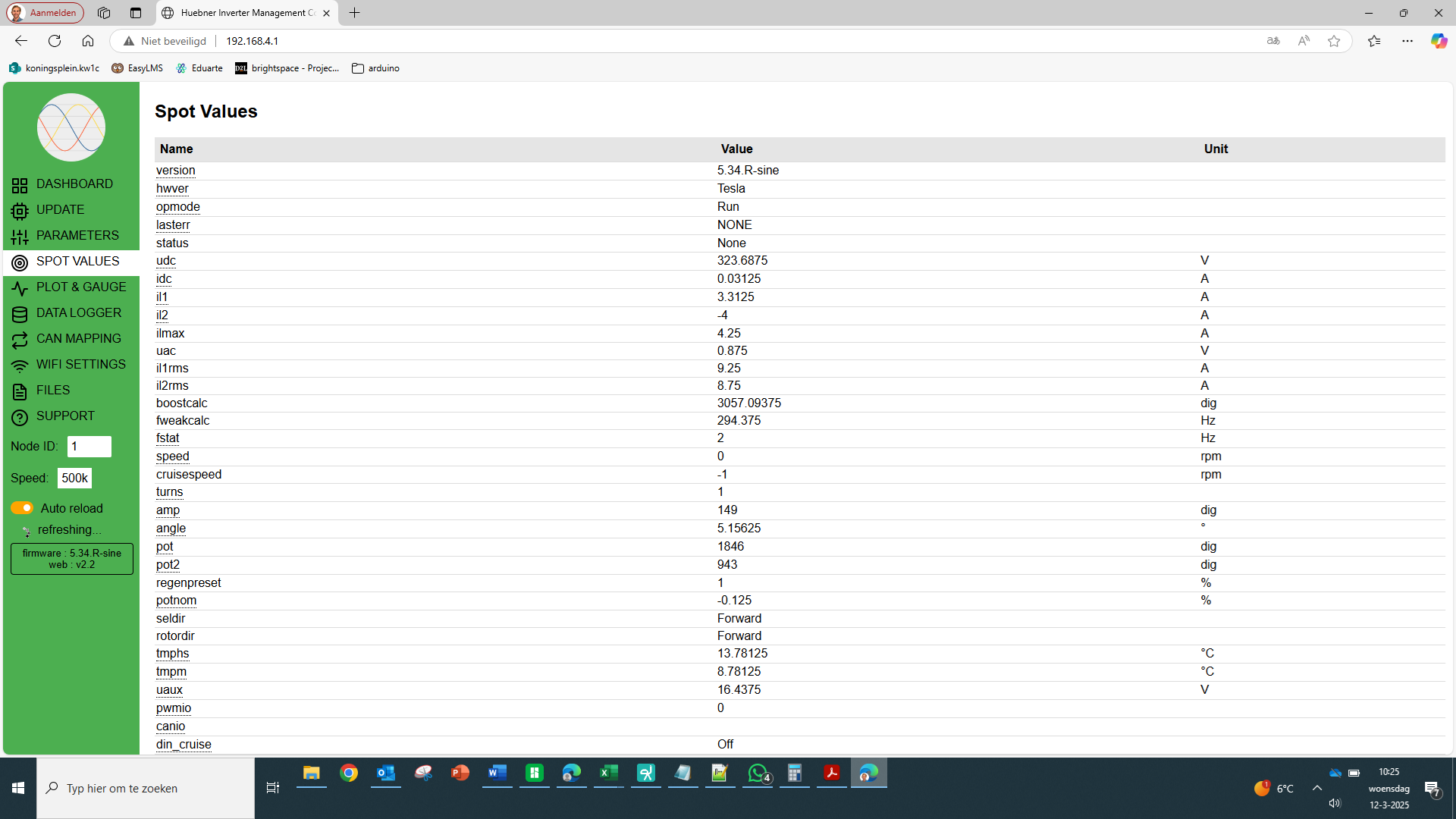

I have some trouble with my SDU rotordir.
The SDU works fine, only sometimes when I start the drive unit the spotvalues 'seldir' and 'rotordir' are opposite. In this case the car is not driving at all, when I press the trottle the car is very jerky. This doesn't stop when I restart the drive unit.
It can only be fixed by waiting 5 minutes and restart again, when I'm lucky the problem is gone...
Does anyone have this problem as wel?

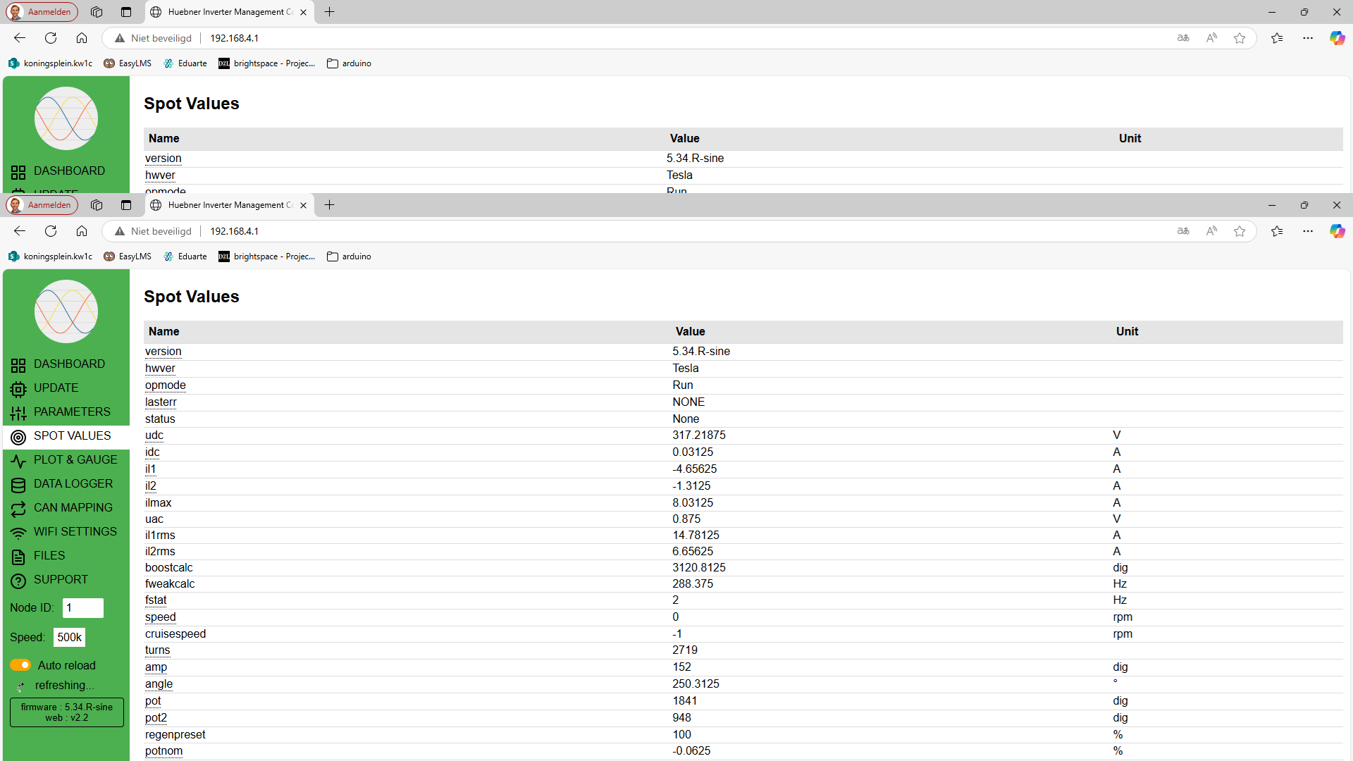

I have attached the 2 screenshots of the spot values, one is from a godd working SDU and one from a jerky SDU.
When the SDU starts jerking the rotordir and seldir have opposite value, this behaviour is very constant.

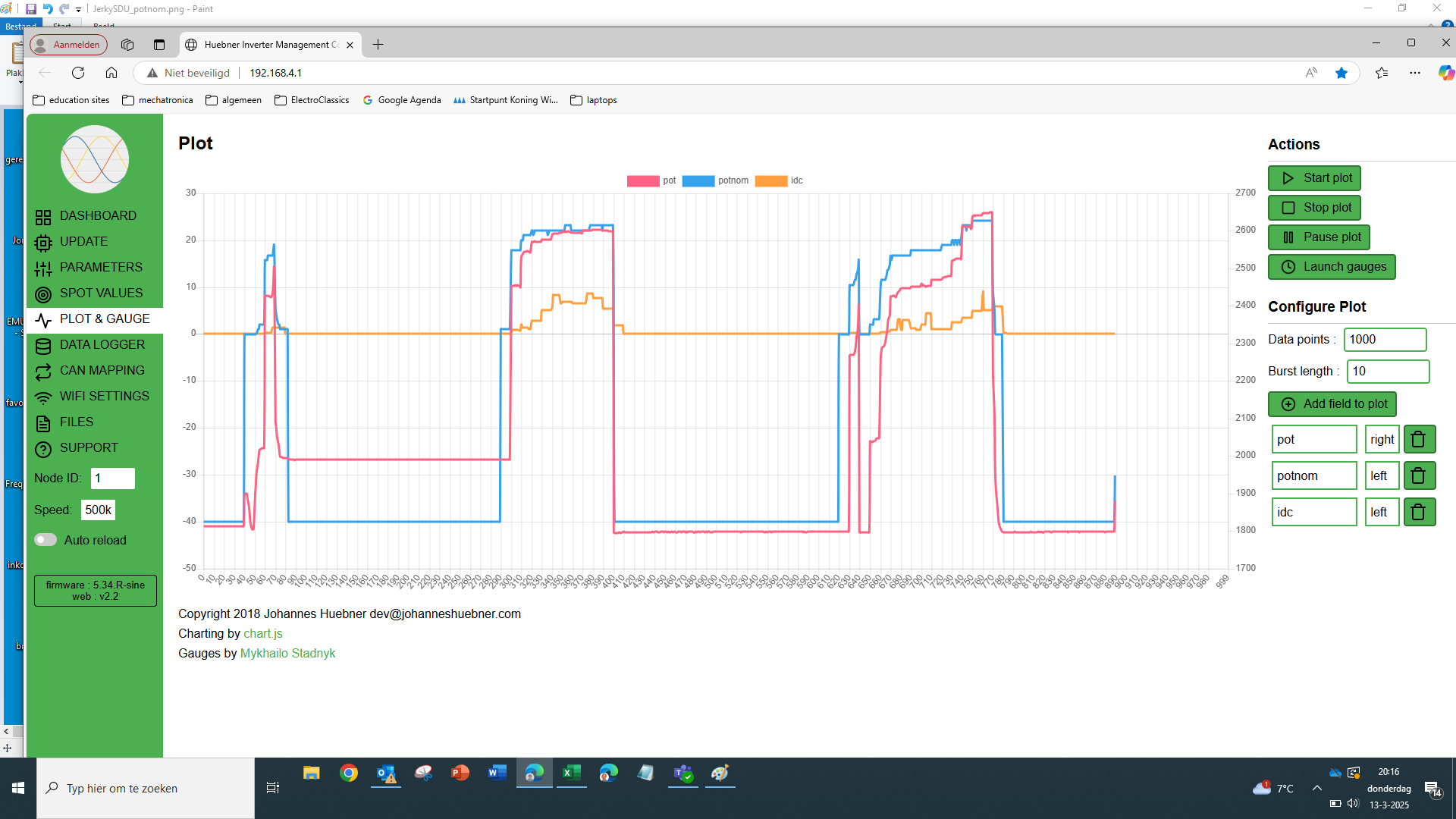

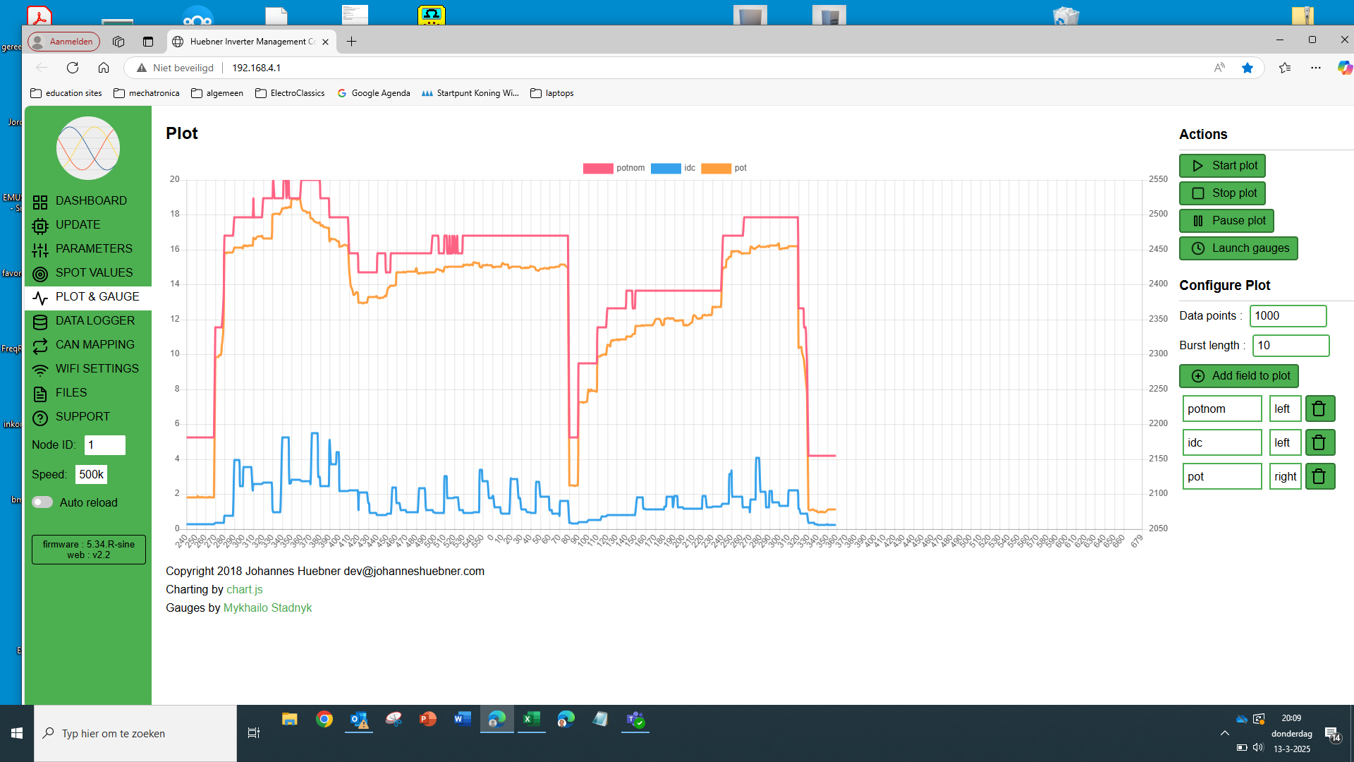

Ok. When it is jerky can you make a plot of potnom please
- Posts: 14
- Joined: Wed Mar 12, 2025 11:11 am
- Posts: 6618
- Has thanked: 341 times
- Been thanked: 1484 times
Re: SDU rotordir problems
Ok, so it's not derating.

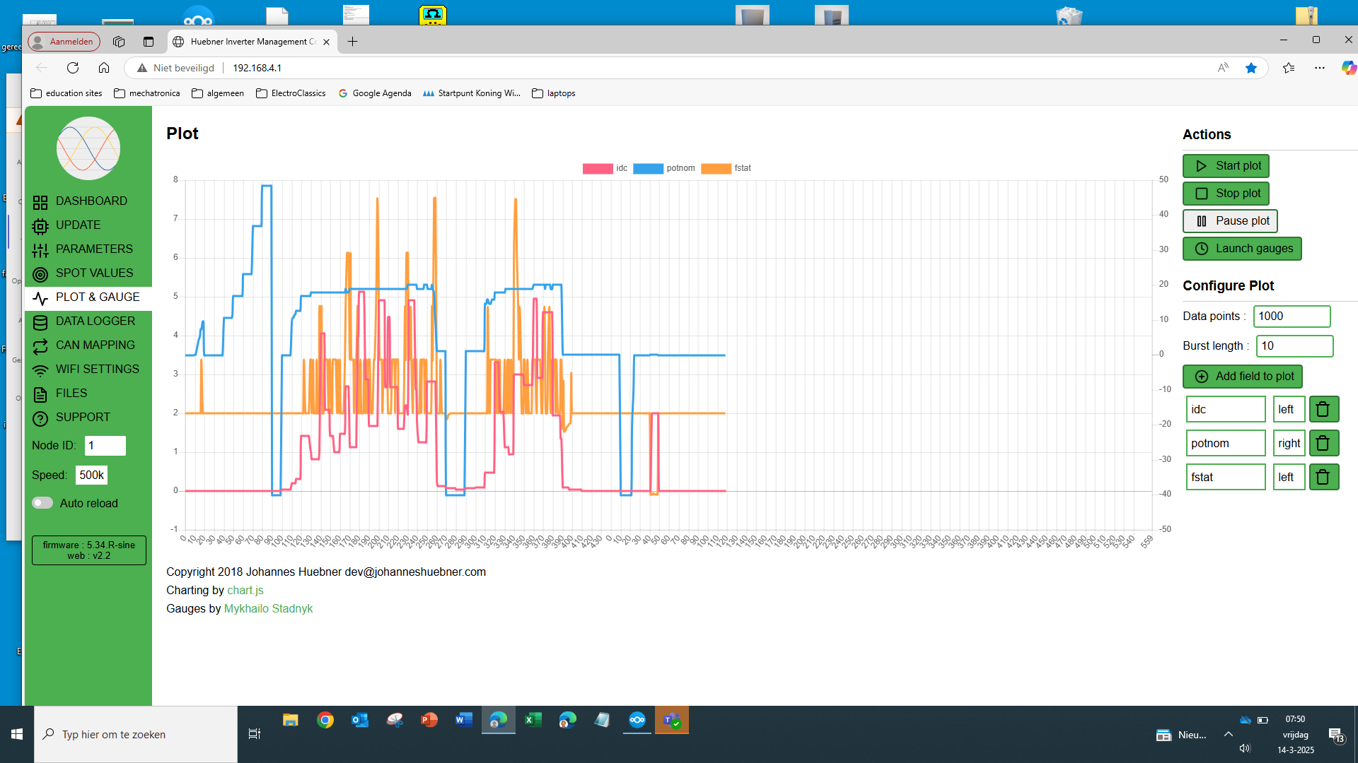

Can you plot fstat when jerky?
- Posts: 14
- Posts: 6618
Ok, so it's only at slow speed then?
- Posts: 14
It is not possible to drive, the car only bouncing. When you press the throttle the bouncung gets louder.
When you push the car a bit forward and it starts rolling it is possible to drive bud it drives jerky.
