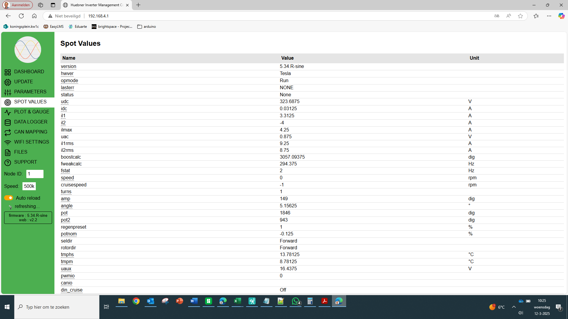

At standstill it is likely that rotordir is opposed to seldir because the direction can only be determined once the rotor is spinning. So I think your problem is not related to that

I have attached the 2 screenshots of the spot values, one is from a godd working SDU and one from a jerky SDU.
When the SDU starts jerking the rotordir and seldir have opposite value, this behaviour is very constant.
