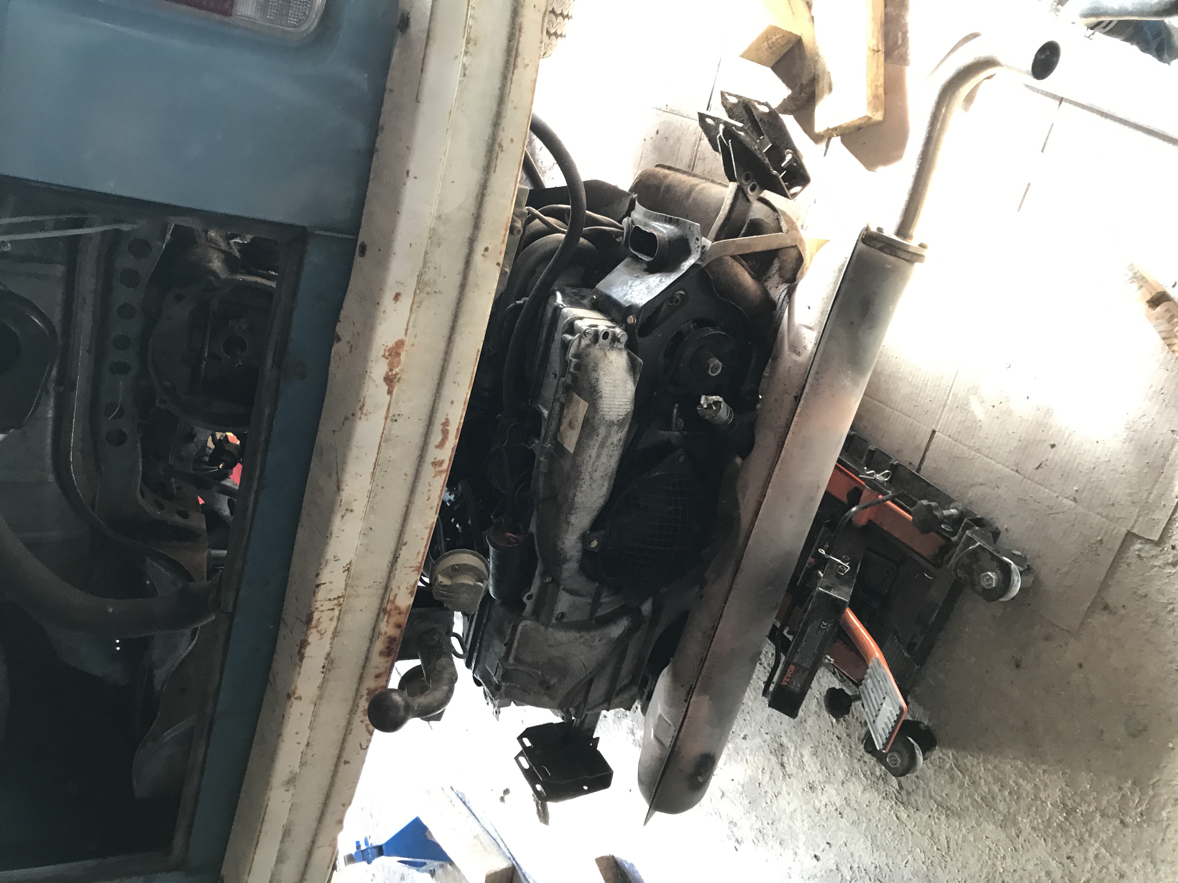

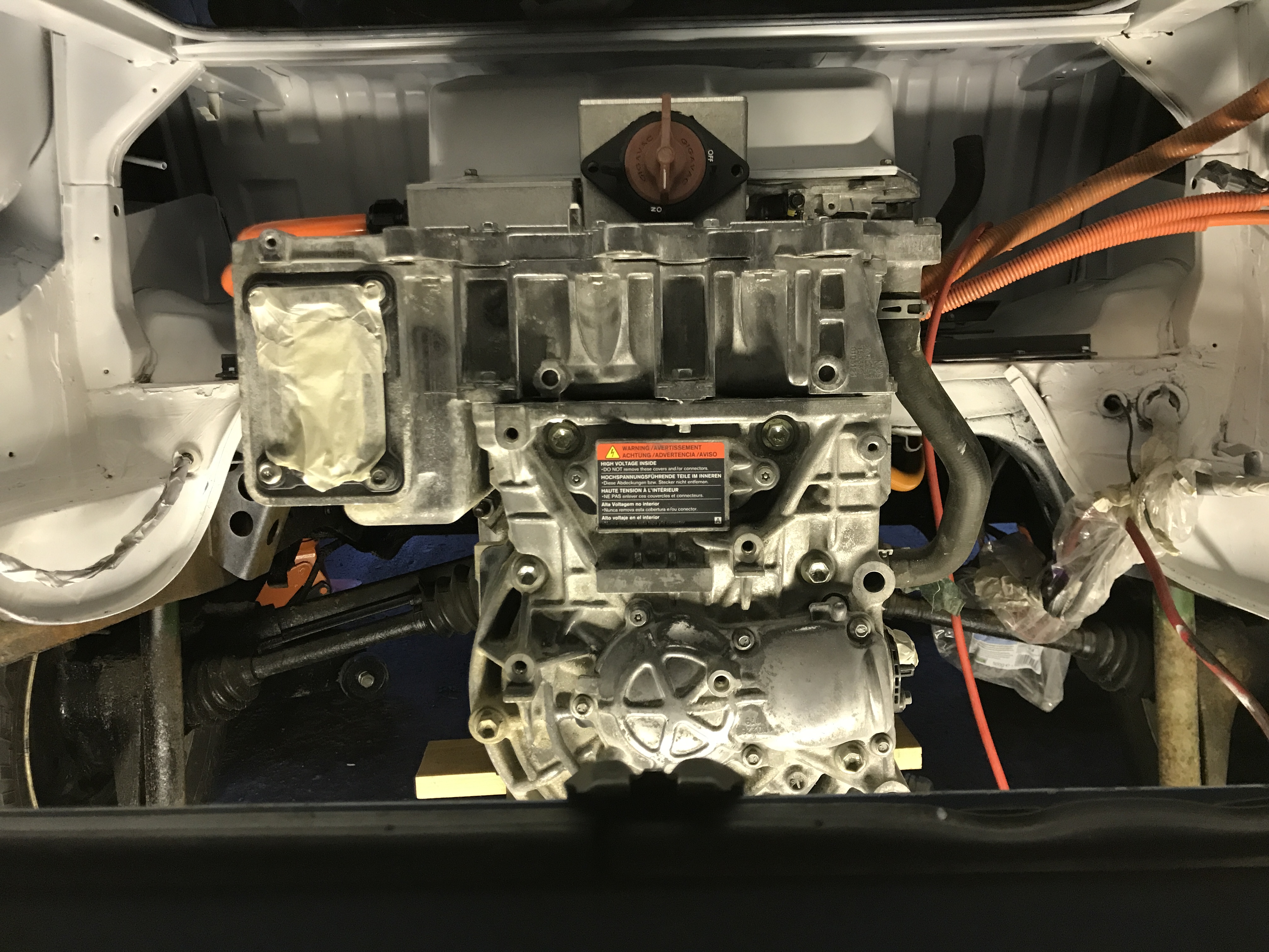

Out with the old, in with the new…
That’s the motor in place with a nice fit on the coupler (ignore yesterday’s panic attack!)
PDM does fit, despite what I thought early on in the build. The challenge is the cables, but they can be adjusted to avoid hitting the inverter. I’ve modified the way they are held by brackets.
One of the tight points is the coolant hose, which isn’t visible but runs from the top right corner of the inverter and is fed from the right hand side of the PDM (im flowing back to front through the PDM in my arrangement). Tight, but ok.
Need to tighten up bolts on the Brat adaptor plates once I’m happy with it all. I also need to create a top box to manage the HV between inverter and PDM now they are separated.
Then the original support bar that held the back of the vw engine goes back, but now with lovely new rubber mounts to replace the decrepit old ones. Then need to create a bracket to go between motor and support bar. Then, then, then….etc.

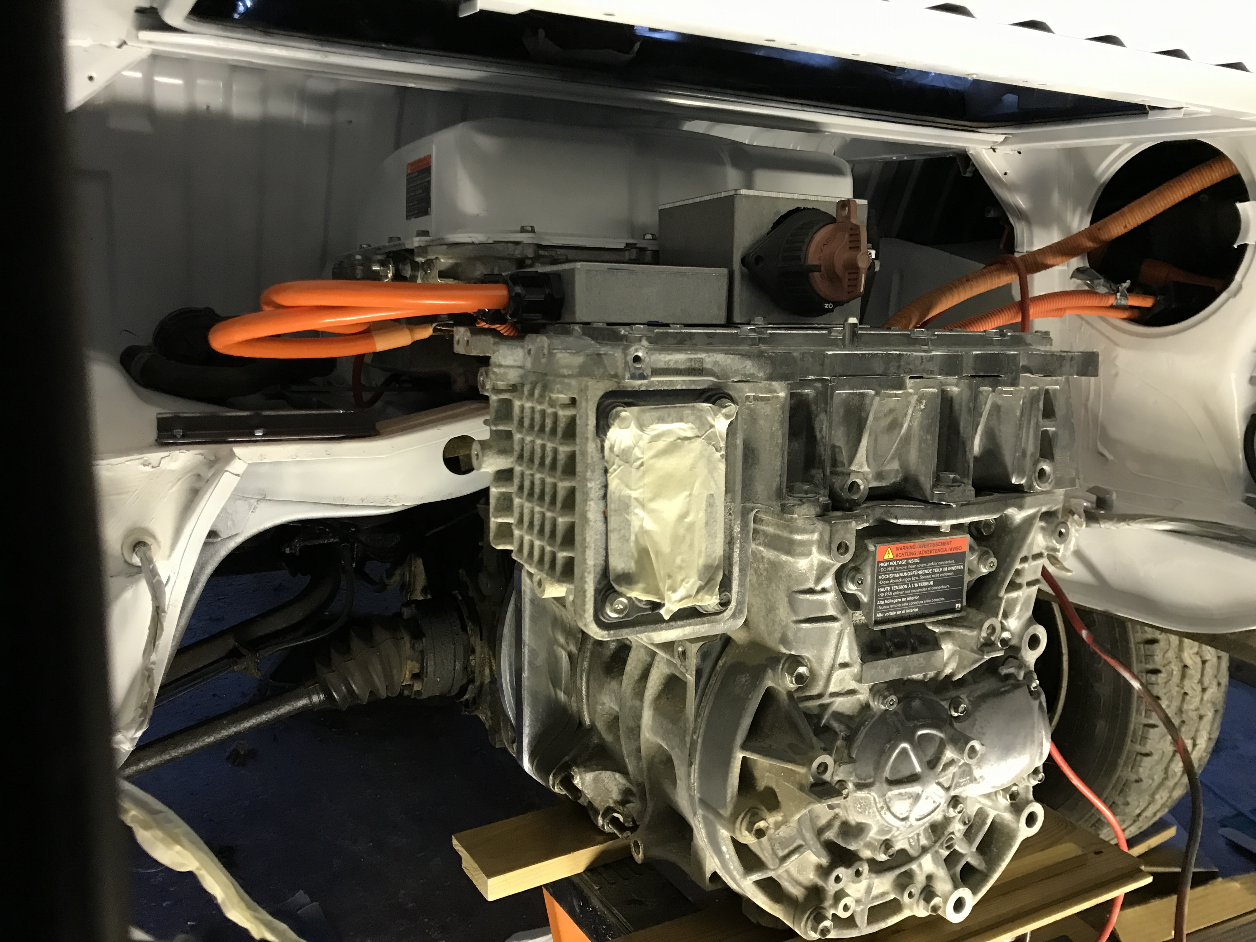

Re: [WIP] Leaf to VW Type 2 Campervan
No. That’s not what I’m saying.
The PDM is separate from the inverter/motor.
The PDM physically fits into the fuel tank space. It is orientated 90deg to normal.
But the height of the top of the inverter, when mounted with the motor, using your adaptor plates is very close.
The closeness is not due to the PDM ‘box’ itself, but there’s a potential for the cables that exit the PDM to clash with the top edge of the inverter.
Early on in my build I’d commented about this. The post yesterday was confirming my plan is possible.
But it requires some ‘tweaking’. All the cables still exit from the PDM standard locations, but I have adjusted the Nissan brackets and cable management to make them avoid the inverter with the way I’ve arranged it.
I’ll do a side photo soon, maybe later that should clarify.

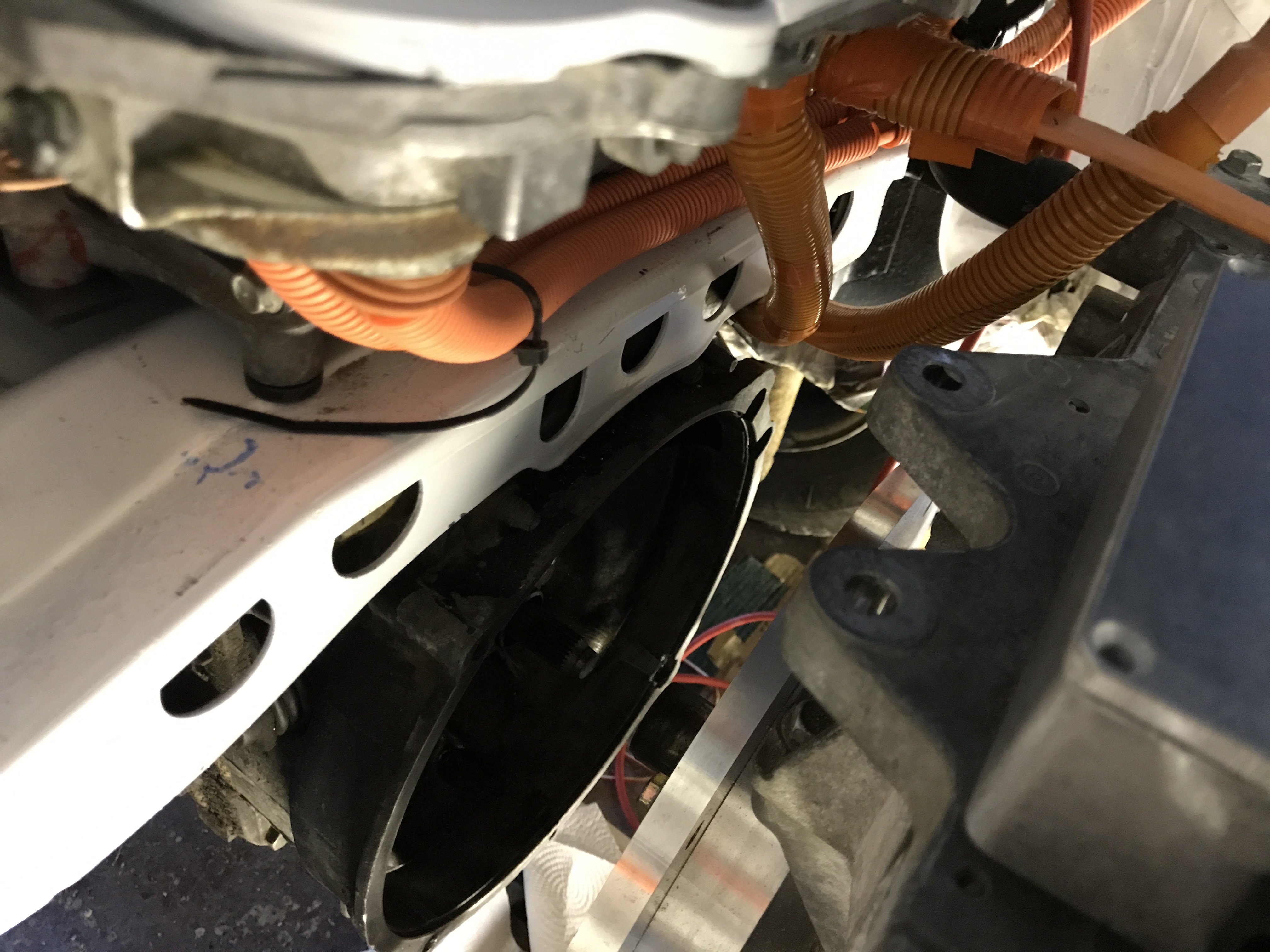

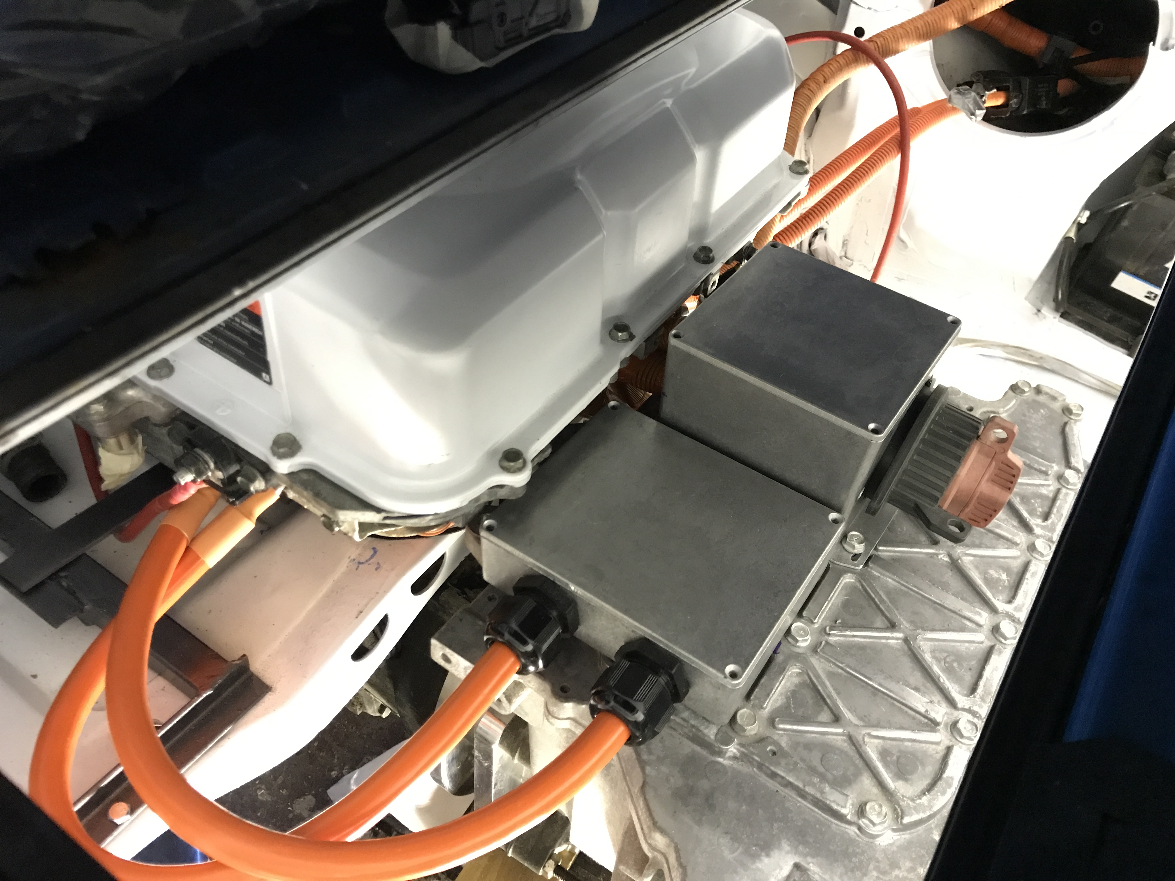

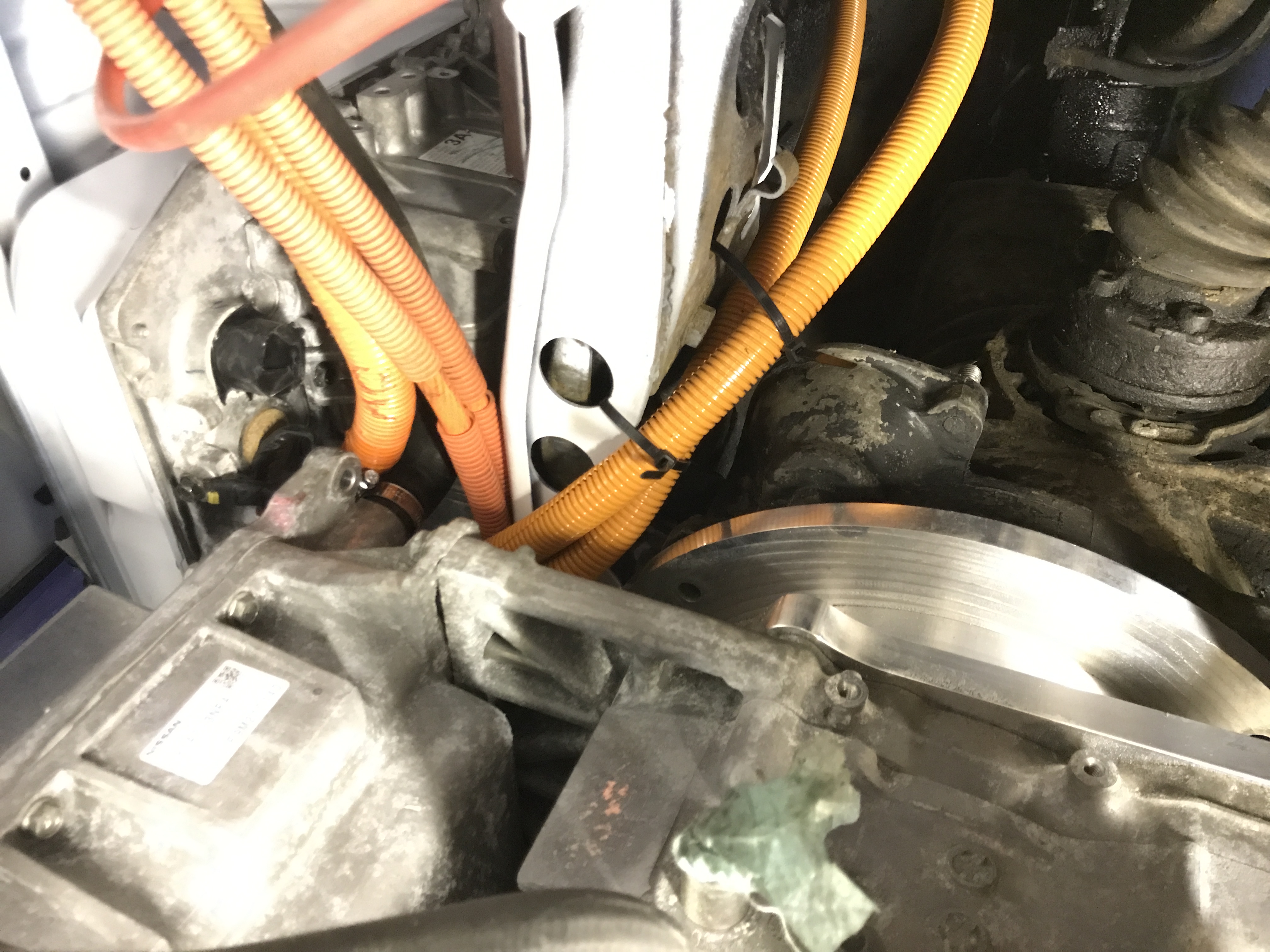

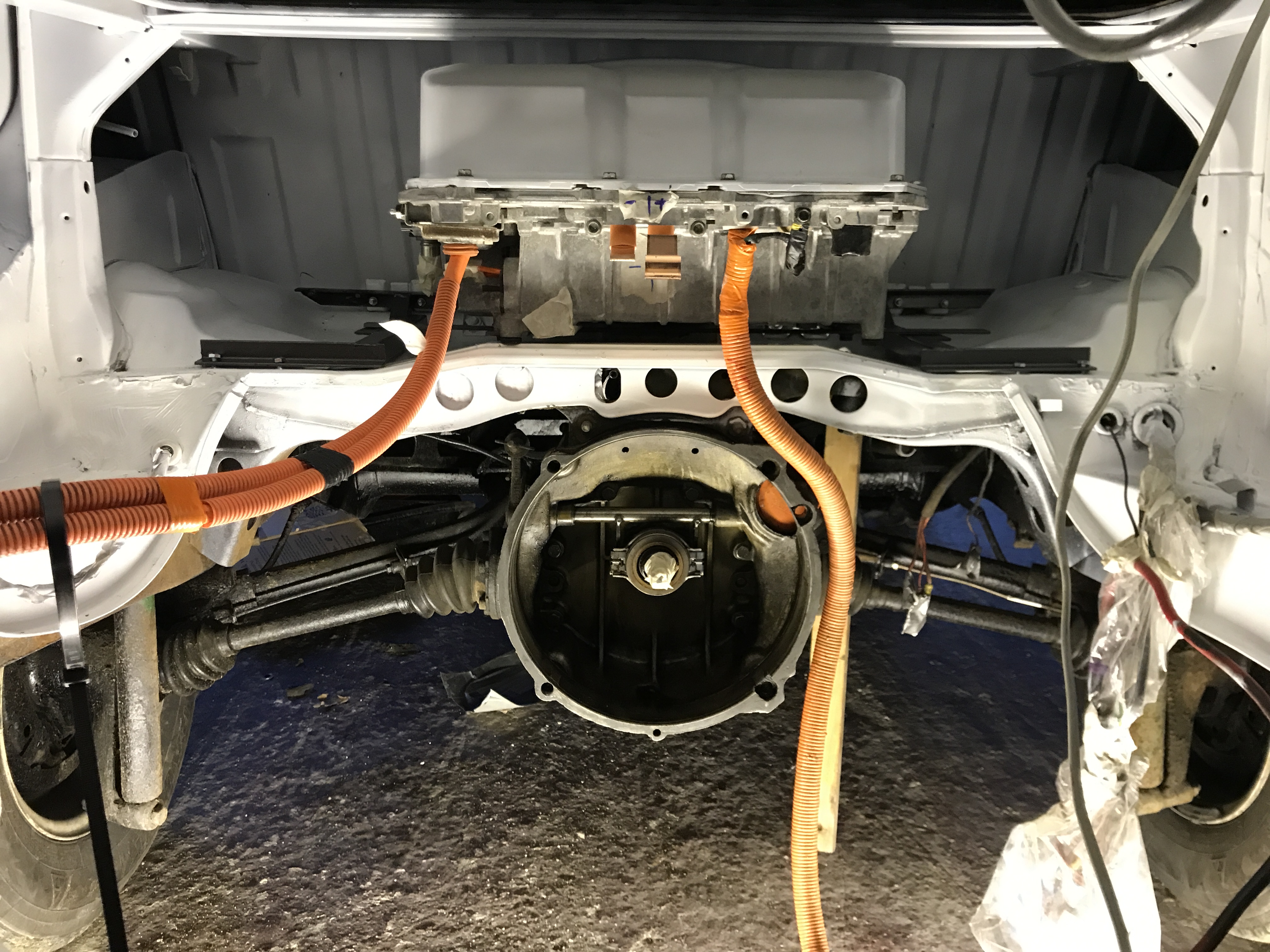

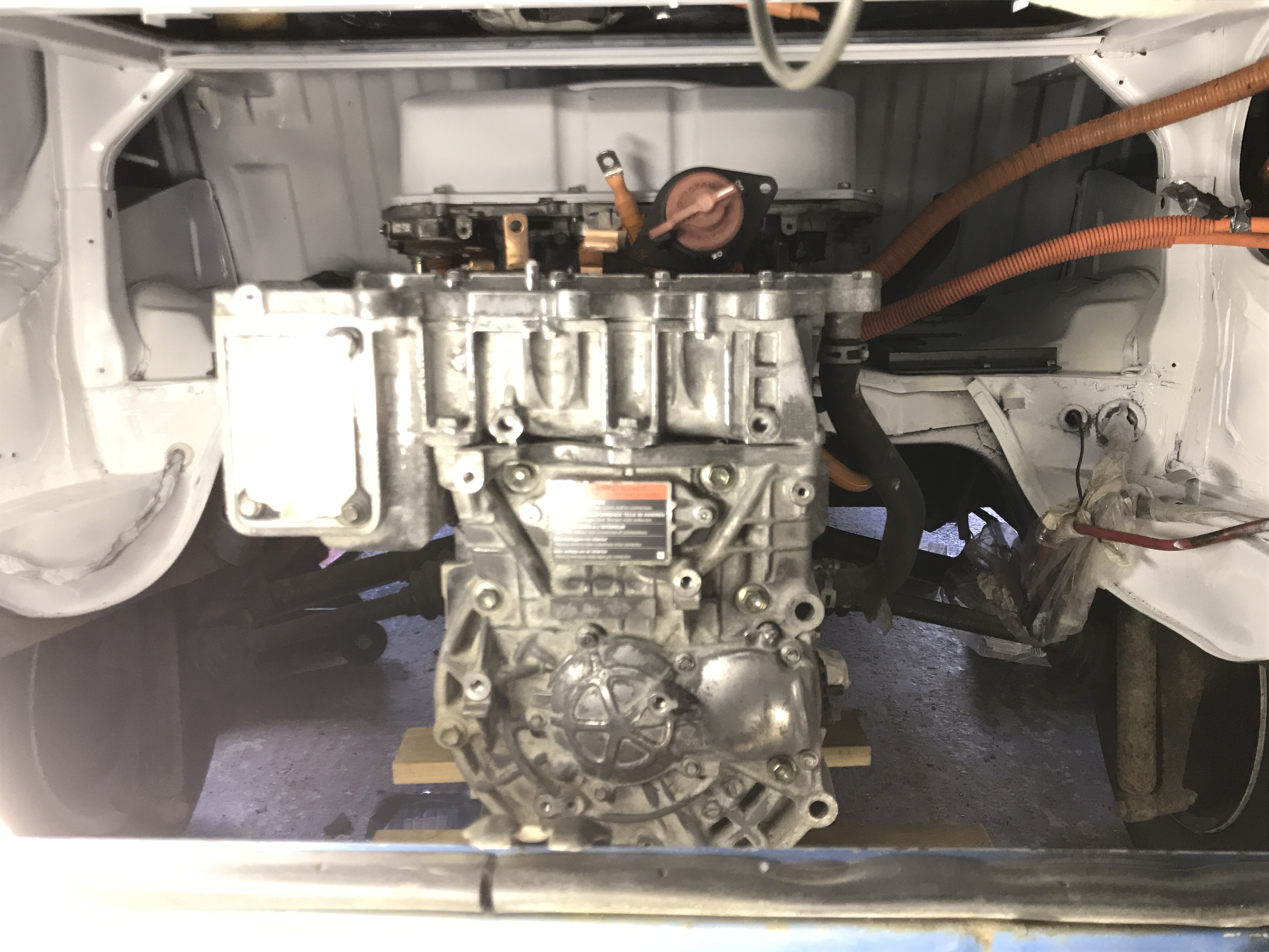

Some more images to better explain what’s what…
(Still WIP, some loose ends)
Slight side angle. Shows the PDM sat on the shelf where the fuel tank was. Top view through the engine hatch that later T2s have…
Photos above are with motor mounted to vw transmission, and all is fine. But this next one shows how close it is with a small gap before final mounting…
I’ll do more down below images once things are a bit tidier, but here’s one from the right hand side. Bottom 2 cables are heading off to the battery. Top 3 are the AC and DC charge cables. (Enlarge image if it’s showing the wrong way round)
Last one. Is it just me, or does this beasty look a bit ominous?

No the PDM does not fit on top of the inverter. If that was possible I wouldn’t have been doing all this juggling. The only way that I could come up with is what I’ve shown. By being placed in the fuel tank space it is actually slightly lower than if it was on top of the inverter.
The main service disconnect is still mid way in the battery pack. But it’s about as accessible as it is in a Leaf - not easy to get to in a hurry. In the event of a problem, I want something easy for me or emergency workers to break the circuit. That switch breaks the HV on the way to the battery from the PDM.

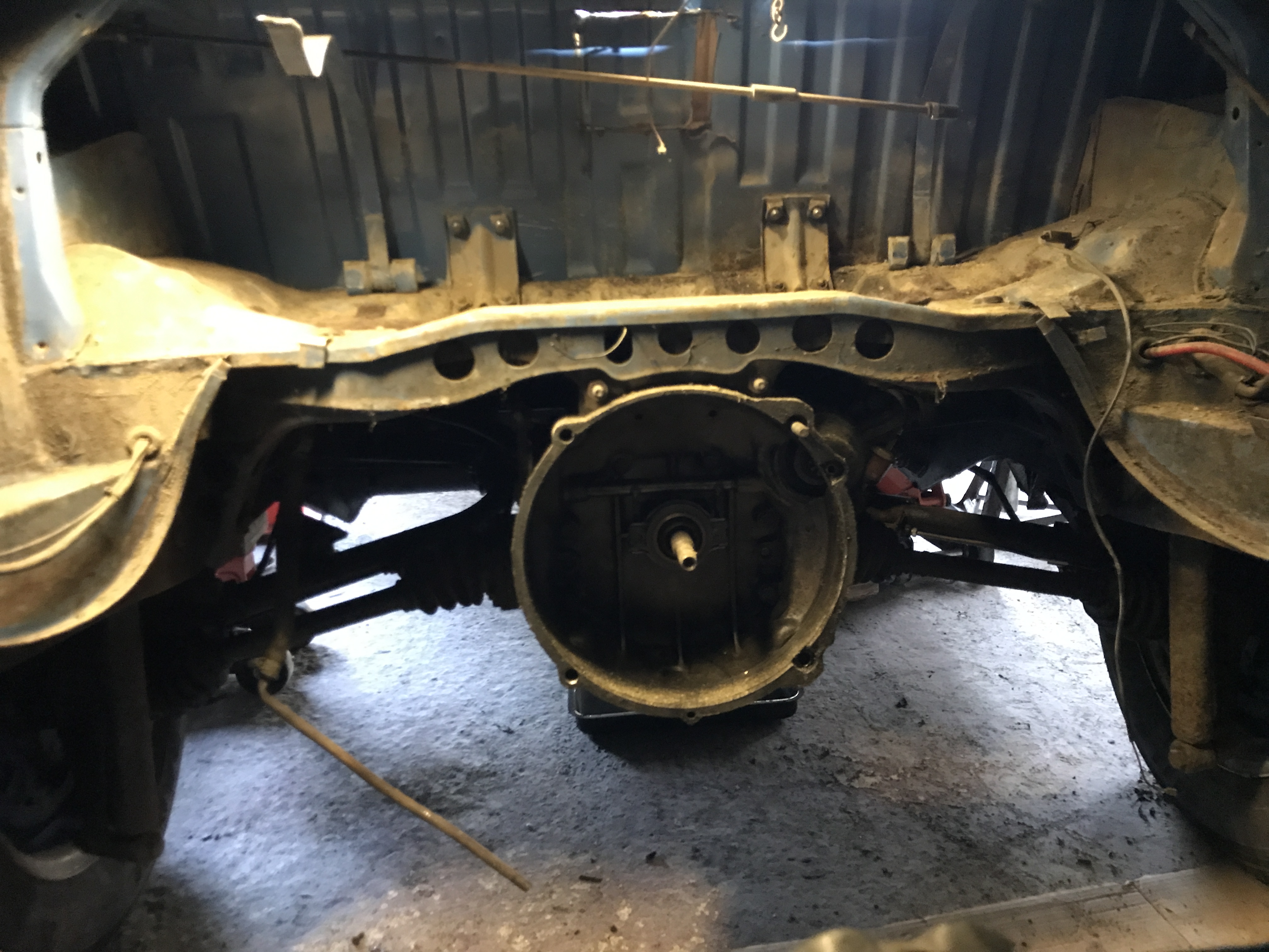

Image is a bad picture up front showing the existing servo. Vacuum line runs 2m back behind the camera to the engine bay.

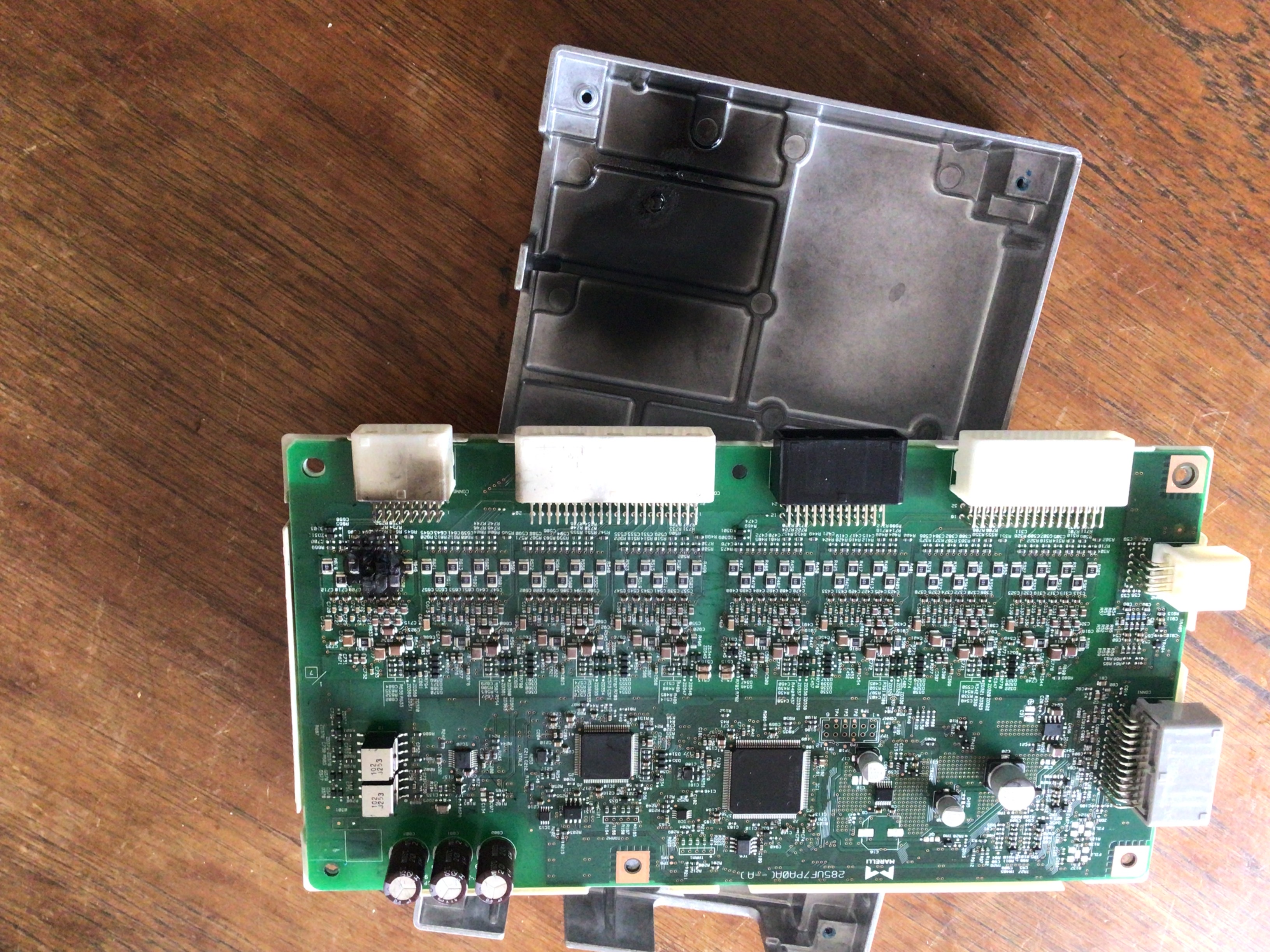

Let the smoke out…
Not happy. Bad enough it happened at all, but I know a 60kWh Leaf BMS is going to be hard to find - unless the reverse engineering of Leaf BMSs is relevant here and I might be able to use a 24.
Will recap what I did wrong when I’ve wiped away the tears.
Edit - hilariously, this post has just elevated my status to ‘engineer’ according to the forum’s algorthym! I beg to differ.
I think the 24kwh bms has been reverse engineered and it's possibly to flash new firmware on it, so possible to work with a different pack. There has been some alluding to this on the forum.

Anyone know if swapping in a BMS from a 30kWh battery (I have a workong one, but low SOH) into my 60kWh pack (both leaf OEM batteries) would work enough to let me get the bus running? I wouldn’t expect accurate SOC, but if it allowed all the internal checks to be passed and the system start up and run ok, it would let me prove everything else is valid while I source a 60kWh BMS.
As a quick solution BMS30 will do, you can also unsolder 93S86 the unit will count SOH100%

I would appreciate advice to confirm my understanding of the leaf BMS and HV paths.
My confidence took a bash when I stupidly messed up (plugging in BMS before HV wiring completed). But it’s leading me back to basics to make sure I understand before I repeat plugging in the replacement BMS.
Sanity check…
When we have a standard leaf battery, and with the service disconnect removed, there is no risk of HV causing an overload in the BMS. But why is this? The cell taps are running back to the BMS, so the HV positive (up to about 180 volts on each half) is potentially there. At what point does the BMS connect to the HV negative to create a circuit? The contactors make the circuit, and link the battery to the motor stack, by going to the PDM.
In my setup, it is physically a different shape to the Leaf battery, but logically the same, with all the original modules, service disconnect and contractor unit located as Nissan intended.
The voltages on each module, and cumulatively across each half of the battery (either side of the disconnect) are as I would expect (approx 180V each side currently) They match what I documented when the modules were all in situ in the leaf battery case before dissection.
What further test can I do before I go the final step and connect the BMS? How can I be sure I won’t create an unwanted circuit through the BMS? Could faulty contactors create an unwanted HV circuit through the BMS? How should I test that?
In normal operation, how does the BMS operate safely with the HV?
I know it is a mistake to have the service disconnect in a non-standard position. But I have not done this. As far as I can tell I have a logically correct setup.
I’m basically just really nervous having reached this stage. If anyone wants to correct anything I just said or point out something obvious I should or shouldn’t do, much appreciated.
Sanity check…

Look at where your BMS blew up, check all the cell voltages on that connector to a known pinout. The negative stays in place while measuring all other voltages to find a missing wire or a break in your HV circuit.
This clearly looks to be a cell tap mix up to me form the photos of the damage.
The BMS is indeed the last thing you plug in. You need to wire up the HV between the modules before doing so.

Correct - I found I had plugged modules 15 and 16 (16 is the final one) back to front. The burnt area is the connector for them. But equally it was premature for me to have the BMS plugged in at all at that stage.
It is interesting that you can identify that from the image. What are you seeing?
Yes, all HV modules are now connected. I just need to be sure that no unwanted HV will go through the BMS. So I’m keen to make sure I understand how the BMS works safely in normal operation to make sure I’m recreating that correctly.
