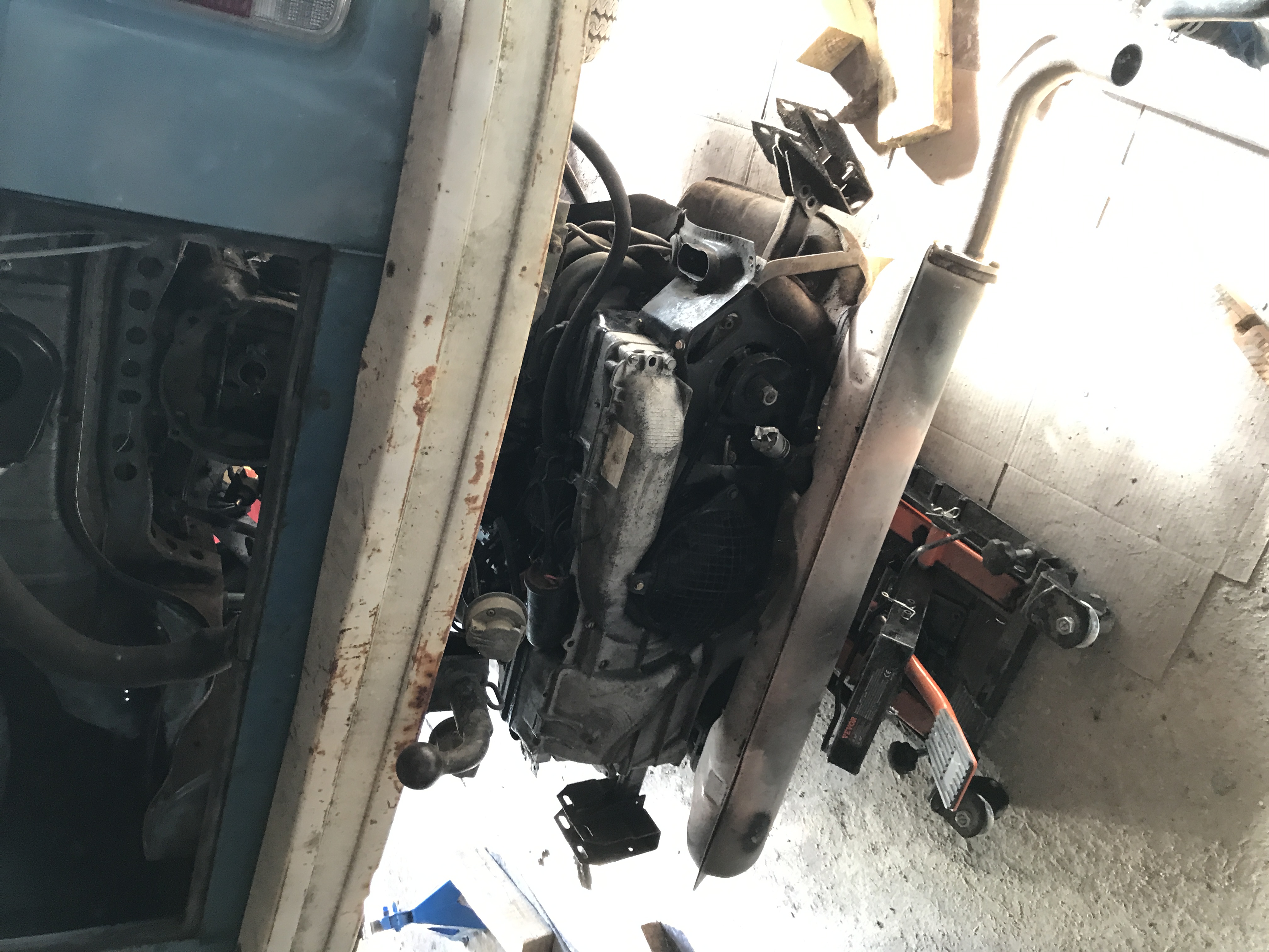

Out with the old, in with the new…
That’s the motor in place with a nice fit on the coupler (ignore yesterday’s panic attack!)
PDM does fit, despite what I thought early on in the build. The challenge is the cables, but they can be adjusted to avoid hitting the inverter. I’ve modified the way they are held by brackets.
One of the tight points is the coolant hose, which isn’t visible but runs from the top right corner of the inverter and is fed from the right hand side of the PDM (im flowing back to front through the PDM in my arrangement). Tight, but ok.
Need to tighten up bolts on the Brat adaptor plates once I’m happy with it all. I also need to create a top box to manage the HV between inverter and PDM now they are separated.
Then the original support bar that held the back of the vw engine goes back, but now with lovely new rubber mounts to replace the decrepit old ones. Then need to create a bracket to go between motor and support bar. Then, then, then….etc.

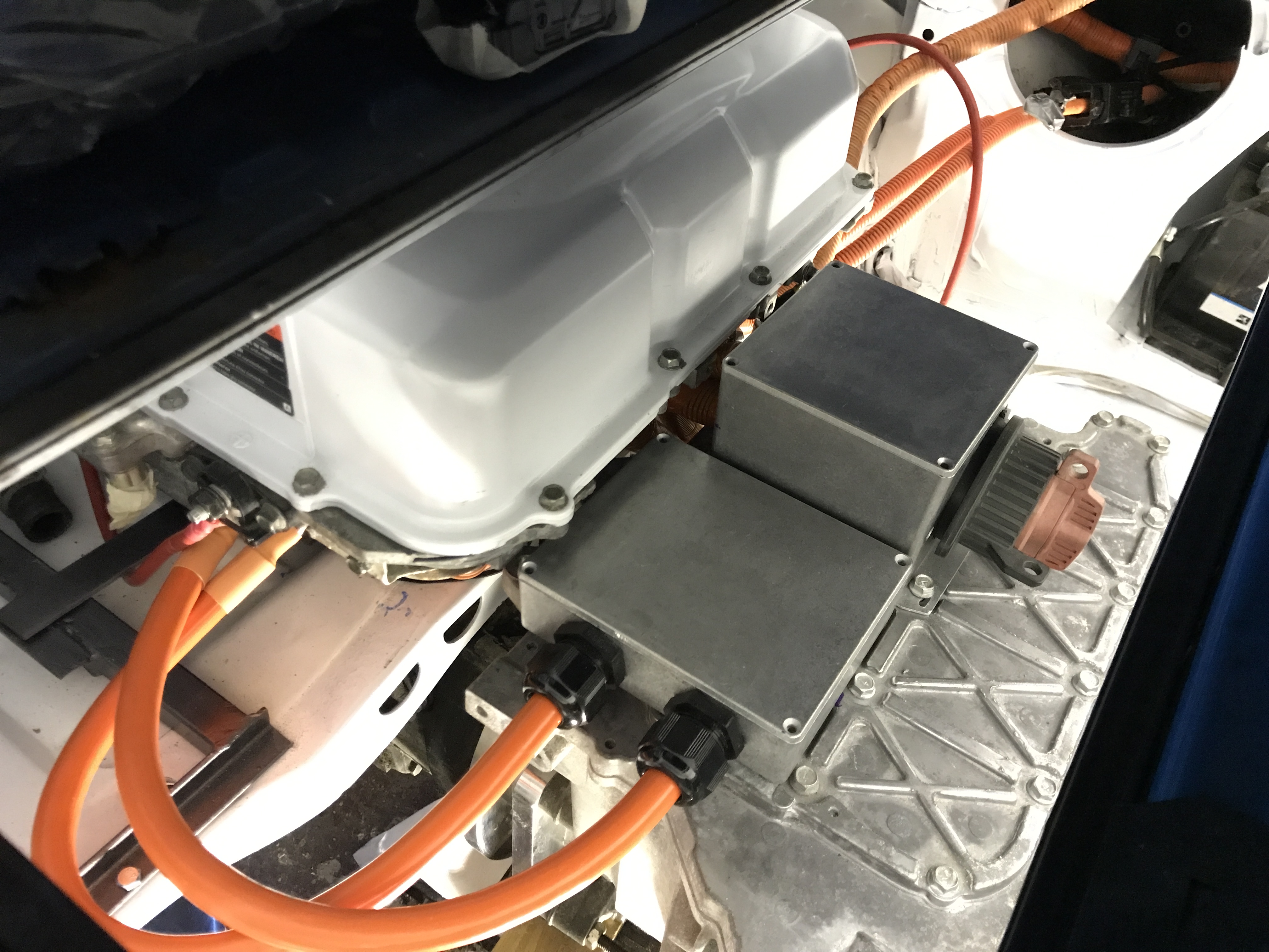

No. That’s not what I’m saying.
The PDM is separate from the inverter/motor.
The PDM physically fits into the fuel tank space. It is orientated 90deg to normal.
But the height of the top of the inverter, when mounted with the motor, using your adaptor plates is very close.
The closeness is not due to the PDM ‘box’ itself, but there’s a potential for the cables that exit the PDM to clash with the top edge of the inverter.
Early on in my build I’d commented about this. The post yesterday was confirming my plan is possible.
But it requires some ‘tweaking’. All the cables still exit from the PDM standard locations, but I have adjusted the Nissan brackets and cable management to make them avoid the inverter with the way I’ve arranged it.
I’ll do a side photo soon, maybe later that should clarify.

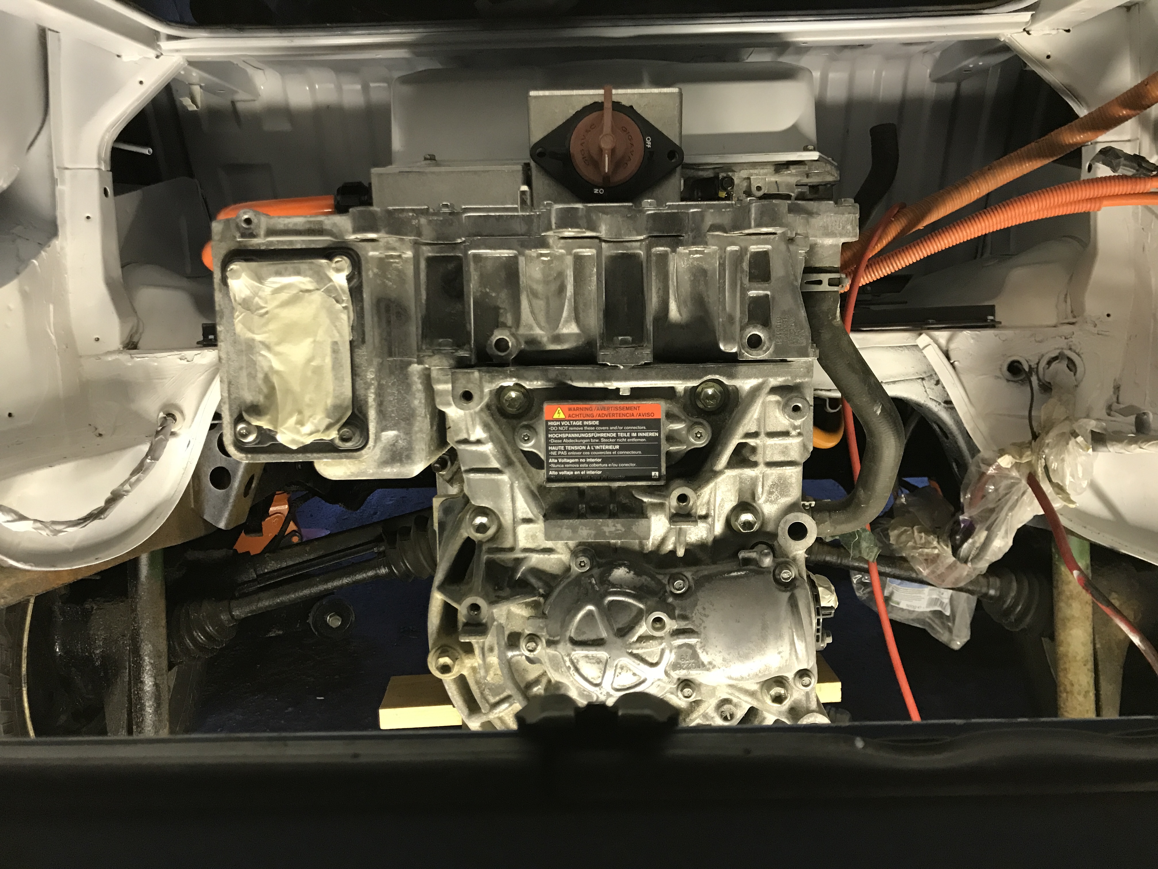

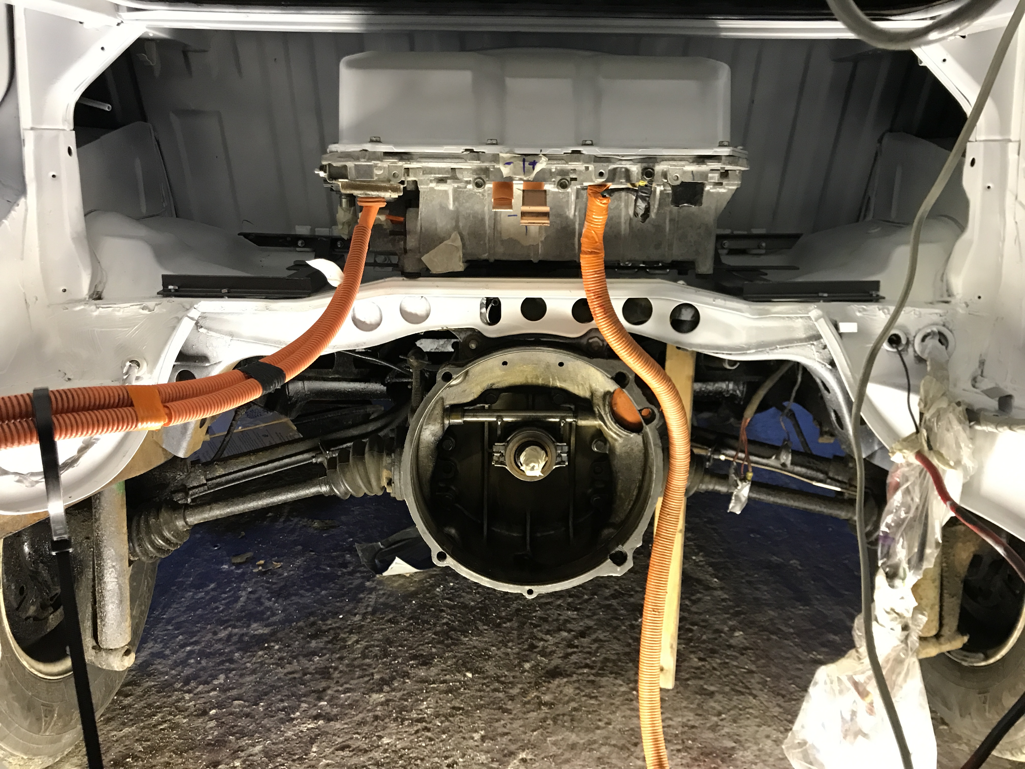

Some more images to better explain what’s what…
(Still WIP, some loose ends)
Slight side angle. Shows the PDM sat on the shelf where the fuel tank was.
Top view through the engine hatch that later T2s have…

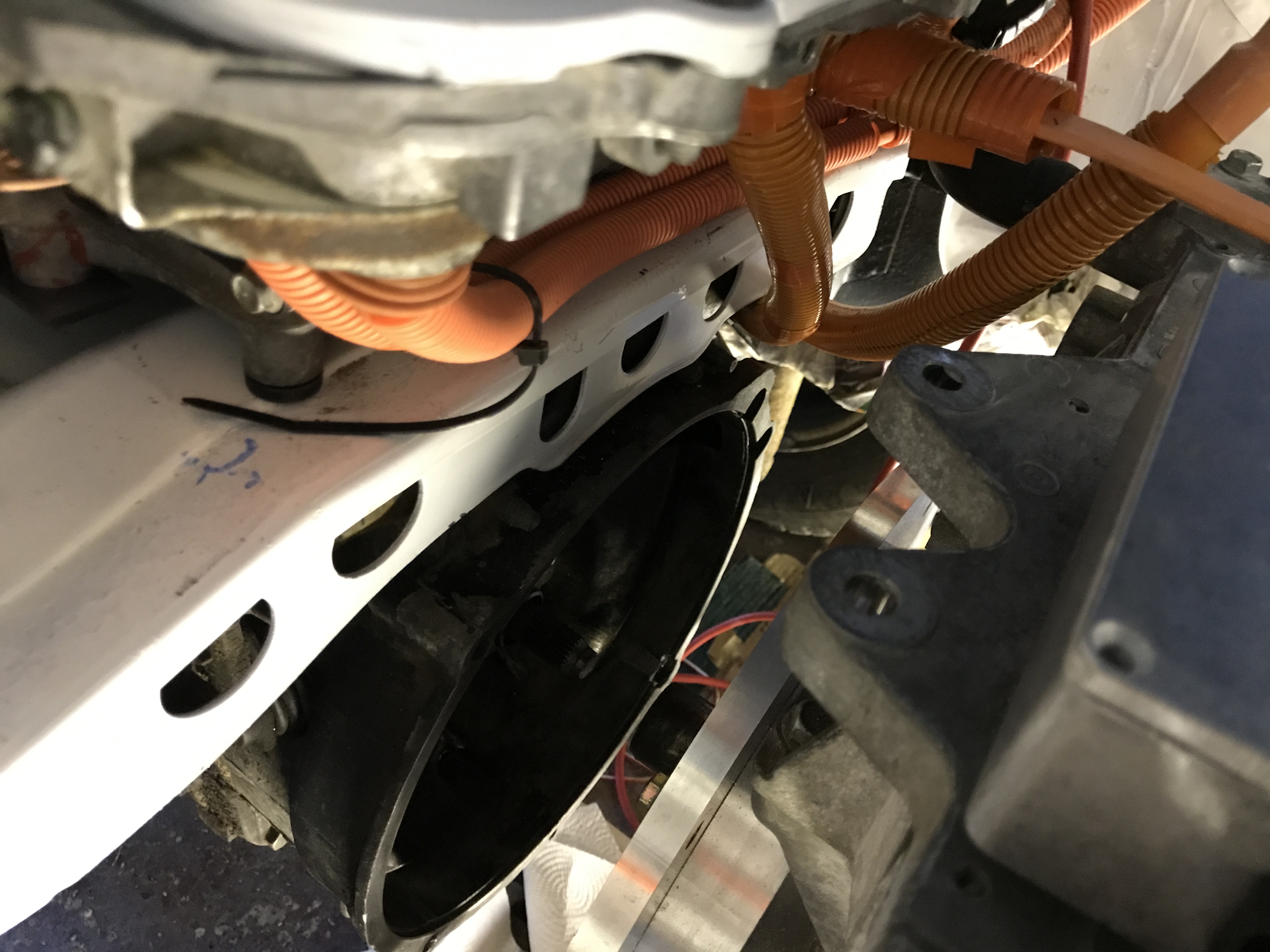

Photos above are with motor mounted to vw transmission, and all is fine. But this next one shows how close it is with a small gap before final mounting…
I’ll do more down below images once things are a bit tidier, but here’s one from the right hand side. Bottom 2 cables are heading off to the battery. Top 3 are the AC and DC charge cables. (Enlarge image if it’s showing the wrong way round)
Last one. Is it just me, or does this beasty look a bit ominous?

but dose the pdm fit on top in it original position on top of the inverter regardless of cables?
also why is your hv disconnect ontop of the motor?
ianlighting
Posts: 184
Location: Uk
Has thanked: 162 times
Been thanked: 89 times
Re: [WIP] Leaf to VW Type 2 Campervan
Post by ianlighting »
Bratitude wrote: Sat Mar 15, 2025 8:02 pm but dose the pdm fit on top in it original position on top of the inverter regardless of cables?
No the PDM does not fit on top of the inverter. If that was possible I wouldn’t have been doing all this juggling. The only way that I could come up with is what I’ve shown. By being placed in the fuel tank space it is actually slightly lower than if it was on top of the inverter.
The main service disconnect is still mid way in the battery pack. But it’s about as accessible as it is in a Leaf - not easy to get to in a hurry. In the event of a problem, I want something easy for me or emergency workers to break the circuit. That switch breaks the HV on the way to the battery from the PDM.

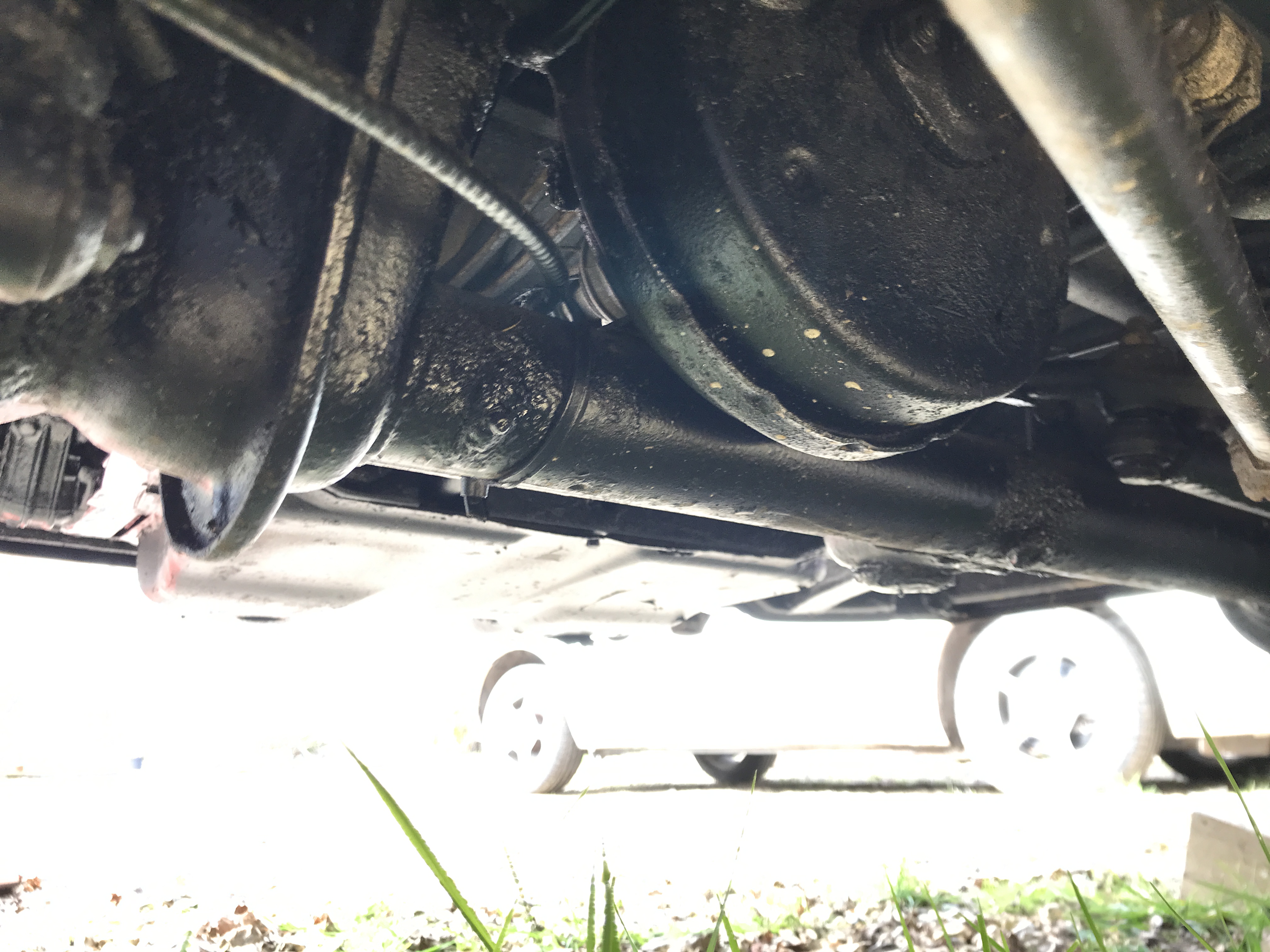

I need to ponder how to do my brake vacuum. Brake booster vs vacuum pump. There’s a decent write of up the options here, courtesy of Brat Industries…
https://bratindustries.net/electric-bra ... atsun-720/
If I had time, I’d investigate the quieter booster option, but I’m behind my ideal schedule and really want to get the bus on the road for summer. So I plan to go for the easier to implement vacuum pump. I can always come back to it the future.
So that decided, I need to think about where to position the new bits - pump, valves, sensors etc. There’s plenty of videos of people playing with this - think AliBro did one and a Bobby Come Lately, plus others I’m sure.
The thing with the VW is the brake servo and cylinder are located up front near the front wheels. Although I’m accepting the intermittent grinding whining noise of the pump every so often, I would prefer it if it was not under my seat! That noise would probably bug me after a while.
So can I make use of the existing vacuum line that runs back to the engine bay, about 2 meters away and hide the gubbins back there?
Any reason why that’s a bad idea? Does the 2m of vacuum line between the pump and the master cylinder introduce reduced performance?
Also need to think about whether I just need a pump and have that feed the existing vw brake servo (that’s separate to the master cylinder), or whether I need a separate vacuum reservoir aswell. If I need a separate reservoir that’s another thing I’d probably prefer to put at the back where the engine bay is.
Image is a bad picture up front showing the existing servo. Vacuum line runs 2m back behind the camera to the engine bay.

You are thinking my way :D I also did the minimum on the vacuum system just to minimize the time there and prioritizing other areas first. I took the Volvo vacuum switch and vag vacuum pump route.
1) the brake booster is a vacuum reservoir by itself already, I don't get why people add additional reservoirs, to have the pump running longer periods of time less frequently? Anyways, it shouldn't matter where in line you would have the reservoir. (With the assumption that you don't have flow restrictors in the system (i.e. changing hose diameters etc.)
2) Any length of hose between the pump and brake booster can be just considered as vacuum reservoir volume. In theory what the added length between the pump and booster is likely to give you is delay on vacuum pressure build up speed. Is that going to be noticeable in normal driving conditions, probably not.
3) Pressure switch/sensor should be as close as possible to the brake booster to minimize time delay for pressure signal.
Since you are not taking this to the track, the possible delays on the vacuum build up speed shouldn't really matter in normal driving conditions. And you can always move the pump closer to the booster then, if you don't jump the gun and go all in with the i-booster then :)

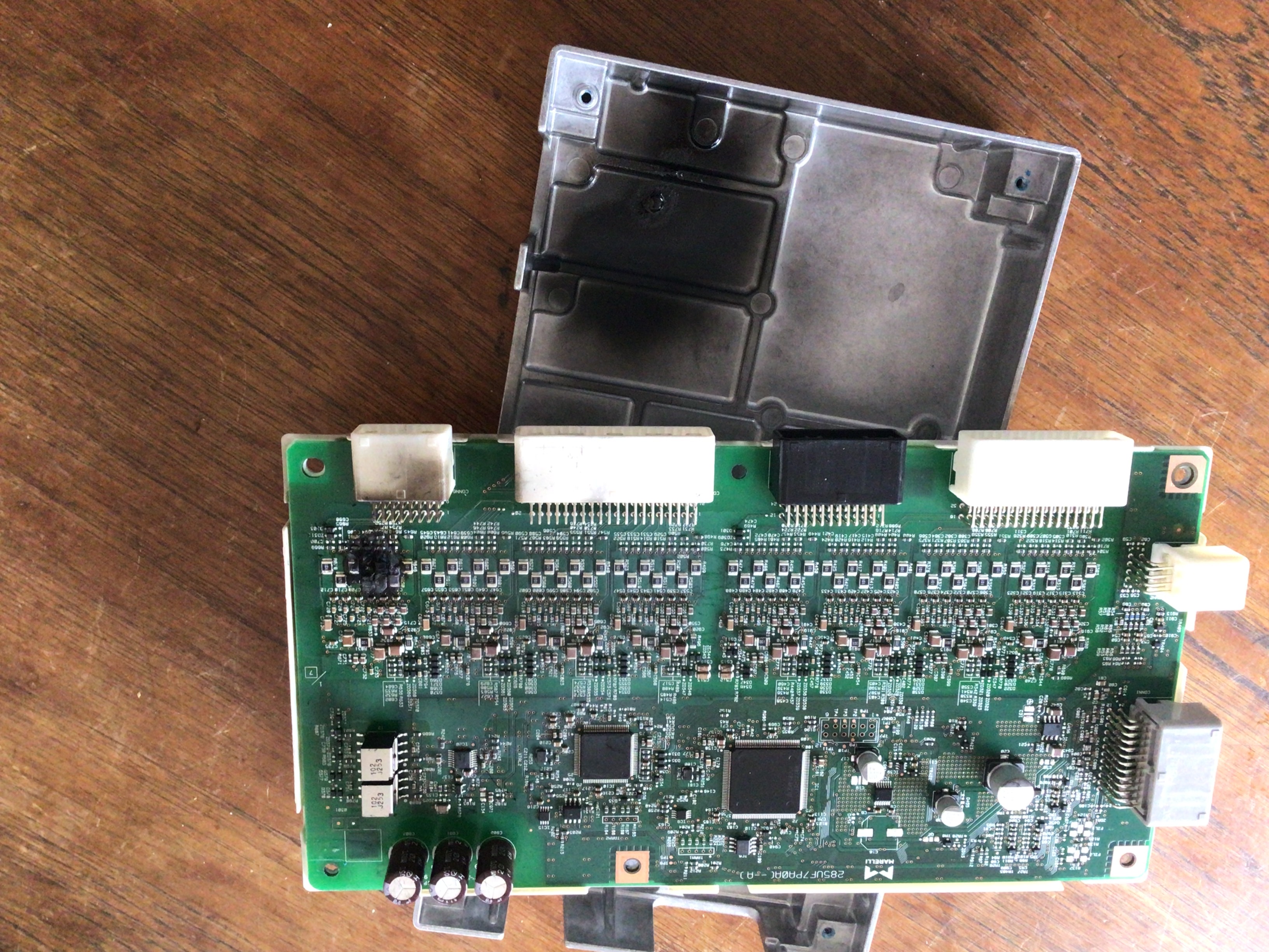

Let the smoke out…
Not happy. Bad enough it happened at all, but I know a 60kWh Leaf BMS is going to be hard to find - unless the reverse engineering of Leaf BMSs is relevant here and I might be able to use a 24.
Will recap what I did wrong when I’ve wiped away the tears.

What further test can I do before I go the final step and connect the BMS? How can I be sure I won’t create an unwanted circuit through the BMS? Could faulty contactors create an unwanted HV circuit through the BMS? How should I test that?
In normal operation, how does the BMS operate safely with the HV?
I know it is a mistake to have the service disconnect in a non-standard position. But I have not done this. As far as I can tell I have a logically correct setup.
I’m basically just really nervous having reached this stage. If anyone wants to correct anything I just said or point out something obvious I should or shouldn’t do, much appreciated.

Look at where your BMS blew up, check all the cell voltages on that connector to a known pinout. The negative stays in place while measuring all other voltages to find a missing wire or a break in your HV circuit.
This clearly looks to be a cell tap mix up to me form the photos of the damage.
The BMS is indeed the last thing you plug in. You need to wire up the HV between the modules before doing so.
tom91 wrote: Sun Apr 06, 2025 11:34 am
Correct - I found I had plugged modules 15 and 16 (16 is the final one) back to front. The burnt area is the connector for them. But equally it was premature for me to have the BMS plugged in at all at that stage.
It is interesting that you can identify that from the image. What are you seeing?
Yes, all HV modules are now connected. I just need to be sure that no unwanted HV will go through the BMS. So I’m keen to make sure I understand how the BMS works safely in normal operation to make sure I’m recreating that correctly.
