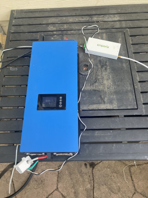

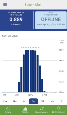

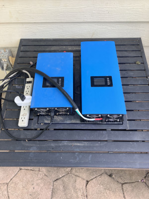

so a bit of an update and a new discovery, I keep pushing the envelope in search of new bottlenecks, also made an arbitrary goal of 10 kWh of energy production per day
so I keep adding solar panels, 200 watt each to be exact, and I add them in pairs because I am connecting them in parallel to up the voltage, so I went from 6 panels and 1,200 watts total, to 8 panels for a total of 1,600 watts, and learned how that effects the 1,000 watt inverter
so my operating input DC voltage is 2 x 37 volts or 64 volts because the panels are in pairs aka parallel
Gregski
Posts: 3170
Has thanked: 635 times
Been thanked: 1610 times
Re: The Greg's Grid Tie Solar Project
Post by Gregski »
I know what you are thinking, how can you fit 6 gallons into a 5 gallon bucket, right?
well these inverters aint all that efficient, so you don't use 1,000 watts of solar panels to feed a 1,000 watt inverter like this one cause it will be operating at maybe 70% efficiency
that's why I decided to pump in 1,600 watts of solar panel energy into a 1,000 watt inverter, and here's what happened
FYI, the specs on this SUN grid tie inverter claim 92% efficiency and yes there is a discrepancy of what it claims it is doing on it's little LCD display and what the Emporia smart plug graph shows below
we flattened the bell curve so we hit a limit and are leaving energy on the table sort of speak
don't mind that it says OFFLINE I have it on a sunrise sunset schedule so the Emporia smart plug powers itself off and back on

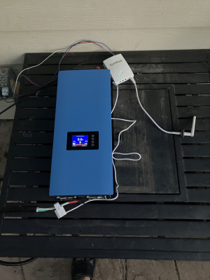

so it was time for an upgrade... to a 2,000 watt 240 volt animal
Note that Emporia does not make 240 volt smart plugs so we have to switch to their Vue Monitor and use a hall effect current sensor

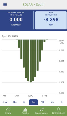

so here is a first look at a production graph with eight 200 watt solar panels (1,600 watts) feeding into a 2,000 watt 240v inverter
Note: no need to adjust your monitors, Emporia the company who makes the smart plugs and the Vue monitor and software that I use to provide these graphs changed how they display solar production to now be upside down, so blue right side up is consumption and green upside down is solar production, I won't lie to you at first I thought I installed the hall effect current sensor on backwards, but it do the same thing clipped on either way, and I confirmed this with their Tech Support
now we see a nice pointy tip at the top of the upside down bell curve, valley curve? something like that

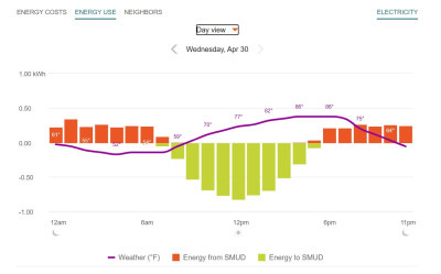

ha ha, indeed, I think that is the trend these days as here is a graph from my city electric company, and although we are looking at a different day, you can also see that when I am sending them my electricity the green part of the graph is upside down

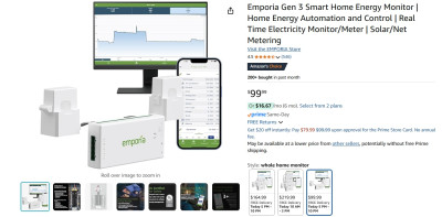

so just picked up one of these Emporia Gen 3 Monitors for myself and my baby brother to monitor our solar, these have way stronger WiFi signals than just suing the plugs, and it works great for him since his inverter is in a shed on the side of the house, I am thinking of picking up yet another one for our mums house
these also unlike just the Smart Plugs actually recognize if your energy is coming or going, so they don't show solar as consumption in blue but as production in green, good times
FYI they finally discontinued support for their Gen 1 product line so I advice you don't buy those used on eBay any more, at least jump in at Gen 2 if buying used

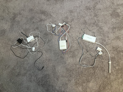

Mandatory Stare and Compare
from left to right all three Gens of the Emporia monitors

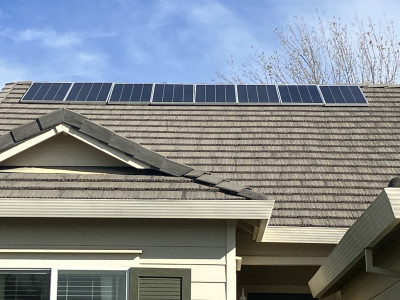

Post by Gregski »

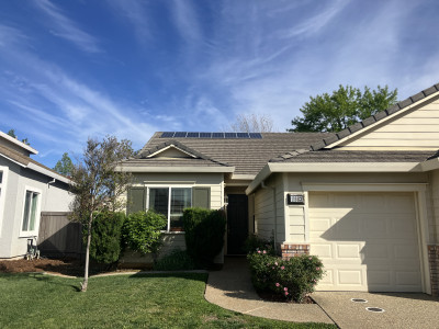

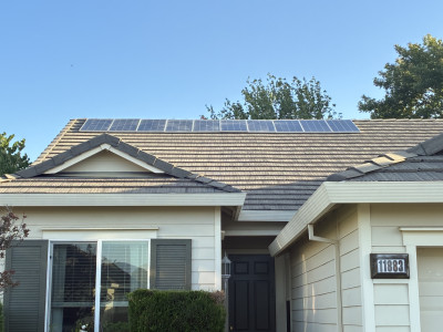

added two more 200 watt panels for a total of ten, now we have 2,000 watts of solar panels feeing into a 2,000 watt inverter, they are connected in pairs, so there are five pairs in parallel, and I can't wait to see how much energy that generates, hoping for at least 10 kWh per day
Total System Cost so far: $2,500(ish)
(yes I tried to wash them with Windex last night when I added the two additional panels on the right)
hell yeah 10 kWh of Sunergy
