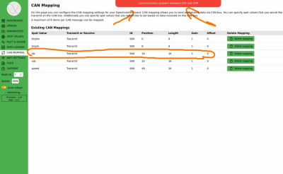

So..... I was doing the CAN mappings for the motor and inverter. I saved the mappings and turned off the car and turned it back on.
The screen was not showing the SOC anymore and the voltage was 309V instead of 369V.
2nd BMS was blinking slow and when I looked it is MUXSHORT...

Can mappings work for the inverter. at least first 2 and 4th. To test the other 3 and 5 I need to drive the car.
Now even if the BMS does not have the correct voltage for the battery, I am taking the battery voltage from the inverter (udc) and is showing the correct value of 369V.
I will post all files as they are, tonight after work.

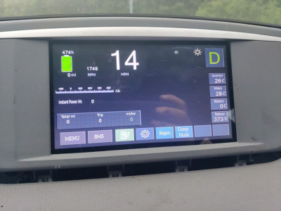

It fits in place of the other screen perfectly. the other screen was also a 7".
Not liking the colors and how you can see from different angles.
In the future I am going to test a DWIN screen. problem is that it uses a different software then Nextion and I am going to leave it as is for now.
DWIN is also $40 cheaper on Amazon.
Pictures are not good either. in reality is it is a lot better.
Closeup.

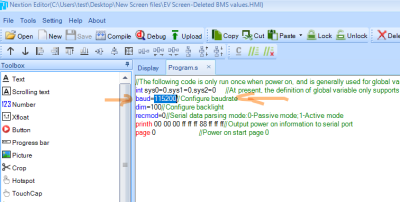

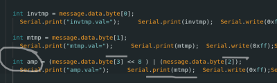

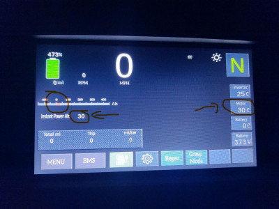

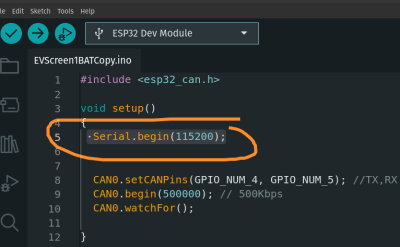

Not sure what am I doing wrong . All can messagess I pulled so far work except the Amps/idc. the battey percentage also changed in the latest BMS code.
Now instead of 47% I am getting 474 which I guess is 47.4% because that is approximately what my soc battery should be based on the 373V. Before I was only getting 2 numbers for the percentage. I could modify the screen to display only 2 numbers but then I can never display 100%. I can go only to 99%, ant at 100% will display 10%.
I then modified the arduino code to display the motor temp instead of amps and it displays the motor temp. So either idc is not the right value for the AMPs used or the CAN mapping for this value does not work for some reason.
Not sure if it is related, but once I put the ignition on I lose the connection to the inverter or the bms boards from the esp32.
but, at the same time the other mapings form the inverter work fine. like RPM, inverter temp, motor temp.

to get decimals in nextion you have to use the float element in nextion editor

Thing is it worked before changing the bms with a different software version, and I do not need 3 numbers for the charge. 47% is good. I do not want to see 47.4%PetersonOctavius wrote: ↑Fri Jun 27, 2025 4:48 am to get decimals in nextion you have to use the float element in nextion editor
UPDATE:
I had to divide by 1000 to only get 2 digits.

So finaly all thing I need on the screen to drive are there but the data fom CAN is coming in very slow about 3-5 seconds behind.
@johu can the CAN data be refreshed faster?
Once I turn the ignition on i lose the connecting to the esp32 or the esp32 cannot connect to the inverter and BMS, or my laptop cannot connect to the ESP32. the CAN data still comes in.
I turned of the 12v for the ESP32 and I am getting the CAN data but is still slow.

So it is not the BMS that is slow. I disconnected the BMS and got the same results. Screen still slow. not sure what it is.
- Proton
- Posts: 312
- Location: Georgia/US
- Has thanked: 185 times
- Been thanked: 47 times
UPDATE:
Problem was the baud rate for the Nextion display. Now the display updates instantly. From what I've been reading 155200 is the fastest the screen can do.
