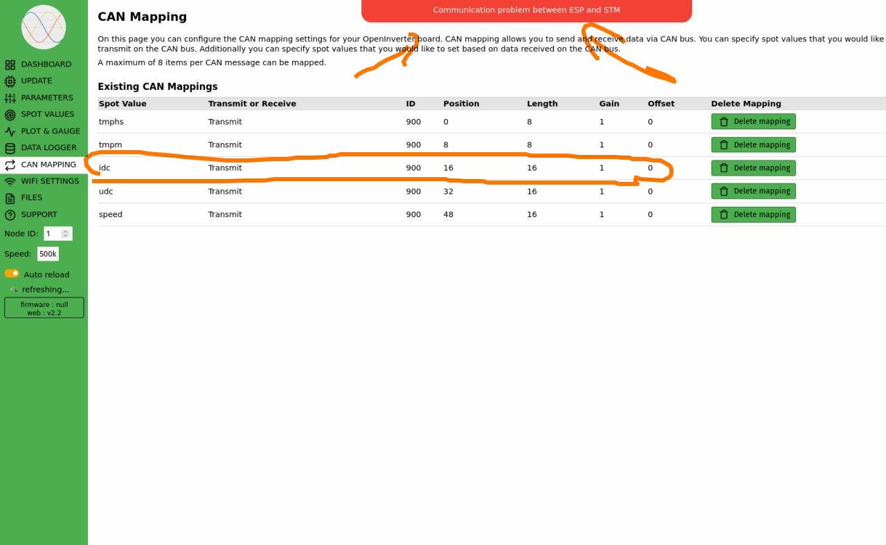

Not sure what am I doing wrong . All can messagess I pulled so far work except the Amps/idc. the battey percentage also changed in the latest BMS code.
Now instead of 47% I am getting 474 which I guess is 47.4% because that is approximately what my soc battery should be based on the 373V. Before I was only getting 2 numbers for the percentage. I could modify the screen to display only 2 numbers but then I can never display 100%. I can go only to 99%, ant at 100% will display 10%.
I then modified the arduino code to display the motor temp instead of amps and it displays the motor temp. So either idc is not the right value for the AMPs used or the CAN mapping for this value does not work for some reason.
Not sure if it is related, but once I put the ignition on I lose the connection to the inverter or the bms boards from the esp32.
but, at the same time the other mapings form the inverter work fine. like RPM, inverter temp, motor temp.

to get decimals in nextion you have to use the float element in nextion editor
Proton
Posts: 306
Location: Georgia/US
Has thanked: 184 times
Been thanked: 43 times
Post by Proton »
PetersonOctavius wrote: Fri Jun 27, 2025 4:48 am to get decimals in nextion you have to use the float element in nextion editor
Thing is it worked before changing the bms with a different software version, and I do not need 3 numbers for the charge. 47% is good. I do not want to see 47.4%
