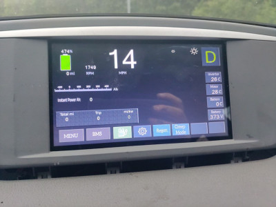

For monitoring i have a 5inch nextion display with an ESP32 reading from the canbus and displaying on the nextion display.
I wrote a basic arduino code like :
If canbus available check for the id
If id is (for example) 0x1Dsend the value to the serial bus which is connected to the nextion dislay.
Current and voltage are being read straight from the isa shunt
Gear, tmphs, rpm are sent from the vcu (in your case that would be from your imverter board) via custom can mapping

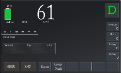

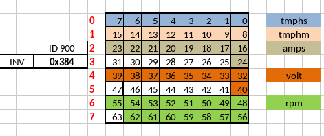

I have to thank @PetersonOctavius for starting me and helping me on this project. I will open another separate thread to post the current files in case anybody wants to use them. they work for nextion 5" and 7" screens. both have a 800x480 displays. mine is the 7" version.
The screen still has the plastic on it so it is a little washed out.
This was done in Excel but if anybody is good at Photoshop, it can be made to look a lot better.
- Proton
- Posts: 301
- Location: Georgia/US
- Has thanked: 184 times
- Been thanked: 43 times
I am going to try to finish the CAN mapings for the motor. inverter, battery temperature temperature and RPM, next 2 days and then I will post the files.
I was trying for a new look in Photoshop but that is going to take a while.

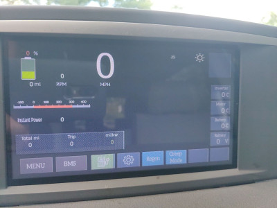

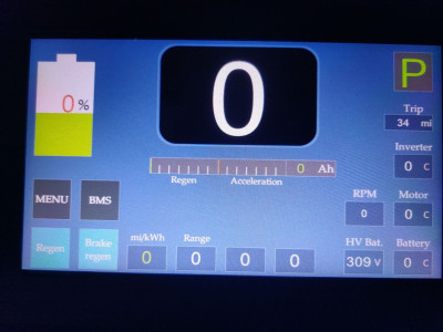

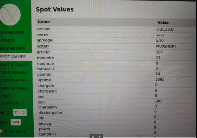

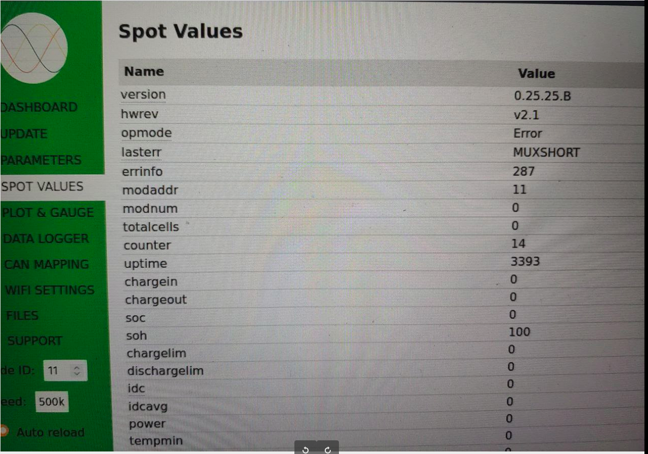

So..... I was doing the CAN mappings for the motor and inverter. I saved the mappings and turned off the car and turned it back on.
The screen was not showing the SOC anymore and the voltage was 309V instead of 369V.
2nd BMS was blinking slow and when I looked it is MUXSHORT...
- Proton
- Posts: 301
Can mappings work for the inverter. at least first 2 and 4th. To test the other 3 and 5 I need to drive the car.
Now even if the BMS does not have the correct voltage for the battery, I am taking the battery voltage from the inverter (udc) and is showing the correct value of 369V.
I will post all files as they are, tonight after work.

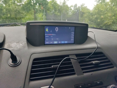

It fits in place of the other screen perfectly. the other screen was also a 7".
Not liking the colors and how you can see from different angles.
In the future I am going to test a DWIN screen. problem is that it uses a different software then Nextion and I am going to leave it as is for now.
DWIN is also $40 cheaper on Amazon.
Pictures are not good either. in reality is it is a lot better.
Closeup.
Closeup.

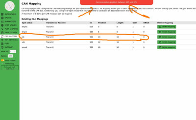

Not sure what am I doing wrong . All can messagess I pulled so far work except the Amps/idc. the battey percentage also changed in the latest BMS code.
Now instead of 47% I am getting 474 which I guess is 47.4% because that is approximately what my soc battery should be based on the 373V. Before I was only getting 2 numbers for the percentage. I could modify the screen to display only 2 numbers but then I can never display 100%. I can go only to 99%, ant at 100% will display 10%.
I then modified the arduino code to display the motor temp instead of amps and it displays the motor temp. So either idc is not the right value for the AMPs used or the CAN mapping for this value does not work for some reason.
Not sure if it is related, but once I put the ignition on I lose the connection to the inverter or the bms boards from the esp32.
but, at the same time the other mapings form the inverter work fine. like RPM, inverter temp, motor temp.
- Posts: 125
- Joined: Mon Oct 16, 2023 2:37 am
- Location: Willemstad, Curaçao
- Has thanked: 68 times
- Been thanked: 19 times
to get decimals in nextion you have to use the float element in nextion editor
