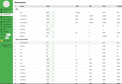

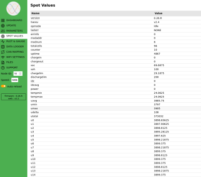

Re: Flying ADC 16 channel BMS 96S test
I installed the 2.4 BMS version.
Do I have to change any settings to start balancing the cells? Mine always show in Idle mode.
The 2.4 Version works no problems so far. still do not know how to make them balance. never seen them saying "balancing"johu wrote: ↑Tue Jul 08, 2025 7:56 am Yes worked on that, see latest commit.
You need to set param balance to both and ubal below what the cell voltage is, say 3800mV and the balancing is only carries out in state idle, which is switched to once the current from current sensor is below some treshold. Johu afaik made new params for idle state current in latest commits, if your idle current is higher than previous hardcoded treshold. If you have no current sensor you can probably force it to be idle all the time by enabling current sensor and playing with offset and adc value to show 0 or close to that.
