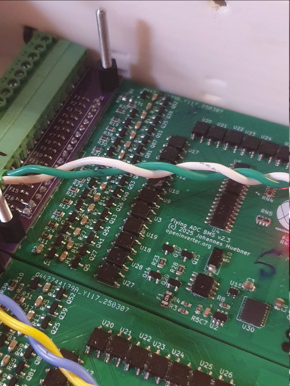

maiks wrote: Fri Jun 06, 2025 7:26 am Thank you, @johu. I just want to confirm—should I remove the components marked in red (as shown in the attached image) and replace them with 10 nF or 22 nF 0603 SMD ceramic capacitors?
see pic on my "implementation", ther resistors are beneath the caps

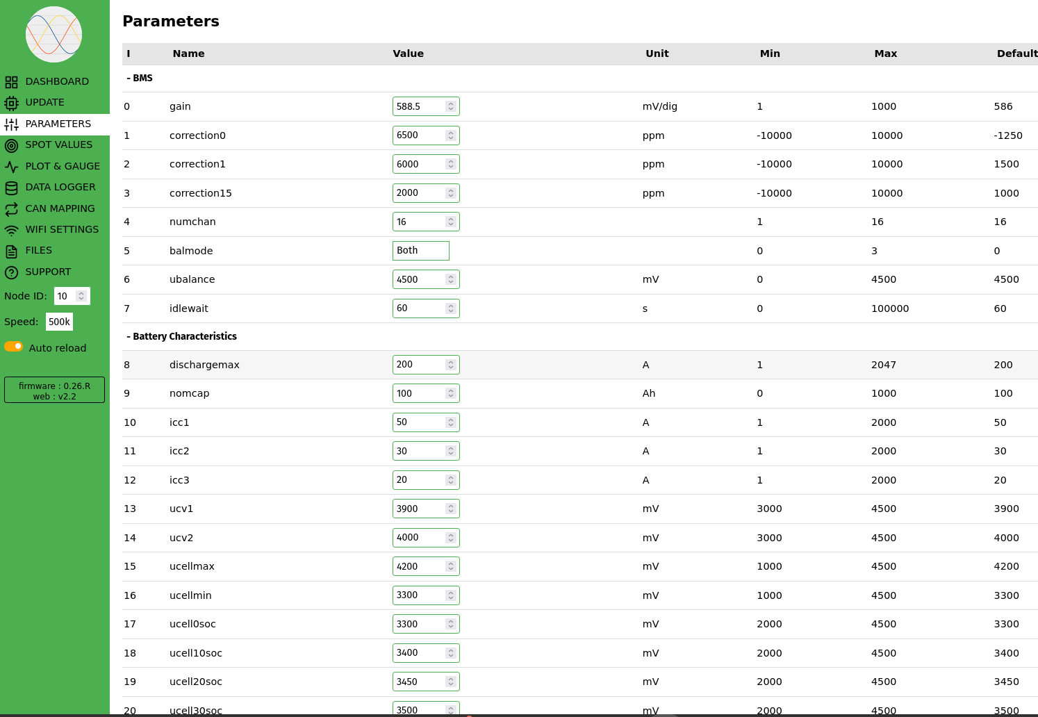

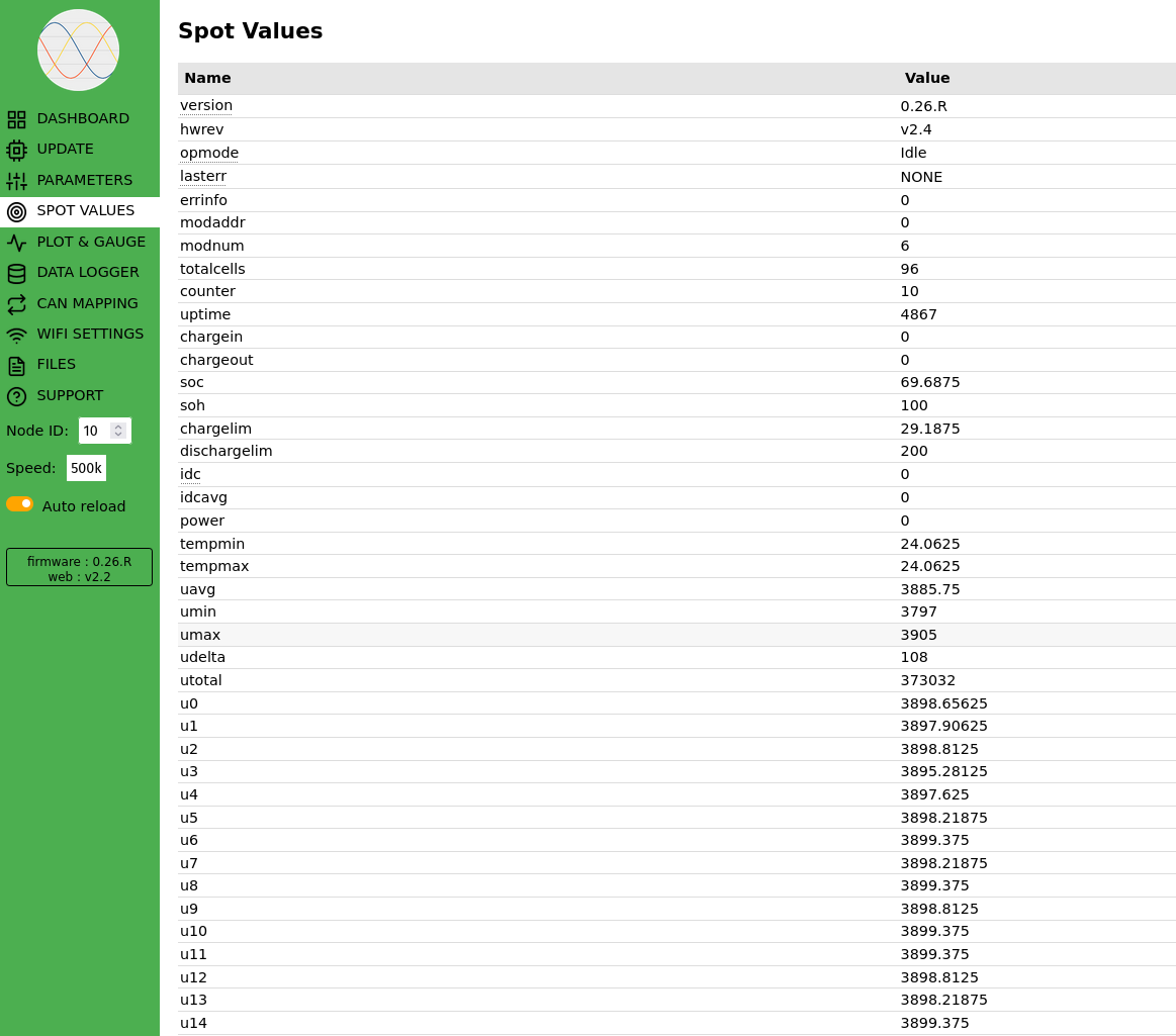

I installed the 2.4 BMS version.
Do I have to change any settings to start balancing the cells? Mine always show in Idle mode.
PetersonOctavius
Posts: 131
Location: Willemstad, Curaçao
Has thanked: 77 times
Been thanked: 21 times
Re: Flying ADC 16 channel BMS 96S test
Post by PetersonOctavius »
ubalance should be around 3700 3800

The 2.4 Version works no problems so far. still do not know how to make them balance. never seen them saying "balancing"
skr
Posts: 64
Joined: Wed Jun 01, 2022 7:11 pm
Has thanked: 14 times
Been thanked: 26 times
Post by skr »
You need to set param balance to both and ubal below what the cell voltage is, say 3800mV and the balancing is only carries out in state idle, which is switched to once the current from current sensor is below some treshold. Johu afaik made new params for idle state current in latest commits, if your idle current is higher than previous hardcoded treshold. If you have no current sensor you can probably force it to be idle all the time by enabling current sensor and playing with offset and adc value to show 0 or close to that.
