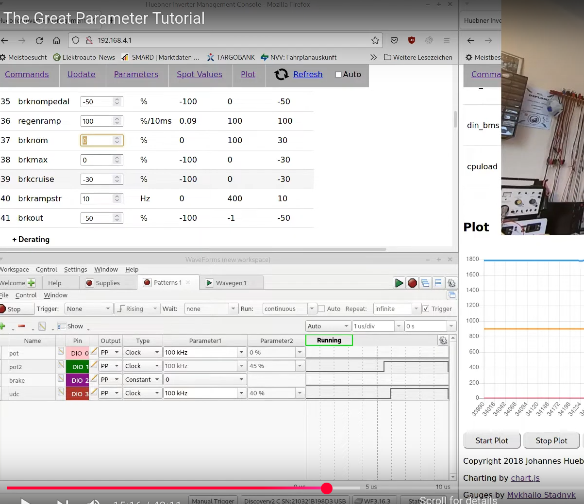

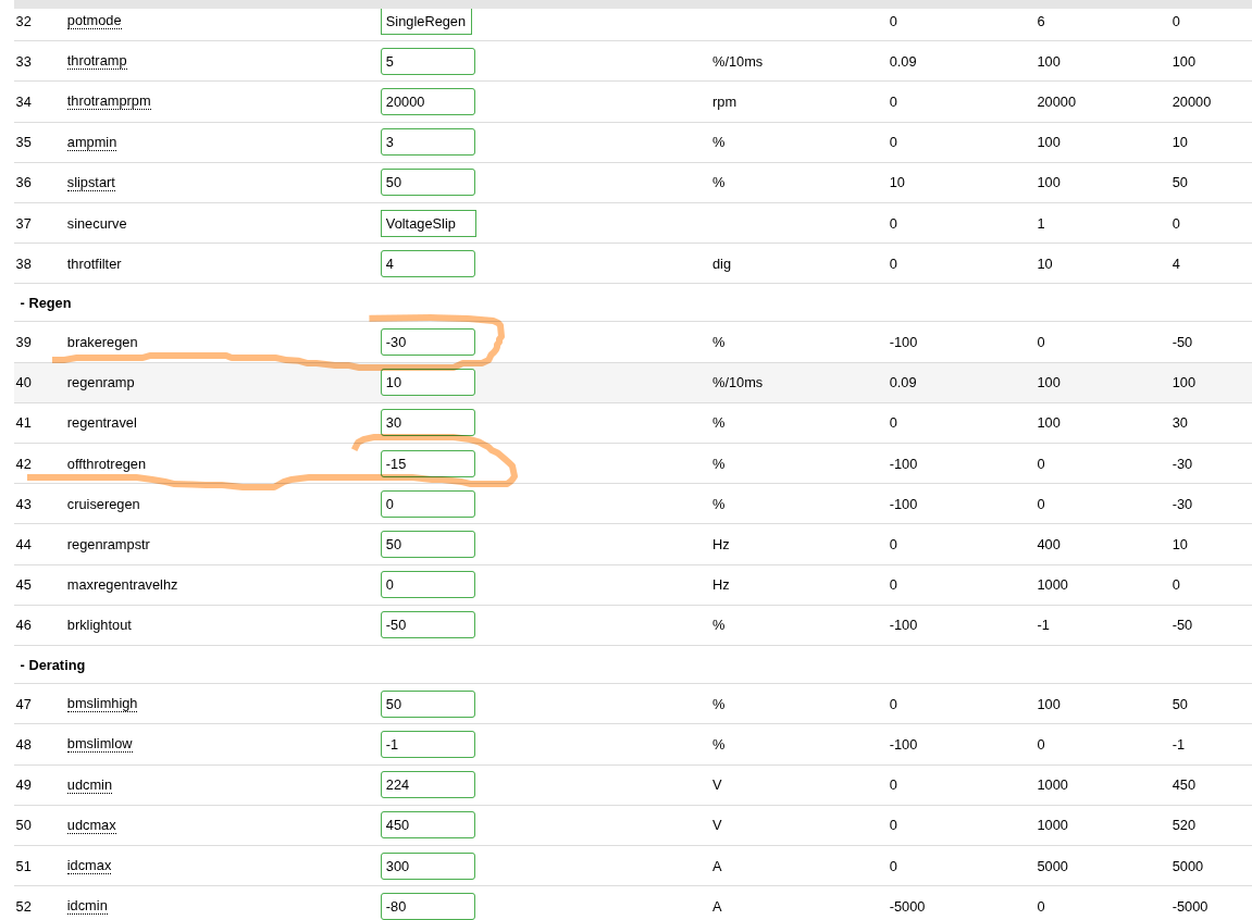

If anybody can spot what config is wrong but I am not getting offthrotregen or any brakeregen when I press the brake pedal.
I just connected the wire from the brake switch and when I push the brake pedal the din_brake is ON
The settings Johu has in the Parameter video are not the same with what I see on the screen.

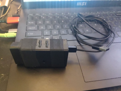

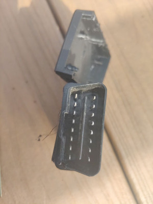

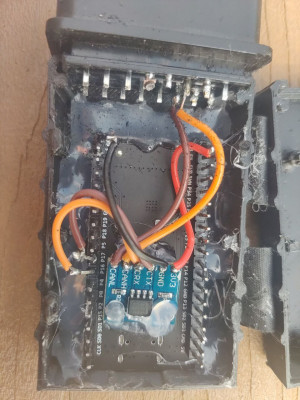

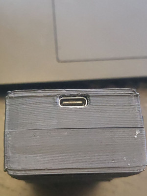

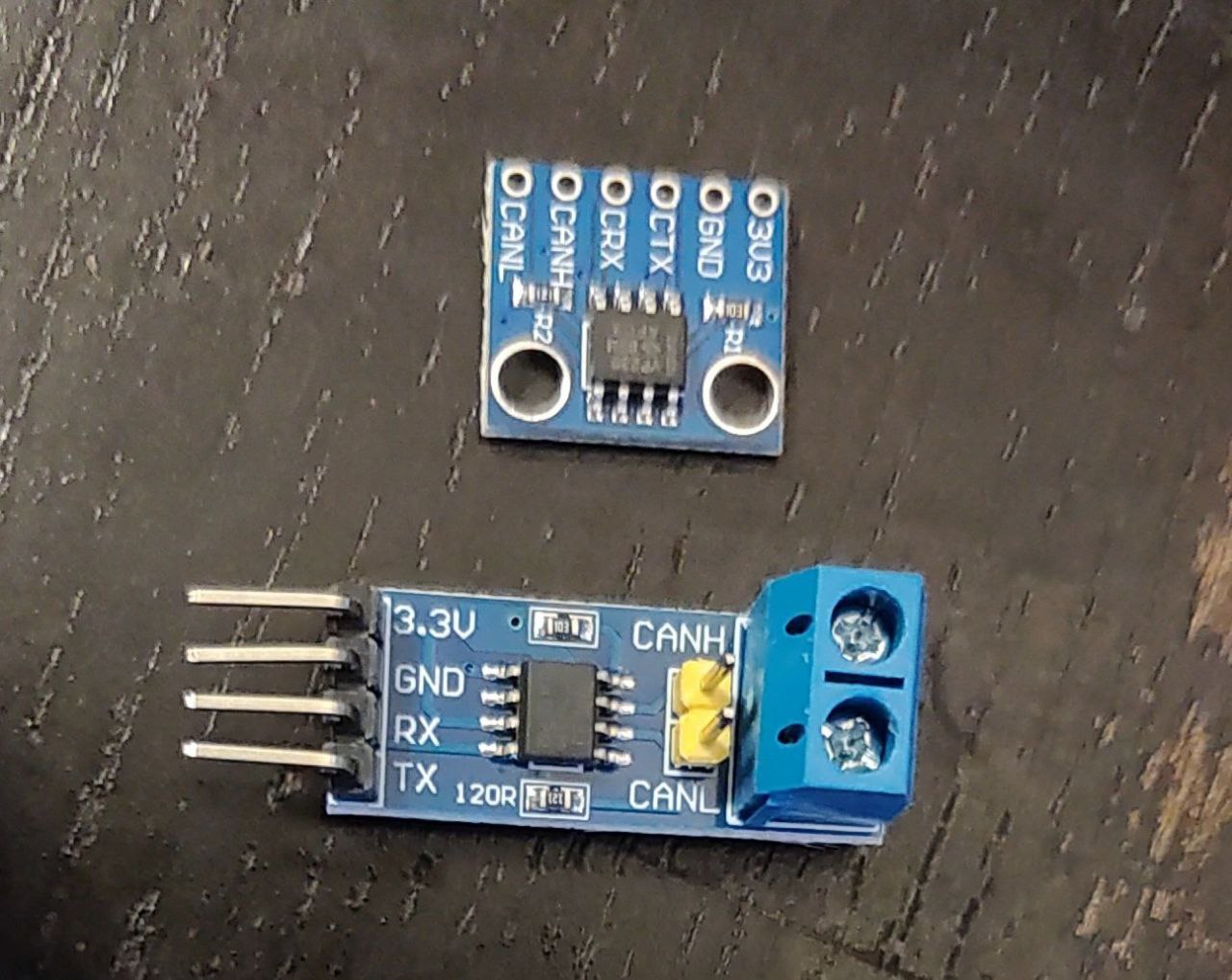

I used Alibros video to create a CAN adapter? in a compact version, to work with Savvycan.
Alibro uses the bigger 3.3v Can board and I used the smaller one , so it can fit in the 3D printed box.
The small board is powered directly from the ESP 32, and the ESP32 is getting power from the computer via the USBC cable.

Can anybody help me with a config file for Tesla SDU with brake regen that is working. I have the pin15 connected to the brake light.
I keep modifying the parameters but nothing works. I was never able to see brake regen work so far.
alexbeatle
- Posts: 292
- Has thanked: 82 times
- Been thanked: 35 times
Per https://github.com/damienmaguire/Tesla- ... ctions.pdf
pin 15 in the brake light switch - e.g. on/off switch from the brake pedal. It's in an input to the SDU the brake pedal has been pressed, not an output to the brake light.
Can you plot your potnom vs idc? You might just be missing parameter maxregentravelhz=100 and you’ll get off throttle regen. Then with the brake input, you can have the brake regen.

I only need brake Regen. Connected to ESP32 web gui I do not see an option to plot values. with the other board that had wifi in the motor I was able to plot.
I tried maxregentravelhz=100 and still nothing
can you upload you parameters?
Also on the esp32 when I put the ignition ON I loose connection to the inverter. I have to do all changes before the Ignition is on.

This is what I have right now, but I feel could use improvement. Both offthrottle and brake regen work for me. Don't forget to change params per your battery pack and throttle pedal.Proton wrote: ↑Sun Jul 20, 2025 1:17 am I only need brake Regen. Connected to ESP32 web gui I do not see an option to plot values. with the other board that had wifi in the motor I was able to plot.

@alexbeatle Regen works now. still do not understand why and what parameters made that happen.
I will PM you the screenshots with IDC and speed. found how to do it in the ESP 32 web GUI.
- manny
- Posts: 195
- Location: Netherlands
- Has thanked: 58 times
- Been thanked: 159 times
looking at the papams it's probably the throttle setting.
Yours is set to "potmode": 0, (Pot 1 is throttle and pot 2 is regen strength preset)
Apparently throttle gets priority over regen.

You might be right . For potmode I had SingleRegen. Thank you Manny. good observation.
