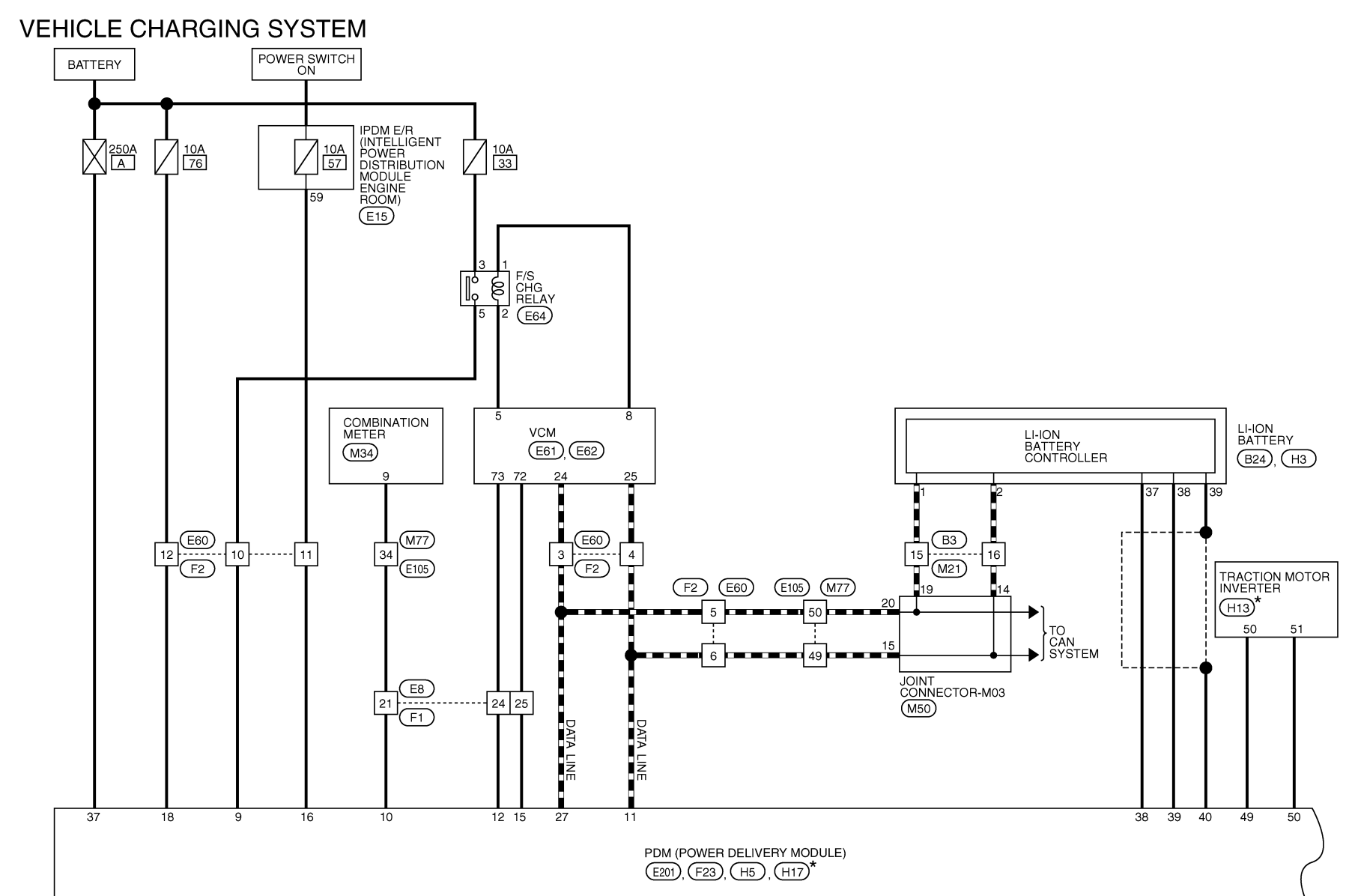

Nissan PDM related, do you have PDM pin 9 energized when trying to have DCFC contactors controlled?
It's and additional layer of safety Nissan has implemented
Also, I don't know if this has been noted earlier, but the PDM has a plug in signal for indicator lamp. Pin 10 is pulled down when PDM thinks it has a charging plug. I'll be using this for a dash light as it's in Leaf.

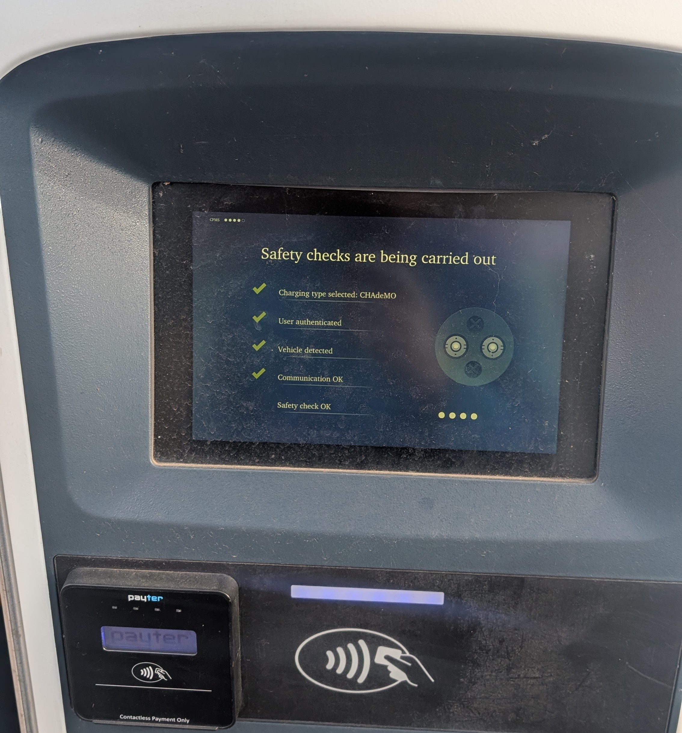

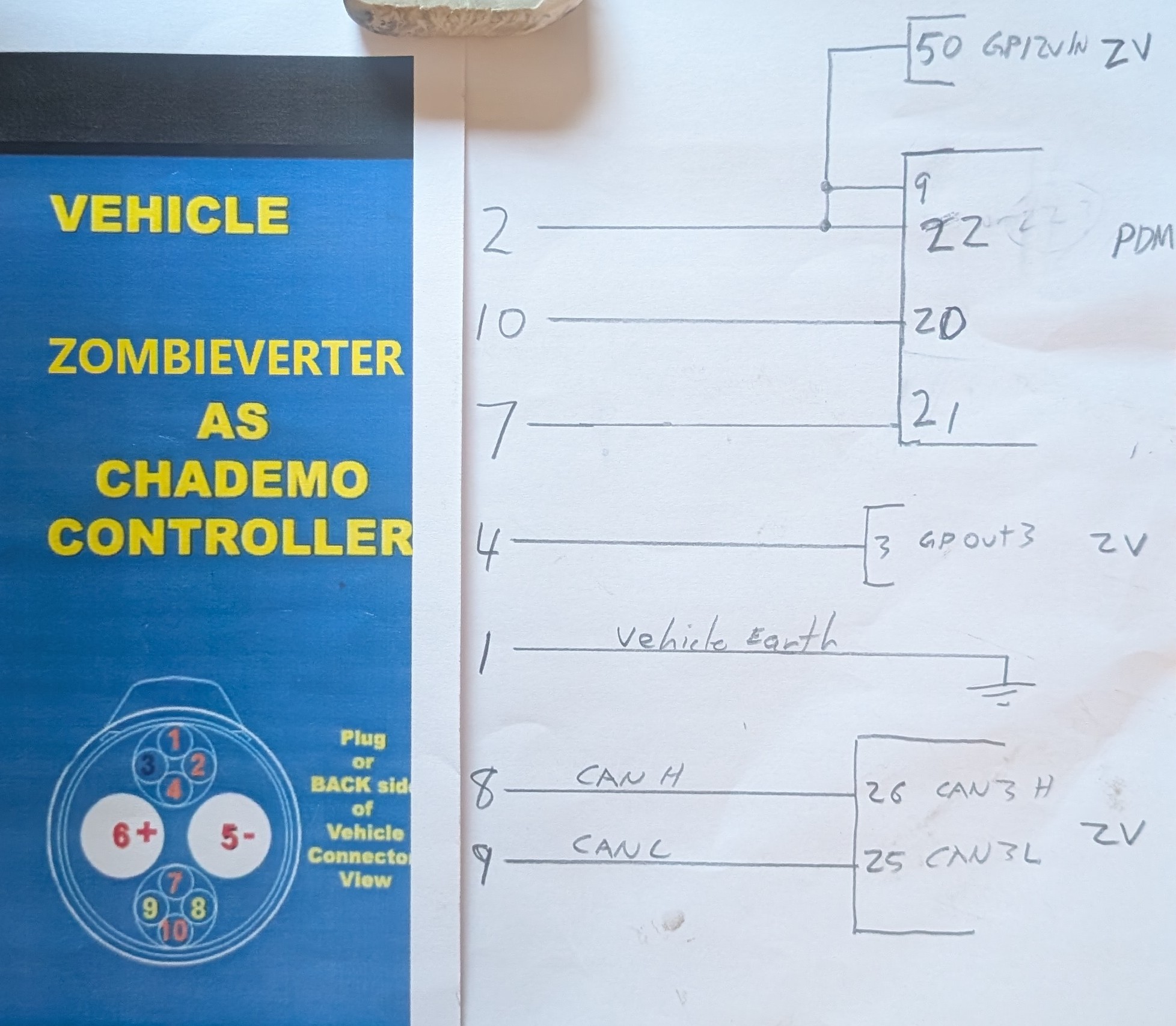

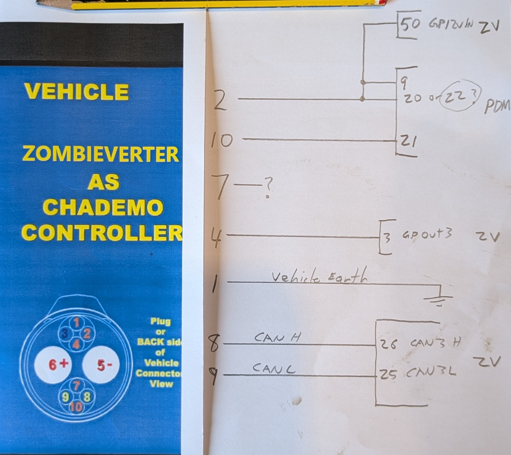

I know this is an old thread but the topic is relevant to my situation. I'm trying to get Chademo working on my van. I'm using a full Leaf stack from a 30kWh AZE0. The wiring is shown below.
Wiring schematic
Wiring schematic

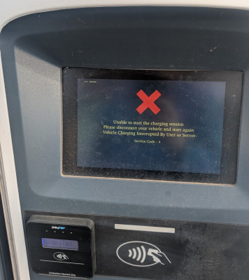

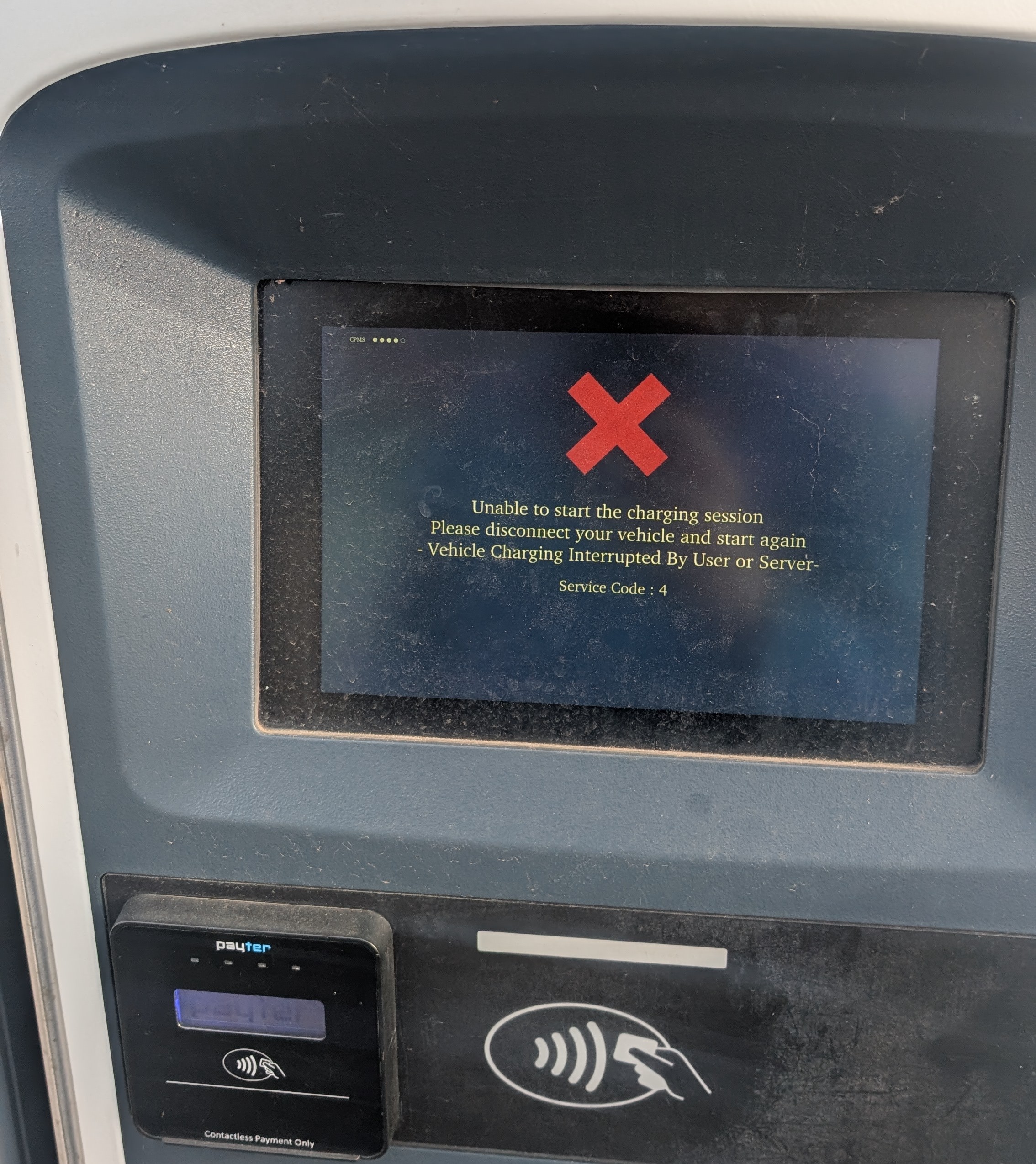

When I try and DCFC the station shows vehicle detected, communication established but fails on the final safety checks. My van goes into charging mode when I power pin 2 and earth pin 10 on the Chademo plug as well as when connecting to the charging station.
I'm not sure about some of my wiring, specifically Pin 2 Chademo -> pin 20 PDM?. Maybe it should be going to pin 22 PDM?
Also pin 7 Chademo currently isn't connected, but the diagram shows it connected to a 12v pullup resistor.
Should I connect it?
What value resistor should I use?
Should the 12v be constant or from the enable relay?

I looked again at how the Leaf PDM is wired to the Chademo socket and changed around PDM pins 20-22 as per this diagram.
Sadly still no charge. I suspect the quick charge contactors aren't closing. Can someone confirm this is how it should be wired and what is required to close the QC contactors in the PDM?

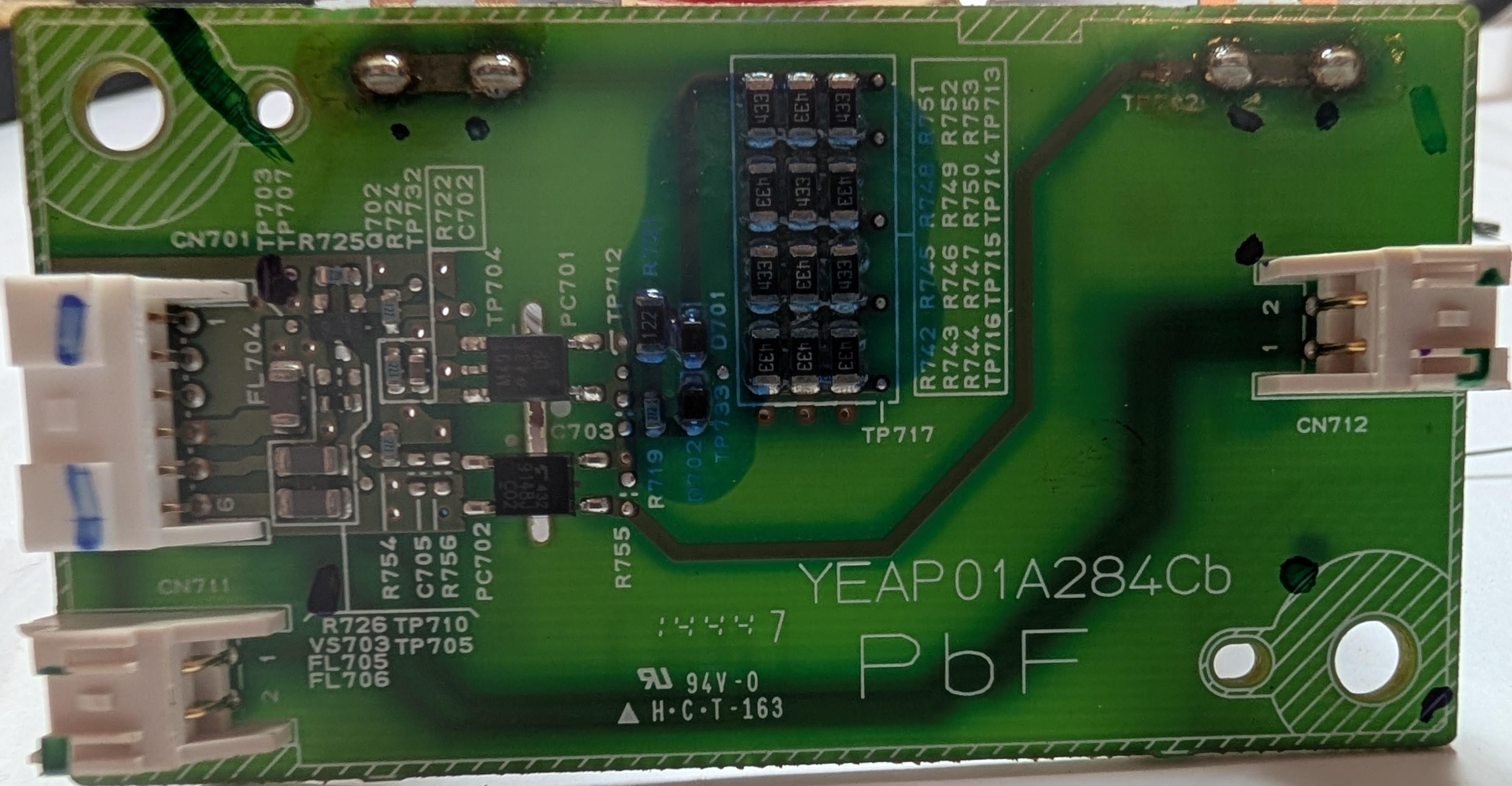

My van has a 2017 AZE0 from a 30kWh Leaf and the pictures below are from a 2015 24kWh.
If you can’t tiger the dcfc contactors externally then you’ll need to hardwire them unfortunately

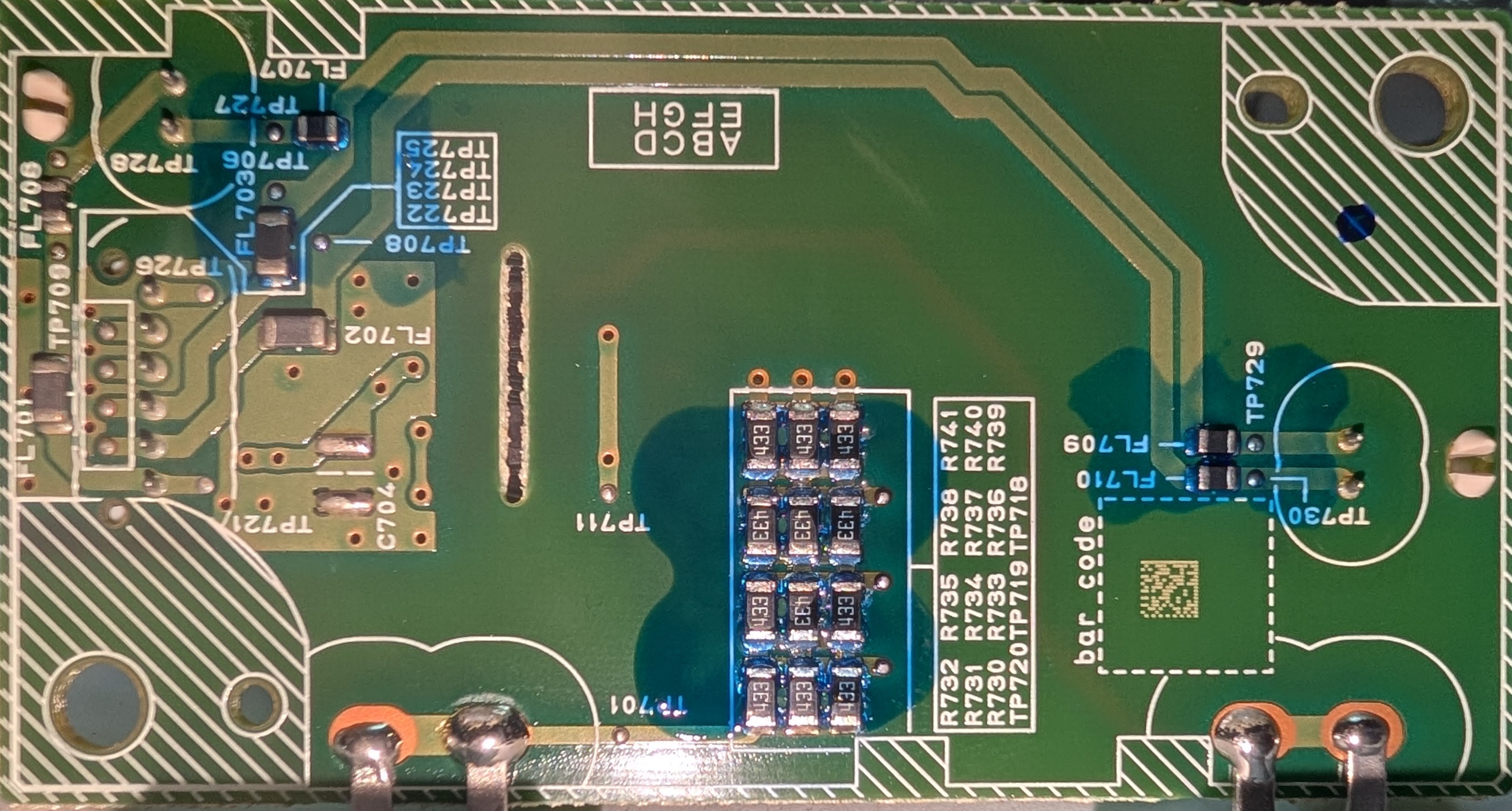

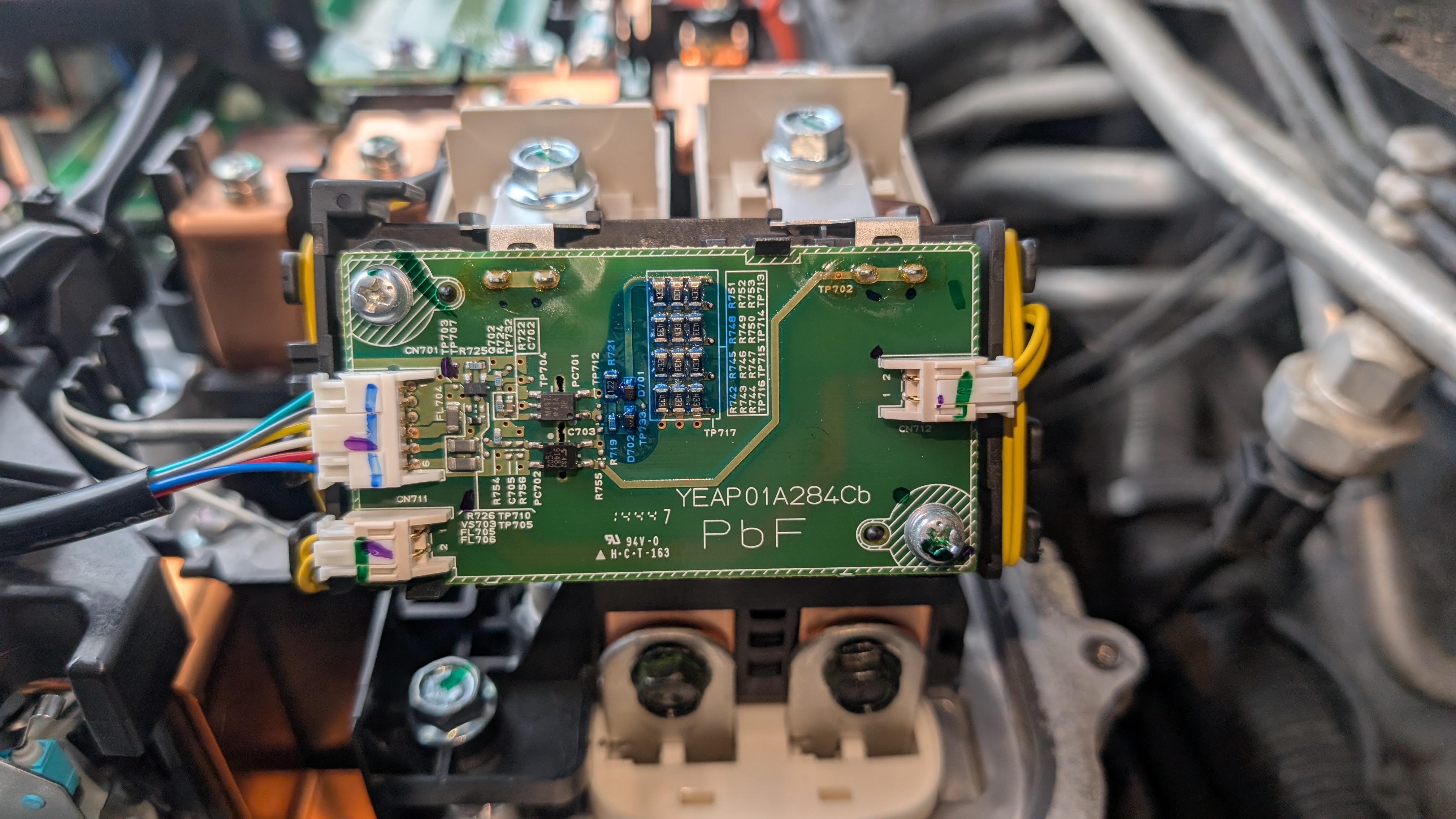

I've come to that conclusion as well. So in preparation I lifted the lid on my spare AZE0 leaf stack so I could get to the PCB on the QC/dcfc contactors.
QC pcb
QC pcb

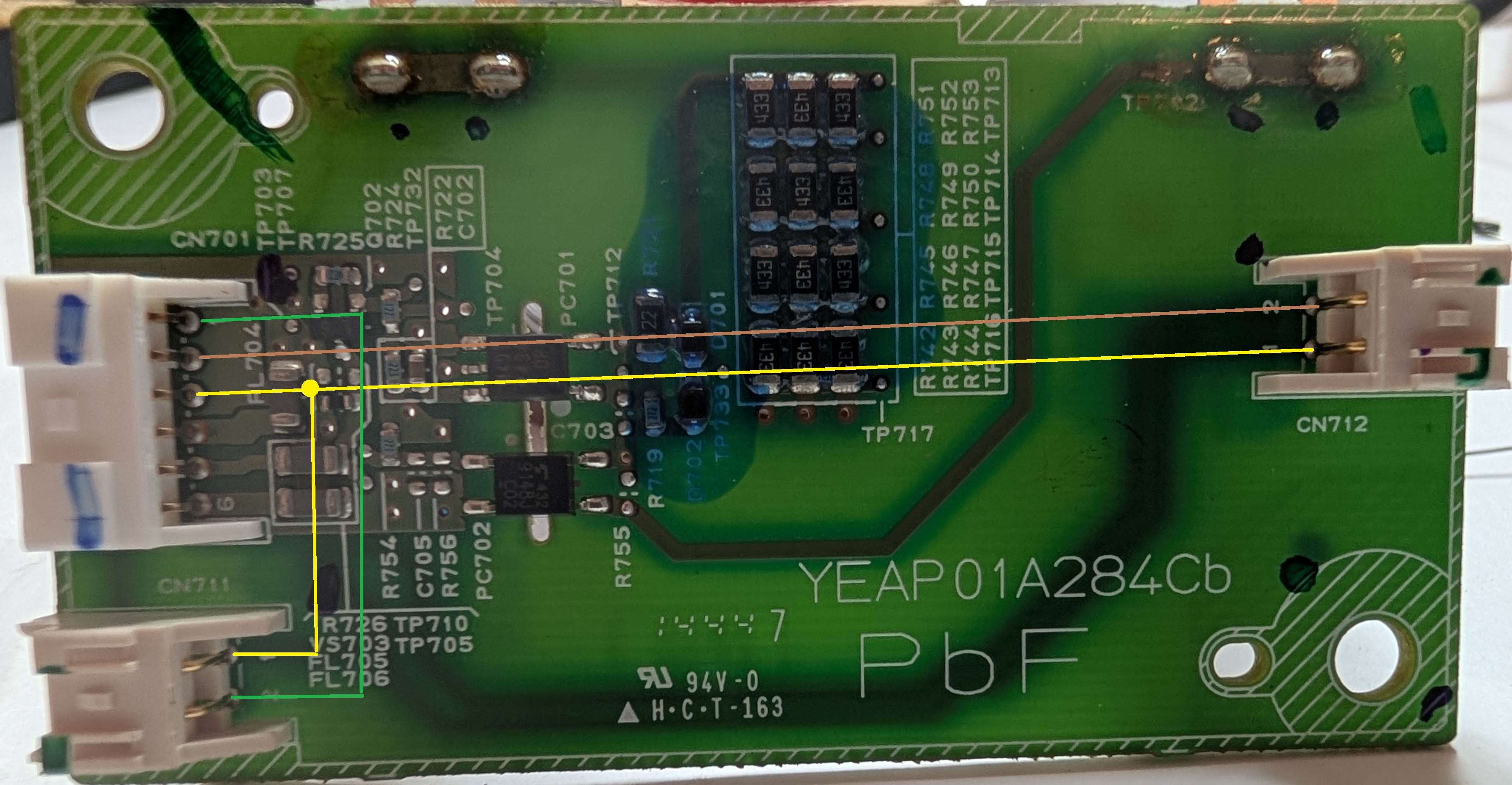

I've done a partial schematic of the pcb.
  • CN701 pin 1 -> CN711 pin 2
  • CN701 pin 2 -> CN712 pin 2
  • CN701 pin 3 -> pins 1 on both CN711 & CN712
Schematic diagram
Schematic diagram
So it looks like the Leaf can control the contactors individually as we have 2 feeds and one common. That means this is useable as is and the only wiring modification needs to be done at the other end of the pdm. That will be tomorrow's job and then test Chademo.
Below is a front and rear picture of the pcb.
