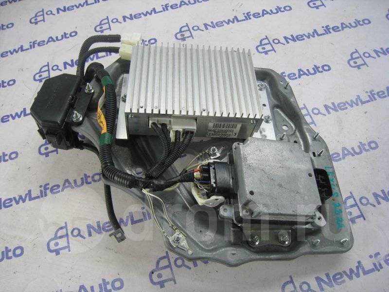

Is this spare part needed?

Just purchased a good condition 2008 GS450H that has a battery fault. I plan to convert to EV by selling off the engine first to fund batteries. Will I be able to just plug in this board and drive away without the engine or is there going to be a lot of faults stopping me from doing that. I'm anxious awaiting Damien's build to see what happens. Wonder if I can join the class remotely as I'm off work for 3 weeks because of COVID19.
