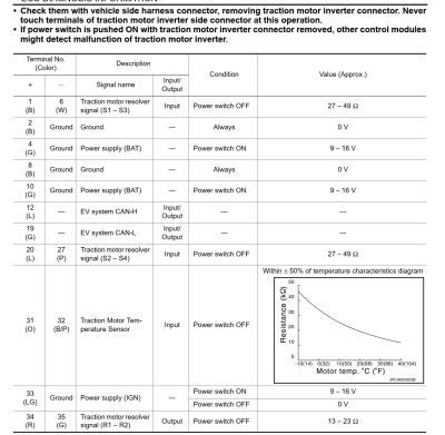

PDM Pin / Resolver Pin & ID / color
1 / 1 Sin + / Black
6 / 8 Sin - / Green
20 / 7 Cos + / Pink
27 / 6 Cos - / Blue
31 / 4 Temp gnd / Orange
32 / 3 Temp / BLK&PNK
34 / 5 EX / Red
35 / 2 ! EX / Green

Well, thanks to you driving me to rewire it again (thank you!), I've discovered an issue with the wiring, and for the life of me, I can't make heads or tails of this. Is the exciter single-ended? I guess I expected differential
I have it wired correctly per the 2011 Service Manual. But the pins don't match the circuit. I can't see any other way for the pins to line up, so I can't imagine they're transposed...
Referring to the green external PDM connector, Pin 35 (exciter R2) is connected to motor temp sense ground on the PDM (pin 31) .
Please see my photos, and if you have any idea what the hell I've done to mix all the pins up . Is this some half year revision or something?

Looks to me that you're on the wrong row for the motor controller board. Looks to be labeled 1-20, then the next row is 21-40, right? I see it as you have 17 and 15. Unless you're labeling another connector number at the PC board..

The numbers are pertaining to the green 36 pin external connector on the PDM from a 2011.

Here is a manual with EM61 specific wiring info to compare. https://www.thunderstruck-ev.com/images ... 9908742192 on page 11

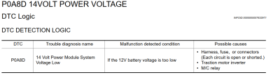

Wired up the OBD to the CAN Bus:
Leafspy says there are errors with the Leaf Battery (which I knew about), P3180-00-C0/EVC-249 HV Battery System, and P334D4-00-0E/EVB-130 Bat internal resistance. I wasn't planning on using this pack anyway, but its easier to test with this whole thing for now. I have BMW cells Im planning on using when I get this thing running.
Unfortunately, these are the errors that already existed when I bought the car :(

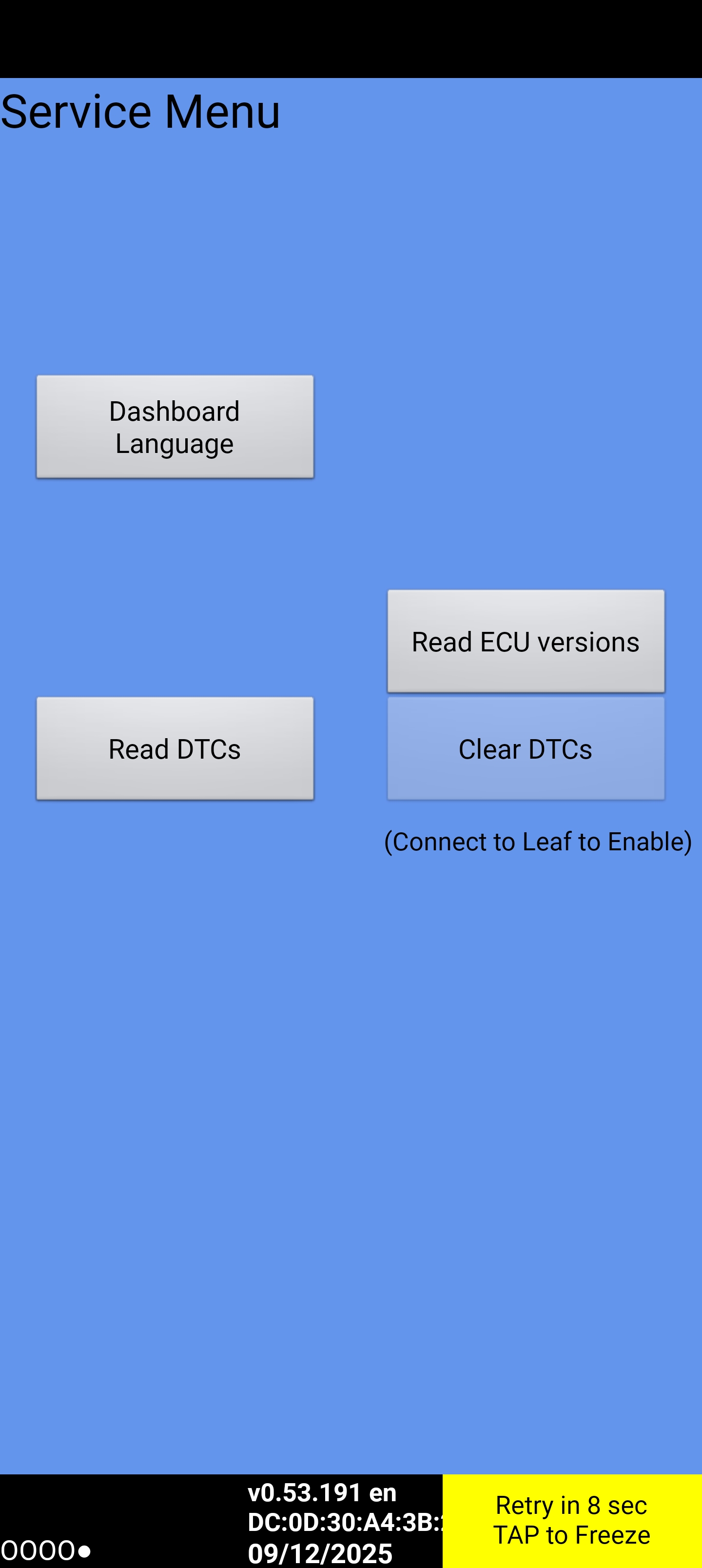

Ok, ran Leafspy without any HV battery connections, and it reported back "No DTC's" but also had the scan DTCs button greyed out. I don't understand how it couldn't complain about the missing components, so I am going to acquire another ODB scanner to make sure. Admittedly I have no experience or knowledge of Leafspy and its not exactly new user friendly, so this could be my own ignorance. Doing some reading tonight.

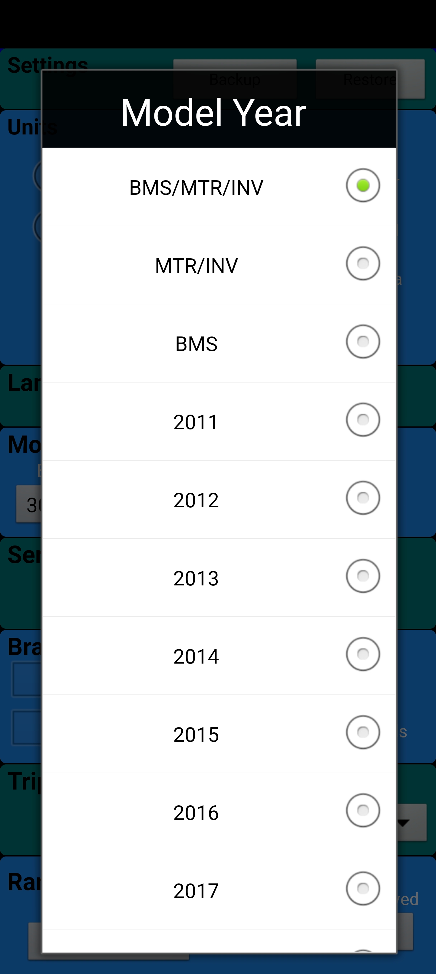

Would you be willing to take the step back and compile a "current state" of your setup? Again I don't ask this only for me, but for Tom, Damien and the OpenInverter community
Meaning:
  • Do you currently have the setup in the state where you can get the motor to spin momentarily as you had earlier? If not, can you get it to that state?
  • Would you for clarity list the modules you have connected to Zombieverter? Would you provide a picture of the Zombieverter connector and list which wire whould be which in the said picture?
  • Would you elaborate on how you have connected the +12V power to Zombieverter and the Leaf modules? I.e. do you have Zombieverter controlling the inverter power by a relay or are all +12V connections wired directly to the lab supply?
  • Are you currently doing the tests with the BMW modules or with the Leaf battery
  • As you have updated Zombieverter FW version and probably changed parameters, can you provide an up to date params json AND a CAN trace of the system spinning the motor briefly?
  • When getting the trace, if possible start recording just before you start the system then do the sequence for example: Zombie into run mode and switch to drive/reverse, press throttle, back to neutral, shutdown --> stop trace
Which mode did you have selected with Leaf Spy (pro?) when you tried the DTC reading?
Would you do a recheck with LeafSpy so that you have HV on, or what did you mean by "ran Leafspy without any HV battery connections"

Wasn't able to get a CAN log today, my CAN hardware decided to stop liking my work computer, So ill just bring mine into the shop tomorrow and get more data.
I got a Leafspy scan once I read the .... manual, and i've attached it below. I'll leave that up to interpretation. A lot of if is complaints from disconnected CAN systems, but it also has what may be a resolver or a handful of other things.
I did also read the motor when I spun it by hand, and got a graph in the ZV UI. It works both ways, and Im assuming speed is derived from the resolver output, so there's that. If thats the case, then that points to possibly ok resolver?
Also, the motor does spin up when the initial blip happens at the boot time, and it appears to be responsive to throttle input for those brief few seconds. Also a check for the resolver being ok. Coils are all still within spec, no burns or shorts, no discolored enamel, either....
Are there resolvers available? The leaf Service Manual says replace the motor if the resolver is bad.
This is still screaming bad wiring, but I just cannot find where that could be.
Again, thank you all for helping and sticking with me.

Looked these up for y'all
Nissan FSM lists these on a priority in which they should be checked
1.
  • P0A8D 14VOLT POWER VOLTAGE
    P0C79 DRIVE MOTOR A INVERTER VOLTAGE
    P318E CAN ERROR
    P3193 CAN ERROR
    P3197 CAN ERROR
    U1000 CAN COMM CIRCUIT
2.
  • P0A1B DRIVE MOTOR A CONTROL MODULE
3.
  • P324F DRIVE MOTOR A INVERTER IGBT
beeetown wrote: Sat Sep 13, 2025 12:43 am This is still screaming bad wiring, but I just cannot find where that could be.
Why you don't want to share your full wiring with few images?
Have you checked that you supply the inverter enough +12V power and that your lab power supply? Are you supplying a high enough voltage (9-16V as per TMS-32)?
P0C79 Drive Motor “A” Inverter Voltage Too High
If the high voltage DC voltage is too high
• Traction motor inverter
• High voltage harness or connector
• Li-ion battery
• High voltage parts except for trac-
tion motor inverter
P318E CAN data error
If traction motor inverter detects CAN data error
VCM
P3193 CAN data error
Li-ion battery controller
P3197 CAN data error
Electric shift control module
U1000 CAN communication line
If CAN communications signals continu-
ously cannot be transmitted
Harness or connectors
(CAN communication line is open or short-
ed.)
P0A1B Drive Motor “A” Control Module
A malfunction is detected in the traction motor inverter (motor controller) Traction motor inverter
CAUTION:
If this DTC is detected simultaneously with P0A8D, inspect the 12V battery first, as it is suspected to
be dead.
P324F Drive Motor “A” Inverter IGBT Over Current / Over Temperature /Over Voltage
• If an over current has occurred in the IGBT
energizing current
• If IGBT temperature is too high
• If there is overvoltage in the high voltage DC
voltage
• Traction motor
• High voltage harness or connec-
tor
• High voltage cooling system
• Li-ion battery
tion motor inverter
CAUTION:
• If this DTC is detected simultaneously with P0A8D, inspect the 12V battery first, as it is suspected to
be dead.
