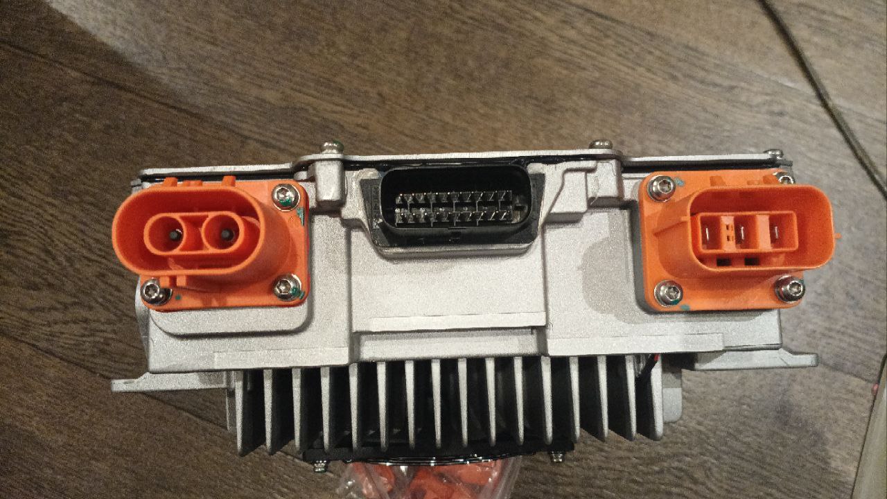

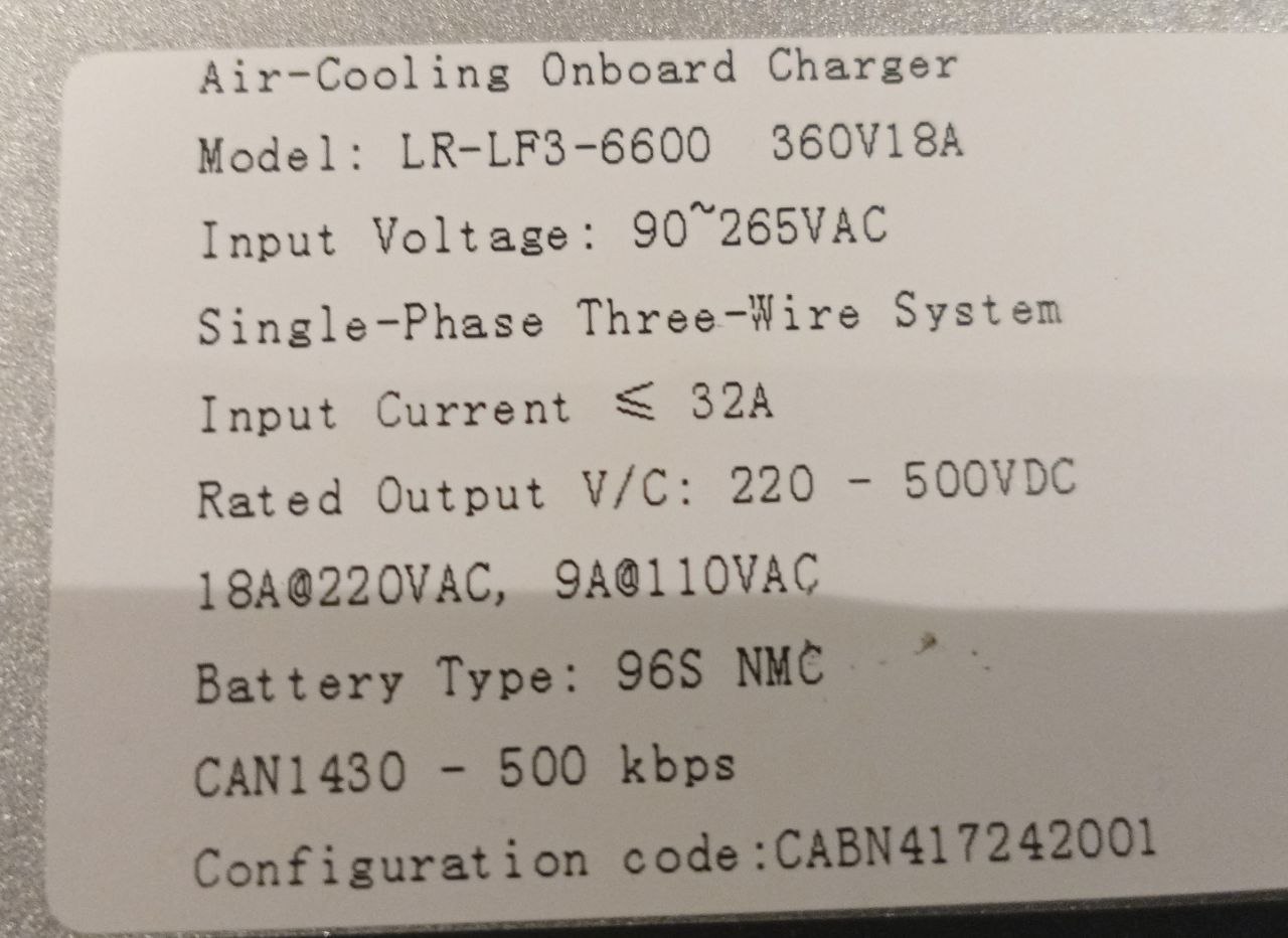

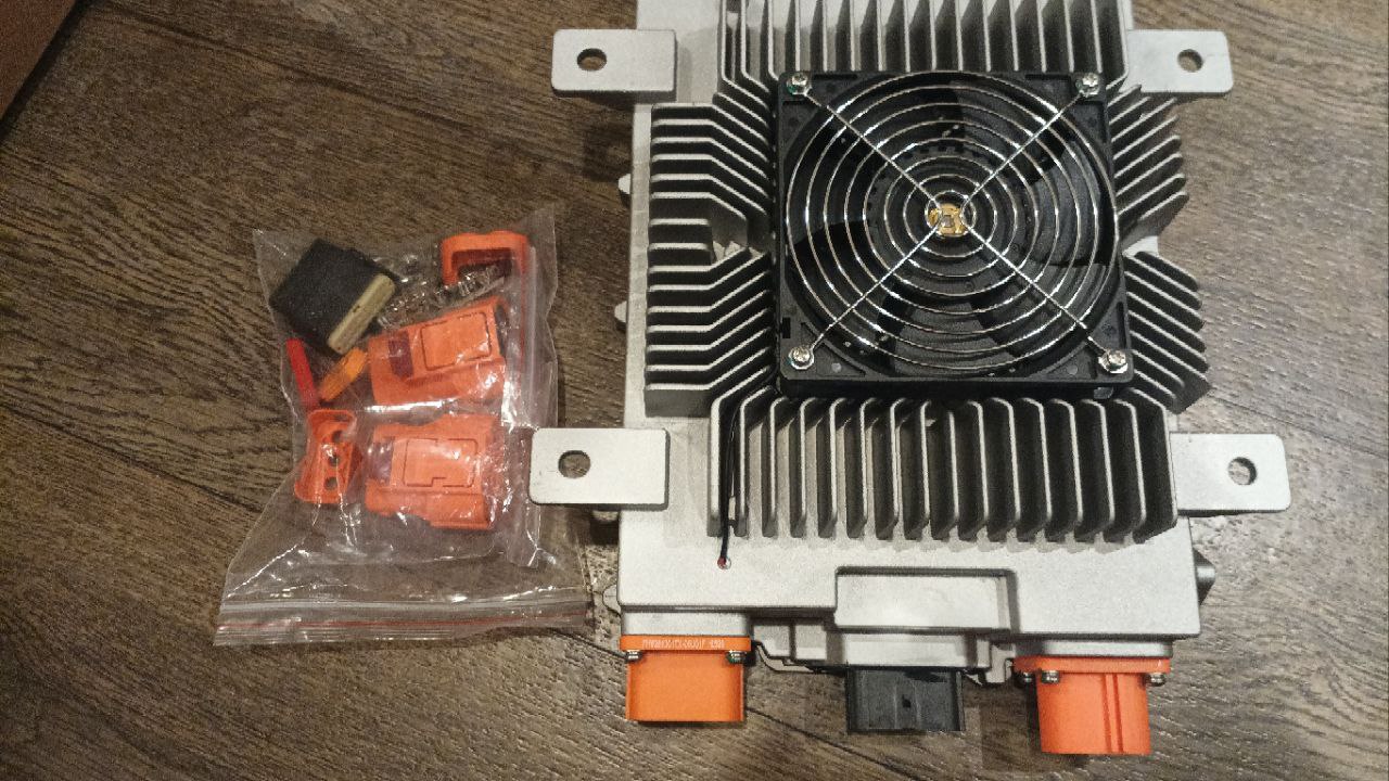

So after not touching the car for about 6 months I decide to scrap the Tesla charger with the open inverter board and buy a Chinese air cooled 6.6 charger.
I had to many problems with the Open-inverter board on the Tesla charger.
last thing I tried to move the WiFi card out with some extension wires and I damaged the card. I bought the same WiFi card and tried to flow the instructions on how to flash the card with no success and decided to just abandon and go to the Chinese Charger.
with the Chinese charger I complicated myself a little bit because I chose the CAN version and now I have to figure out how to send the CAN messaged to the charger, and once I figure it out I can start charging.
I could have chosen the fixed voltage version but if I can figure out the CAN messages and how to send them, this inverter
can charge batteries from 220V to 500V, so it can be useful in future projects.
Been thanked: 1913 times
Nice that it comes with all connectors.
Maybe you can get the BMS to send the required messages directly, provided it's on the same bus.
How is the BMS going anyway?
