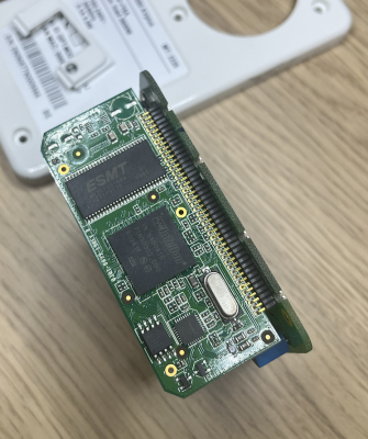

Hello, I am working on a project from pyPLC with EvseMode hardware. I have a tp-pa4010(same as this:viewtopic.php?p=59745#p59745) teardown, arduino nano, Raspberry Pi ready. But I don't quite know how to connect all hardware together and do the resistor wire things. Can you show me a picture of your final hardware looks like? Or a list of things that I need to buy (resister, other things, etc.)

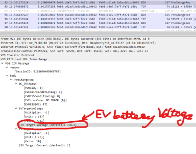

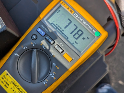

Today I was able to do the light bulb test on the Polestar 2. With the DC/DC converter I mentioned earlier, supplied it with 12v and set it to 580v (voltage drops a bit to around the requested voltage when the car is measuring voltage, as this converter is unregulated), only needed it to pass precharging. After that I could switch the separate power of and the vehicle kept discharging for 1 hour, possibly more but this was all the time I had. After disconnecting the setup the cooling fans kicked on and the SoC updated by dropping to 74% after switching to drive.
This is a very good sign for discharging these vehicles for V2x and that will be my next test with goodwe gw10k-bt and a decent cable.
Here is the video: https://youtu.be/dzOr7A8TZGg
And the log below

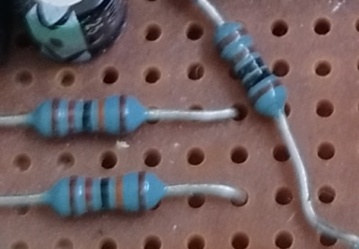

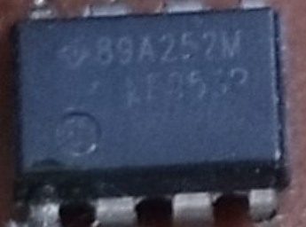

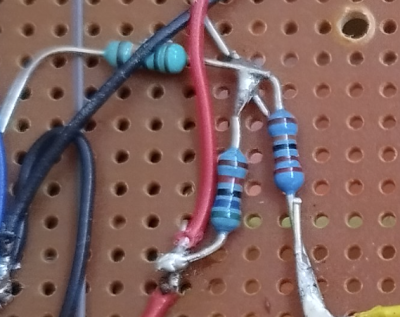

Thanks for adding more detail pictures to the GitHub. I have now modified my TP-PA4010 and working on other steps. I try to list electric unit that this project needed. Sorry for having so much question. I am quite new to doing physical electric things.uhi22 wrote: ↑Sat Jun 15, 2024 7:31 pm The overall block schematic is here: https://github.com/uhi22/pyPLC/blob/mas ... vseMode.md, added also some photos of my setup there.
The raspberry (or windows laptop) running pyPLC connects with an ethernet cable to the tp-pa4010. The tp-pa4010 and the arduino are powered by 5V from an USB power bank (in my case the light-green 18650 accu and the taped USB electronics).
The most work is the PWM generation. The schematic is linked in the github, it is this: https://www.instructables.com/Arduino-E ... ng-Station We need +12V and -12V, this is solved in the original schematic with a voltage converter, and in my case I use two separate 5V-to-12V converters, one to create the +12V, the other to create the -12V. Example B0512S-1WR3 from https://de.aliexpress.com/item/10050048 ... ry_from%3A
For showing the status, my Arduino uses two WS2812 full RGB LEDs, which only need one pin on the Arduino, instead of the three conventional LEDs in the original design. And I added a poti (between 5V and ground) which feeds an analog input of the Arduino, to be able to adjust the generated PWM ratio. In case the box shall never do AC charging, the poti can be replaced by a bridge from the analog input to ground, which will lead to fix 5% PWM ratio.
The PP resistor of 1k5 is directly contained in my self-made plug, and the CP and PE just use a simple twisted pair from the plug to the box, this is the yellow cable which can be seen in the video from Augsburg Linux day.
- light-green 18650 accu
- 2 * B0512S-1WR3 voltage converter
- what kind of bridge that can replace potentiometer?
- what kind of cable that connect to PEV ? 3D printed module that plug into PEV charging port
- what kind of capacitance you used in this project?
- Does Arduino code are as the same as this project? https://www.instructables.com/Arduino-E ... g-Station/

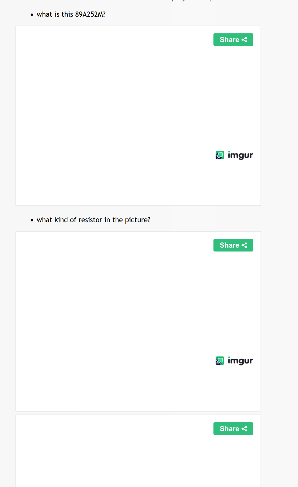

- what is this 89A252M?
- what kind of resistor in the picture?
- what kind of 3 squares in the Circuit diagram?

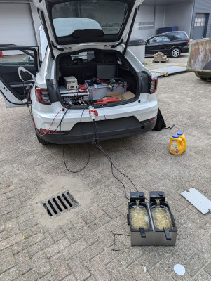

Hey all, little update on the polestar project.
We were successfully able to configure the inverter to work without a BMS (lead acid battery mode).
Here a little picture of a big load connected. The car just kept it's contactors closed for over an hour.
I have worked together with Griffigroen on this as an educational research project at an institution. Sadly the project is now ending, and we are not able to finish the system (adding HV contactor; automating the voltage setting on the precharge circuit; putting it in a nice safe enclosure etc.). Also thanks for the headsup on the risks @uhi22. We were aware of the risks and besides being NEN9140 certified, also under supervision. But you can never be careful enough.

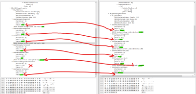

- Much like MarkG-PE's BMW iX3, I needed to adjust the cpdc->EVSEMaximumVoltageLimit.Value down to 400V to get under the 421.4V that the car had. https://github.com/uhi22/pyPLC/issues/1 ... 1895574418
- You need an actual plug, or a thin screwdriver blade or something to trick the locking pin into believing a plug is present in the socket. It must expect to hit the edge of the plug or something, but if you don't have anything in there it will over travel and cycle the locking pin and fail. My ultimate plan is to buy a DC charging plug for the final setup (with HRC fuses inside for uhi22, and also because I have seen people burnt from battery banks before and it's nasty), which should solve my plug problem but I am not sure if I am confident enough that this is going to work just yet
Anyway, I managed to get the contactors to close and liven up the port for about a second tonight, before it errored out, so I will need to dig through the logs and find out why, but I will keep you posted if I get stuck or make progress.

Interesting, that the Kona checks the physical plug. My 2018 Ioniq does not. You could use your type2 AC cable, to trick it, I think.

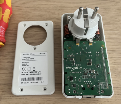

I ordered a used dLAN 200 AVplus meanwhile, I thought that's the better option. Did I get this wrong?

The best proven-in-use is the TL-PA4010, no matter whether with or without suffix P.
The dLAN 200 AVplus has the benefit that it can sniff both sides of the SLAC communication (the TL-PA4010 can only listen to one side, depending on the configuration). This is very helpful for just sniffing. But I do not know whether it was used in EvseMode. You can just try.
The pros and cons are described here: https://github.com/uhi22/pyPLC/blob/mas ... ardware.md

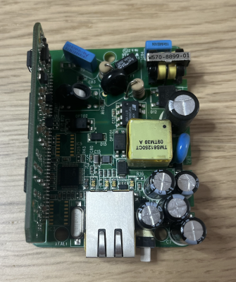

Hi, I received my Devolo dLAN 200 AVplus meanwhile. Turns out it looks very different from inside or am I missing something. Just FYI. I guess I'll continue with the TP-Link TL-PA4010 then.

Oh, there seem to be quite different versions, this is from 2009 (date code points to week 41 in 2009). My part (pictures here: https://github.com/uhi22/pyPLC/blob/mas ... 200-avplus) is from 2010, it is a "single board" design without the "daughter board".

Re: Drawing power out of CCS port (V2x, inverse charging, bidirectional CCS)
one update - I was able to collect traces from a real 350kW charger and have updated the OpenV2Gx code to reflect the params from there. The charger is giving much higher voltage and other params in the ChargeParameterDiscoveryRes - as below:
Hence I've updated the code to reflect these values and will try the discharging experiment once again with these updated higher voltage values (1000V v/s 450V), etc.mhpev wrote: ↑Thu Aug 29, 2024 9:44 pm Today I was able to test with 2 EVs in the US using CCS1 - Chevy Bolt and Kia Ev6 I was able to close contactors (EV expects voltage during pre-charge at the DC terminals - so I used a similar flyback that another member had used for the Polestar2 discharge.
Based on the changes in my prior message comparison, I was able to close contactors on the Kia EV6 and discharge at close to 800V. Since the charger emulated up to a 1000V the EV allowed direct access to the 800V battery without going thru the DC-DC/boost convertor.
Here's an image showing the same. Only issue I'm having with are Teslas that have NACS connector and support CCS1 using the NACS <-> CCS1 convertor. Once the charger is connected these Tesla Model Y (and in the past Model S) - via this NACS-CCS1 connector don't see any L2 GreenPHY or above v2G messaging on the wire...
