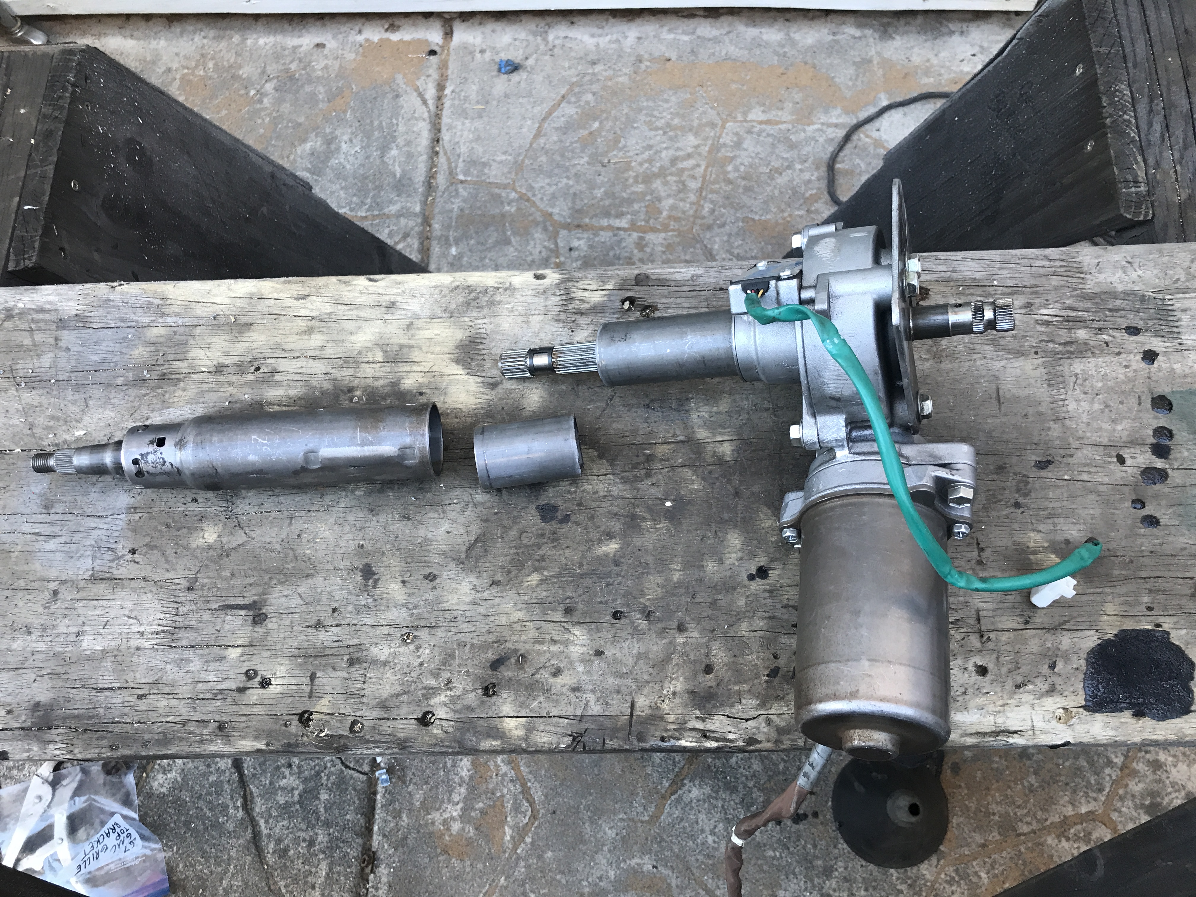

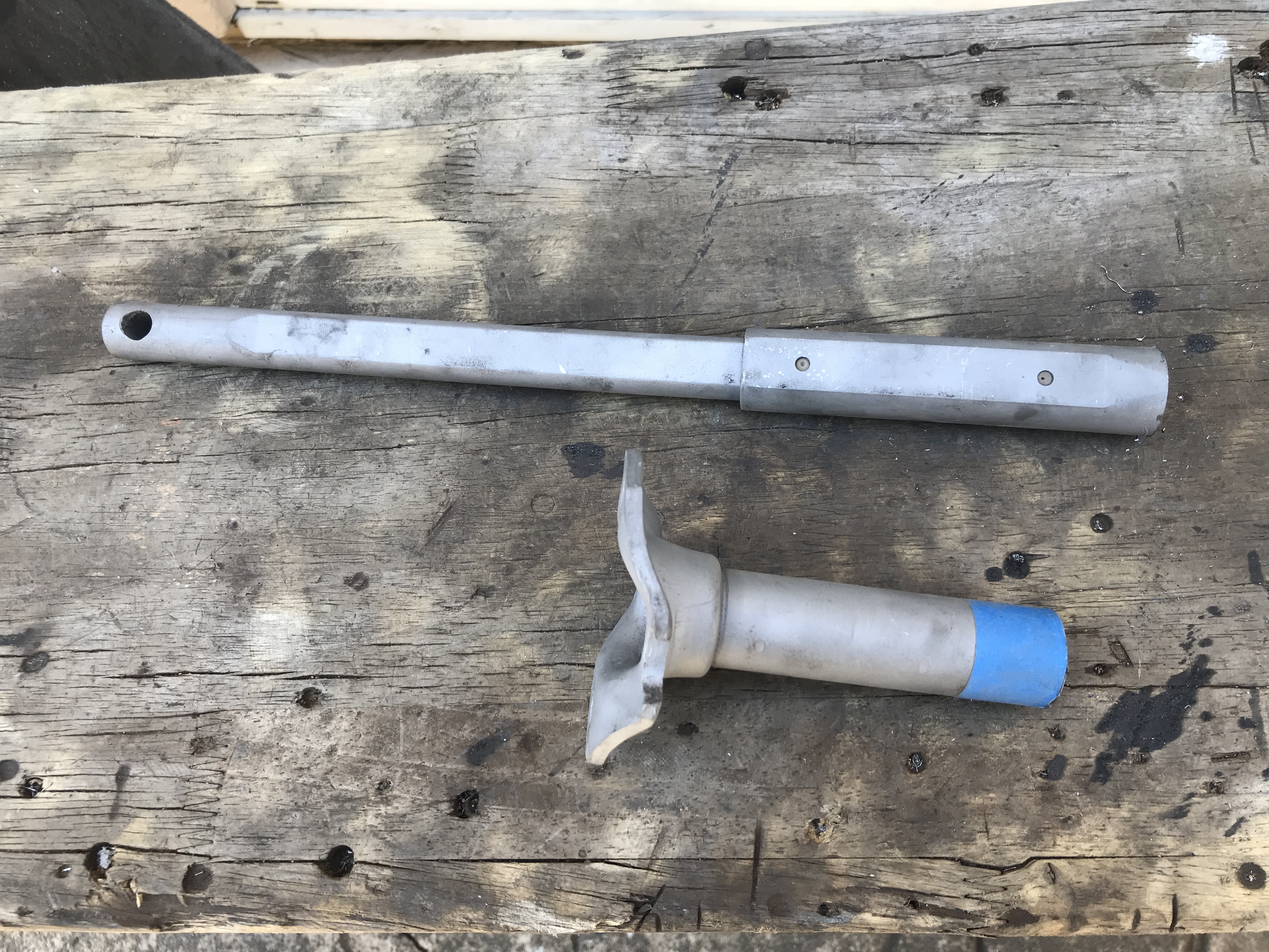

and after all that if I had to do it all over again I would not waste my time pulling it apart I would just cut it right at the join of the two cylinders, in order to expose the shaft

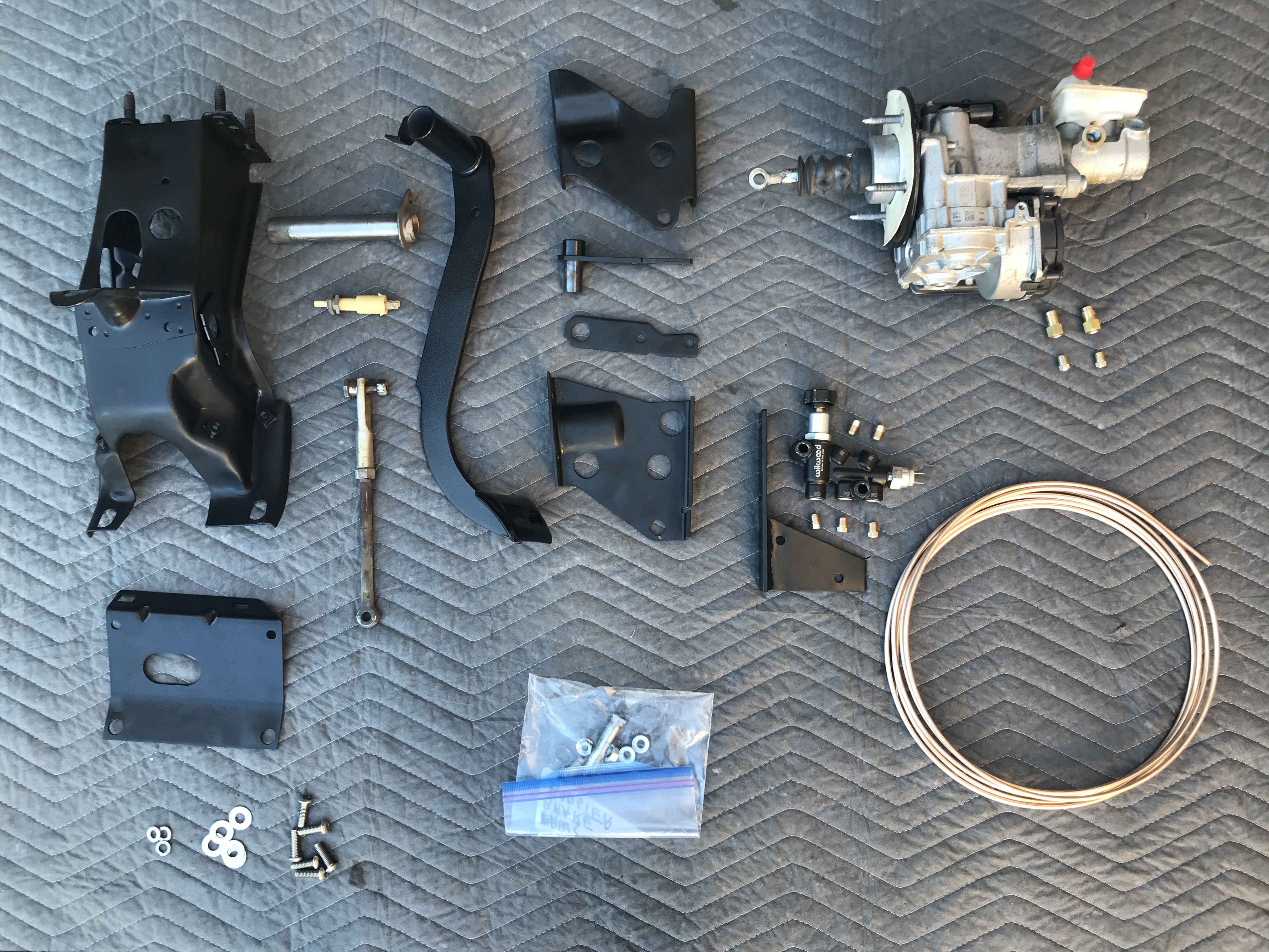

Post by Gregski »

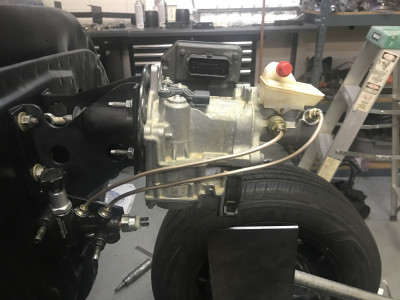

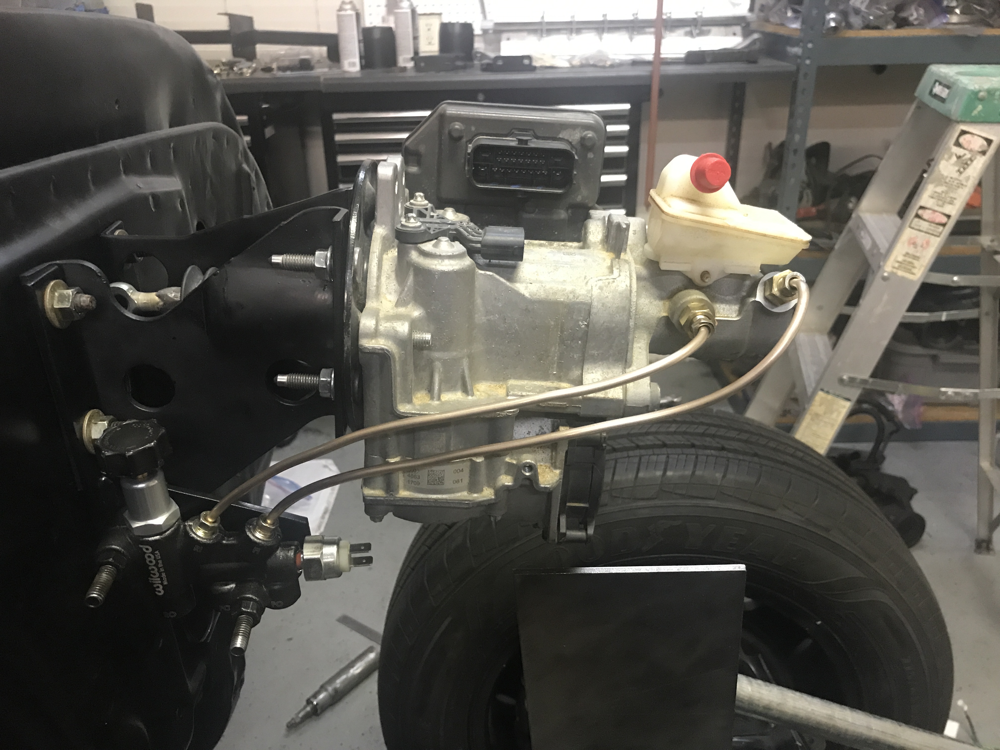

Tesla Honda CRV Model 3 electric power brake booster about to go on
nothin' to it but to do it!

Post by Gregski »
still haven't done the brakes, but...

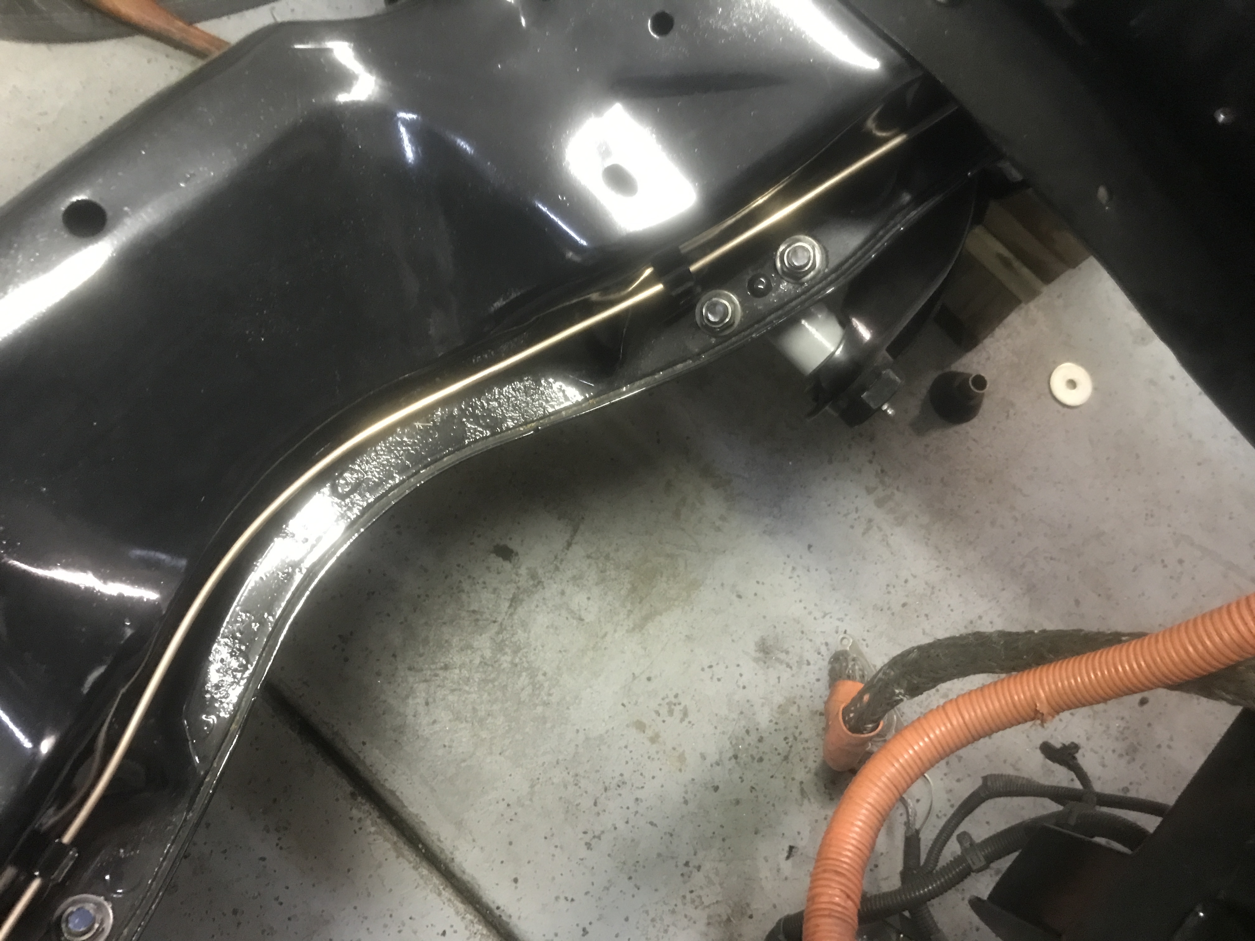

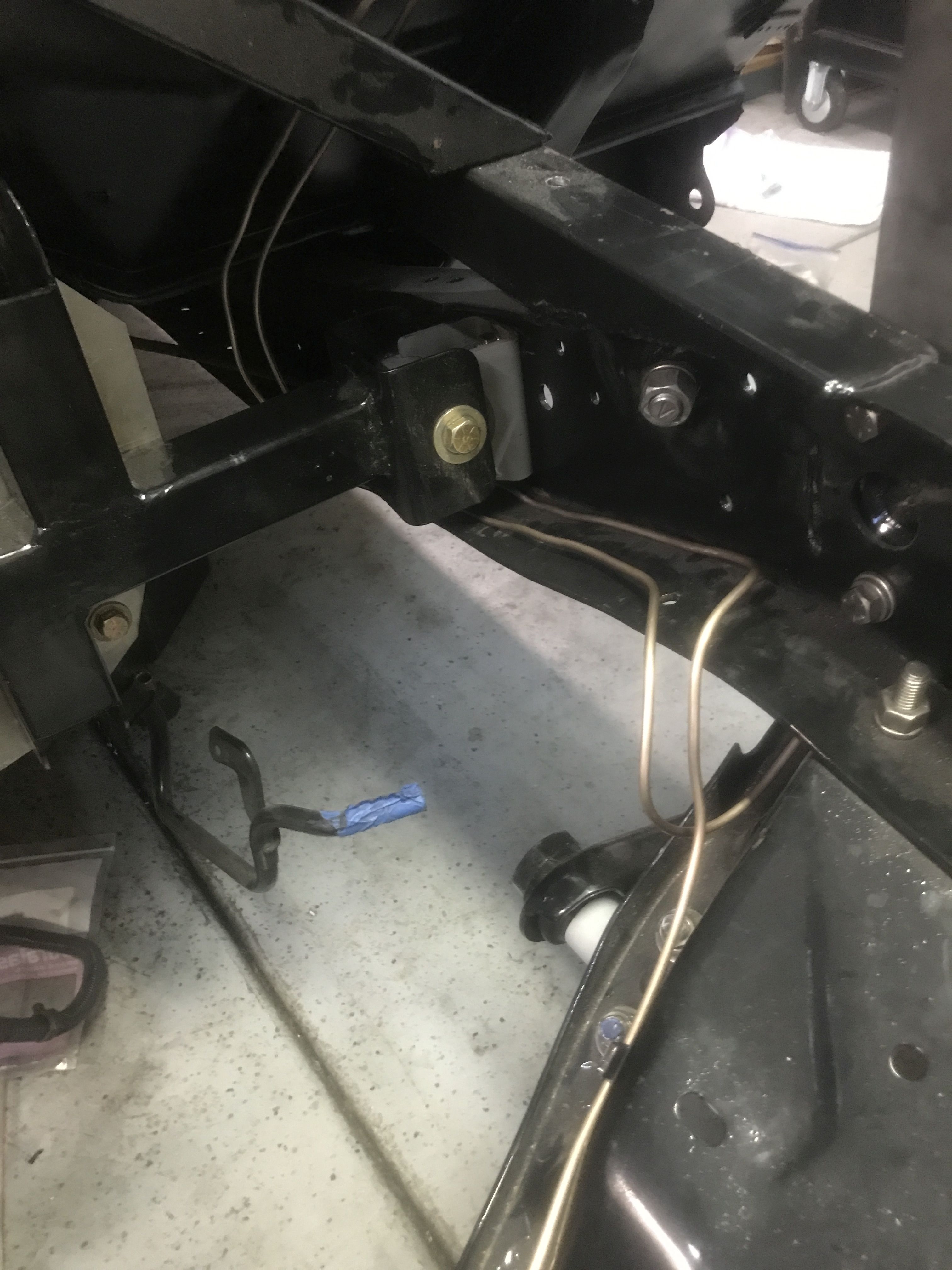

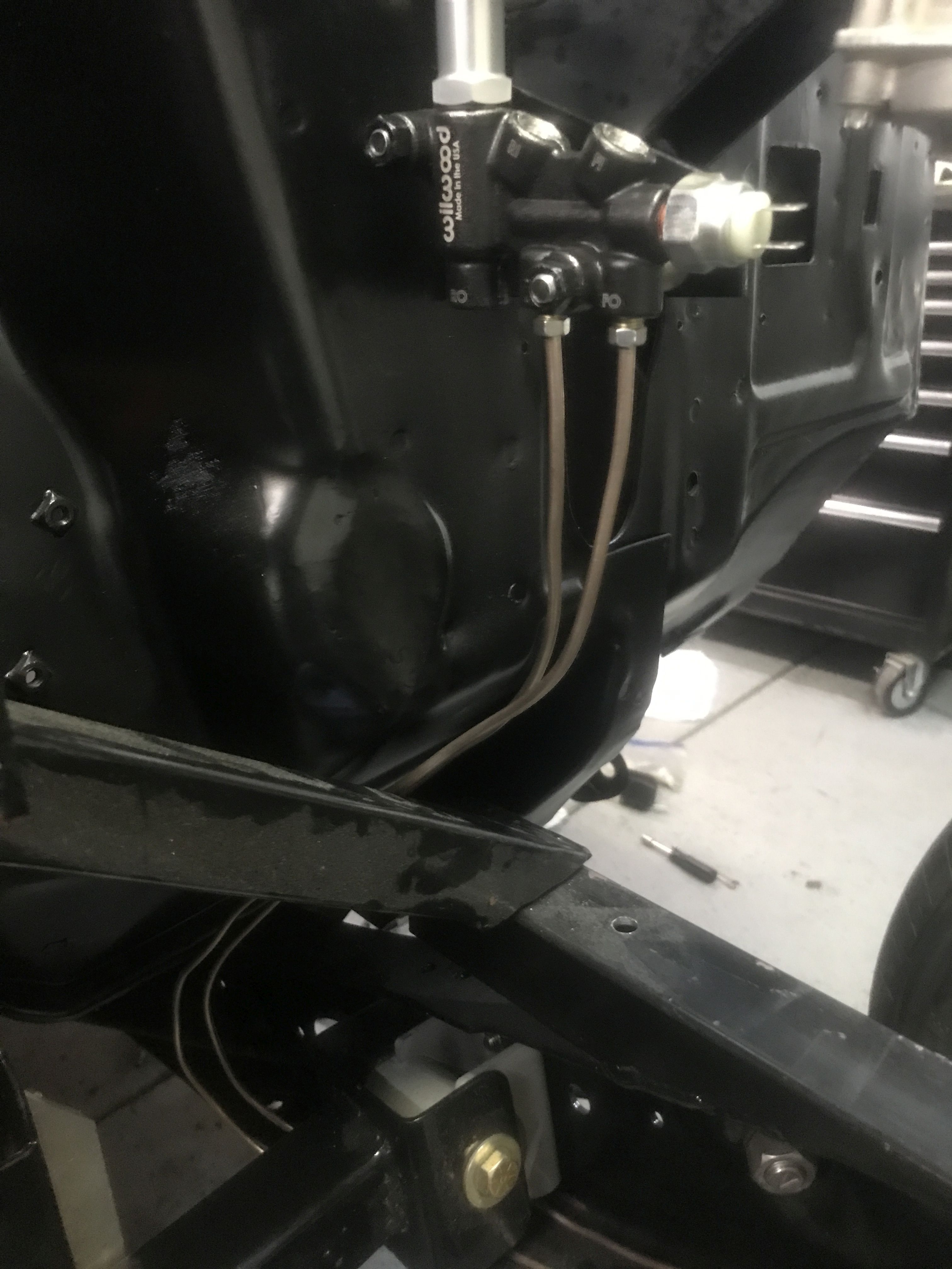

Post by Gregski »

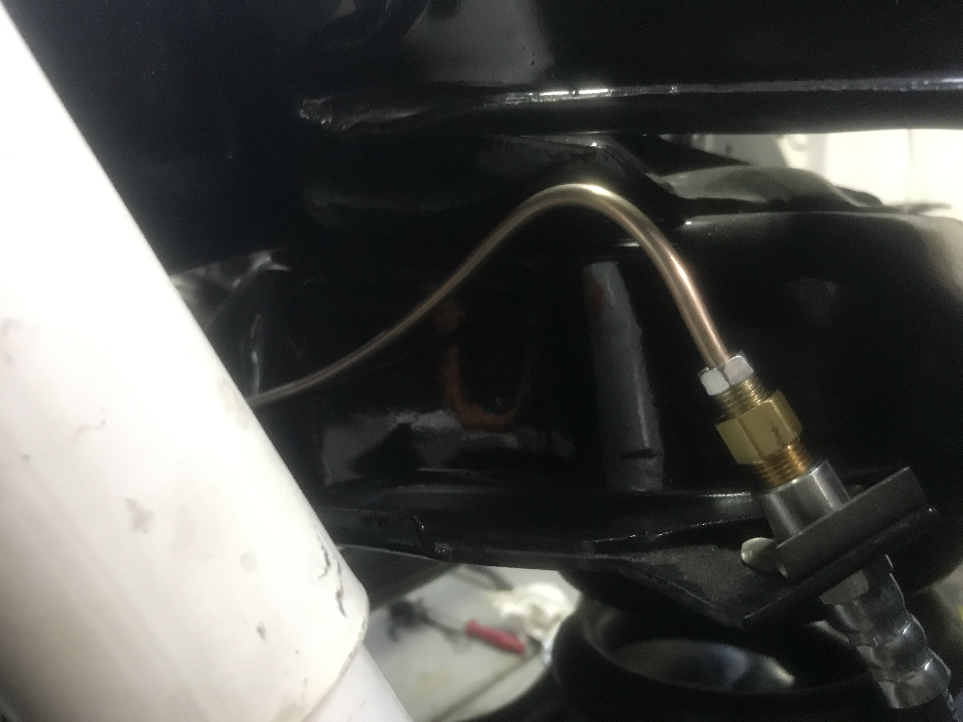

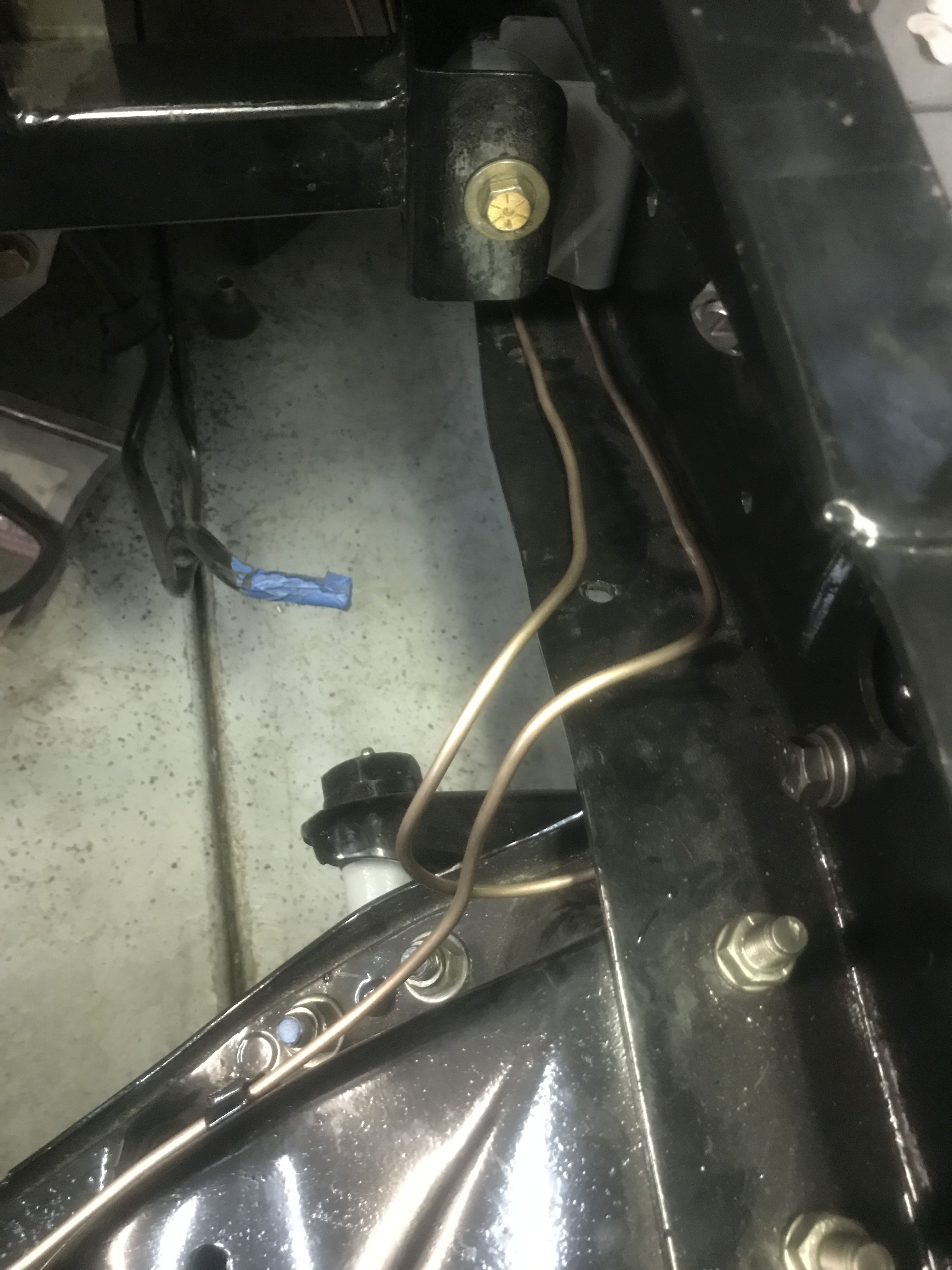

on this episode of Midnight Auto, we finally [start to] tackle the brake lines

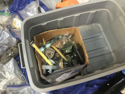

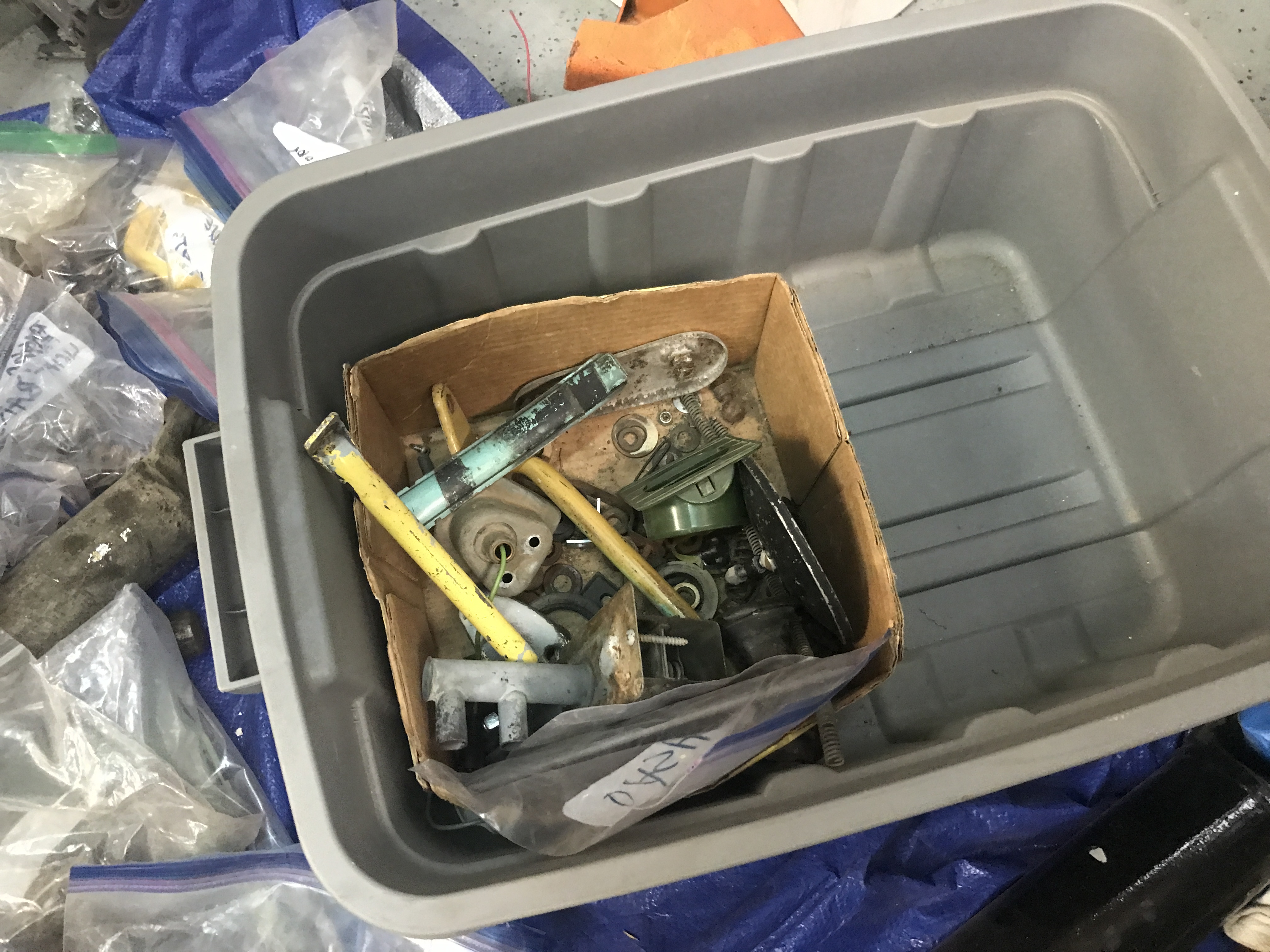

Me: "well I better go finish them brake lines"
also Me: "look a box of random rusty bits!"

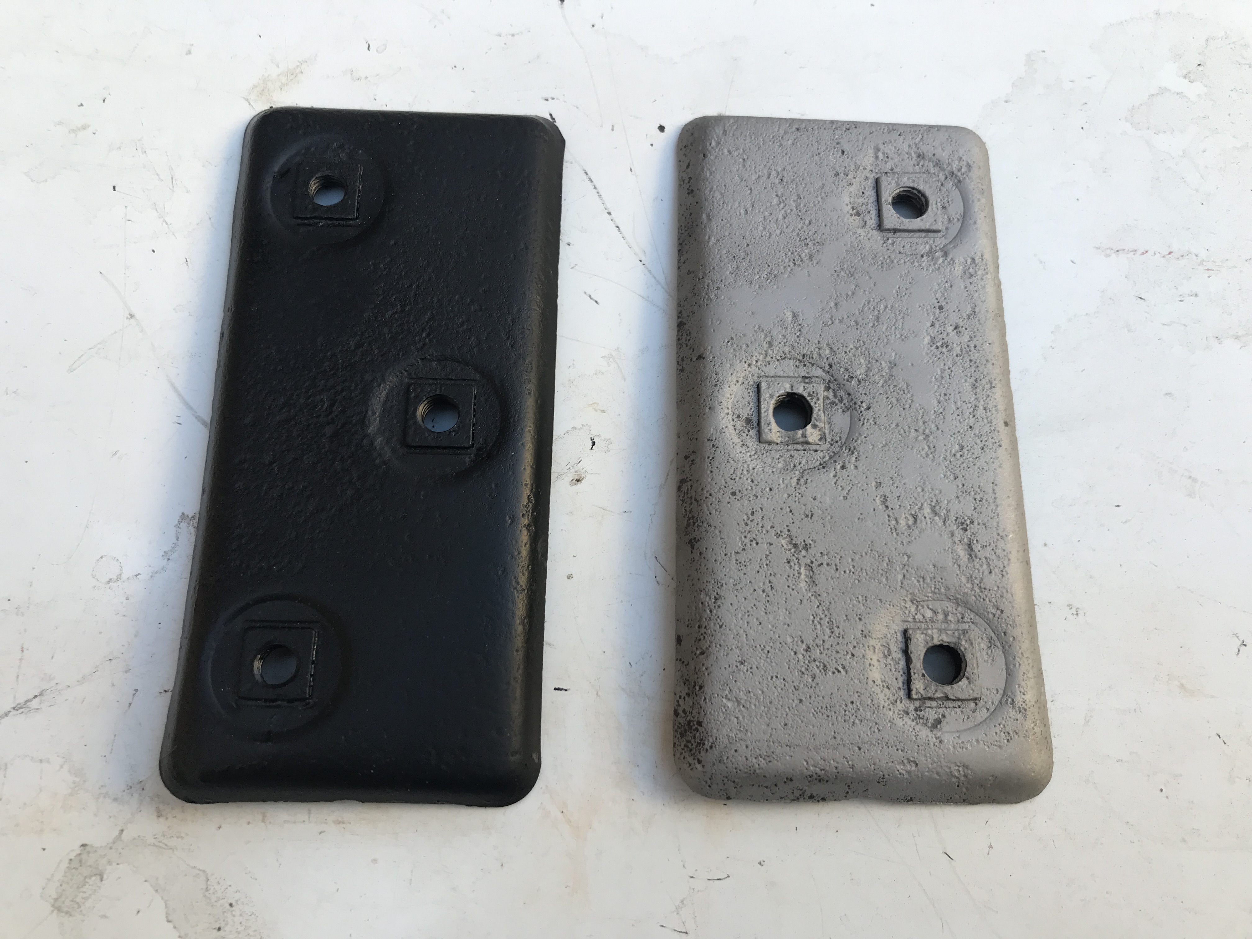

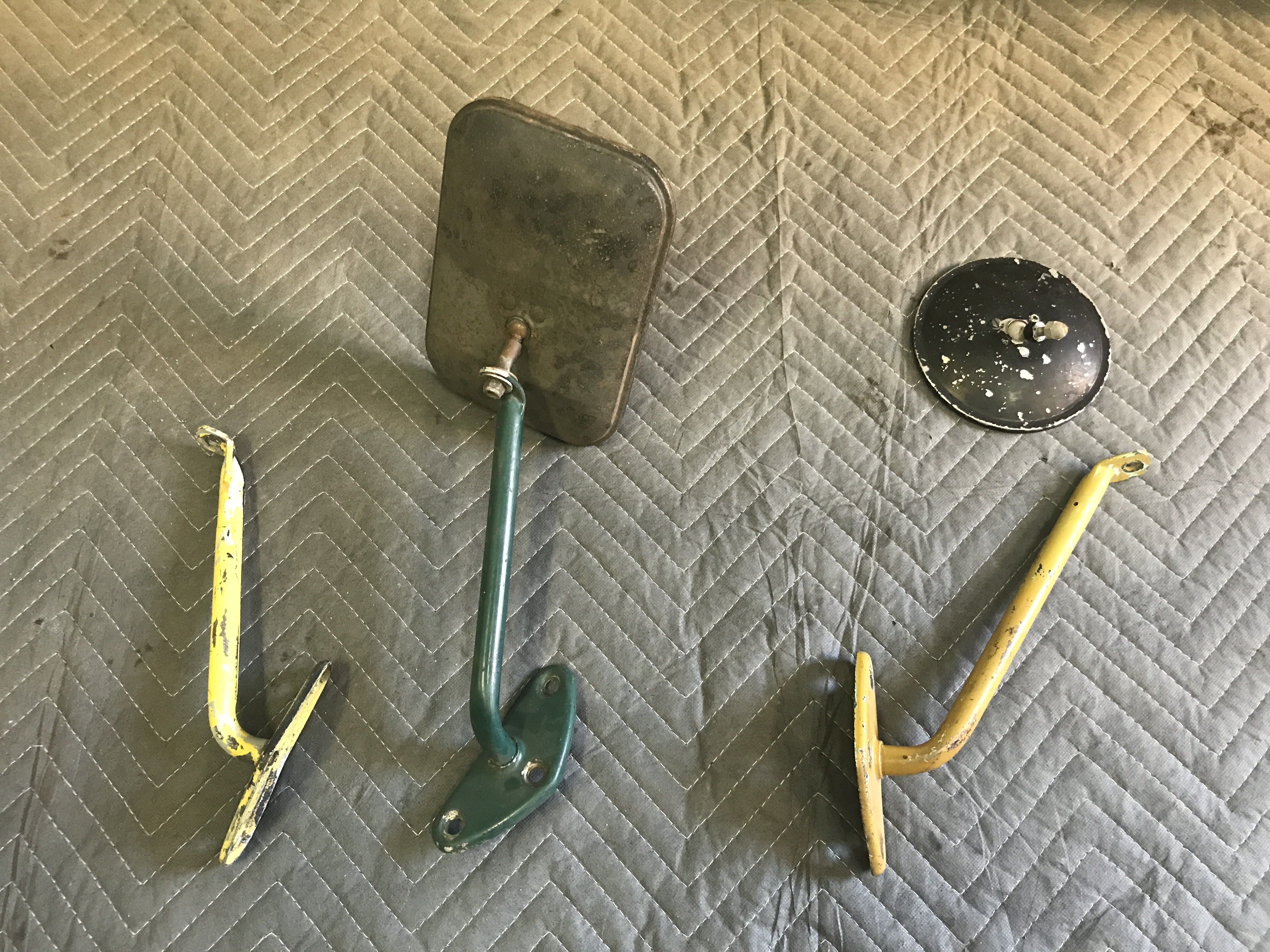

Post by Gregski »

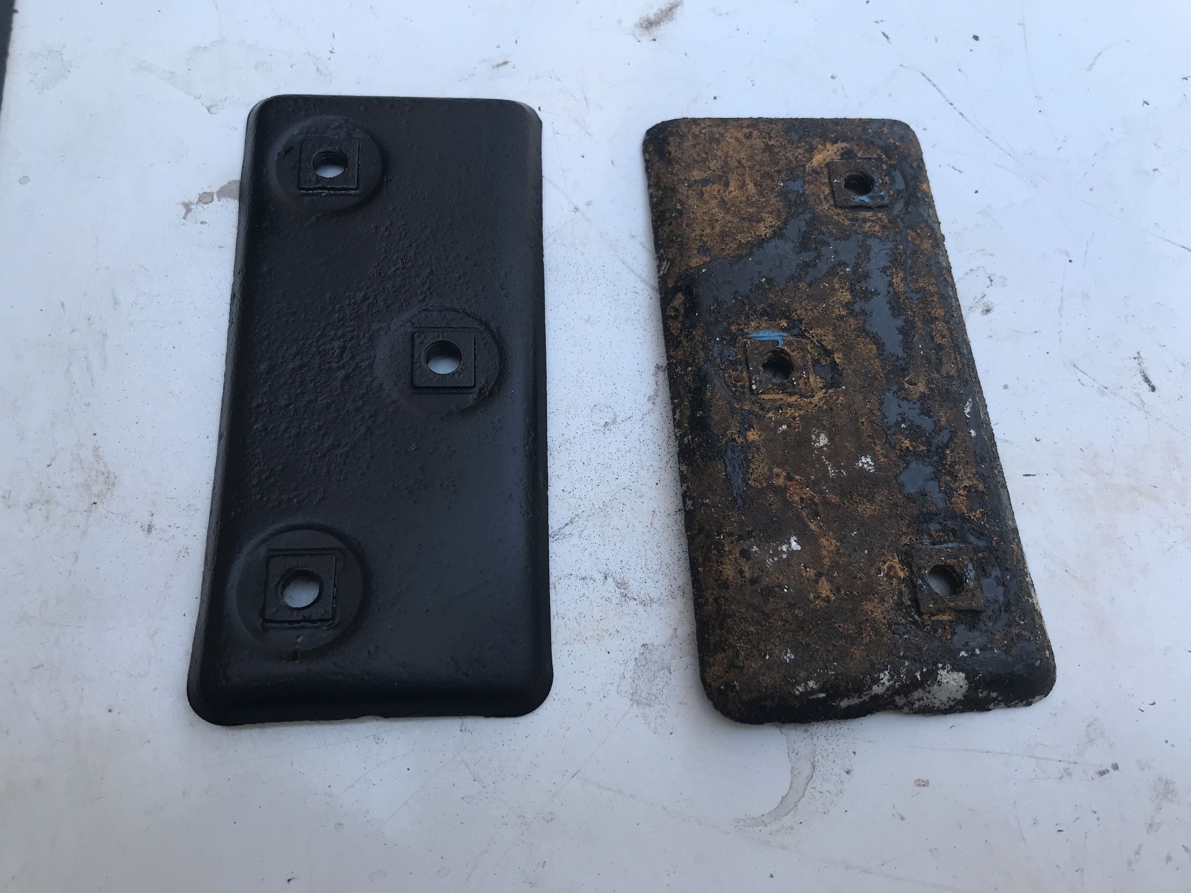

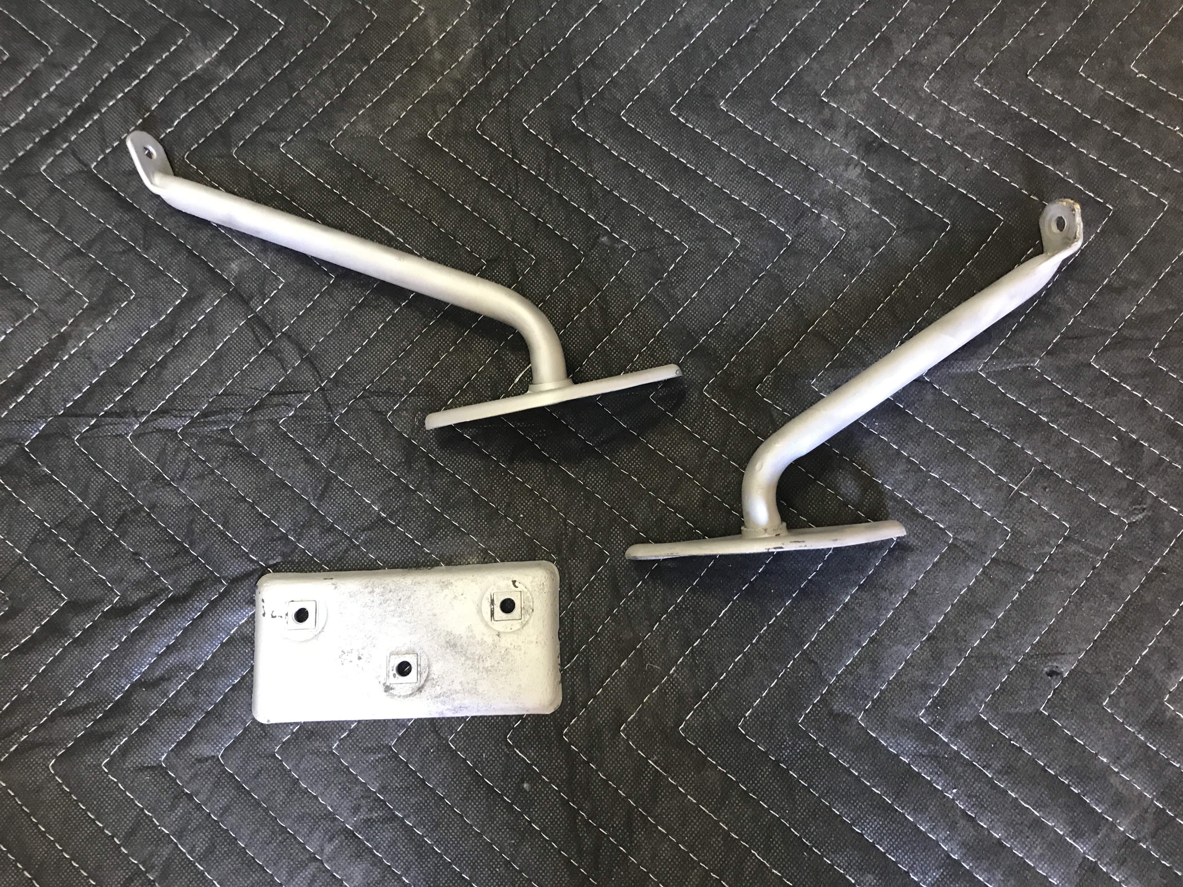

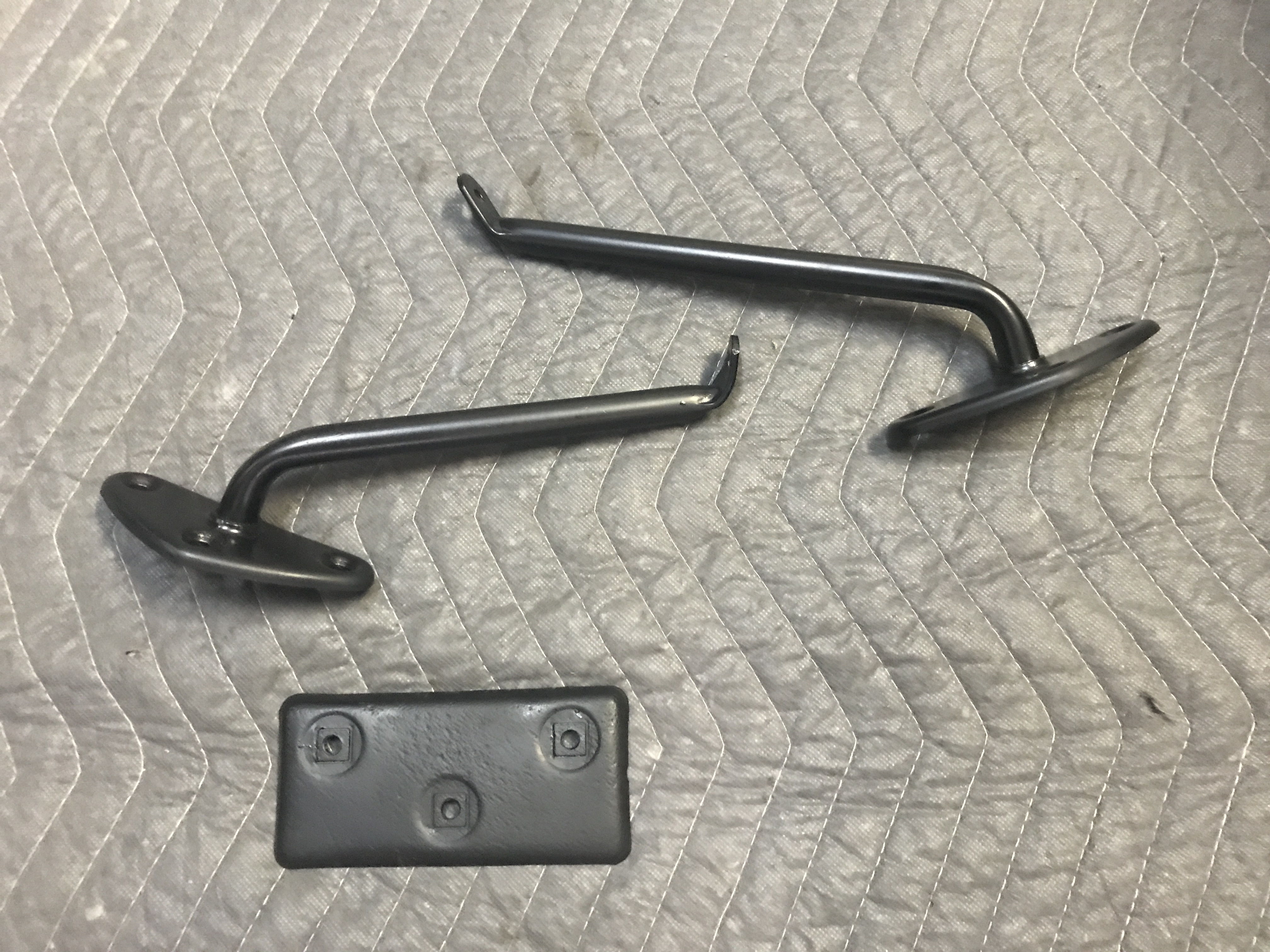

I think I need to put a BOLO out for another side mirror backing plate ?
wait is that sorta like saying ATM machine?

Post by Gregski »
and now,
Racing Top Tip: in order to make turning left easier I run my right hand side, side mirror without the backing plate!

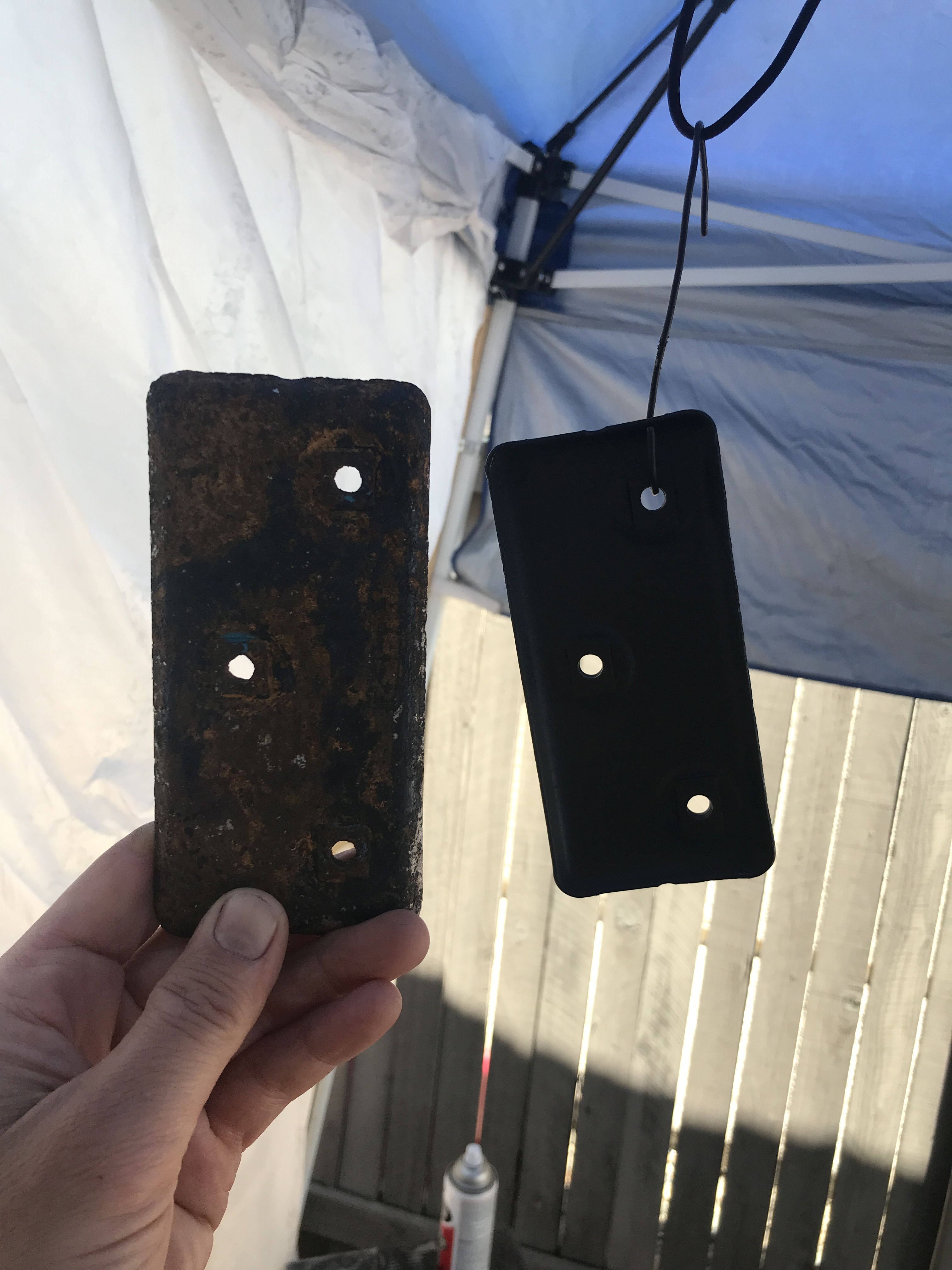

Gregski
Posts: 3161
Has thanked: 631 times
Been thanked: 1608 times

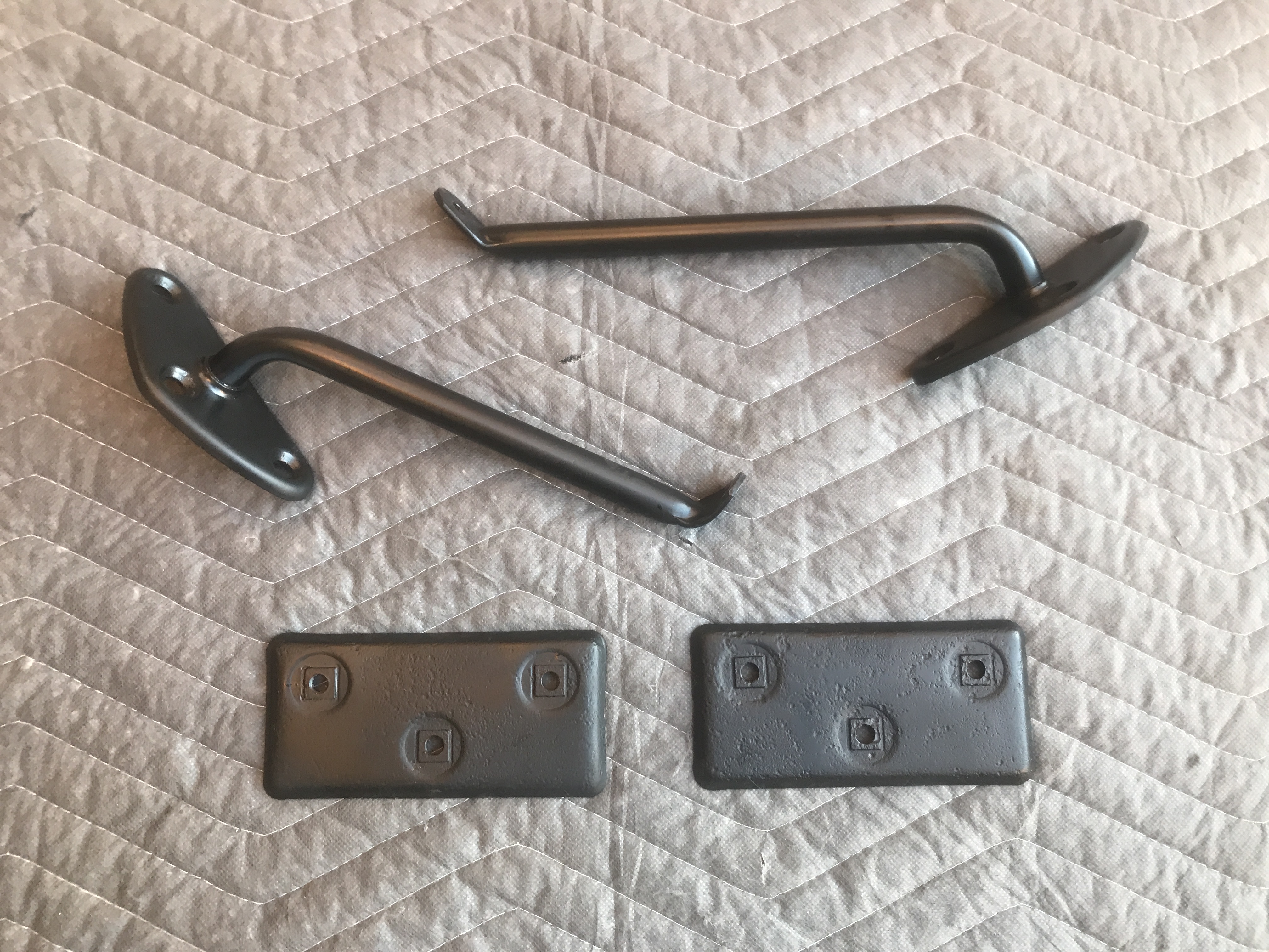

Post by Gregski »
literally as soon as I took the bits above out of the oven I found the missing piece (at the bottom of the Atlantic)

Post by larsrengersen »

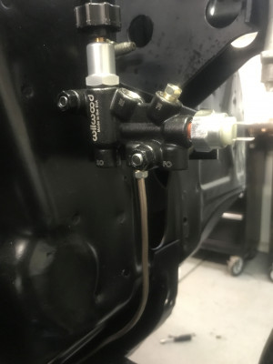

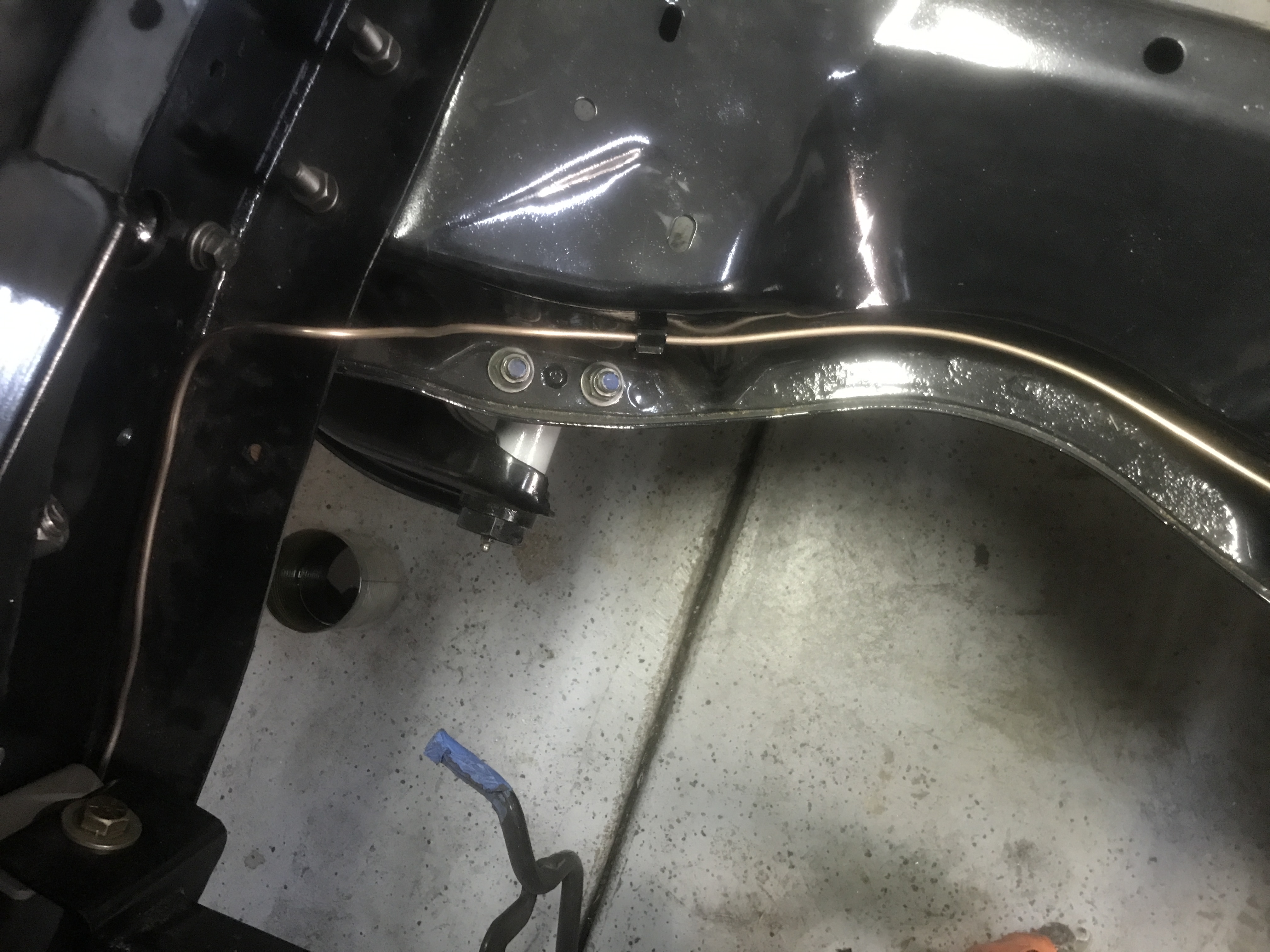

Gregski wrote: Tue Jul 12, 2022 5:34 am on this episode of Midnight Auto, we finally [start to] tackle the brake lines
Must admit that I initially installed the brake lines that way.
However, I now believe swapping them would be the correct and preferred way with rear drum brakes.
If you swap them most fluid displacement will go to the rear in.
But I’m curious what you and others think since in the end you want most stopping power from the front discs but that is up to the valve to handle and residual pressure valve to support.
Gregski
Posts: 3161
Post by Gregski »
larsrengersen wrote: Tue Jul 12, 2022 7:57 pm
thank you for that feedback, really appreciate it, I think swapping those lines shouldn't be too difficult if need be, I believe that Honda CRV came with drums front and rear

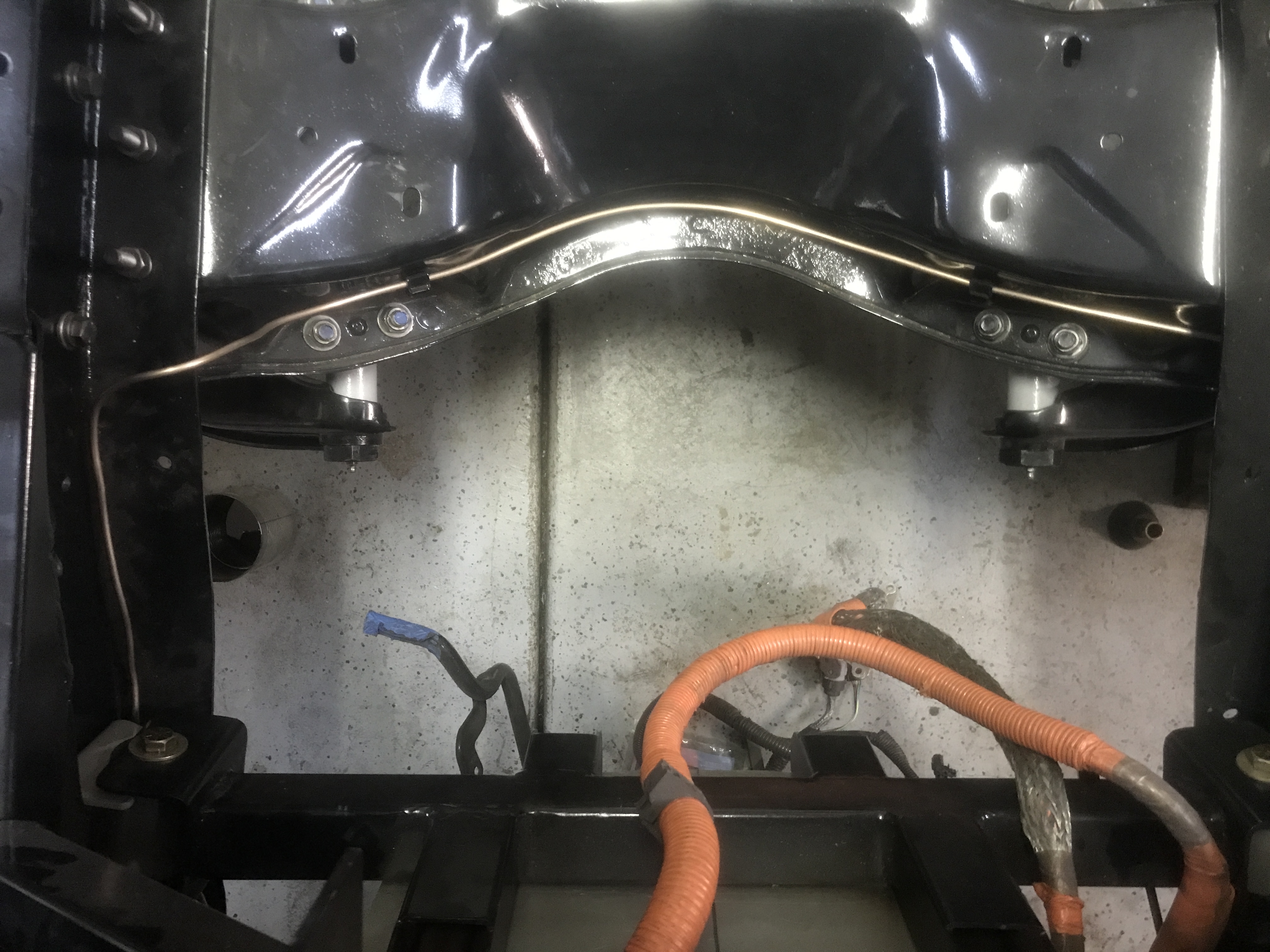

Post by Gregski »
good enuff for government work
and order has been restored
Gregski
Posts: 3161
Post by Gregski »

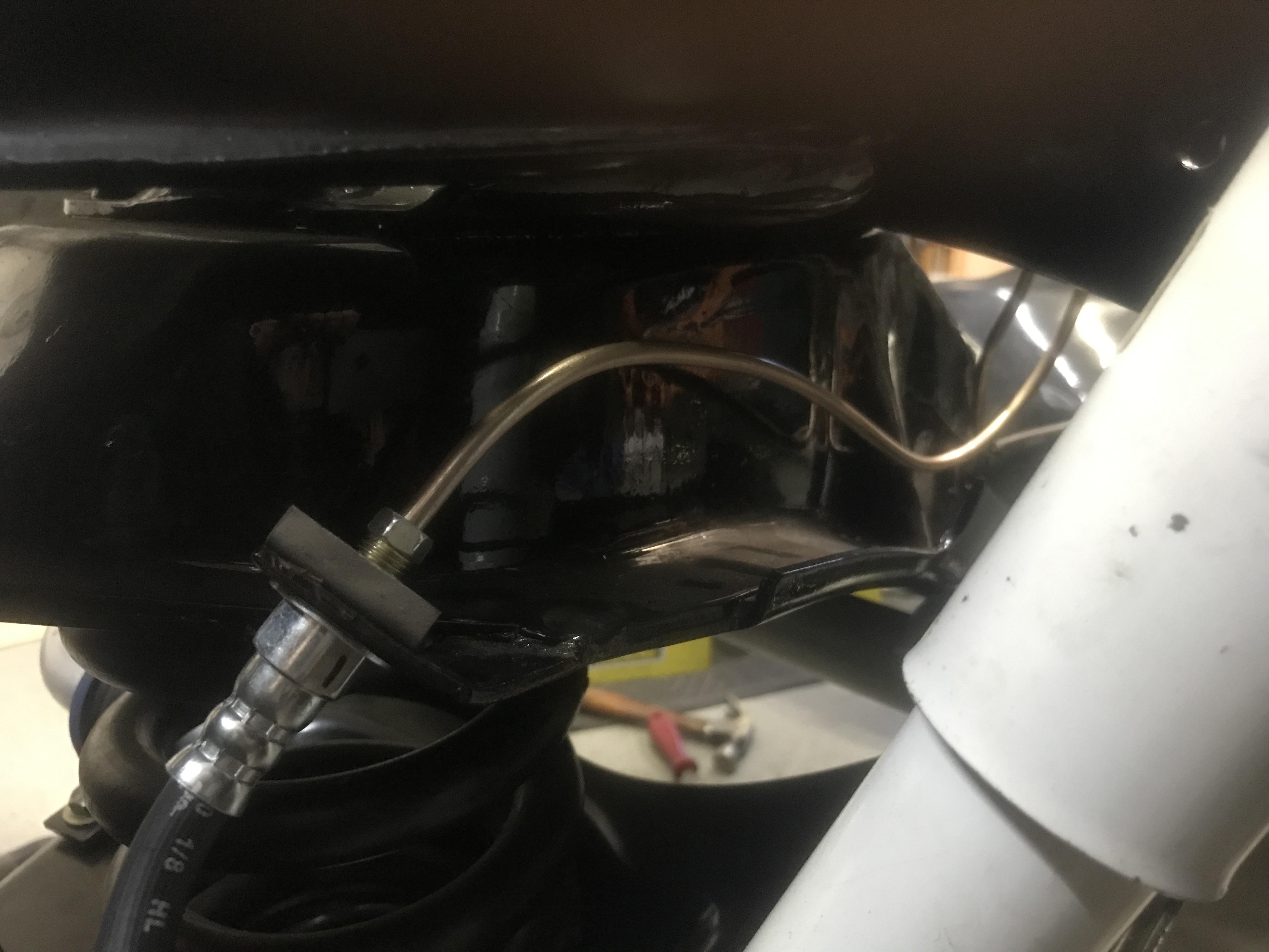

plumbing brakes like a Boss!
nice sweeping curves
Gregski
Posts: 3161

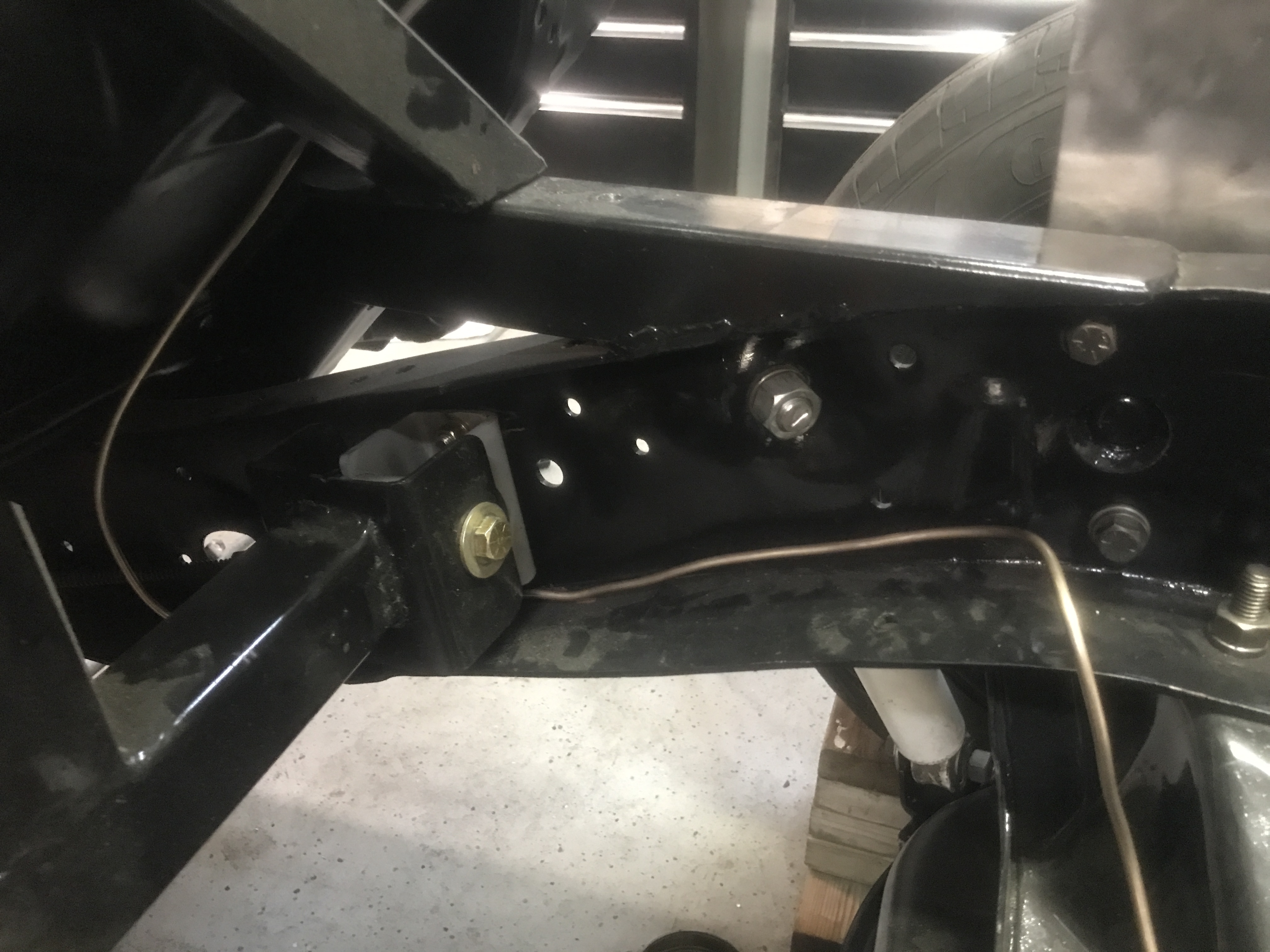

Post by Gregski »
yeah I forgot to put a fitting on my best run, don't judge me
did I mention the nice sweeping curves

Post by Gregski »
I think once I clamputize them they won't look so wild
and I ran out of line, I guess 15 feet was not enuff, so I gotta buy another spool to do the rear drum brake line run, not all the way back to the rear axle just to the transmission crossmember

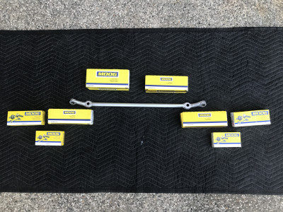

Post by Gregski »
looks like my MOOG steering linkage parts from Rock Auto are on a US tour complements of FedEx
MASPETH, NY
KEASBEY, NJ
SNYDER TWP, PA
PORT CLINTON, OH
CHICAGO, IL
COUNTRYSIDE, IL
CAMDEN, MO
HIGGINS, TX
ENCINO, NM
NAVAJO NATION, AZ
NEEDLES, CA
BAKERSFIELD, CA
STOCKTON, CA
Shipment exception
Weather delay

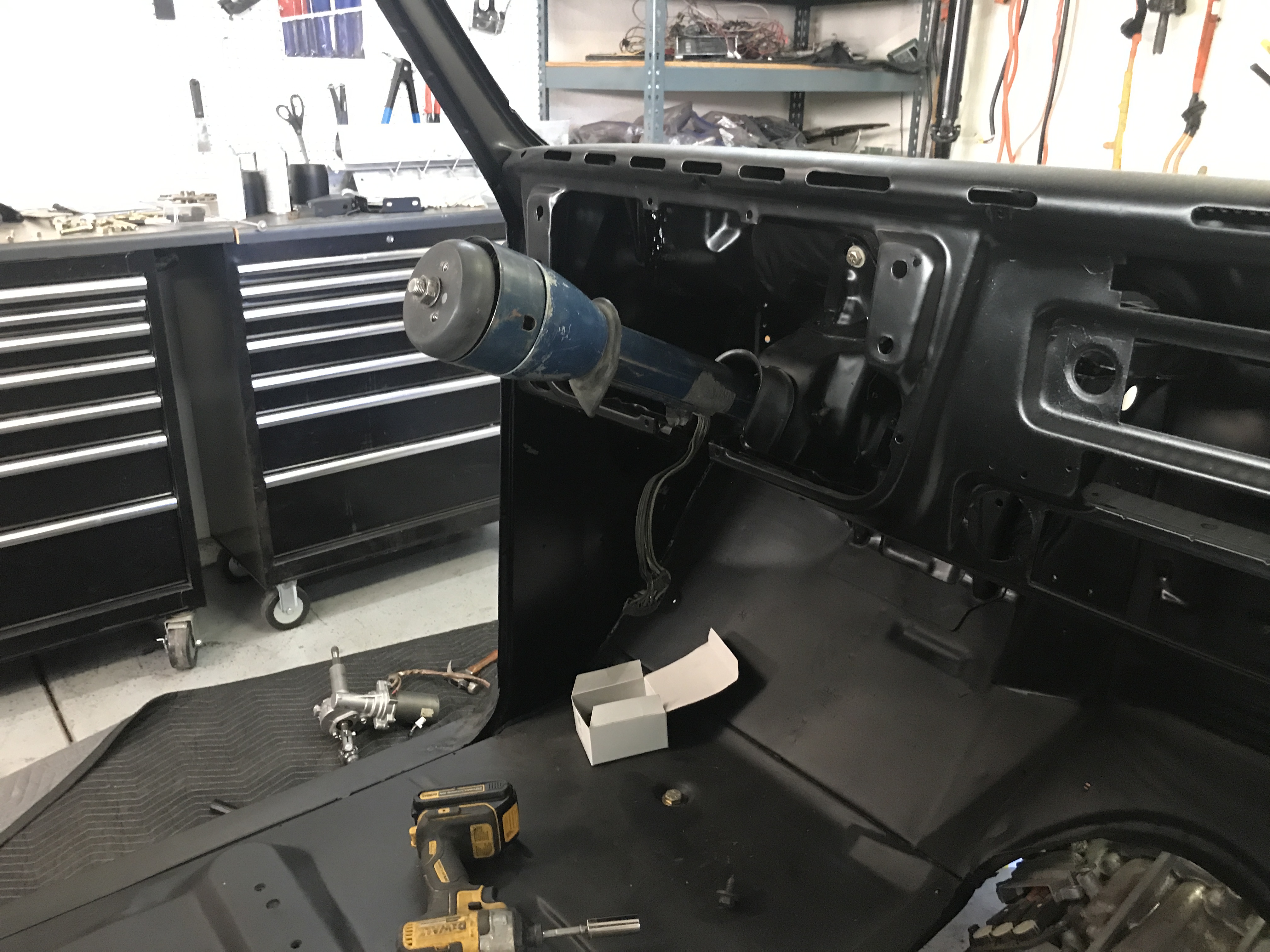

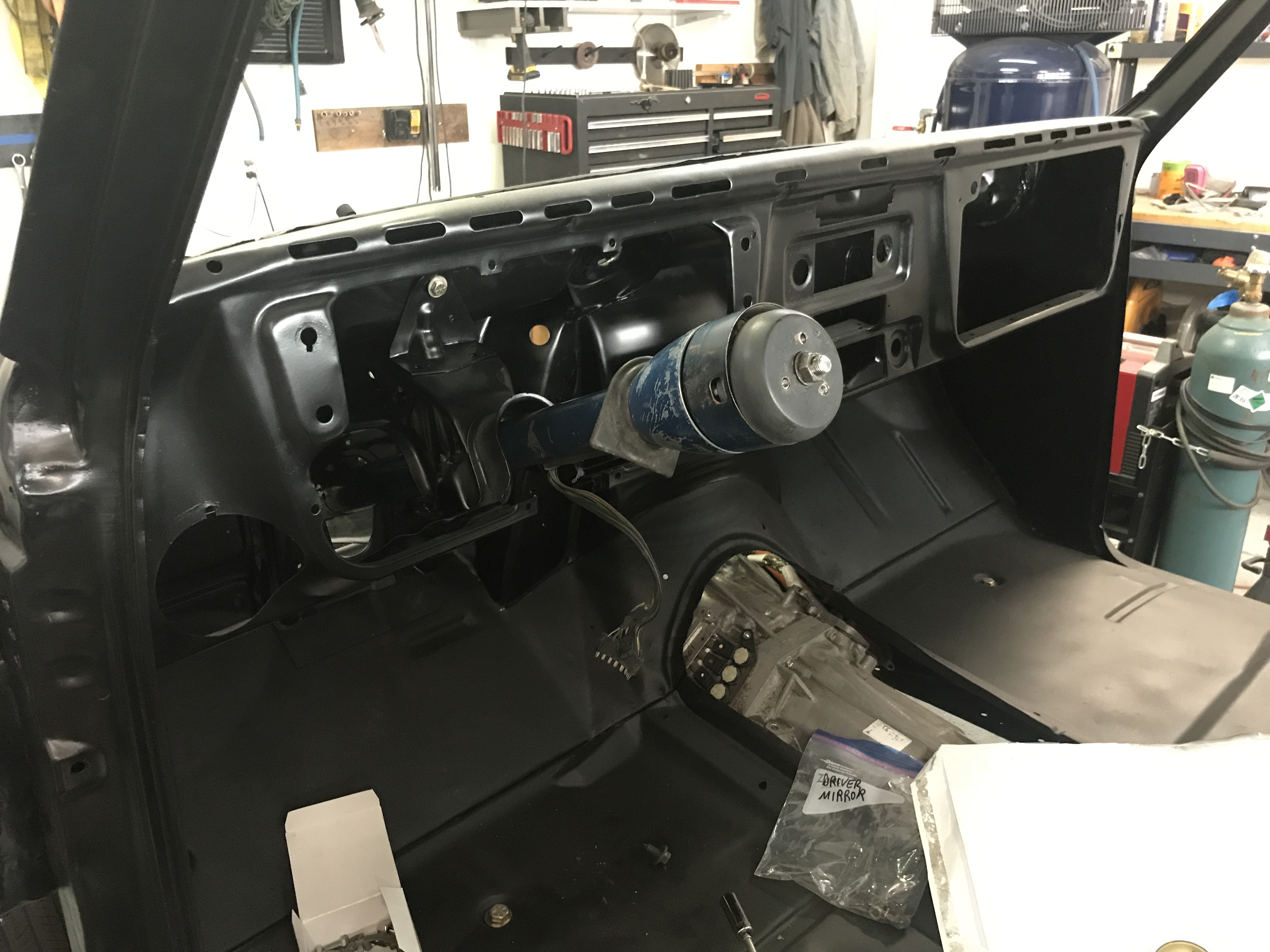

Post by Gregski »

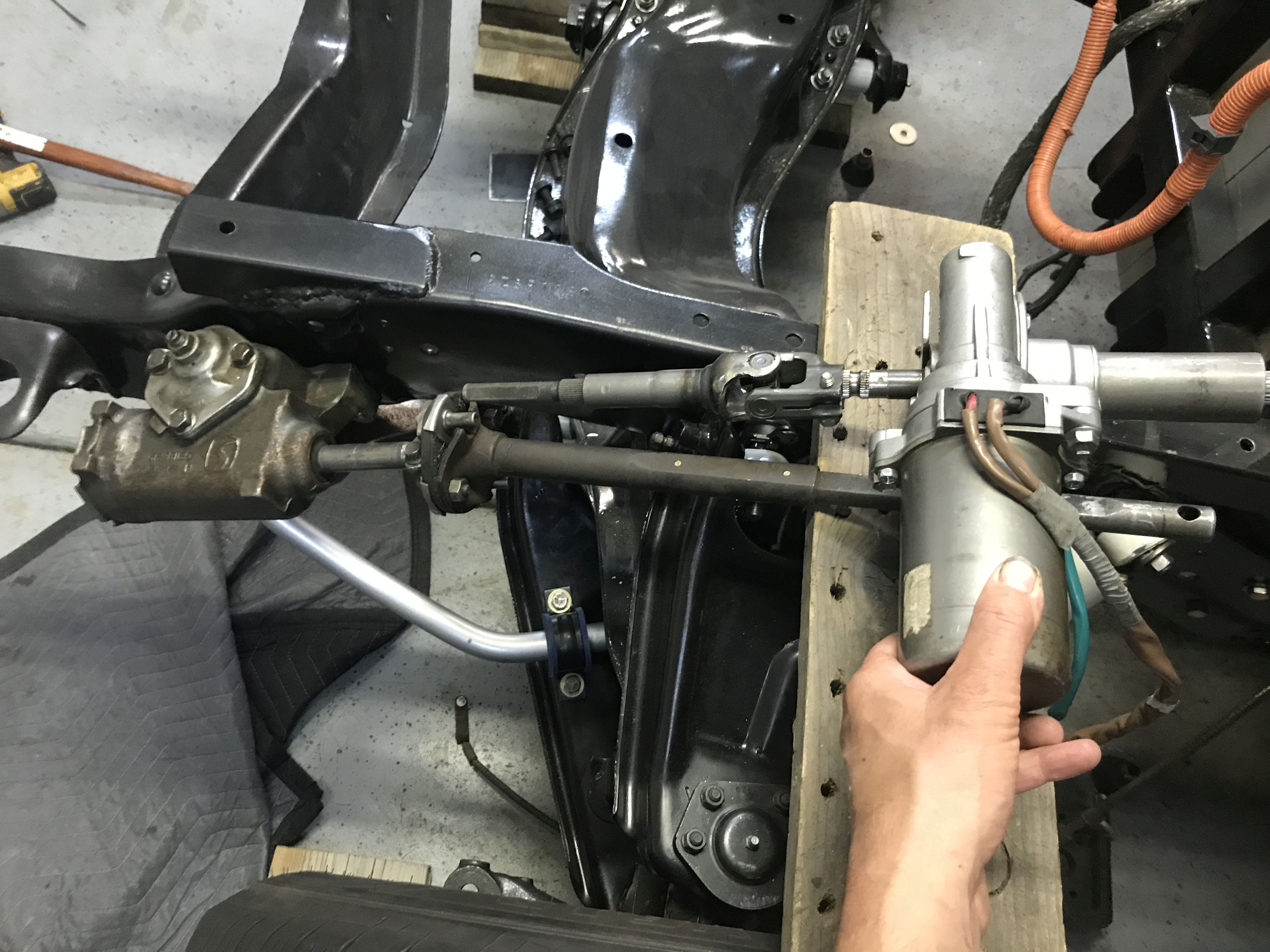

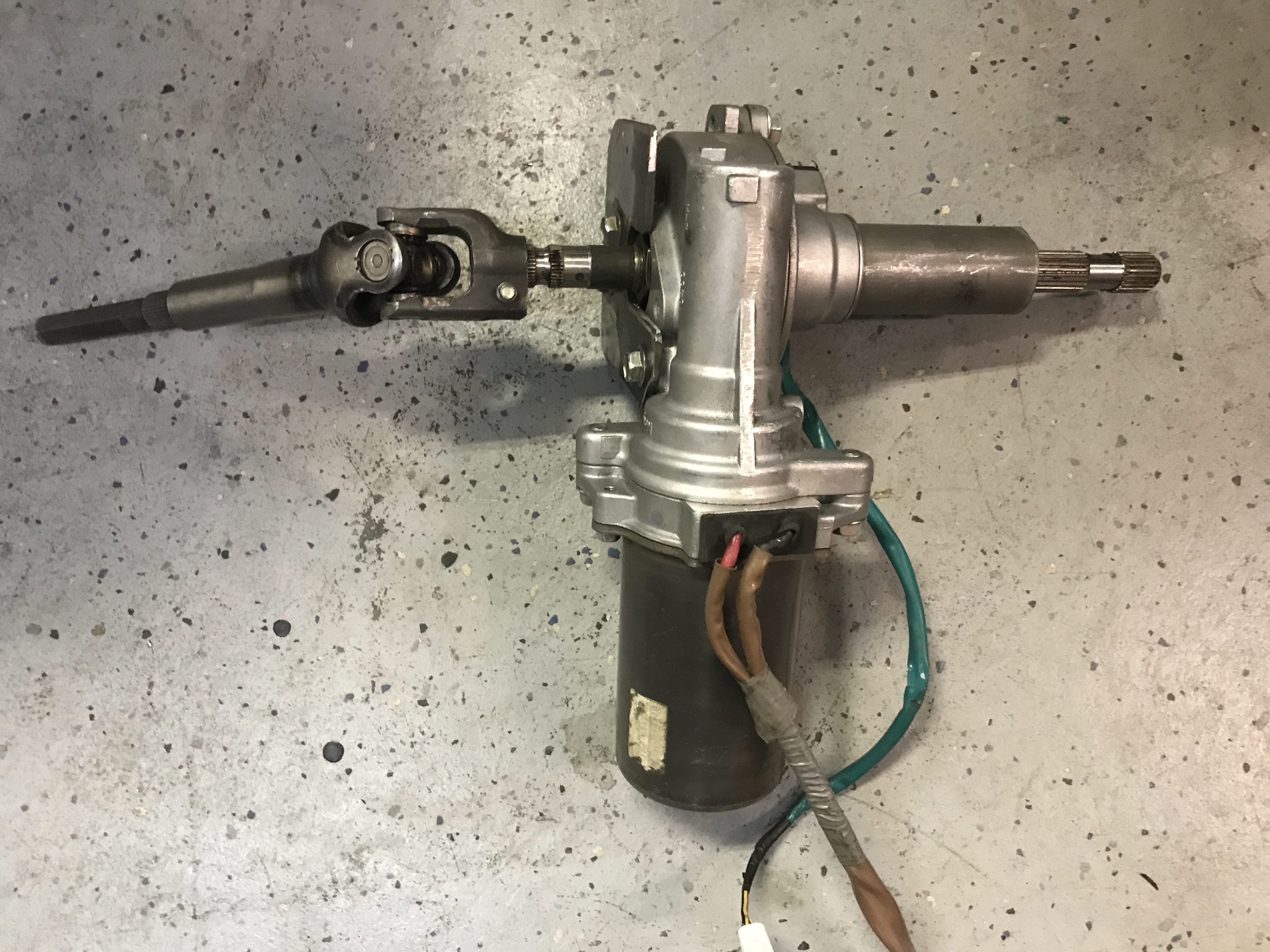

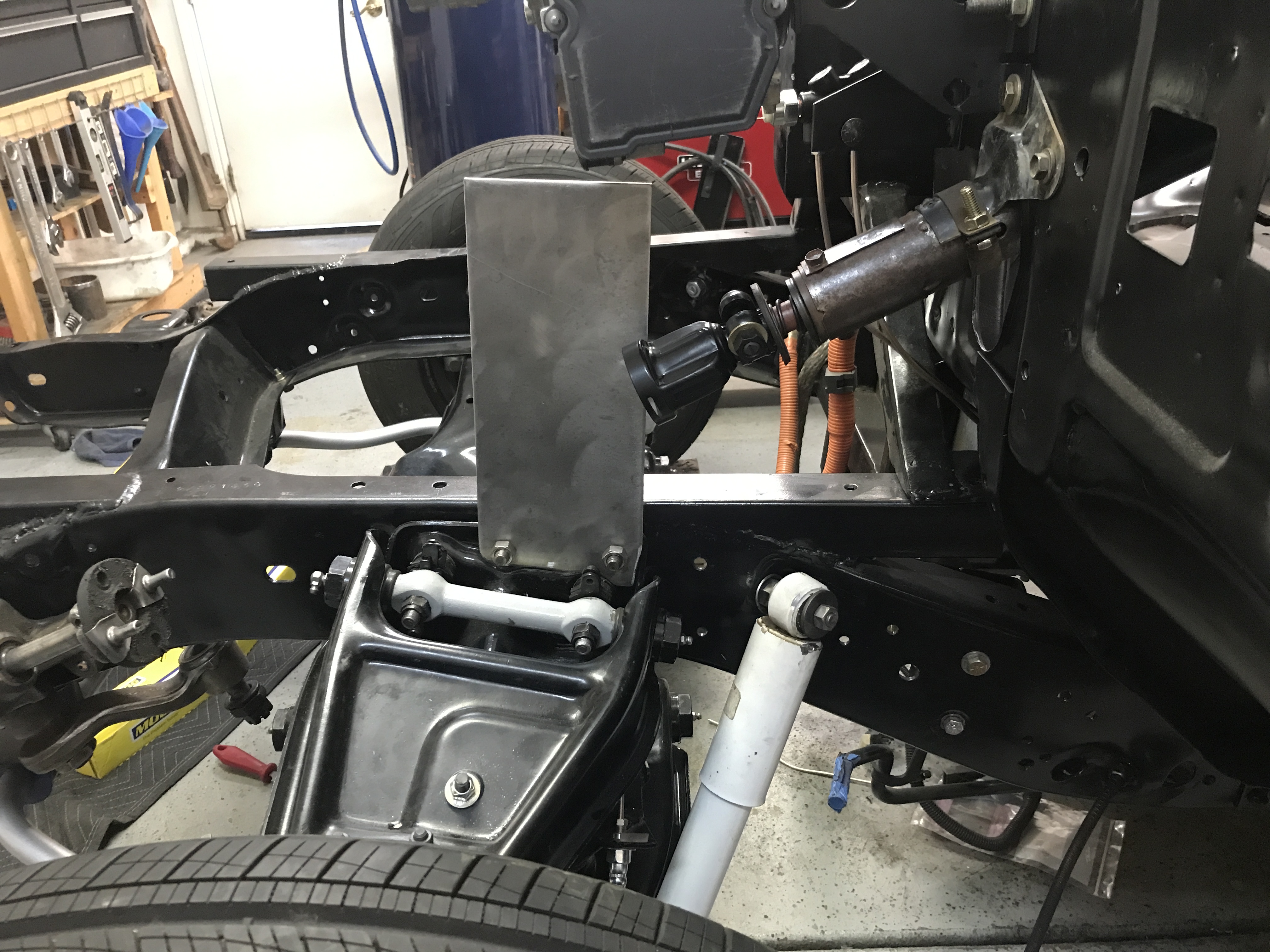

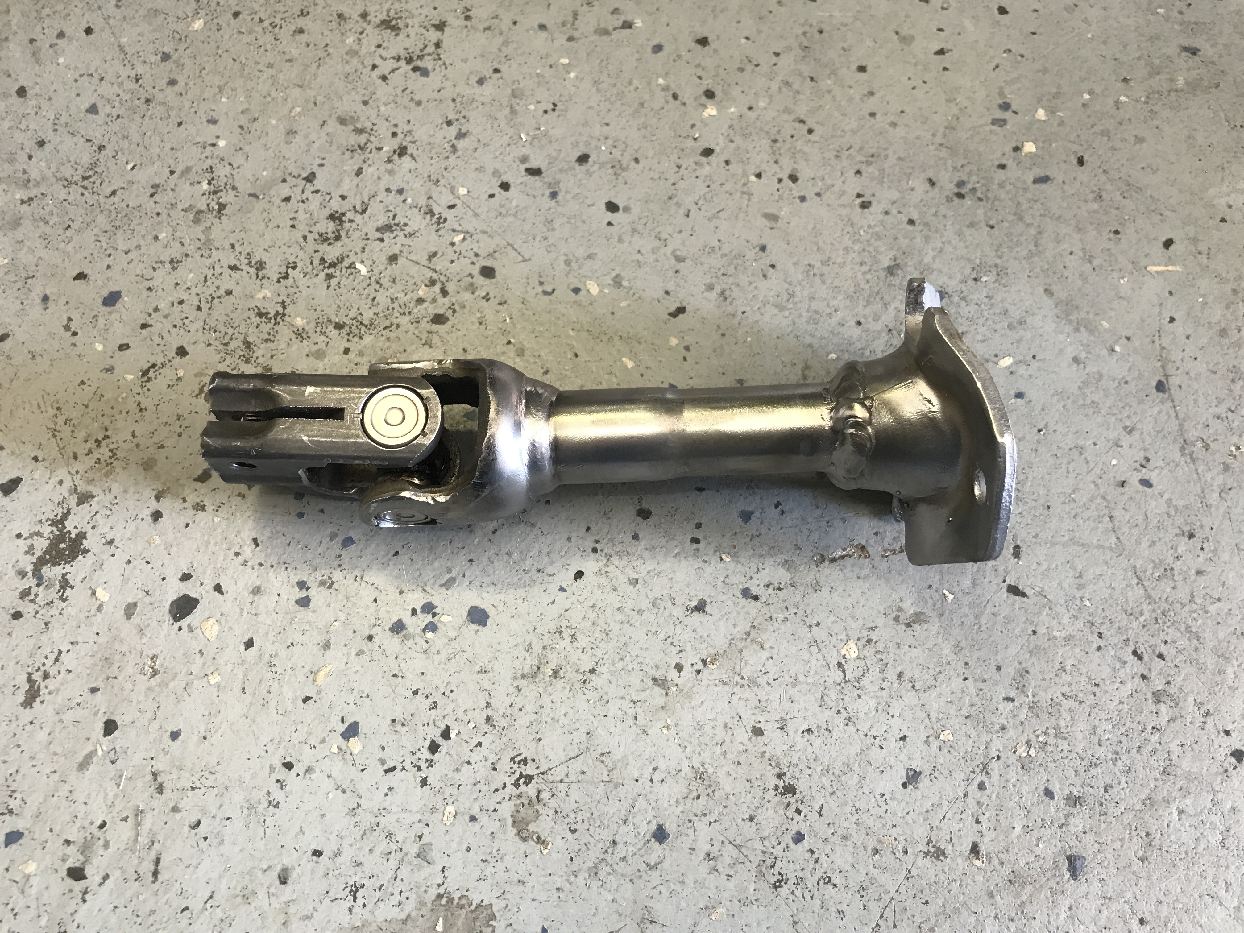

so I decided to install the new old steering column in just for mock up of the Prius electronic power steering
now we can determine the distance the Prius power steering mechanism needs to fill from the Chevy point A to the Chevy point B type of thing

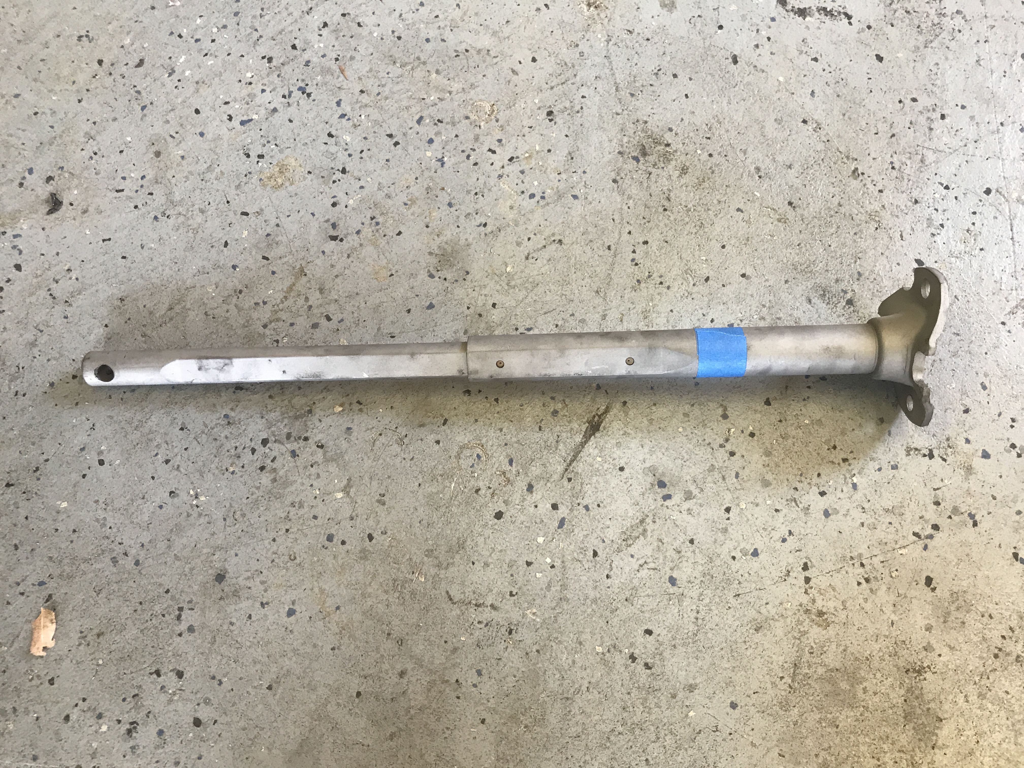

Gregski
Posts: 3161
Post by Gregski »

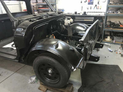

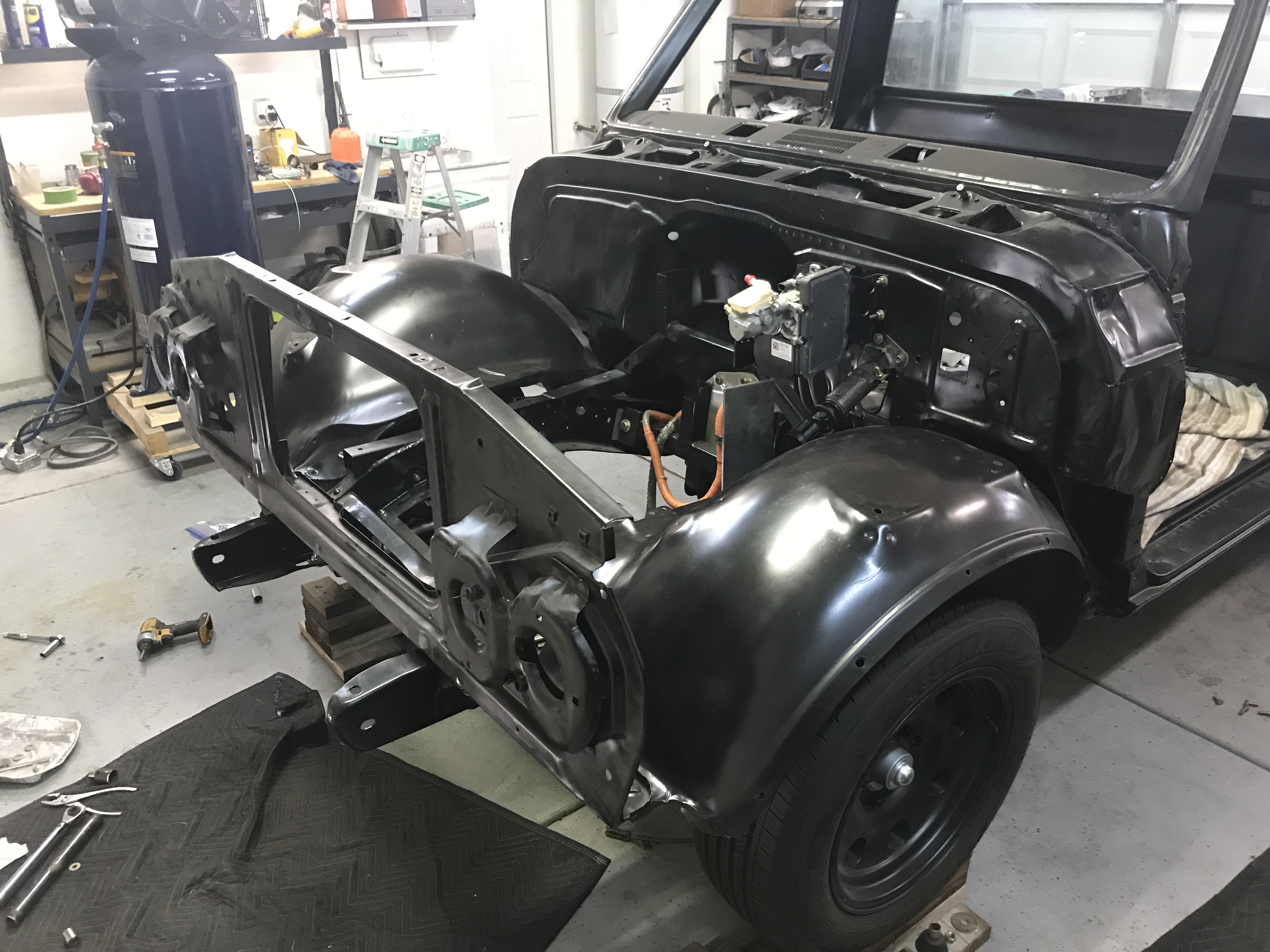

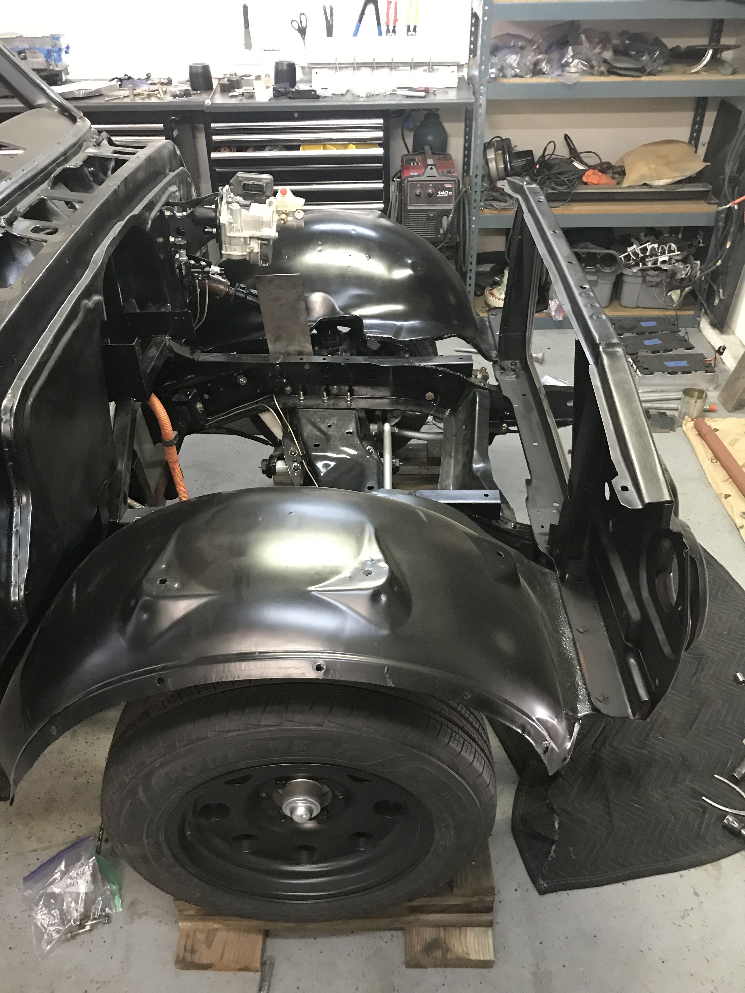

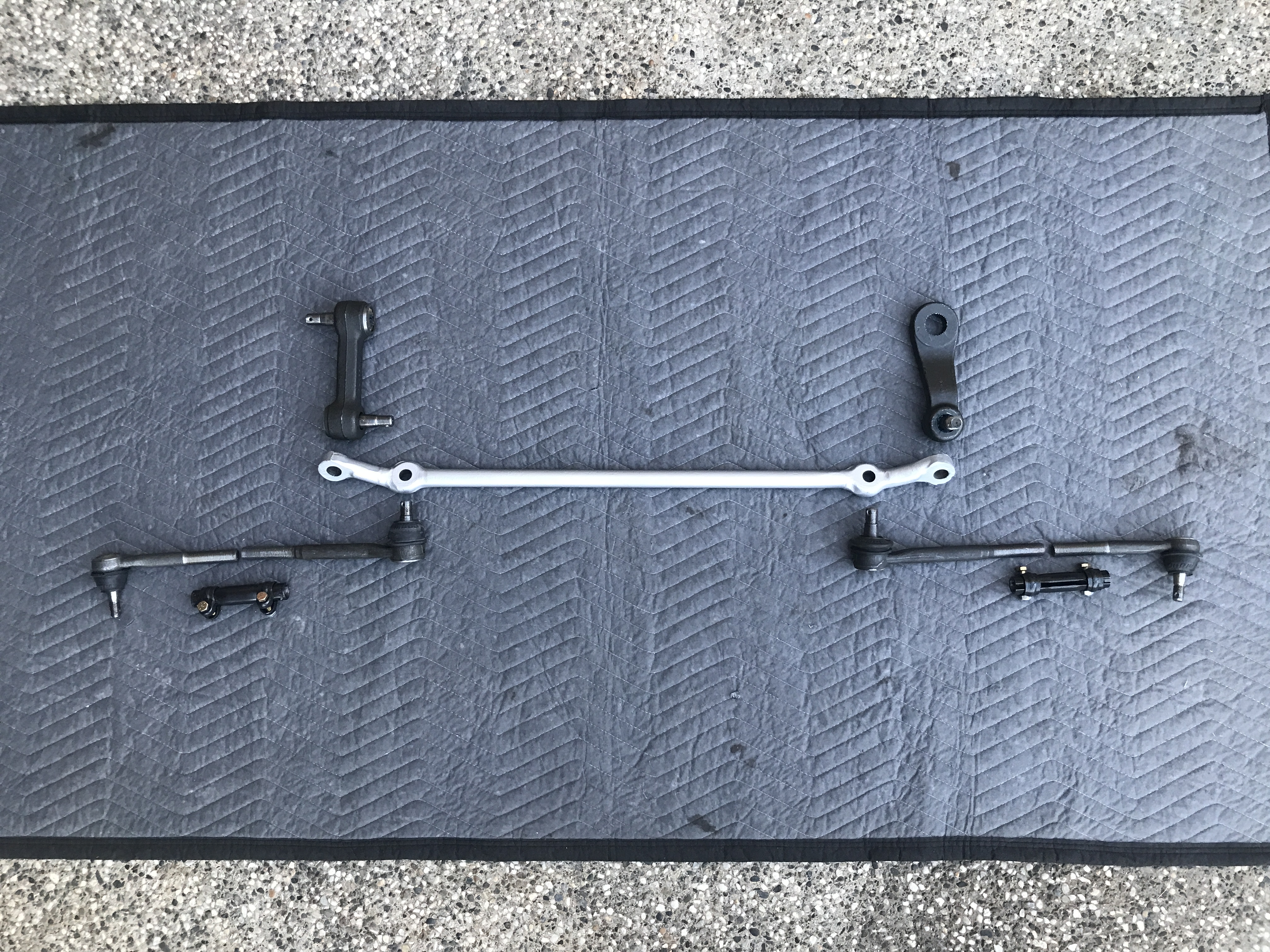

big day today, hope to accomplish quite a bit, install brand new steering linkage, and get the radiator core support and inner fenders back on, among 7 million other little things, you know how it goes...
American version of the rack n pinion steering jobbie thingie
Gregski
Posts: 3161

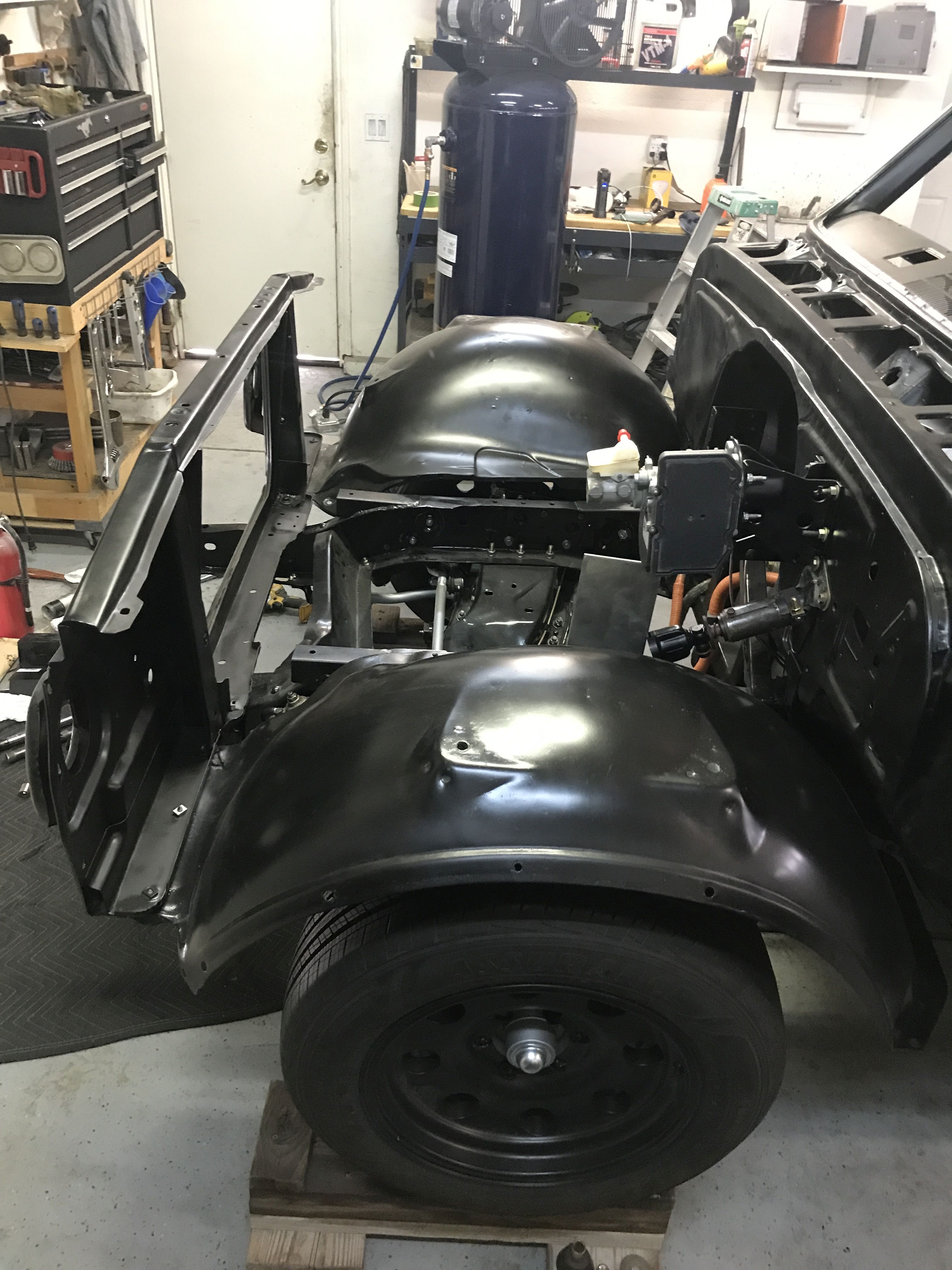

Post by Gregski »
so with a help of a friend got the steering linkage on, the inner fender, and the radiator core support
Gregski

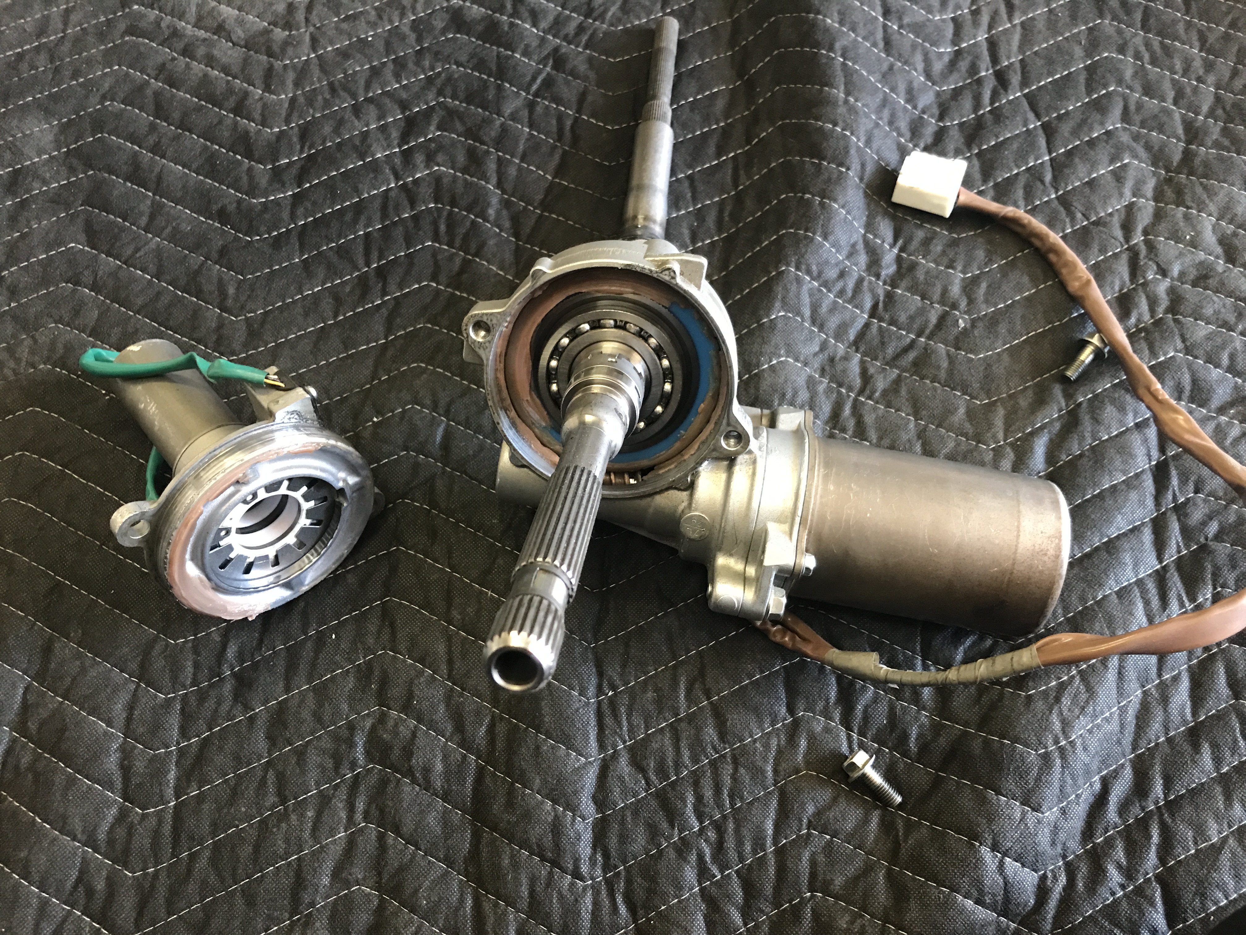

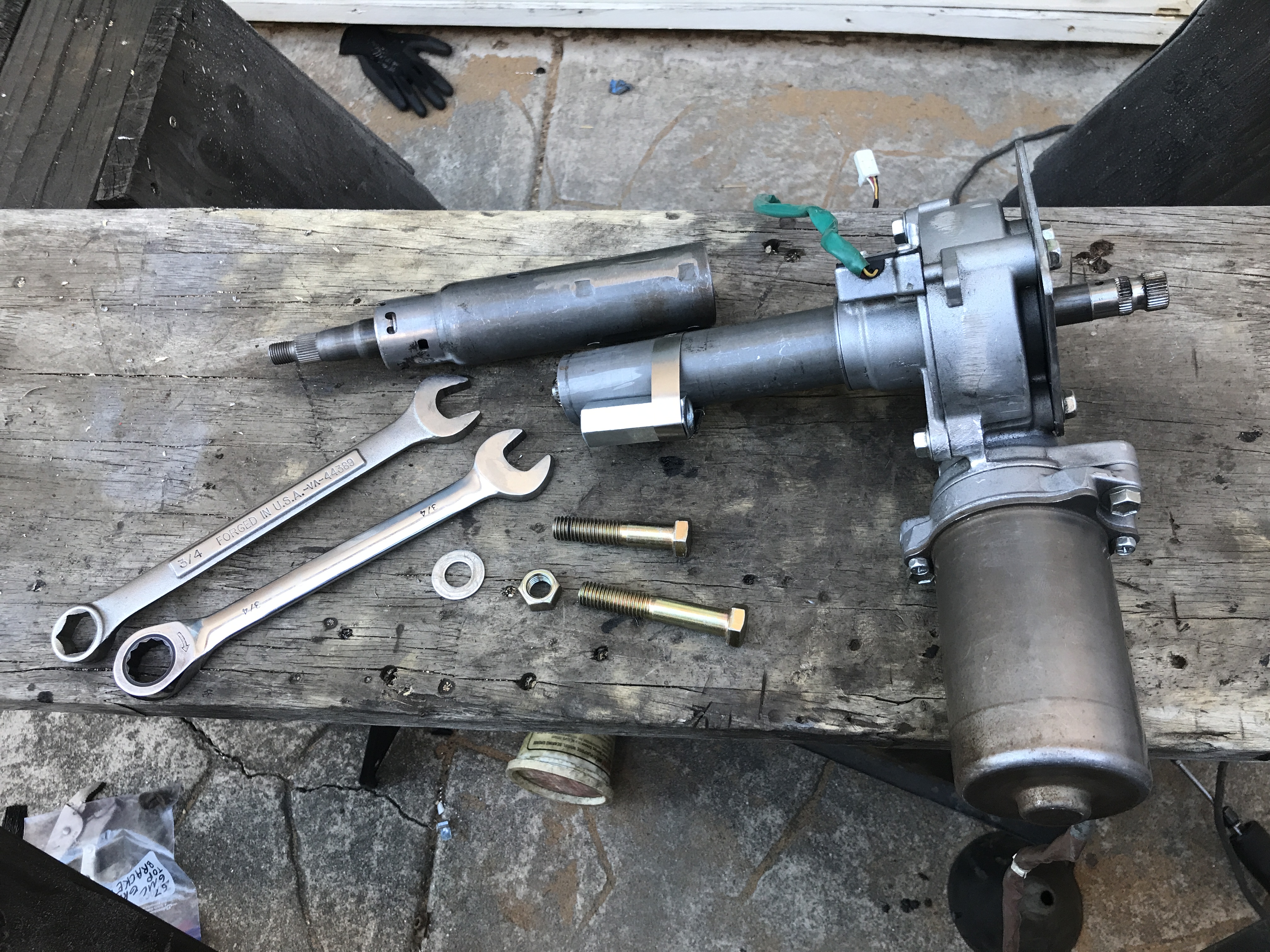

Post by Gregski »

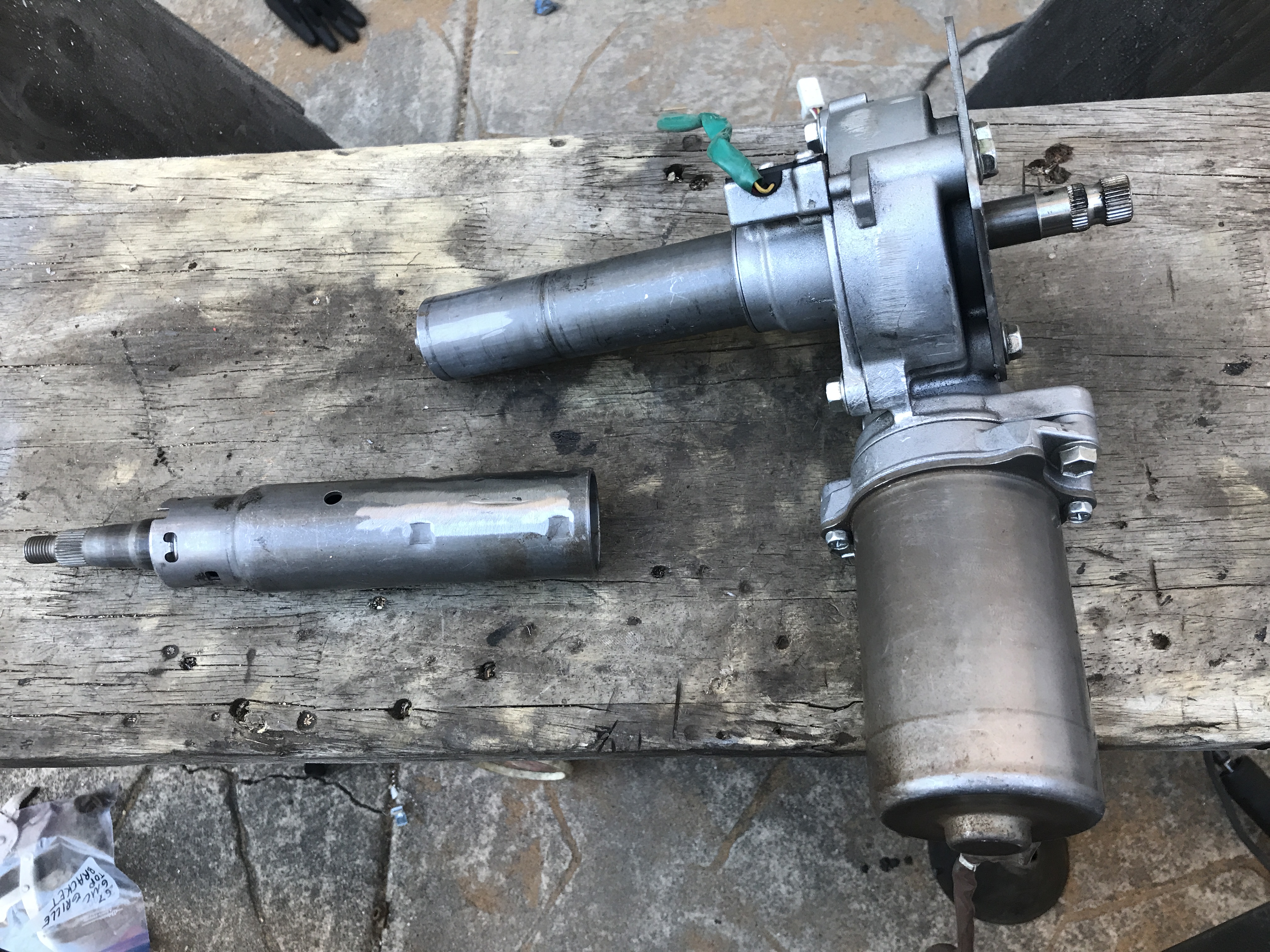

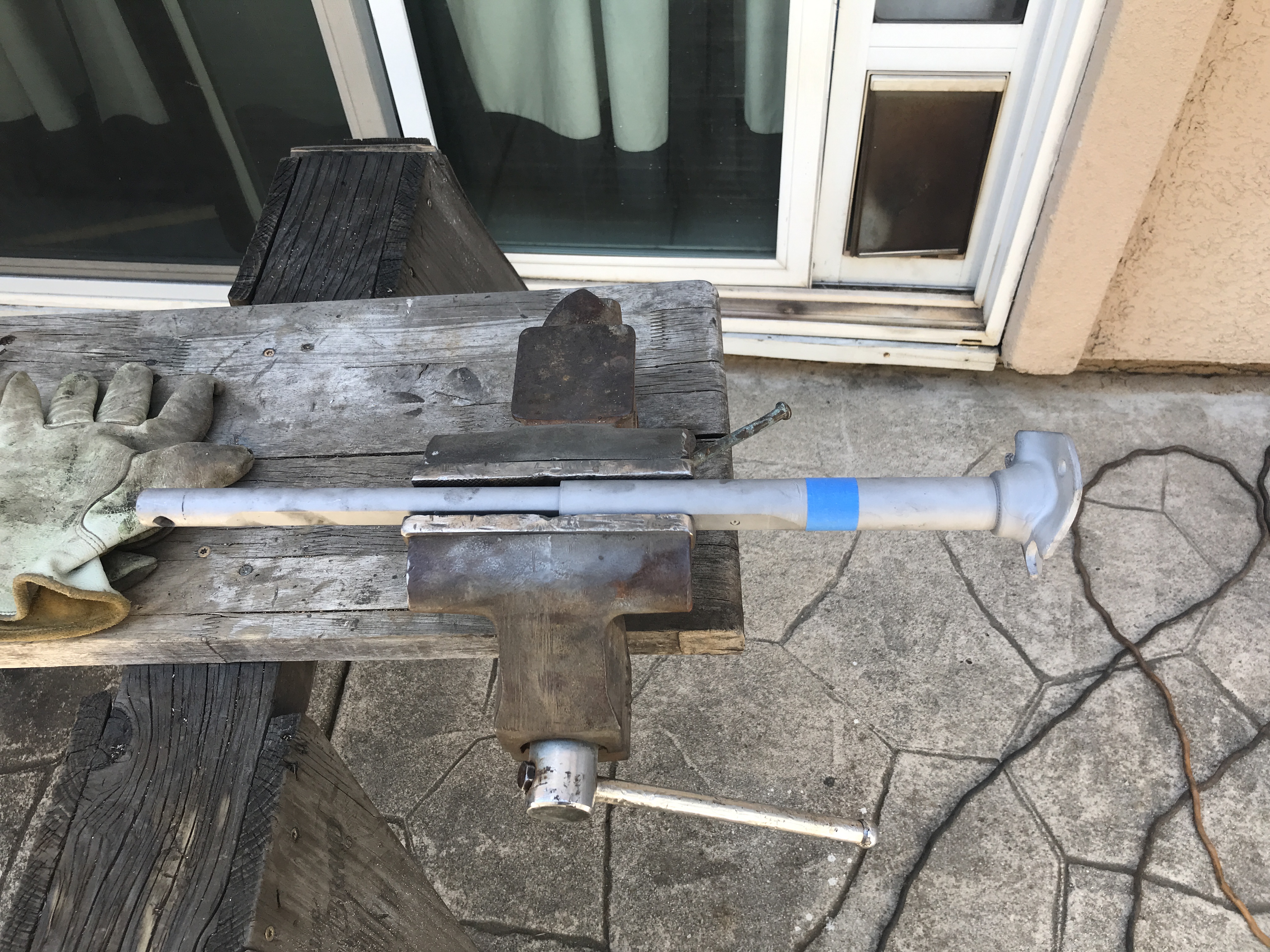

then we took on the Prius power assist steering and decided to graft it into the GM intermediate steering shaft
this end goes to the stock GM manual steering box connected via what is called a rag joint

Post by Gregski »
here we are re clocking the Prius gizmo
