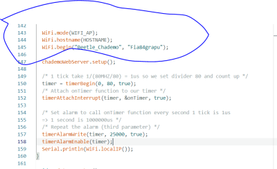

Ok back to this. I think I found the problem. Is default IP for ESP32 should be 192.168.4.1 But mine is not defining the default serial.
I added this in the INO file.
And got this in the serial printout on the Arduino screen.
And ...

If you connect to the ESP32 wifi network and the ip address will be 192.168.4.1
And got this in the serial ...
