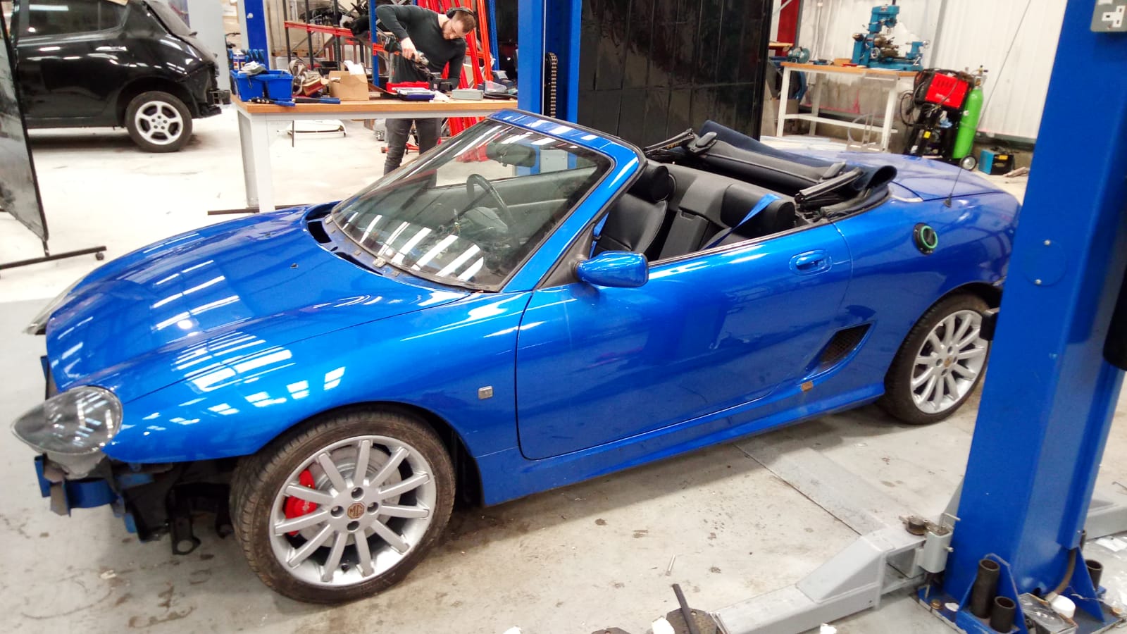

Let us know if you need a test vehicle, we have 3 running leaf motor/inverter with our own powertrain controller. would be happy to use one to help trial this.

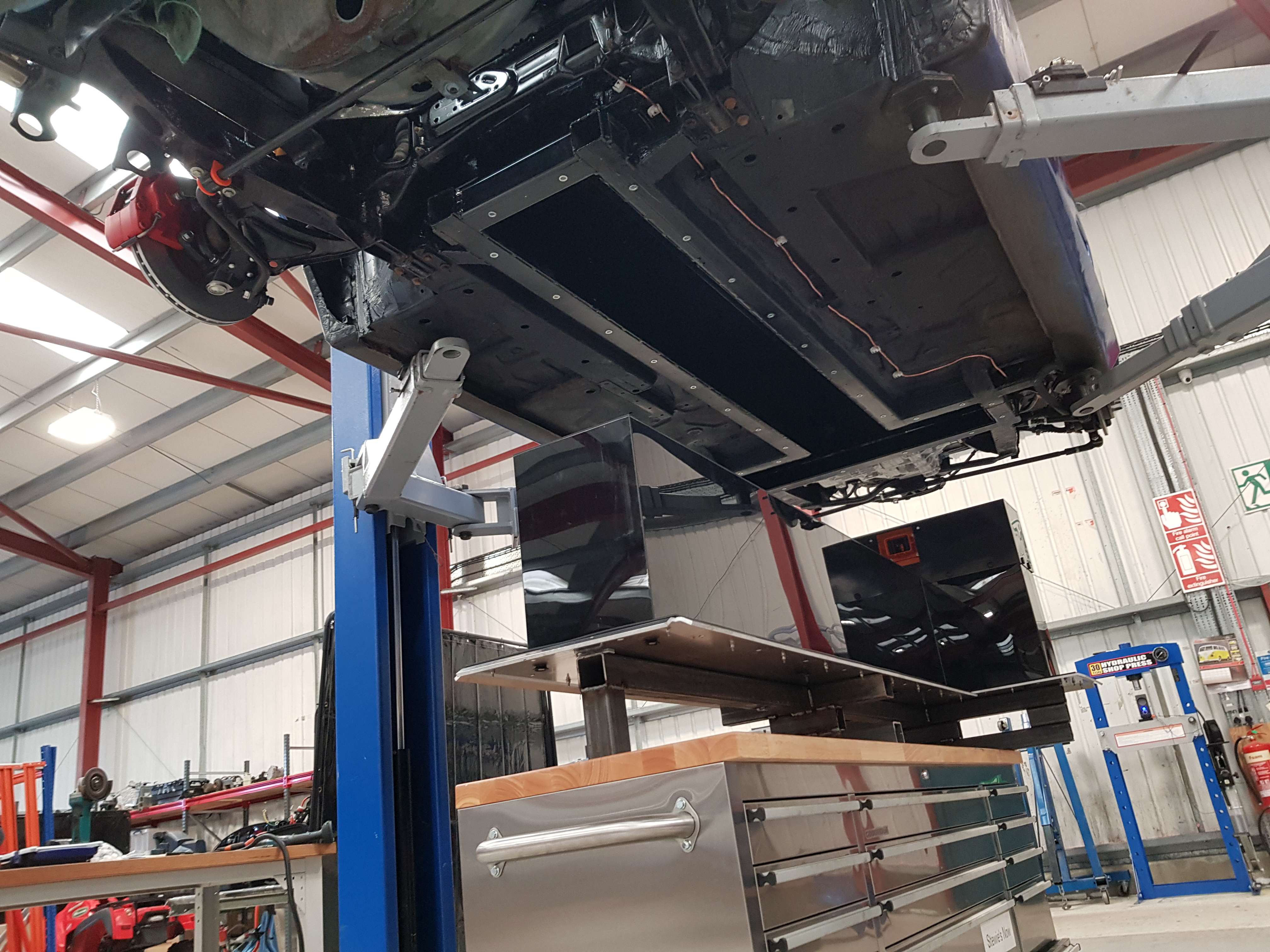

Yeah. We could support that - have a mule vehicle for our powertrain controller (vcu replacement) that we could adapt - leaf motor and 45kwh battery.

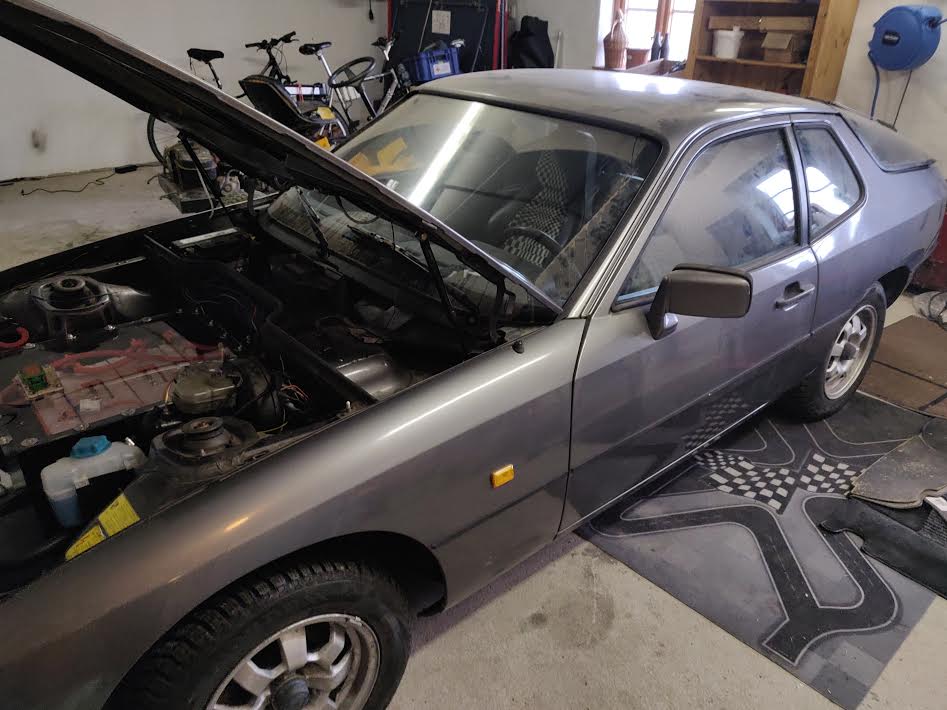

I am almost ready to join motor and transmission so will be able to test myself soon!

@Johu if you want to spend some time with one of our cars for fine tuning the software we'd be happy to host you and pay expenses kf we are able to use the system for customer projects.
Think I mentioned before that we already have a solution for controlling the stock inverter, we are just looking to add more power!

"Drove" my Touran today, so now I have something to work on right here.
