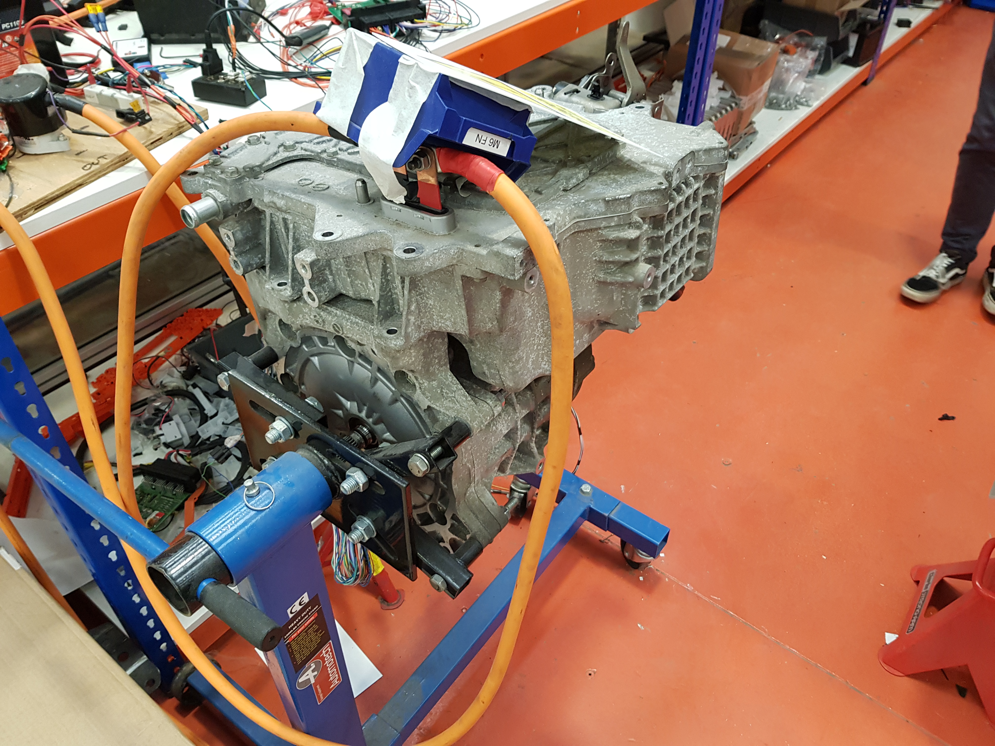

Let us know if you need a test vehicle, we have 3 running leaf motor/inverter with our own powertrain controller. would be happy to use one to help trial this.

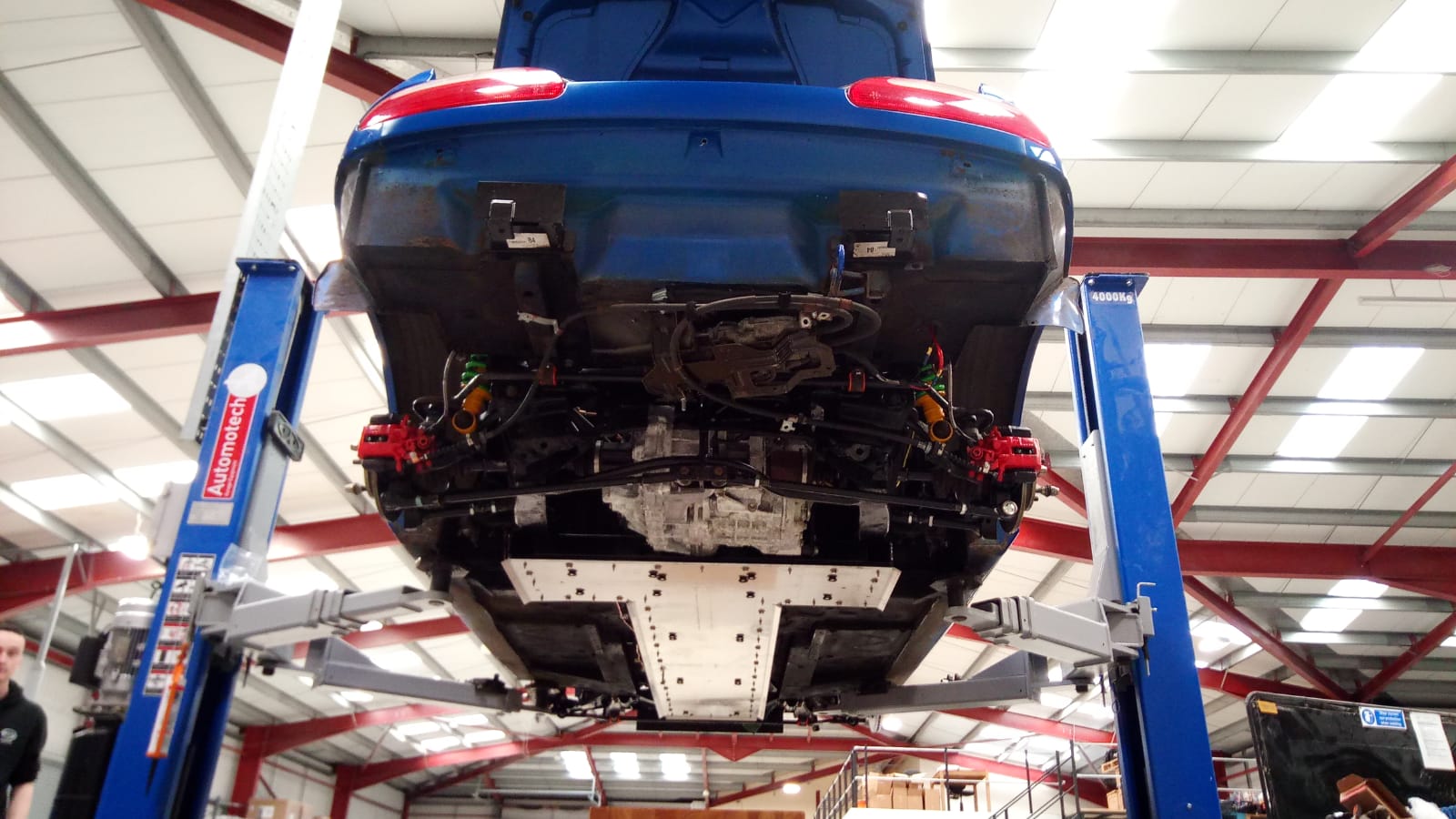

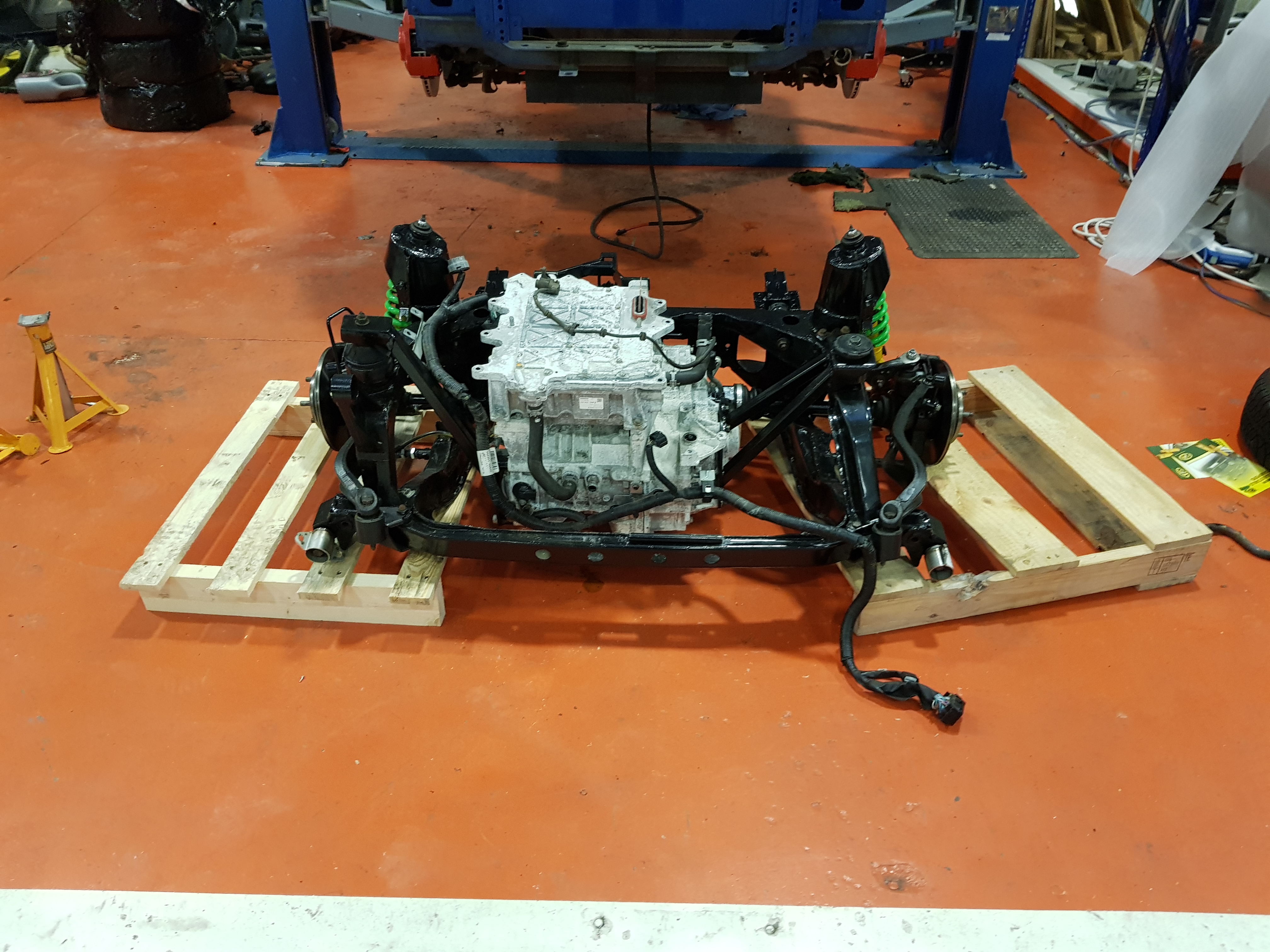

Re: Does Firmware now support "Field Weakening" for Leaf Motors

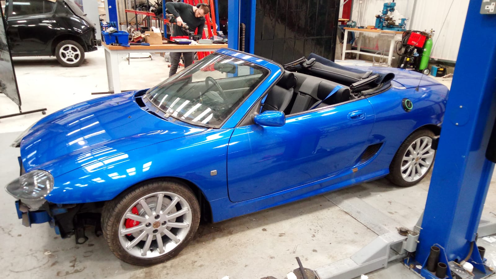

Yeah. We could support that - have a mule vehicle for our powertrain controller (vcu replacement) that we could adapt - leaf motor and 45kwh battery.

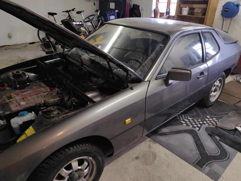

"Drove" my Touran today, so now I have something to work on right here.
