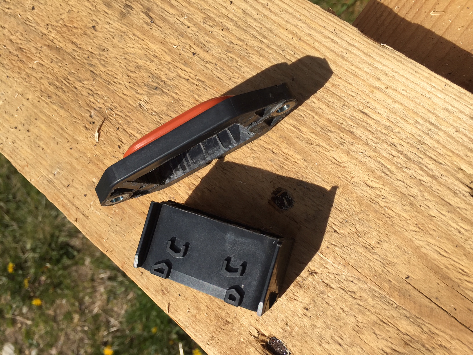

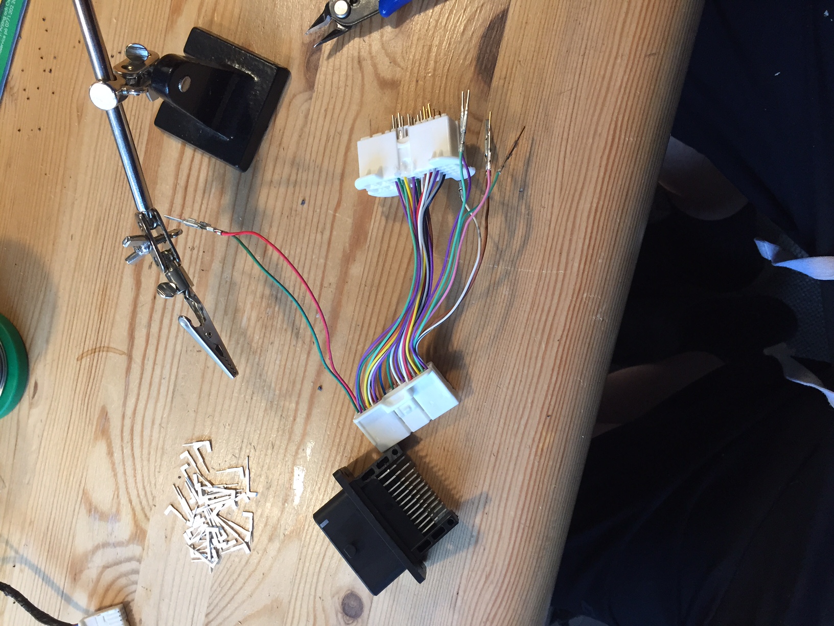

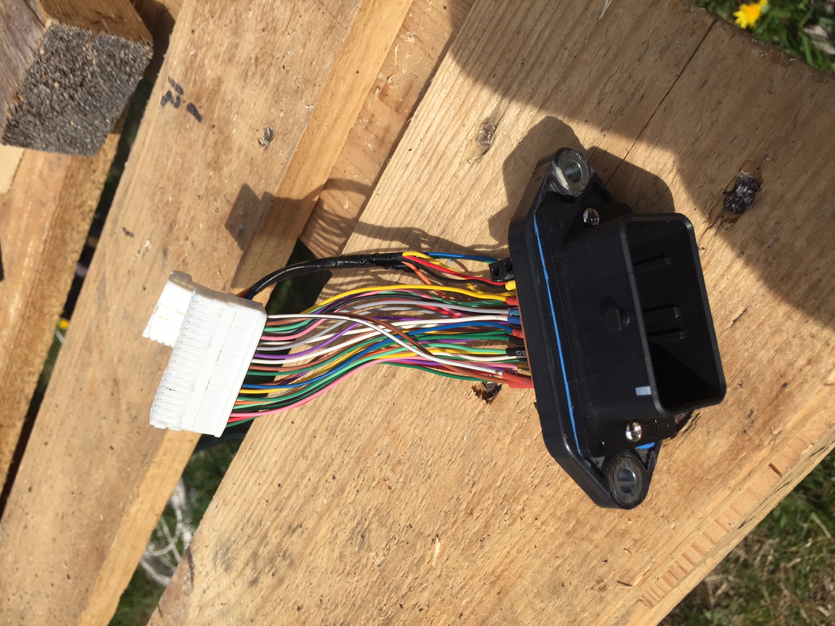

Post by Filip »
This is my version of inverter connector, based on Molex parts.
First I tore the original connector apart
Then I soldered the wires to the new connector.
After that it was time to try to fit the new connector to the inverter, I used the old connector and cut it flush.
Then some cutting with the knife to get it square, and last but not least some sealant between the two.
This is the final inverter connector:
If anyone is interested I have all the partnumbers for my build somewhere, I can post them if there is interest.

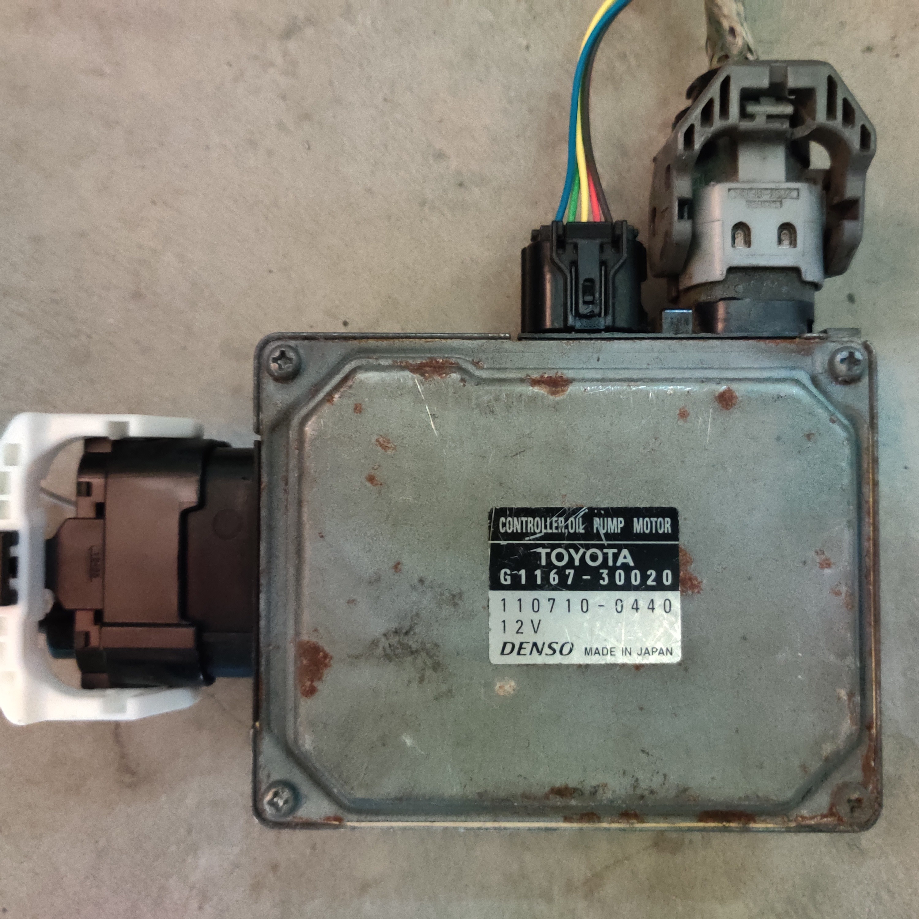

GS450H Oil Pump Controller Part No. ?
Post by Bassmobile »
Anybody help a guy with the part number for this Oil Pump Controller?
Can somebody add this part No. to the Wiki possibly
arturk
Posts: 148
Location: United States, MD
Has thanked: 7 times
Post by arturk »
Here it is
