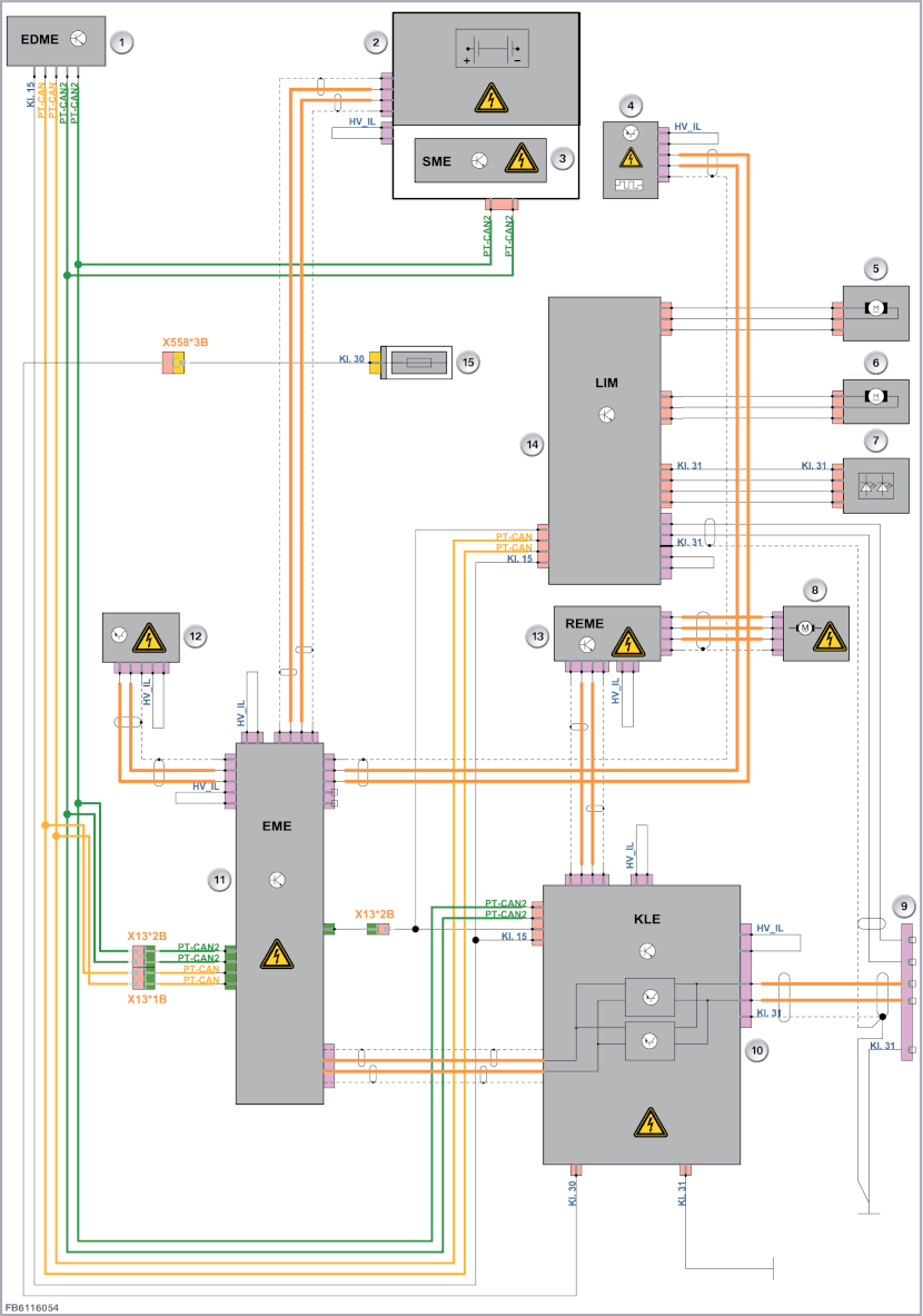

You could try this location as LIM seems to be on PT CAN 1 but only PT Can 2 seems shown here. Or hopefully PT can 1can be found at this location too.

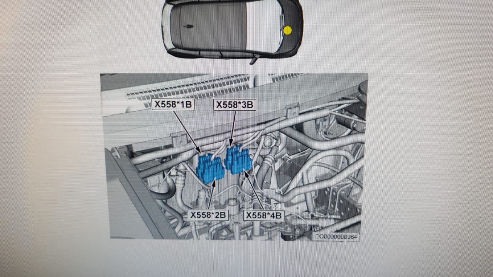

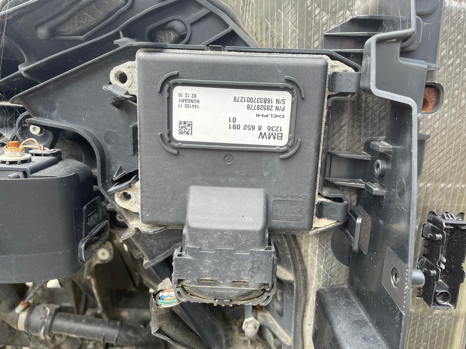

Right, time for a little update. Seems we have been doing a bit of a wild goose chase. The LIM is connected to PT-CAN1 which is not the one being shown in the videos. The PT-CAN one connects to the LIM , EME(inverter) and EDME(ev ecu) only. The edme is located in the left front wheel arch behind the liner. So the only places to get to PT-CAN1 are at those 3 modules. The battle continues. Just ordered an edme from a breaker (pictured) ao if I have to rebuild a f*&king i3 in my shed from parts to get a can log I will :D

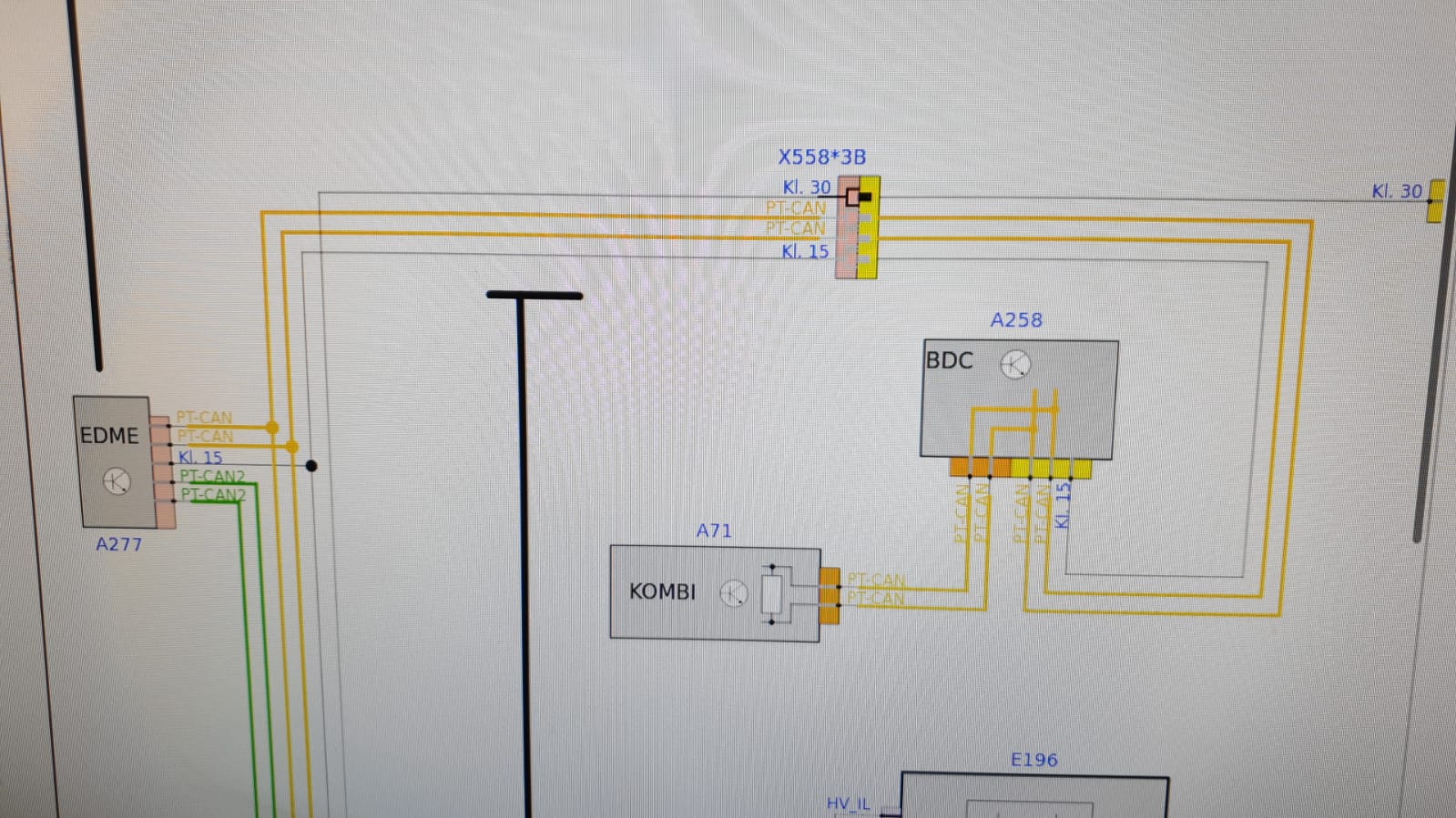

Update : Seems PT-CAN1 goes to the car via connector X558 3B under the bonnet. Could be an easy point to get access by back probing the connector.
Update 2 : Wire colours. RED=PT-CAN-L , Blue/RED = PT-CAN-H

Depending on model may be on X558 1b pins 5 and 6 as pictured.

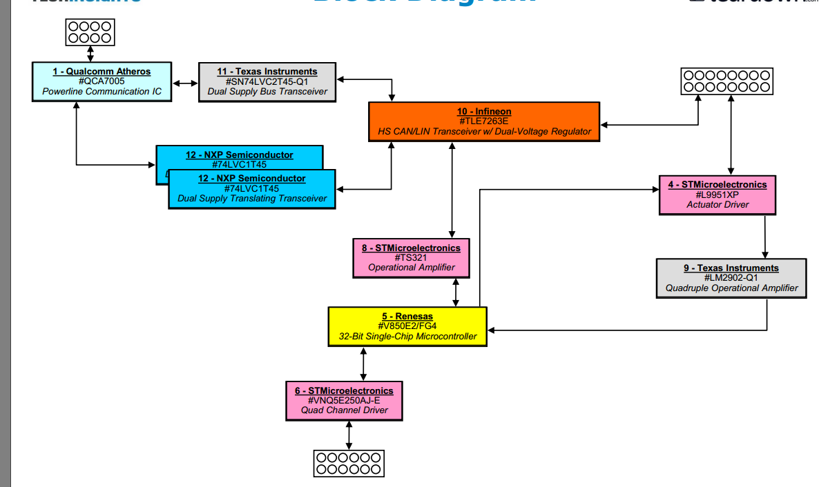

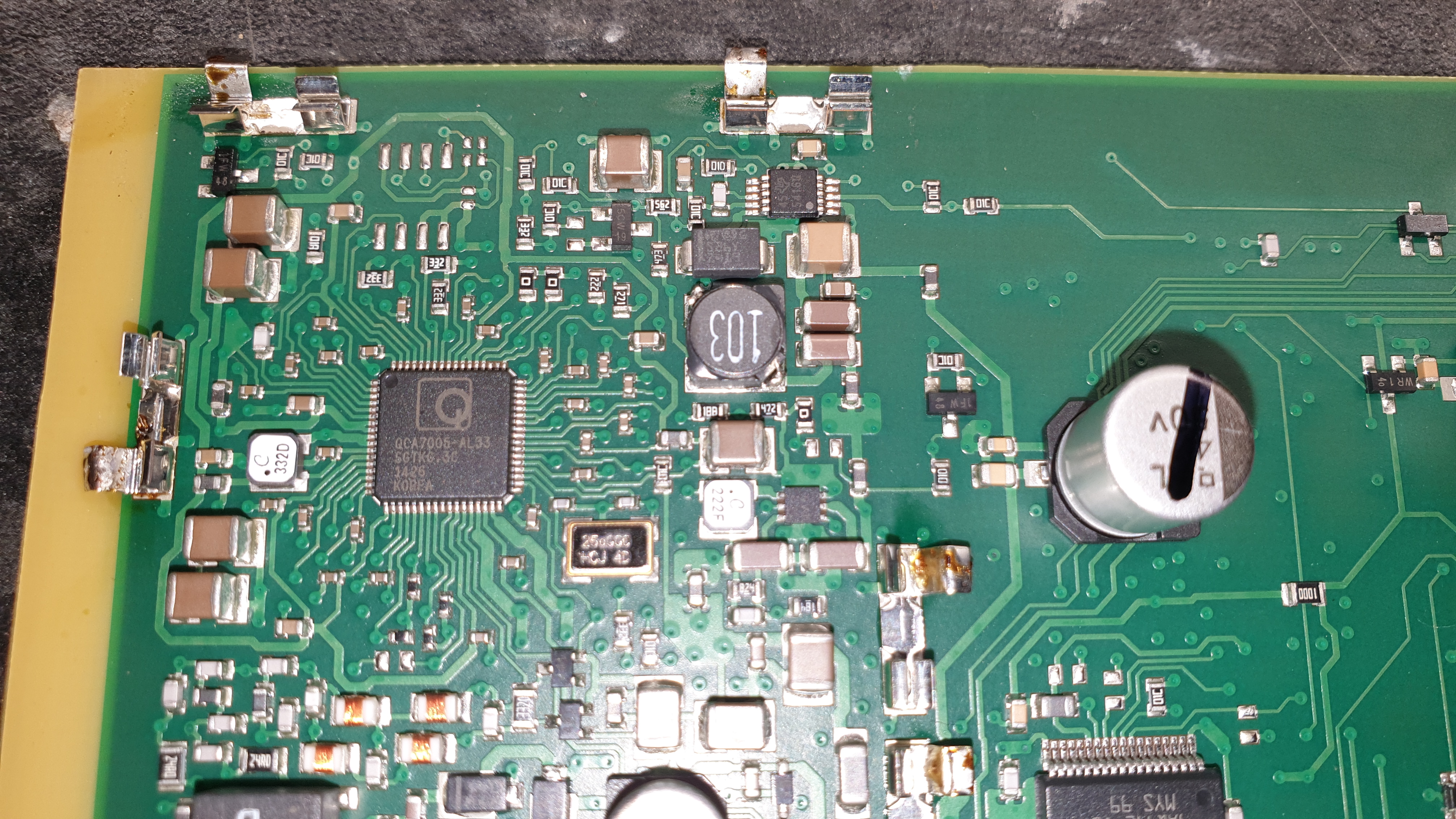

While waiting for some can logs I decided to pop off that shielding can in the lim at take a look at what might be inside...
Been thanked: 1918 times
No additional host processor? I'm sure there is a Tricore on the underside :)
Posts: 4006
Been thanked: 1135 times
Only 2 core it seems : viewtopic.php?p=19851#p19851

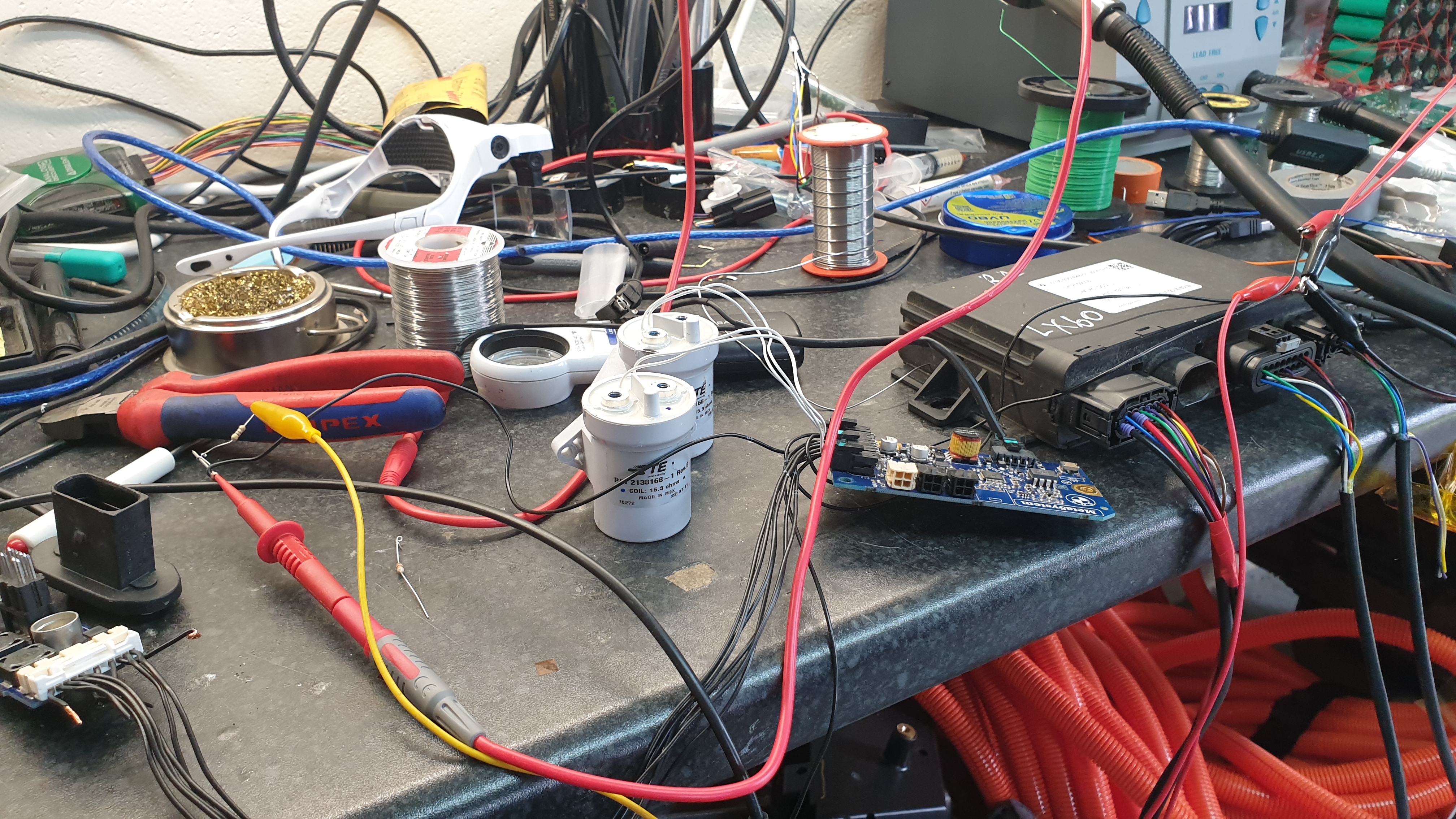

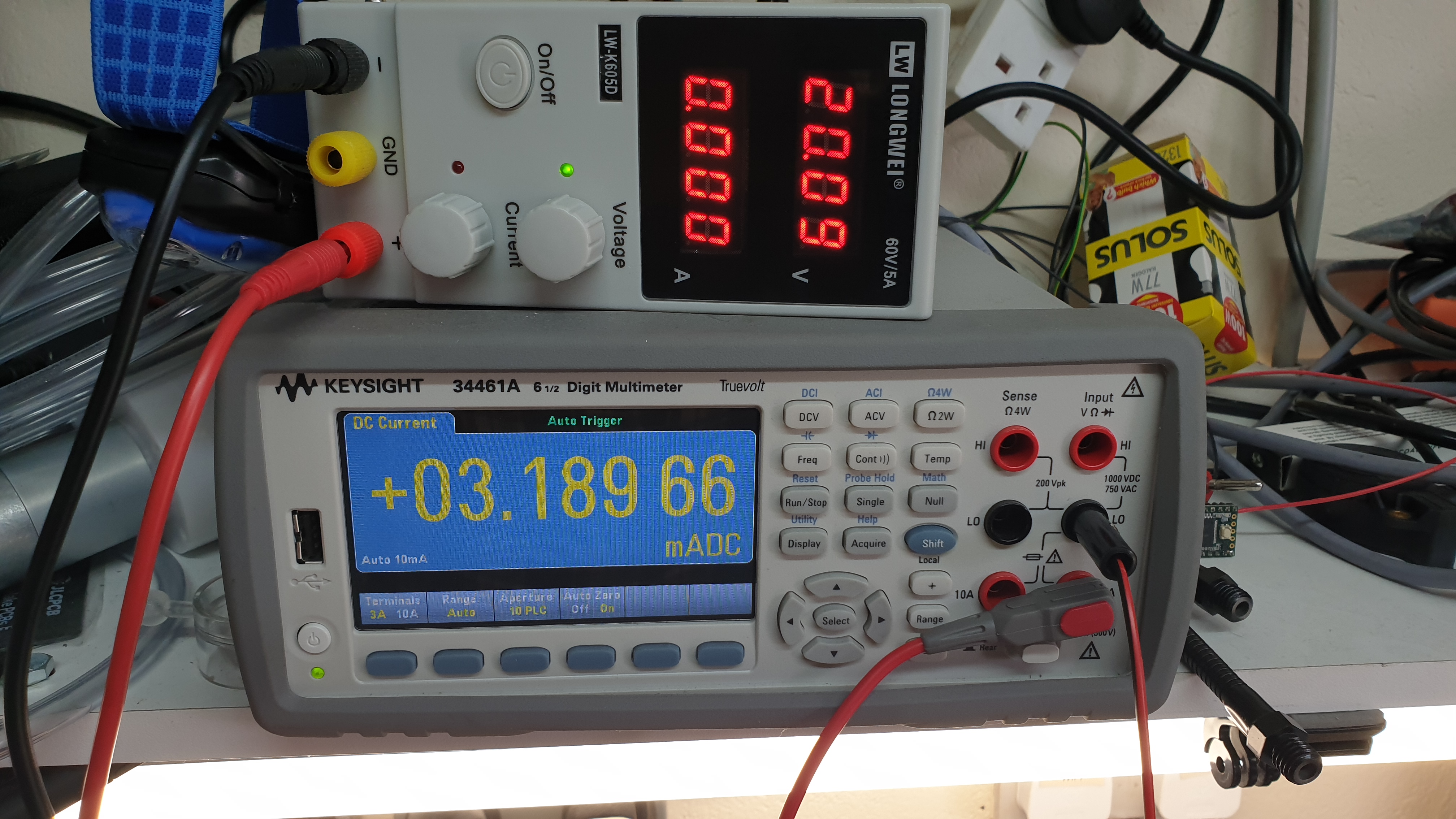

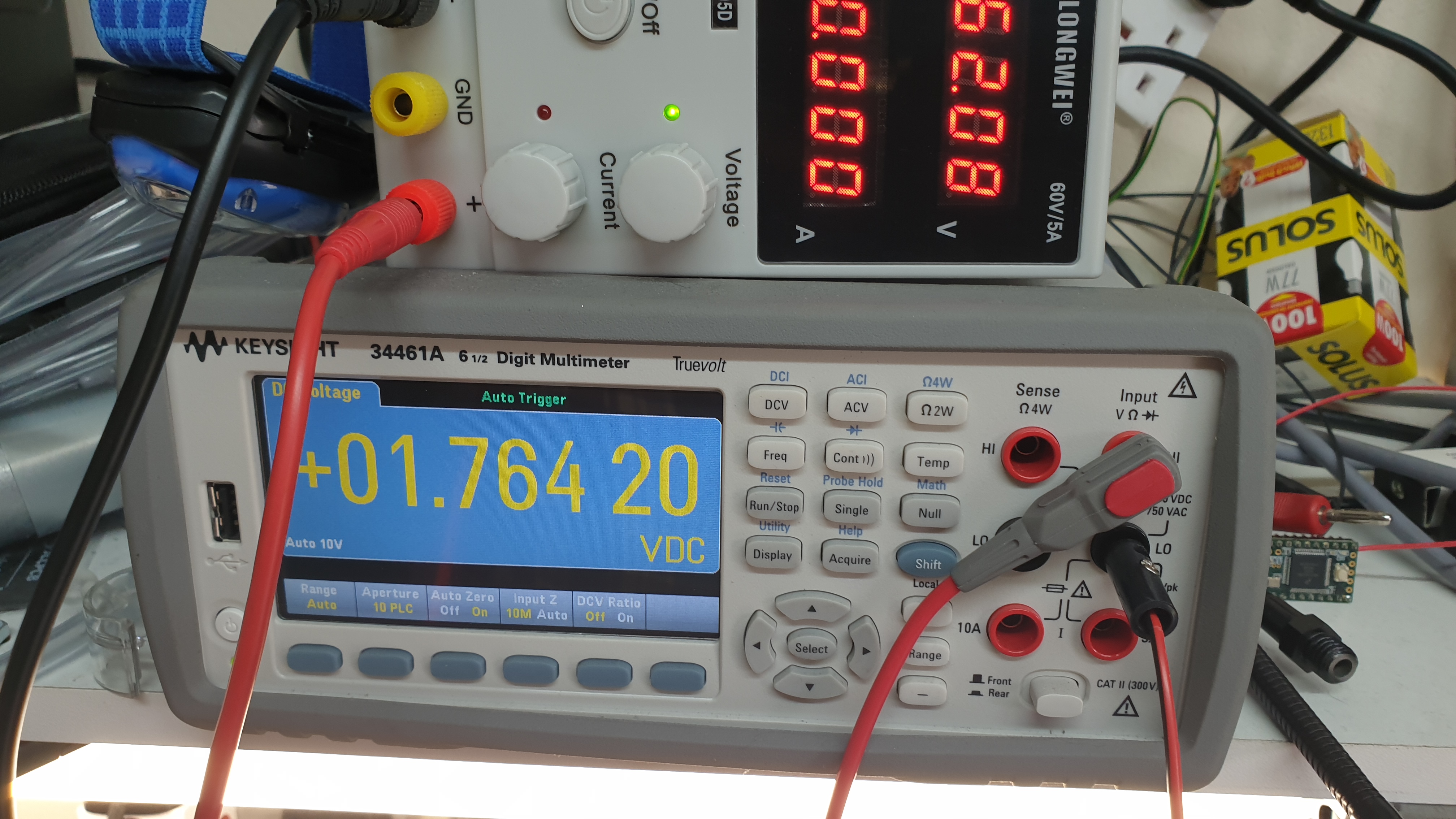

Always the hard way. Spent the morning running the big 50mm sq cables under the grey goose to the fc junctions box. Then decided to have a look at the little hv sense board from the KLE. Instead of a nice 0-5v signal it just sat there at 11v. No amount of varying the hv input would budge it. Some time later I discover its not a voltage output but rather a current output! The input on the LIM measures 476R to ground. Connected a 470R resistor between the output of the sense board and ground and there we are. So, the LIM doesn't want to see a voltage proportional to the HV input on the CCS side but rather a current.

Few quick measurements with the sense board connected to the LIM.
