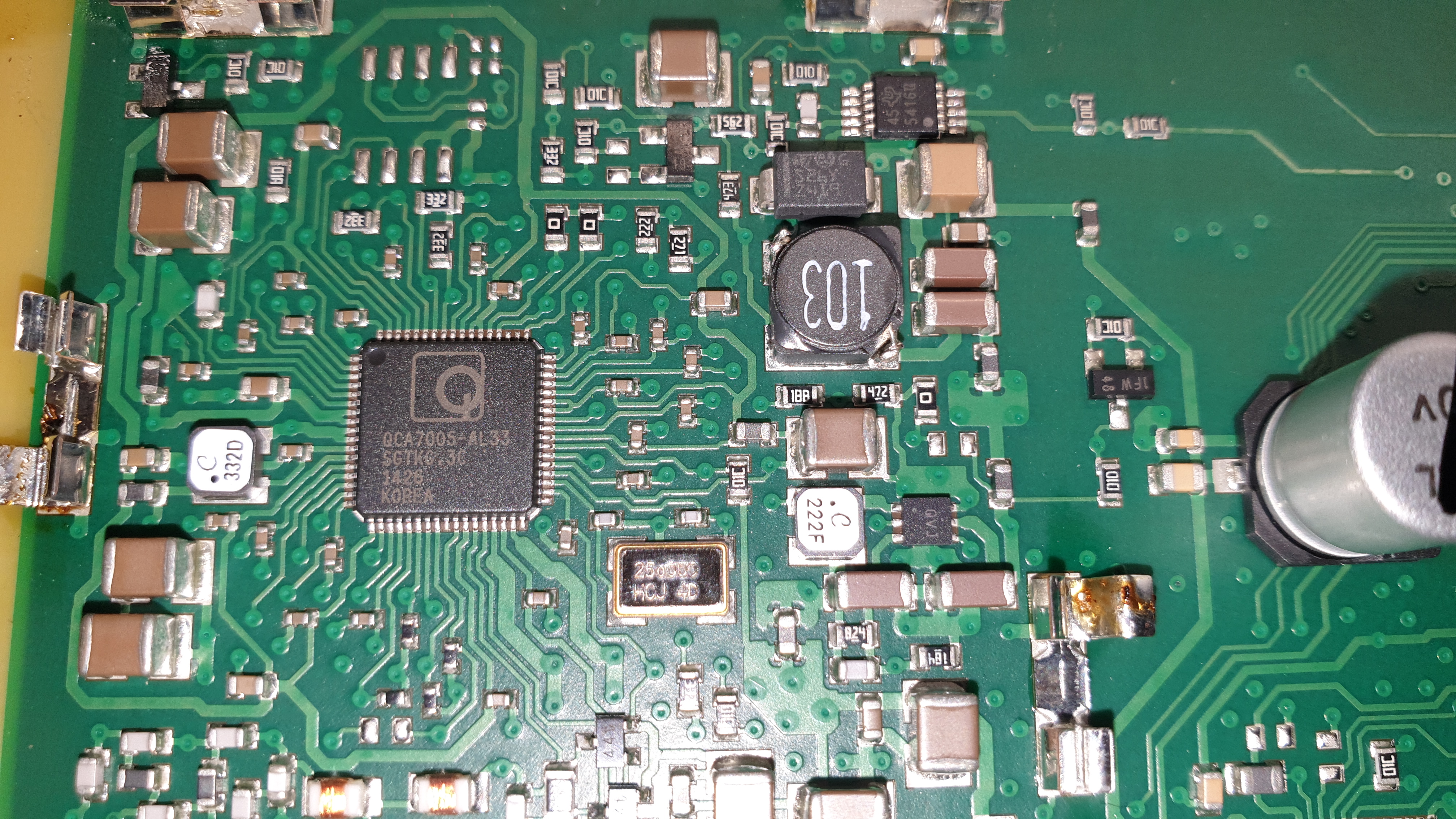

While waiting for some can logs I decided to pop off that shielding can in the lim at take a look at what might be inside...

No additional host processor? I'm sure there is a Tricore on the underside

Only 2 core it seems : viewtopic.php?p=19851#p19851

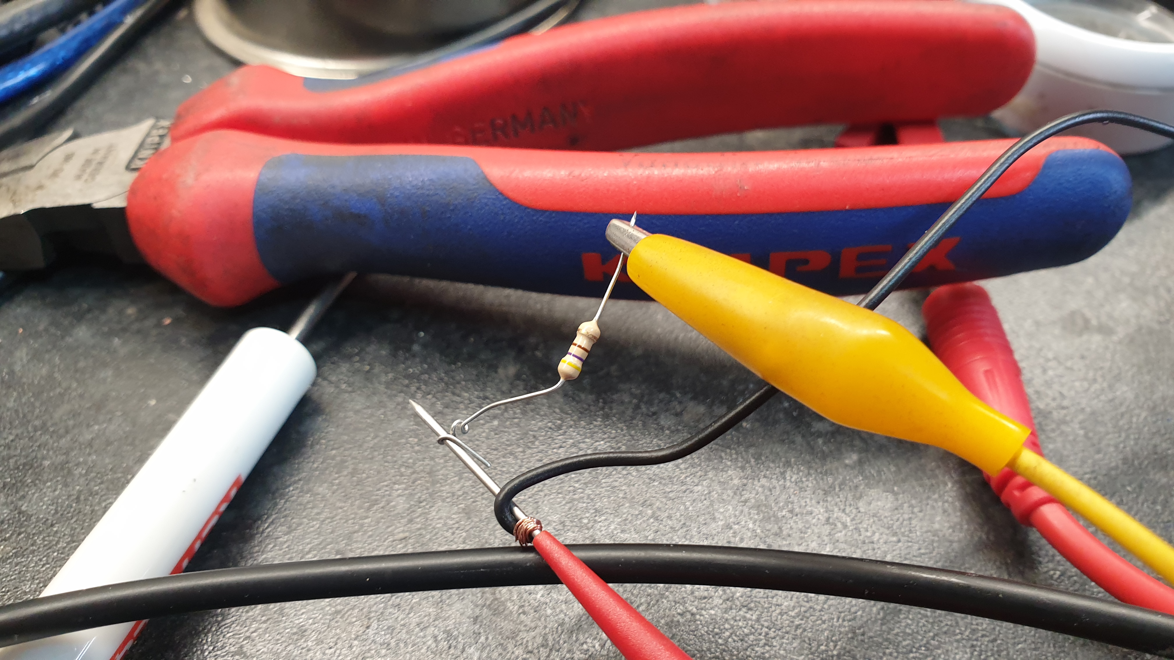

Always the hard way. Spent the morning running the big 50mm sq cables under the grey goose to the fc junctions box. Then decided to have a look at the little hv sense board from the KLE. Instead of a nice 0-5v signal it just sat there at 11v. No amount of varying the hv input would budge it. Some time later I discover its not a voltage output but rather a current output! The input on the LIM measures 476R to ground. Connected a 470R resistor between the output of the sense board and ground and there we are. So, the LIM doesn't want to see a voltage proportional to the HV input on the CCS side but rather a current.

Few quick measurements with the sense board connected to the LIM.

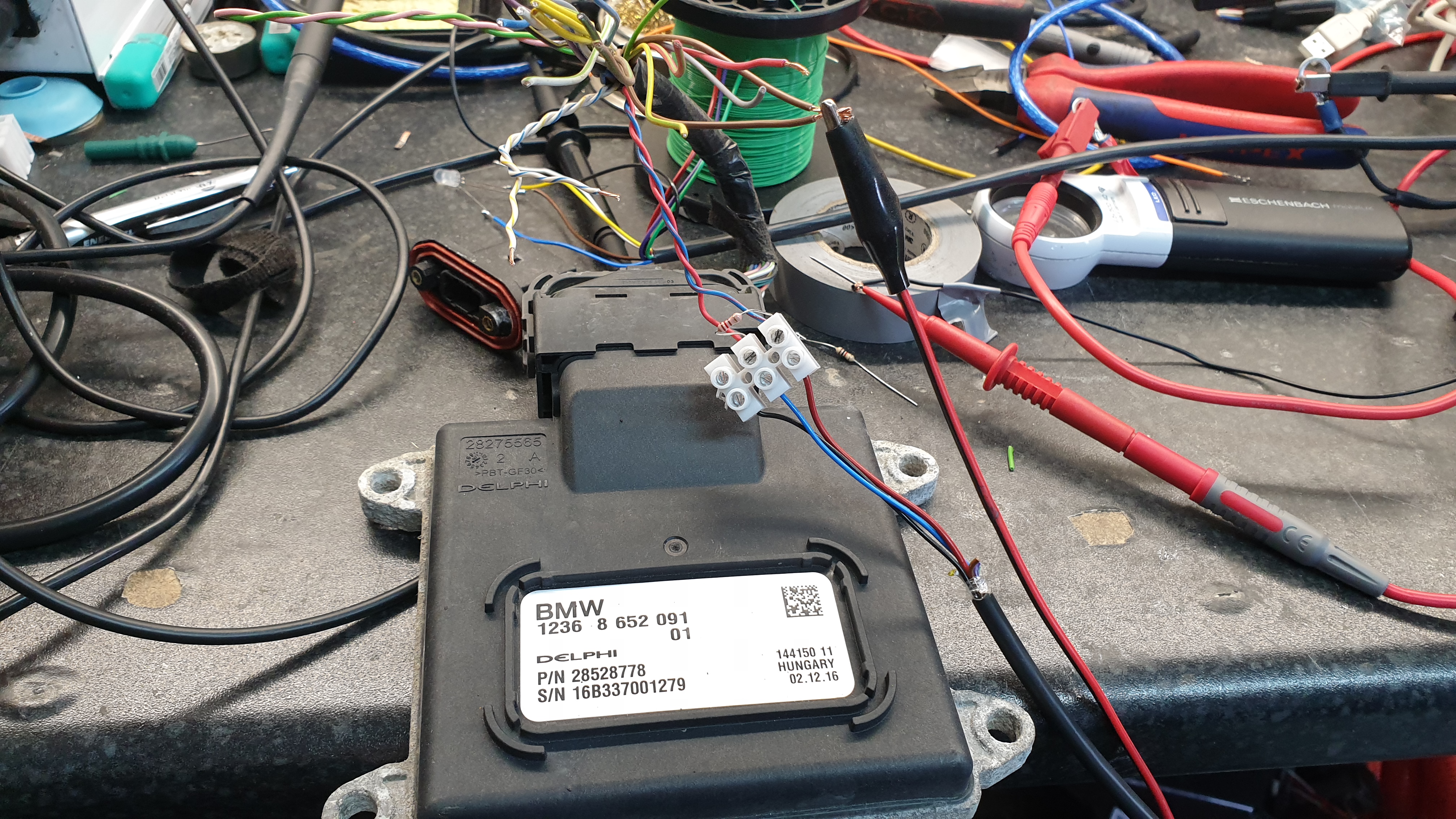

Setup a repo to start pulling all this together :
https://github.com/damienmaguire/BMW-i3-CCS
Also got a 2017 LIM and EMDE from the same car. CAN logs on the repo. First finding :
id 0x512 dlc 8 time 640ms 0x00 0x00 0x00 0x00 0xfe 0x00 0x00 0x12
Wake up id. Sending this causes lim to constantly send its ids.

Pleased to say we have the first batch of logs now on the repo from AC charging
LIM ids 0x272 , 0x337 , 0x390 , 0x3b4 and 0x514

Added a second set of logs for AC charging to the repo. So message 0x12f is really interesting. This wakes the lim from sleep over can. Seems to have a counter in the low nibble of byte 1 that goes from 0x0 to 0xe. I suspect byte 0 is a crc so will need to try and figure that out eventually.
