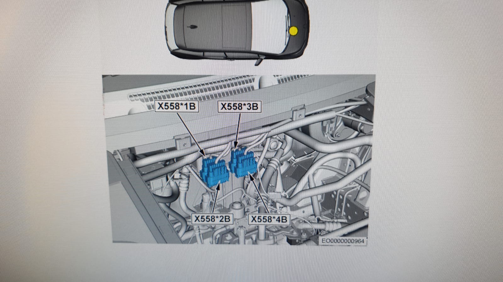

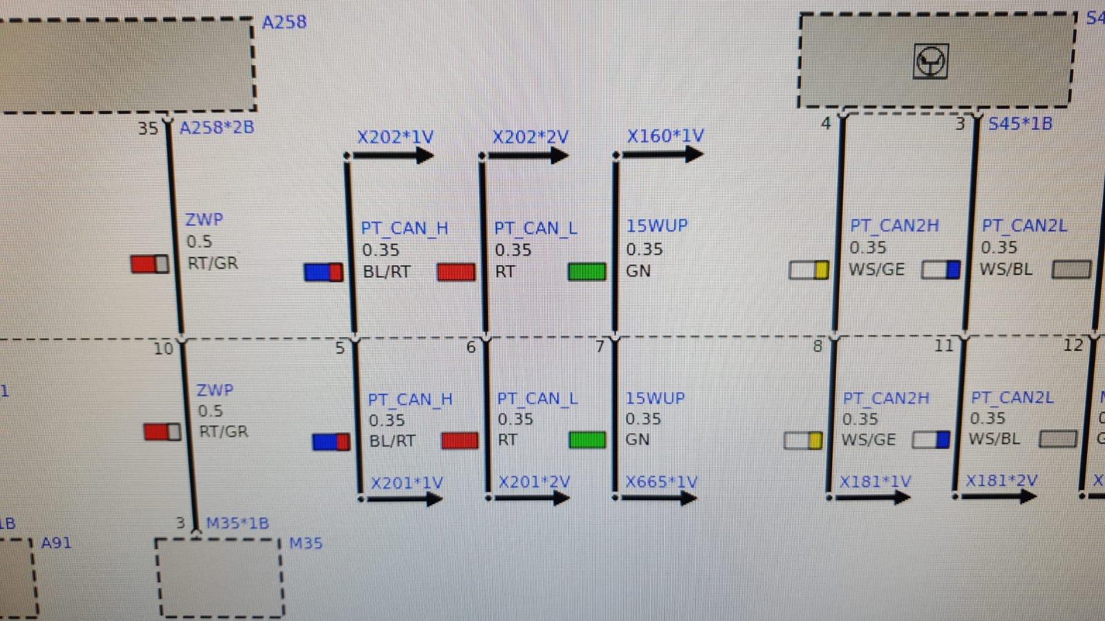

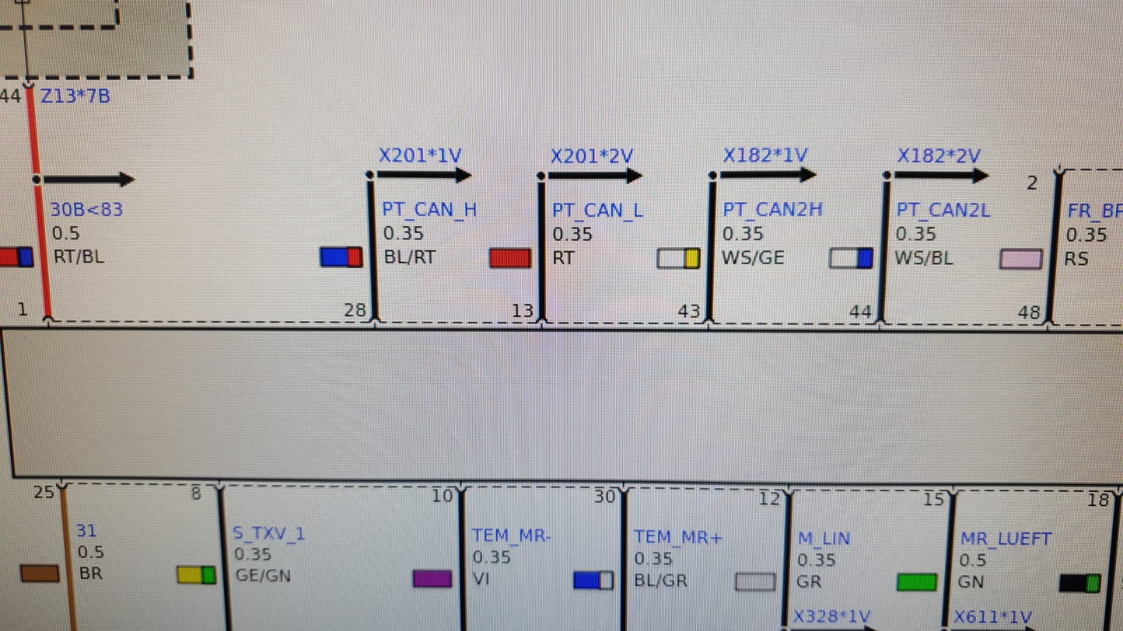

Update : Seems PT-CAN1 goes to the car via connector X558 3B under the bonnet. Could be an easy point to get access by back probing the connector.
Update 2 : Wire colours. RED=PT-CAN-L , Blue/RED = PT-CAN-H
- Posts: 4000
- Been thanked: 1117 times
Depending on model may be on X558 1b pins 5 and 6 as pictured.

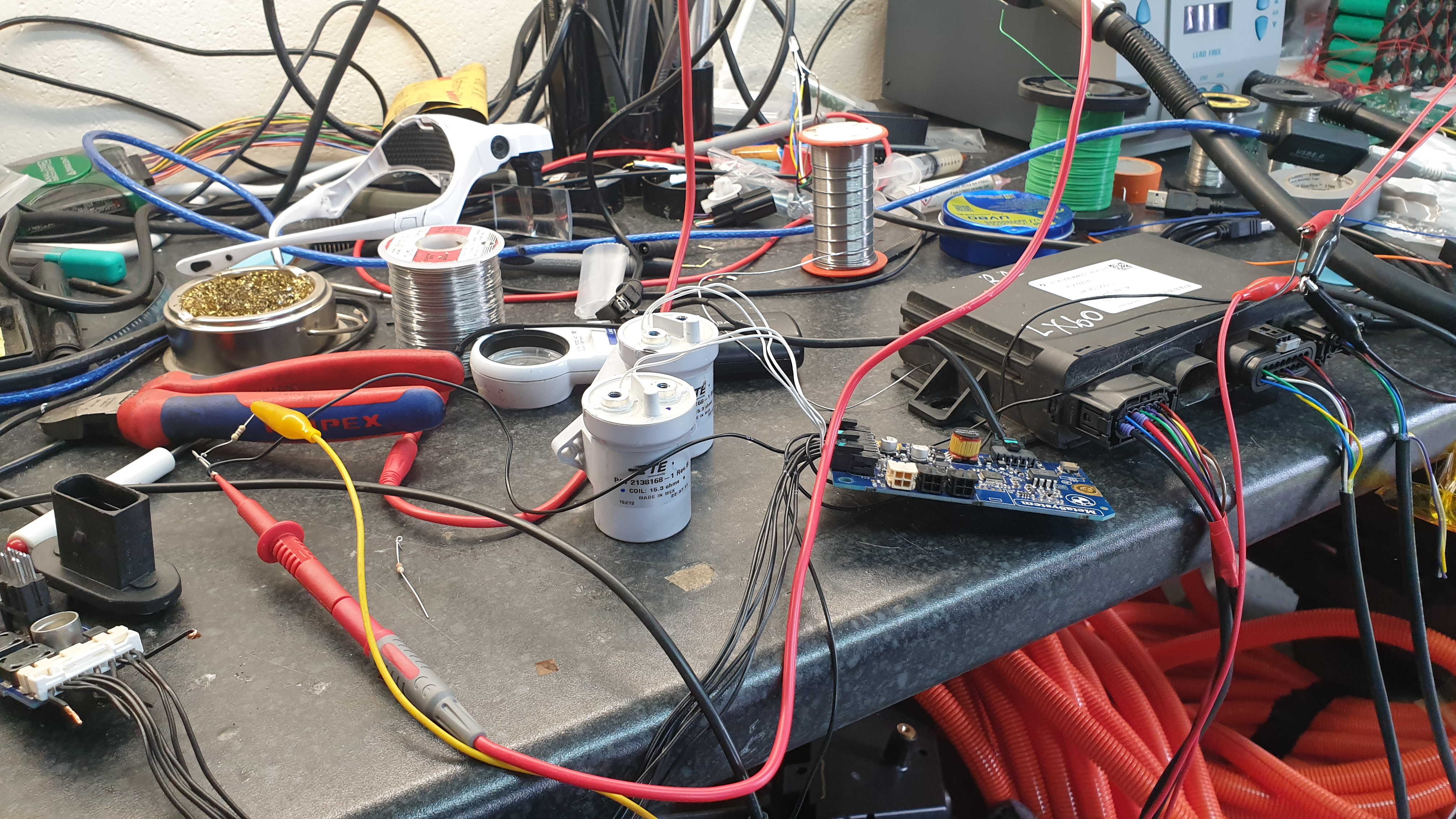

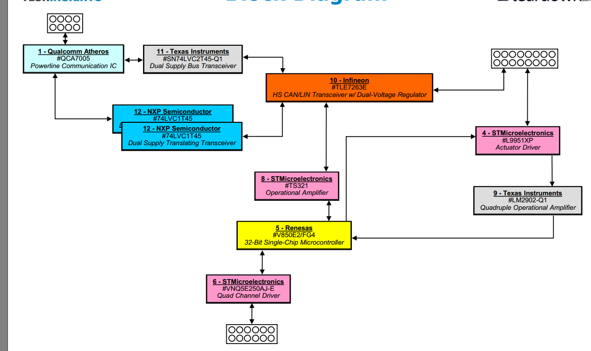

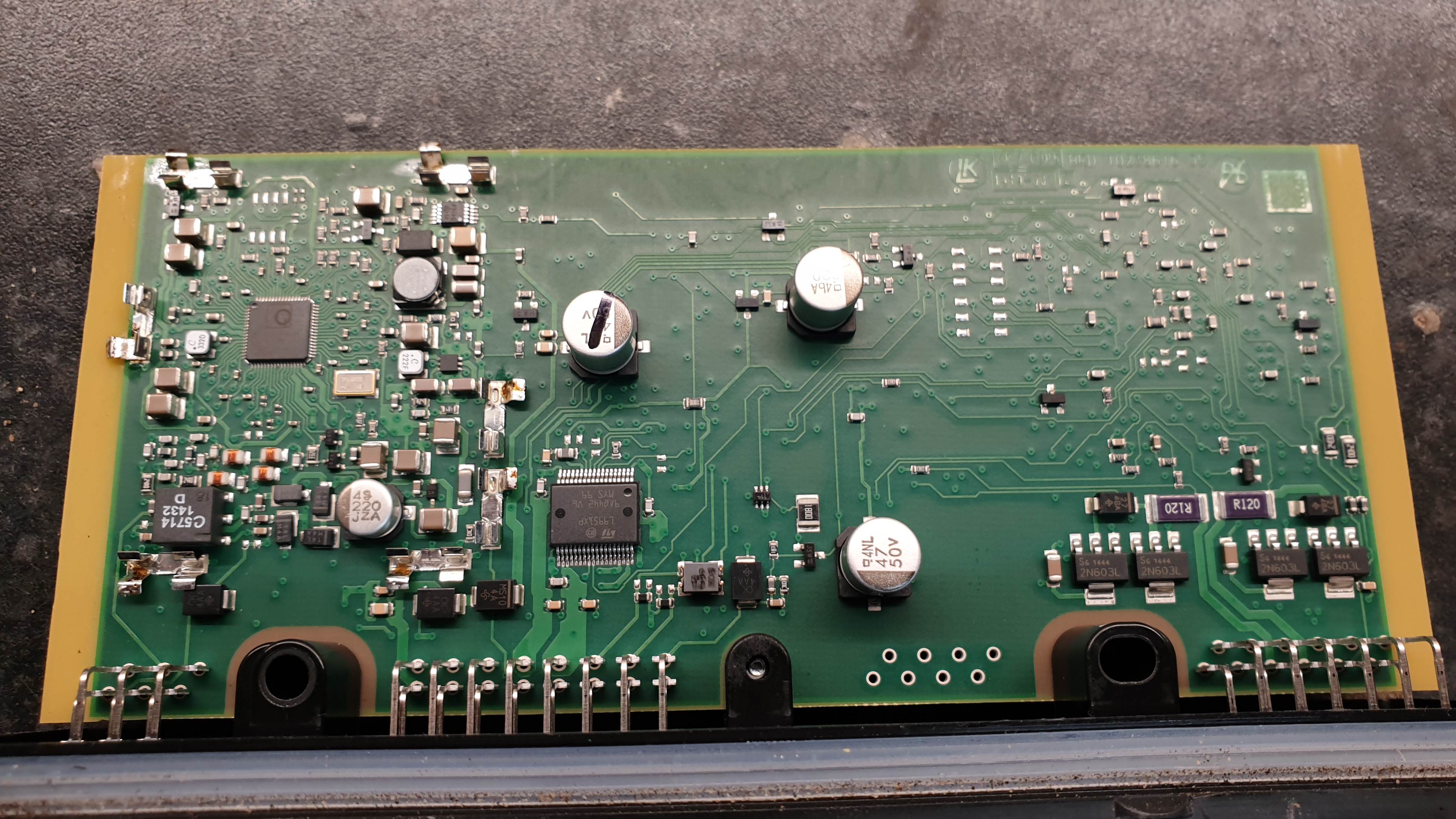

While waiting for some can logs I decided to pop off that shielding can in the lim at take a look at what might be inside...
- Been thanked: 1913 times
No additional host processor? I'm sure there is a Tricore on the underside
- Posts: 4000
Only 2 core it seems : viewtopic.php?p=19851#p19851

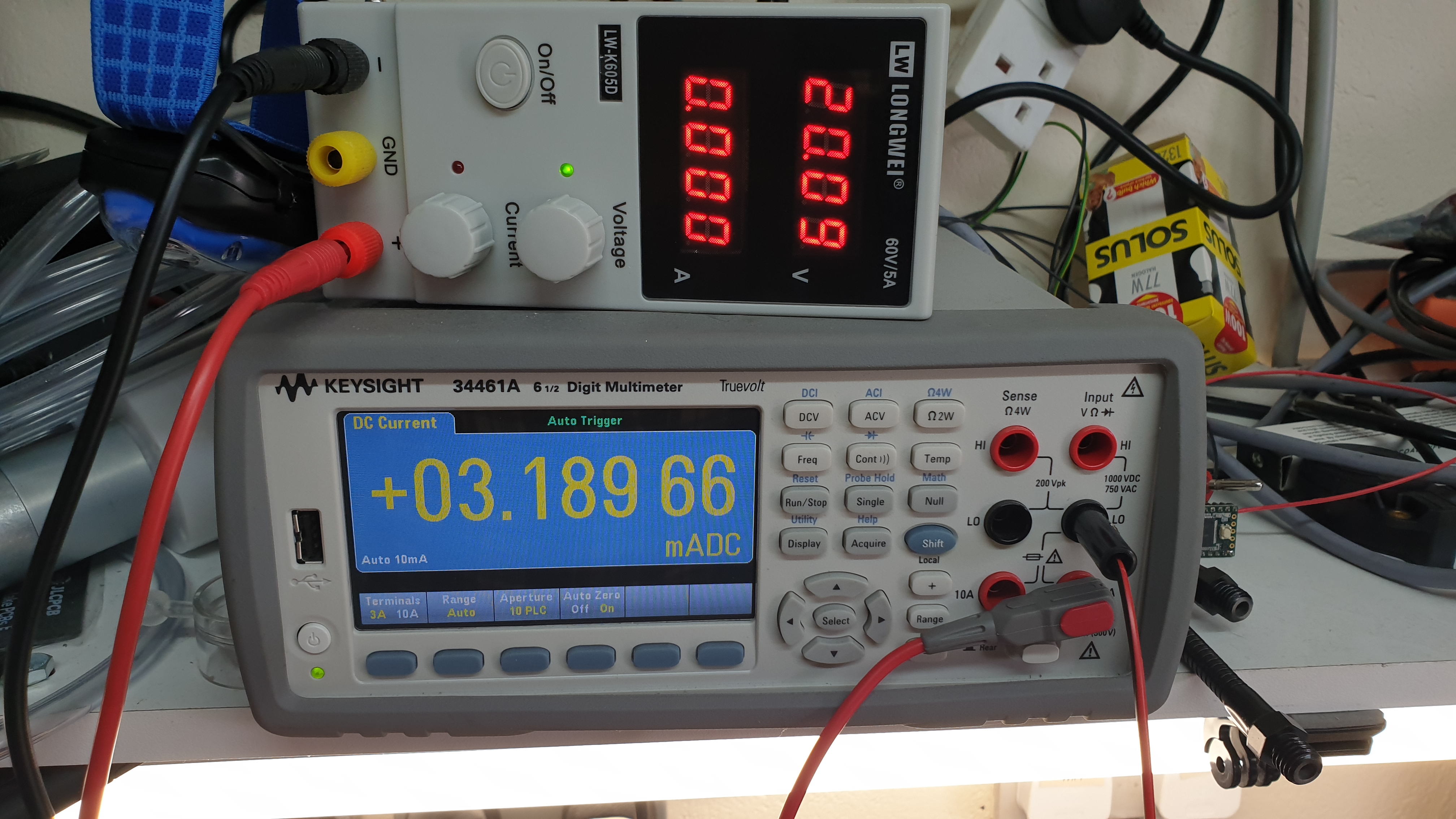

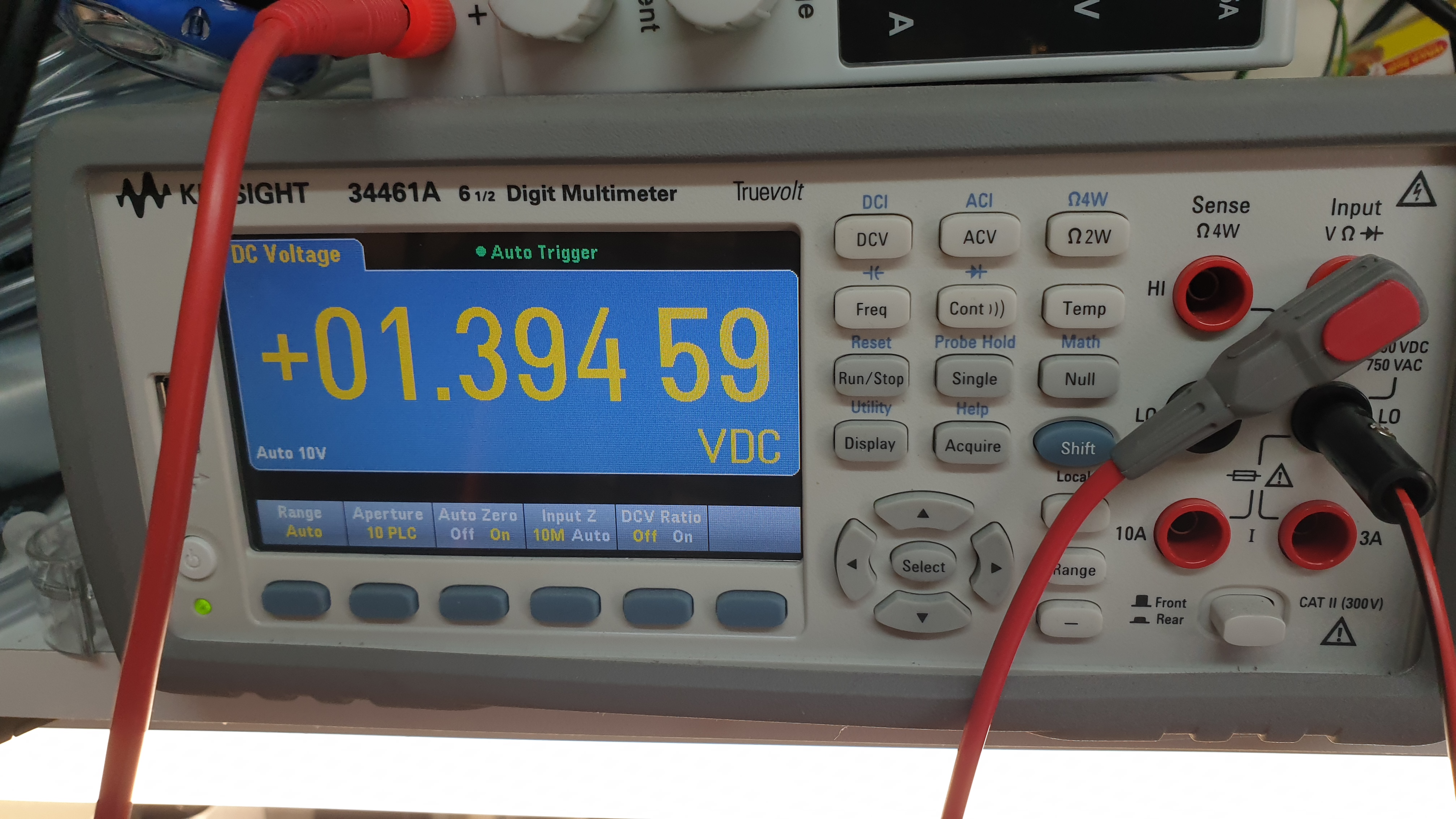

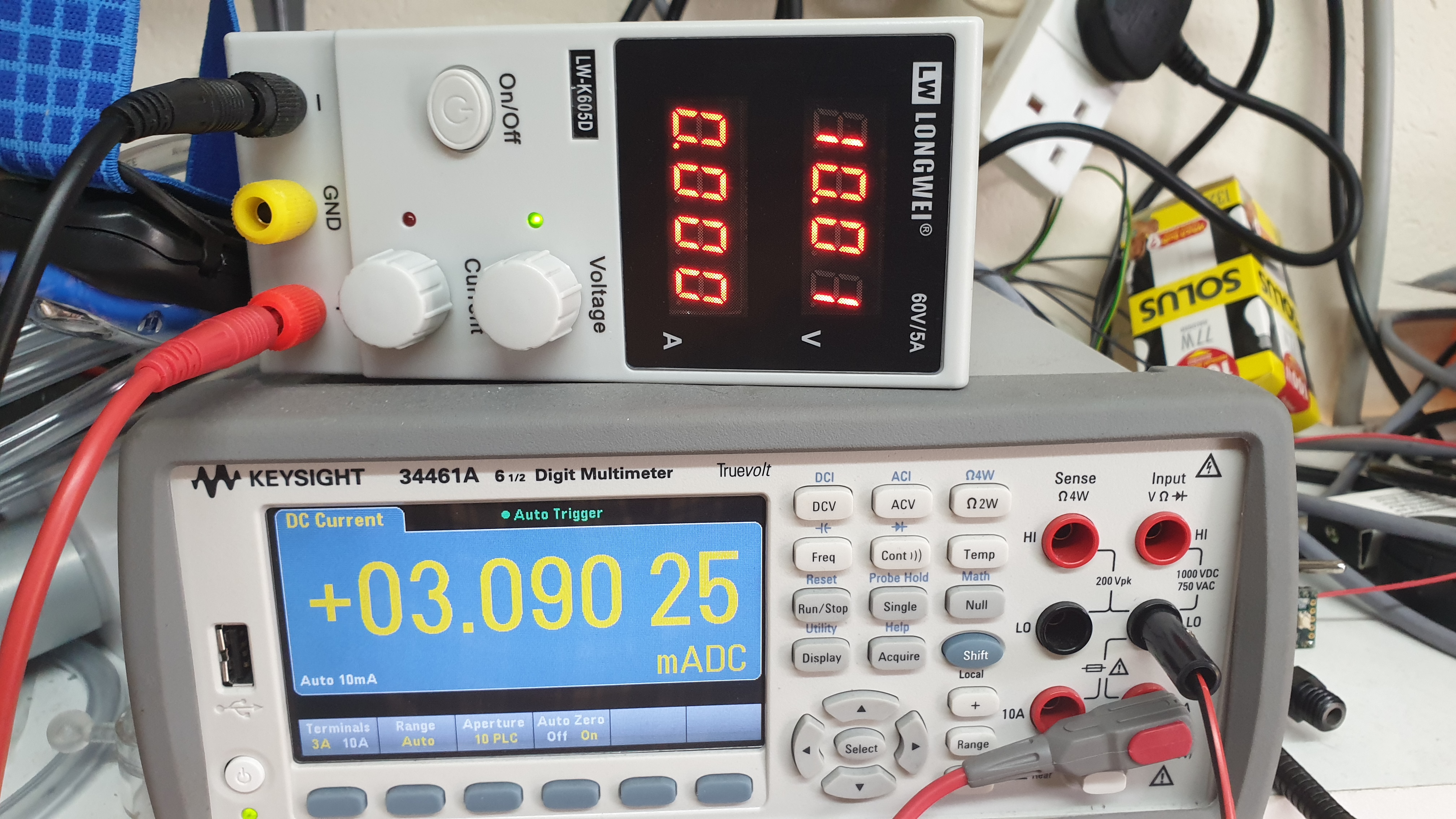

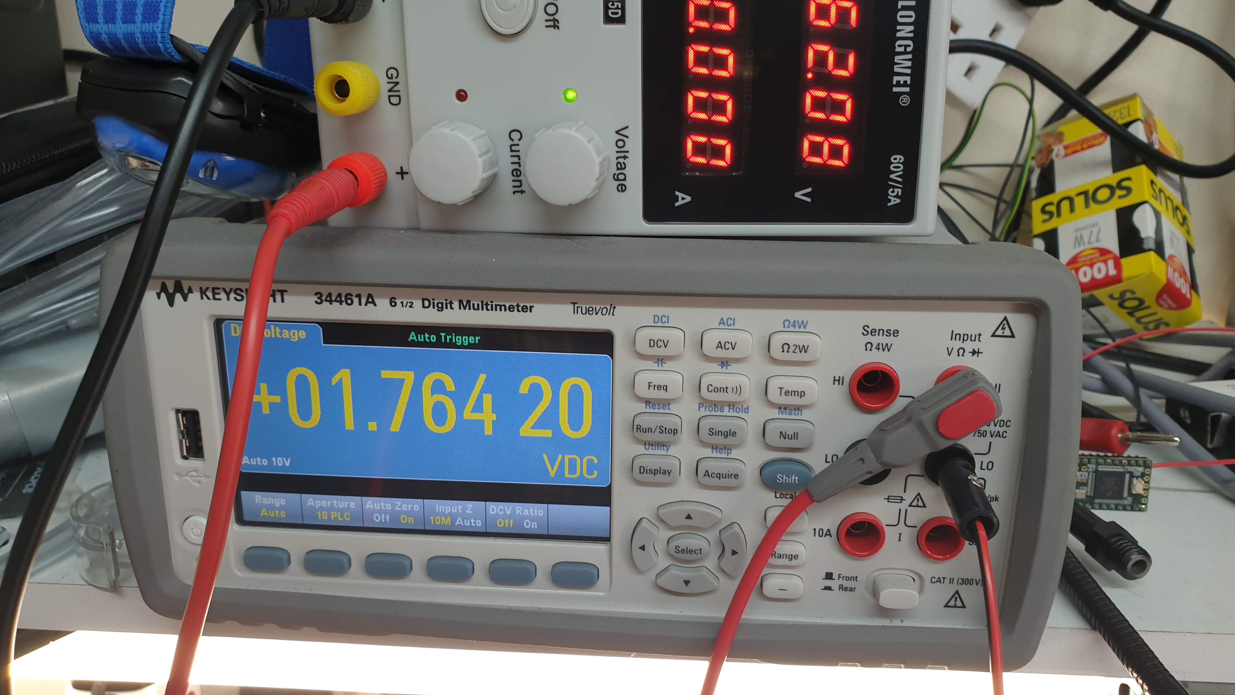

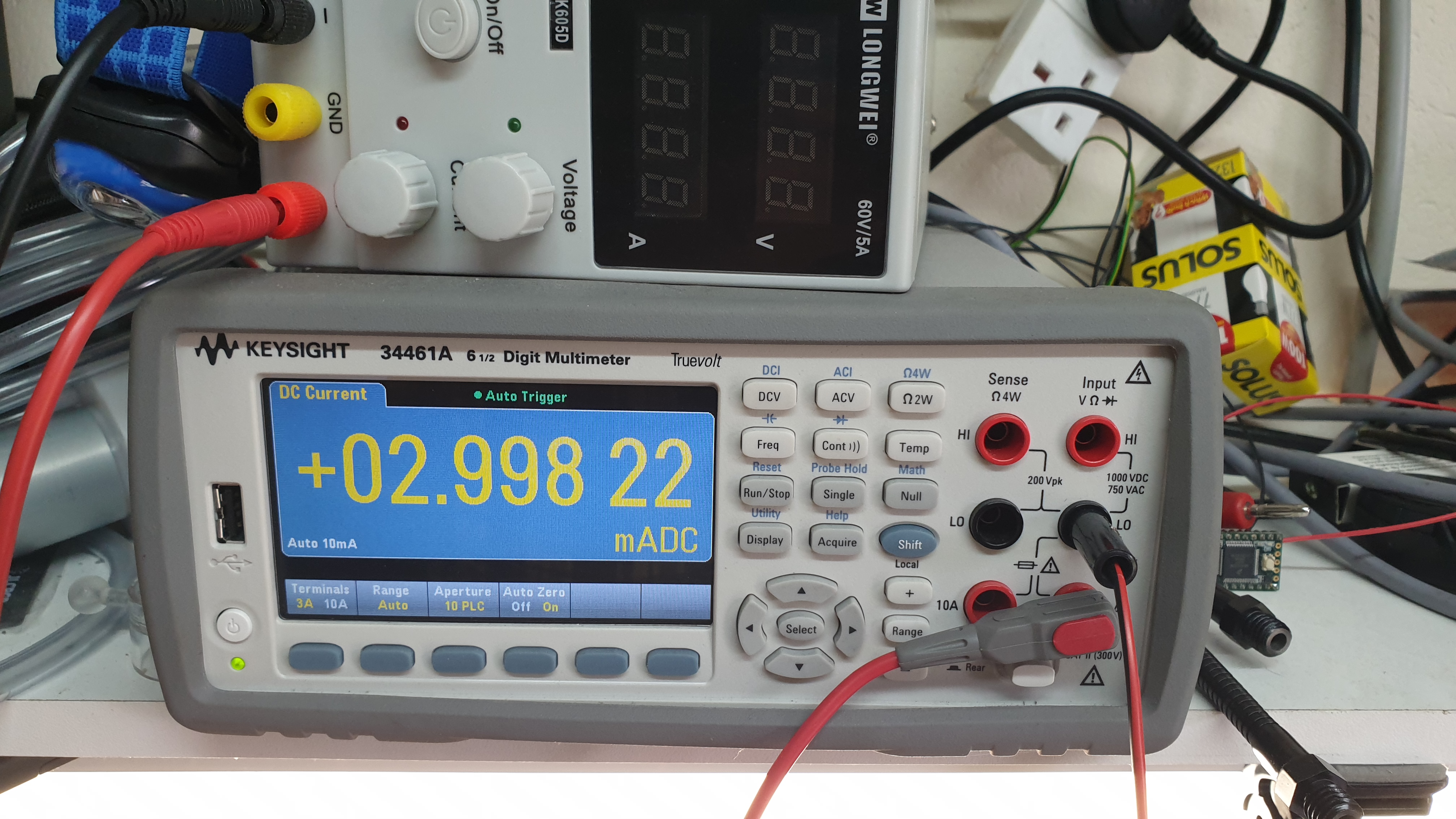

Always the hard way. Spent the morning running the big 50mm sq cables under the grey goose to the fc junctions box. Then decided to have a look at the little hv sense board from the KLE. Instead of a nice 0-5v signal it just sat there at 11v. No amount of varying the hv input would budge it. Some time later I discover its not a voltage output but rather a current output! The input on the LIM measures 476R to ground. Connected a 470R resistor between the output of the sense board and ground and there we are. So, the LIM doesn't want to see a voltage proportional to the HV input on the CCS side but rather a current.

Few quick measurements with the sense board connected to the LIM.
