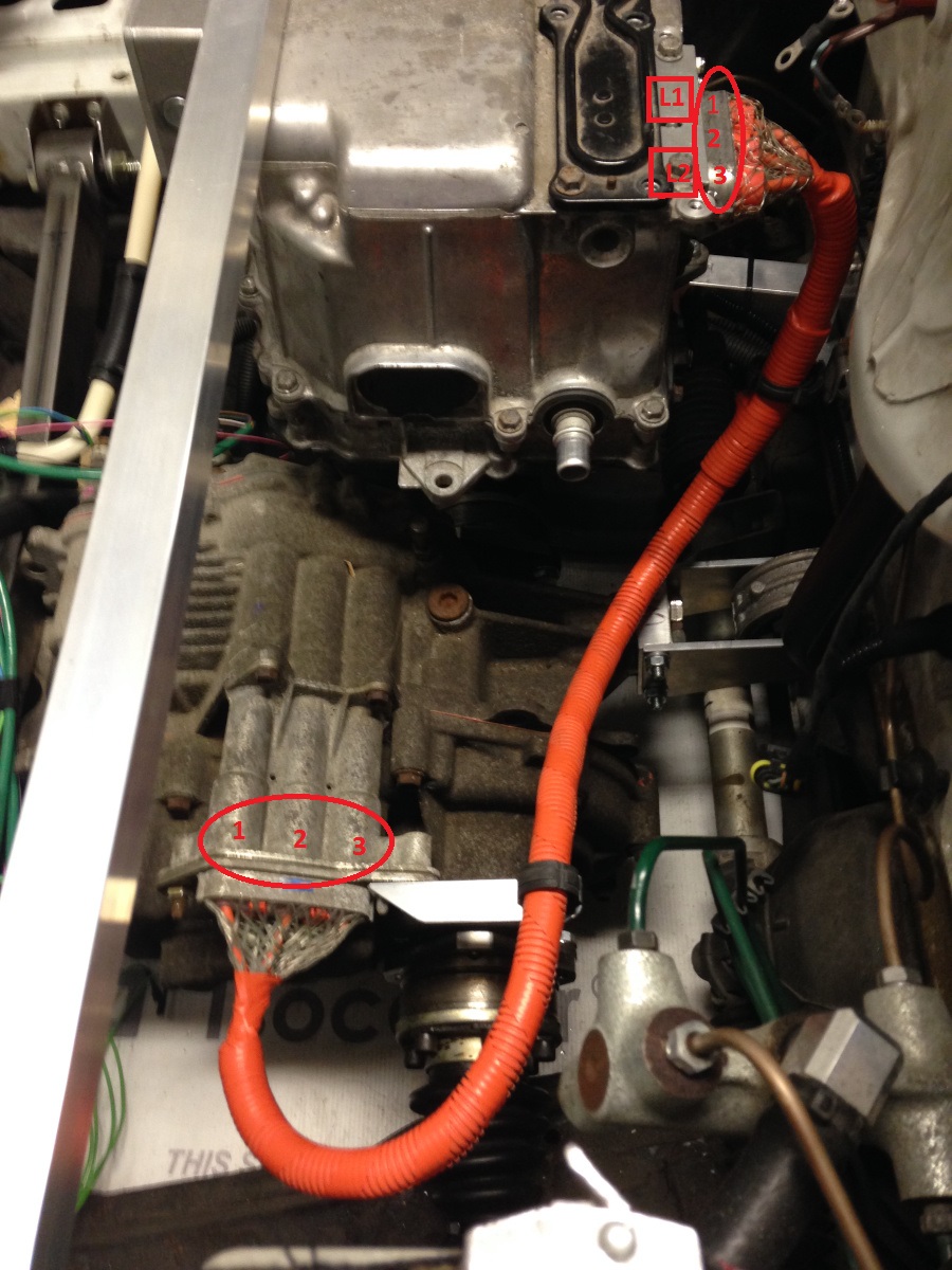

1. according to your photo of the installation between the inverter and the motor, I can not see the order of connection of three-phase wires, I need to see the order of connection. on the inverter, the numbers for the current sensor and the numbering of the phases I marked correctly. and correctly marked on the engine?

1. With the phase order markings on the motor, on the inverter I have the opposite order i.e. switch 1 & 3. Phase order as in picture above. I don't know the order of the current sensors but it is the stock Toyota placement and then using the logic board to handle the connections.

Re: Toyota MGR Rear Traction Transaxle
Maybe my phase order is as described in the picture... I will have to double check when I get home.
Phase order double checked and the picture has the same order as I do.

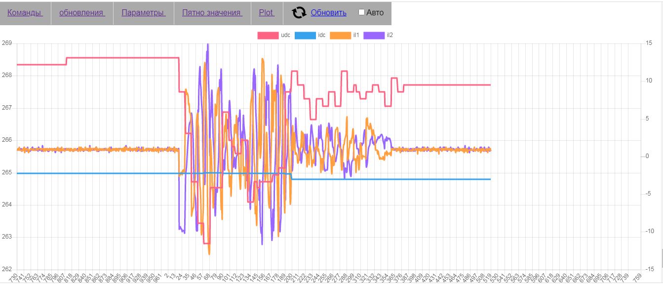

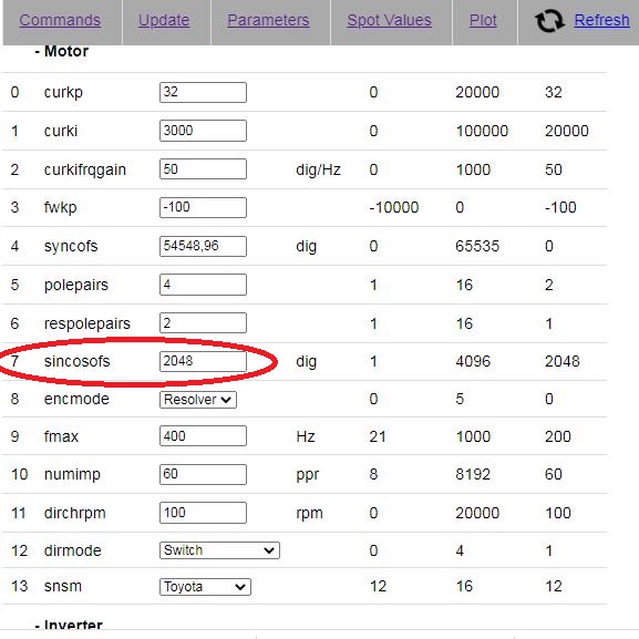

установил прошивку 4.97. R-foc
installed firmware 4.97 R-foc.
вроде бы отрегулировал syncofs по инструкции.
seems to have adjusted syncofs according to the instructions.
при включении старт и вперед с помощи акселератора, двигатель крутится вроде бы нормально.
when you turn on the start and forward with the help of the accelerator, the engine seems to be spinning normally
когда переключаю назад тоже нормально крутится, но при отпускание акселератора двигатель все равно крутится но медленно.
when I switch back, it also spins normally, but when the accelerator is released, the engine still spins but slowly.
регенерация не требуется.
no regeneration needed.
где я ошибаюсь
where am i wrong?
My best guess is to try adjust the syncofs value and see if it changes anything.
idle mode seems to be active (set to 3), which might explain this behavior.mikmur wrote: ↑Fri Jul 09, 2021 8:35 am установил прошивку 4.97. R-foc

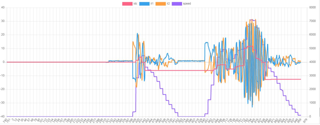

installed firmware 4.97. r-foc. until I get it syncofs, I will not change the firmware.
in the same digits syncofs behaves strangely. when entered into manualid 20 amps or more amperes 90 ..... .....the engine spins back and forth. when entering manualid 0 amps and enter ...... the motor will spin up quickly and stop.
what's wrong again, puzzling

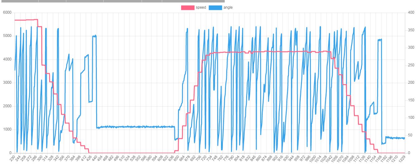

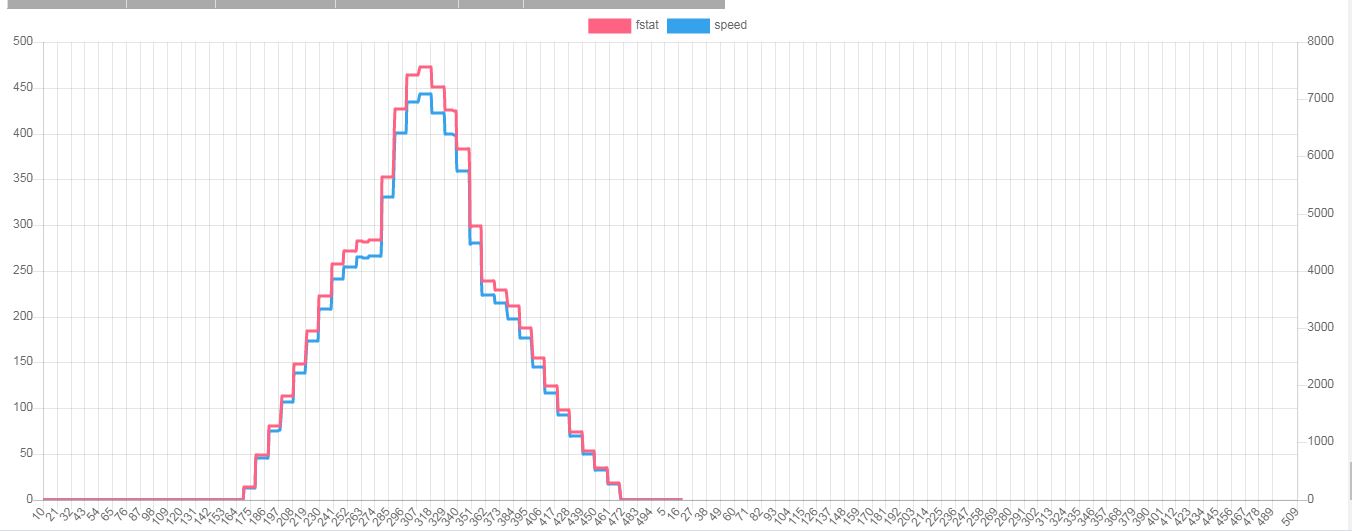

Maybe the resolver phases are switched?
If you slowly turn the motor by hand, what does your angle plot look like?
Idle mode is set to always on, I do not think that will cause your issue, but try setting it to off.
Also, you have "dirmode" = Switch just as I do, this needs to be tied to 12v for the syncofs tuning process to work.
Edit: I think your syncofs value is on the "wrong side" of the valley, when you use the throttle it appears the MGR rotates in the opposite direction selected.

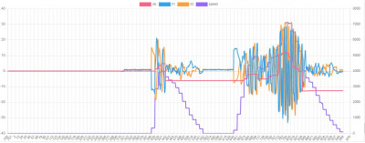

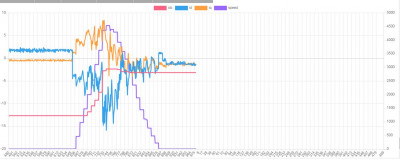

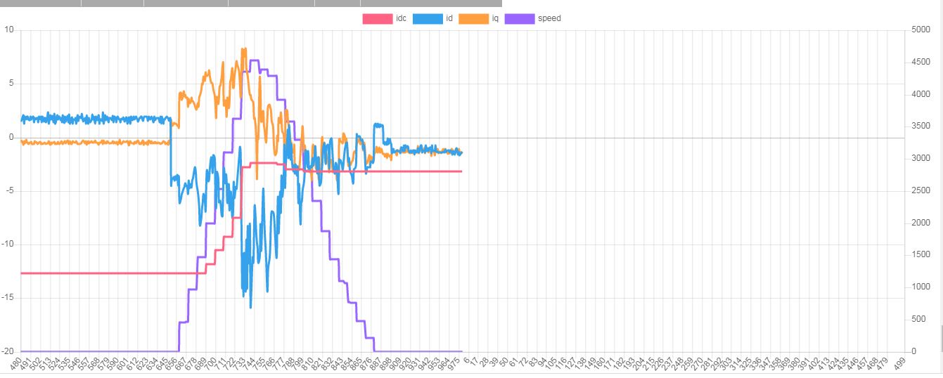

Hello everybody.
после долгих мучений мотор вроде нормально раскрутился.
after long torment, the engine seemed to spin normally.
для установки sincosofs необходимо измерить напряжение с энкодера (после резистивного делителя)
to install the sincosofs, you need to measure the voltage from the encoder (after the resistive divider)
чтобы раскрутить мотор-редуктор медленно, руками, один оборот трудно.
to unwind the geared motor slowly, by hand, one revolution is difficult.
как-то раскрутил и замерил напряжение между GND и с энкодера (после резистивного делителя).
somehow unwound and measured the voltage between GND and from the encoder (after the resistive divider).
от минимум бил 0 вольт, до максимума 0,65 вольт.
from a minimum beat 0 volts, to a maximum of 0.65 volts.
according to instructions (((U1+U2)/2)/3.3)X4096
U1=0.00V
U2=0.65V
Sincosofs=806.78
вот видео и если что не так с параметрами жду комментариев
here is a video and if something is wrong with the parameters I am waiting for comments
обновление:
renewal:
напряжение поднял до 270 вольт
voltage raised to 270 volts
переснял видео заново
reshoot the video
добавил графики разные
added different graphics
