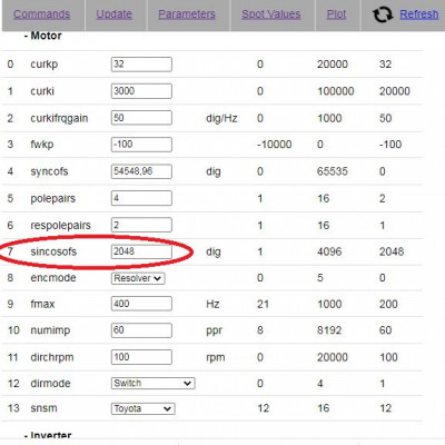

Re: Toyota MGR Rear Traction Transaxle
Idle mode is set to always on, I do not think that will cause your issue, but try setting it to off.
Also, you have "dirmode" = Switch just as I do, this needs to be tied to 12v for the syncofs tuning process to work.
Edit: I think your syncofs value is on the "wrong side" of the valley, when you use the throttle it appears the MGR rotates in the opposite direction selected.
Hello everybody.
после долгих мучений мотор вроде нормально раскрутился.
after long torment, the engine seemed to spin normally.
для установки sincosofs необходимо измерить напряжение с энкодера (после резистивного делителя)
to install the sincosofs, you need to measure the voltage from the encoder (after the resistive divider)
