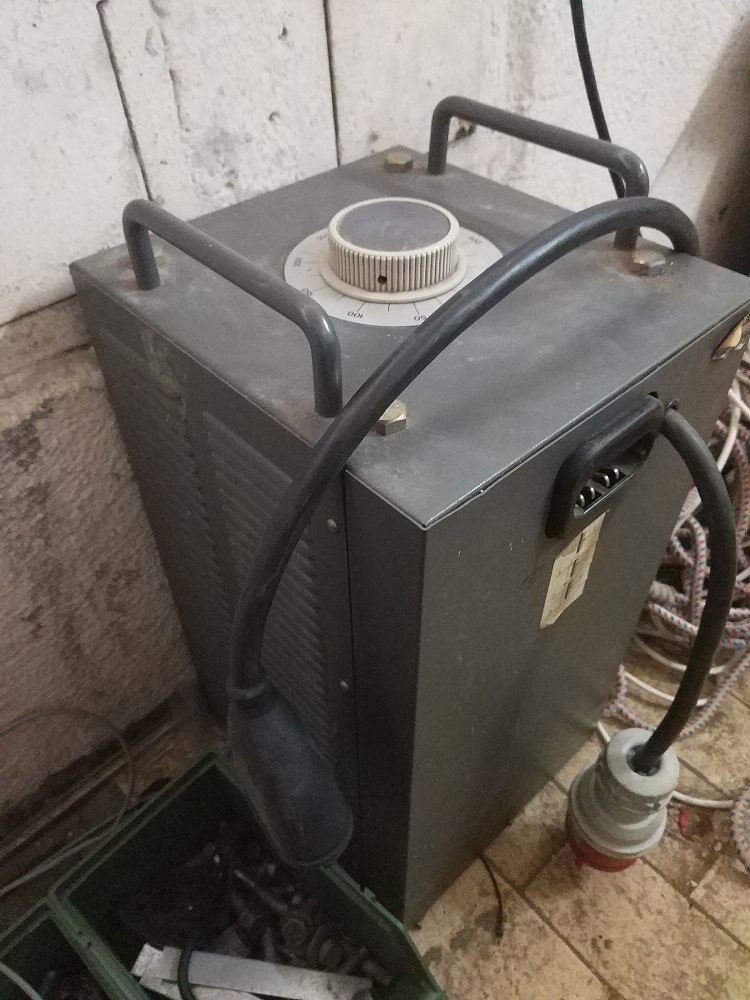

I got something home that seems to be usefull and heavy as well. While it is unused it sits quietly in a corner, but if i use it it starts to rumble with 120Hz.
This is Variac or autotransformer. This particular unit is 3phase 10kW model. If i feed it 3phase 400Vac it will make from 90Vac to 450Vac.
Conversion is made by transformer core. To vary the voltage i can move secondary transformer core out of primary by a knob on the outside.
So i decided to make 3phase rectifier of an old army ammo can. First i got 3 phase bridge. A nicely shaped cooling fins and one 100uF film capacitor rated to 900Vdc. I added a 50A forward diode so i cant connect the whole thing wrong.
Once i connected it and tested everything it became clear alu fins will heat up. So i got one 230Vac cooling fan over the fins.
I do have to be near the thing when it charges since it doesnt have any voltage control. I simply set it to battery voltage with some overhead so the desired current flows and then over time current slowly diminishes as voltage equalises.
In the face of my car full charge i need to reset voltage at least 3 times to get to 400Vdc desired battery voltage.
I am sure i could make a simple DC voltage detector to cutoff the main AC contactor. But for now it works as excellent home charger backup.

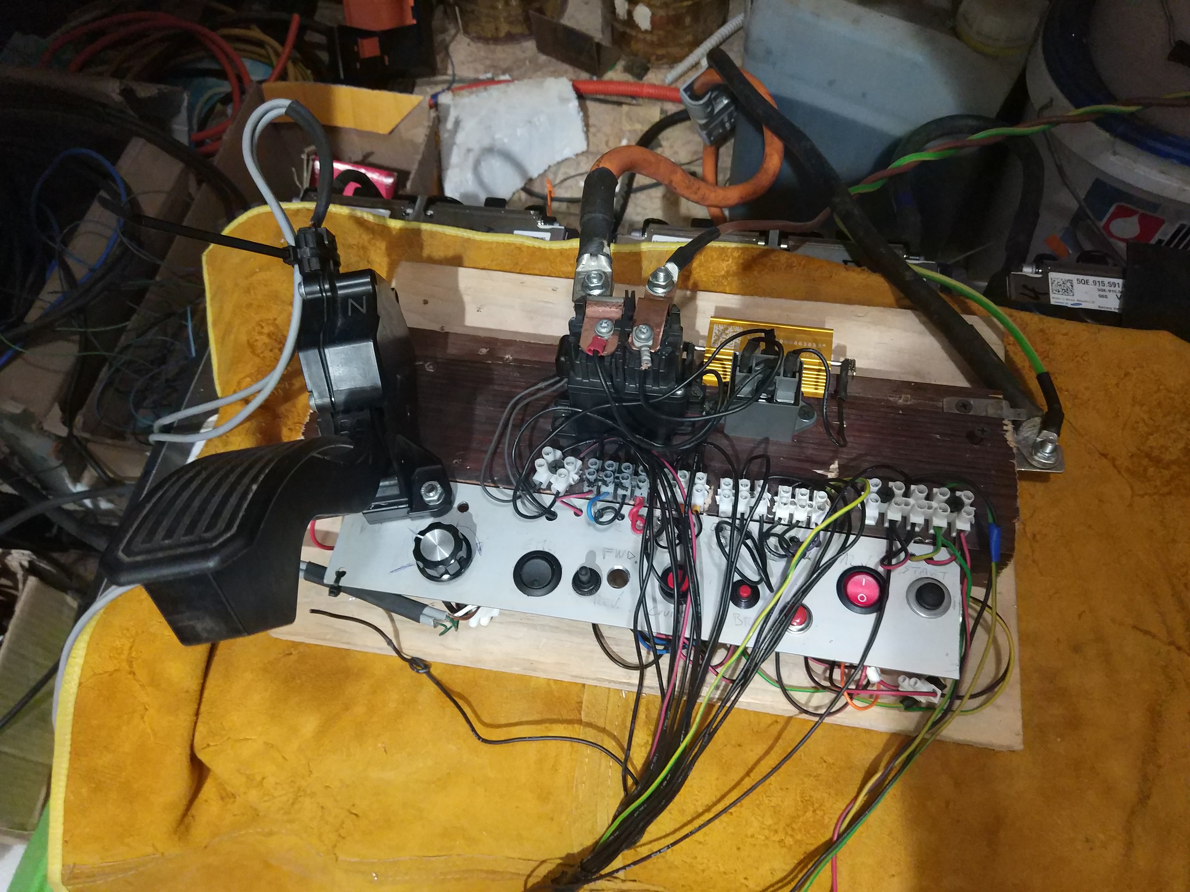

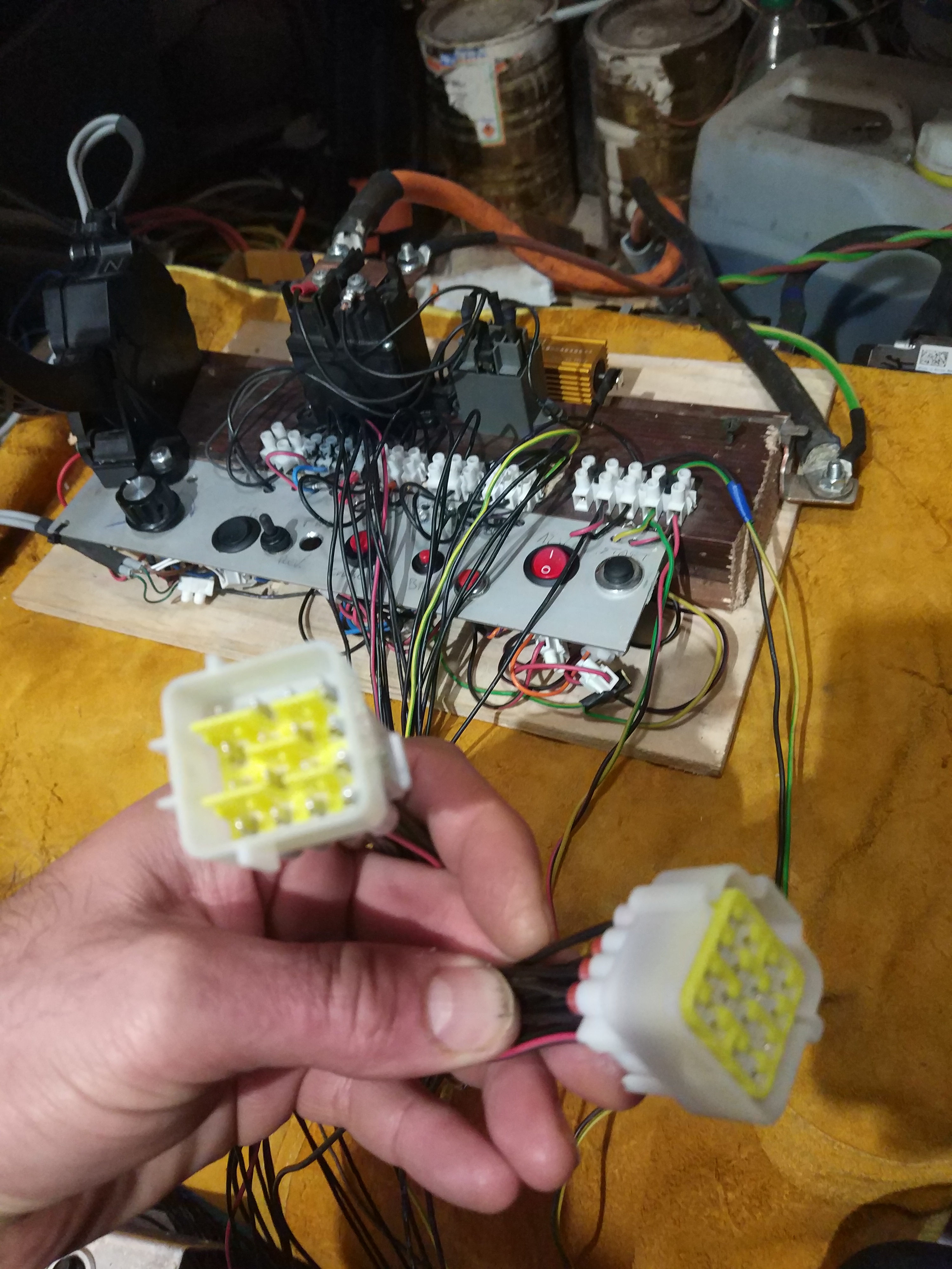

HM... Some posts reminded me of a thing i made for testing basically any Johannes board, be it Rev1, 2 or the newest edition.
I took a block of good straight wood. I screwed on a wide alu angle so i had somewhere to put my switches. Underneath the angle i sorted all the wires.
DC contactor, precharge relay, warning LEDs and large resistor i fixed to wooden support.
I made a harness from 20 wire signal cable and i used numbered wires for every line.
I used standard 16 pin crimped sealed connector from aliexpress
This way whatever inverter i use i will have the same setup and interchangeable connectors on all.
I can thus test all inputs as well as most of the outputs with this. It lets me connect directly to inverter and 400Vdc battery, or 60Vdc battery if i choose it.
I think it was well worth investing some switches, DC contactor, relay, Prius pedal some wire and large 150R resistor.
