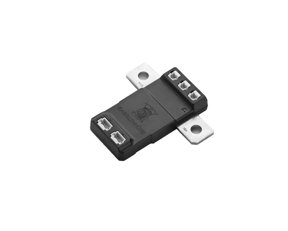

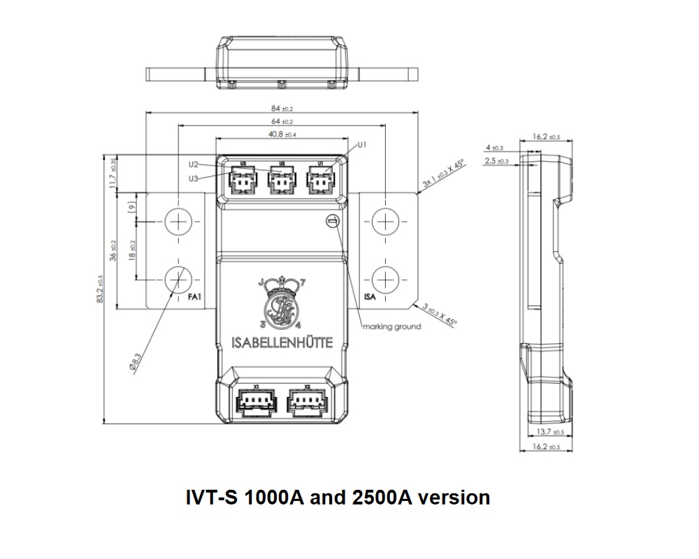

ISABELLENHÜTTE IVT-S CAN current and voltage sensors
This is the sensor Damien is integrating with Lexus GS450H VCU
Pretty robust and versatile device.
At $290 is somewhat expensive though.
I am still interested and I was curious if there is any interest in group buy for those sensors for US/Canada region.
I found US distributor where I can buy them at discounted price if I get 10+ units.
If there is enough interest I would be willing to organize "group buy" and distribute sensors for $200 plus shipping.
I am planning to buy exactly the same version Damien is showing in his video which is 1000A with 3 Aux inputs, this should be appropriate for most conversions. Picture above shows 500A but drawing shows 1000A unit (not trying to confuse anyone). The difference is 2 bolt terminals on 1000A vs 1 bolt on 500A.
Anyone interested please PM me. If there is enough PMs I will create separate thread to keep track on requests.

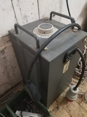

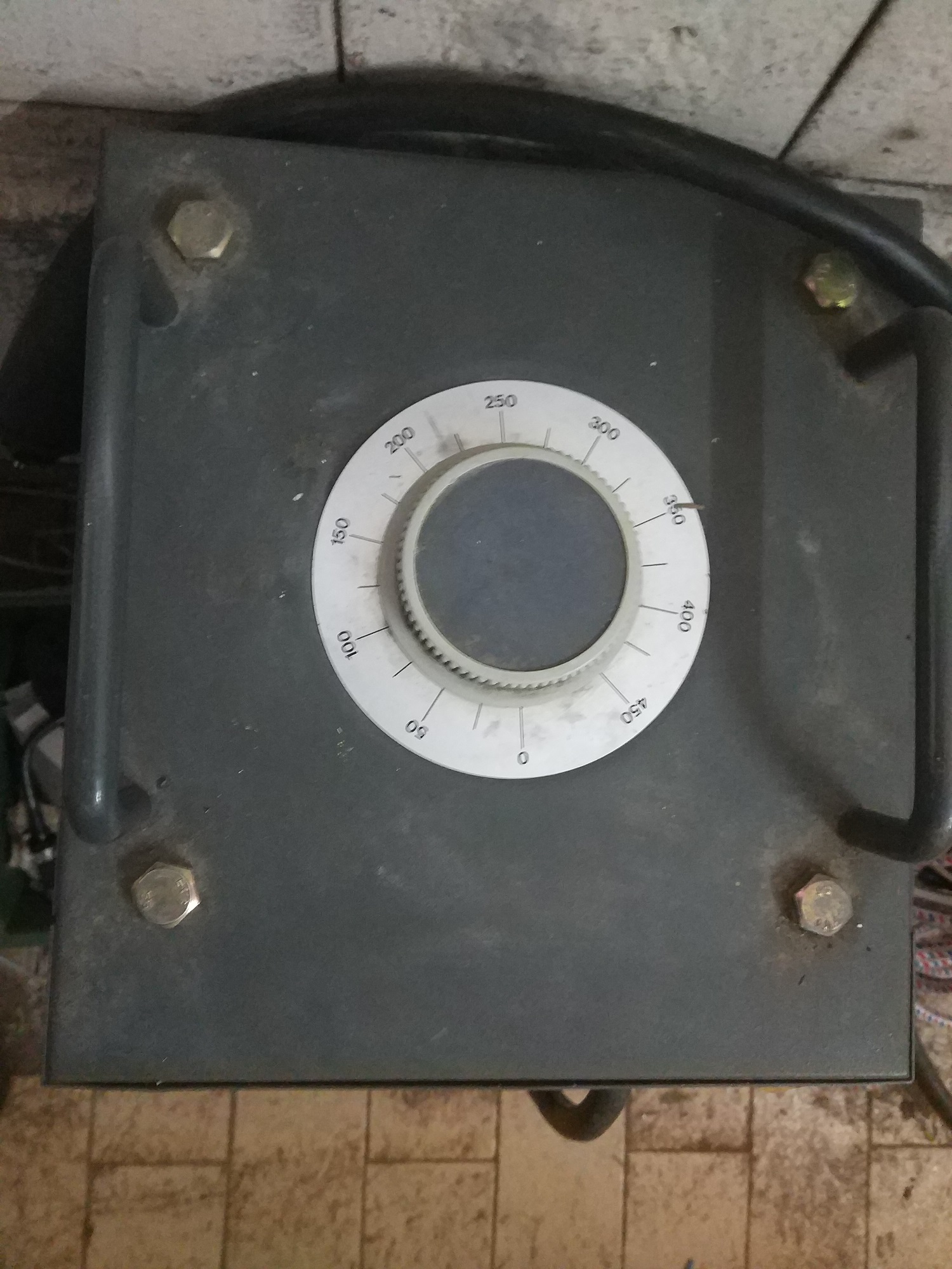

Mechanical 3phase charger
I got something home that seems to be usefull and heavy as well. While it is unused it sits quietly in a corner, but if i use it it starts to rumble with 120Hz.
Conversion is made by transformer core. To vary the voltage i can move secondary transformer core out of primary by a knob on the outside.

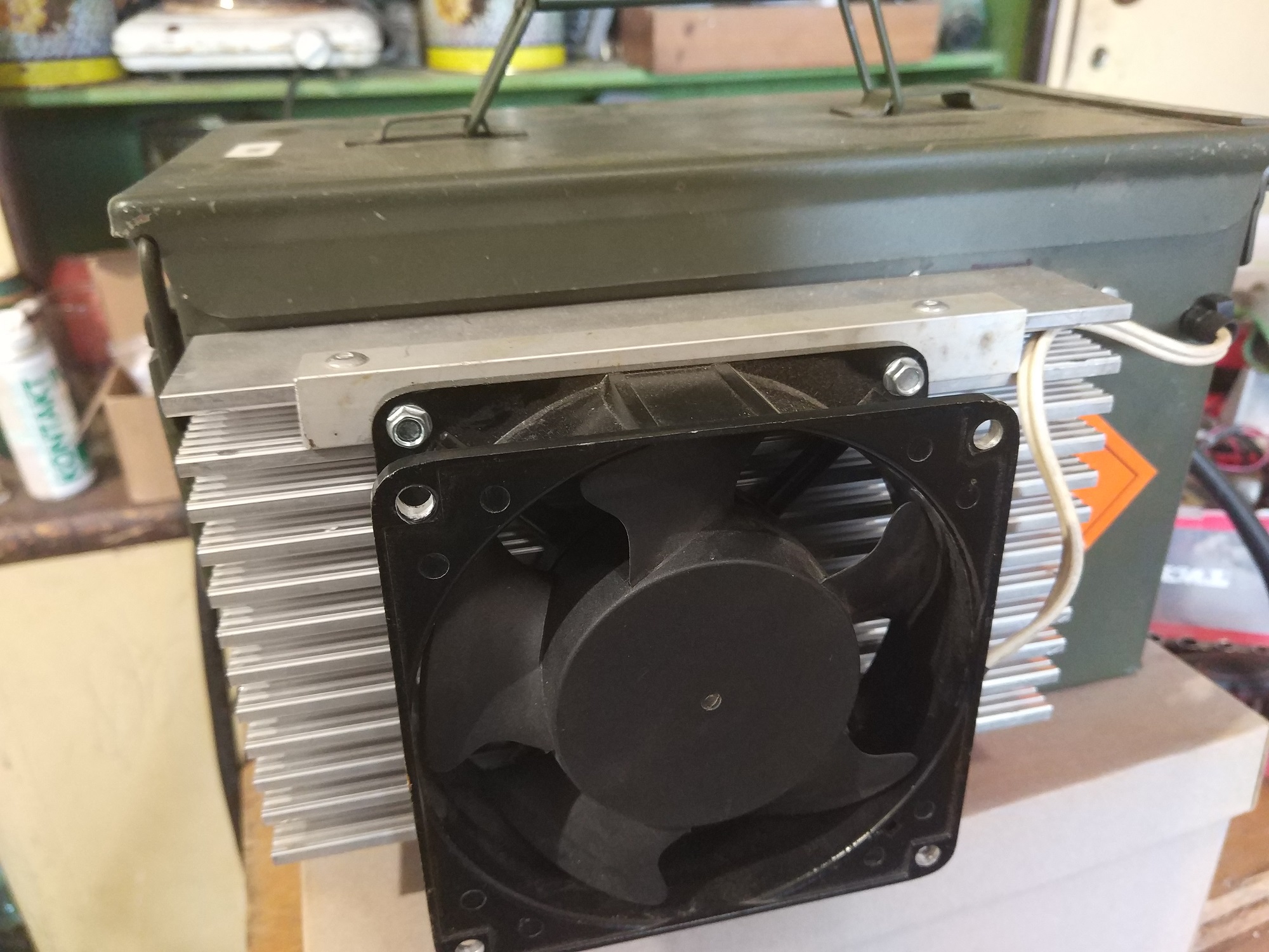

So i decided to make 3phase rectifier of an old army ammo can. First i got 3 phase bridge. A nicely shaped cooling fins and one 100uF film capacitor rated to 900Vdc. I added a 50A forward diode so i cant connect the whole thing wrong.
Once i connected it and tested everything it became clear alu fins will heat up. So i got one 230Vac cooling fan over the fins. I do have to be near the thing when it charges since it doesnt have any voltage control. I simply set it to battery voltage with some overhead so the desired current flows and then over time current slowly diminishes as voltage equalises.
In the face of my car full charge i need to reset voltage at least 3 times to get to 400Vdc desired battery voltage.
I am sure i could make a simple DC voltage detector to cutoff the main AC contactor. But for now it works as excellent home charger backup.
This is Variac or autotransformer. This particular unit is 3phase 10kW model. If i feed it 3phase 400Vac it will make from 90Vac to 450Vac. Conversion is made by transformer core. To vary the voltage i can move secondary transformer core out of primary by a knob on the outside.

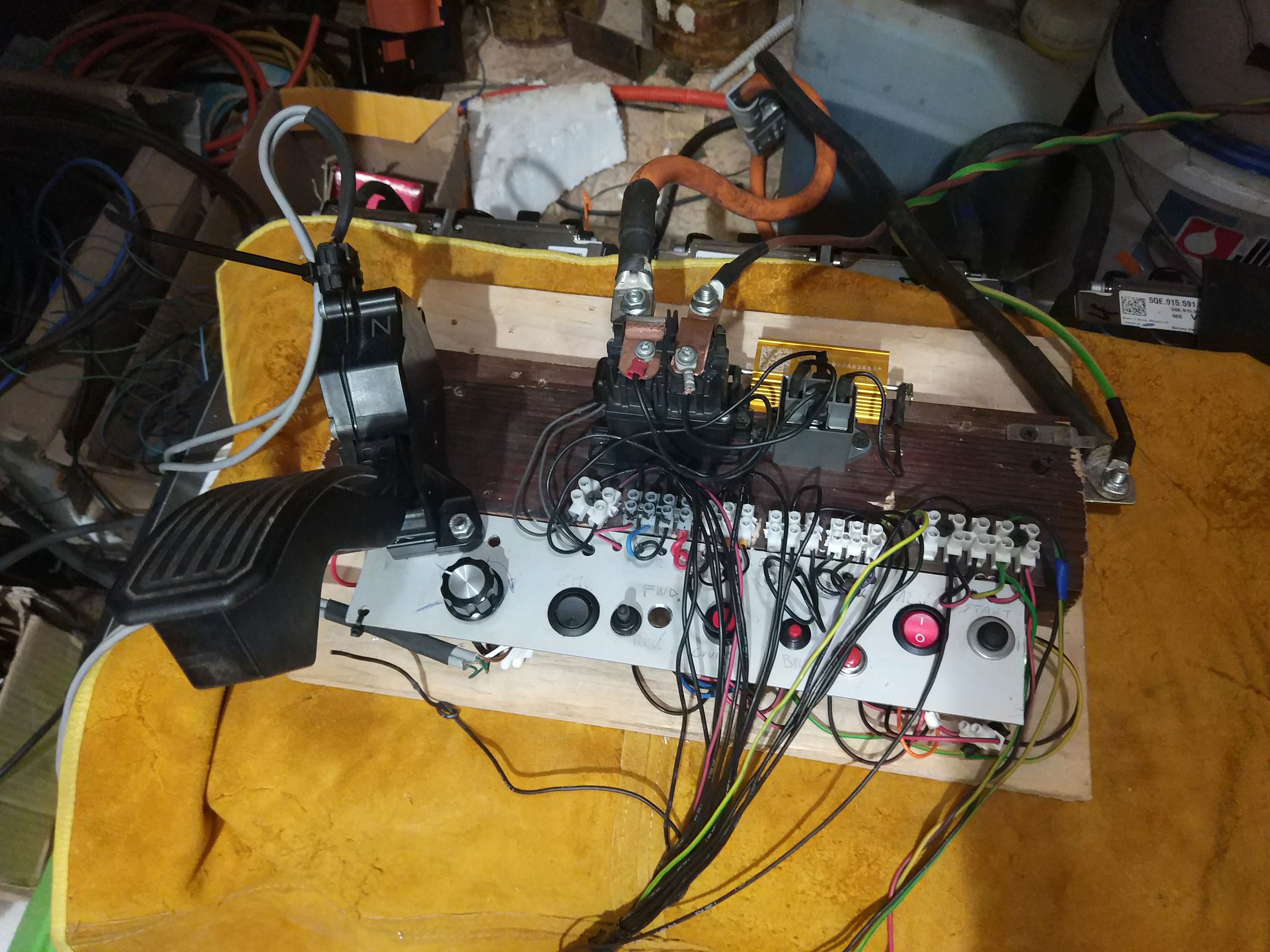

HM... Some posts reminded me of a thing i made for testing basically any Johannes board, be it Rev1, 2 or the newest edition.
I took a block of good straight wood. I screwed on a wide alu angle so i had somewhere to put my switches. Underneath the angle i sorted all the wires.
DC contactor, precharge relay, warning LEDs and large resistor i fixed to wooden support. I made a harness from 20 wire signal cable and i used numbered wires for every line.
I used standard 16 pin crimped sealed connector from aliexpress
This way whatever inverter i use i will have the same setup and interchangeable connectors on all. I can thus test all inputs as well as most of the outputs with this. It lets me connect directly to inverter and 400Vdc battery, or 60Vdc battery if i choose it.
I think it was well worth investing some switches, DC contactor, relay, Prius pedal some wire and large 150R resistor.

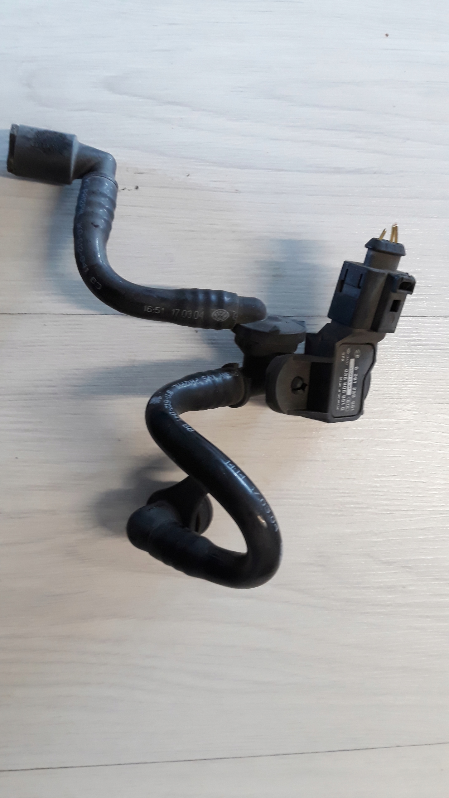

I use the pressure/vacuum sensor with part number 036906051G to control the vacuum pump in both my conversions.
Its supply voltage is 5V and it outputs an analog voltage proportional to the pressure, i.e. the more vacuum, the lower the voltage. The voltage can either be used with a voltage divider and a heavy low pass filter (1 Hz) to control an NPN transistor (that controls a relay) or with an ADC. I have tried both and it works well. It is important to have some hysteresis otherwise the pump tends to switch on and off around your desired vacuum.
The given part number is just for the sensor, try to get the whole assembly as depicted. It also contains a kickback valve.
The part number for the matching connector should be 1J0973724 is 1J0973704.
