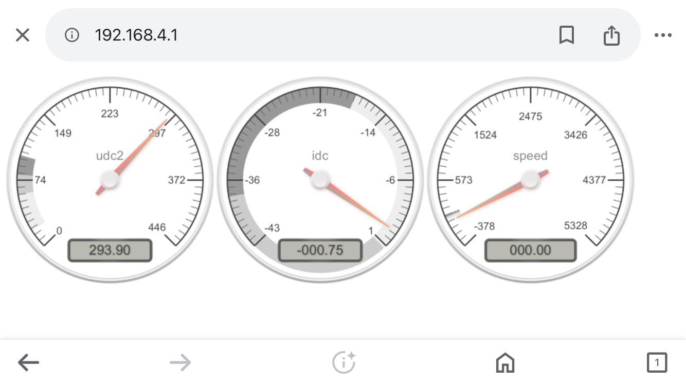

Re: [DRIVING] 1984 Voltswagen Rabbit Prius Gen 3 ZOMBIE
here I am just using my iPhone to show some basic virtual gauges: Volts, Amps, and RPM
I use the battery pack voltage as a fuel gauge for example 327 volts is 90% charged but that's as high as I am willing to go without BMS and I think I can run it down to like 265 maybe
the Amps show me how much current I am drawing
and the Speed gauge shows me the electric motor RPM
