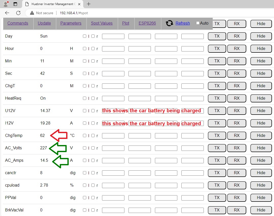

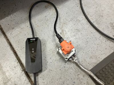

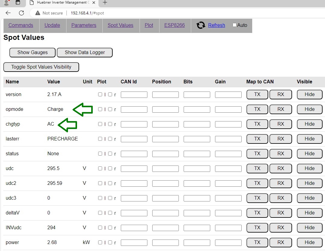

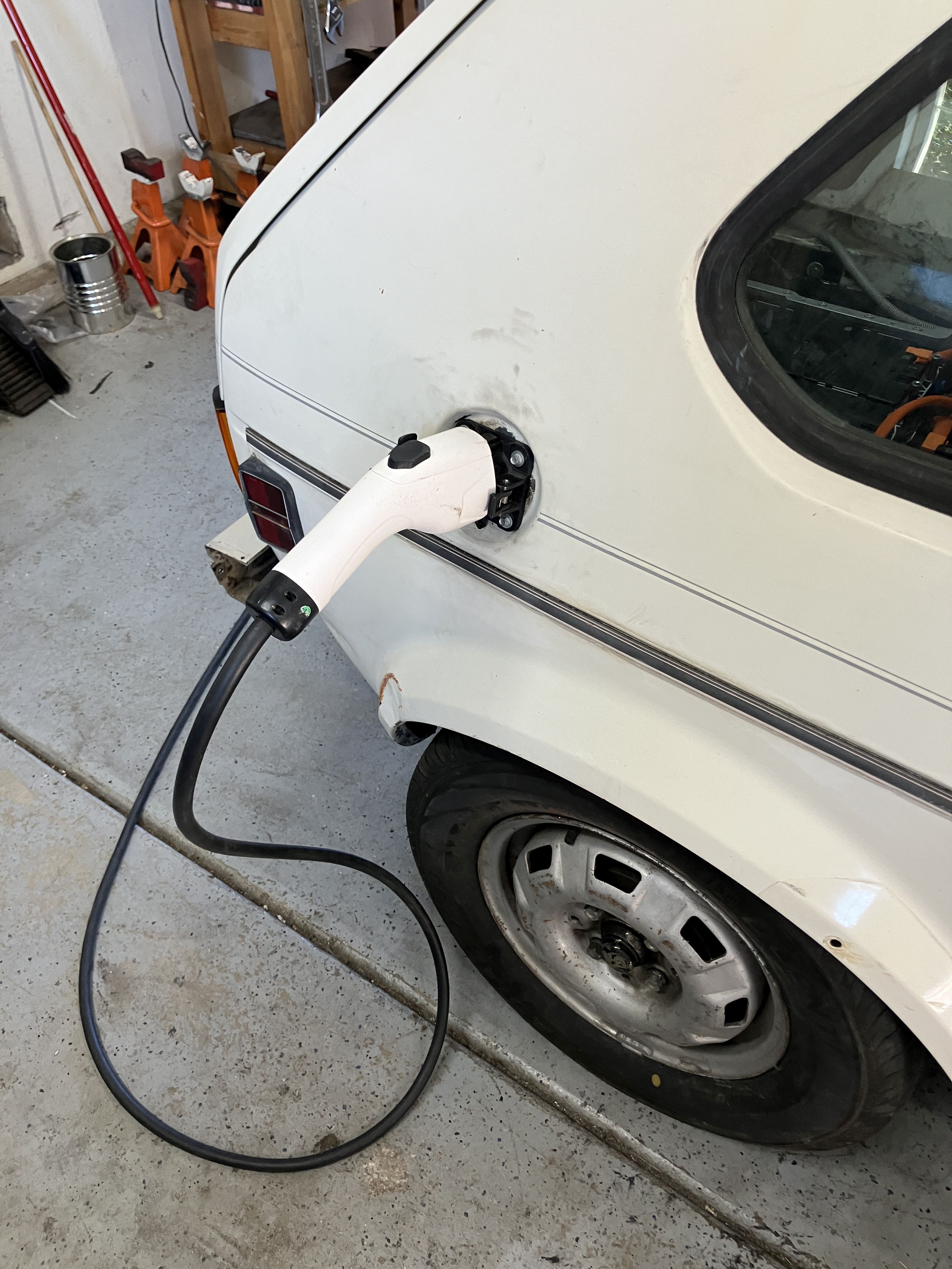

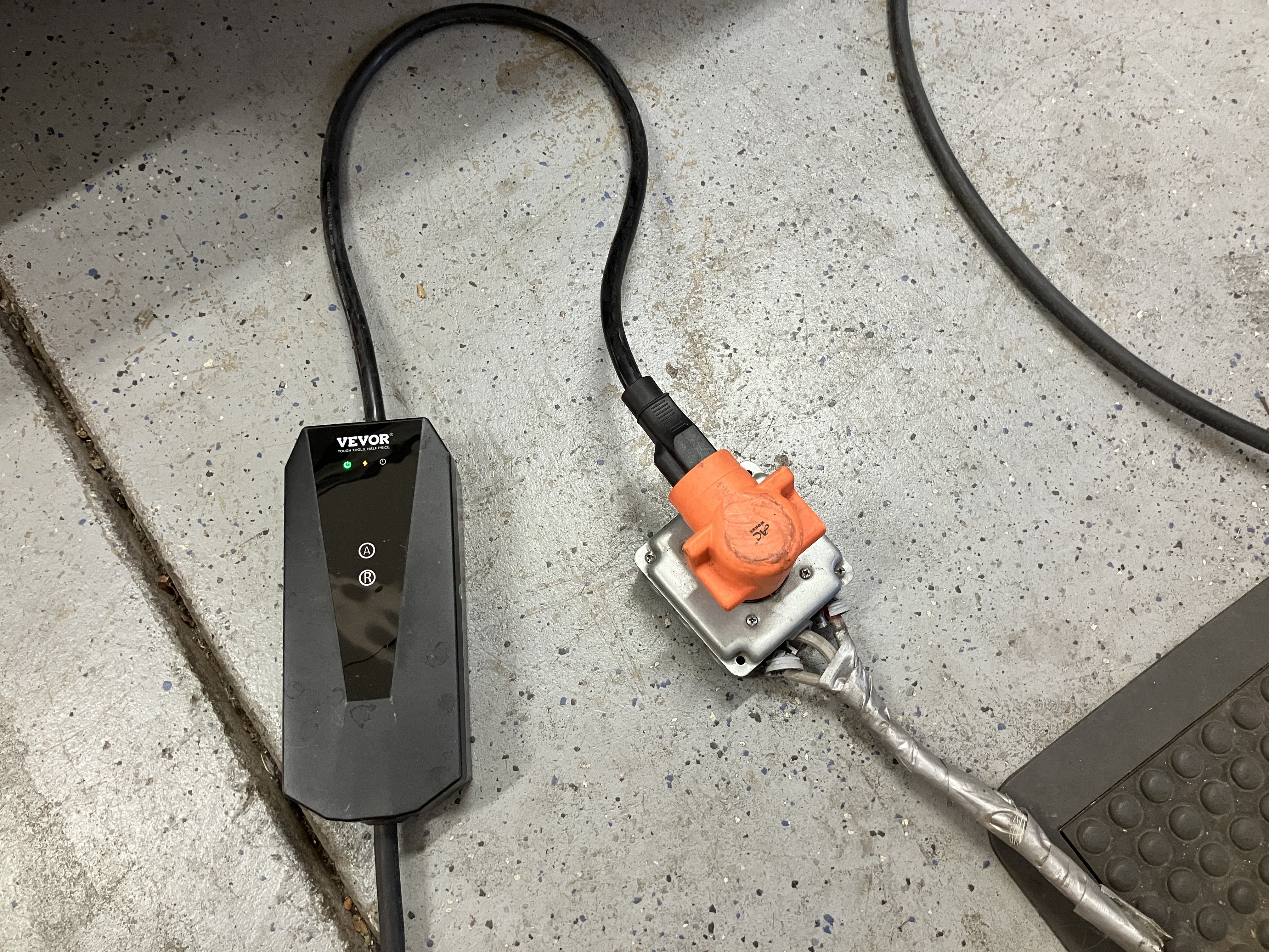

OK, so got the charging workings, yes all by myself, by simply following exactly precisely the steps from the boys on Mr. Damien Maguire's best kept secret Discord Server which you can get access to by supporting him on EVBMW Damien Maguire where you can show your support for him creating Open Source Electric Vehicle Projects!
Super Thanks to the Fellas on the Discord Server I appreciate you too much !!!
The Zombie will go into Charge mode without the Control Pilot signal connected and even without the J1772 hair dryer plug plugged into the charge port, so just be aware of this.
One way to tell if the CAN communication is working is to look for some charger Spot Values such as charger temp and U12V (U=Volts) and I12V (I=amps) which tell you the DC-DC converter part of the charger is charging the regular 12v car battery.
That's Level 2 charging which just means at 240 volts
It don't have to be the Science of Rockets, here I am just using a regular clothes dryer outlet that i added an extension to, and we converted our clothes dryer from electric to gas, so this is always available

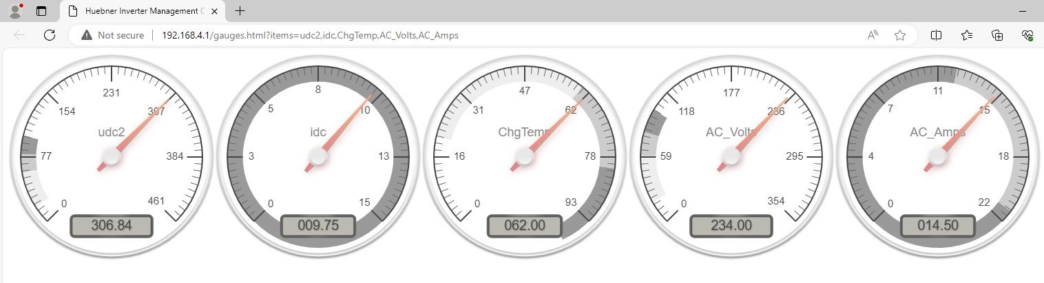

Charging Gauges

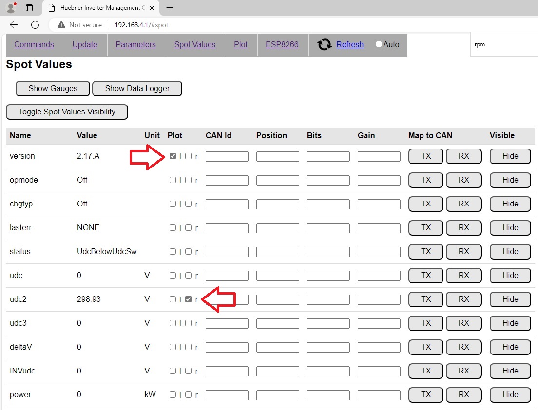

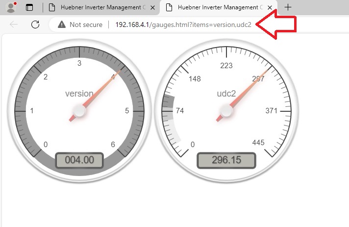

Woodfie wrote: Mon Jul 01, 2024 7:50 am Yes, title 192.168.4.1/gauges.html?items=
Appears, but as yet a blank page.
sorry I did not answer this earlier, it appears that we must select the Spot Values we want to appear on the gauge page using the little check boxes, and I don't think it matters if we check the l or r column, it's actually pretty cool since it is dynamic and fully customizable
Example: here I select the l check box for the Version, and the r check box for the battery voltage aka udc2
and this is the result, note the URL see how now it passed these parameters to the next page?

Post by Woodfie »
Gregski wrote: Sun Jul 07, 2024 9:29 pm sorry I did not answer this earlier, it appears that we must select the Spot Values we want to appear on the gauge page using the little check boxes, and I don't think it matters if we check the l or r column, it's actually pretty cool since it is dynamic and fully customizable
Great, thanks for that .. fron a post from tom, it seems just one motor is displayed, the highest temp one..
This us good to know.

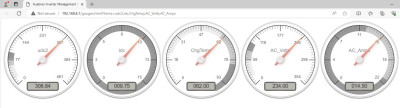

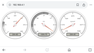

Post by Gregski »

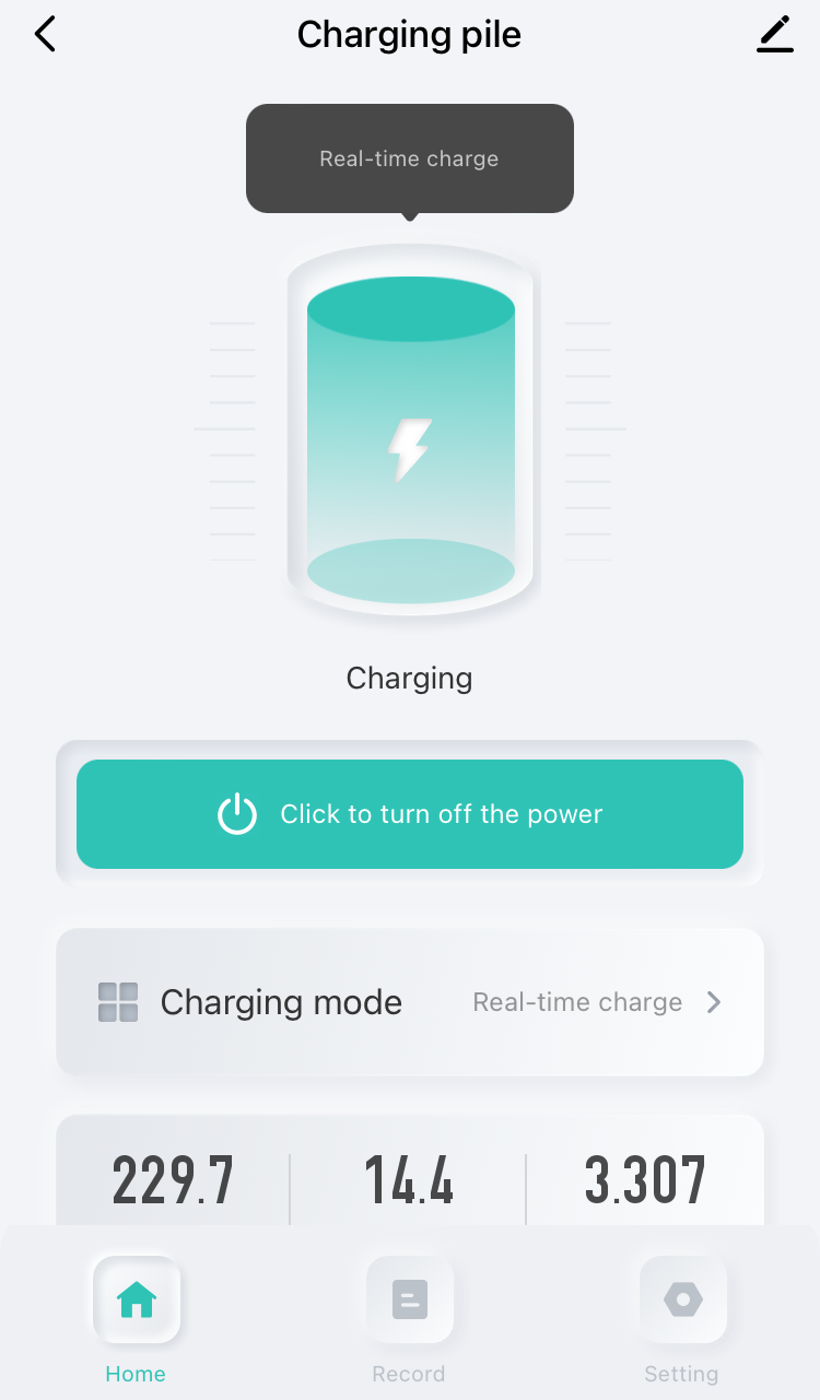

here I am just using my iPhone to show some basic virtual gauges: Volts, Amps, and RPM
I use the battery pack voltage as a fuel gauge for example 327 volts is 90% charged but that's as high as I am willing to go without BMS and I think I can run it down to like 265 maybe
the Amps show me how much current I am drawing
and the Speed gauge shows me the electric motor RPM
