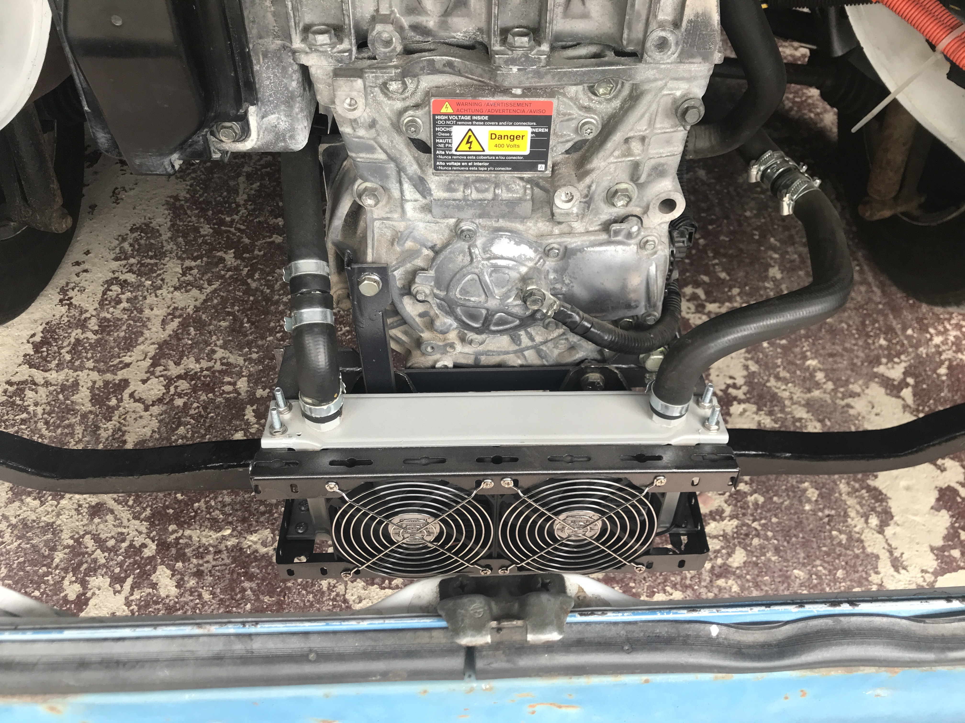

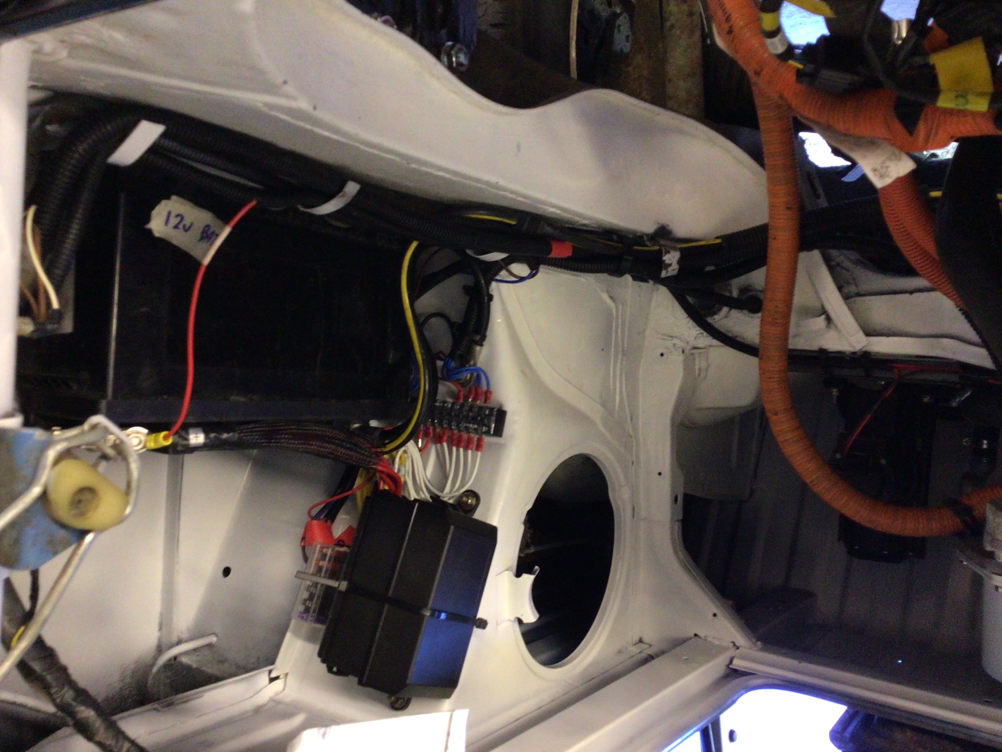

So CANbridge isn’t the answer. Investigating 62kWh BMS.
In other news, cable tidying…
1) Engine Bay now much nicer… (aaargh, upside down!)
2) VCU wiring up at the front. Getting there, still a bit to do on the driver controls part which are still a bit temporary.

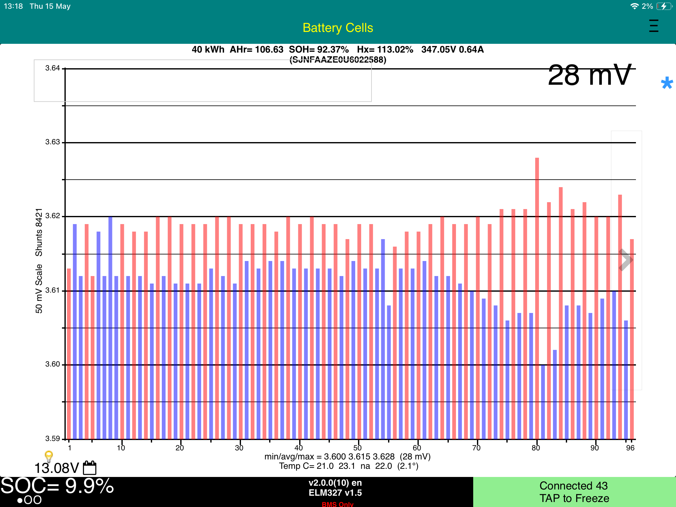

I’ve moved on from focussing on my weak cell 55 as he doesn’t seem to be much of a problem. Still a slacker, but nothing serious.
All the attention now is cell 67. As mentioned this is the first cell of module 11 on a 2meter HV extension and the first of 30 cell tap extensions.
Just to be sure, Ive remade the BMS connections to all the cells in module 11. Rechecked the HV for a tight connection and retested around the block and then on to the Shell.
So this is what I get to watch when Chademo charging. Playing chicken with battery cell!
That 99mV can bounce around of course, think up to 150 at one point.
I called it quits at 85% SOC and with cell 67 reaching about 4.08. That’s an upper limit I’m happy with. I’d prefer not to experiment with that cell hitting 4.10 and higher, although happy to hear anyone’s thoughts on safe voltages for a leaf 60kWh battery cell.
Edit - this is only a rapid charging problem as far as I know so far. Should I have the need, I ought to be able to go higher on my home 2kW charging.
Battery temp got up to 26.5deg
Chademo charging started at 30-something kW, but then was down in the 20s. Did about 30minutes.
Once I was done charging cell 67 rejoins the rest of the pack. Then 15 min drive home and final LeafSpy when at rest.
Is the voltage on that high cell being measured at the cell or at the end of a series link joining the last module to the module with the high voltage when charging? In other words, measuring between cell 67 @4.065v and cells 68 and 69 that are both low at around 3.985v. The cell average voltage at that point was 3.99v.
I'm thinking the high reading is being exaggerated because of additional resistance between the negative on the high cell and the negative on the next cell that is using to get used to get voltage reading across cell 67 and this affecting the voltage reading of cell 68 and 69 ......
This can generally be verified if the voltage drops on the high cell when the charging stops, yet rises on the next two cells, then drops even more if a load is applied and the next two cells rise further ......

T1Terry wrote: Mon May 19, 2025 9:40 am Is the voltage on that high cell being measured at the cell or at the end of a series link joining the last module to the module with the high voltage when charging? In other words, measuring between cell 67 @4.065v and cells 68 and 69 that are both low at around 3.985v. The cell average voltage at that point was 3.99v.
Not sure if any of that made sense, it did in my head when I was writing it, but not so sure reading back after posting it :?
T1 Terry
The main conclusion I reached is that there isn’t much I can do about it apart from monitor it to make sure it doesn’t peak too high.
Since that post, I’ve done another drive of 80 miles, often at 60 mph. And done an AC charge from a low SOC back up to 90%. None of this causes that situation. It’s only a Chademo charge that will stress things and display those peaks on each module, with that module 11 being the worst. As long as I know the potential risk area, that’s the main thing. There’s nothing I can do about the HV or cell tap cable lengths, and I’ve remade the module 11 connections to be absolutely sure. I can set a max charge limit to 85% which should keep it within safe limits based on what I’ve seen so far. Most of the time that’s going to be plenty to get back from wherever I’ve been.

New BMS / ‘weak’ cell clarifications
So my correct* BMS arrived to match the 60kWh battery and to replace the 40kWh BMS I had been using. As expected, the predicted range and SOC charge makes more sense now. (The 40kWh BMS will be for sale if anyone’s looking)
I’ve just done a real world test drive to prove its range. 150 miles. This was on a warm day, about 80% driving at 50 - 60mph. Had an extra passenger for some of the drive and some extra weight on board from packages I was moving so pretty good test I think.
I drove it down to turtle mode, so I now have a real understanding of my limits.
*actually the BMS is from a 62kWh, whereas mine is 60. So there remains a minor disconnect. My original 60kWh BMS reported the battery as 165Ah. This new one thinks it’s 175Ah, so I think that means it would let me try to charge up to a greater capacity than my battery actually supports. So I will never test that, and will aim to manually stop based on Ahr rather than SOC %.
To prep for my extended drive I had stopped charging at 162Ah. The VCU reported this as 97%, LeafSpy thought 92.6%. Then ran down to 4% on VCU display. This would have been fine, if it wasn’t for my weak cell#55, which really was not happy at the very steep track we live up. It’s 18% / 1:5.4 gradient and I couldn’t make it to the top. Had to roll back down! That cell had dropped dramatically to 400mV below average under that load and I guess the BMS decided to intervene. It had been a little low before that, but nothing extreme.
Left the bus at the bottom, came back later and crawled slowly up the hill and made it back to the house. Cell #55 gradually recovered on its own with the delta reducing at a steady rate. Then once the battery was put on a slow charge, it rejoined the rest of the pack. I’ve since been on a couple of drives and there’s no lasting effect. But clearly going down to 4% is not a good thing to do - at least when/if I replace the module with cell #55 in it.
Then there’s cell #67 which was the discussion from the last few comments with T1Terry, Brat and Tom. I’d talked about an extra voltage peak during Chademo charging. As was pointed out, this is likely the BMS miscalculating because it is unable to accommodate the extra resistance from a 2m HV cable that the OEM battery didn’t have.
I wasnt sure before, but that same cell voltage does also drop under acceleration, which I think Tom suggested I’d expect to see. As soon as the load is removed, LeafSpy shows nothing unusual with this cell #67.
I wondered whether I’d find that as my SOC charge ran down that the drop on 67 under load might impact performance. But as far as I can tell that wasn’t the case. I was still accelerating to test performance with a low SOC and seemed normal. So that means I only have to be conscious of whether #55 is misbehaving.
Talking of load under acceleration, there is something. Bear in mind this vehicle is not intended as a race day winner! I’m happy with the improved acceleration compared to the previous 1800cc petrol lump, and being able to keep going all the way up to 60mph is pure joy :)
But if I forget myself and decide to try to jump off at the lights or a roundabout and demand too much, the power cuts out for a split second. This can happen when moving off from 0mph. Doesn’t happen once I’ve got momentum up. Not a problem I’m too concerned about, I just won’t be stupid and try to win races at the lights!

We’re gonna need a bigger… radiator.
Up til now the motor temperature in my conversion reported by LeafSpy hasnt gone over 70deg C. In a not very scientific comparison test, a few weeks ago I drove our standard issue Nissan Leaf for 30 minutes down the motorway at 70mph to see what ‘normal’ should look like, and got a similar temperature.
On Friday, with outside temperatures of 31 C, and after driving 70 miles, the motor temperature hit 80C in the VW!
If anyone knows the upper limit for Leaf motor stack temperature, it would be good to hear. I knew the rad I used was a dinky little thing, but perhaps it’s not able to do a good enough job for the hotter days. Or maybe I’m still within acceptable limits? I’m a bit in the dark on this one.
But in good news, the prime directive of getting to and from music festivals has been achieved. Drove 140 miles there and back, so did it on a single charge with 15% usable battery capacity remaining. Loaded up with 1 wife, food, drink, chairs, table and assorted paraphernalia :)

this temperature is quite normal, there is no need to worry.
for the inverter, anything above 80° is critical, and the motor can tolerate 130° in long climbs.
