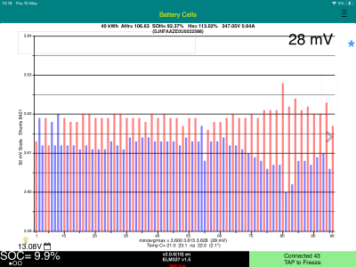

The final LeafSpy (it’s zoomed in below, so looks worse than it is) once back home shows 3.60 for the lowest cell and 347V for the pack. I think I’m right in saying that I’d expect to see the low cells much lower than that on a close to empty battery. So gives me hope that my range can go closer to the 150 than 100. But whether that is possible with the current BMS is something I haven’t dared to push yet.

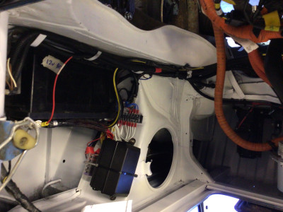

In other news, cable tidying…
1) Engine Bay now much nicer… (aaargh, upside down!)
2) VCU wiring up at the front. Getting there, still a bit to do on the driver controls part which are still a bit temporary.

Decided for my next test that if I was going to burn somewhere down with a battery fire I’d rather do the Shell garage than the local hotel (dear lawyers, this is just a poor taste joke and not a statement of intent).
All went ok.
I’ve moved on from focussing on my weak cell 55 as he doesn’t seem to be much of a problem. Still a slacker, but nothing serious.
All the attention now is cell 67. As mentioned this is the first cell of module 11 on a 2meter HV extension and the first of 30 cell tap extensions.
Just to be sure, Ive remade the BMS connections to all the cells in module 11. Rechecked the HV for a tight connection and retested around the block and then on to the Shell.
So this is what I get to watch when Chademo charging. Playing chicken with battery cell!
That 99mV can bounce around of course, think up to 150 at one point.
I called it quits at 85% SOC and with cell 67 reaching about 4.08. That’s an upper limit I’m happy with. I’d prefer not to experiment with that cell hitting 4.10 and higher, although happy to hear anyone’s thoughts on safe voltages for a leaf 60kWh battery cell.
Edit - this is only a rapid charging problem as far as I know so far. Should I have the need, I ought to be able to go higher on my home 2kW charging.
Battery temp got up to 26.5deg
Chademo charging started at 30-something kW, but then was down in the 20s. Did about 30minutes.
Once I was done charging cell 67 rejoins the rest of the pack. Then 15 min drive home and final LeafSpy when at rest.
Is the voltage on that high cell being measured at the cell or at the end of a series link joining the last module to the module with the high voltage when charging? In other words, measuring between cell 67 @4.065v and cells 68 and 69 that are both low at around 3.985v. The cell average voltage at that point was 3.99v.
I'm thinking the high reading is being exaggerated because of additional resistance between the negative on the high cell and the negative on the next cell that is using to get used to get voltage reading across cell 67 and this affecting the voltage reading of cell 68 and 69 ......
This can generally be verified if the voltage drops on the high cell when the charging stops, yet rises on the next two cells, then drops even more if a load is applied and the next two cells rise further ......
Not sure if any of that made sense, it did in my head when I was writing it, but not so sure reading back after posting it :?

T1Terry wrote: Mon May 19, 2025 9:40 am Is the voltage on that high cell being measured at the cell or at the end of a series link joining the last module to the module with the high voltage when charging? In other words, measuring between cell 67 @4.065v and cells 68 and 69 that are both low at around 3.985v. The cell average voltage at that point was 3.99v.

The main conclusion I reached is that there isn’t much I can do about it apart from monitor it to make sure it doesn’t peak too high.
Since that post, I’ve done another drive of 80 miles, often at 60 mph. And done an AC charge from a low SOC back up to 90%. None of this causes that situation. It’s only a Chademo charge that will stress things and display those peaks on each module, with that module 11 being the worst. As long as I know the potential risk area, that’s the main thing. There’s nothing I can do about the HV or cell tap cable lengths, and I’ve remade the module 11 connections to be absolutely sure. I can set a max charge limit to 85% which should keep it within safe limits based on what I’ve seen so far. Most of the time that’s going to be plenty to get back from wherever I’ve been.

ianlighting wrote: Tue May 20, 2025 5:56 am The main conclusion I reached is that there isn’t much I can do about it apart from monitor it to make sure it doesn’t peak too high.
His statement is if the measurement it self is in correct, not that the cell it self is too high

Bratitude wrote: Thu May 22, 2025 12:57 pm
His point is interesting. But there is no way to verify since it’s the BMS that reports this data and it’s only seen during a fast Chademo charge.
Even if the BMS is not reporting accurate voltage due to the wiring changes I’ve done compared to OEM original, I still have to behave as though they are ‘real’. Because any safety measures the BMS might take to protect a cell, module or pack, due to a cell that has overly high voltage, are going to be real. I’m speculating on the BMS behaviour, but if the BMS decided to shut down to prevent a cell reaching too high a voltage for example, it doesn’t matter if the cell is actually at a normal level if it was tested separately. All that matters is what the BMS thinks.
So that means charging up to 100% on AC (only tested up to 90% so far) is fine, and 85% on Chademo, keeps cell 67 within a safety margin.
It’s a bonus if cell 67 is actually not peaking in the way the BMS reports.

Have you figured out where the offending cell is?
Does it also sag under heavy loads? If so it could be an extended cable.

tom91 wrote: Fri May 23, 2025 7:52 am Have you figured out where the offending cell is?
Yes, I know where it is. And yes it is at the start of a module on an extended main HV cable. I’m sure that’s the reason.
It also has extended cell tap wires, but then so do 29 other cells. So the unique thing is the main HV.
Under AC charging it’s fine. Not noticeable during driving.
I haven’t noticed a drop under heavy acceleration, but I probably need to repeat tests with particular focus on that next.

So yea the HV cable will be the change. As you are measuring including volt drop (during discharge) and volt increase during charging.
Specially since during charging its a steady current for a while so it will be picked up better by the BMS.

tom91 wrote: Fri May 23, 2025 8:19 am So yea the HV cable will be the change. As you are measuring including volt drop (during discharge) and volt increase during charging.
Unless an expert specially called out what I was doing as particularly dangerous, i am not planning to change the setup, just monitor and manage it.
But I am interested to understand how non-OEM BMSs deal with this scenario. Do they let you configure cable size and resistance so that cell tap monitoring and balancing takes this into account? On a cell by cell basis?

It is not dangerous, as long as the connections are fine, you can just throw faults/derate more quickly.
ianlighting wrote: Fri May 23, 2025 8:28 am Do they let you configure cable size and resistance so that cell tap monitoring and balancing takes this into account? On a cell by cell basis?
Yes a lot feature "busbar compensation"
