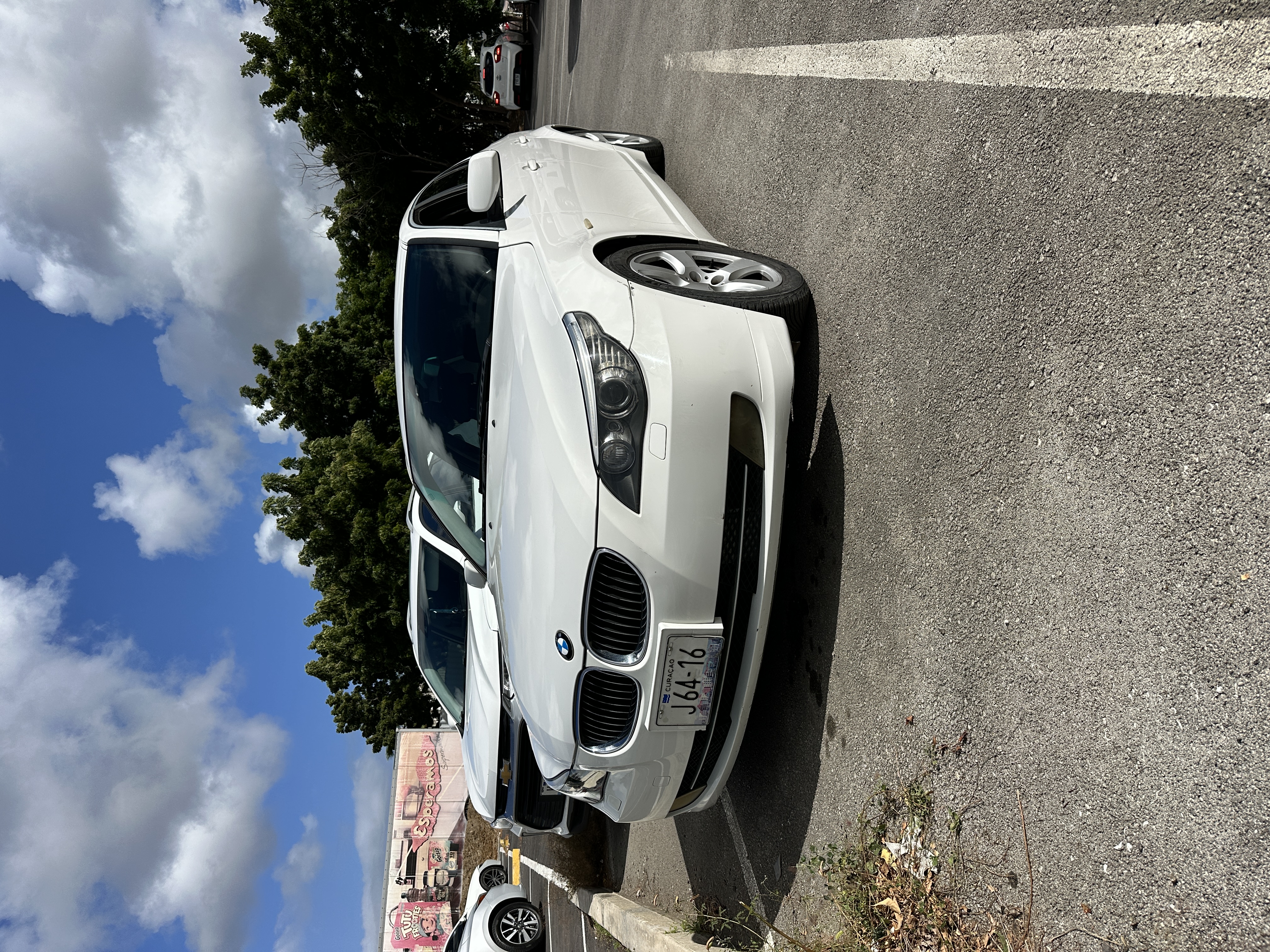

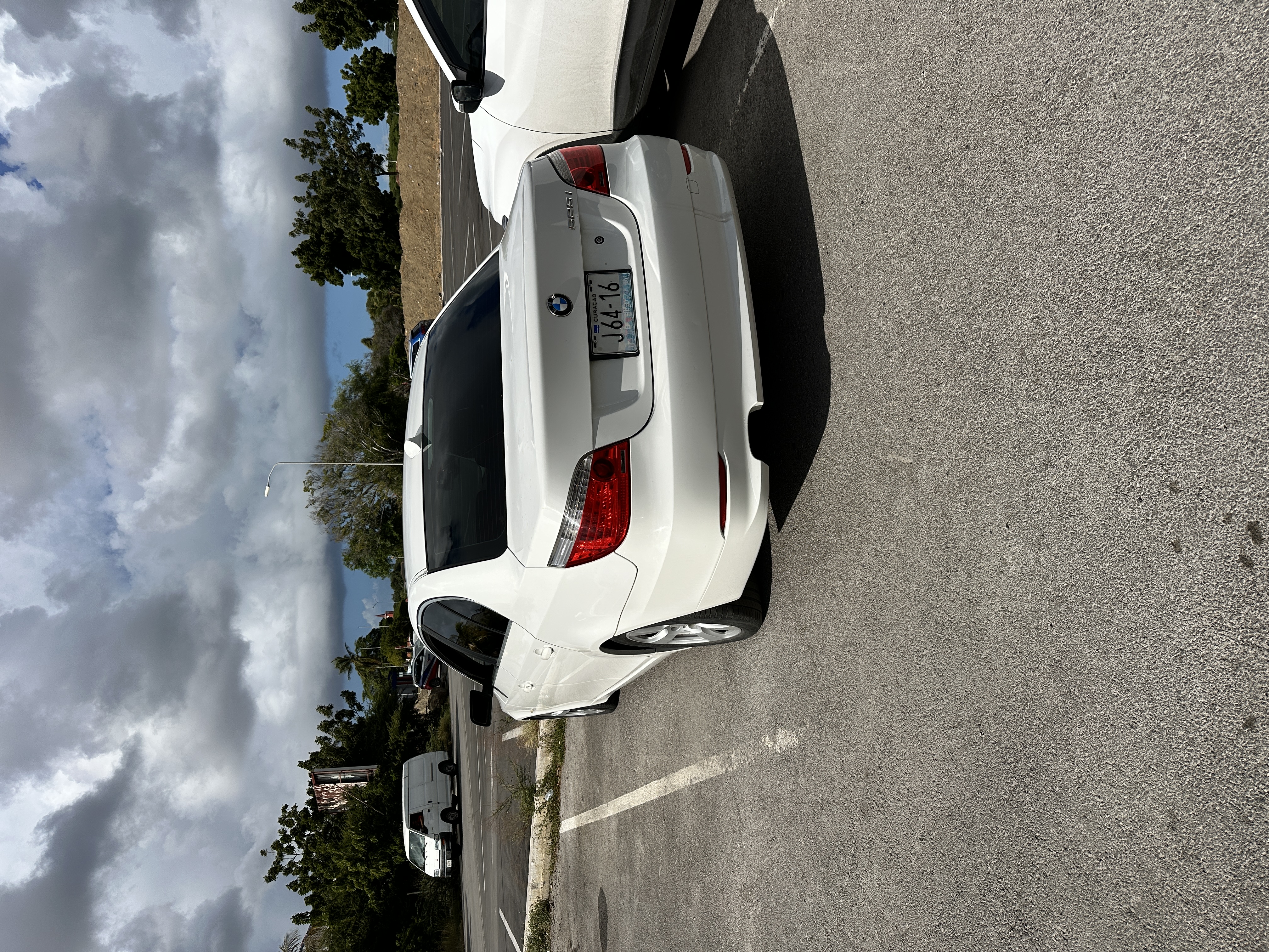

Re: BMW E60 2007 conversion
annnddd. today jan 20th, 2026......road legal
still need to install and plumb the AC system...but i can drive it to the shop.
im suprised...did it in less than a month...
idontknow why the pictures are sideways...sorry Gregg
